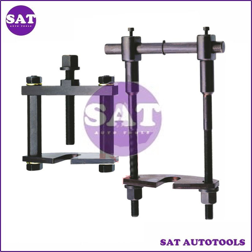

<p dir="auto">I need one, does anyone have one I could borrow? </p>
<p dir="auto">Now, before you comment, yes I know you can get them off by drilling, prying, burning, basically destroying yada yada, but I want to save the bushings that are installed as they only have a few miles on them. Is this dumb of me?</p>
<p dir="auto"><img src="https://i.ebayimg.com/images/g/6bIAAOSwjXRXX4HH/s-l1600.jpg" alt="s-l1600.jpg" class=" img-fluid img-markdown" /><img src="http://i178.photobucket.com/albums/w276/monty23psk/DSC04318.jpg" alt="Image result for BMW Front control arm bushing tool" class=" img-fluid img-markdown" /></p>

<p dir="auto"><strong><a href="/post/97833">straight6pwr said:</a></strong></p>
<p dir="auto">i was able to use a 3-jaw puller. I drilled a shallow hole on the end of the control arm stub to keep it from walking off.</p>
<p dir="auto">I tried this first, but was unsuccessful, then I posted here.  </p>
<p dir="auto"><strong><a href="/post/97834">Boris3 said:</a></strong></p>
<p dir="auto">Doh, drilling a shallow hole...should have thought of that.</p>
<p dir="auto">I got mine off with a three jaw puller, but between the walking tool and not having a solid pull surface against the rubber (like the picture of the tool) and with only the jaws on the lollipop I tore up the CAB in the process. Might work for <a class="plugin-mentions-user plugin-mentions-a" href="/user/jdesign" aria-label="Profile: Jdesign">@<bdi>Jdesign</bdi></a> since his CABs are pretty much new.  </p>
<p dir="auto">And this i why I was unsuccessful. I saw the rubber start to flex and I didnt want to tear it. I might just make a plate to fit on the back side and use a 3 jaw.</p>

<p dir="auto">Bushings are new, but you need the lollipop? Trade someone for some shitty old ones, or just burn/cut them out. That Farm and Fleet puller in the picture will still be a PITA. Spend an extra hour at work next week to make up the cost, and save yourself 2 hours of dicking around at the shop. It pains me a little to say these things, but it's the truth.</p>
<p dir="auto">The reason I want them off is I have Condor solid mount replacements. The control arms themselves are newer Lemforder units. I can easily remove them, but without the proper tool they will be destroyed.. The lollipop is not needed either.. here is what the replacement looks like:</p>
