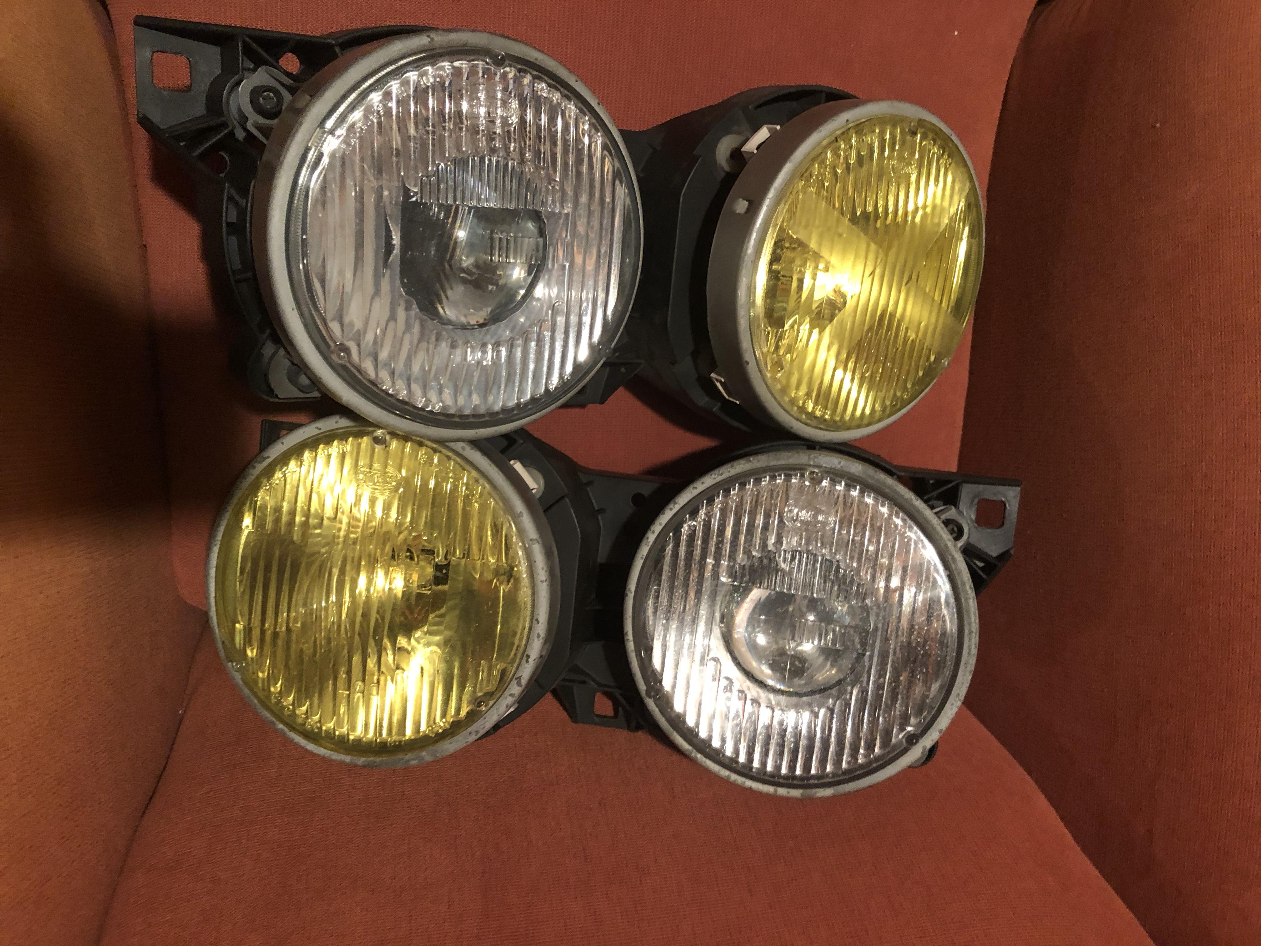

<p dir="auto">Not attached to these at all, just got a great price and figured to use them or sell to fund as bi xenon performance is what I’m after.</p>
<p dir="auto"><a href="/assets/uploads/files/monthly_2019_01_20B1FE02-F070-4722-8C96-2F25430286BD.jpeg.e5bc2f8e53ebcd6a442e961e9e8e2004.jpeg"><img src="/assets/uploads/files/monthly_2019_01_20B1FE02-F070-4722-8C96-2F25430286BD.thumb.jpeg.639bd54ccdfd20c7cece3b679aa2c503.jpeg" alt="20B1FE02-F070-4722-8C96-2F25430286BD.jpeg" class=" img-fluid img-markdown" width="1000" height="750" /></a></p>

<p dir="auto">also, e30s have no horizontal leveling in the system other than tilting the whole headlight assembly so you have to get the levelness of the cutoff nearly perfect as well. test and double check your alignments in stages so you don't have to back-pedal a ton.</p>

<p dir="auto">there was some guy making adapter plates in the past, not sure if those are around anymore. dig on R3v</p>
<p dir="auto">DEPO brand lights, like your ecstuning link shows, are garbage for light output.  the stock headlights are better.</p>
<p dir="auto">the best plug-and-play upgrade is to find real Hella or Bosch Euro headlights and install HID bulbs into them. </p>
<p dir="auto">the cheapest route is HID bulbs in the U.S. ellipsoids you may already have in the car. </p>
<p dir="auto">stay away from anything LED for these type of headlights. HID is far superior. </p>
<p dir="auto">----------</p>
<p dir="auto">all that being said, i've done the bixenon retrofit into e30/e34 headlights 5 times now, and its worth the effort. </p>
<p dir="auto">if you decide to dive in, i've done a mini write-up and can provide advise as needed. Check post January 21st below</p>
