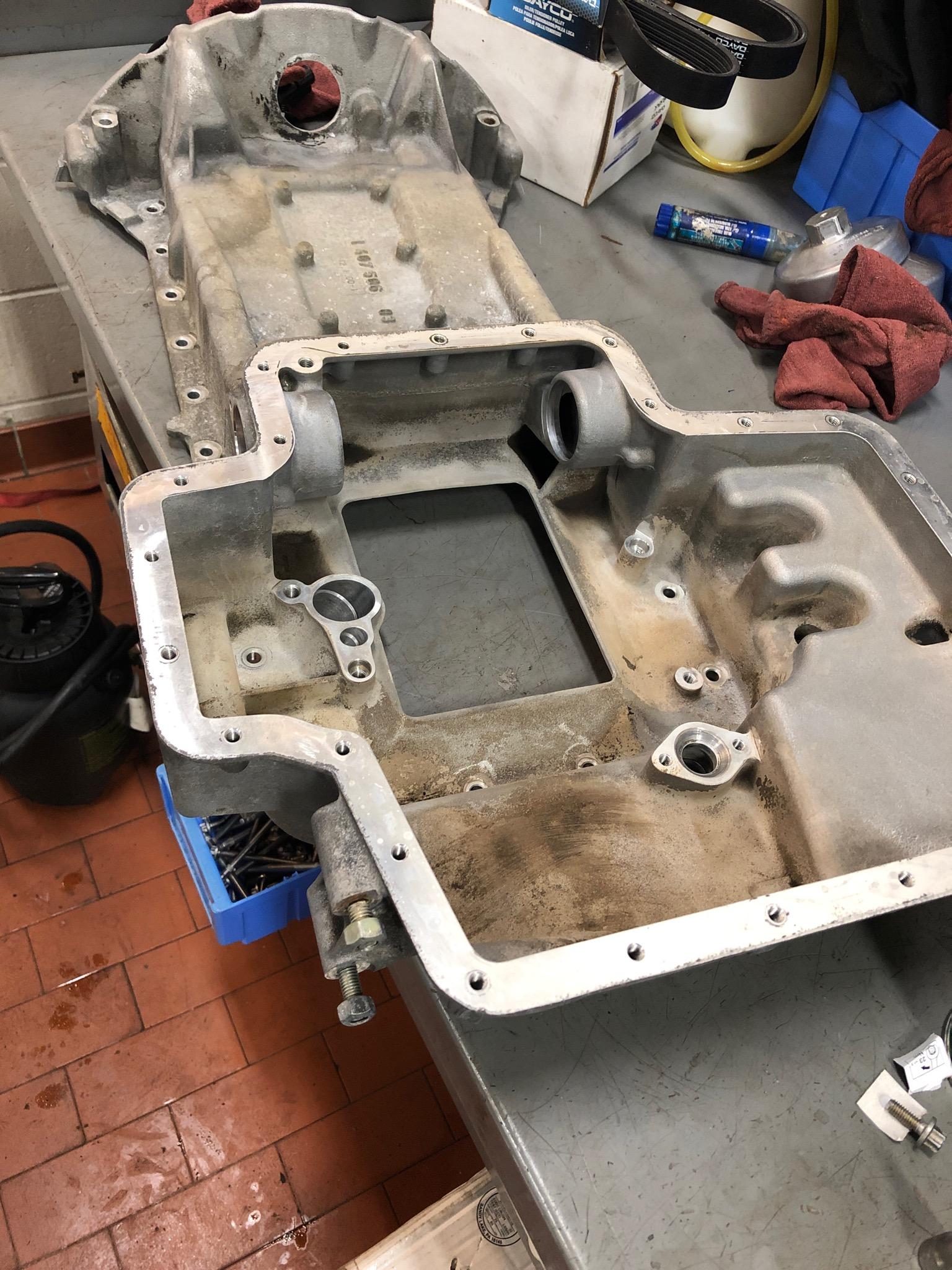

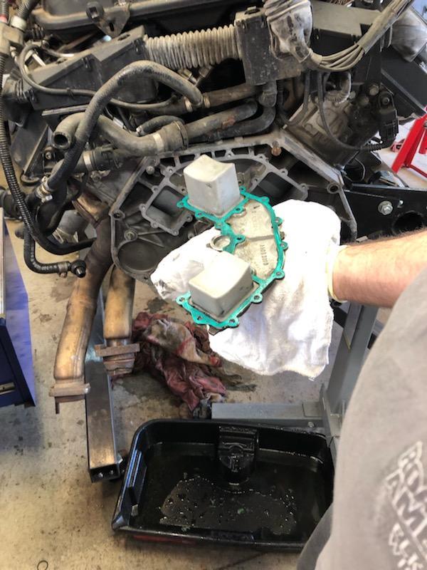

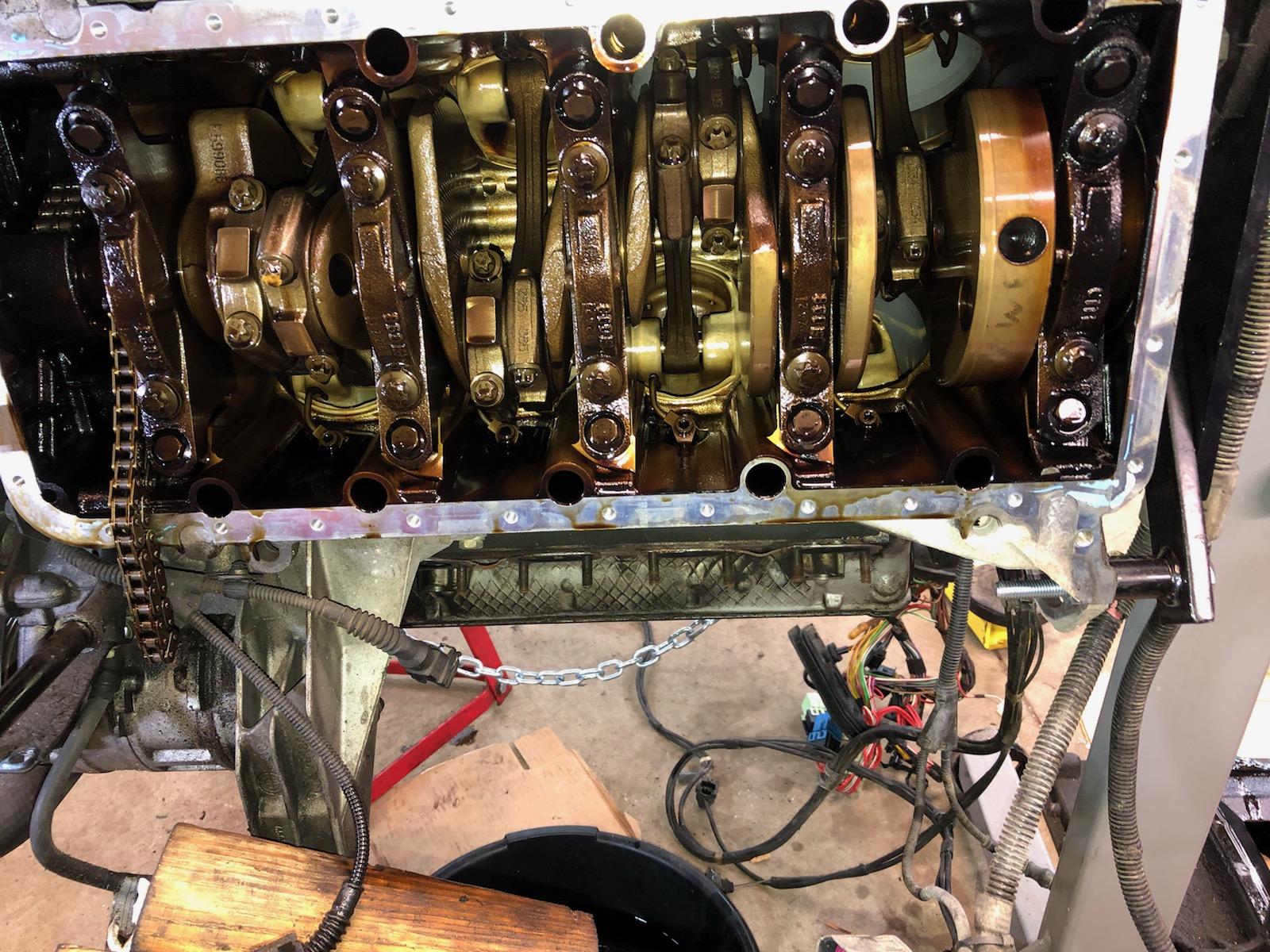

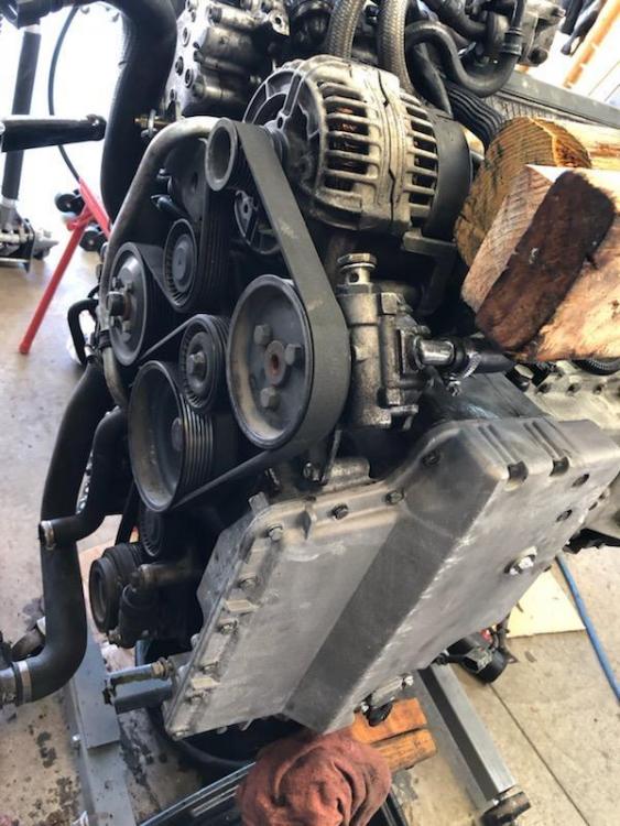

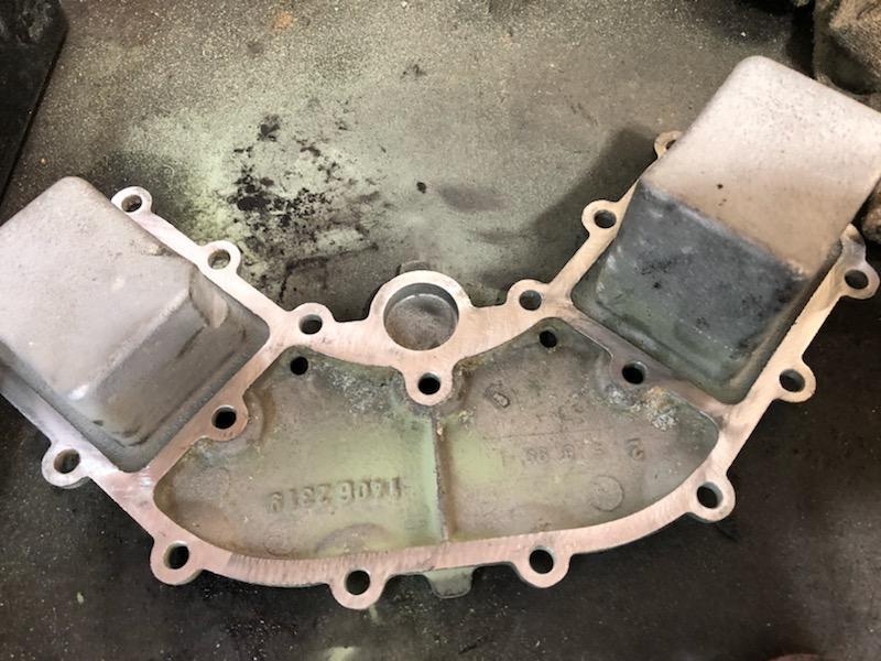

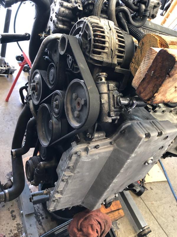

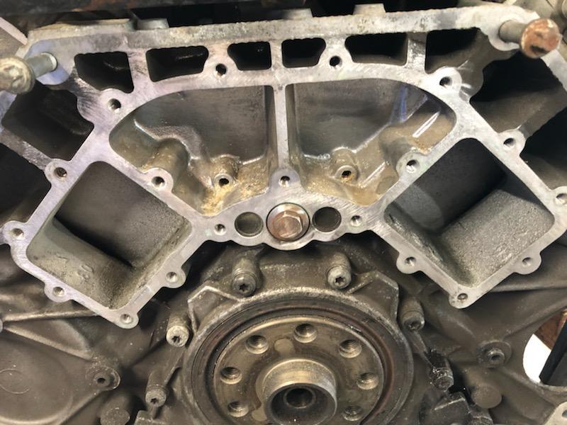

      Getting off to a little slow start.  During shipping, a caliper snuck under the oil pan and, a bunch of bumps later, cracked it.  The guy I bought the motor from sent a "new" upper oil pan.
      The oil pan and some other parts saw the parts washer.

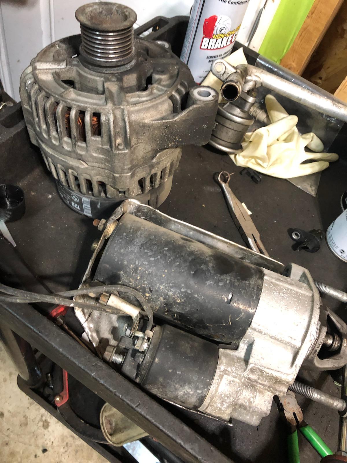

      Got the alternator and starter rebuilt for good measure!
      Chip, chip, chipping away!

          Motor is on the engine stand!  Upper oil pan gasket is coming Monday.

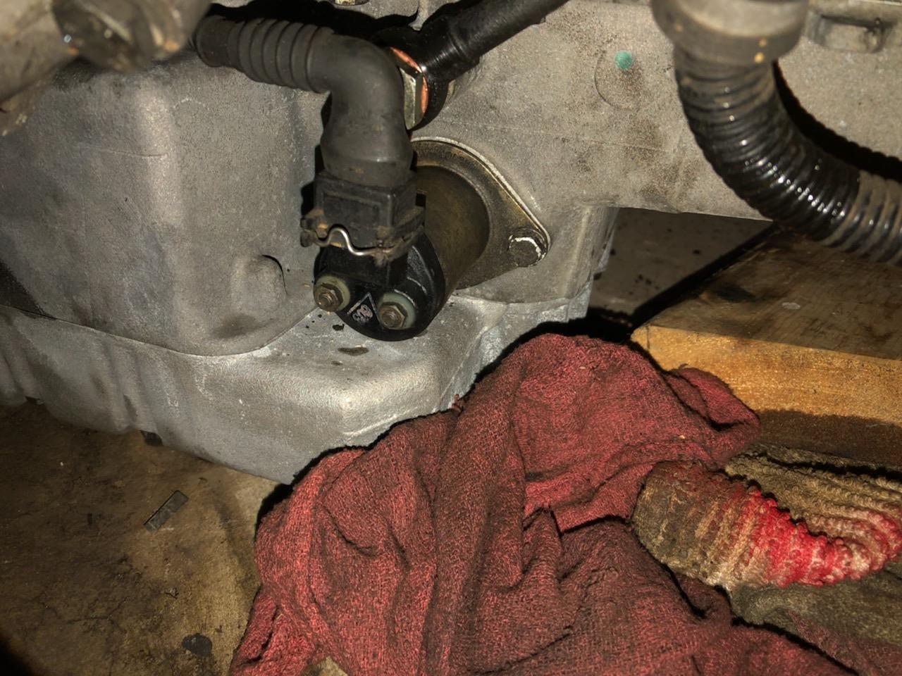

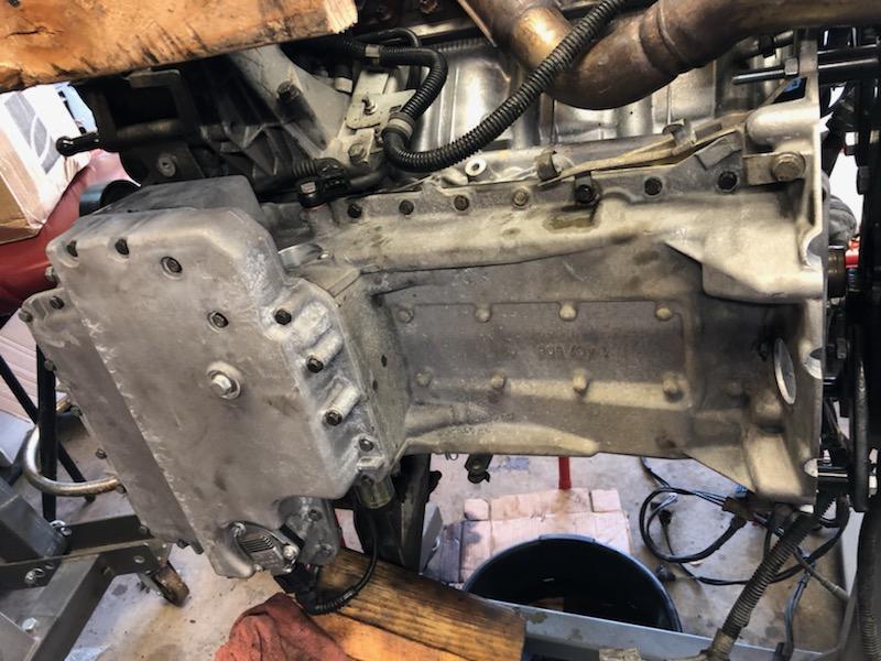

            Updates! New pan is going on as we speak.

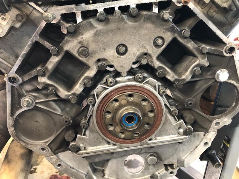

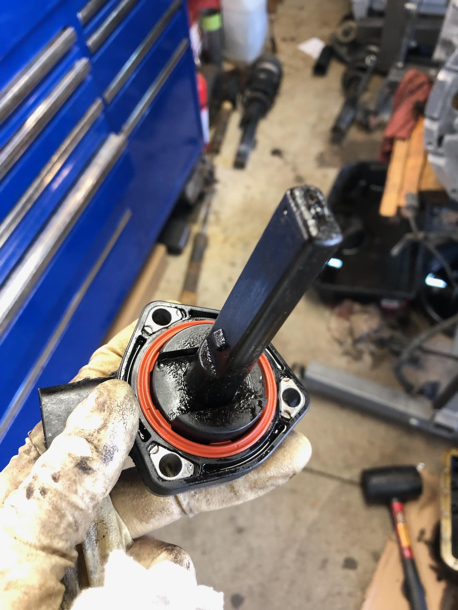

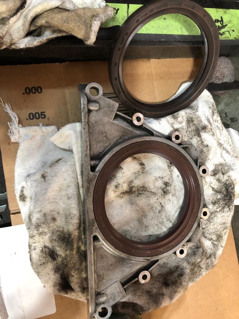

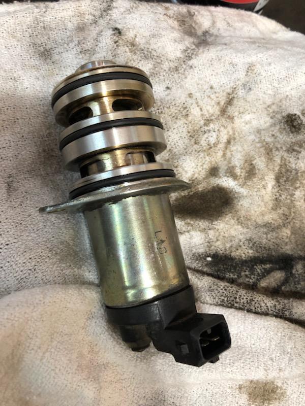

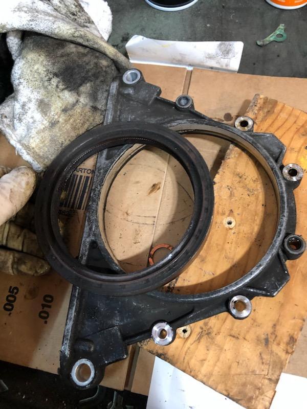

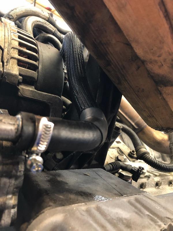

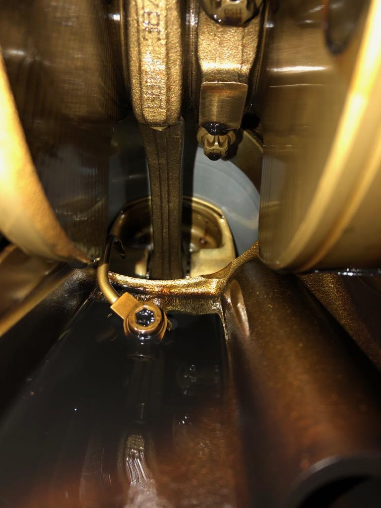

              Mike B. has been chipping away at the motor.
              New upper and lower pan gaskets, all new o-rings for the pan/oil solenoids, rear main, coolant gasket, power steering return hose & oil level/temp gasket.

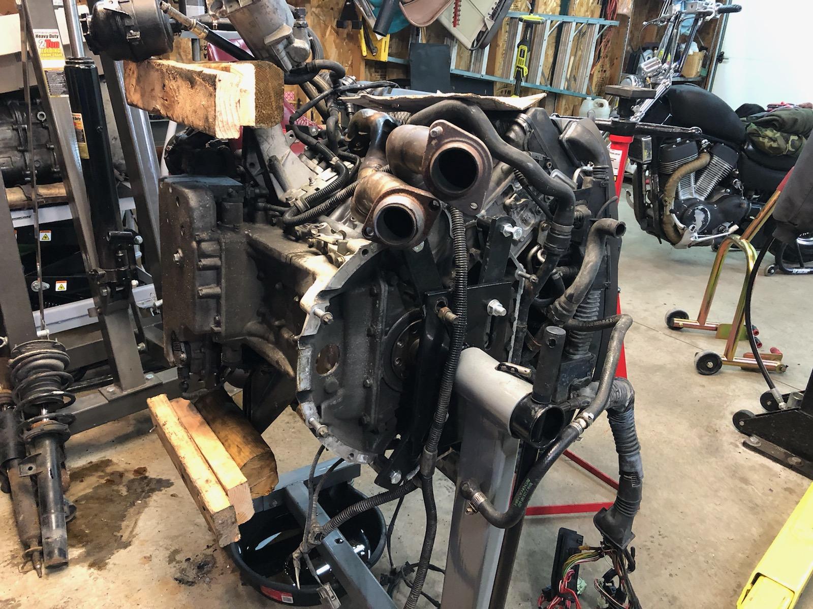

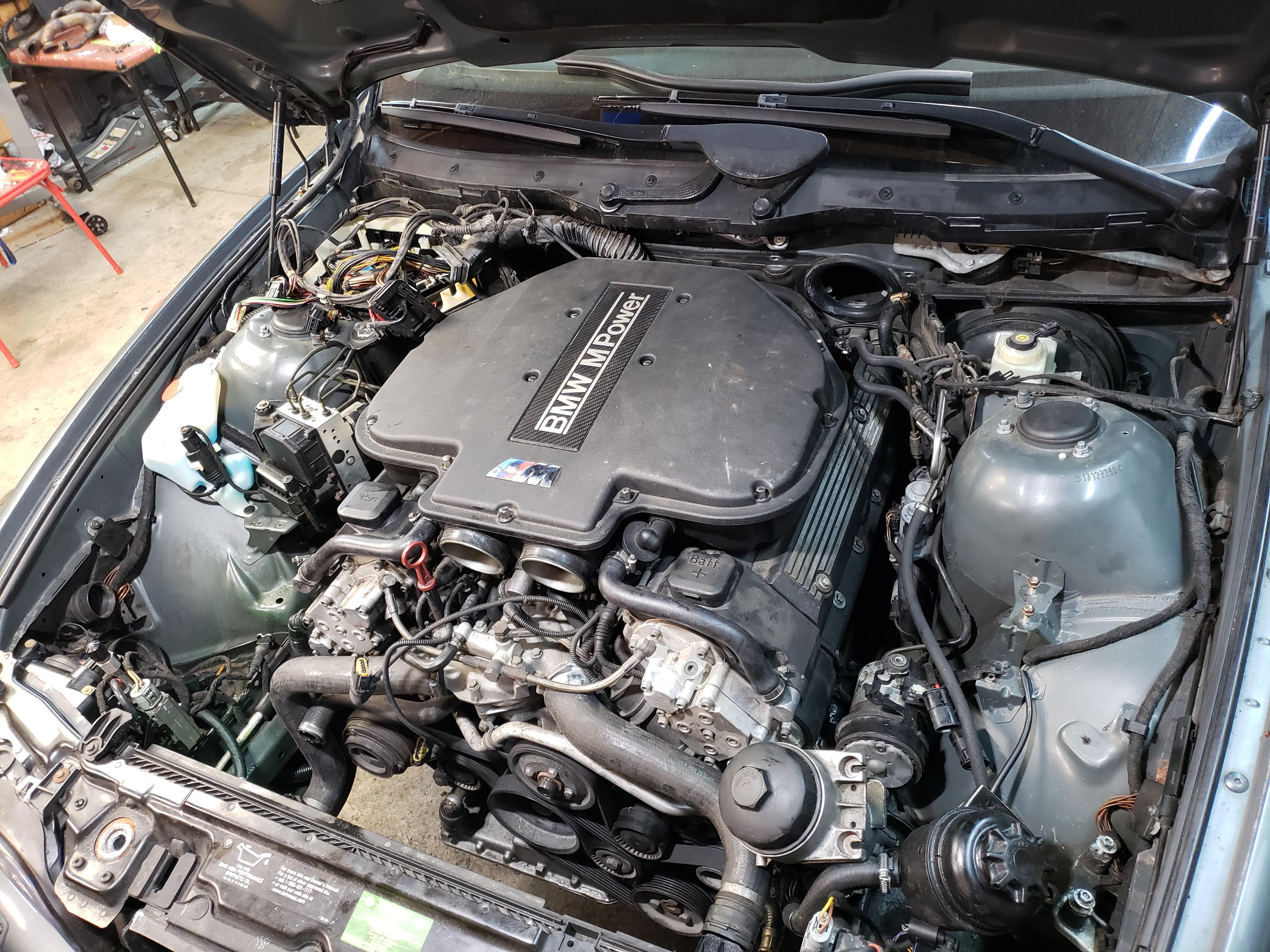

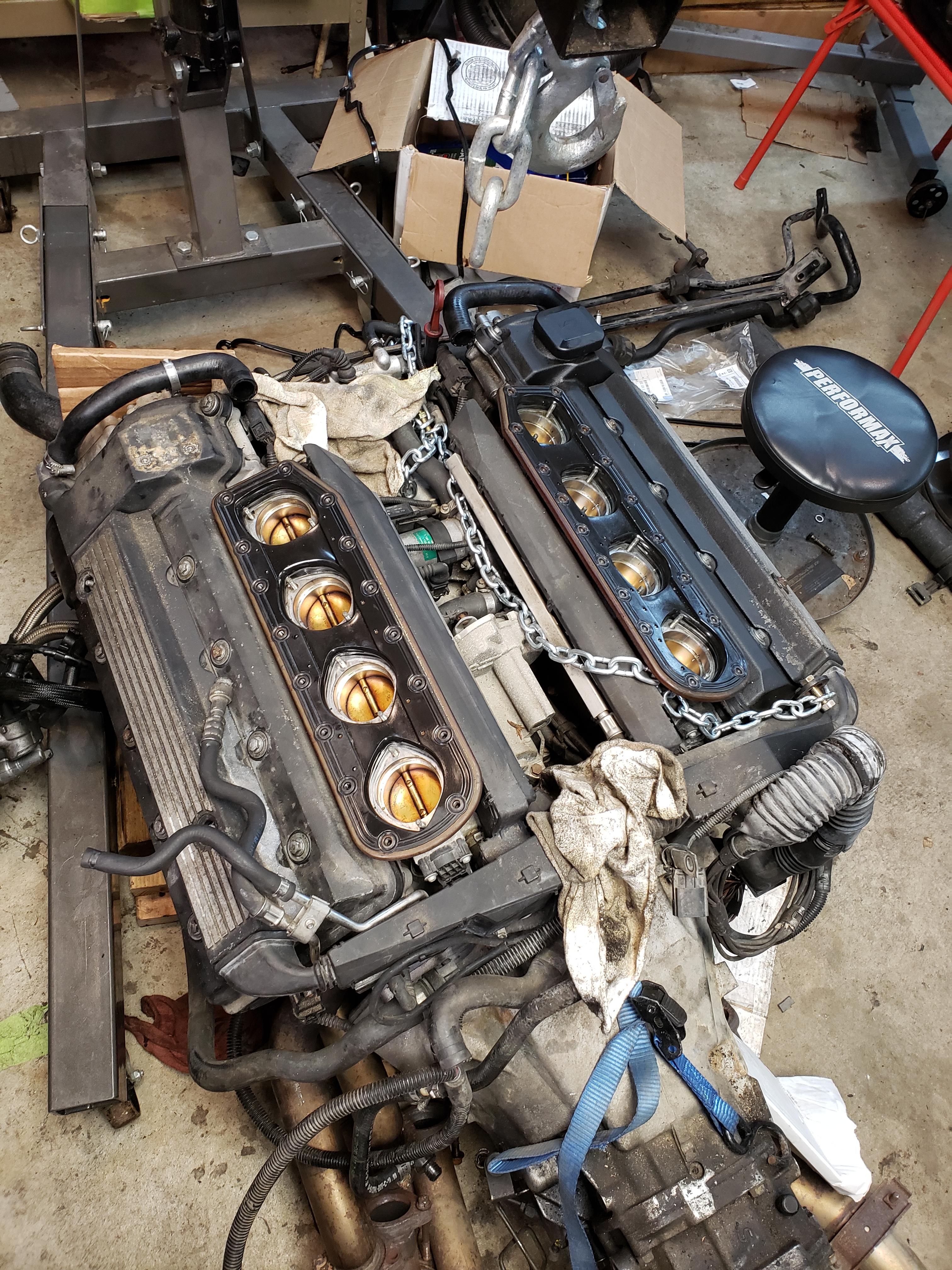

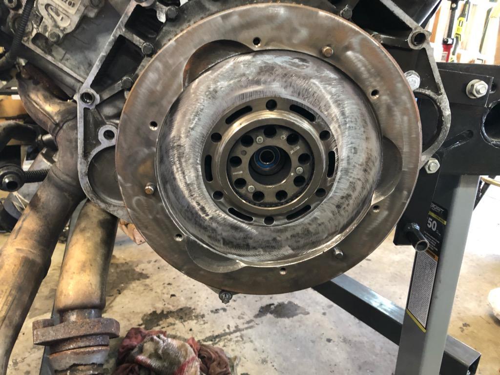

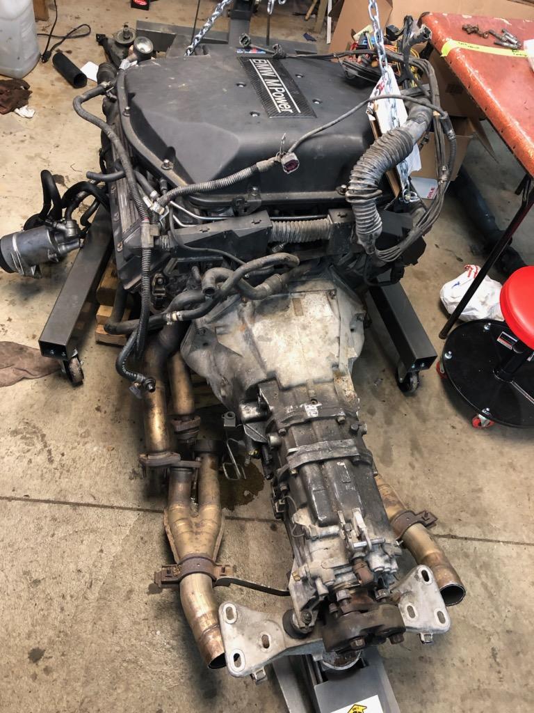

                  M62tu is out!
                  S62 has new valve cover gaskets and rubber washers.

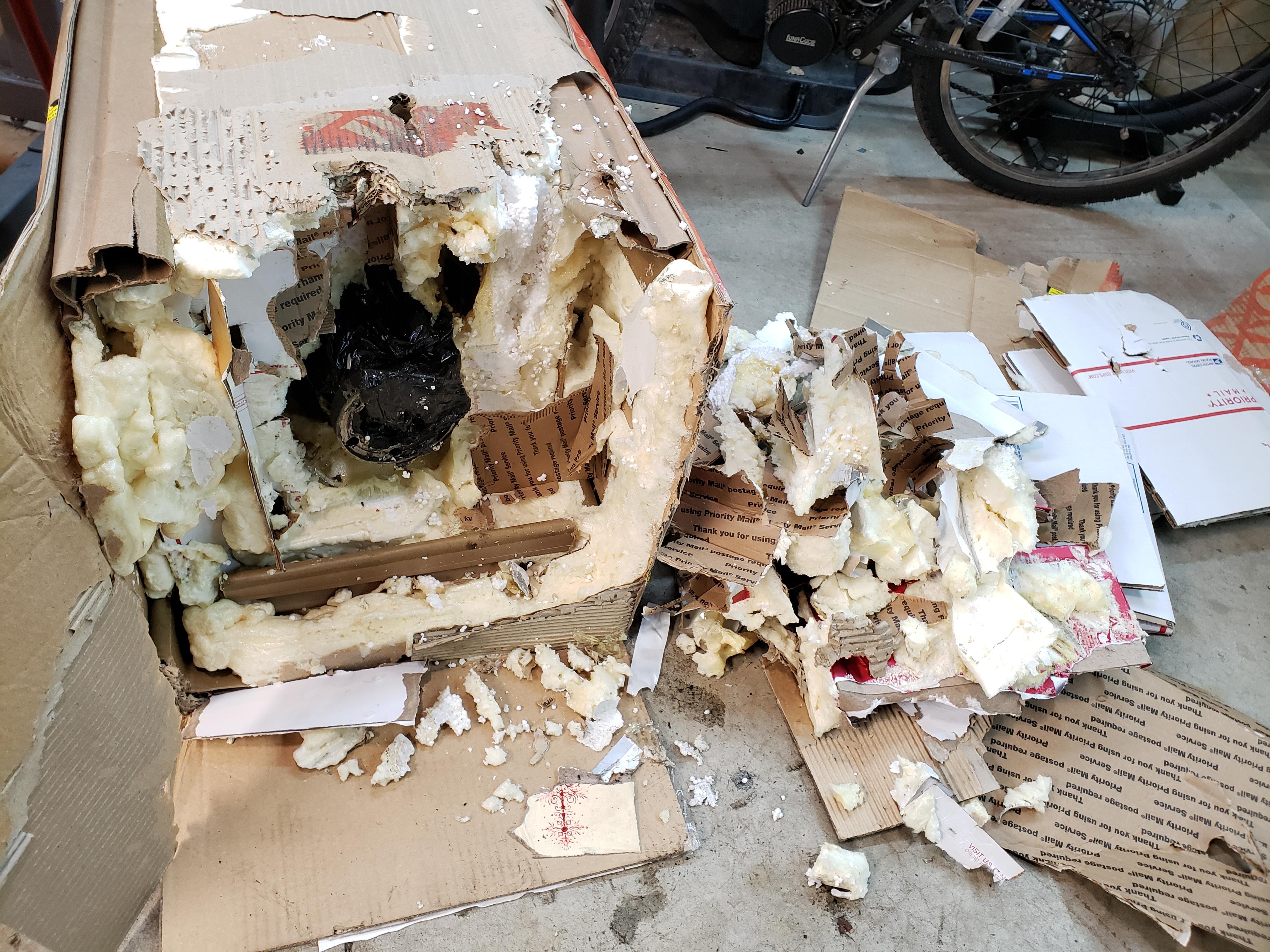

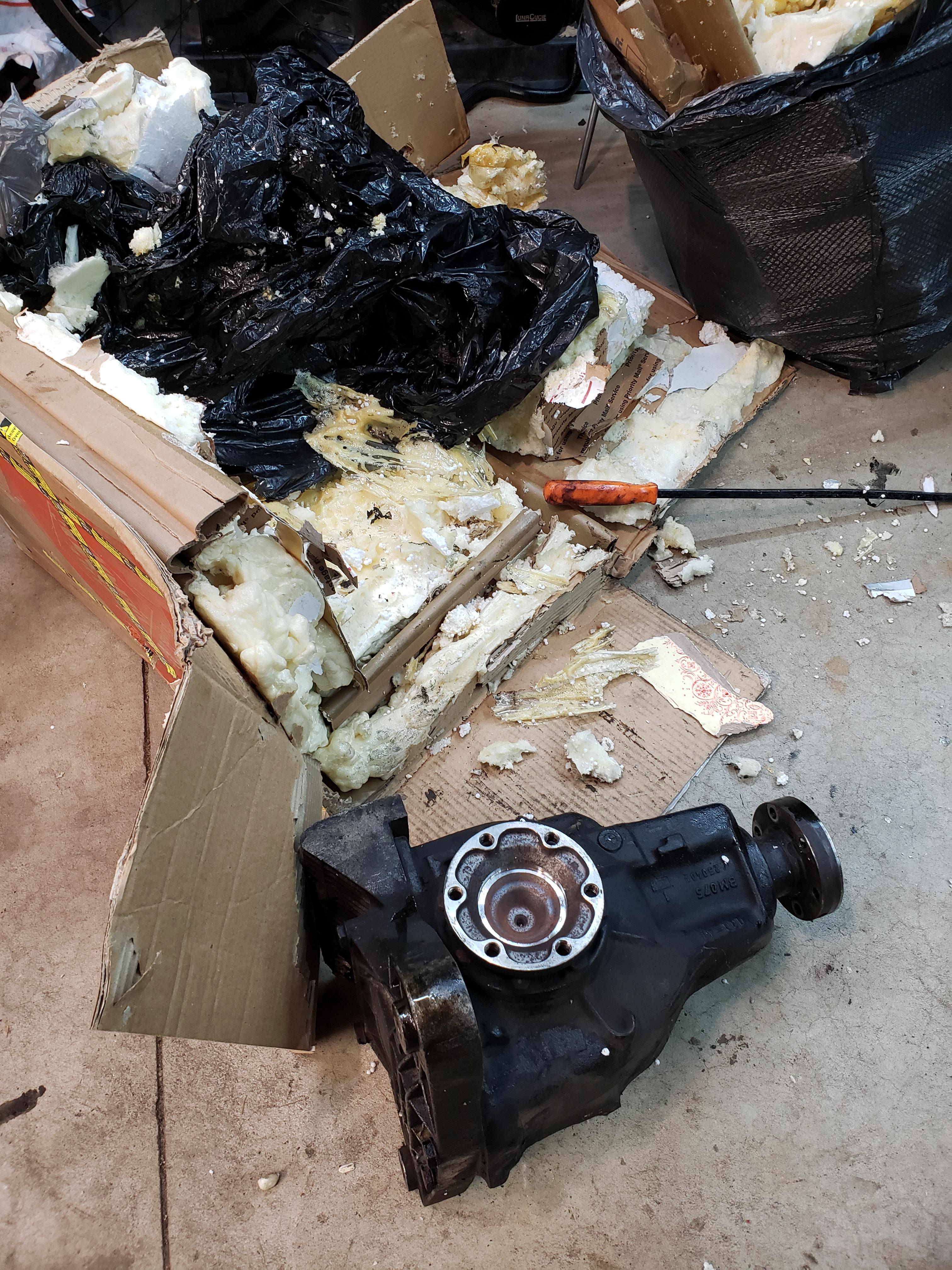

                  Unpacked the diff.  Pulling the motor was easier than ripping thr packaging apart!  Crazy!

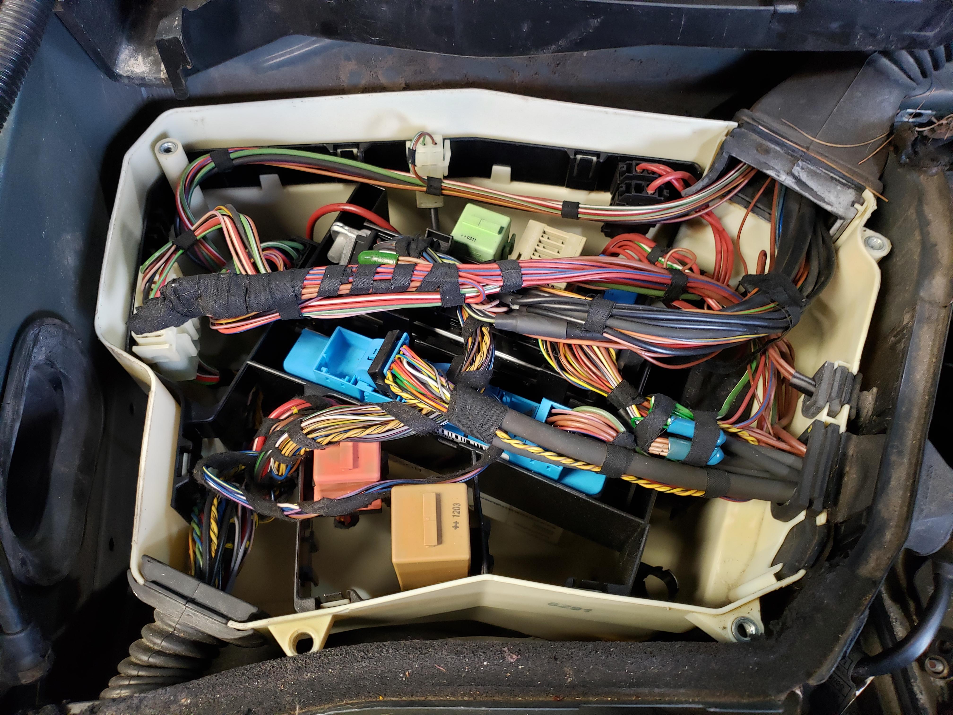

                    Is there a lot of wiring that will need to take place? Or is it mostly plug and play?
                    • DrLeadFootD
                      DrLeadFootD
                      DrLeadFoot
                      #70
                      Not down that rabbit hole yet but some repinning and running some wires should do it.

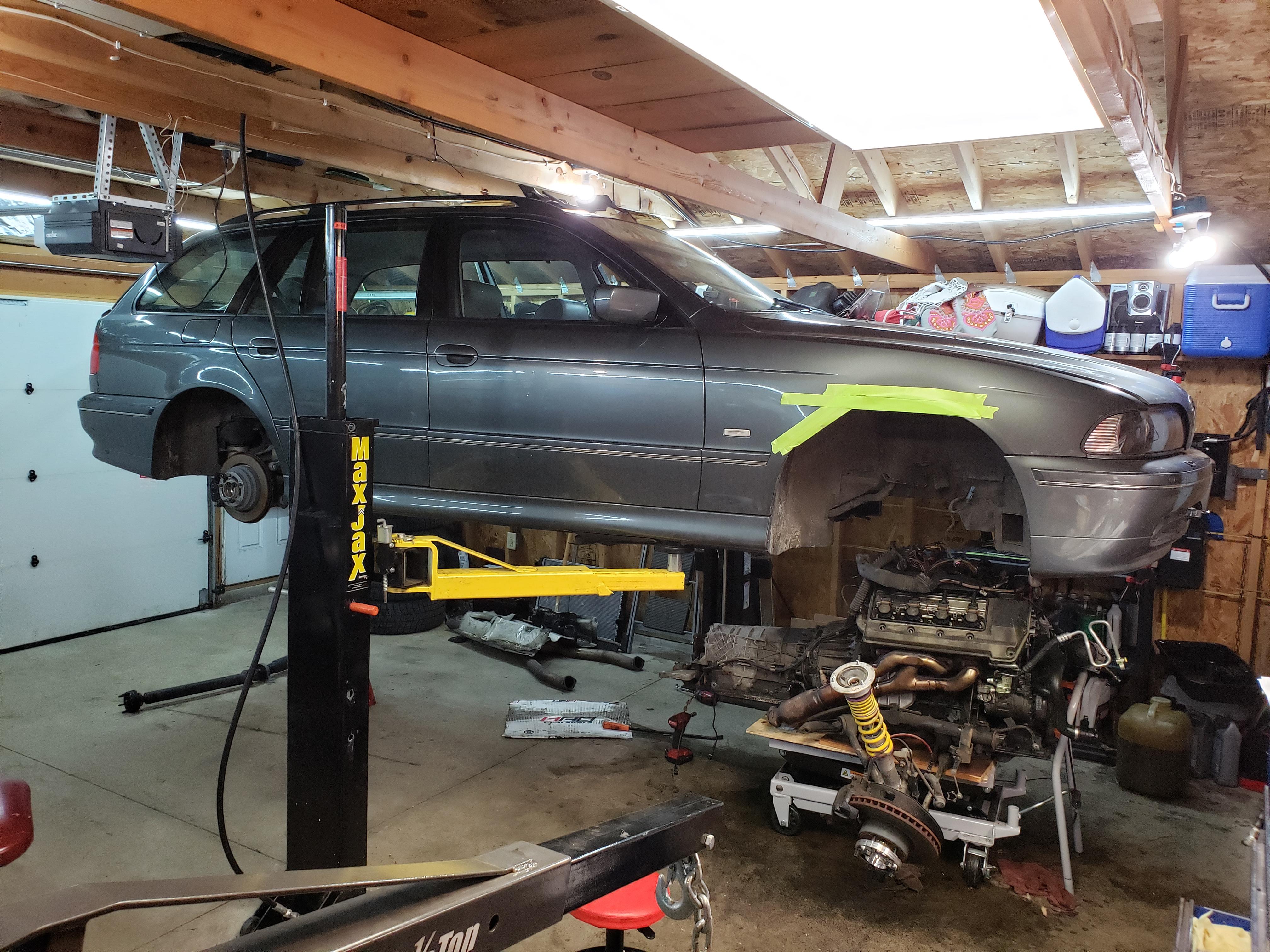

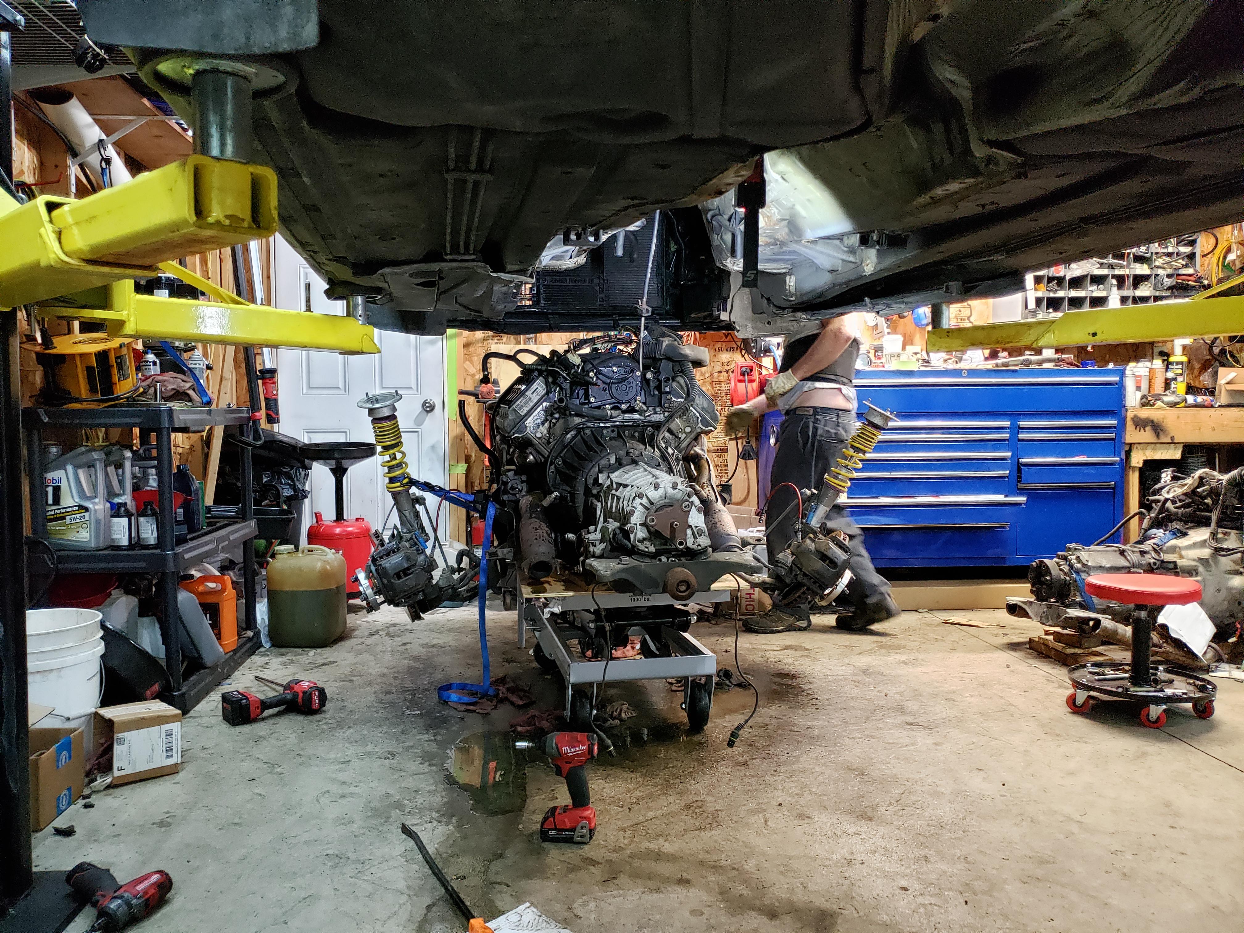

                                #75

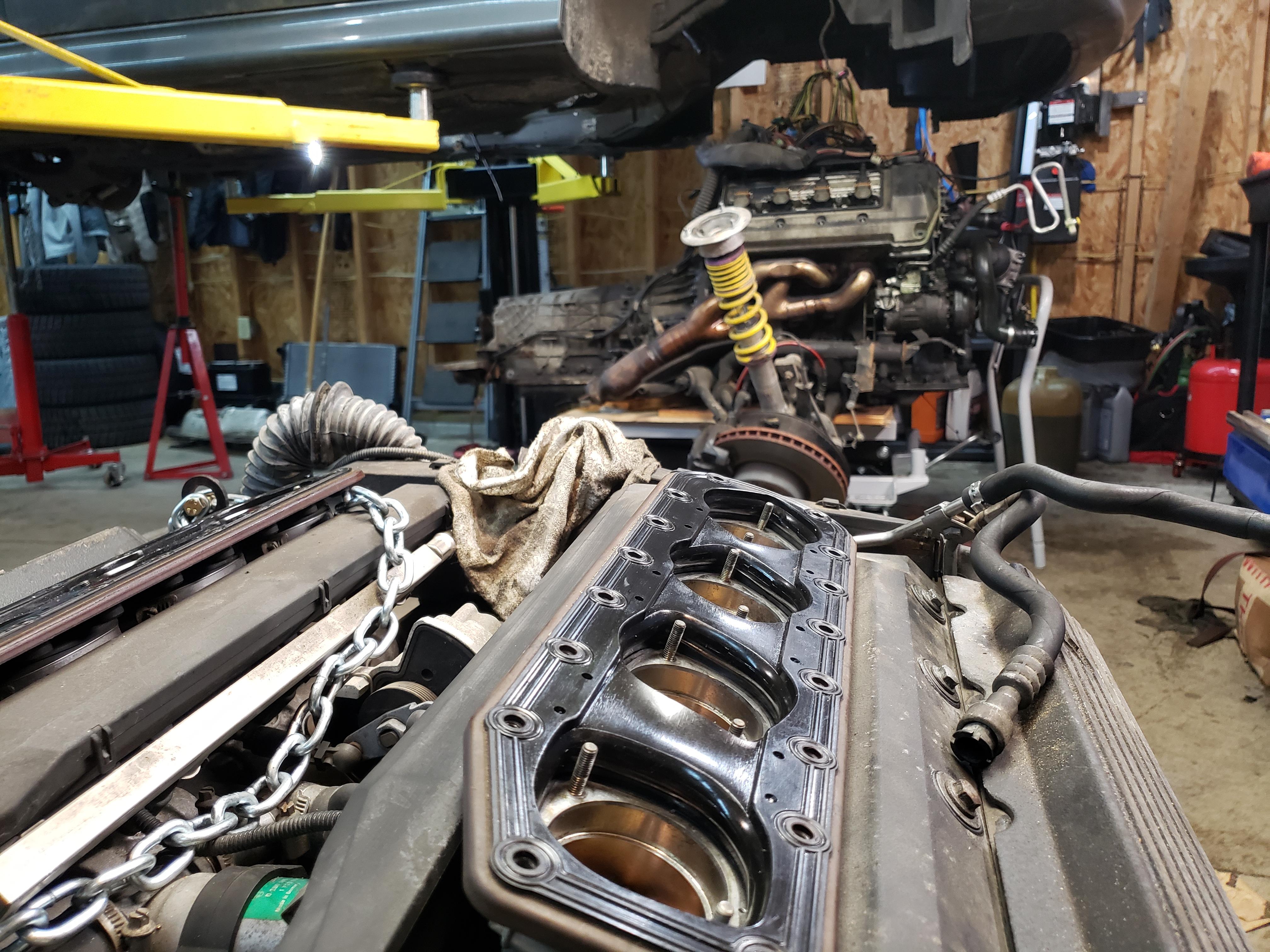

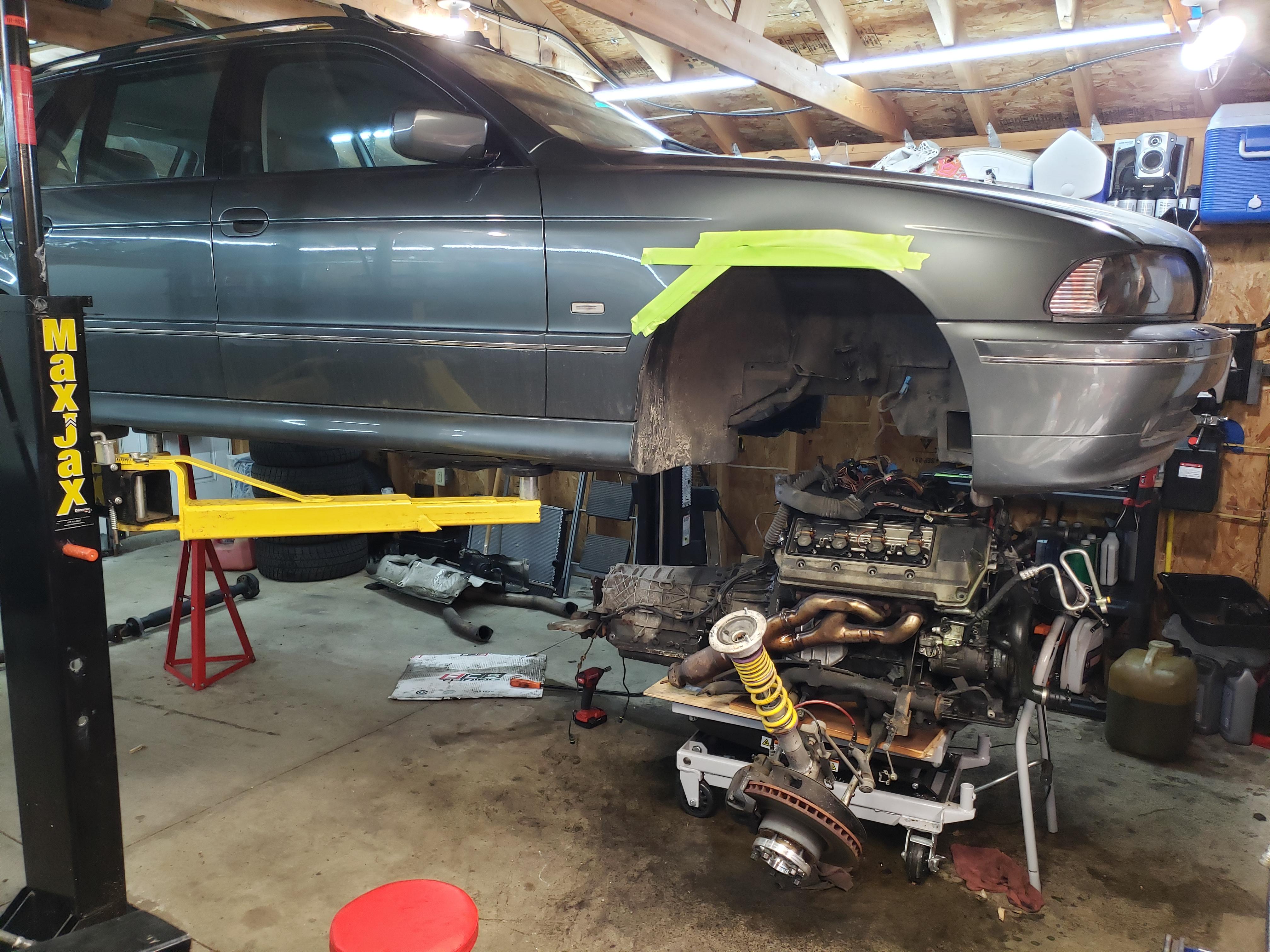

                                8 hours in so far!  A couple snags but nothing major yet.
                                Trans crossmember bolts up to holes that weren't used before.  Needed to run a tap through to clean them up.
                                Installed:
                                M5 steering box, swaybar, motor & trans.
                                Just bolted up the subframe, trans, pos. & neg. cables and starter power wire then called it for the day.

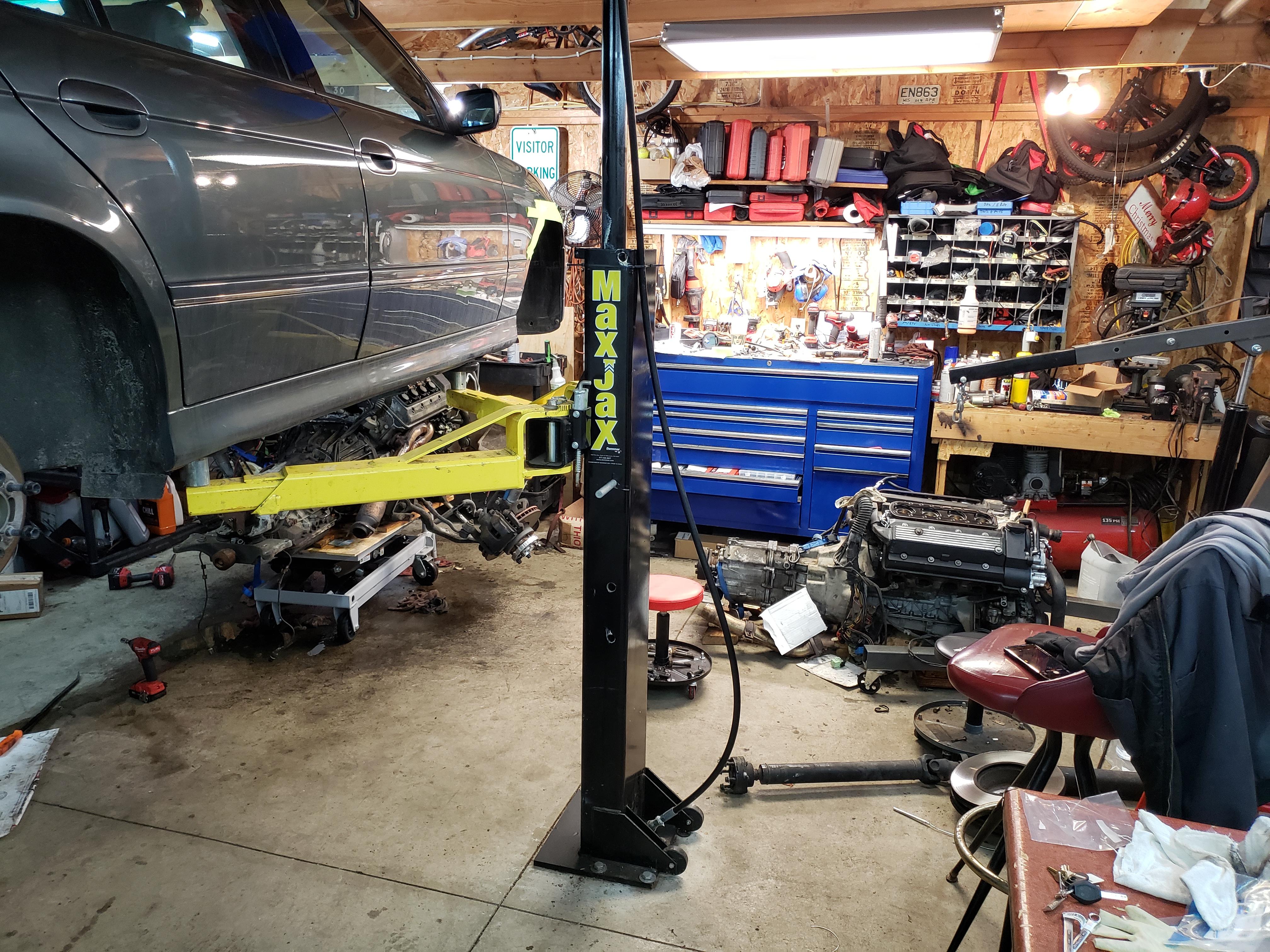

                                         @DrLeadFoot
                                      #78
                                      Awesome!
                                      Side note, thoughts on the MaxJax lift system? I've been looking into either that, or this: https://www.gregsmithequipment.com/Atlas-BP8000
                                      I would have to notch my ceiling (104") to fit the Atlas lift (108"), but feel like it'd be a better long-term option. The MaxJax could be installed as-is and are portable.
                                      • DrLeadFootD
                                        DrLeadFootD
                                        DrLeadFoot
                                        #79
                                        suspenceful said:
                                        Awesome!
                                        It's my buddy's lift and he likes it a lot.  It hasn't been able to hold us back on what we're throwing at it. 4 stars!  Lol

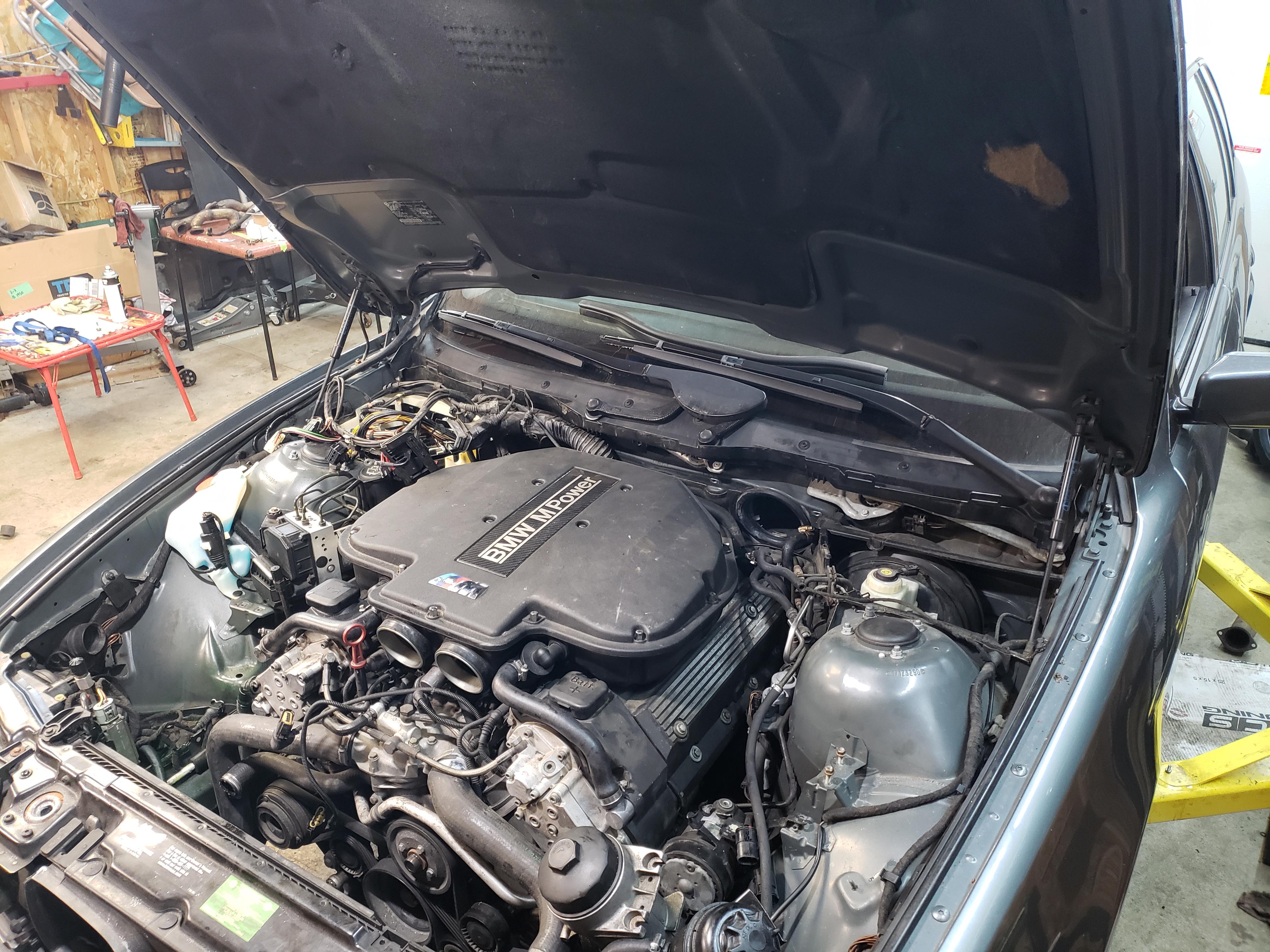

                                          Progress!

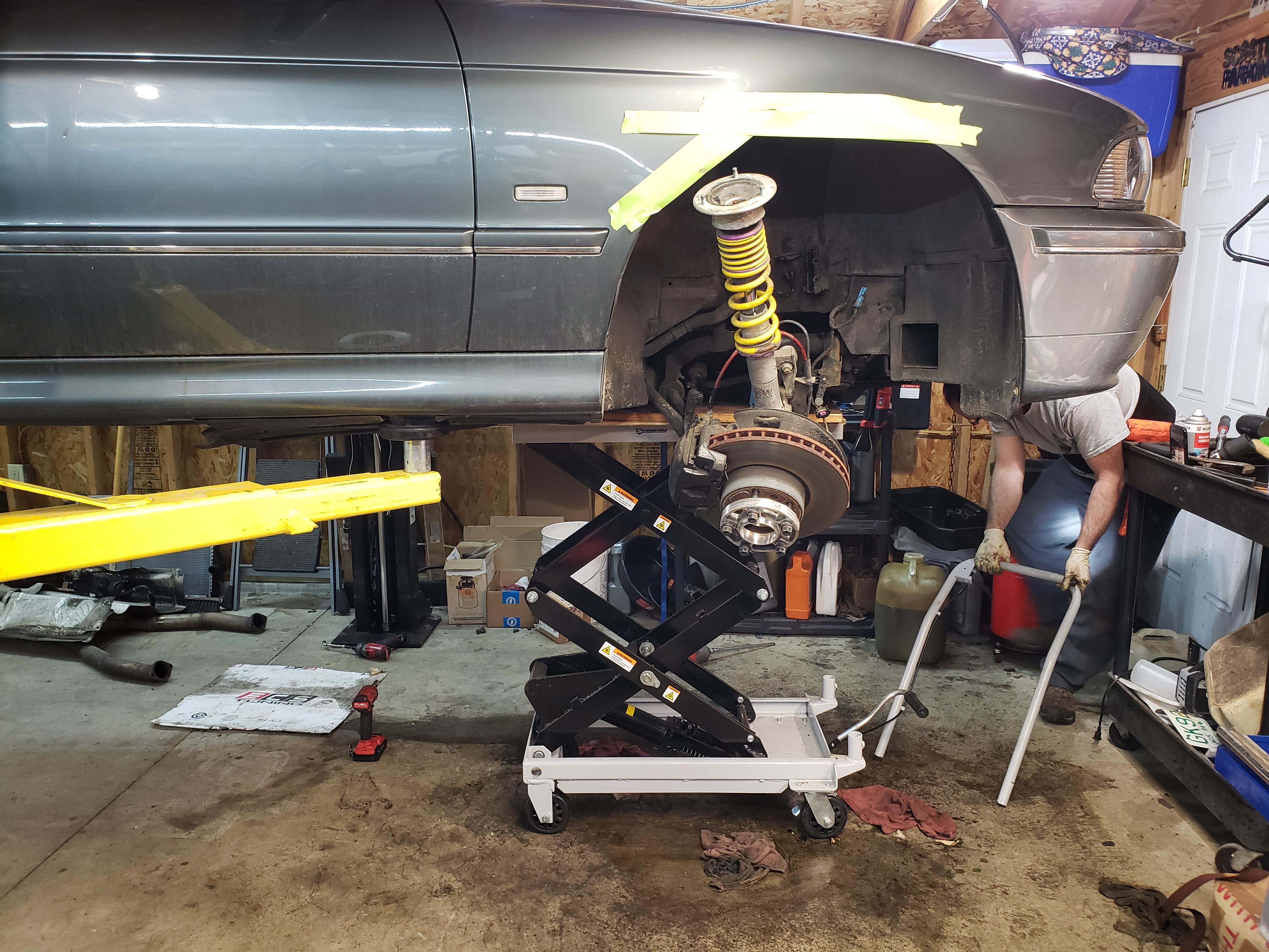

                                          Front M5 brakes all buttoned up.

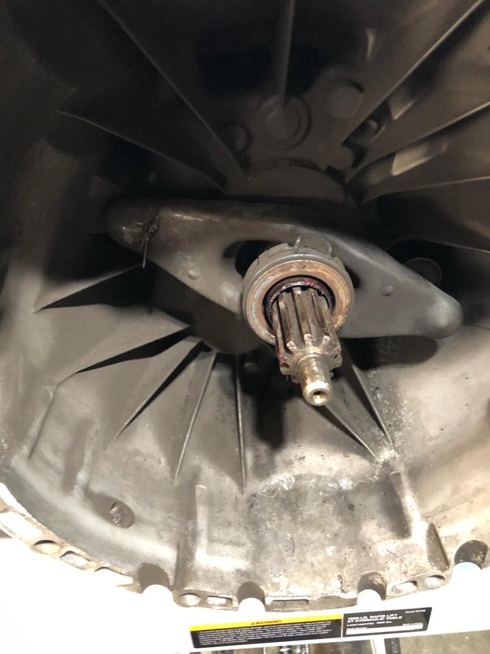

                                          Rear: 540i diff and axles out.  Passenger side M5 brake all buttoned up.  Needed to notch out the m5 backing plate to make way for the caliper.  Might be the air suspension that was different to the M5.
                                          Diff out, m5 diff cleaned up and new pinion and output shaft seals installed.
