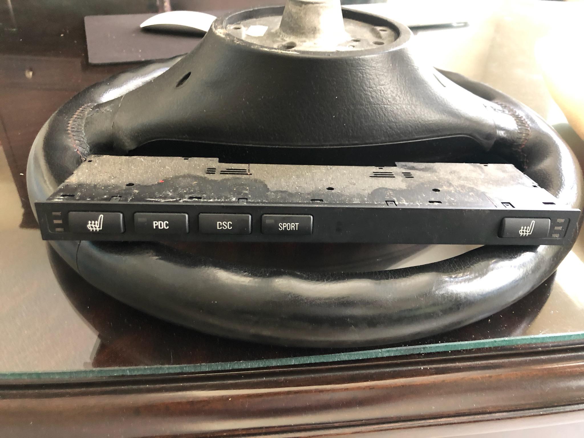

        Parts are slowly being pulled and making their way onto the 40x48" pallet!  Please excuse the blue & red text.  That is the seller and I both adding items to the list.
        -2002 -S62 115k miles, 5k miles on chain guides, rod bearings, vanos
        -Engine wiring harness
        -Trans, Clutch & Flywheel
        -Dinan short shifter kit
        -Pedal assembly (clutch, brake and gas pedal) Clutch Master & Slave w/lines
        -M5 Cluster
        -S62 exhaust manifolds
        -M5 Collectors
        -Intake assemblies w/MAFs
        -Cowl to cover wiring harness. Will be brittle.
        -Secondary Air pump with hoses
        -Coolant hoses
        -Radiator and shroud
        -Coolant reservoir Need M5 one.
        -M5 Steering box includes solenoid and sport button switch panel Female side of connector.
        -48 x 40 pallet U-Ship
        -EWS and Cat delete on ECU
        -Fan blade & Clutch
        -Initial Start up guarantee in writing.
        -M5 Driveshaft, Axles & Diff
        -Rear Reinforcement Bars
        -M5 Fuel pump
        -M5 fuel filter and pressure regulator
        -M5 Fuel lines We need to see whats actually different. But I can include whatever we need. If it isn't a big to-do, I would love to get as many of the lines as possible.  Looks like the lines coming into and out of the filter/regulator are different. I believe you are correct up until the regulator its the same after its a bit different as m5 uses a return line.
        -M5 ABS precharge pump, Bracket and any brake lines associated with this
        -M5 airbox tray for ABS lines to go through
        -Front and rear rotors with calipers
        -m5 good Guibo
        -Vacuum Lines, vacuum valve (engine & to regulator)
        -Power steering lines and reservoir w/hardware. Mounting bracket
        -Oil filter lines and filter housing w/hardware. Mounting bracket
        -Oil Cooler Control Valve and Associated lines
        -Grounding straps/wires
        -Positive voltage wires
        -Sway bars front and rear with bushings
