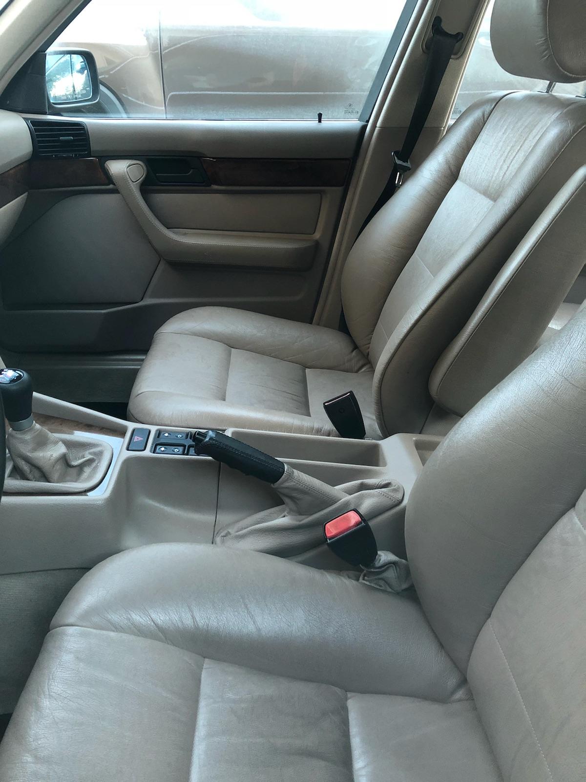

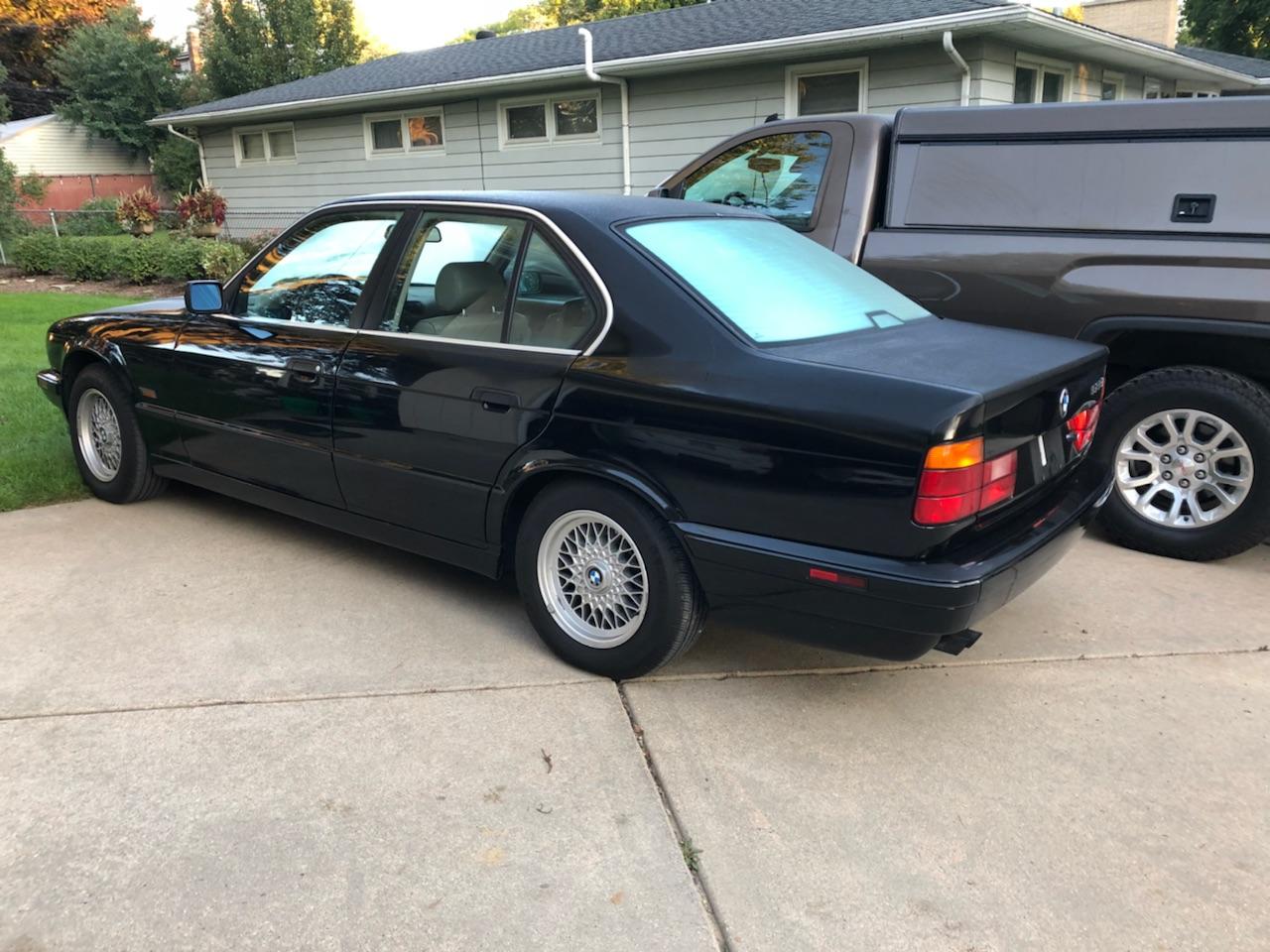

<p dir="auto"><a href="/assets/uploads/files/monthly_2018_09_624D4807-CC89-4510-98F8-5AA9E53E1268.jpeg.7aed2ead17a373c9ac55969b89cd26ca.jpeg"><img src="/assets/uploads/files/monthly_2018_09_624D4807-CC89-4510-98F8-5AA9E53E1268.thumb.jpeg.e6ab843b48c1d27b016bd9d7bedb3bc2.jpeg" alt="624D4807-CC89-4510-98F8-5AA9E53E1268.jpeg" class=" img-fluid img-markdown" width="1000" height="750" /></a></p>
<p dir="auto"><a href="/assets/uploads/files/monthly_2018_09_BAB2795C-CBE9-4843-9925-FD4F4C95858F.jpeg.ba6c75a460f4c55ca63802b95f4e8621.jpeg"><img src="/assets/uploads/files/monthly_2018_09_BAB2795C-CBE9-4843-9925-FD4F4C95858F.thumb.jpeg.e5b20f7a9b18e3399c41d55e4b5696cc.jpeg" alt="BAB2795C-CBE9-4843-9925-FD4F4C95858F.jpeg" class=" img-fluid img-markdown" width="563" height="750" /></a></p>

<p dir="auto">Otherwise that car is in stunning condition, I doubt it will bring many, if any, surprises.</p>
