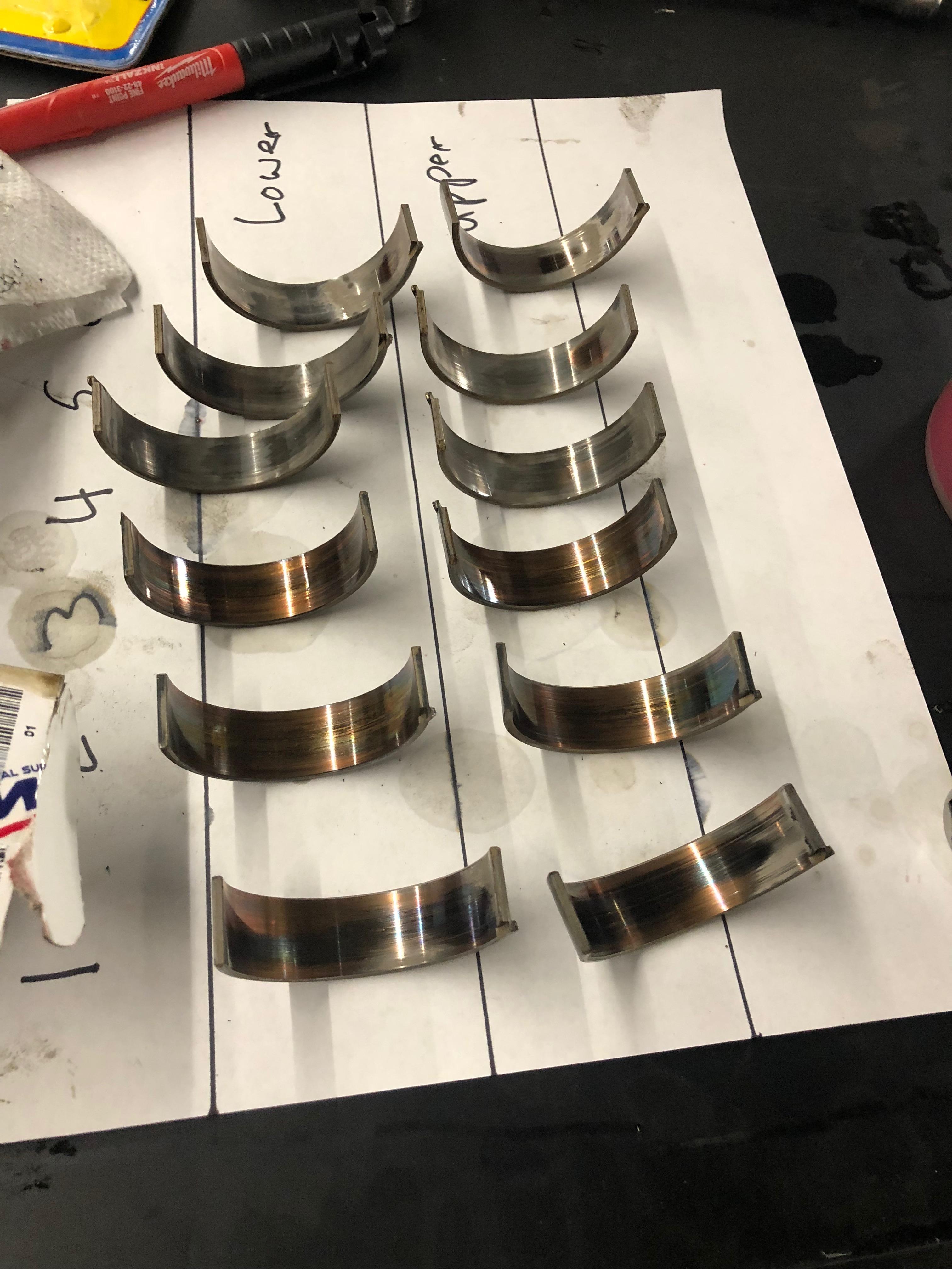

<p dir="auto">Then came my Blackstone analysis. Rod bearings completely toasted</p>
<p dir="auto"><a href="/assets/uploads/files/monthly_2018_09_IMG_9737.jpg.bbc3d09ee014d92cef61723ca529a4fe.jpg"><img src="/assets/uploads/files/monthly_2018_09_IMG_9737.thumb.jpg.787d8782aa800589e34ad003b6fc8985.jpg" alt="IMG9737.jpg" class=" img-fluid img-markdown" width="563" height="750" /></a></p>
<p dir="auto">So now I have new rod bearings. As luck would have it, when I went to test drive the car after bearing install, my cooling system started to take a shit. Temp needle quickly started to peg at the 3/4 mark and discovered my fan was dead. I took this as an opportunity to replace the radiator, water pump/tstat, and have an electric fan wired in to get rid of the factory mechanical fan. </p>

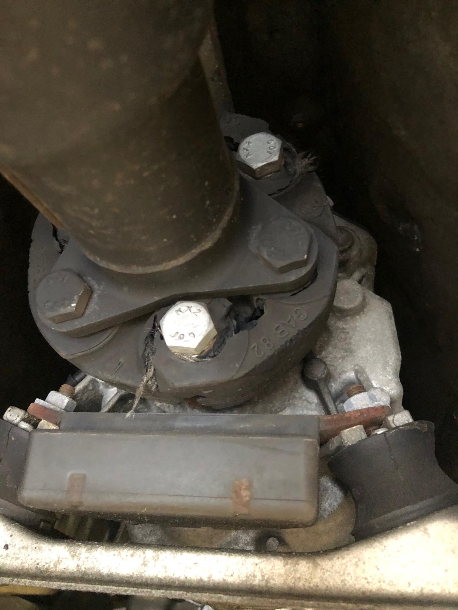

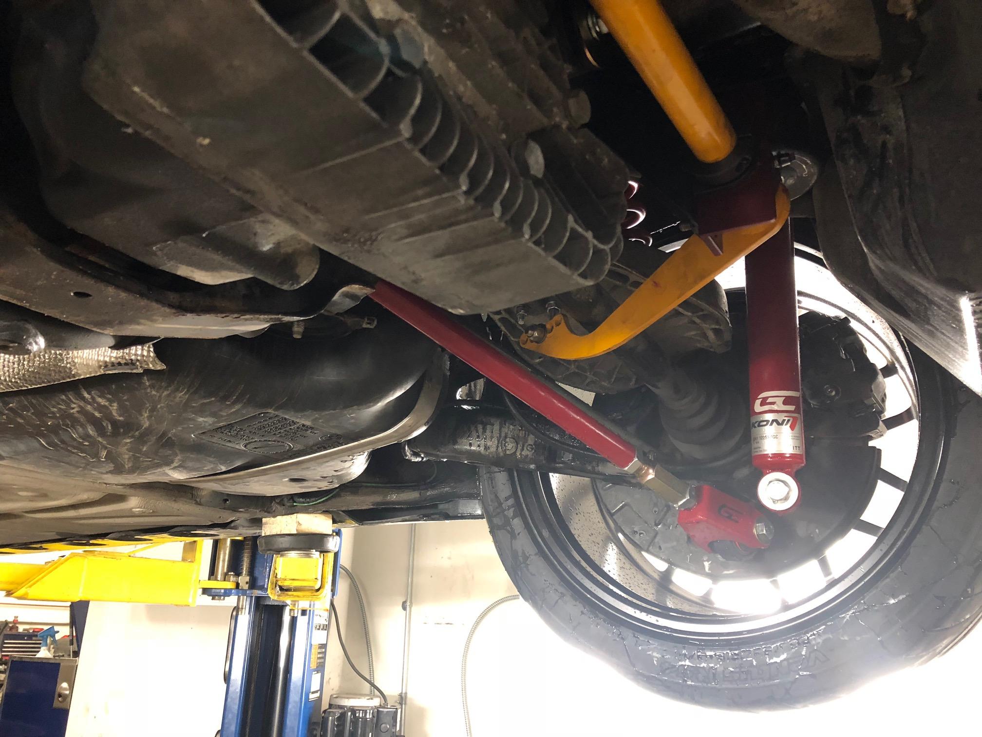

<p dir="auto">Had to deal with a couple unknown things because the guibo was totally fucked and looked like it had maybe 30 miles left before it completely fell apart. Also had a stock mid section welded back in because what was on there was completely fucked, so now the car sounds normal again without excessive levels of e46 rasp. </p>

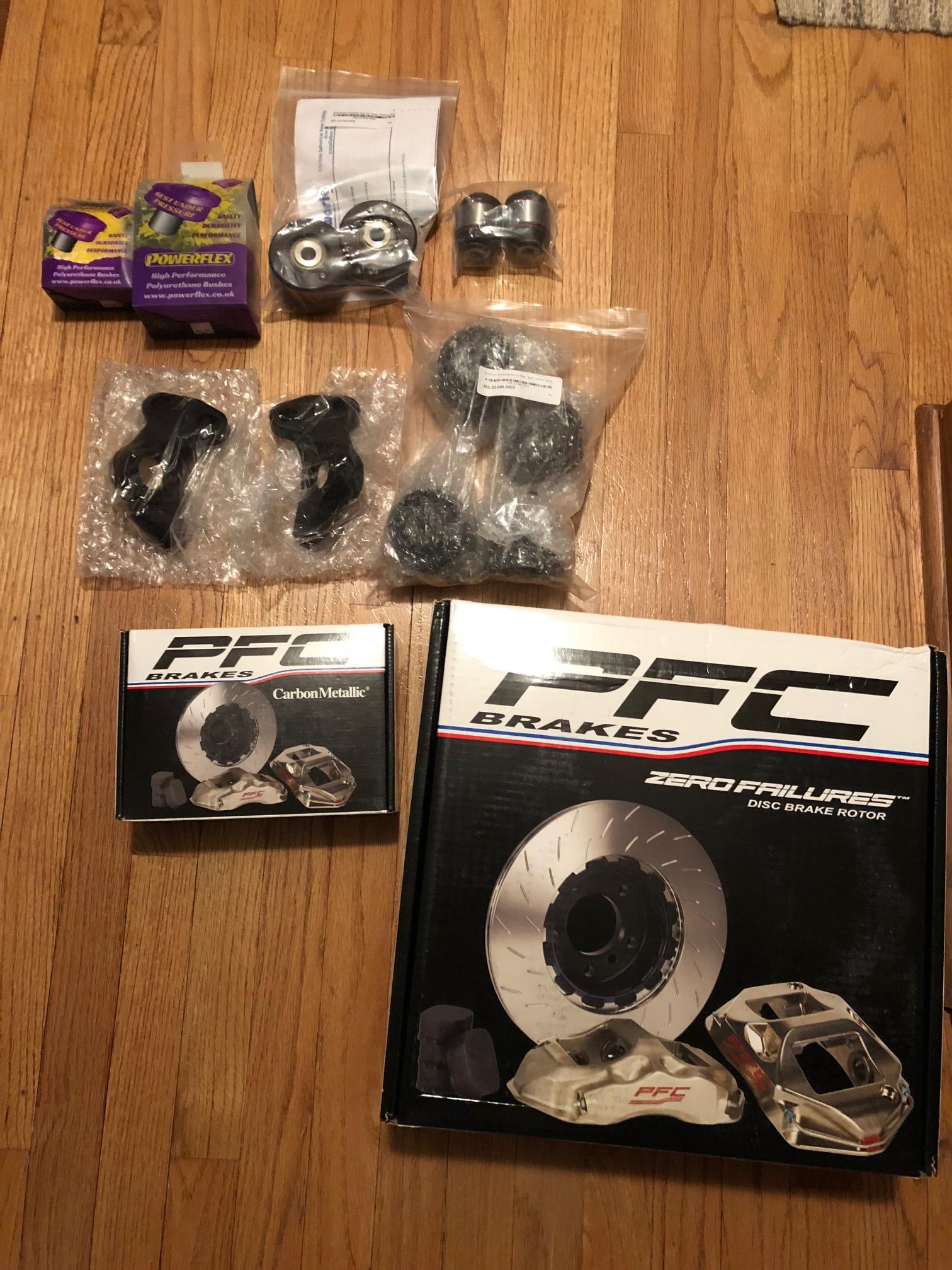

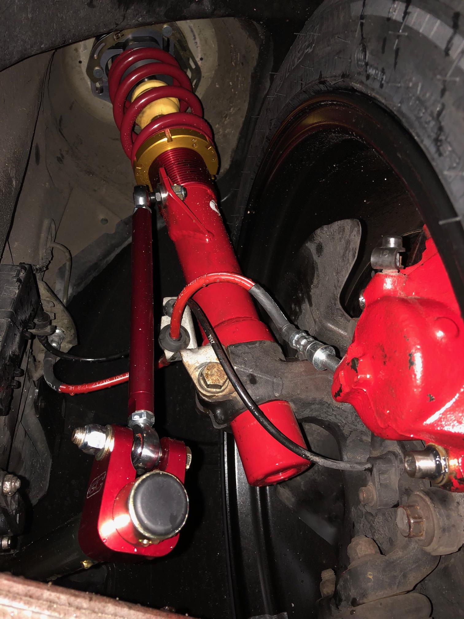

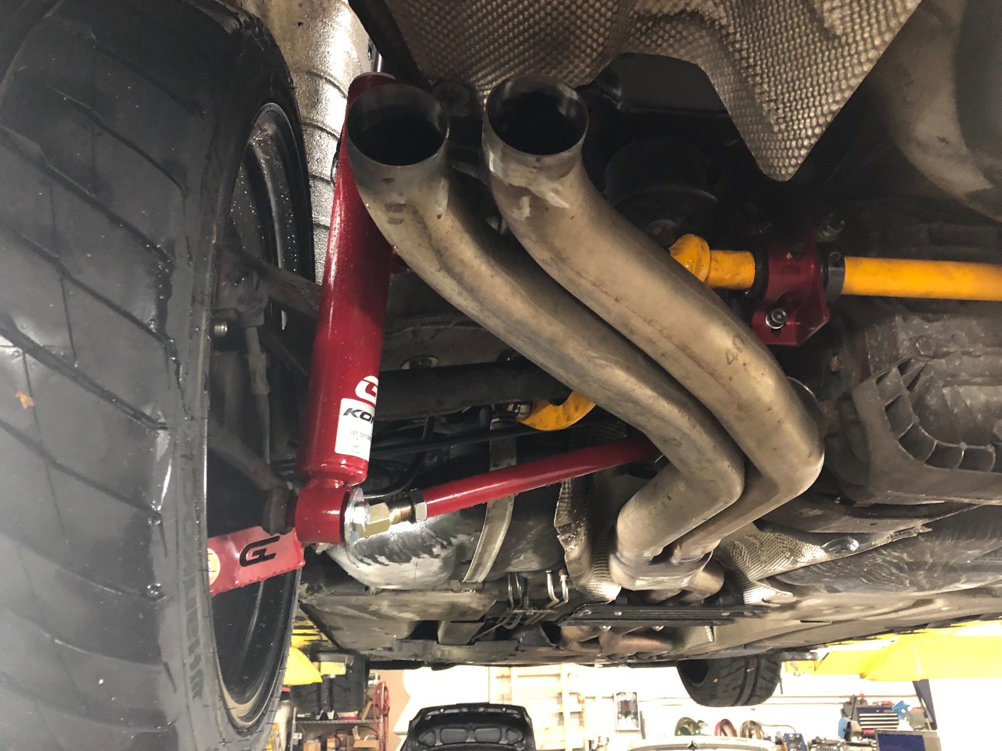

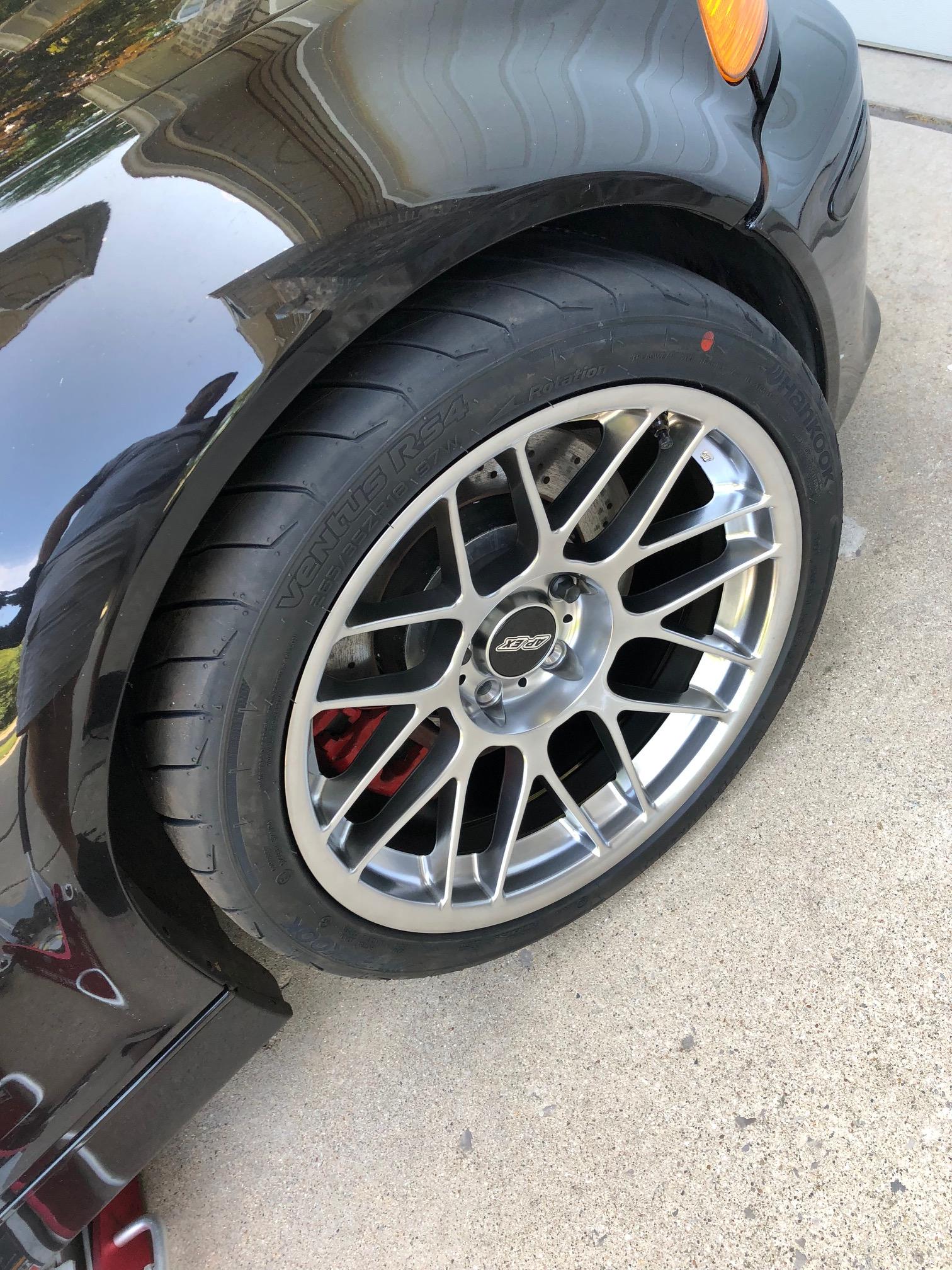

<p dir="auto">The mod list is as follows:<br />
GC coilovers, camber plates, and swaybars with adjustable endlinks <br />
GC rear camber arms <br />
solid aluminum RSFBs<br />
poly diff bushings <br />
RCABS<br />
FCABs<br />
RTabs<br />
PFC direct drive rotors and 08 pads up front<br />
PFC 332 pads in the rear <br />
Apex ARC8  265 square on hankook RS-4</p>
<p dir="auto">Some parts have arrived, and here is a comical test fitment of the apex wheel prior to having camber plates installed (it will require -3.5 in order to not rub):</p>

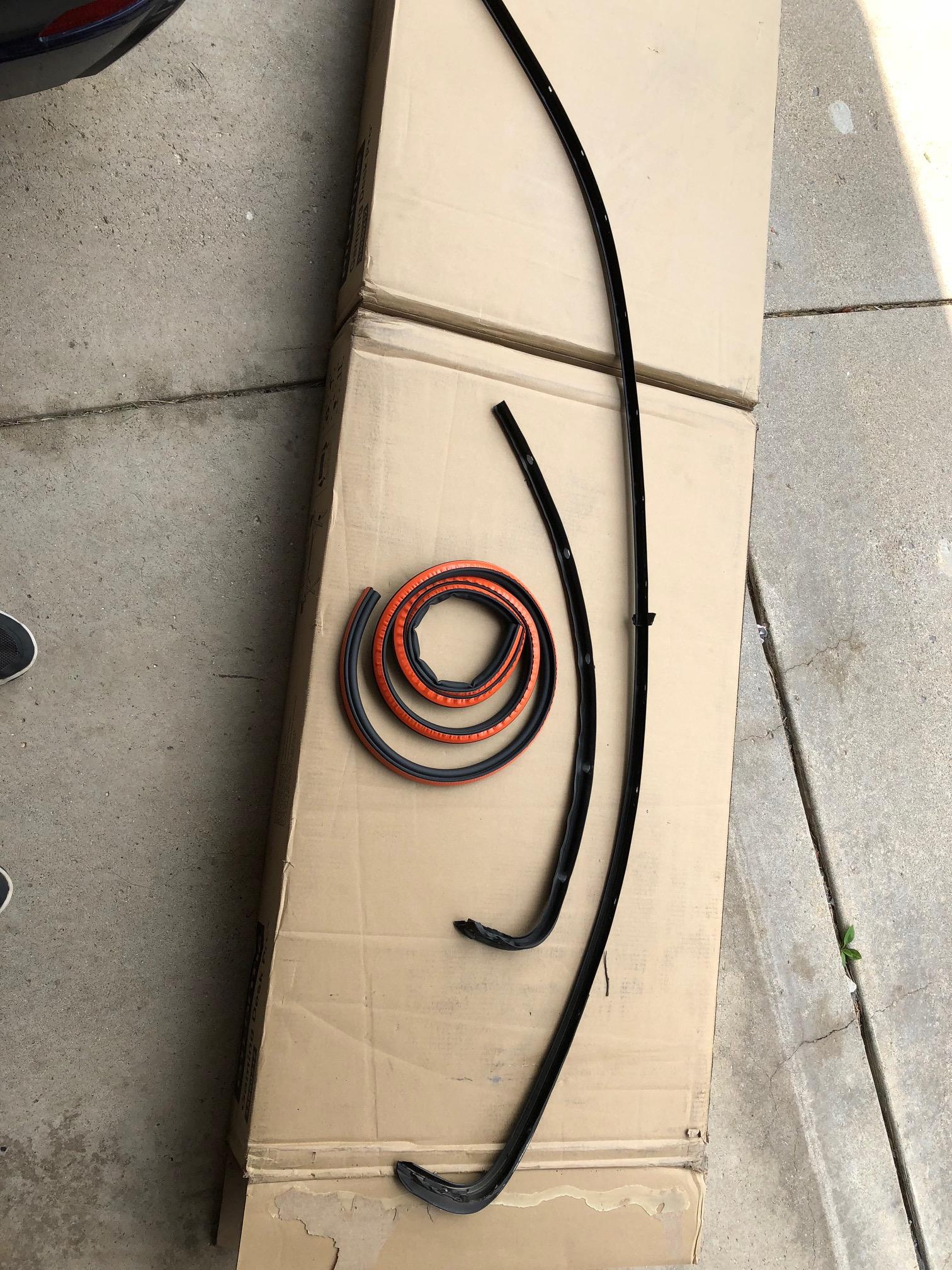

<p dir="auto">One of the main issues the seller had with this car was that he didn't want to pay $560 for a new passenger shadowline trim. The weatherstripping at the rear window was disintegrated so basically the car can't get wet, and BMW doesn't sell it separately. You have to blow 500 bucks on a whole goddamn new trim piece which is fucking absurd to me. <br />
So with an $18 weatherstripping kit from 3M and about an hour of my time, I pulled the liner and ripped out the old weatherstripping and just replaced it. The trim that sits along the bottom of the rear window is also crumbling but that's only like $25 per side for new weatherstripping as an OE part so I ordered those to finish the job tomorrow. <br />
<a href="/assets/uploads/files/monthly_2018_07_IMG_2099.jpg.30b9aeb35c919440a834a71873b8a4b0.jpg"><img src="/assets/uploads/files/monthly_2018_07_IMG_2099.thumb.jpg.c54479890535023f8f4e50abbe508a33.jpg" alt="IMG2099.jpg" class=" img-fluid img-markdown" width="563" height="750" /></a></p>
