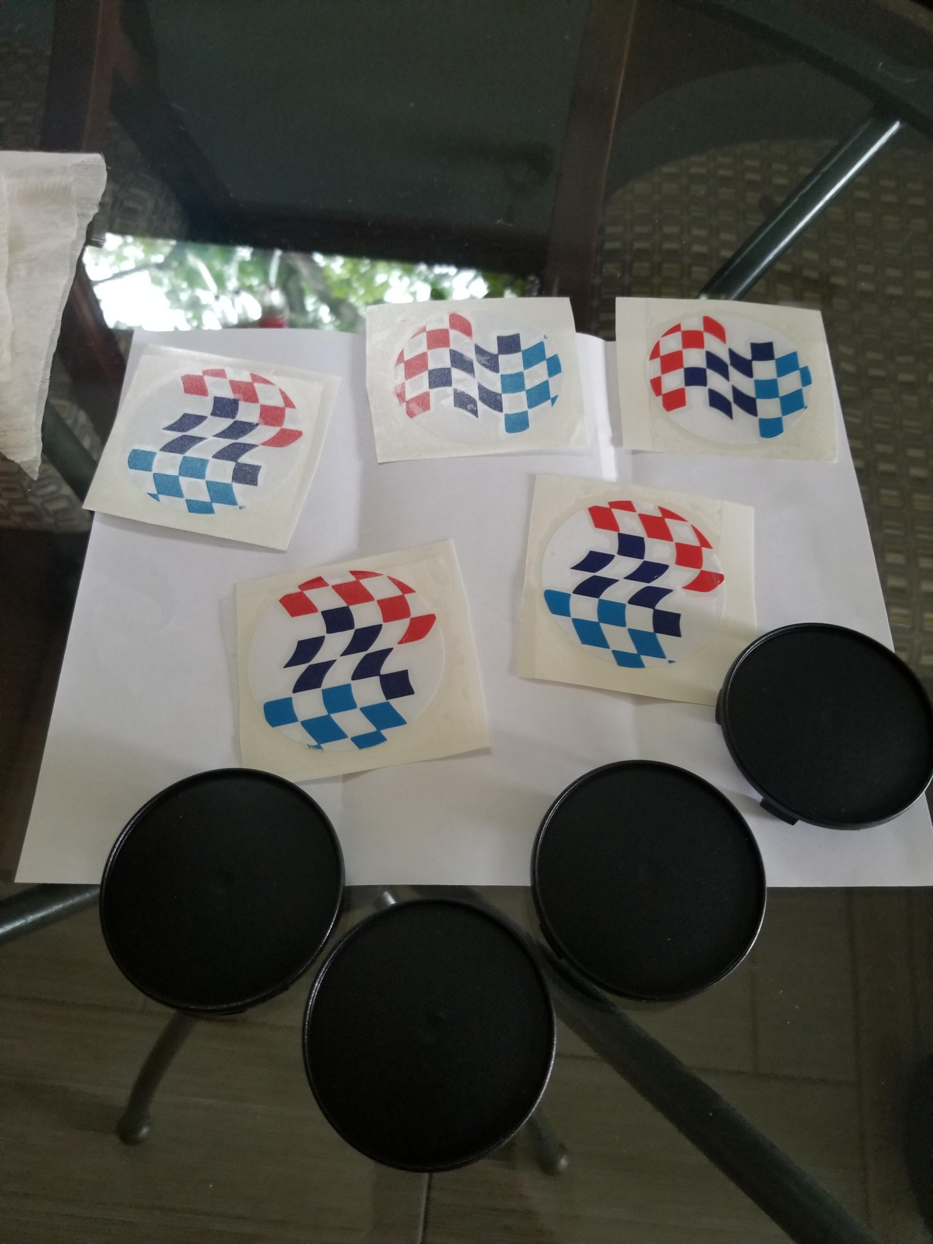

<p dir="auto">I bought these blank wheel caps from ebay <a href="https://www.ebay.com/itm/4x68mm-Universal-Chrom-Wheel-Tire-Center-Blank-Replacement-Hub-Caps-Cover-Silver/182962557719?ssPageName=STRK%3AMEBIDX%3AIT&amp;_trksid=p2057872.m2749.l2649" rel="nofollow ugc">https://www.ebay.com/itm/4x68mm-Universal-Chrom-Wheel-Tire-Center-Blank-Replacement-Hub-Caps-Cover-Silver/182962557719?ssPageName=STRK%3AMEBIDX%3AIT&amp;_trksid=p2057872.m2749.l2649</a></p>
<p dir="auto">They were the cheapest ones from the USofA so I pulled the trigger</p>
<p dir="auto">I gave them a light sanding and a few coats of trim paint. (For a bit of texture to blend a little better with my powder-coated wheels) because obviously I wasn't going to keep them chrome.</p>

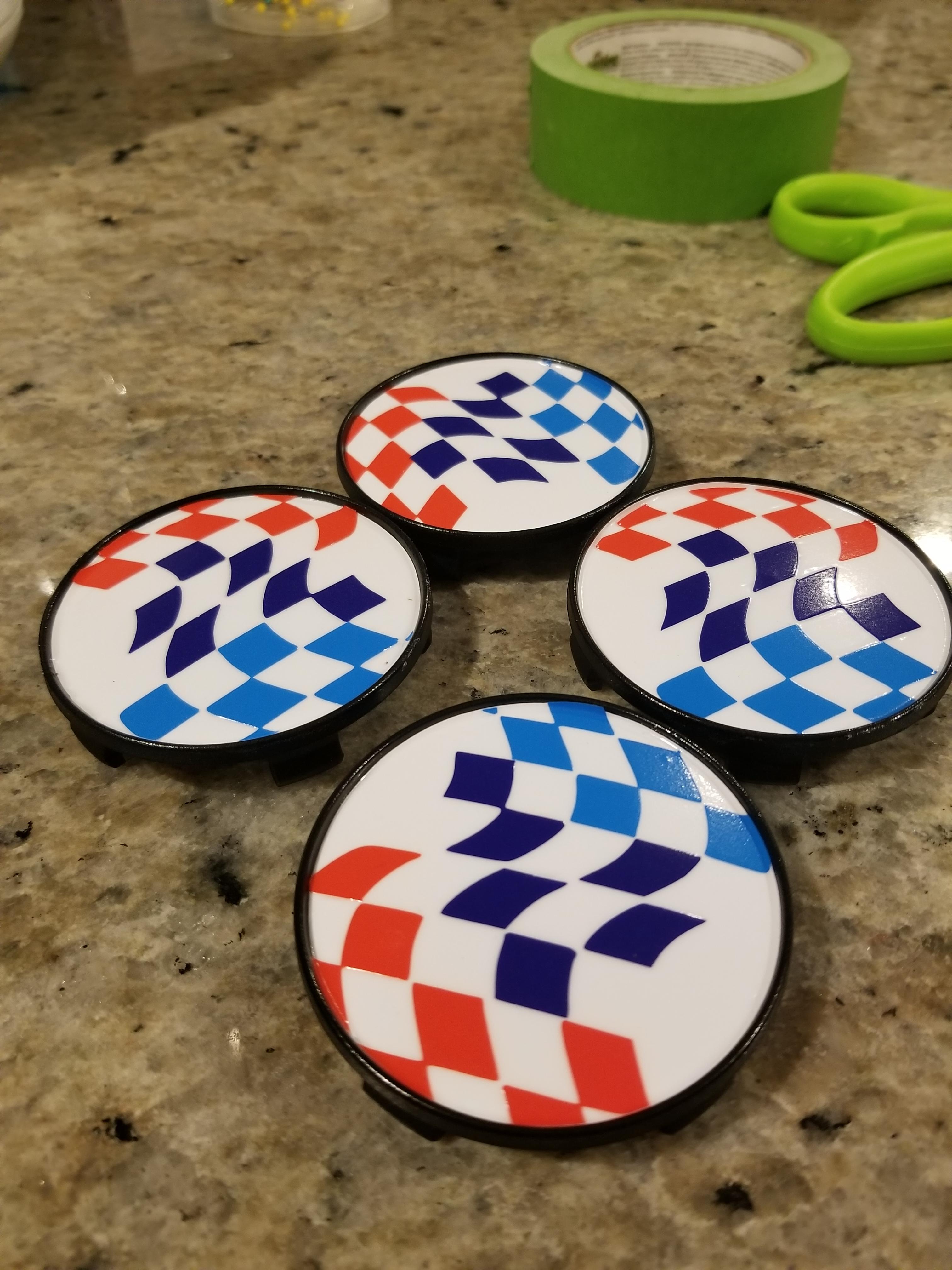

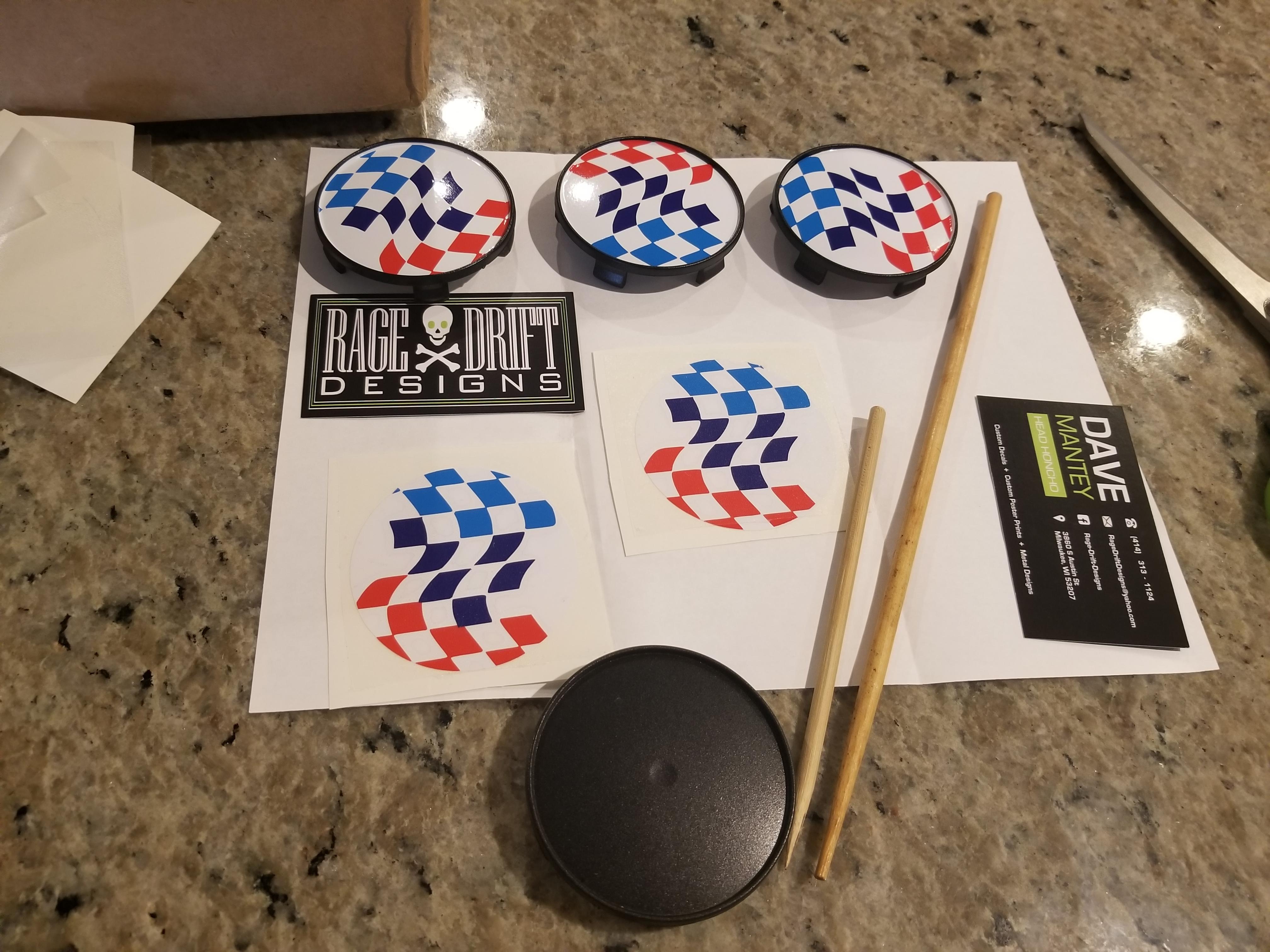

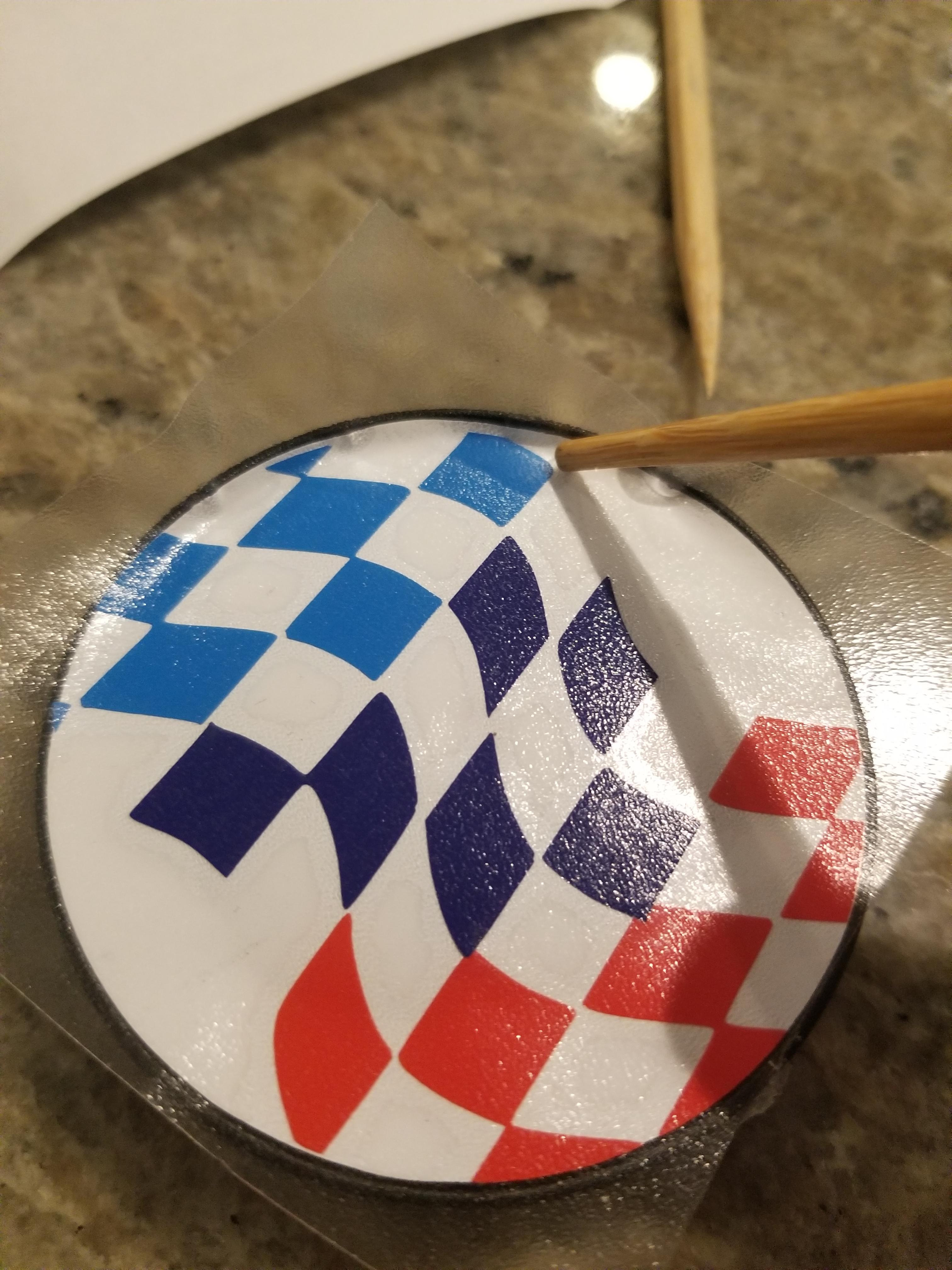

<p dir="auto">Yesterday I got the vinyl in the mail. I was excited to put them on but I had to much caffeine to be able to do it right and waited till this-morning. (You will need VERY steady hands)</p>
<p dir="auto"><a href="/assets/uploads/files/monthly_2018_07_20180713_130500.jpg.e1a88beb964514a65b37c9f202a09cd1.jpg"><img src="/assets/uploads/files/monthly_2018_07_20180713_130500.thumb.jpg.101259f6bfd14bb496fbec65ee8c623b.jpg" alt="20180713130500.jpg" class=" img-fluid img-markdown" width="563" height="750" /></a></p>

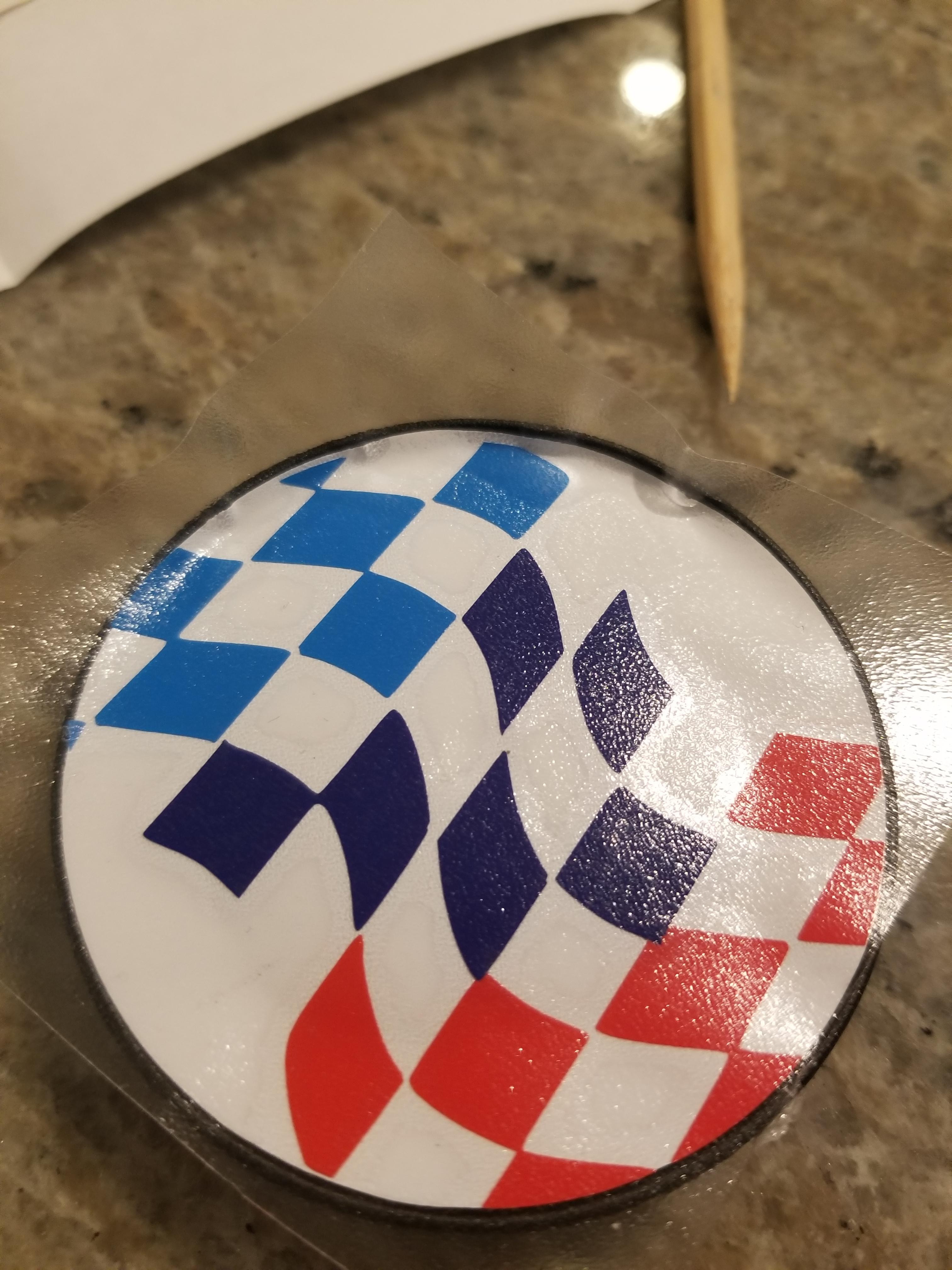

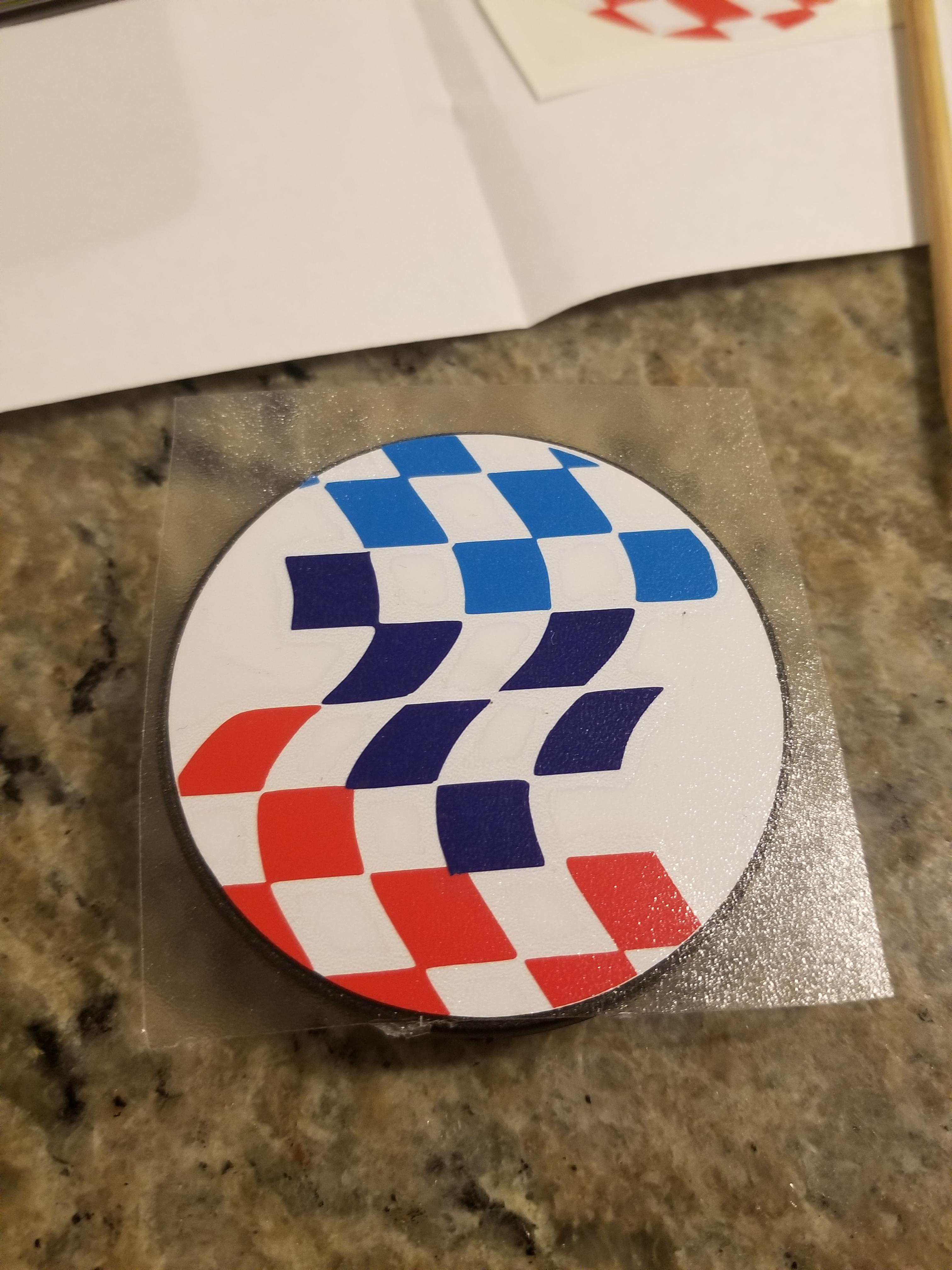

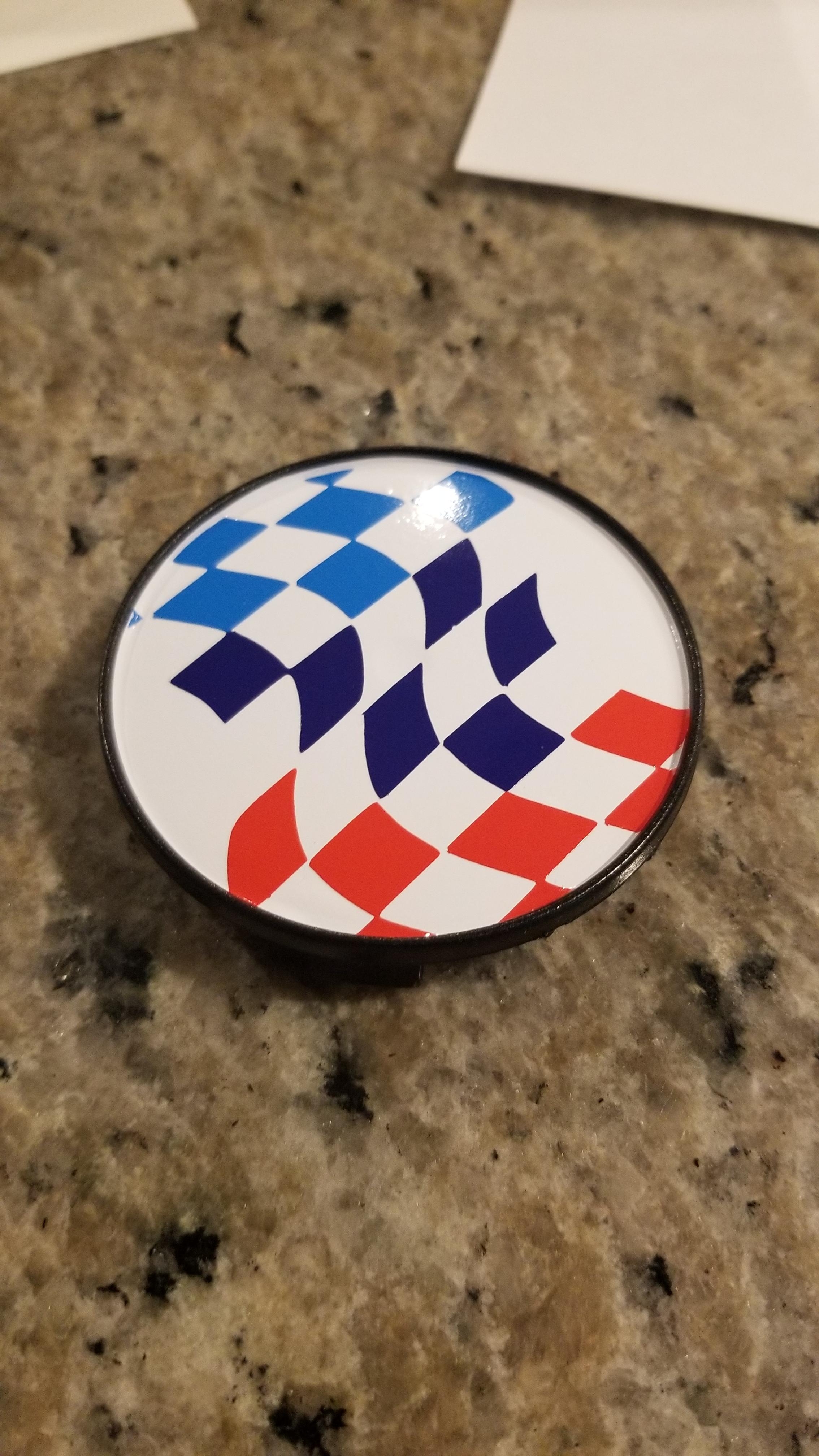

<p dir="auto">I tried my best to center them and started pushing from the middle out to stick the vinyl down. I used a dull and a kinda sharpened stick to push down the edges into the corner. (Because I didn't put the vinyl down exactly perfect each time.)</p>
<p dir="auto"><a href="/assets/uploads/files/monthly_2018_07_20180713_132954.jpg.c81caafe518285c00f0613bcb44d428a.jpg"><img src="/assets/uploads/files/monthly_2018_07_20180713_132954.thumb.jpg.3253d1b1ed863958c953078b7eb6bab1.jpg" alt="20180713132954.jpg" class=" img-fluid img-markdown" width="563" height="750" /></a></p>
<p dir="auto"><a href="/assets/uploads/files/monthly_2018_07_20180713_133054.jpg.cb7c5d3972307a4e2a27868f52bc2ff6.jpg"><img src="/assets/uploads/files/monthly_2018_07_20180713_133054.thumb.jpg.d08fb27c163f2487a137c8d61db96d7b.jpg" alt="20180713133054.jpg" class=" img-fluid img-markdown" width="563" height="750" /></a></p>
<p dir="auto"><a href="/assets/uploads/files/monthly_2018_07_20180713_133055.jpg.b02f85dfba1bd4c61d2c337e537b1206.jpg"><img src="/assets/uploads/files/monthly_2018_07_20180713_133055.thumb.jpg.a697b8081e3432296c590f06389a3278.jpg" alt="20180713133055.jpg" class=" img-fluid img-markdown" width="563" height="750" /></a><a href="/assets/uploads/files/monthly_2018_07_20180713_131622.jpg.71b439287ce840602f218bc0b3541b7a.jpg"><img src="/assets/uploads/files/monthly_2018_07_20180713_131622.thumb.jpg.9cf43dd29e283891da2d8d608e5f01d9.jpg" alt="20180713131622.jpg" class=" img-fluid img-markdown" width="422" height="750" /></a><a href="/assets/uploads/files/monthly_2018_07_20180713_153317.jpg.133bd6c6ce7fc97920ec823a288e488a.jpg"><img src="/assets/uploads/files/monthly_2018_07_20180713_153317.thumb.jpg.20ddfe59271ff65a6e5f49b0d65c201e.jpg" alt="20180713153317.jpg" class=" img-fluid img-markdown" width="1000" height="687" /></a></p>

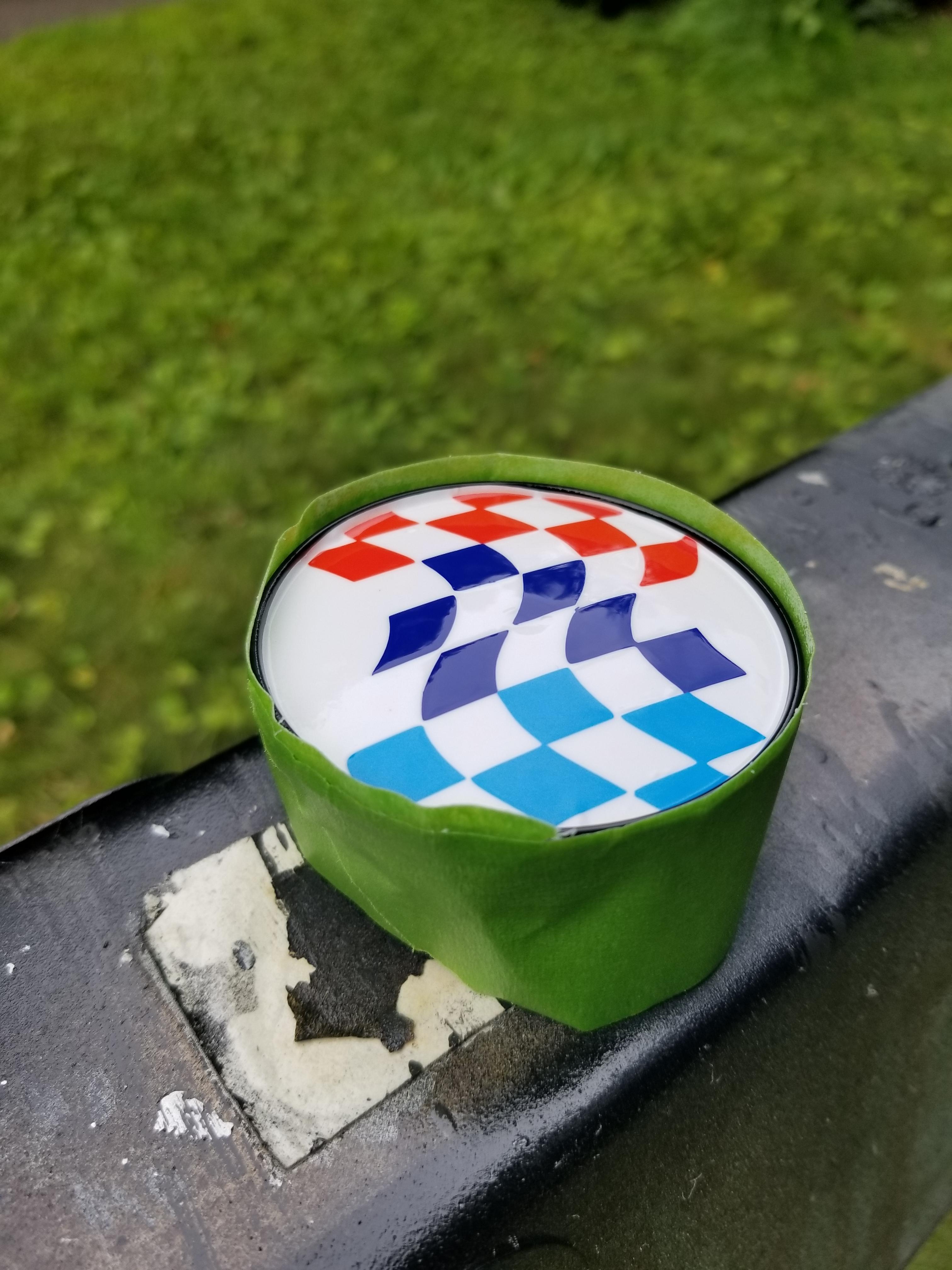

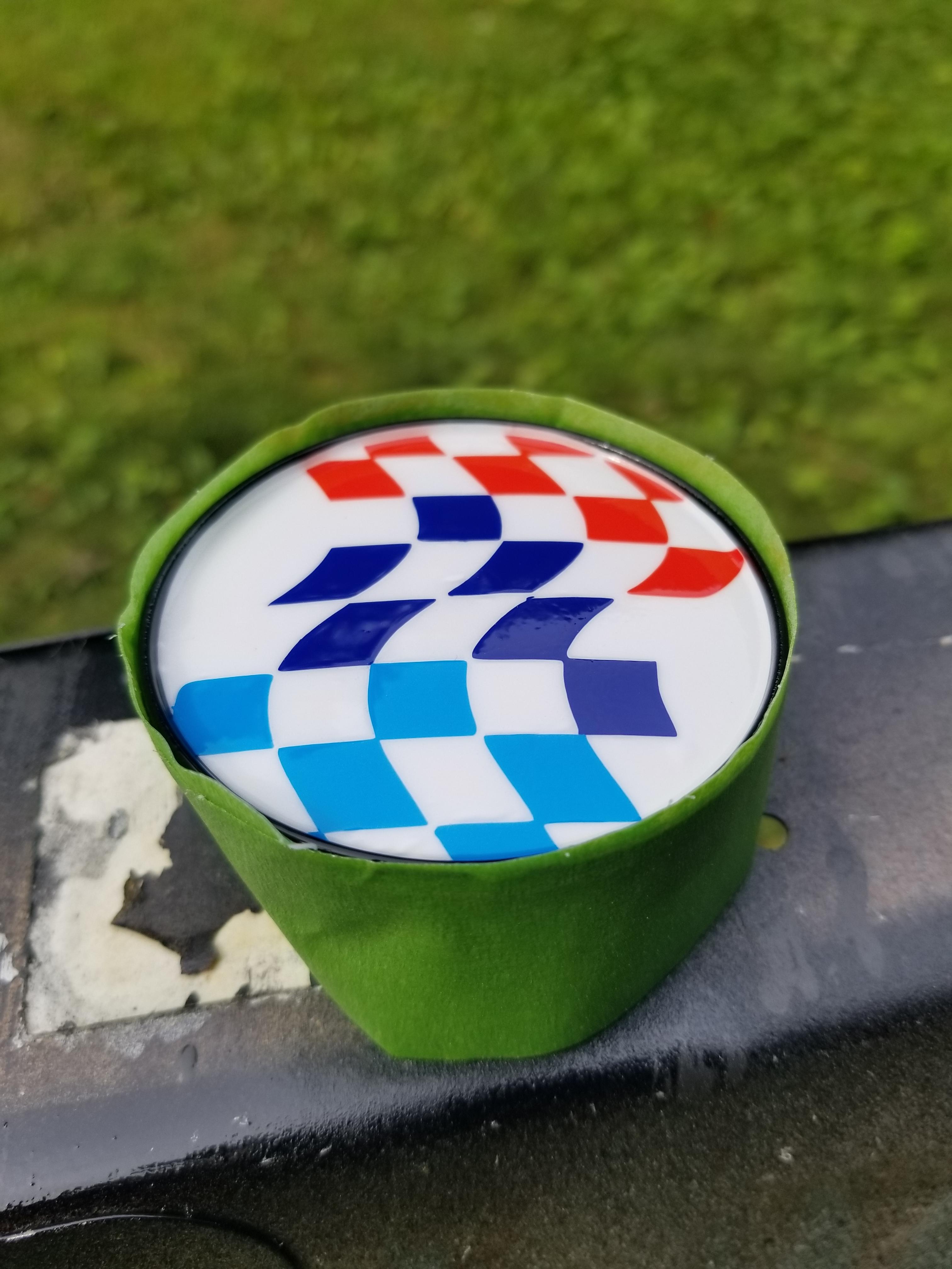

<p dir="auto">A tip when spraying the glaze. Its not like clear so it needs to go in THICK. I sprayed it like a regular clear first then I layed it on thick. I built it up until there was an even amount over the top of both layers of vinyl. I let it dry for 40 minutes then I did a couple coats of the regular clear to make it UV resistant. </p>
<p dir="auto">Here is after the first coat or 2</p>
<p dir="auto"><a href="/assets/uploads/files/monthly_2018_07_20180713_160725.jpg.8cf8bccbeda1ad64c2e0e3147a37ee1b.jpg"><img src="/assets/uploads/files/monthly_2018_07_20180713_160725.thumb.jpg.328342088d4995e09e58b7bc4dc4e2dd.jpg" alt="20180713160725.jpg" class=" img-fluid img-markdown" width="563" height="750" /></a></p>

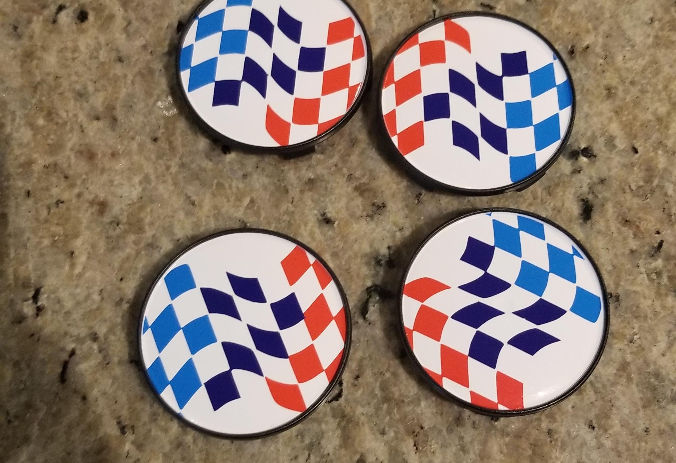

<p dir="auto">and here is after the last glaze coat waiting for the final clear coats.</p>
<p dir="auto"><a href="/assets/uploads/files/monthly_2018_07_20180713_165128.jpg.ce21c802e50d36c3b17adde29c0fc6c0.jpg"><img src="/assets/uploads/files/monthly_2018_07_20180713_165128.thumb.jpg.35b3afda85740183a059f16edcf65e34.jpg" alt="20180713165128.jpg" class=" img-fluid img-markdown" width="563" height="750" /></a></p>

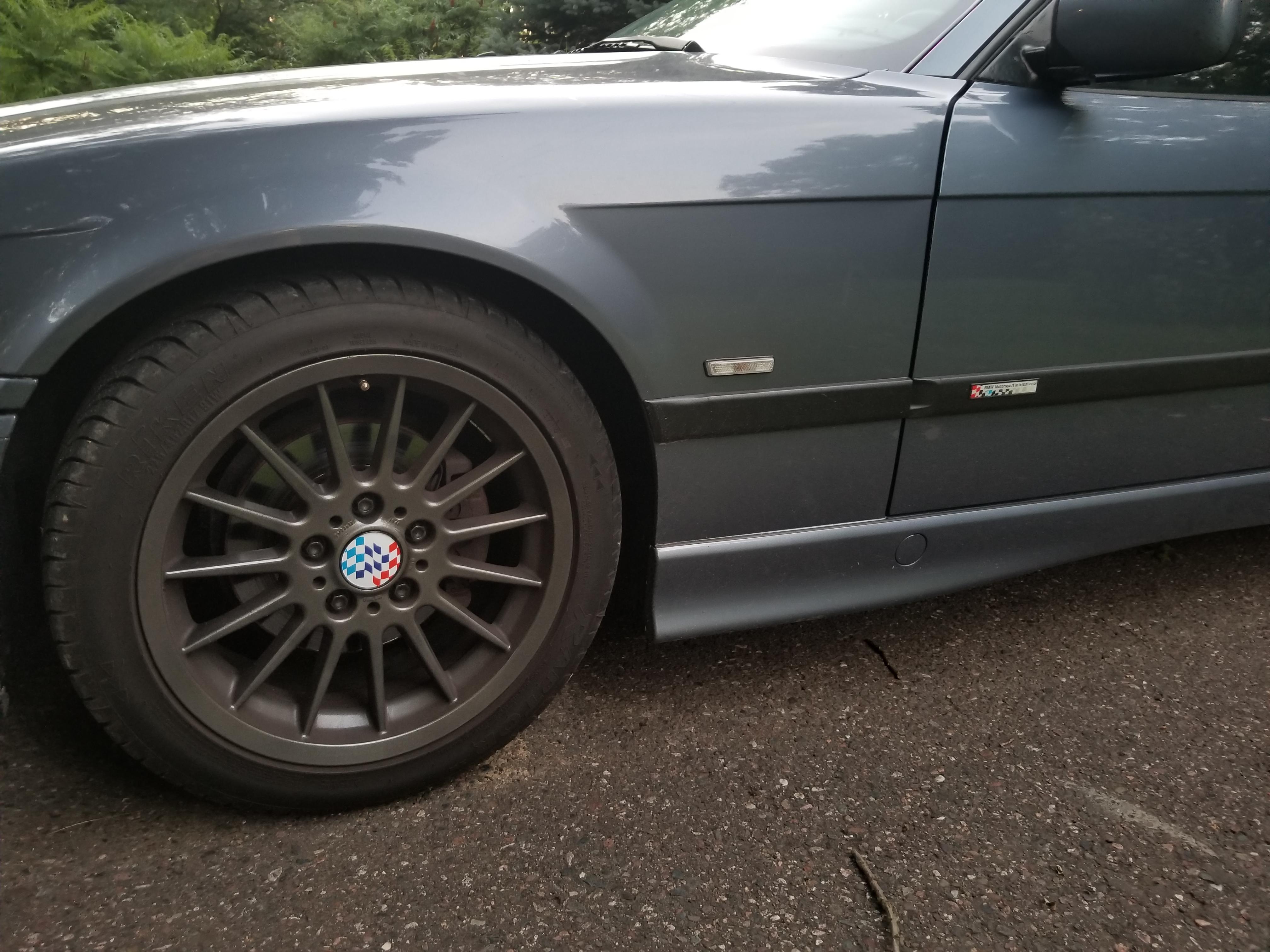

<p dir="auto">As you could see I couldn't wait to see it on my car so I put them on after the last coat dried for about an hour. *excuse my very dirty brakedust filled wheels*</p>
<p dir="auto"><a href="/assets/uploads/files/monthly_2018_07_20180713_204745.jpg.493460889602d401a3a8031d777da7b1.jpg"><img src="/assets/uploads/files/monthly_2018_07_20180713_204745.thumb.jpg.e5028ebfd31a726d8a8a62431dc1ea13.jpg" alt="20180713204745.jpg" class=" img-fluid img-markdown" width="1000" height="750" /></a><a href="/assets/uploads/files/monthly_2018_07_20180713_204530.jpg.1eaeb07f816b18fa282228455d0caffc.jpg"><img src="/assets/uploads/files/monthly_2018_07_20180713_204530.thumb.jpg.c78cd3ada705d2a86a6833b2ae7b502c.jpg" alt="20180713204530.jpg" class=" img-fluid img-markdown" width="563" height="750" /></a></p>
<p dir="auto">If I could do this again I would spray them inside. Stupid bugs... and probably do a black instead of white background (To in your face)</p>
<p dir="auto">Overall I think they turned out GREAT. Definitely big thanks to <a class="plugin-mentions-user plugin-mentions-a" href="/user/bassboy3313" aria-label="Profile: Bassboy3313">@<bdi>Bassboy3313</bdi></a> </p>
