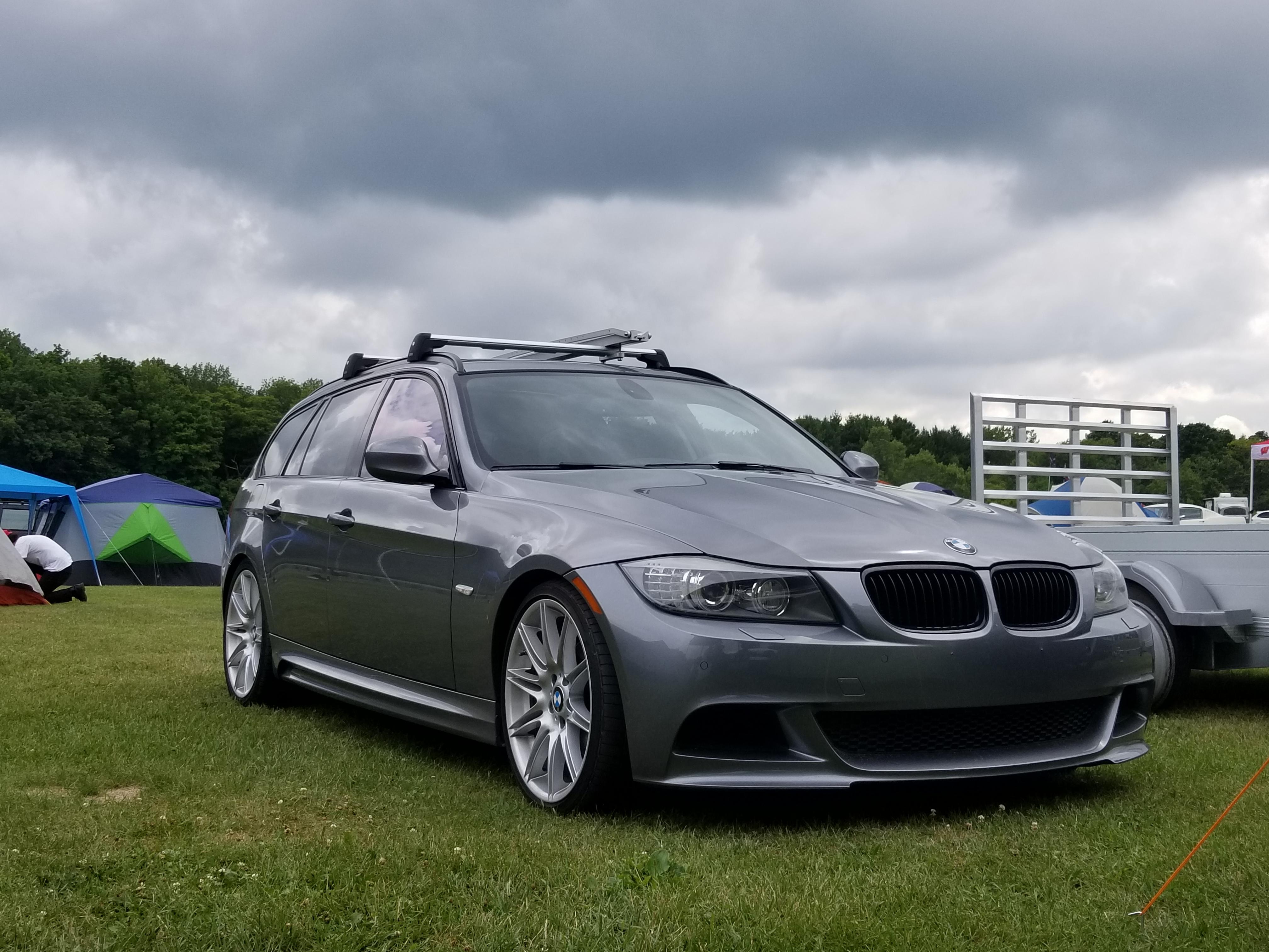

        Got this out for the autocross at RA on Sunday, had a blast!! It handles pretty well considering it's on worn/mismatched tires... some 18's with wider front rubber and matching tires front/rear should do a lot to counter the massive amounts of understeer I was experiencing (the slippery slope of motorsport is real). Ended up in 6th of 8 in D street, and 77th out of 128 overall, not bad!
          Your car looks at home at RA. Pic from the hawk.
            Thanks! That's a nice pic!
