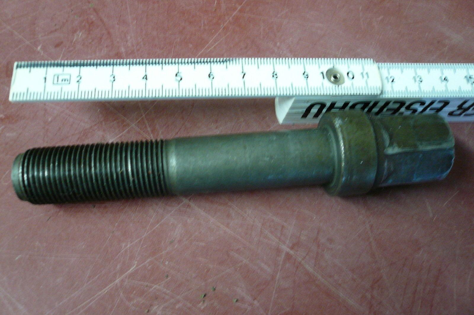

<?xml version="1.0" encoding="UTF-8"?><rss xmlns:dc="http://purl.org/dc/elements/1.1/" xmlns:content="http://purl.org/rss/1.0/modules/content/" xmlns:atom="http://www.w3.org/2005/Atom" version="2.0"><channel><title><![CDATA[Dimensions of front crankshaft bolt?  For a weird purpose]]></title><description><![CDATA[<p dir="auto">I think the main crank bolt on the x50/2 is M18x1.5  Does anyone have one laying around to get the length from under the head and how far the threads go.  Also helpful but I can probably measure while installed is the diameter of the flange under the hex.</p>
<p dir="auto">This is for the van project.  I'm hoping it's around 50mm long.</p>
]]></description><link>https://wibimmers.com/topic/5341/dimensions-of-front-crankshaft-bolt-for-a-weird-purpose</link><generator>RSS for Node</generator><lastBuildDate>Wed, 16 Sep 2026 05:41:53 GMT</lastBuildDate><atom:link href="https://wibimmers.com/topic/5341.rss" rel="self" type="application/rss+xml"/><pubDate>Fri, 06 Jul 2018 12:58:53 GMT</pubDate><ttl>60</ttl><item><title><![CDATA[Reply to Dimensions of front crankshaft bolt?  For a weird purpose on Fri, 06 Jul 2018 15:31:45 GMT]]></title><description><![CDATA[<p dir="auto">Thanks!  That won't work then.  I thought it had a shorter head anyway.  That's what i needed though.  Apparently it is really difficult to find a socket head cap screw in M18x1.5.  Most are the normal coarse thread of 2.5.  I need a bolt to thread into the end of the steering rack to attach my offset/spacer parts.</p>
]]></description><link>https://wibimmers.com/post/93080</link><guid isPermaLink="true">https://wibimmers.com/post/93080</guid><dc:creator><![CDATA[jc43089]]></dc:creator><pubDate>Fri, 06 Jul 2018 15:31:45 GMT</pubDate></item><item><title><![CDATA[Reply to Dimensions of front crankshaft bolt?  For a weird purpose on Fri, 06 Jul 2018 14:13:14 GMT]]></title><description><![CDATA[<p dir="auto">approximately 10mm collar, 50mm smooth shank, 40mm threads, 2mm bullet nose</p>
<p dir="auto">(based on this photo)</p>
<p dir="auto"><a href="/assets/uploads/files/monthly_2018_07_s-l1600.jpg.29d08379ac369b74831f5a7a2380d87f.jpg"><img src="/assets/uploads/files/monthly_2018_07_s-l1600.thumb.jpg.60820be9ff9b84b1e052c492a99a0889.jpg" alt="s-l1600.jpg" class=" img-fluid img-markdown" width="1000" height="667" /></a></p>
