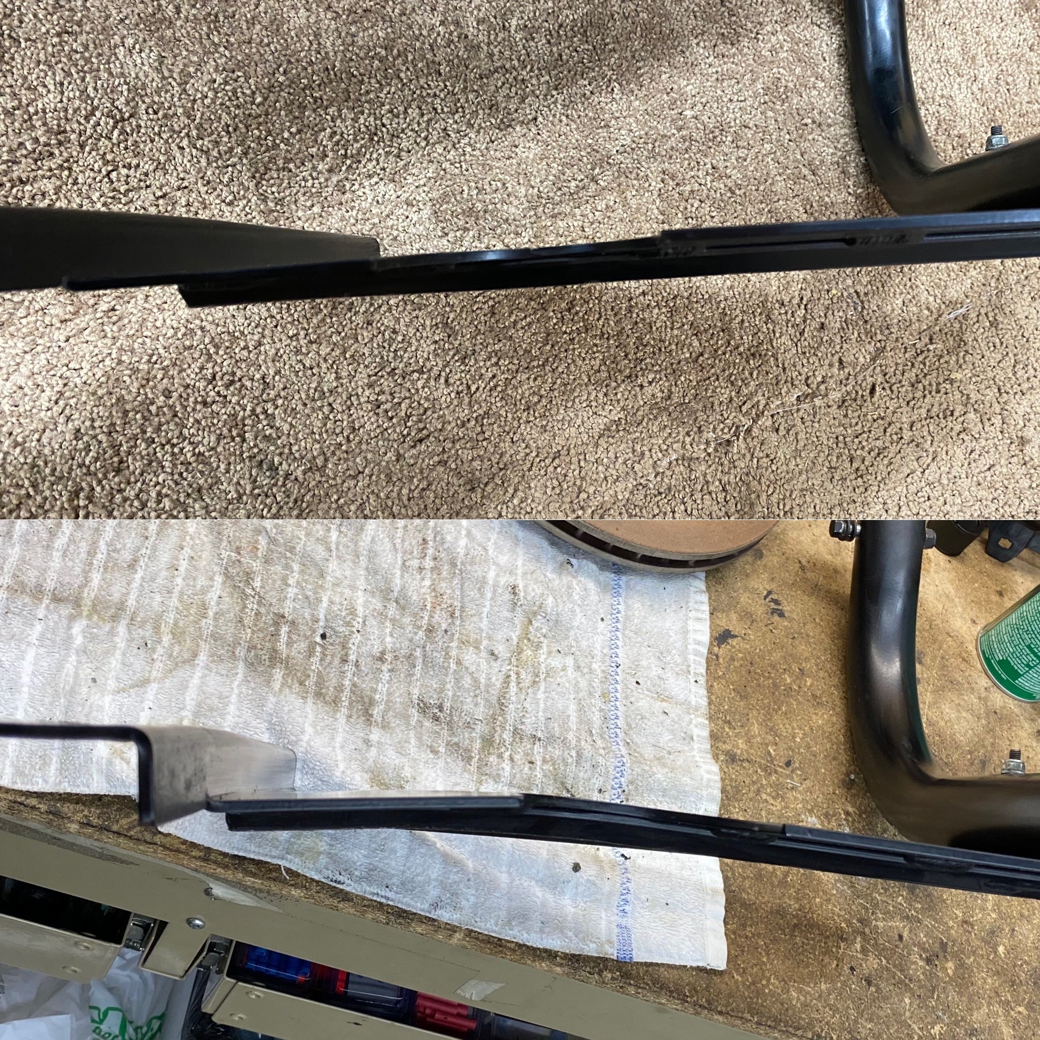

      Car is on the ground after like 14 months on jackstands lol - slapped the driveshaft/exhaust/heat shields back in, got the front suspension in and torqued. Bled the brakes/clutch and thankfully had no leaks after I remade all the lines when I ditched the abs. Shouldnt reeeeaally need to get back under the car anymore other than to hook up the wideband
      the press was able to straighten out the bend in the skid plate pretty easily

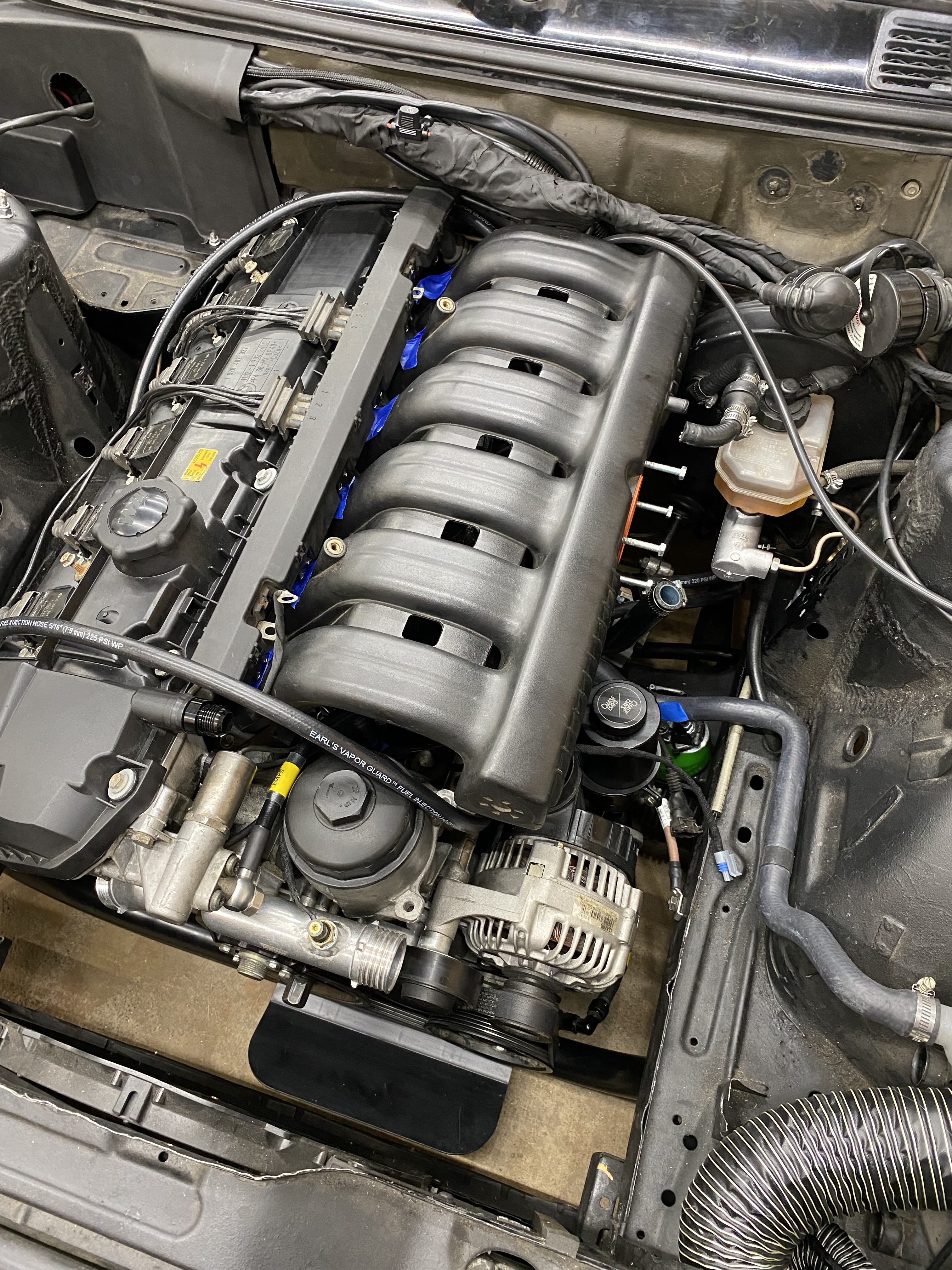

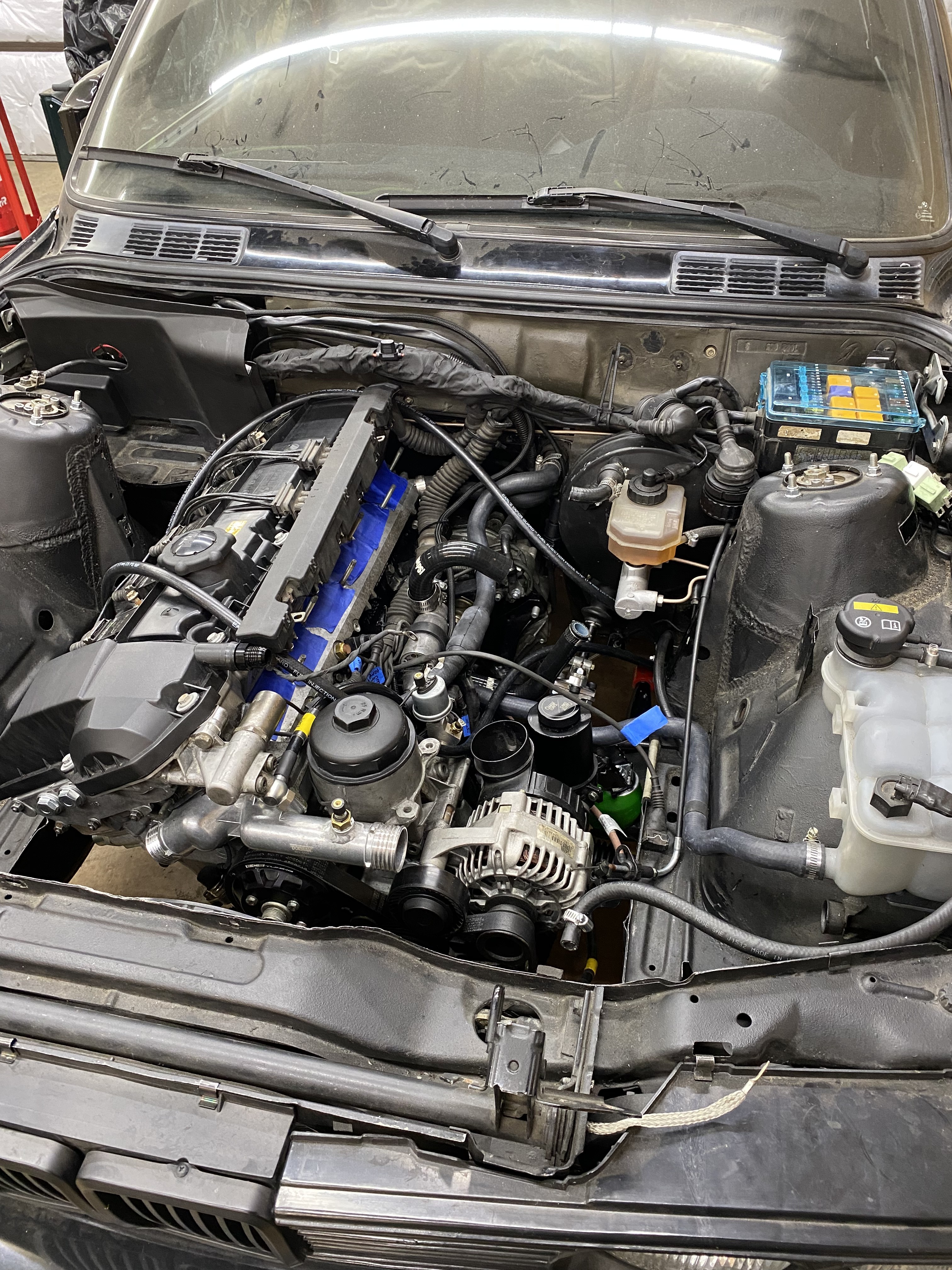

        This is where I stopped over the weekend. Heater core/expansion tank lines are in. Most of the wiring harness is in.
        since I’m going with MS3, I don’t need to use the factory O2, MAF, or IAT wiring- I still left them in the harness just in case, but tucked them out of the way.
        wideband O2 is routed, just needs to be wired. IAT wiring is most likely next up

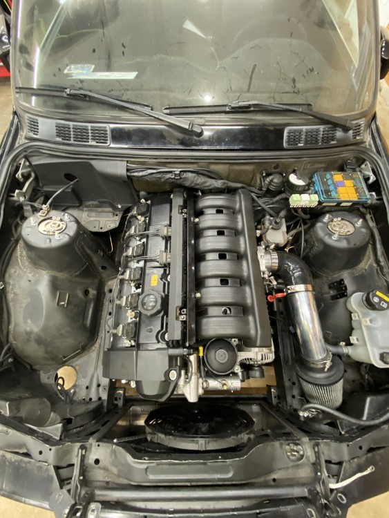

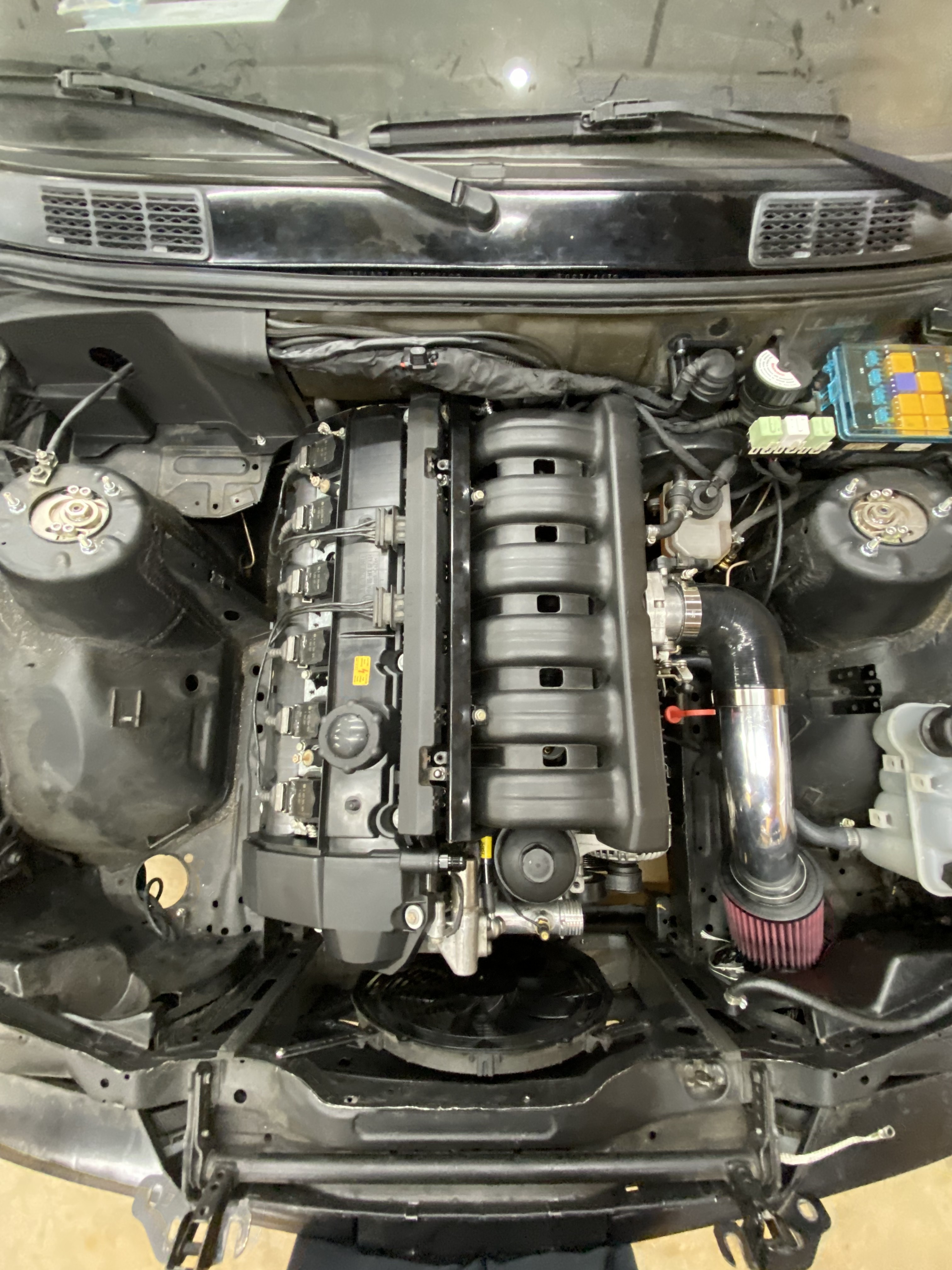

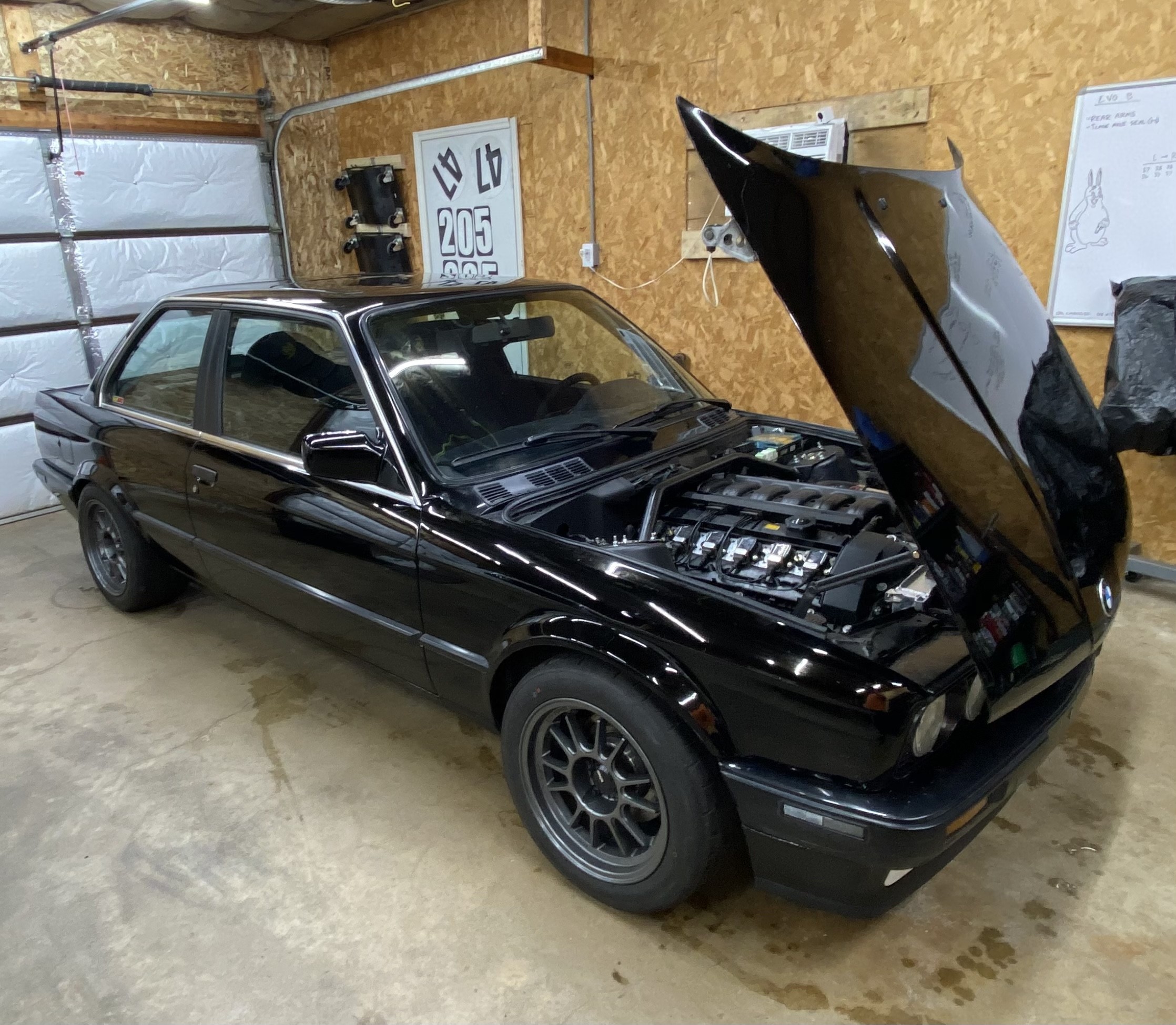

          Wiring in the engine bay is done now, IAT wiring shares the same loom with my VDO gauge wiring & obviously the wideband is it’s own thing. Both have been grounded

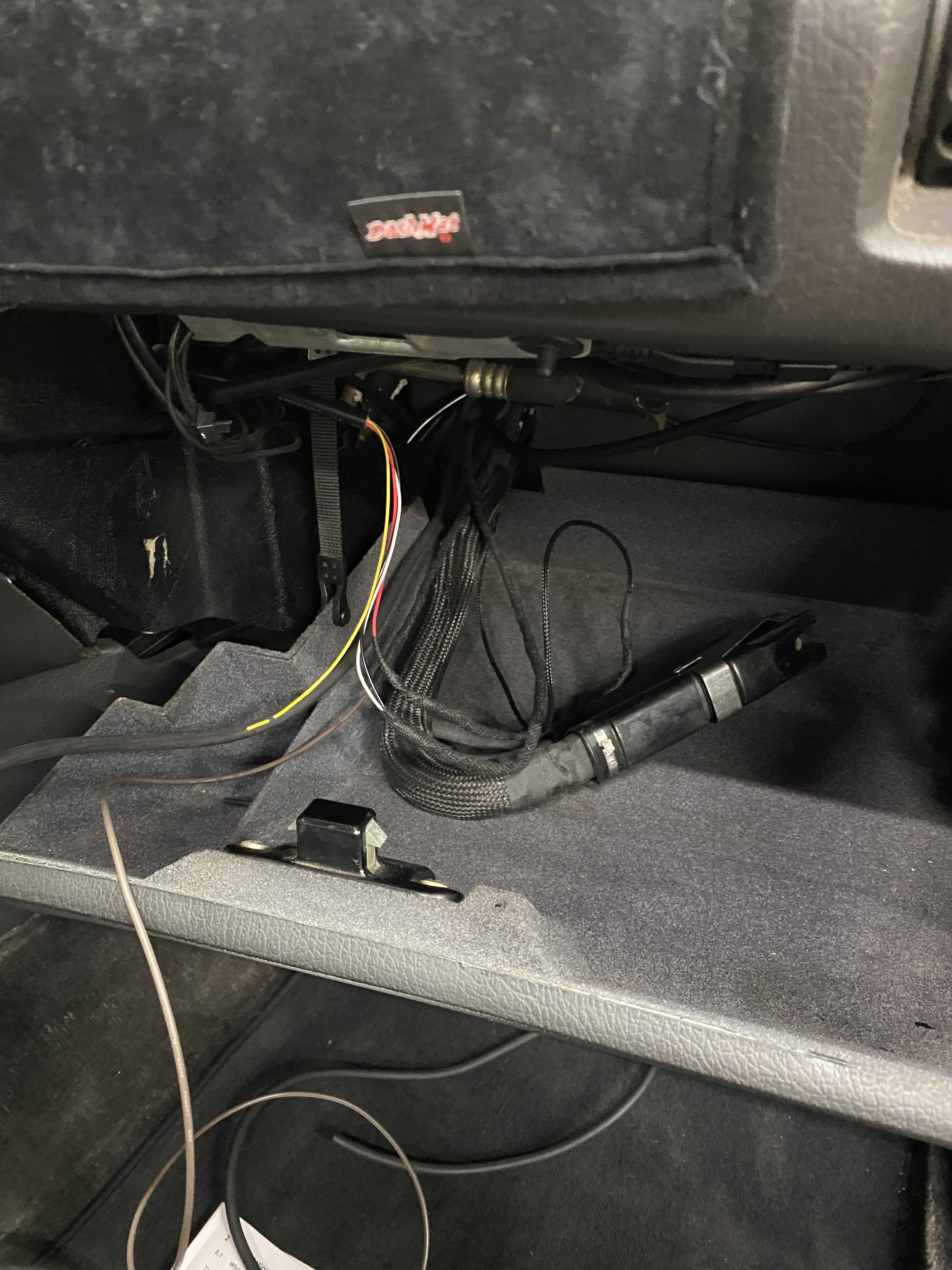

          The only wiring left is to add the MS3 pigtail to the wideband analog output(yellow) and the MS3 Pigtail to the IAT wire(brown), both of which meet up in the glovebox. Vac source for the MS3 is waiting in the glovebox as well.
          I still need to bolt down the intake manifold, cut fuel lines to proper length, trim vac line for the FPR, install fuel rail, injectors, injector harness, throttle body, intake.
          will need to add oil, PS fluid & coolant eventually.
          coolant will most likely be the last thing as I need to verify base timing with MS3 and it’s way easier to do that without a radiator in the way.
          intake tube also needs a bung welded to it for the sensor.
          Catch can location TBD
          eventually once the intake/air filter are in their final spot I want to build an ‘air box’ of sorts or just a heat shield for the filter. Bought some 3D printed brake duct adapters that will be feeding the air filter area with air that isn’t coming directly off the hot radiator E2D221F9-81A2-4473-A4A0-5B084A9723CA.jpeg39DB4523-2642-409C-BF70-D5FD81C37DD6.jpeg
          still need to trim that hose a bunch, just tossed it in to see if it could make the right bends
          might work on it a bit more tonight to get some more engine bay stuff wrapped up, would be fun to attempt a start this weekend
          I’m using an OBD2 valve cover with OBD1 harness. I hate painting, so plastic it is. also using the m52 oil filter housing instead of the metal lid s52 OFH - mainly because when I was running the m52 I bought a brand new PS pump for it & the OFHs are slightly different with pump mounting.
          Mirrors still folded in as it’s still in storage lol

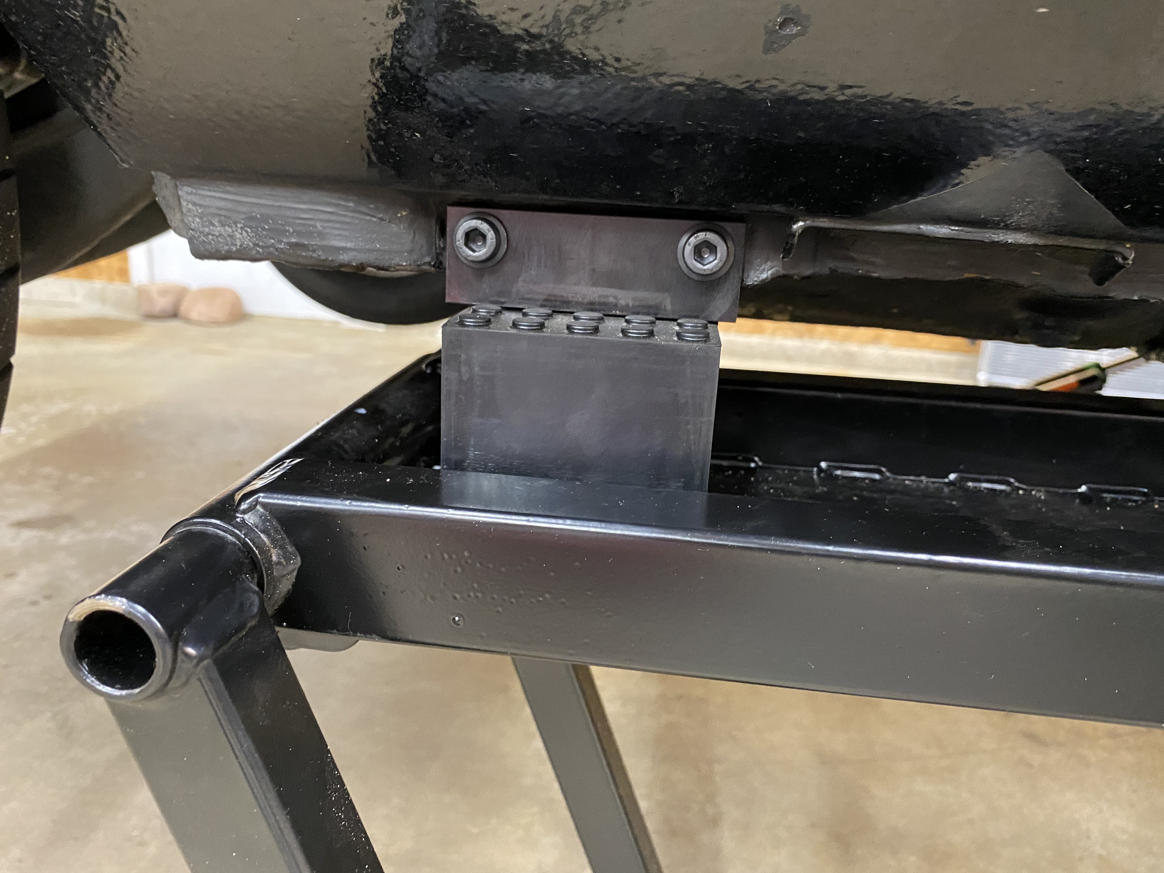

                Boris3 said:
                Nice work!
                I also noticed the Quickjack (?) in the latest picture. Experience with it so far?

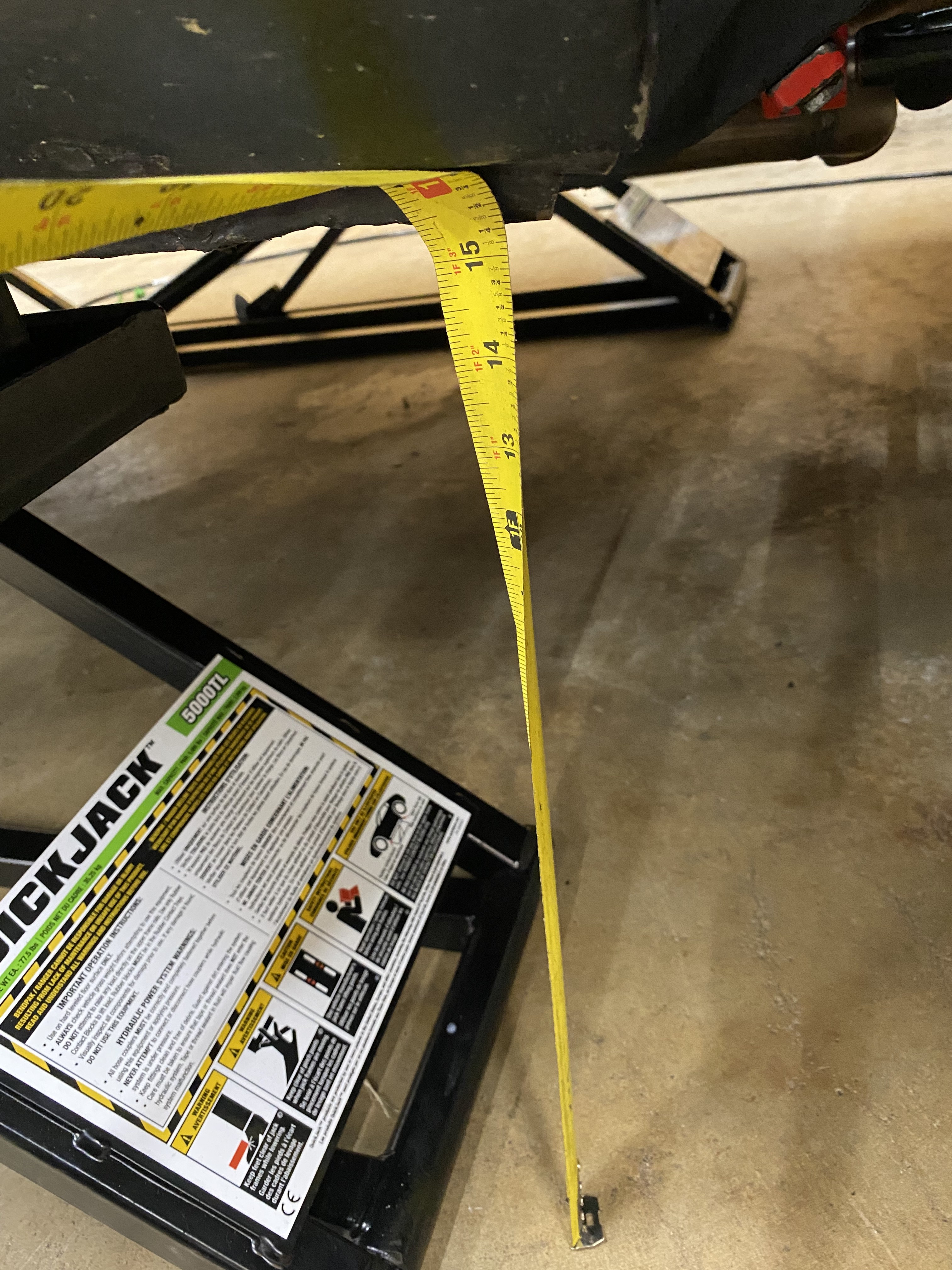

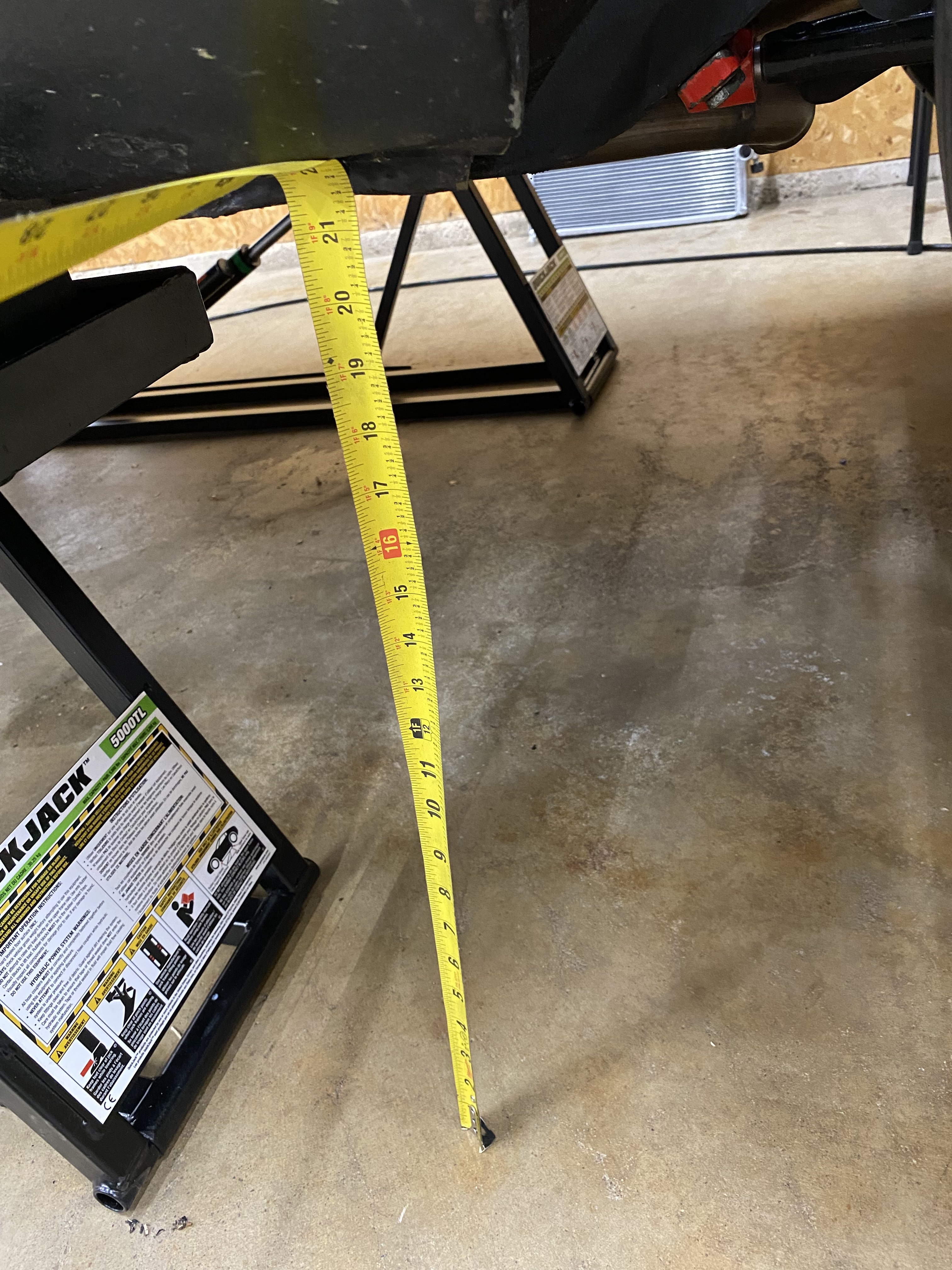

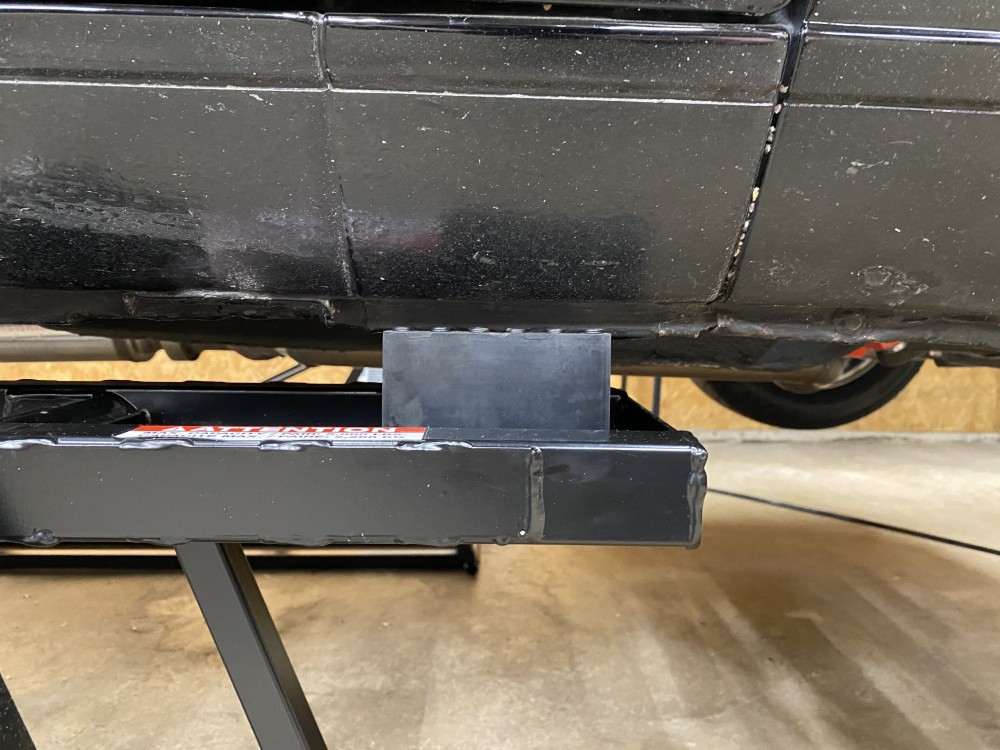

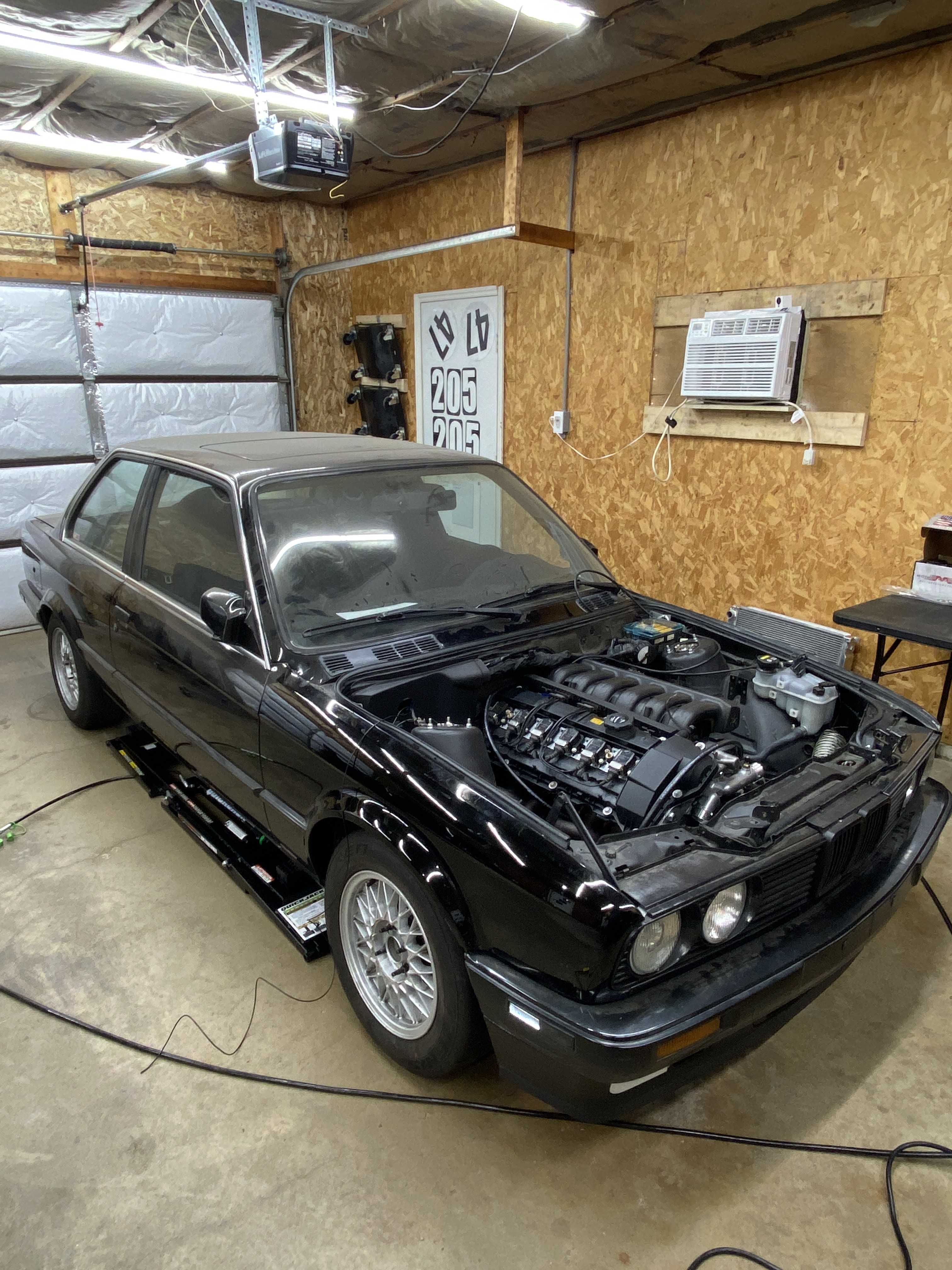

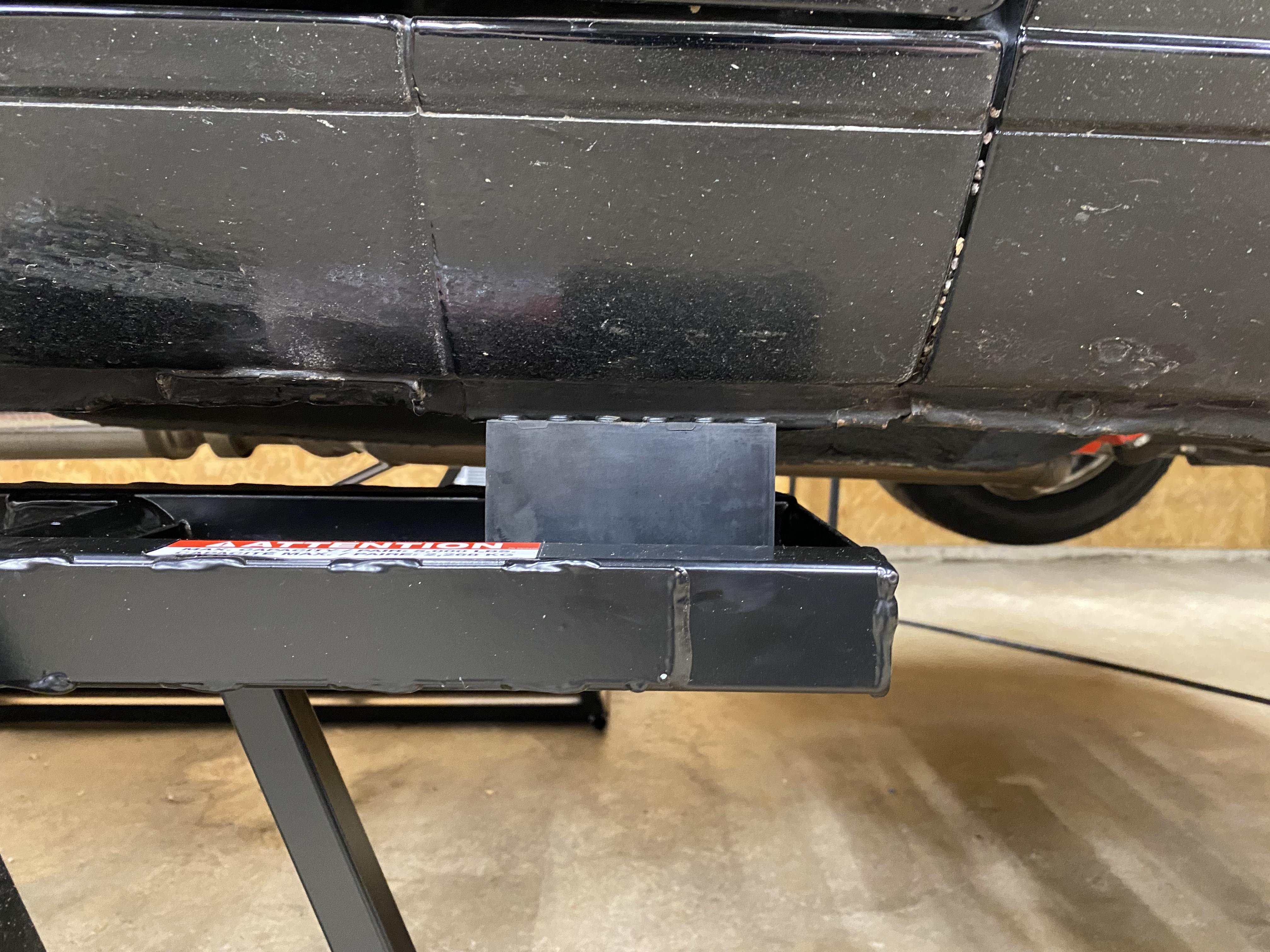

                It’s the quick jack 5000TL (110v) So far have had evo x, nb miata & e30 up on it. Nb miata is about the smallest wheelbase I think you could fit with it.
                Works well with the e30, I’m lifting off the subframe pinch weld connector area (added “race German” extended plates) & pinch weld under the front of the door.
                Once you figure out which liftblocks/orientation works best for the car, setup is a breeze.

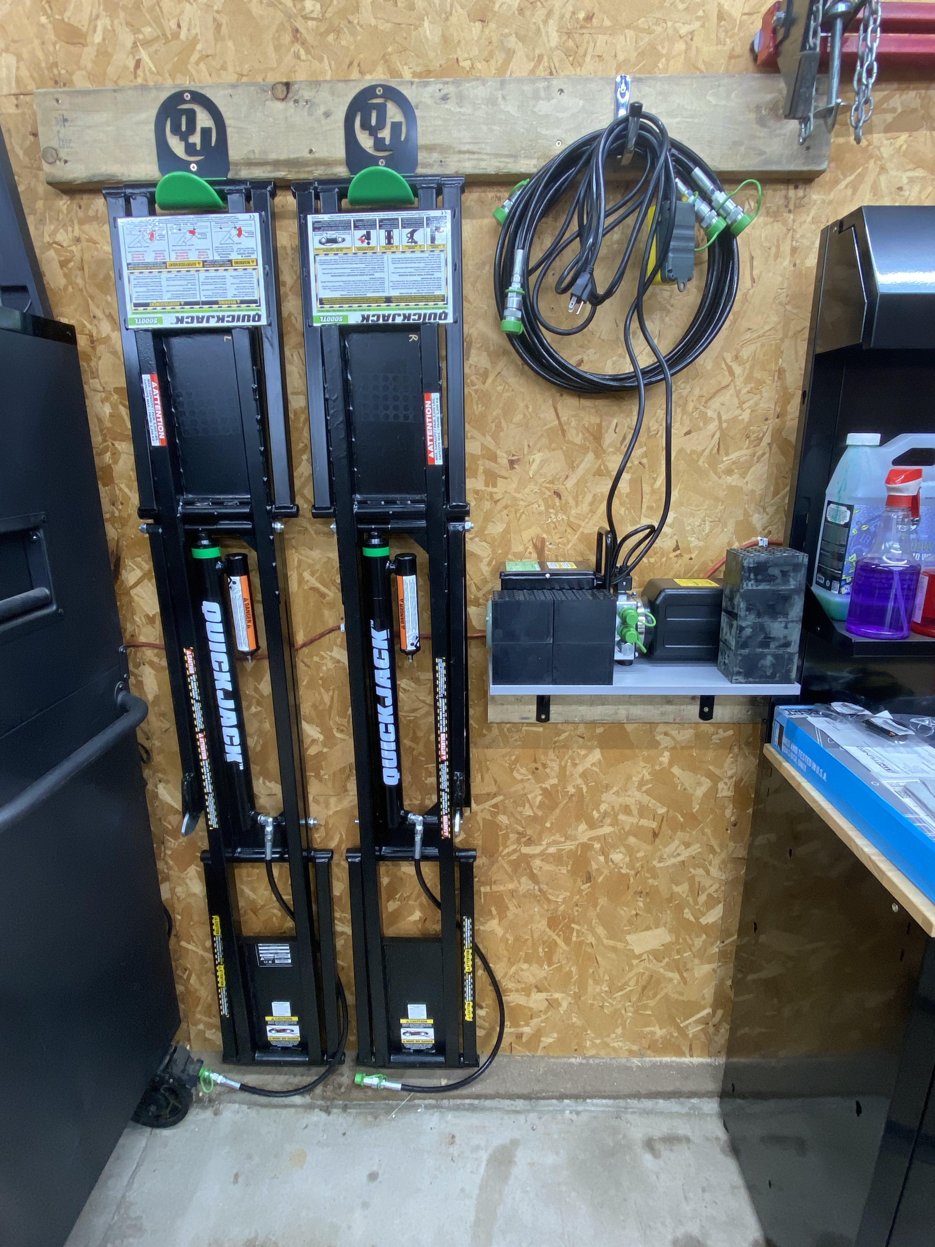

                They are a little on the cumbersome side for maneuverability, the wheels they have on them are hilariously small - but I really didn’t have the room for a 2 post lift.
                these store nicely against my wall on the hooks when not in use.
                super easy setup, bleeding them was kind of annoying as the ATF went everywhere. I opted to use Teflon tape instead of the “updated” pneumatic sealant they provide. (They used to all ship with Teflon tape, but apparently people couldn’t figure out how to tape things and sent it into the pump)
                Here are the 2 locking positions when using the tall blocks
                Lowest lock
                highest lock
                these pics are only using the “tall” set of lift blocks, they include both a short/tall set that do have the ability to be stacked together, I don’t do that though
                Because of how they lift, the car will move about 12” front to rear, just something to keep in mind if you don’t have much room in front of/behind the car
                what’s nice is if you plan on the car being up for a while (lol) you can lower the jacks onto the locks and disconnect all the lines
                I waited for a while for these to go on sale and due to some Home Depot shipping mess ups, ended up getting these for like $1200.
                overall I really like them, changing wheels/tires/oil changes/bleeding brakes is all super easy

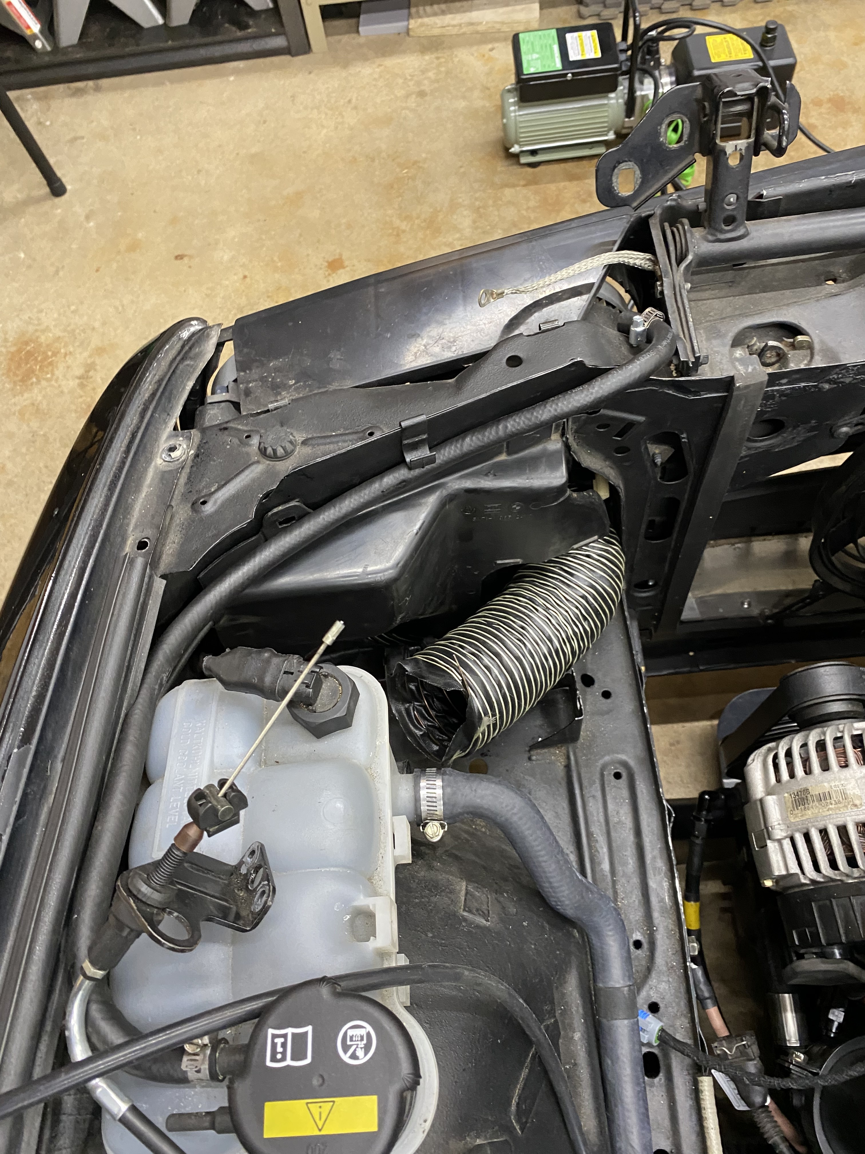

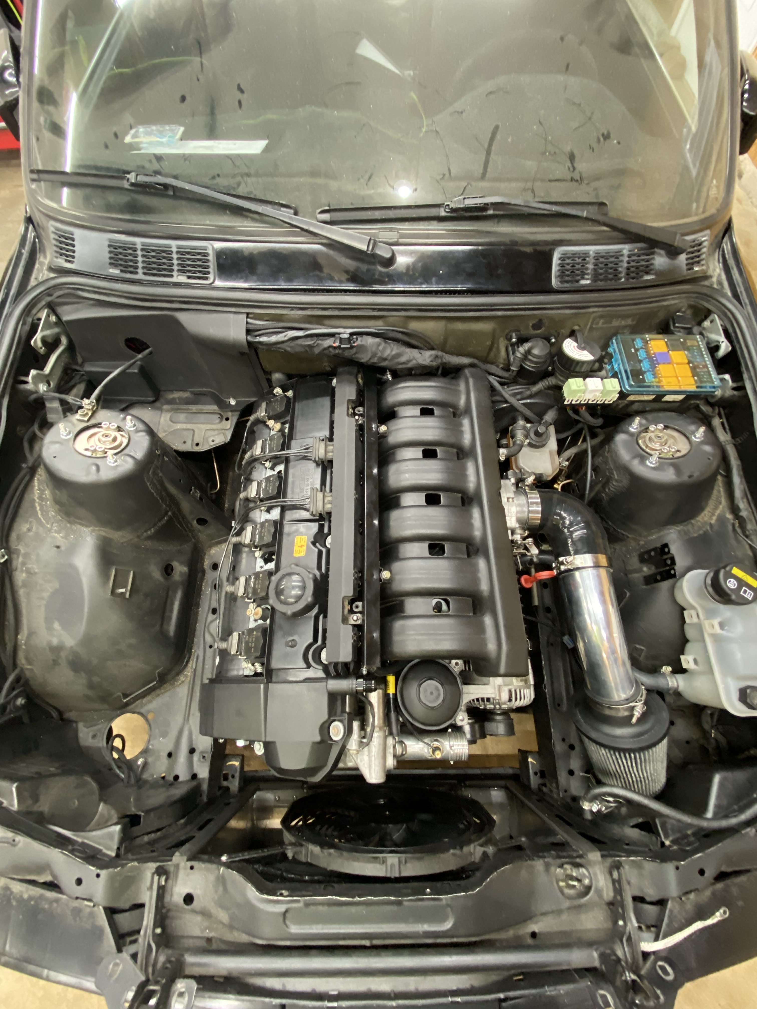

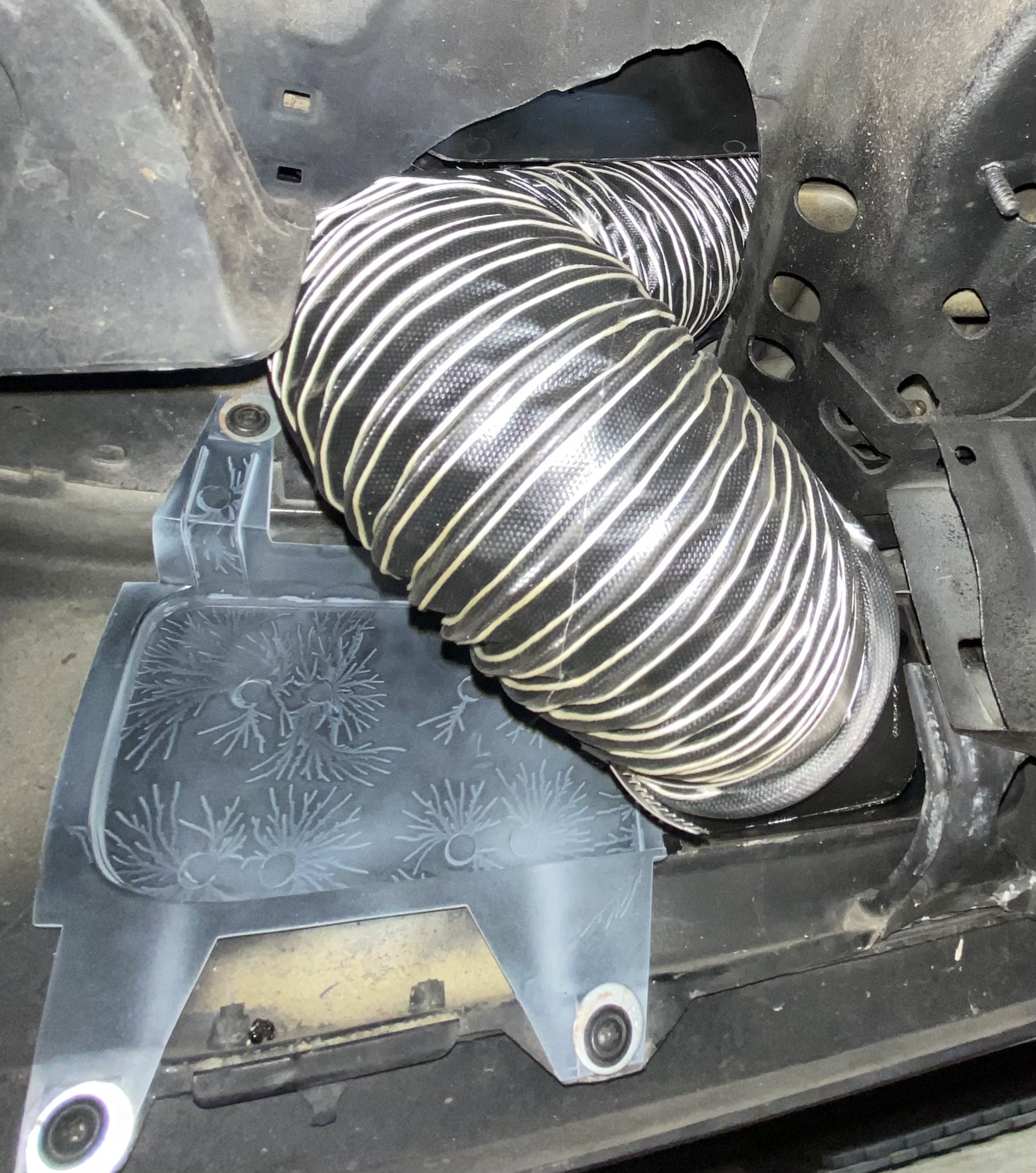

                    Poked around a bit on Sunday, everything is hooked up in the engine bay now(other than radiator), just need to have the IAT bung welded up to the intake tubeF369D24D-2250-4C98-B7B8-9FCA8470FF07.jpeg
                    Here’s a better pic of the duct routing for the intake E64D7DD1-D0F3-4E0A-9787-79C2824ECB81.jpegBC7048B1-765E-4481-8A81-0A3835CD8109.jpeg
                    TBD if it will help or not, they’re fairly tight bends - eventually will add a ‘heat shield’ of sorts along the drivers side frame rail to block what heat I can coming off the rad
                    Added oil & PS fluid, brake fluid level is good, getting closer to hitting the key & finding out if I screwed anything up

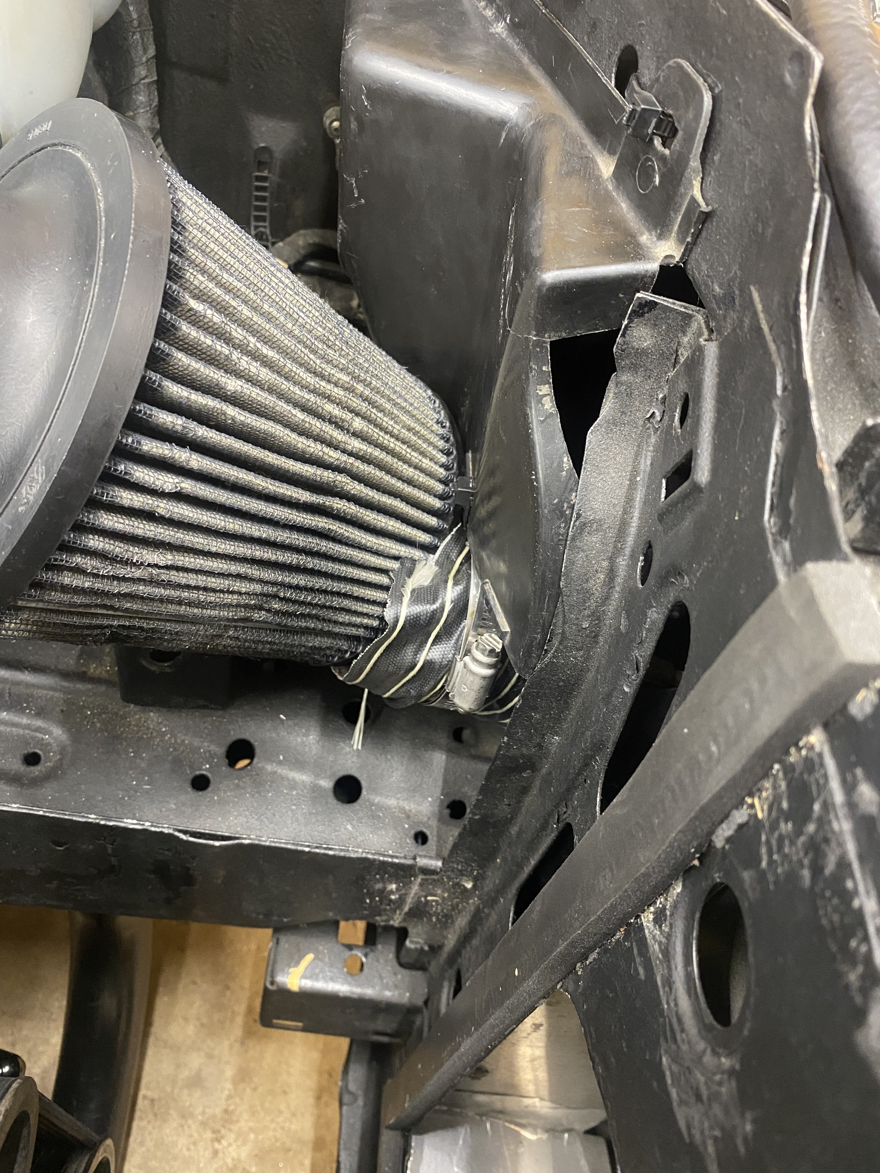

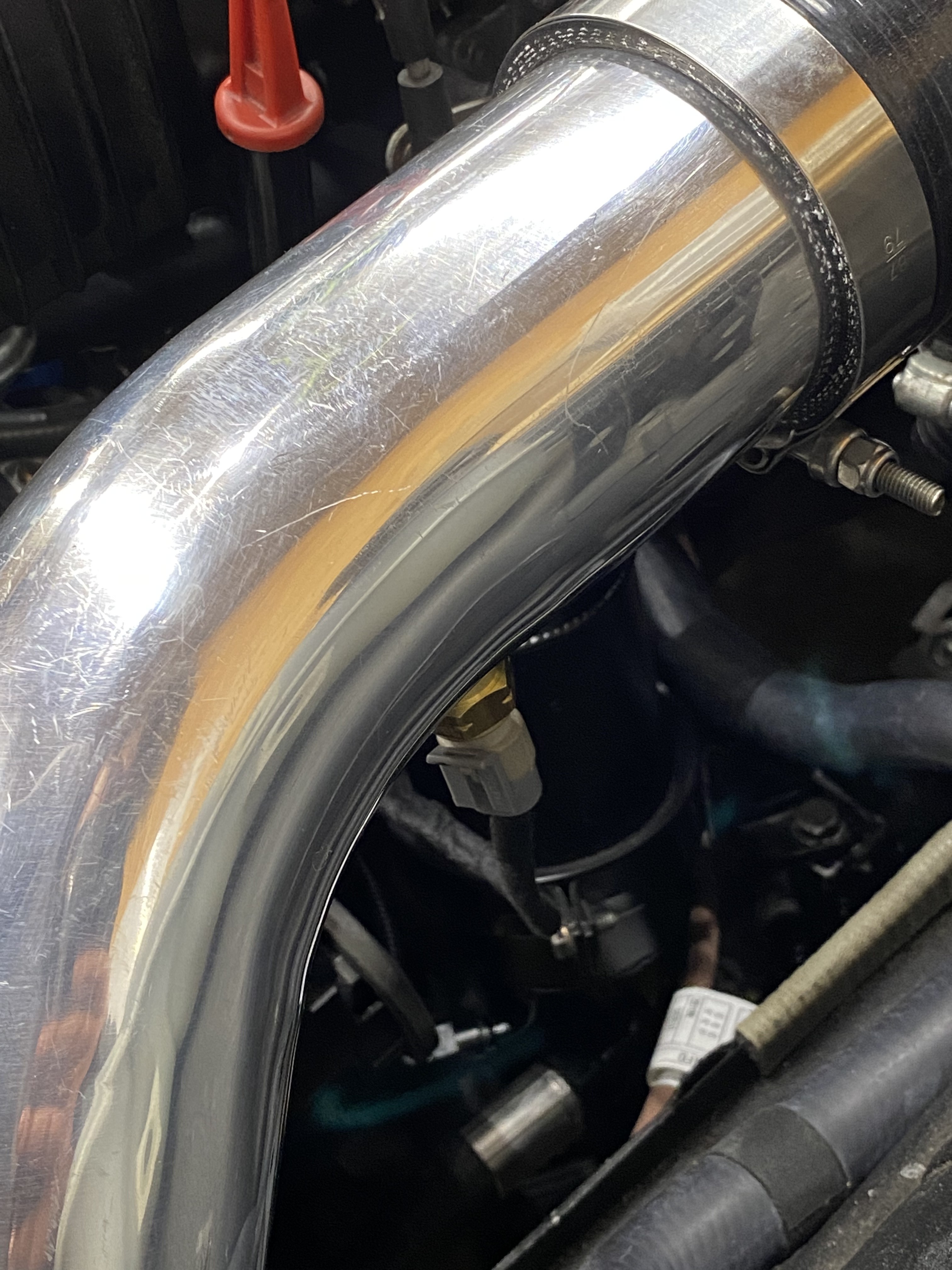

                      new AEM filter that isn’t a cone shape so it fits better

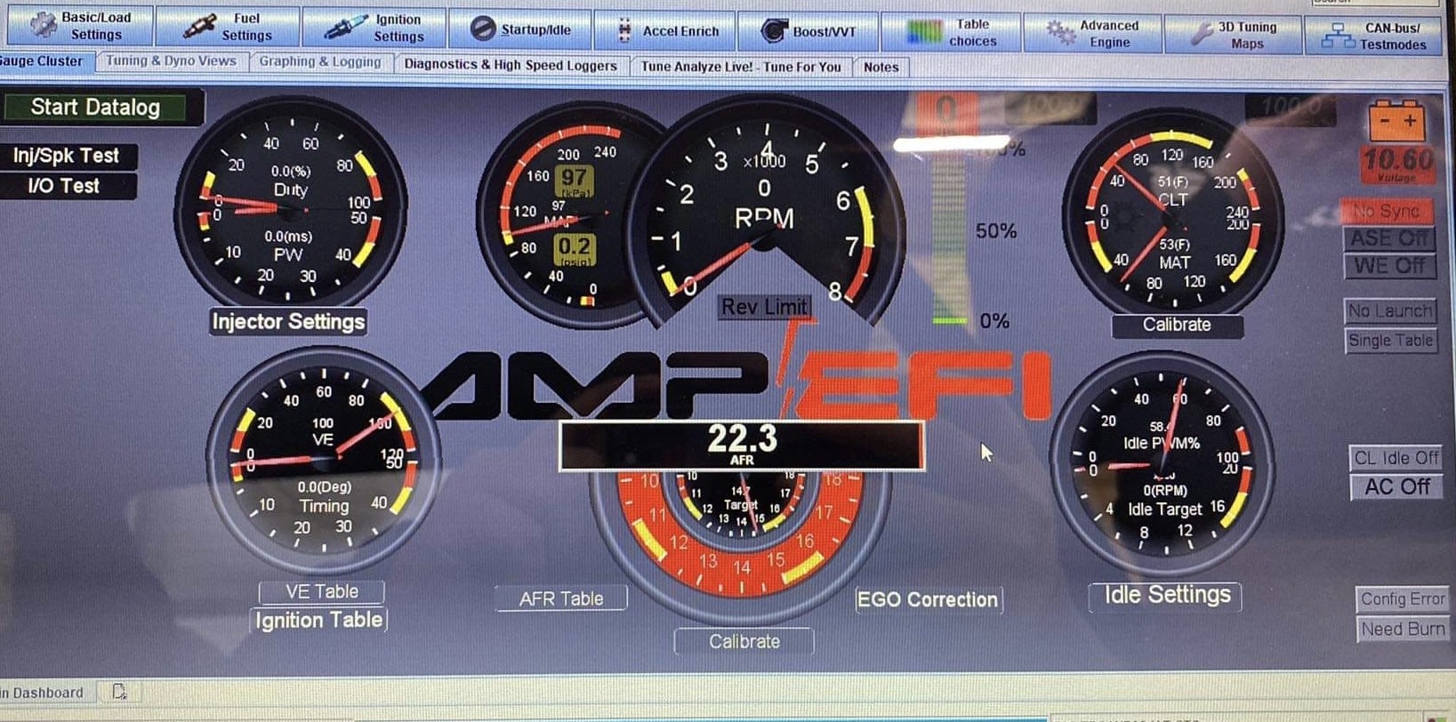

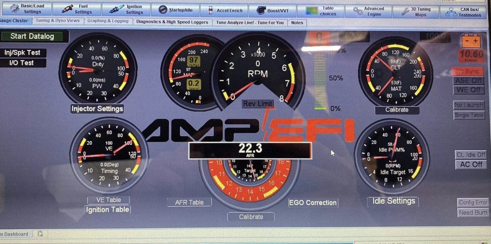

                      wired up the MS3 pigtails for the WBo2 signal and the IAT. Dropped the 2017 battery in the car and hooked up the MS3 to the laptop. Before turning the key I removed the fuel pump relay. Key on and we’re live
                      i bought this MS3 back in like 2017, so needless to say I had to update stuff a few times ha. Firmware updates wiped some oem temp sensor calibrations so had to re-enter the coolant temp, IAT was no big deal as I’m using a GM sensor and would’ve changed it anyway.
                      -Calibrated TPS, changed to GM IAT, added values for stock CTS, switched to wbo2
                      I was going to continue on, but the battery voltage was dropping fairly fast, so I wanted to get a few cranks in to get some oil moved around. It quickly dropped to around 7 volts and wouldn’t really take a charge. Bought a new agm battery a day later, have that on the tender for now. Pulled the oil filter cap off and it was full of oil, will probably do some more priming before putting the fuel pump relay back in. Can probably remove the stock O2 relay now too
                      next up is to jump into the reqfuel & injector settings as I’m running some EV14 380cc (36lb) injectors - when I bought them 3 years ago 380cc was the smallest they offered, now they offer 315cc (30lb)
                      after that’s adjusted can probably attempt a first start. Once it’s idling I can then verify/set base timing. Bought a LS(?) plug wire to use as an extension to go from coil pack to spark plug so I can grab cyl1 signal.
                      assuming that goes smoothly I can drop the radiator in and get PS/coolant bled and go for a first drive
                        #471
                        All the MS3 stuff is good to go after some help on injector dead time voltage curves from a friend, figured I’d burn it to the ecu & then wanted to see if it would start. This was the first time I put the fuel pump relay back in
                        didn’t let it run too long without the radiator, just wanted to see if it would hold idle. It was in warm up enrichment so the idle was pretty high, but should be enough to verify base timing and then toss the radiator in and get everything bled.

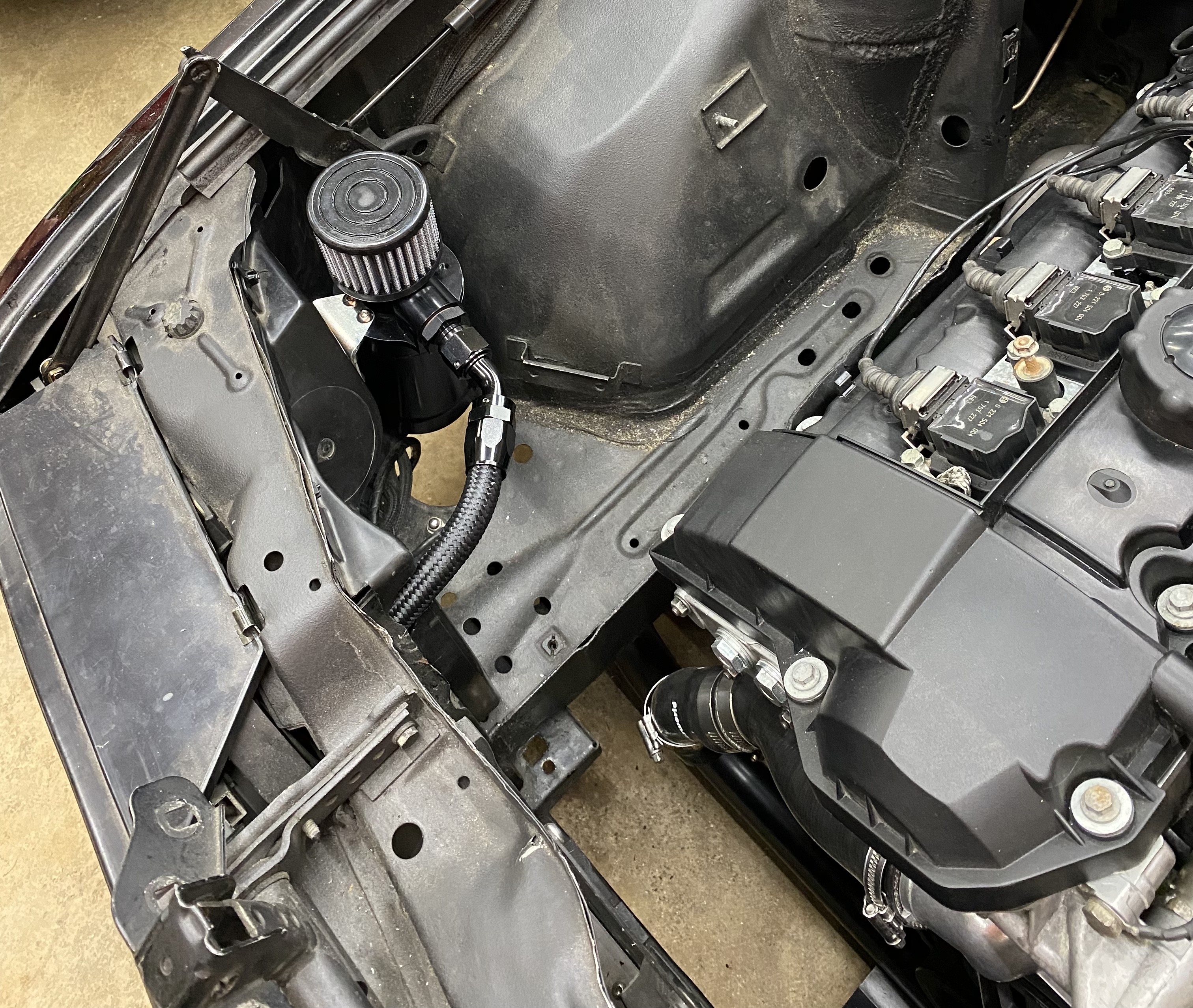

                          Catch can fittings/hose showed up yesterday so I got that installed. Hose routes with core support, we’ll see if that routing works - if not I can re route it. 1114345A-283B-4454-8681-ABB7532FCFA4.jpegC7C7A630-CE88-469F-83E2-00A7C5A861FB.jpeg
                          radiator mount thing shows up today (holds the rubber isolator in place) - going to install the radiator stuff after messing with some tooth #1 angles in tunerstudio to make sure commanded timing is lining up with what I’m seeing with the timing light. Hoping to maybe drive this thing around a bit Friday afternoon/this weekend

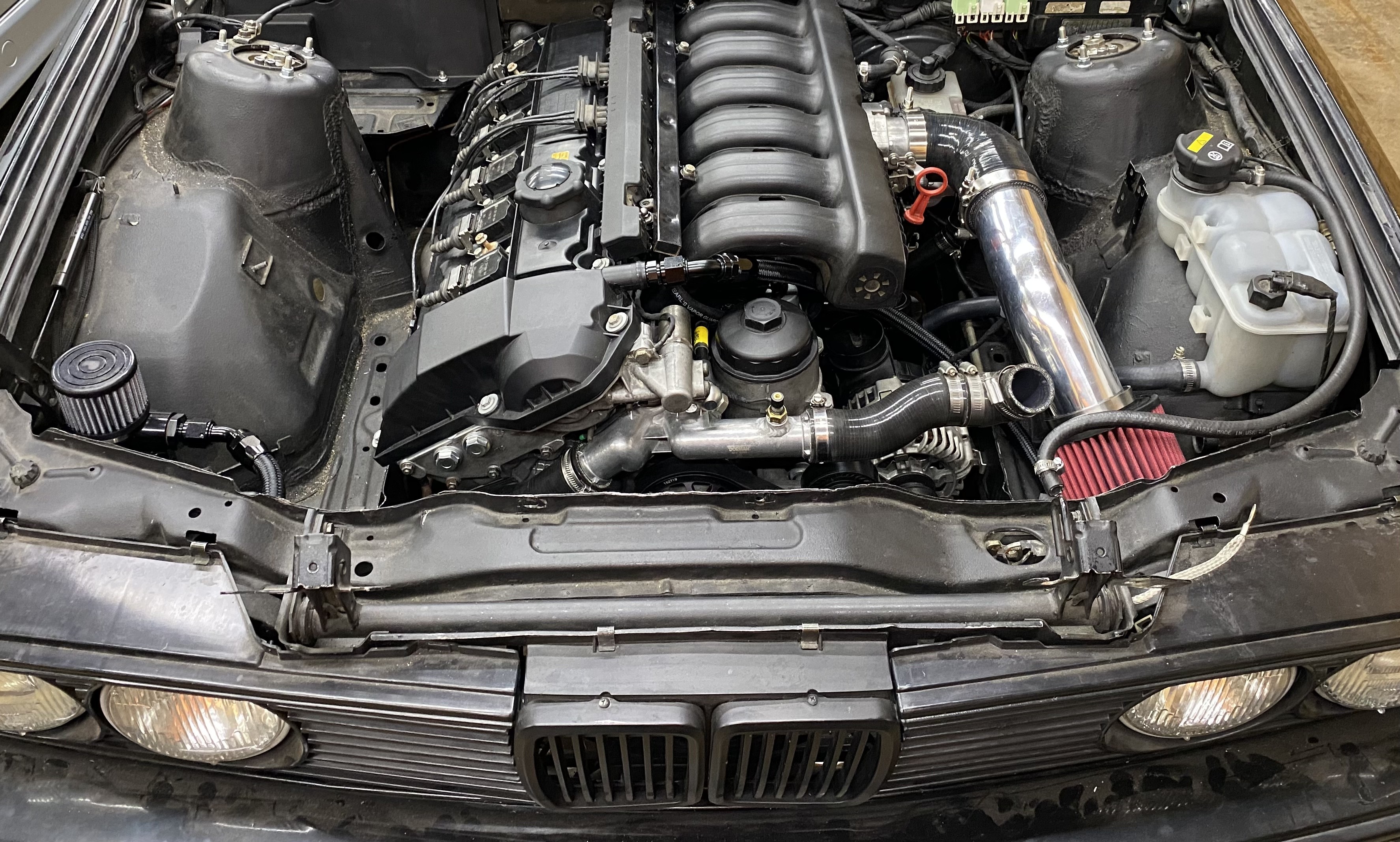

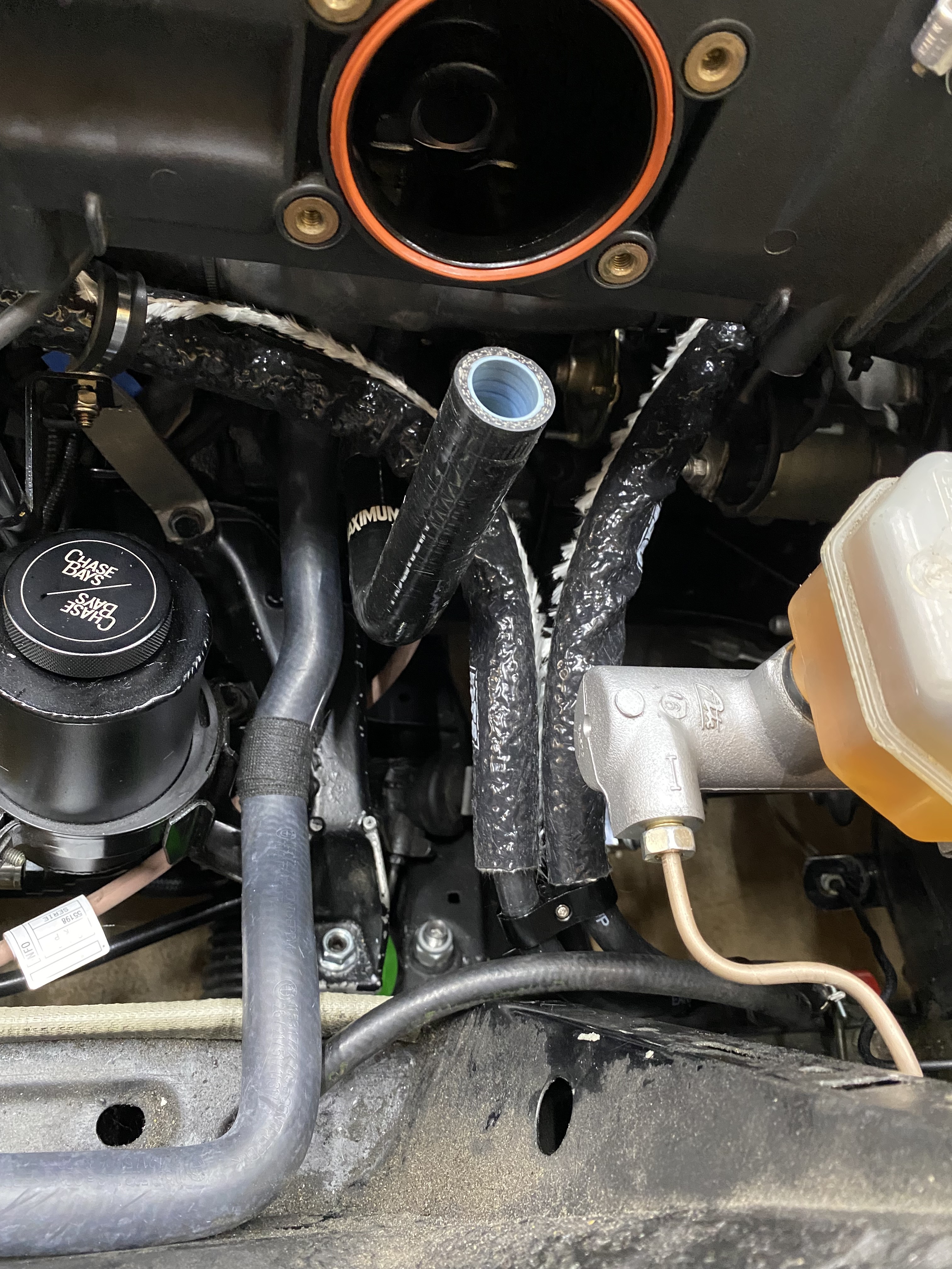

                            Added some DEI heat sleeve to the fuel lines/brake line by the header, PS bled, coolant bled (had to do that a few times). Ended up changing tooth#1 angle from 327° to 324.5° BTDC, set it to fixed timing and cranking at 0° which allowed me to confirm TDC on the damper was aligned with TDC on the timing cover.
                            All washed up an swapped over to the non storage wheels
                            I did end up taking it out for a quick 3 mile blast and honestly the base map that’s provided is pretty decent. It was for s50 originally but changed all that with reqfuel settings and such to work with the s52
                            maiden voyage v2 coming soon

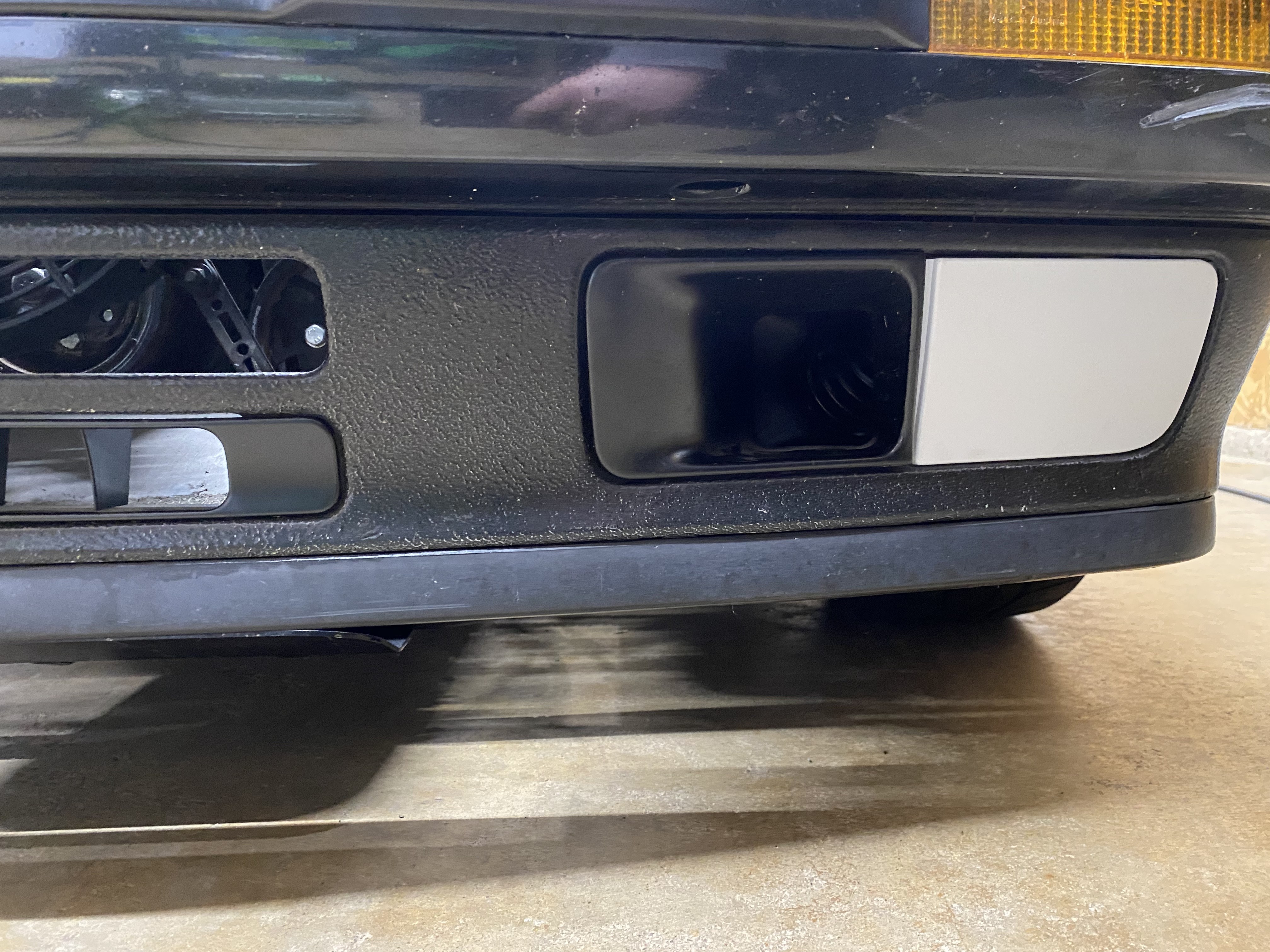

                              need to get the fog light deletes painted yet, but I think most of the stuff is wrapped up. It’s been a year since I’ve heard this thing run, so I’m trying to get re-acclimated to “new” vs “normal” noises lol
