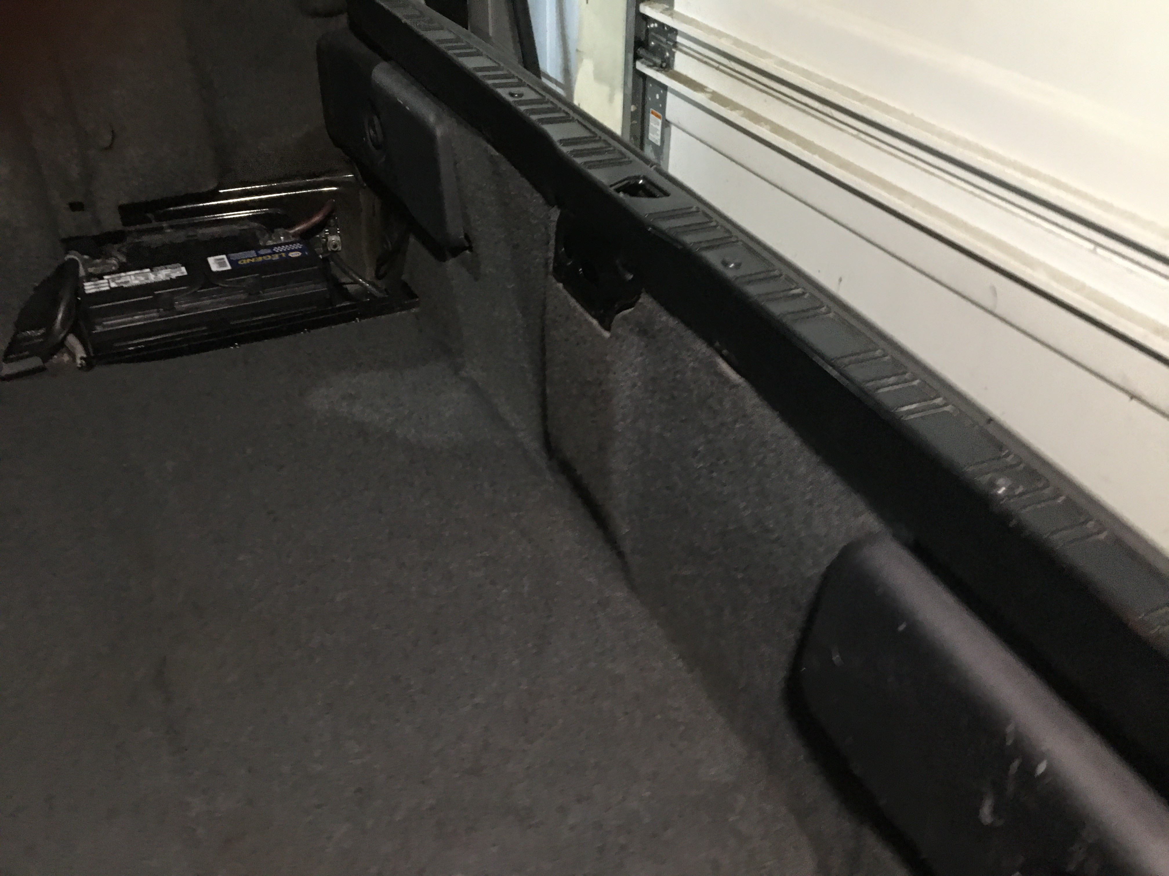

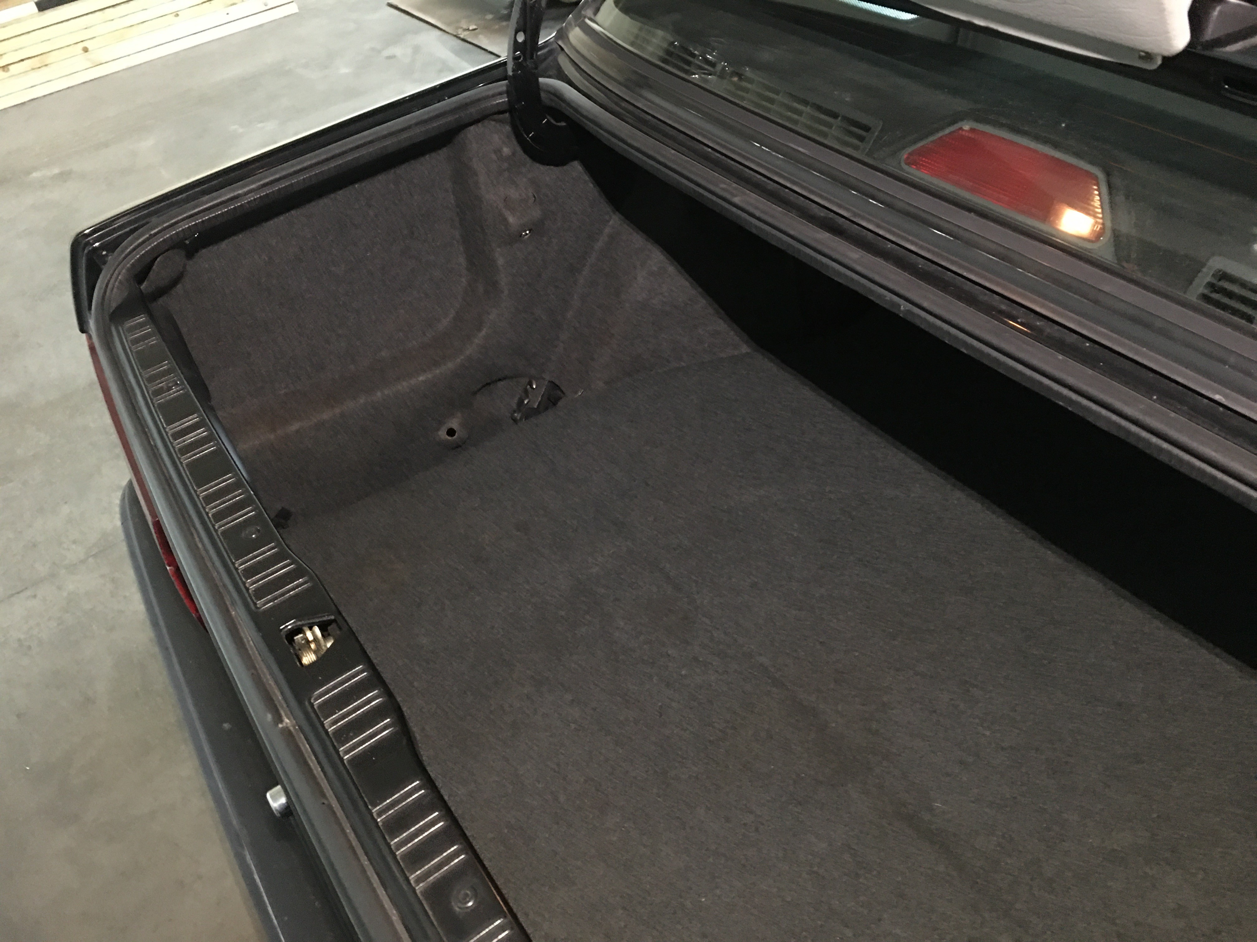

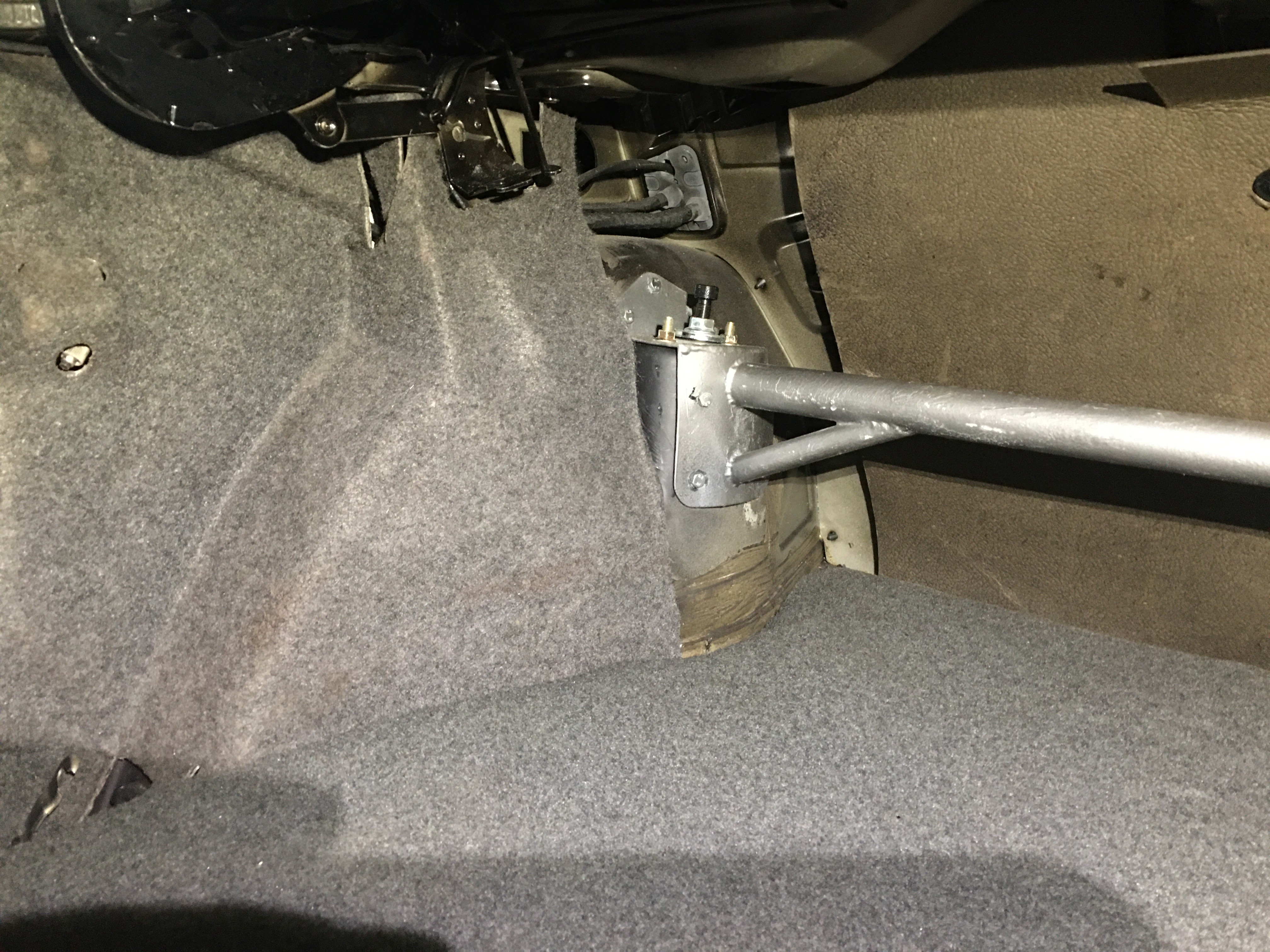

    Trunk carpets in. Could’ve got fancy with cutting them out for my adjusters and strut brace, but just cut them short instead.
    I do have the plastic battery cover, it’s just a tiny bit awkward to affix and it’s nice not having to tear anything apart for tech - so I won’t be using it most likely

      just put a cap on the positive terminal so an errant can of Molson's in your trunk doesnt short the battery.

        Lol. Thanks dan. Figured I’d spray this one and see how it turned out, not sure when I would’ve been able to make it down your way.

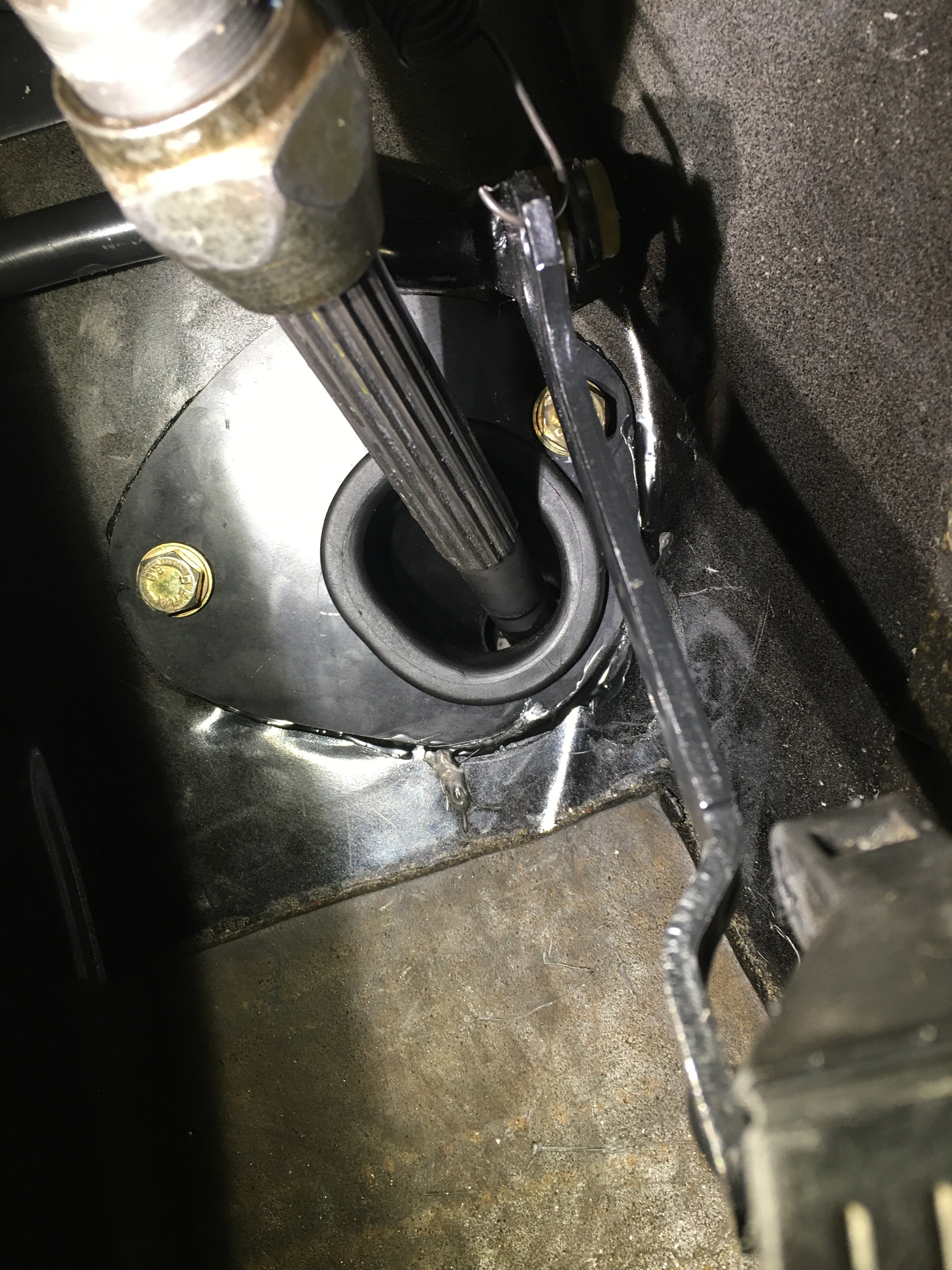

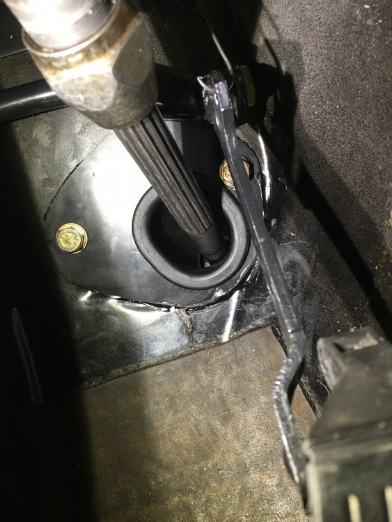

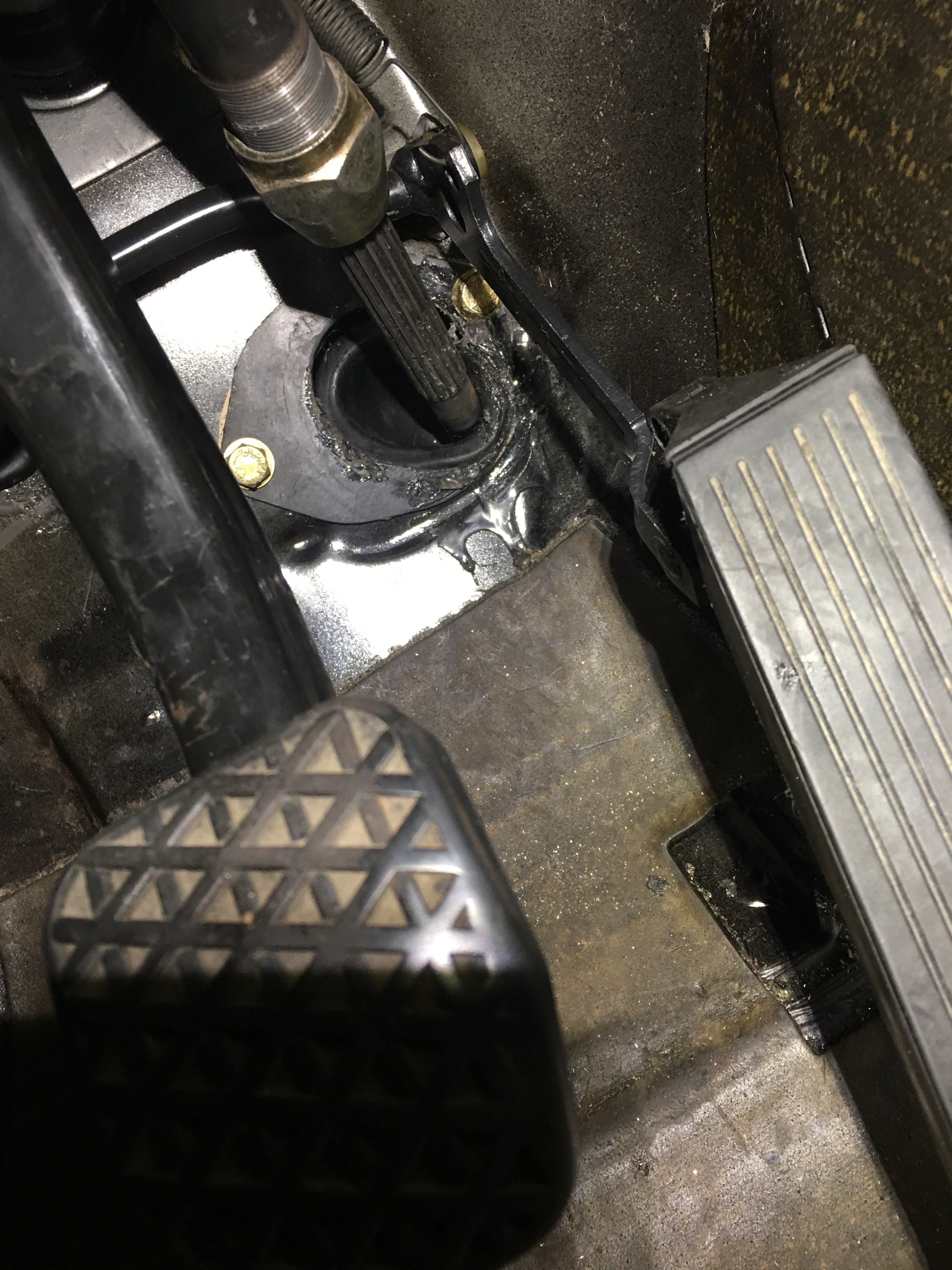

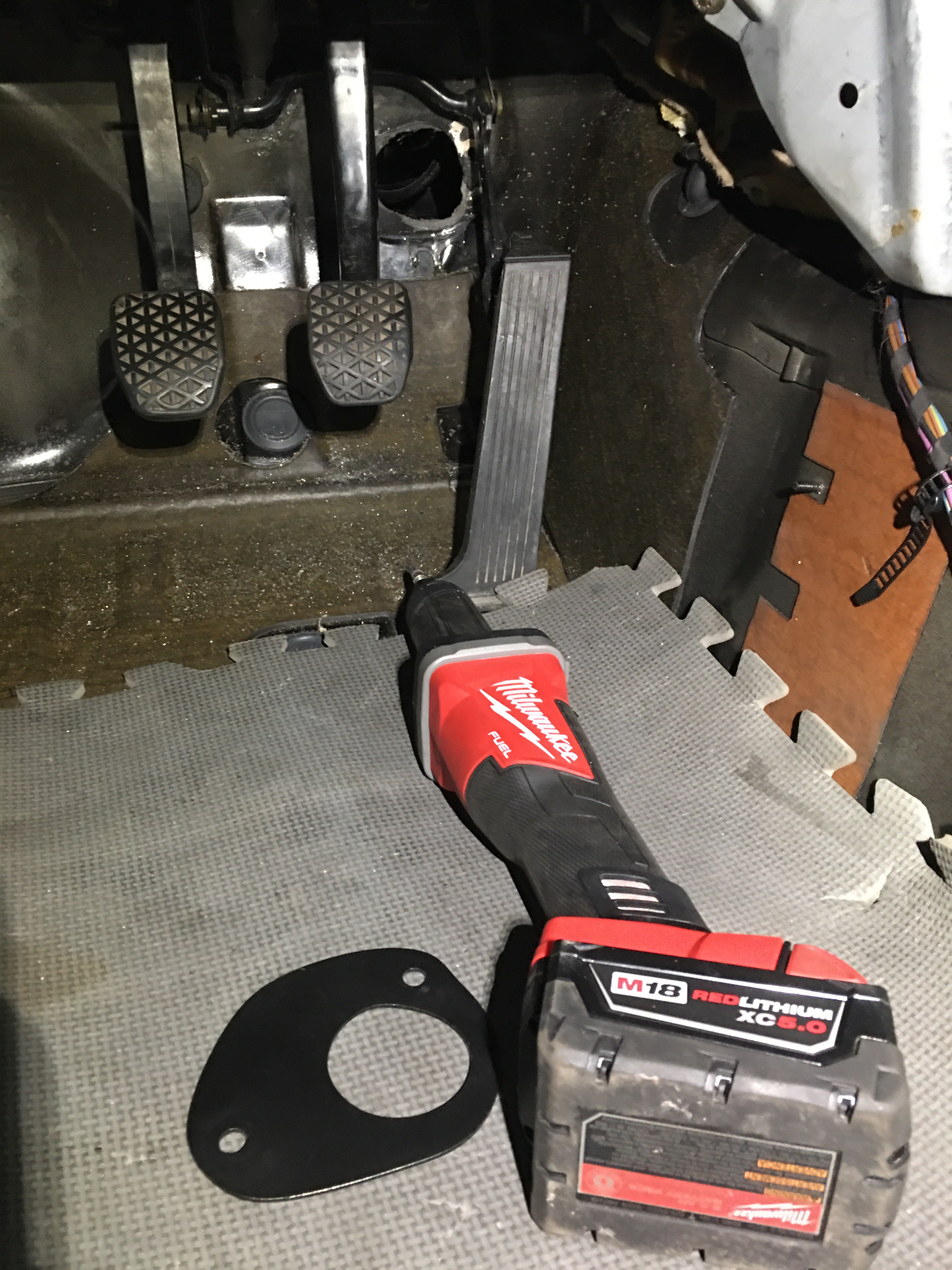

                Found a bit of free time this weekend to tackle the firewall steering shaft boot. Wanted to get that out of the way before putting the interior back in. Lots of e30 yoga was needed
                Here is the before, boot not really attached to much
                removed it all and had to make the hole larger. Queue the angry end
                once the hole in the firewall matched the new plate, I had to trim back some of the sound deadening in the engine bay. Slapped it all back together and sealed it with some 3m gasket in a tube.
                boot fits snug and was a PITA to get snapped in, but once it’s on it is not going anywhere.

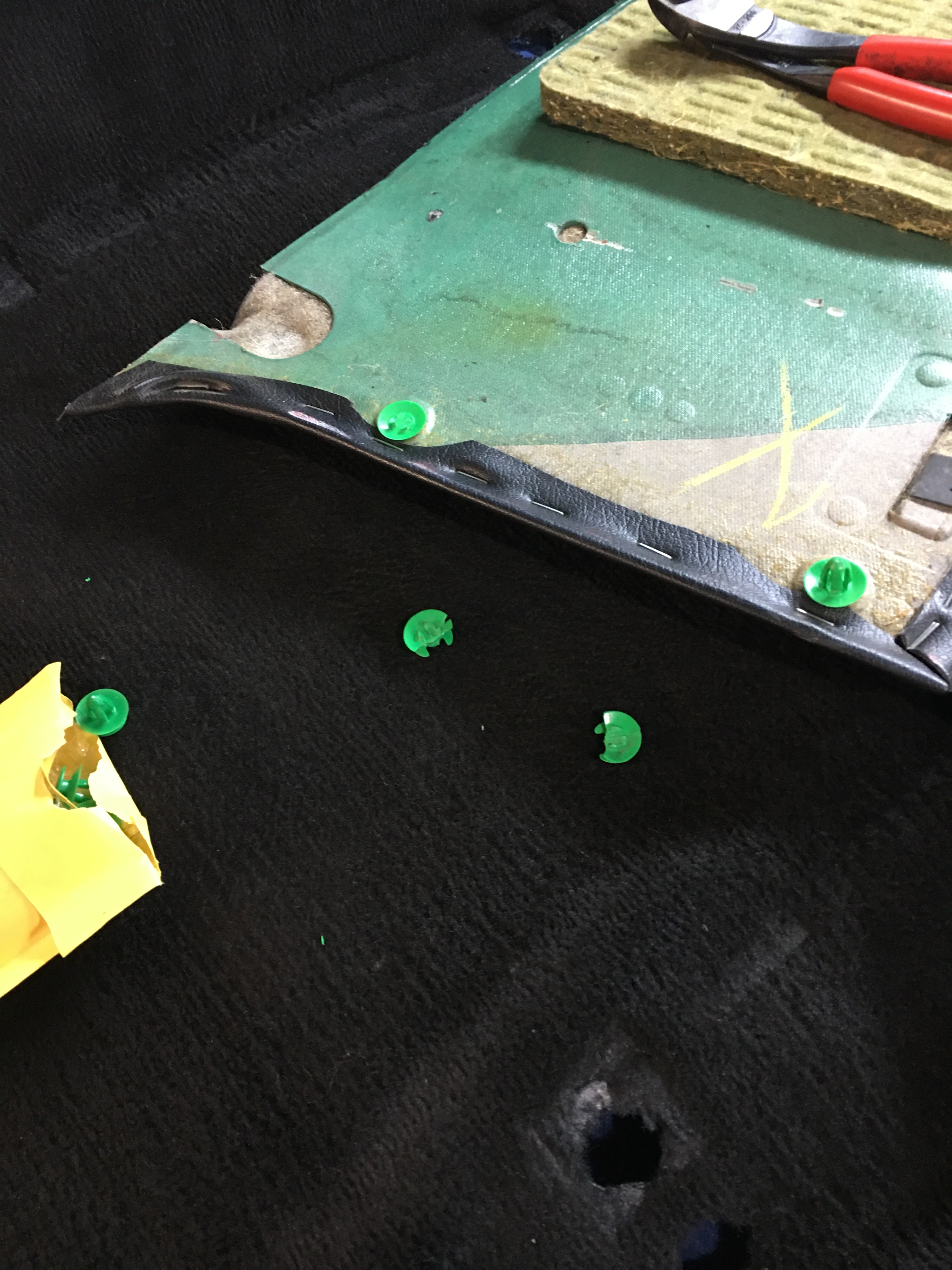

                replaced some old brittle trim clips as well, noticed my door cards kept popping out and some of the rear trim wasn’t staying putC29E9AD0-3BED-45A8-88F3-D354F5870621.jpeg

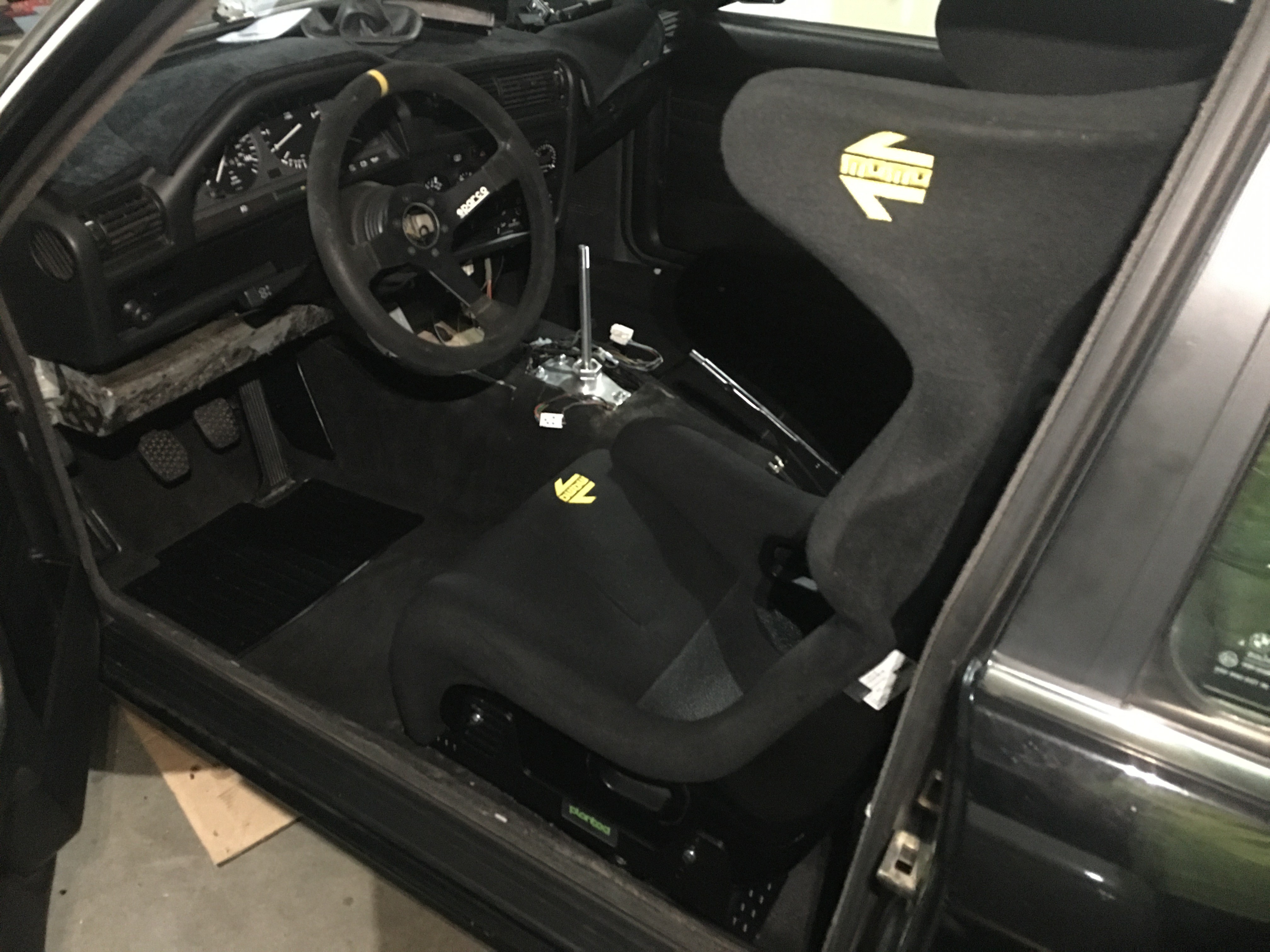

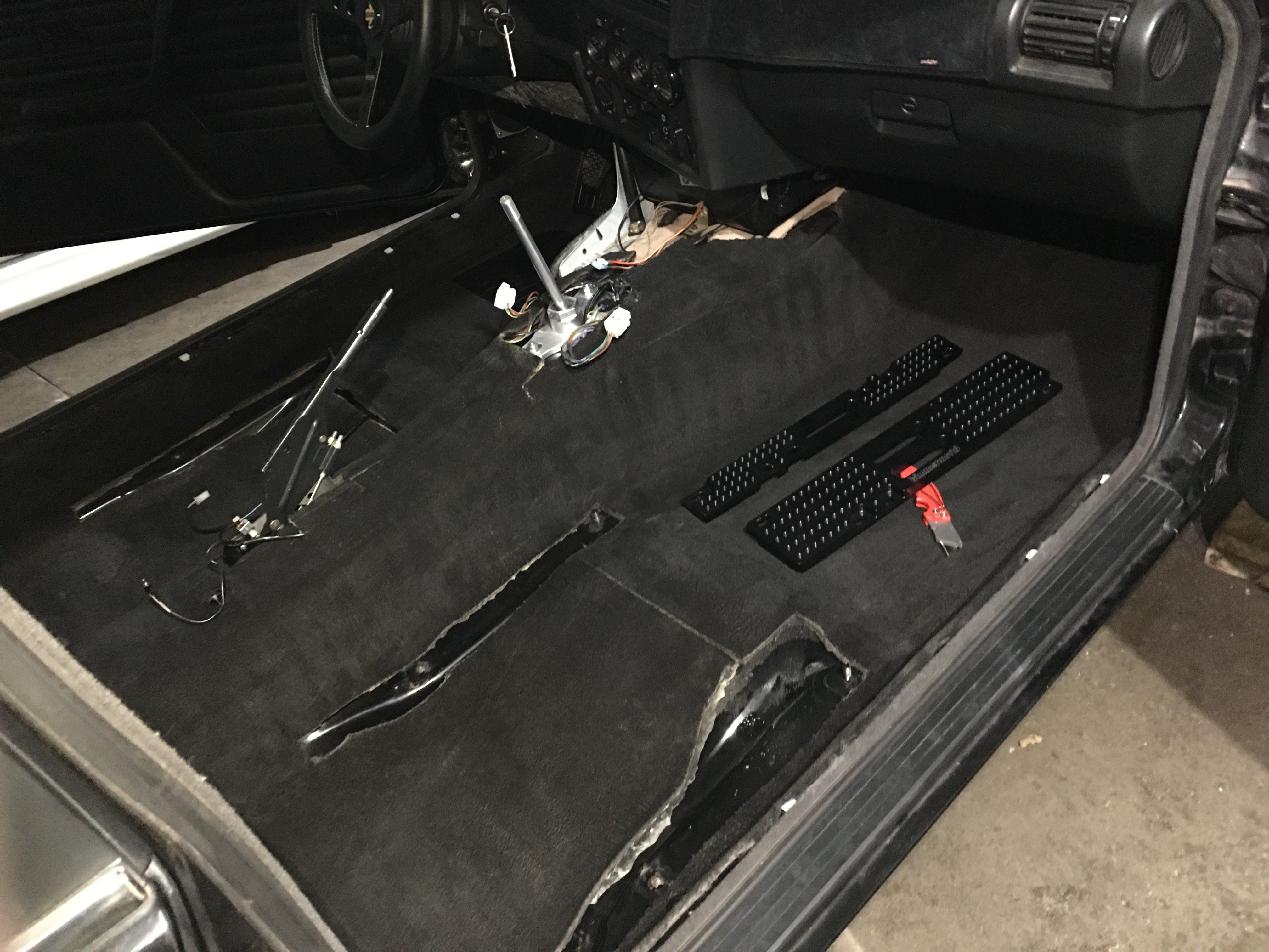

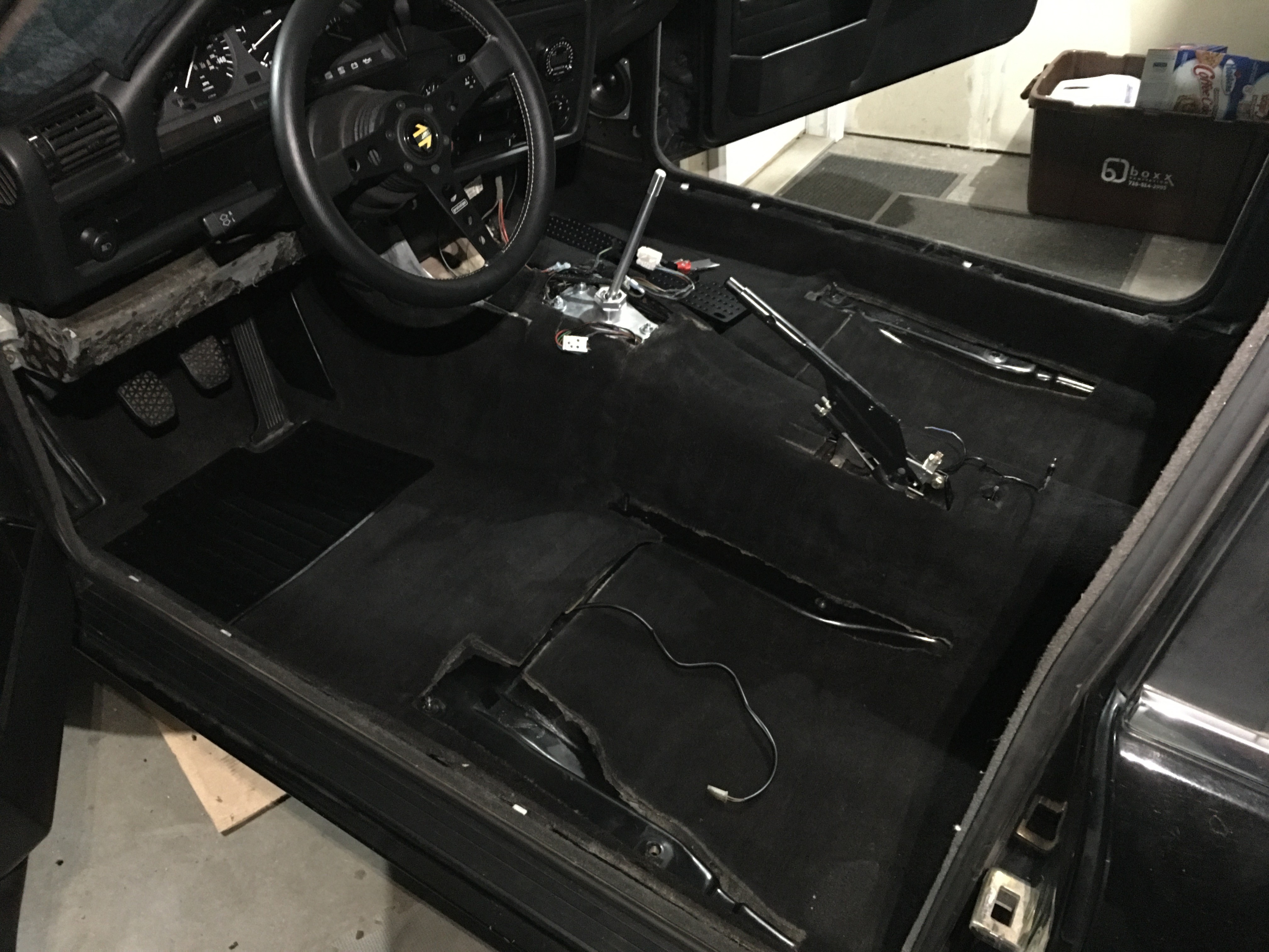

                  I tossed in the new gas pedal stopper, innovate wbo2 & got to work putting the carpet in. Once it was in I sized up the bummerworld floor plates in order to cut the carpet up some more (the plates sit flush against the body). I haven’t bolted the plates down yet, but here’s where I stopped for the night.

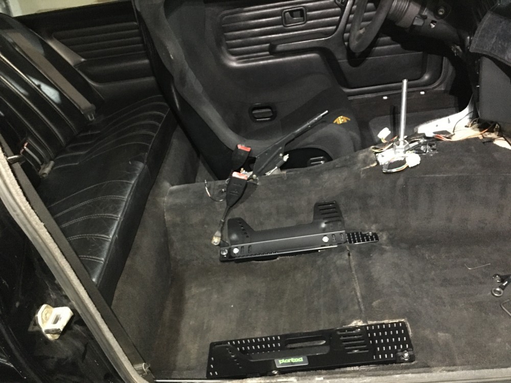

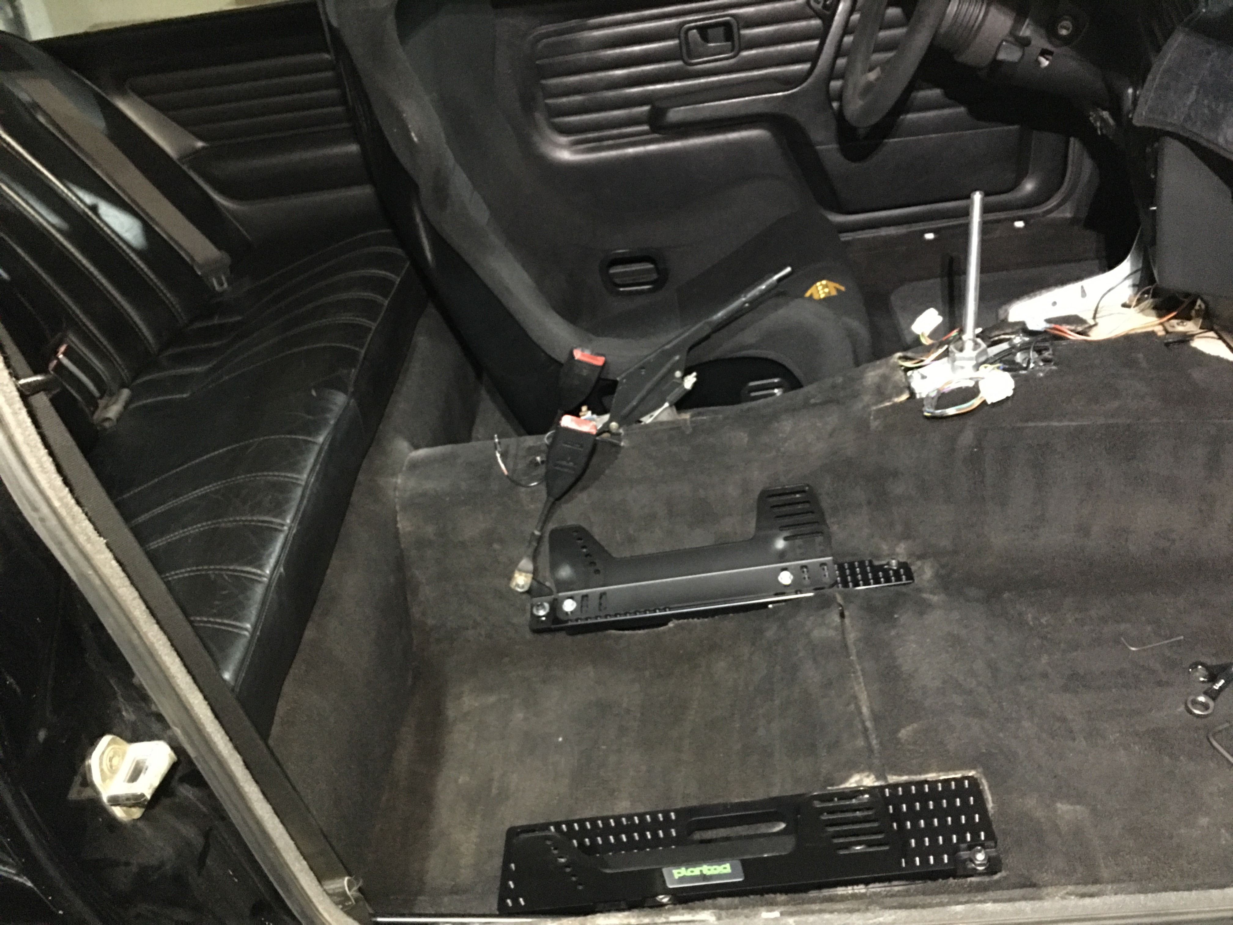

                            Decided against running the bolt-in 4pt. I set it up in the car and realized I didn’t want to drill holes in this car. So that is for sale. Got to work installing the floor plates/rear carpet/rear seat/speaker panels/front seatE28701A2-4D79-4032-AB5E-2264F5DBEE2B.jpeg

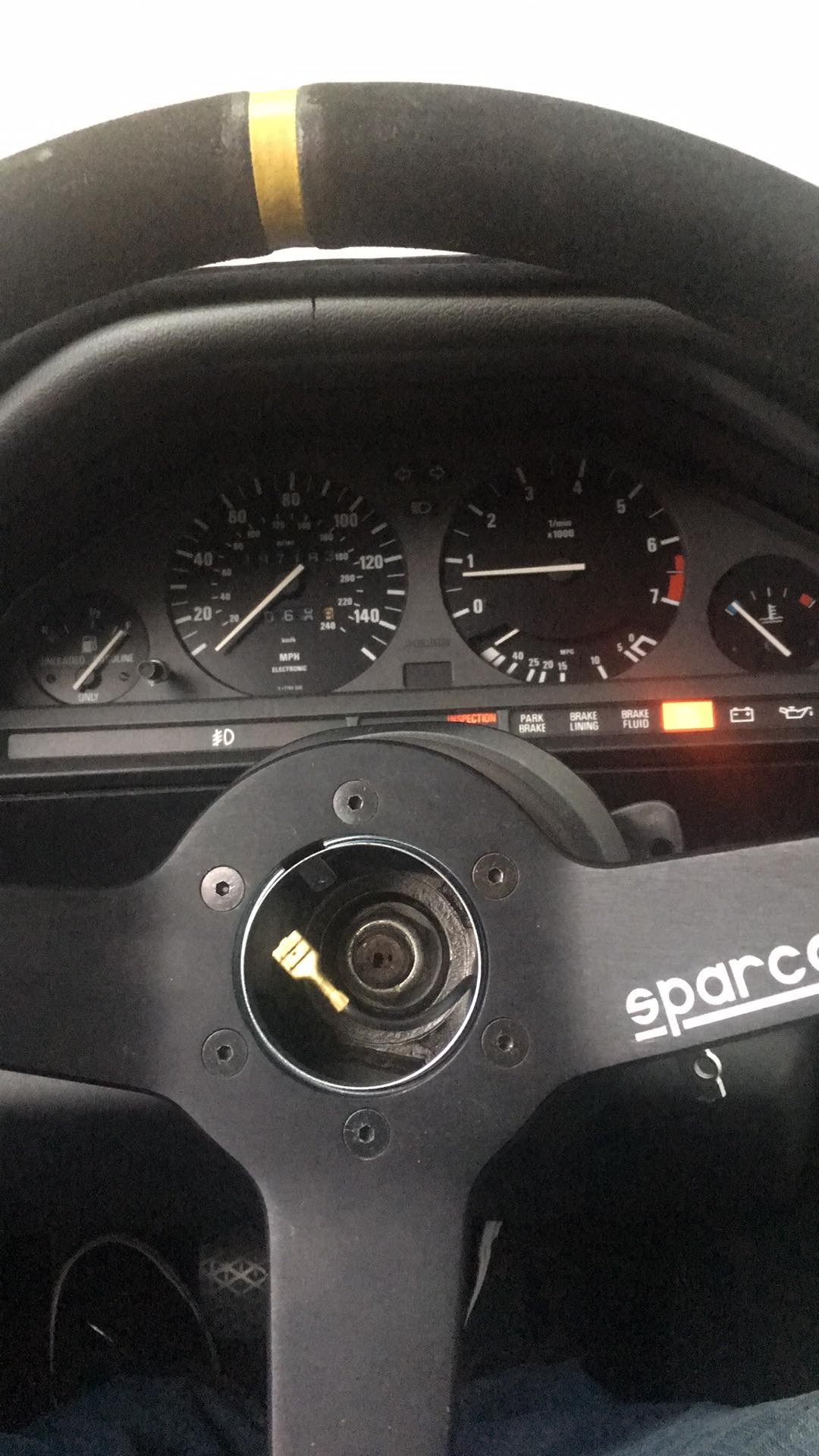

                            pulled the protipo out and tossed the sparco wheel in to see if I’d like the wheel closer to me which I did. So I’ll be trying to sell the prototipo still if anyone is interested as well as the sparco (pictured)

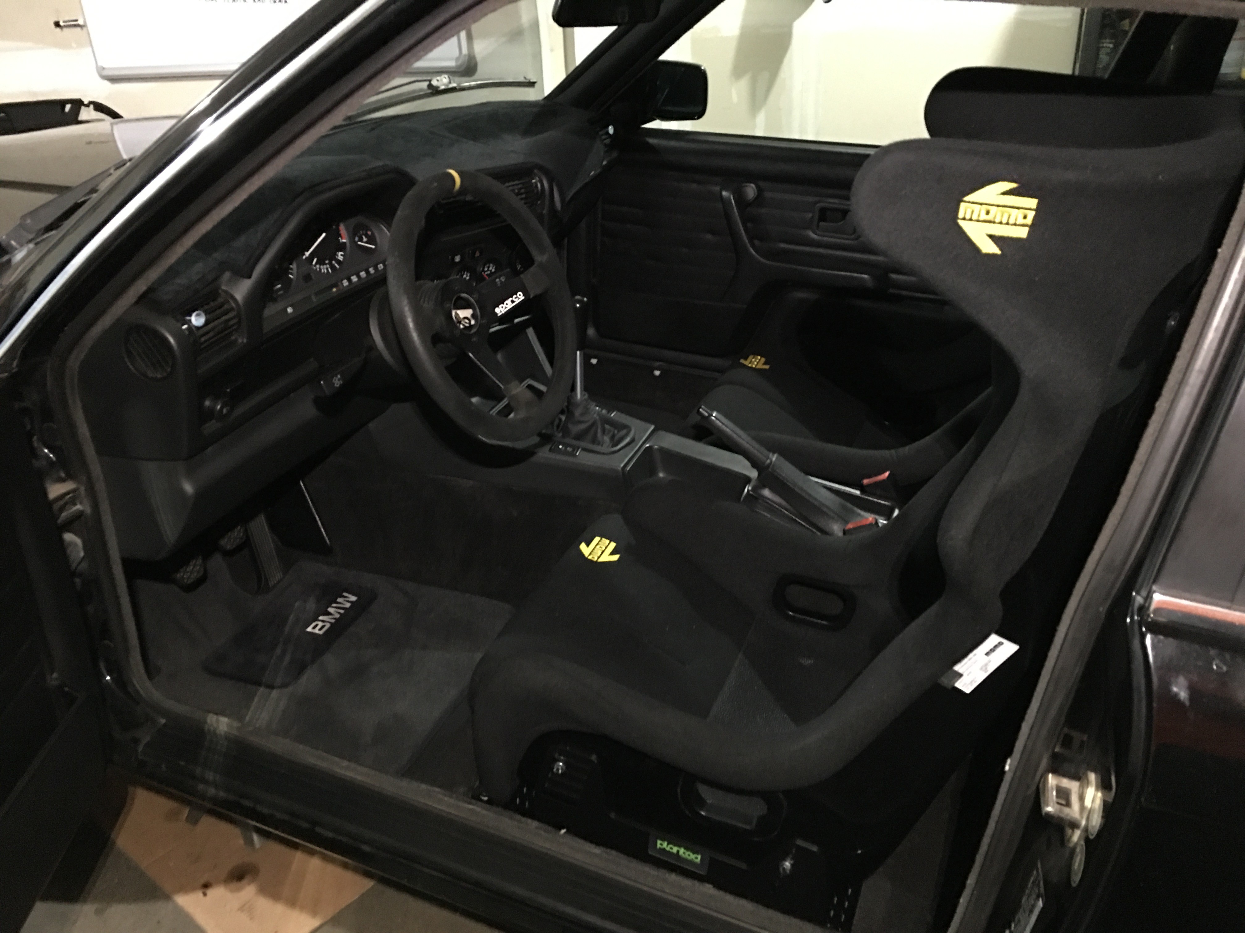

                              Got the rest of the interior back together, less the sill plates. Those clips for the plates are the bane of my existence. I went on realoem, found the PN & ordered and I rec’d the wrong ones. If anyone knows the PN for the sill plate clips please let me know.
                              Finished putting together the rest of the interior.
                              tightened down the seatbelt anchors & tossed the rear seat in
                              floor plates tight & loosely installed the planted side plates installed seat belt receptacles with VAC adapters  I kind of knew based on the drivers seat where to put the side mounts which helped822953EB-7CF6-424A-827D-5AA6A6EEC930.jpeg

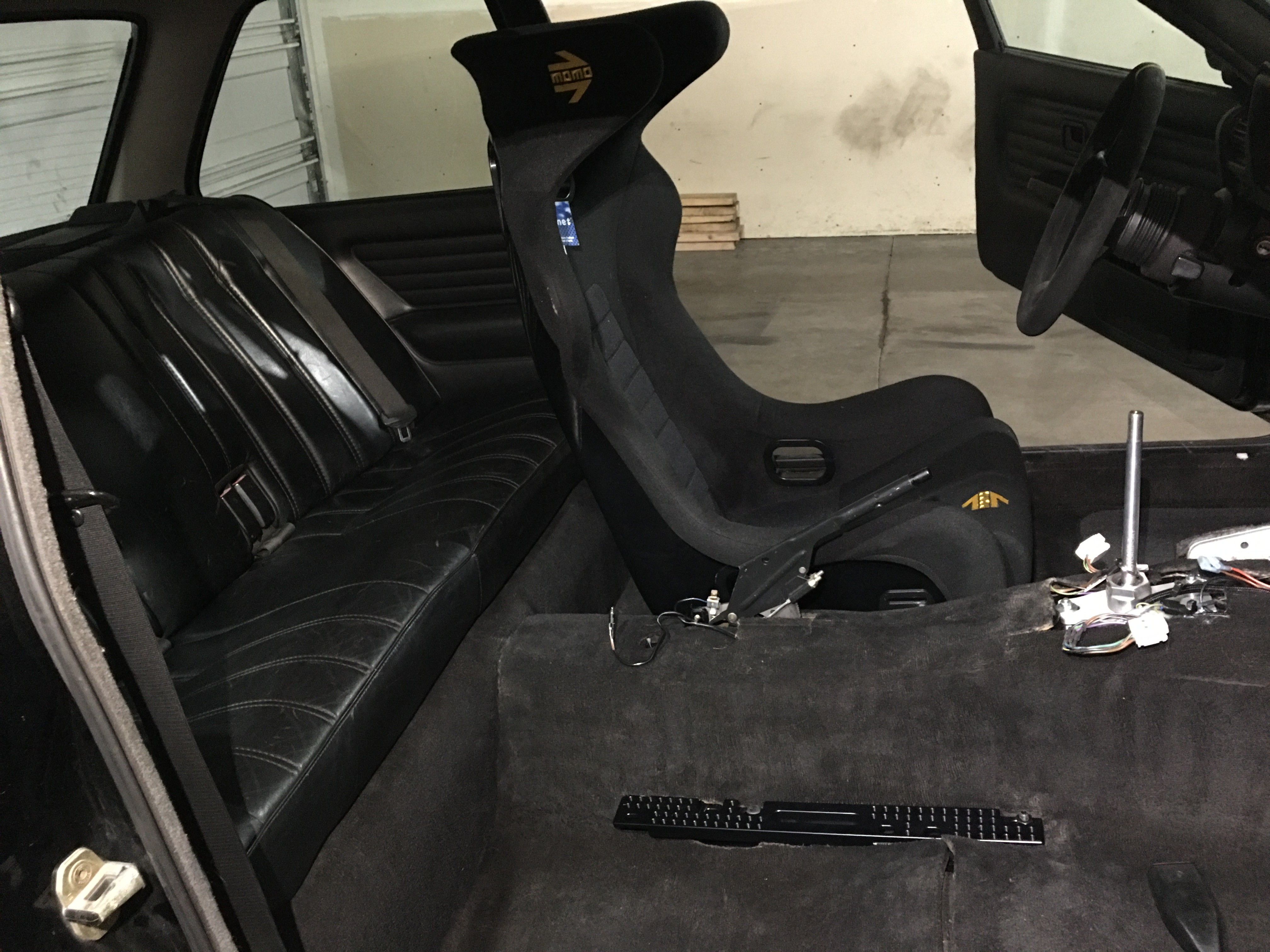

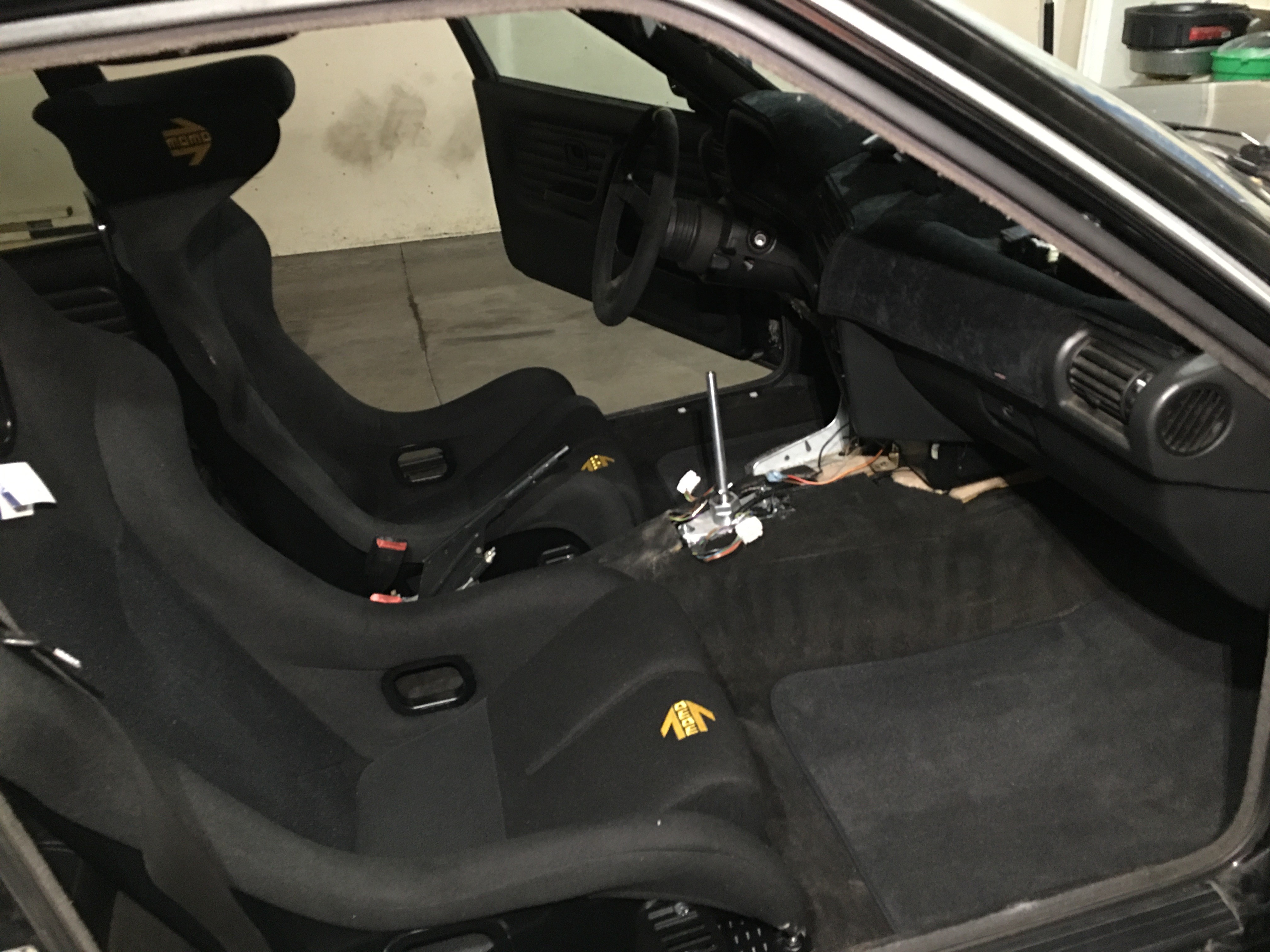

                              next up was the seat

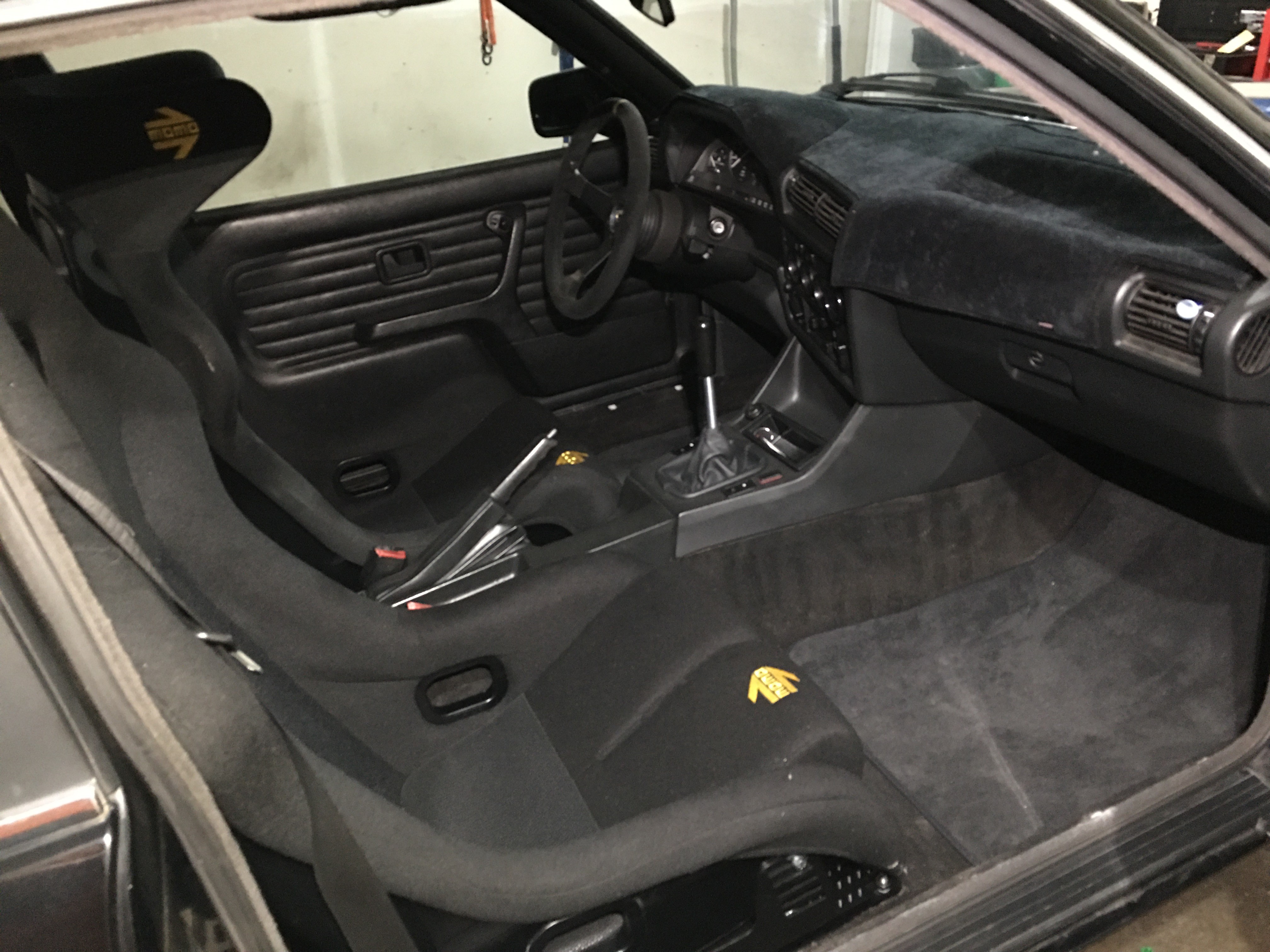

                              it’s a super cup XL, which was wider than the Daytona XXL on the drivers side (which fit without issue). ran into a bit of an issue with the trans tunnel not allowing the seat to clear the door card. Changed the tilt and it clears now (still close though) door shuts like normal at least.
                              Installed the rest of the interior bits and here’s the result, less the annoying sill plates. Even put the floor mats in lol
                               Pretty happy with the interior now. Glad I put the rear seat back in even though it is no longer accessible, I never had anyone ride back there anyways.

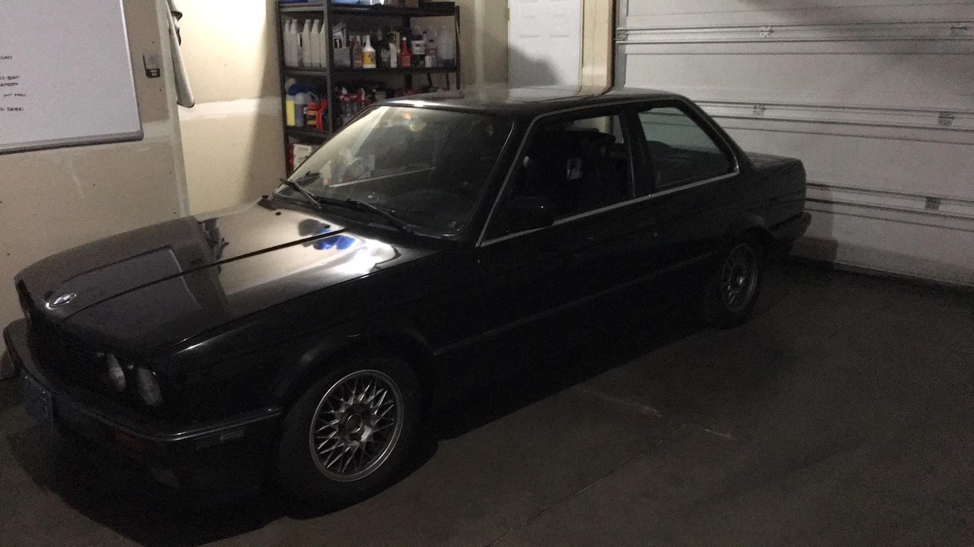

                                    Back on the ground and it fired right up. The coolant “leak”/drip must’ve fixed itself because I Can’t see anything dripping from the area. Before I took it out I had to add some more power steering fluid and re align the steering wheel after having the steering shaft out during the firewall boot install
                                    I need to get this ABS light off the dash, it’s  super annoying. Also sometimes the brake fluid light flashes, it’s full though.
                                    need to wash it so badly
