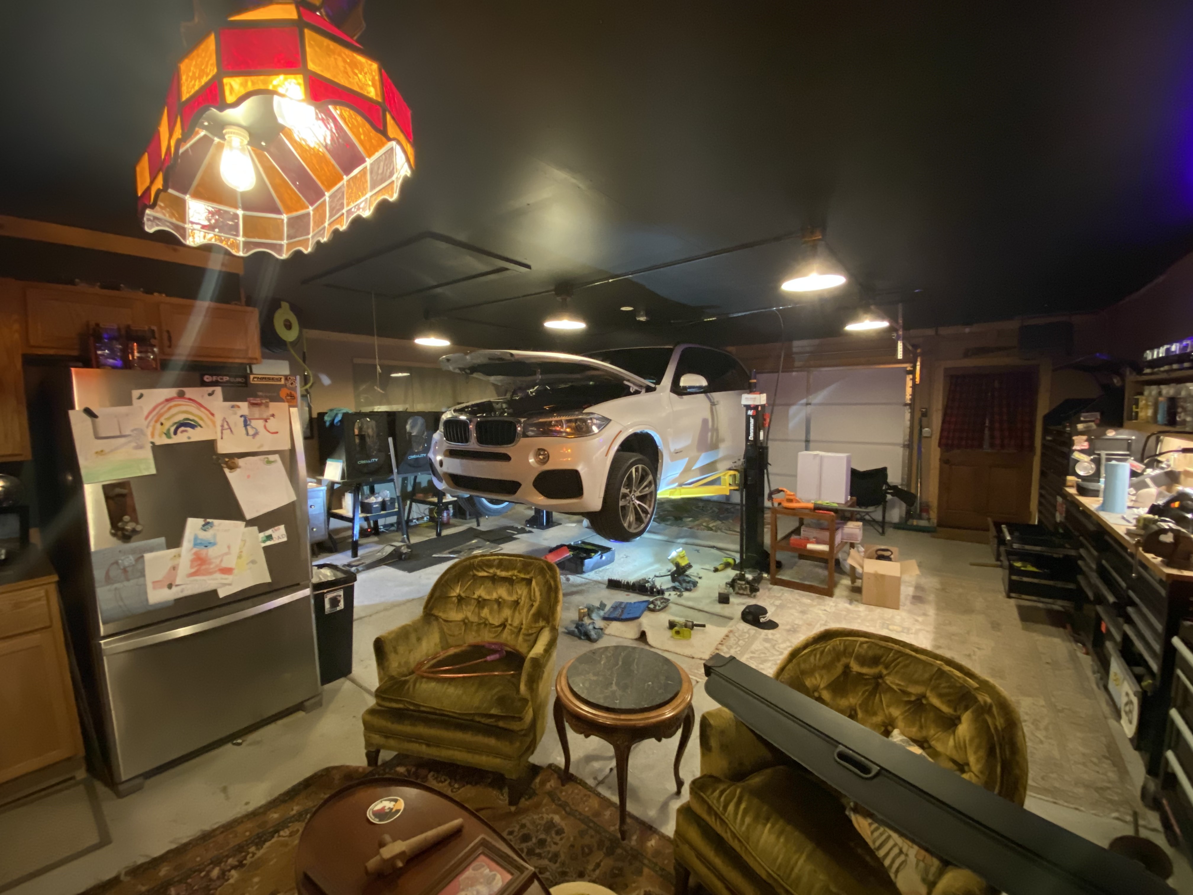

Getting familiar with this car. Transmission pan and fluid, transfer case fluid, front diff fluid, oil change, and eventually a tune up.
Also new tires.
So far found a cross threaded oil drain plug and JB welded fuel tank vent tube on the intake duct.
Once the fluids are done I’ll order a new intake duct, valve cover vent hose, and fuel tank vent tube and then will do all the filters, spark plugs, and coils.

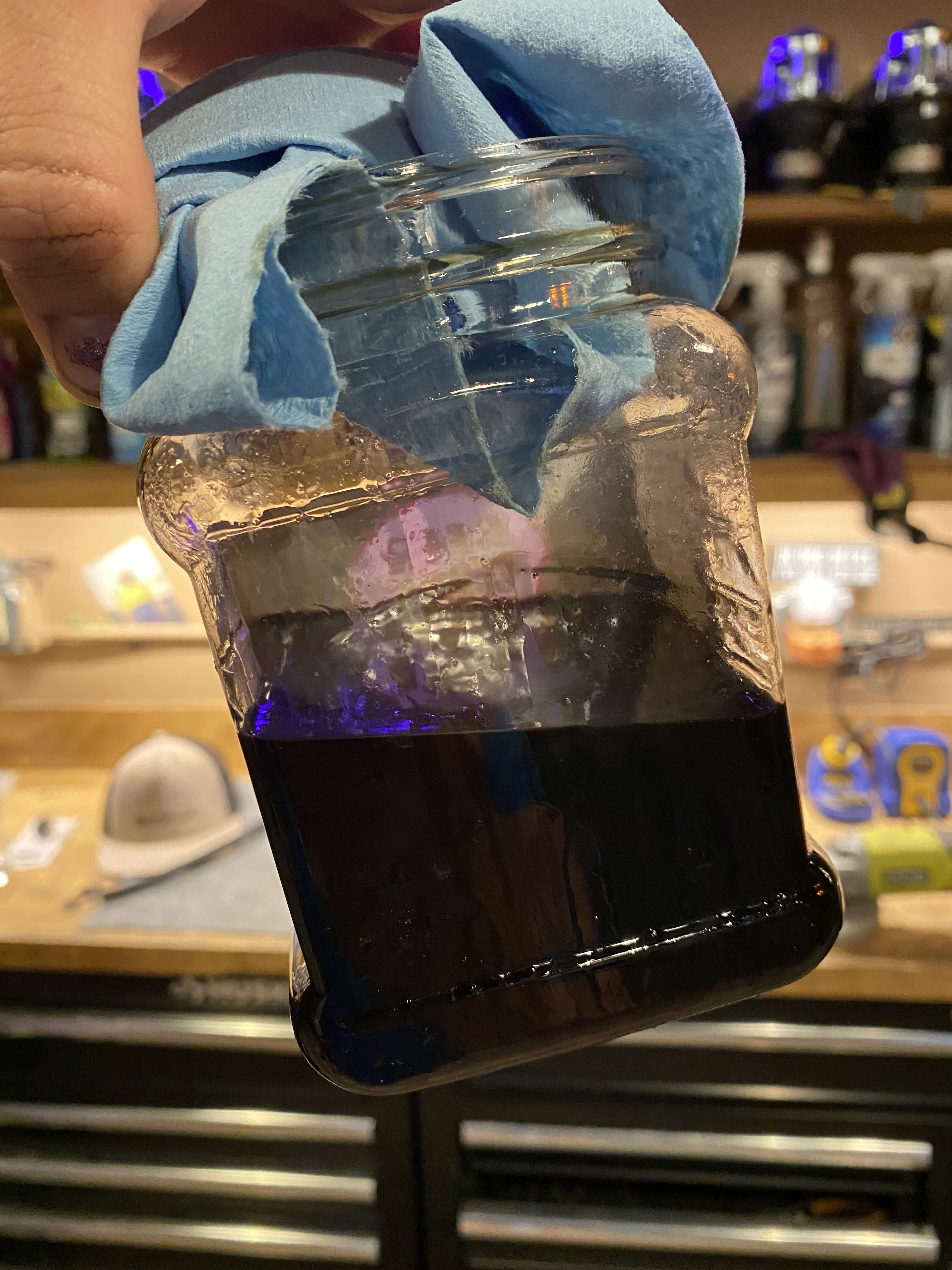

I've got the same list to do on my F15! So annoying the diffs / transfer case only have fill plugs so you have to suck the old fluid out with a vacuum pump. My X5 has 145k on it with original fluids, so I'm especially nervous how the fluids will look (trans especially).

Here was my transfer case fluid. Front diff fluid and transmission fluid didn’t look terrible, but they were pretty stinky.
Tue front diff has a drain plug. Not sure about the rear. And getting the fluid out of the TC with a pump was pretty easy. I got a longer and more flexible hose from the hardware store for my little fluid pump and that made getting everything out of the TC easier.

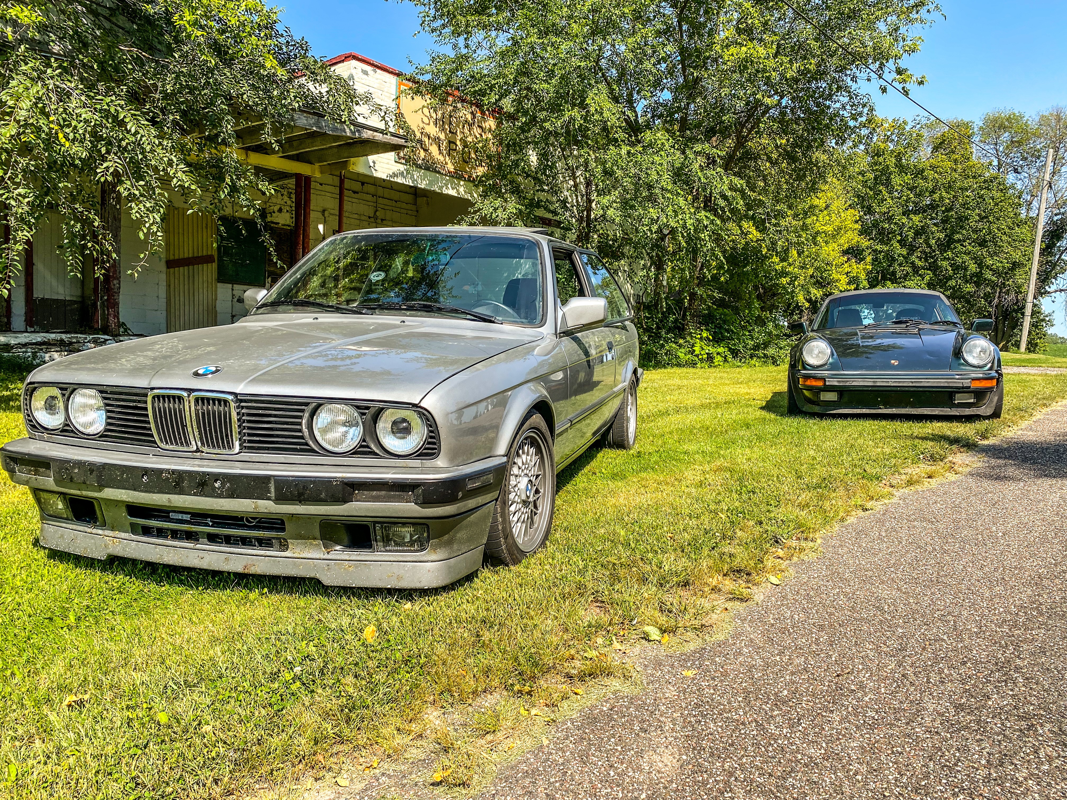

Visited a friend in Minneapolis this past weekend and one of the days we drove the course of the 2020 OC Rally down to Suncrest Gardens pizza farm through western WI. All in about 1k miles over the weekend. I’ve done about 3500 miles on the car this summer with really no issues.
