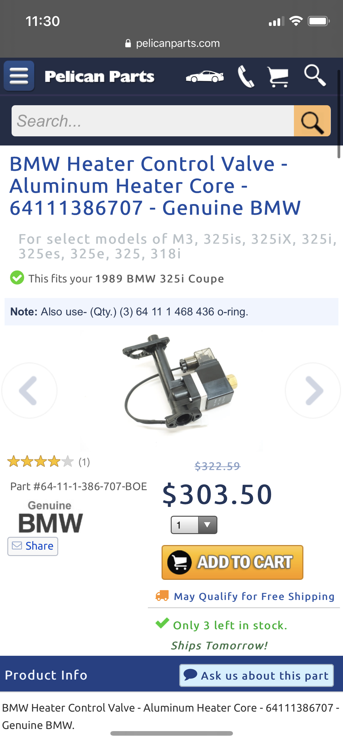

Is this a redesigned heater valve? It’s the right shape at the pipes but the valve itself is different.
Nevermind. Looks like it's a redesigned part. Apparently with lots of issues of them leaking but easily fixed.

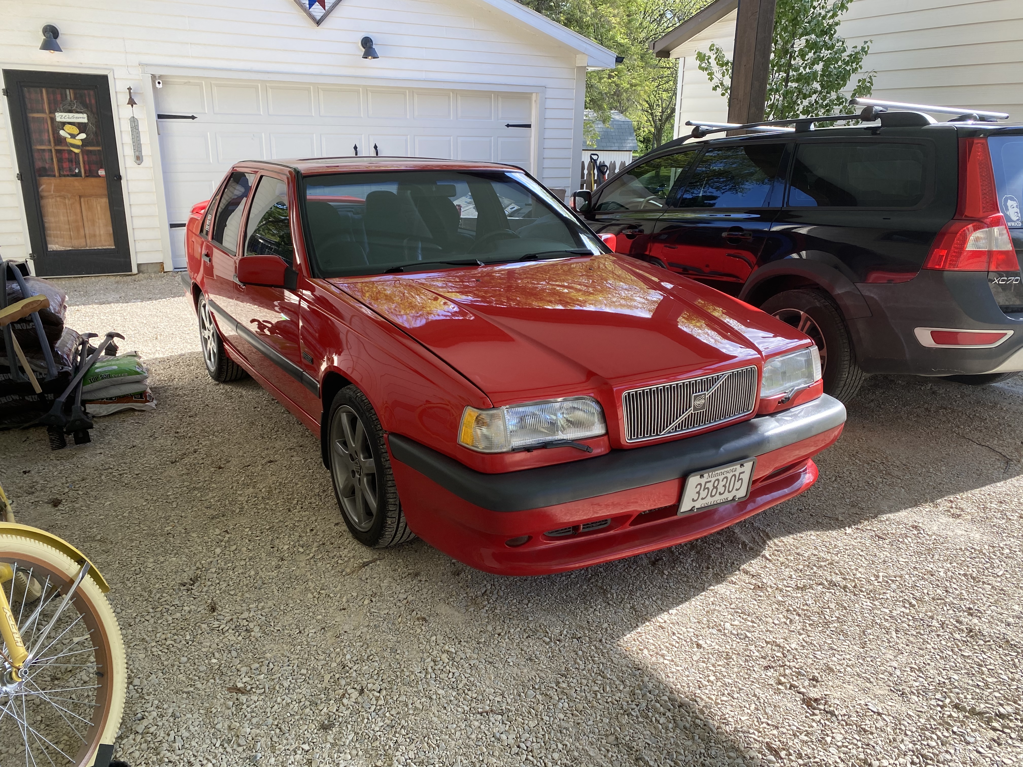

Update. But not to the e30. Since we got Katherine’s Atlas, we don’t use the wagon for anything other than me going to and from work. So, the wagon is going and I got something more fun for a daily.
Needs and exhaust and some other minor things, but, I’m very excited to have something more fun for a daily.
Love it, Volvos are rad.
That is awesome! I love the looks of these old bricks!
An 850 Turbo was my first car and what started everything for me. And at that time an 850R was the coolest thing in the world to me. So I’m very excited to have one for a daily.

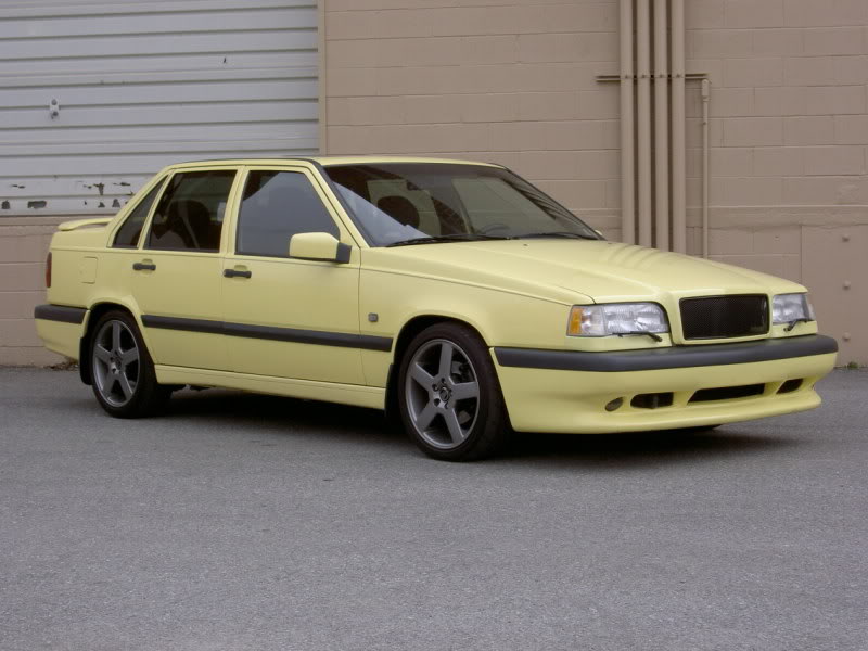

I dont normally like yellow cars but those 850 turbos in yellow with gray wheels definitely do the trick for me.
cool snag!
Those are special cars. But I couldn’t justify the prices people ask for them. It’s insane.

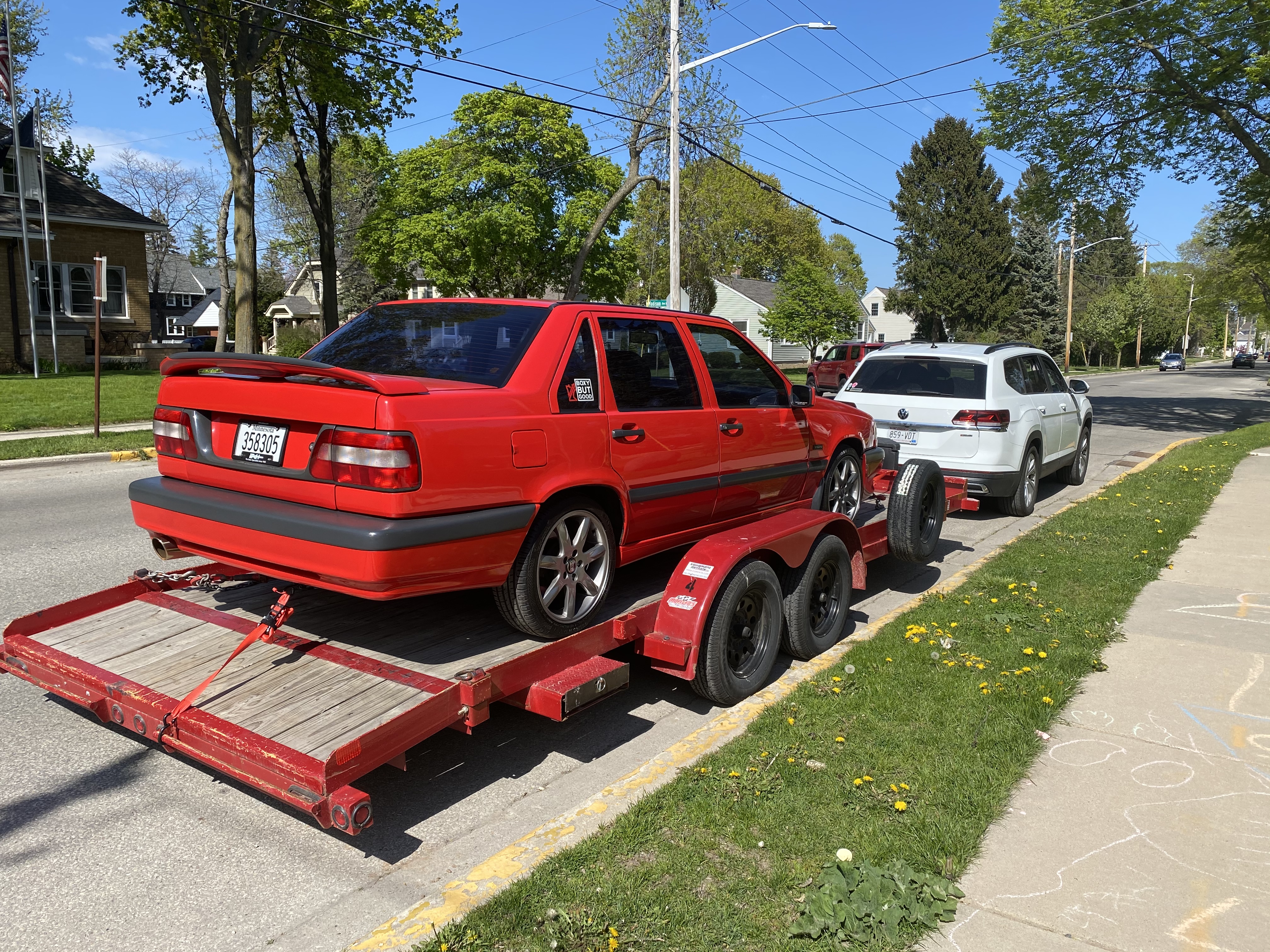

The 850R is up and the exhaust is out. I have a resonator and muffler coming this week so I can fix it. Some other little bits to take care of and then I’ll get it registered. The E30 is coming along as well.
