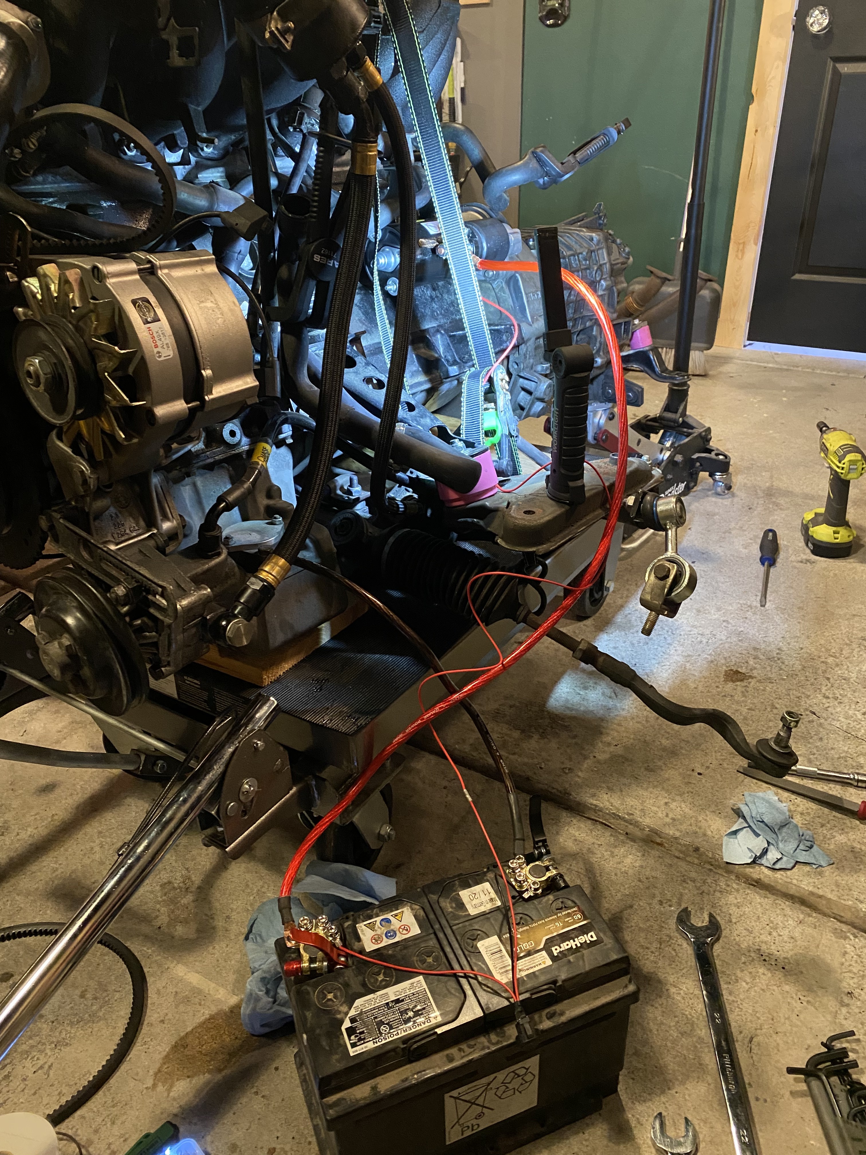

                  New rack is in and I don’t have any power steering. 😑
                  I used a Dex/Merc fluid instead of a DexVI because I read people used that with good results. Even if the fluid was subpar, I can’t imagine I would have zero PS.
                  Maybe the pump is dead. It ran on several occasions dry because I didn’t know it was empty. I also noticed when I started the car in the air to bleed the PS system, the pump didn’t wine at all. Usually it has a few wines as you go lock to lock and get the system filled up.

                    I think everyone is overthinking the fluid type.  I've used Redline power steering fluid for a long time in many BMWs and other cars with no issues.  It is a high end synthetic, but is also labeled only for power steering so maybe different additives?
                    The pump won't last long without fluid, they are a rotary vane pump.  I would recommend finding a ZF pump and rebuilding it before you install it.  I've done one and it isn't hard, then you won't have to deal with more leaks later.

                      I'm sure I'm very well overthinking it. Redline PS fluid was another I saw other people using. I replaced the Vickers setup with a ZF pump when I first go the car, so I will look for a replacement ZF pump and rebuild kit.
                      Oddly enough last night as I was about to pull the car in the garage for the night the PS started working again, decided to take it for another test drive just to see, and I made it half a block before it stopped working again. Since the steering rack is so mechanical in nature, I'm pretty confident the pump is dead.

                        The new pump seems to have fixed it. Will confirm after a test drive.

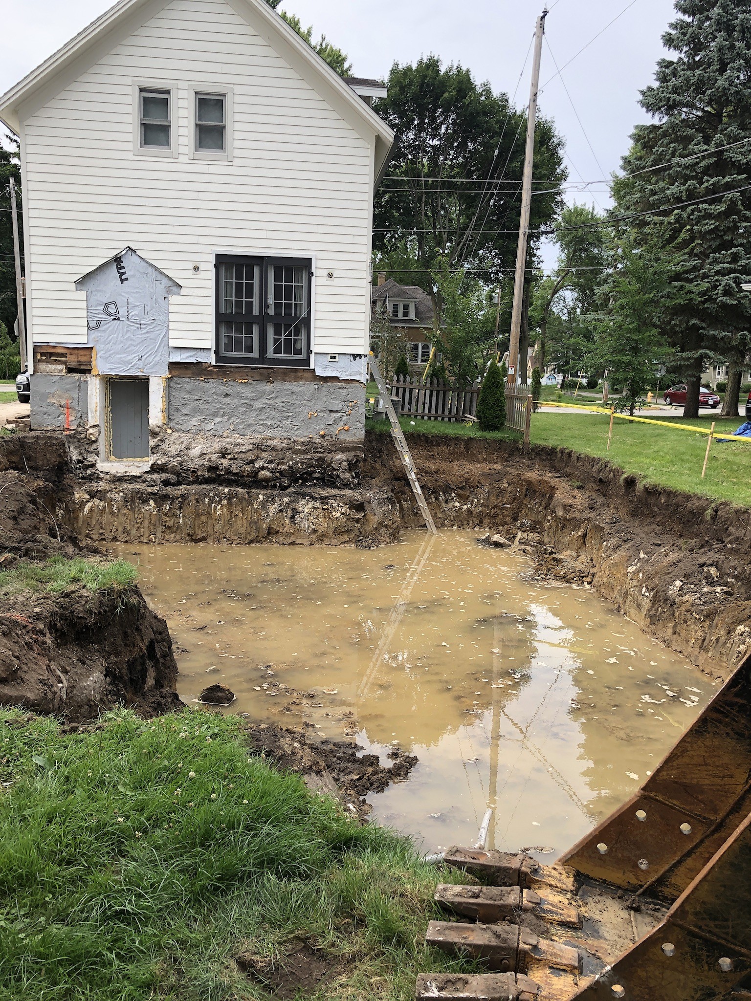

                        In other news, we started a pretty significant home renovation project this week. Going from a small 2 bed / 1.5 bath home to a 4 bed / 2.5 bath home. We bought the house knowing if we were to stay here we’d have to add on at some point. After buying some land from our neighbor to give us about 1/3 acre and being three blocks from downtown Cedarburg, we knew this is were we wanted to stay. So, here we go. Digging for the new basement started today.
                        Although bedrooms and bathrooms for all five of us (eventually six of us) is fantastic, my favorite perk is that the garage becomes my workshop. I’m already in the process of cleaning it up to make it my own space.

                          Leave it as is for lake front property
                            #933
                            Yeah. Apparently the water table is pretty high here. 😑

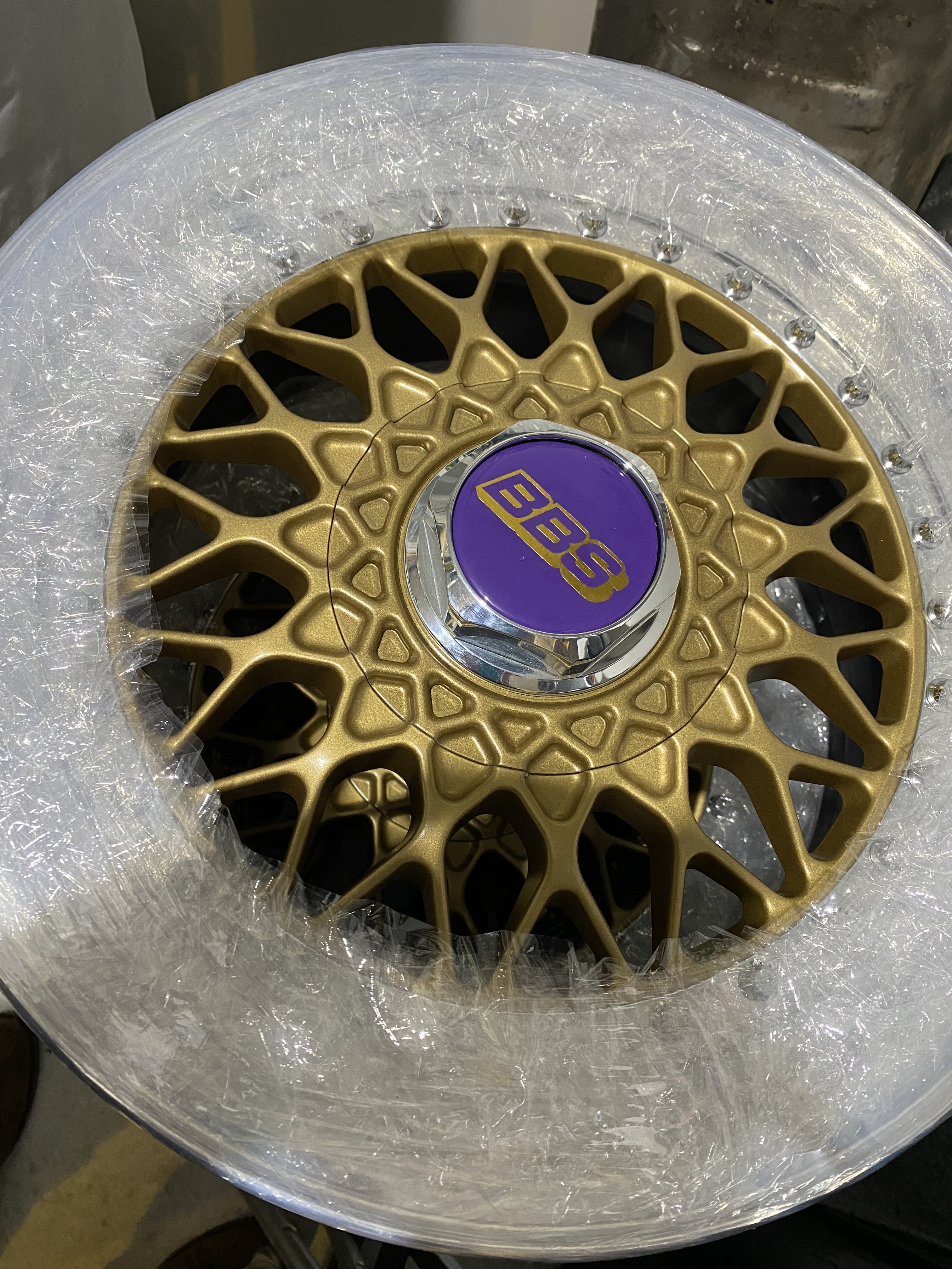

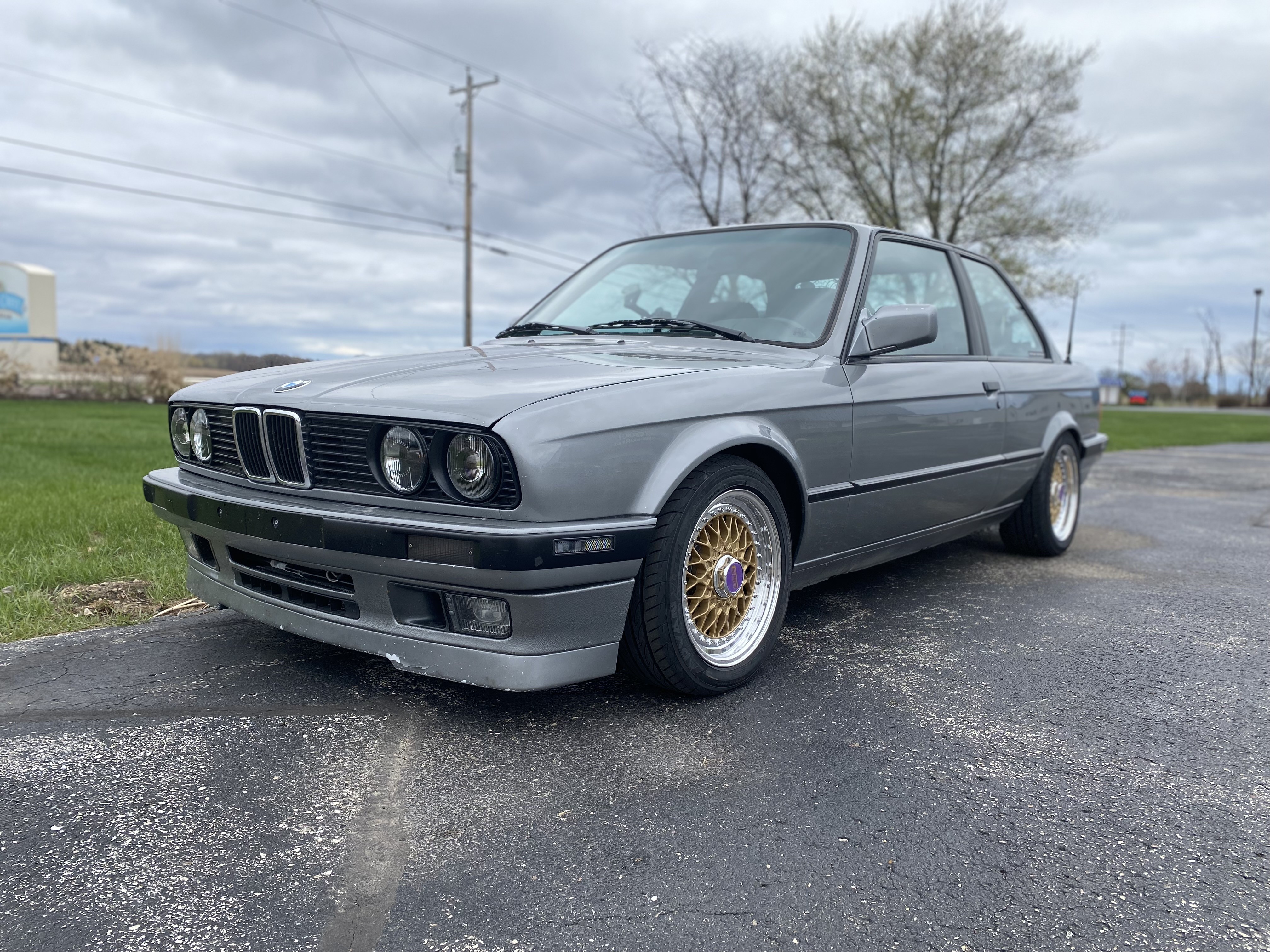

                                Some new wheels and tires for the wagon. I was getting that feeling of wanting another car and knew I had to do something to the wagon to keep it feeling different. I’ve owned it 1.5 years which is a pretty significant milestone for me.
                                Our basement foundation was back filled this week and they started framing today. And I’ve been driving the e30 to work quite a bit. The solid steering linkage definitely transmits extra vibrations into the steering wheel when I’m on the highway.
