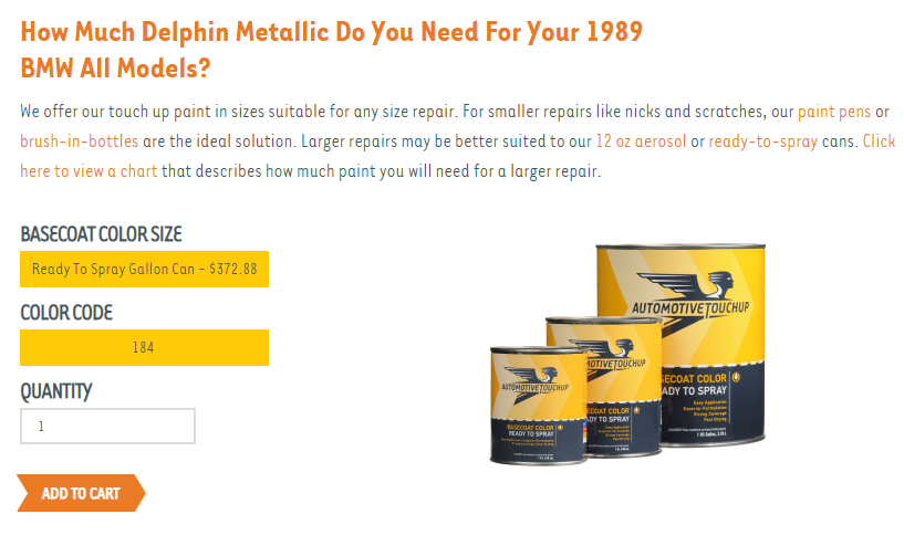

        Yes-ish. I'm painting it Meteor Gray Metallic from Eastwood. I felt it was their closest match to Delphin. To get the Delphin color matched paint from Automotive Touchup would have been about $400/gallon. For it being my first time I didn't want to learn how to paint a car with $400 paint.

          The paint from Eastwood is $122 for color and activator. Automotive Touchup is slightly more:
          I have one gallon of the Eastwood stuff, but will be ordering a second gallon to have just in case. So two gallons from Eastwood will still be $125 cheaper than one gallon of Delphin.
