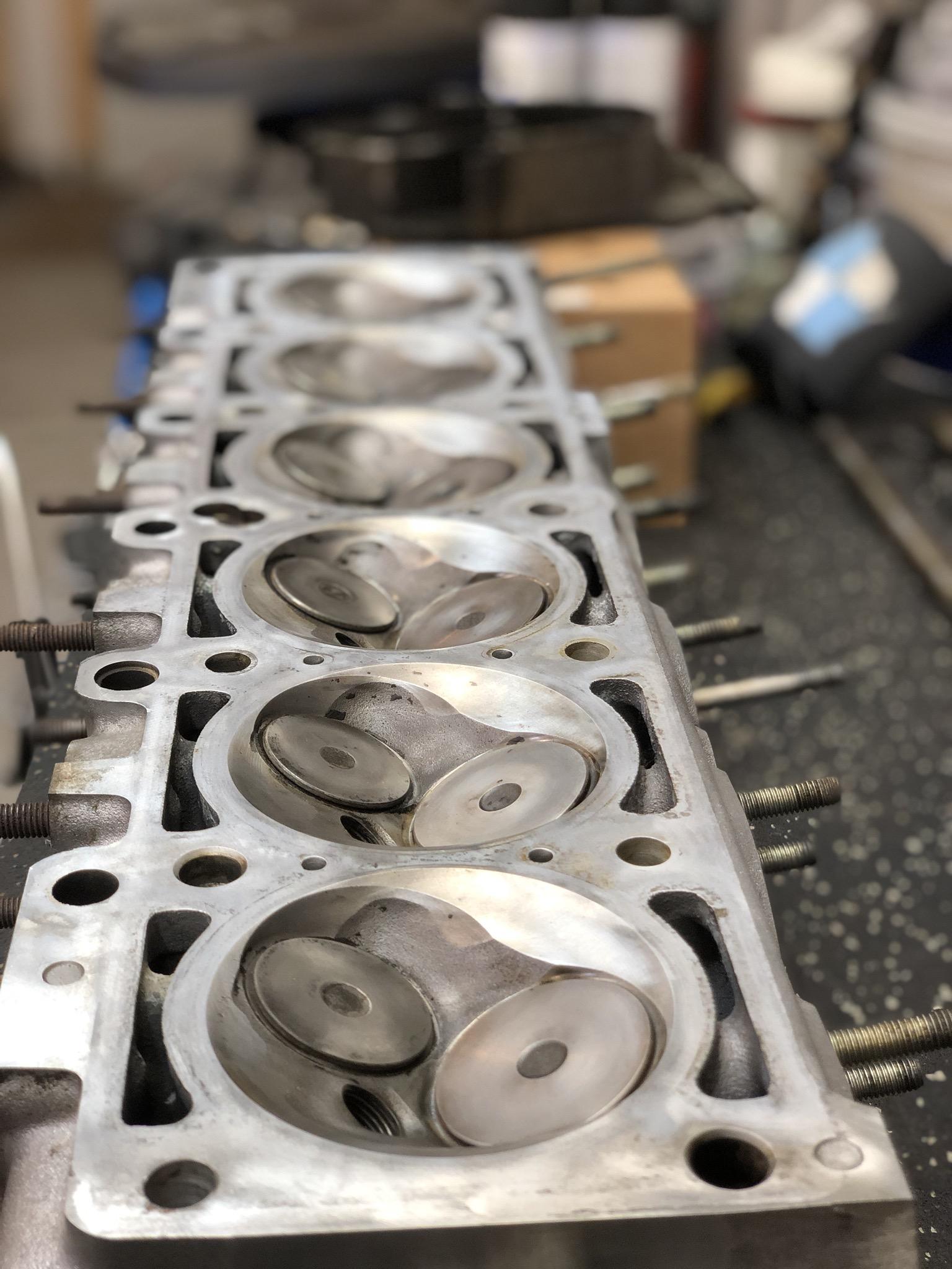

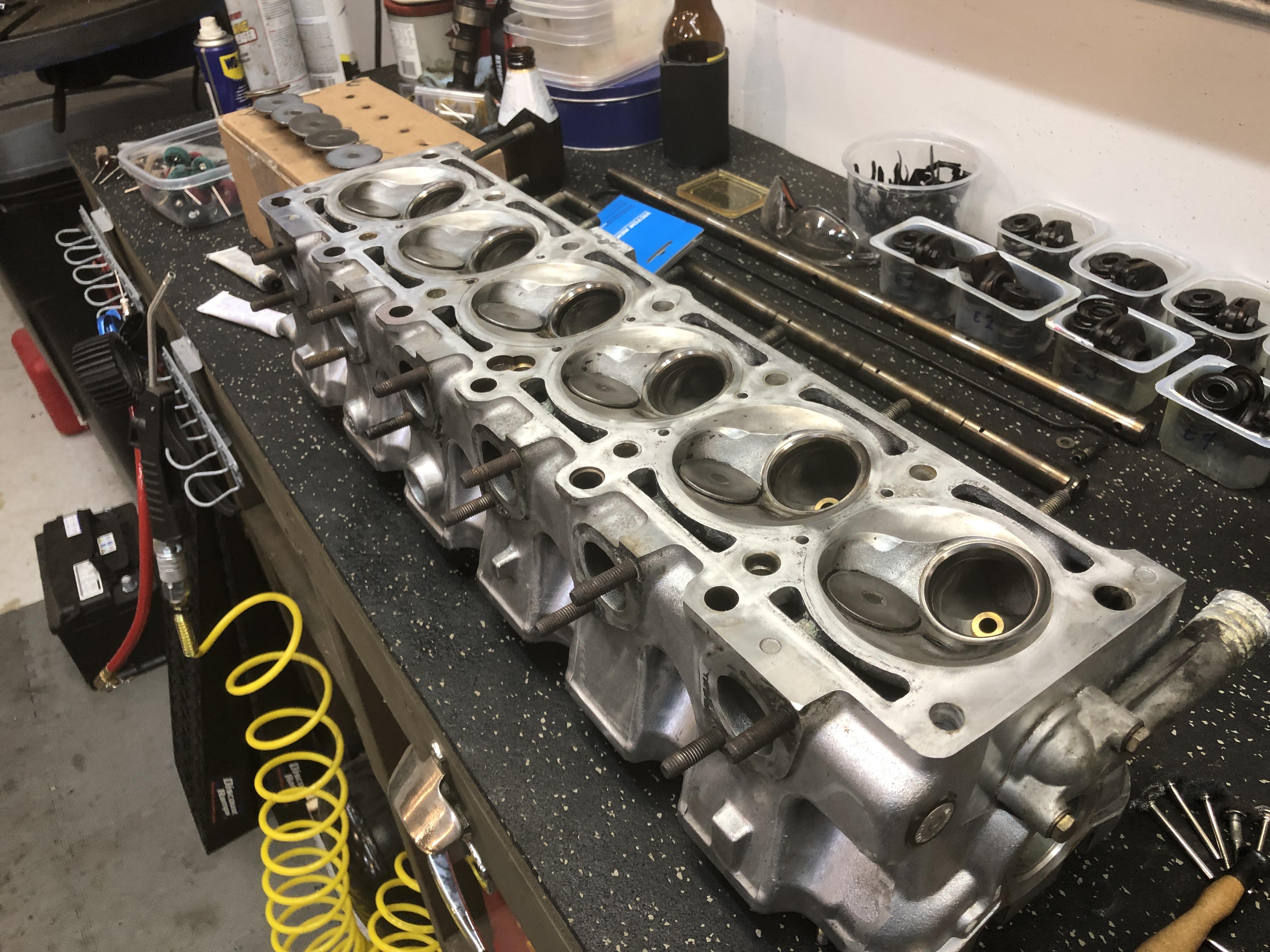

        Also started cleaning up the head from the next engine. I should have taken some before pics because it was very gross.

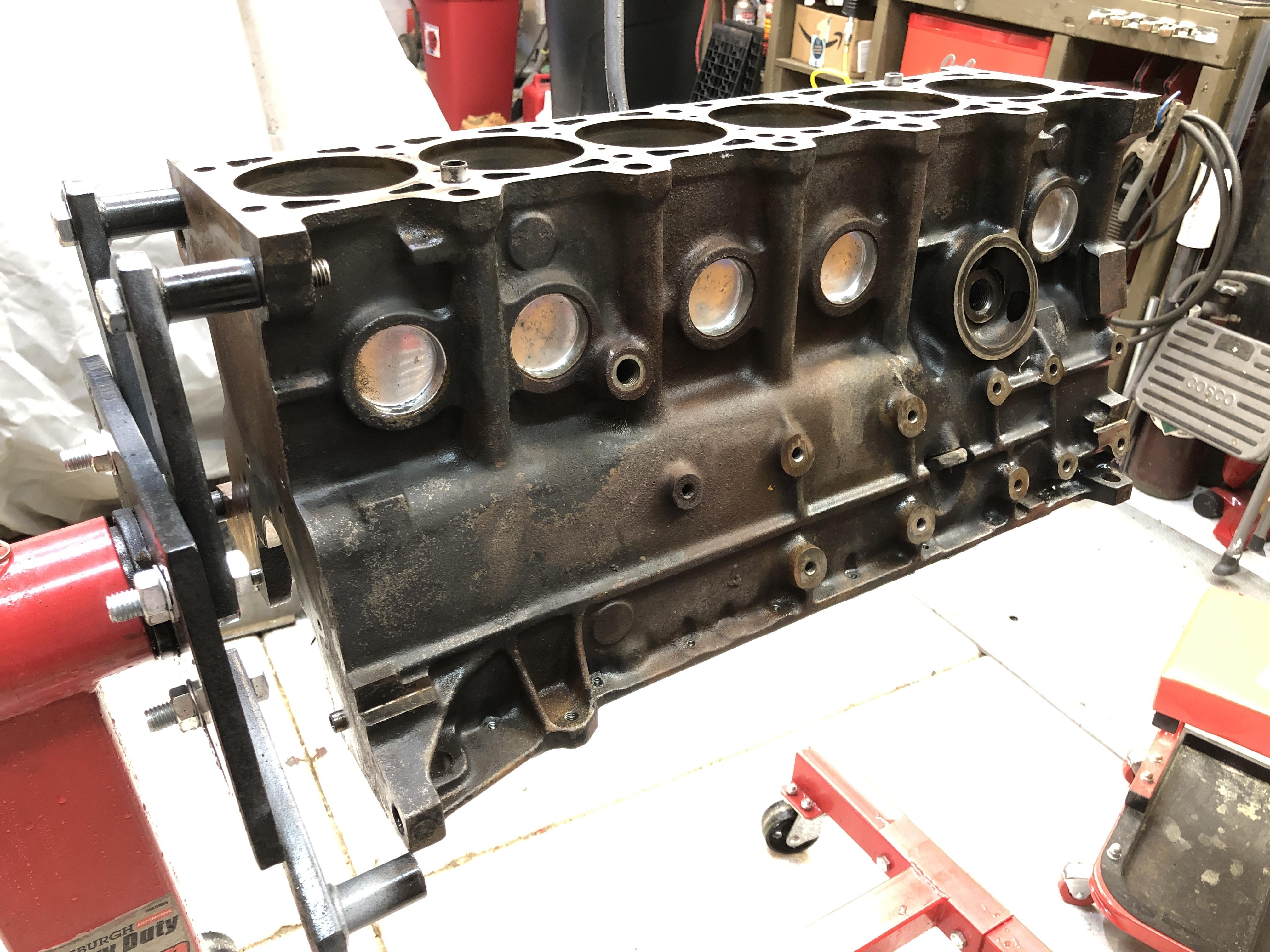

          I am probably going to take this block in to get honed, but in order to do so I need to remove these things. I believe one drives the oil pump and the other is the oil pressure sending unit. I know the gear for the oil pump can not just be remover and reinstalled, but can this little piece pop out? And how do I remove the oil pressure unit?
            #405
            That aluminum bit is an oil pressure relief valve. You can remove it, no problem, with a 22 or 24 mm wrench or whatever it is. Theres just a loose spring on the other side.
            the oil pump drive shaft can be removed via the recessed cap with the bmw logo on it. Make sure you do not forget to put that part in! Ive read a couple threads of people anxiously firing up the engine and quickly realizing they forgot a part. You should also use a drill and a 6/8mm socket on the other end of the shaft (the end under the bmw cap) to prime the oil pump and preoil the engine before startup

                I'm not removing that. I just need to know if it's okay to remove this rod without doing anything crazy to reinstall it.
                  #408
                  It should just pull out.  But it's been a while since I built an M20.
                  You can take the intermediate shaft out for cleaning and stuff just the bearings should stay in place.

                        Started assembling the head last night. Got a bunch of dremel buffing pads which made cleaning the valves and head pretty easy work. Dusty and dirty. But easy.

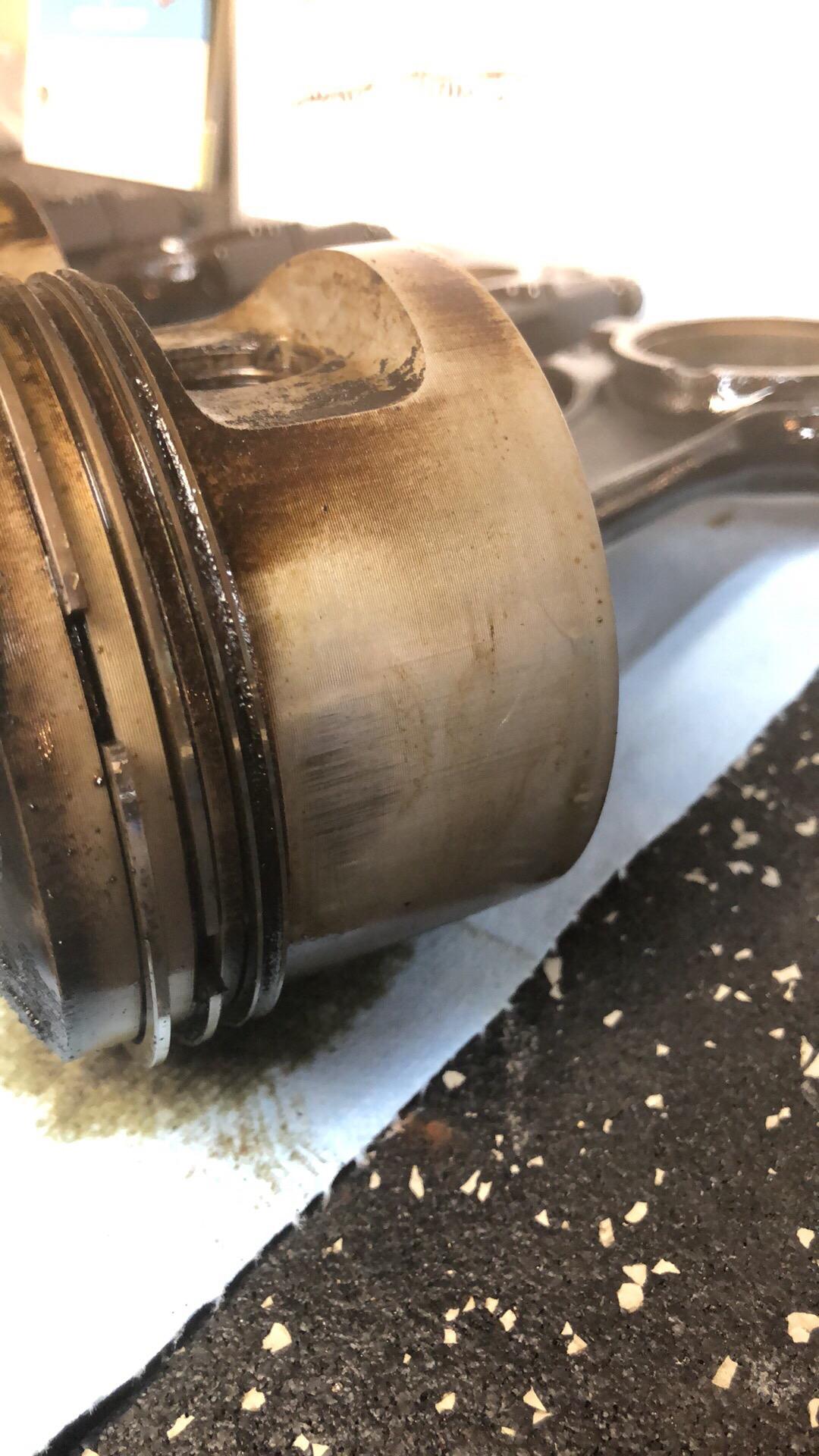

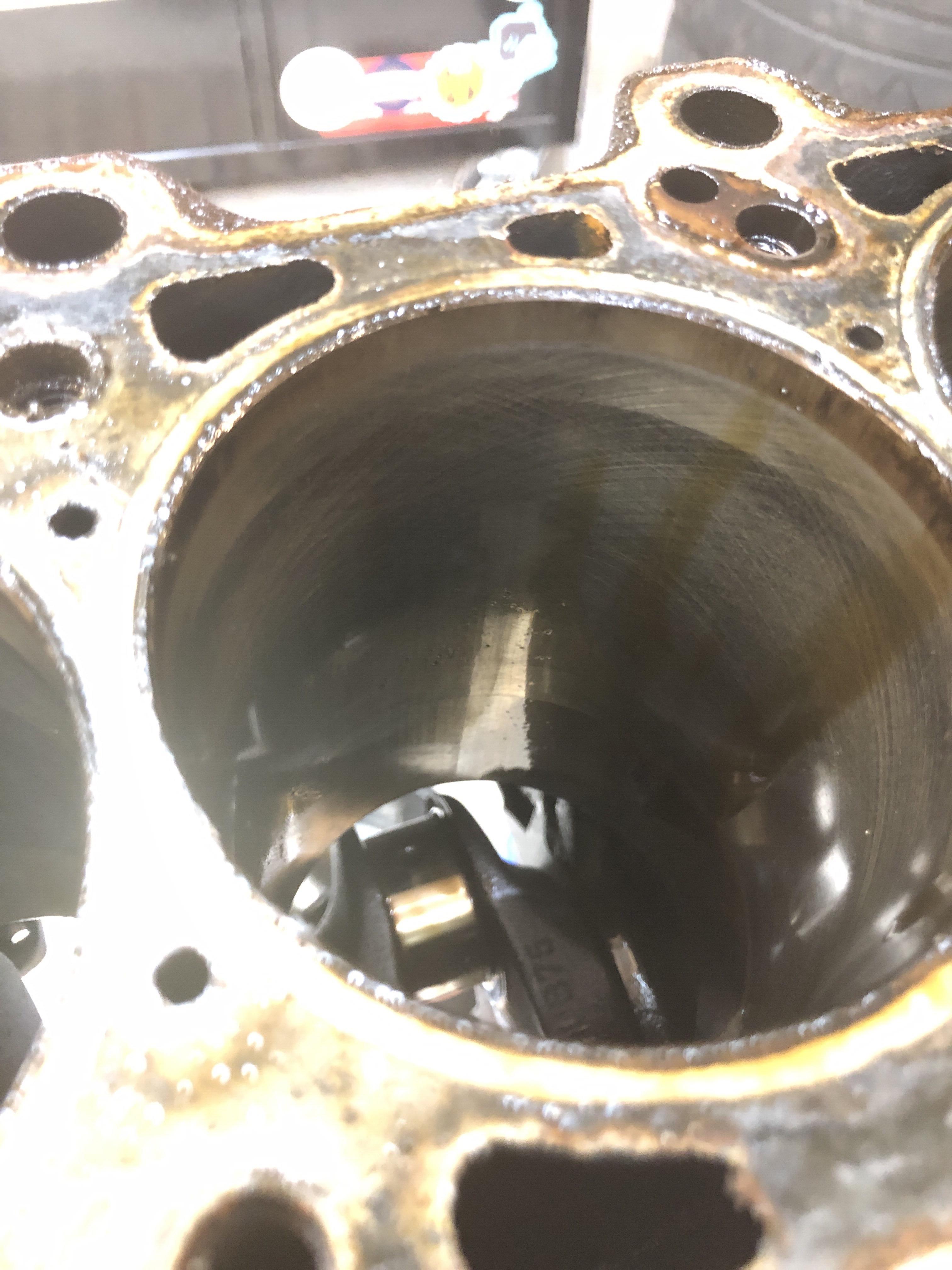

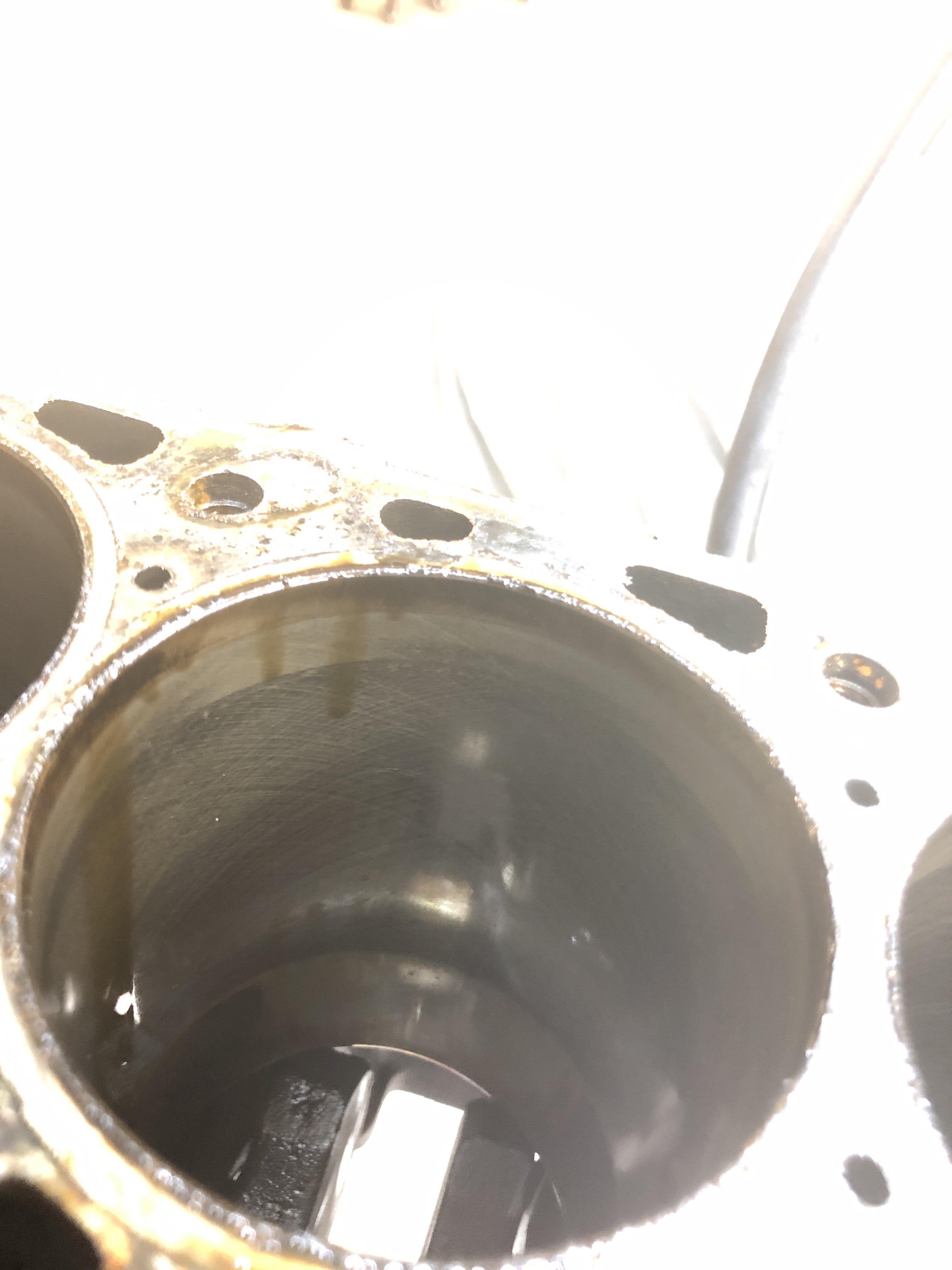

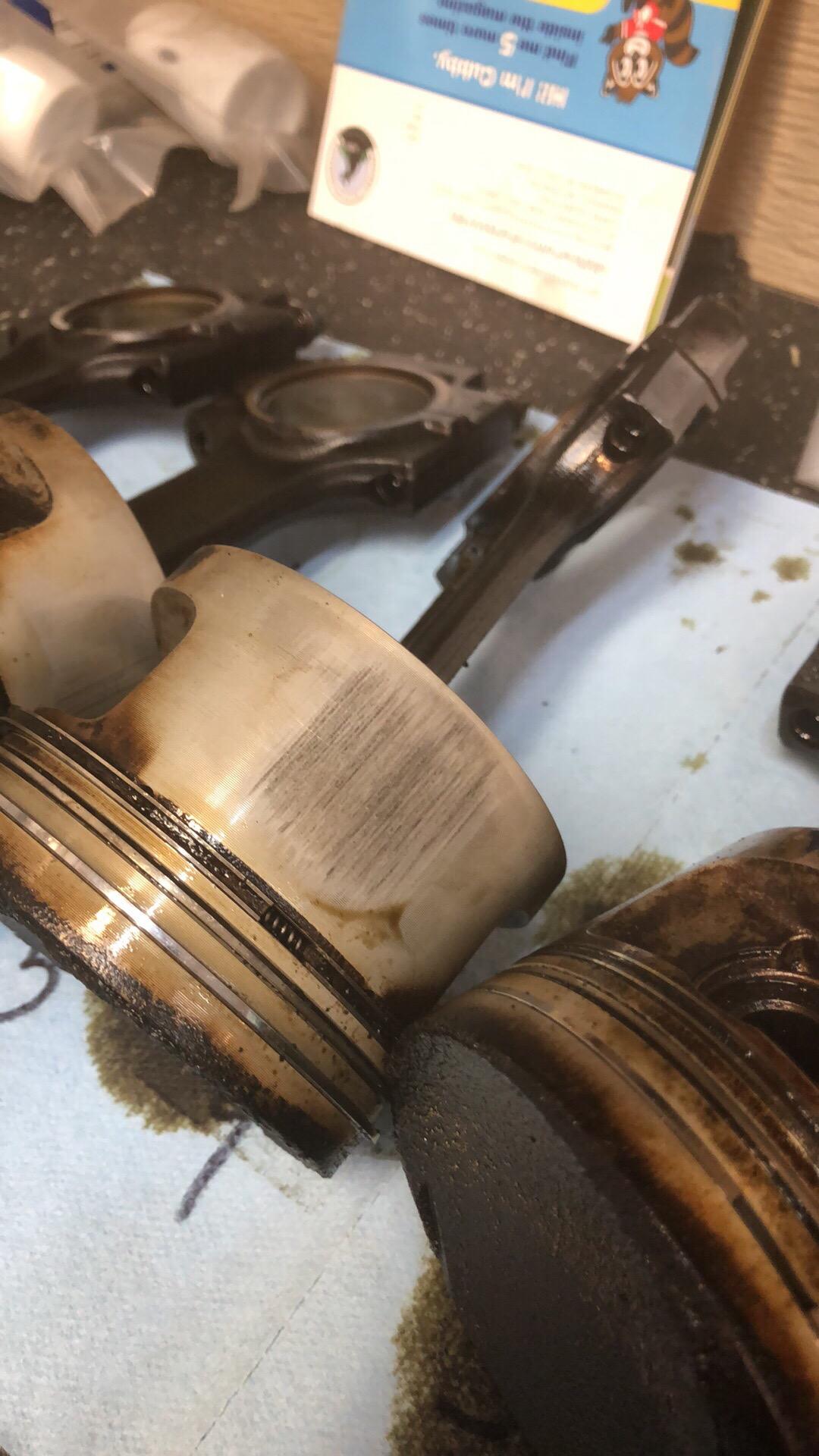

                          Looking for some insight here. Pulled the pistons out last night. My plan was have the block honed and then do new rings and bearings. There's some light scratches on the side skirts - you can't feel them. There's also no vertical scratches on the cylinder walls and the cross hatching is still very visible.
                          I've read to take an emery clutch or scotch Brite pad or something to clean up the pistons. Think I'm okay to move forward with my plan?
                            #413
                            The one side of the piston is a bit more scuffing that I have usually seen on an M20. When I asked the machinist/engine builder about it he said it is no concern/as long as the cylinder bores are clean.
                              #414
                              That's kind of what I've read too. The cylinders are all clean and there are no visible vertical scratches in them. The cylinder I took pictures of is the cylinder that 2nd piston came out of.
                                #415
                                Just polish them up and use new rings.  Check the ring gaps.  The cylinders look nice.  Any lip at the top where the rings don't touch?
                                  #416
                                  Zero lip on the cylinders. They're in really good shape, which is why I just wanted to hone, new rings and bearings and put it back together.
                                  I've never done a full rebuild on an engine before, so there's really no reason for this other than its something I've wanted to do. And the m20 is so affordable to rebuild.
                                    #417
                                    The cast iron used is very high quality.  The one I rebuilt that had unknown miles higher than 280k before the odometer quit working still had no lip at all and just needed a light honing and new rings.

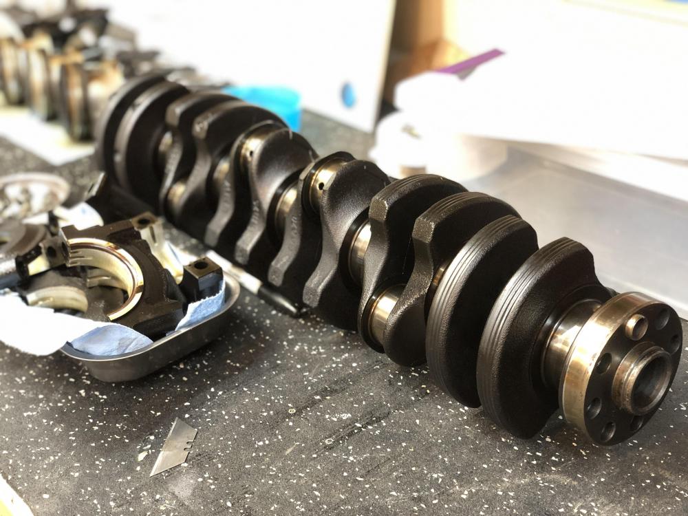

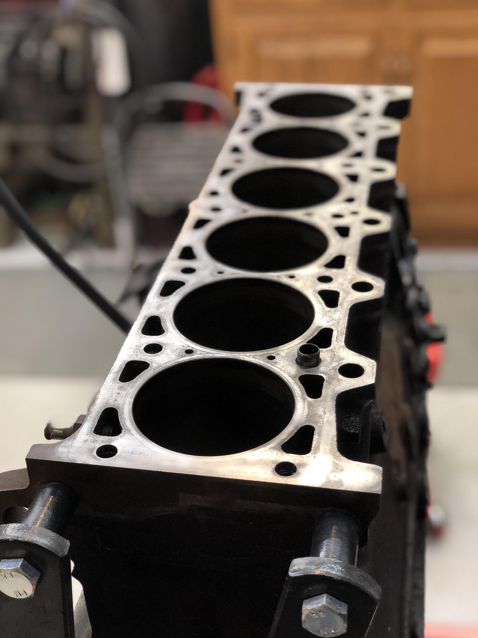

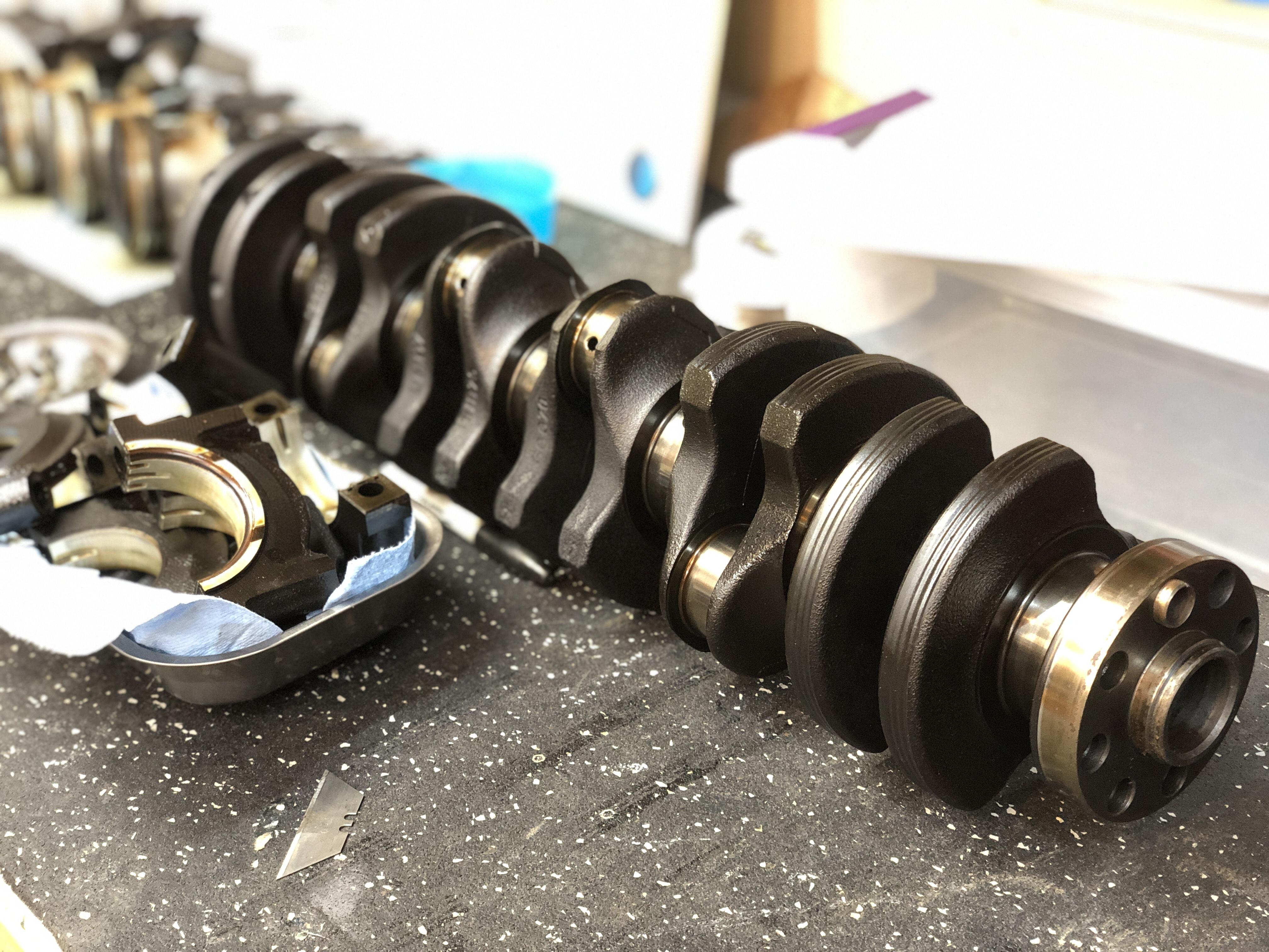

                                      Crank out. Block mating surface cleaned up. And valves are all lapped.
                                      Next I’ll pull the block out into the driveway and pressure wash and then drop it off to get honed. Finish assembling the head.
                                      I think I’d like to get this back together before December so it can go into the car between the end of year and next June. Some big life events that will make car time limited.

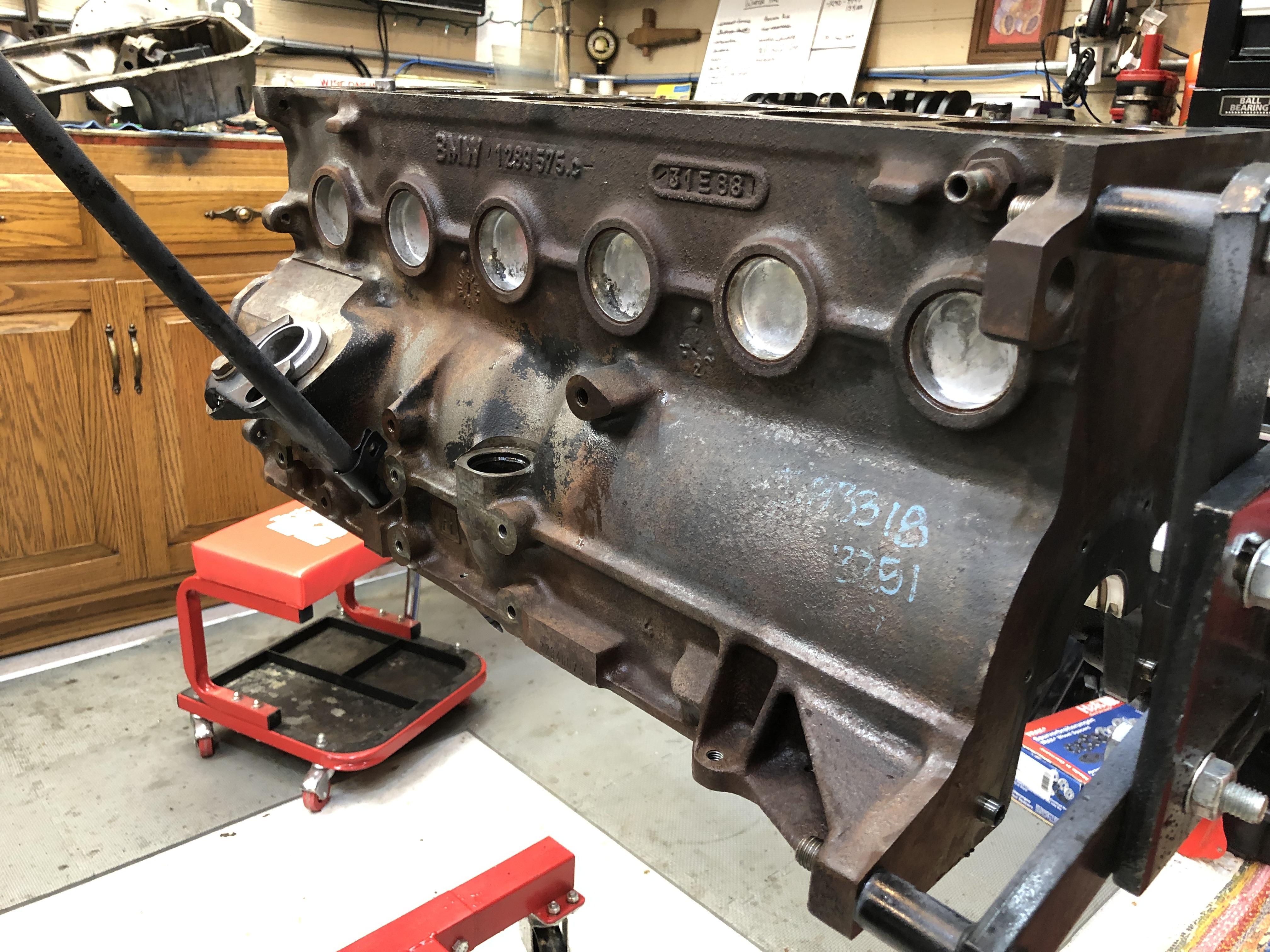

                                        #419

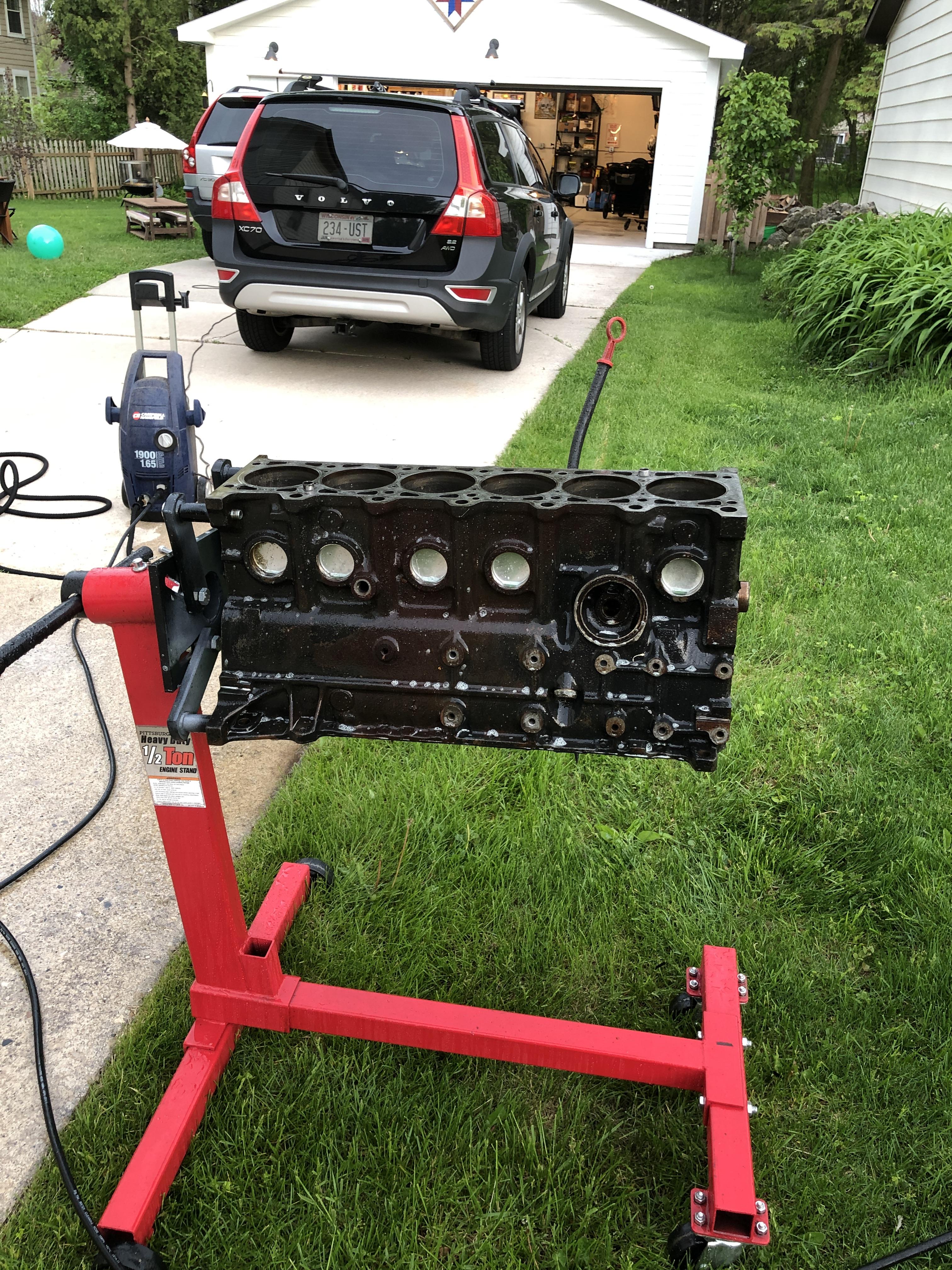

                                        Took a pressure washer to the block tonight.
