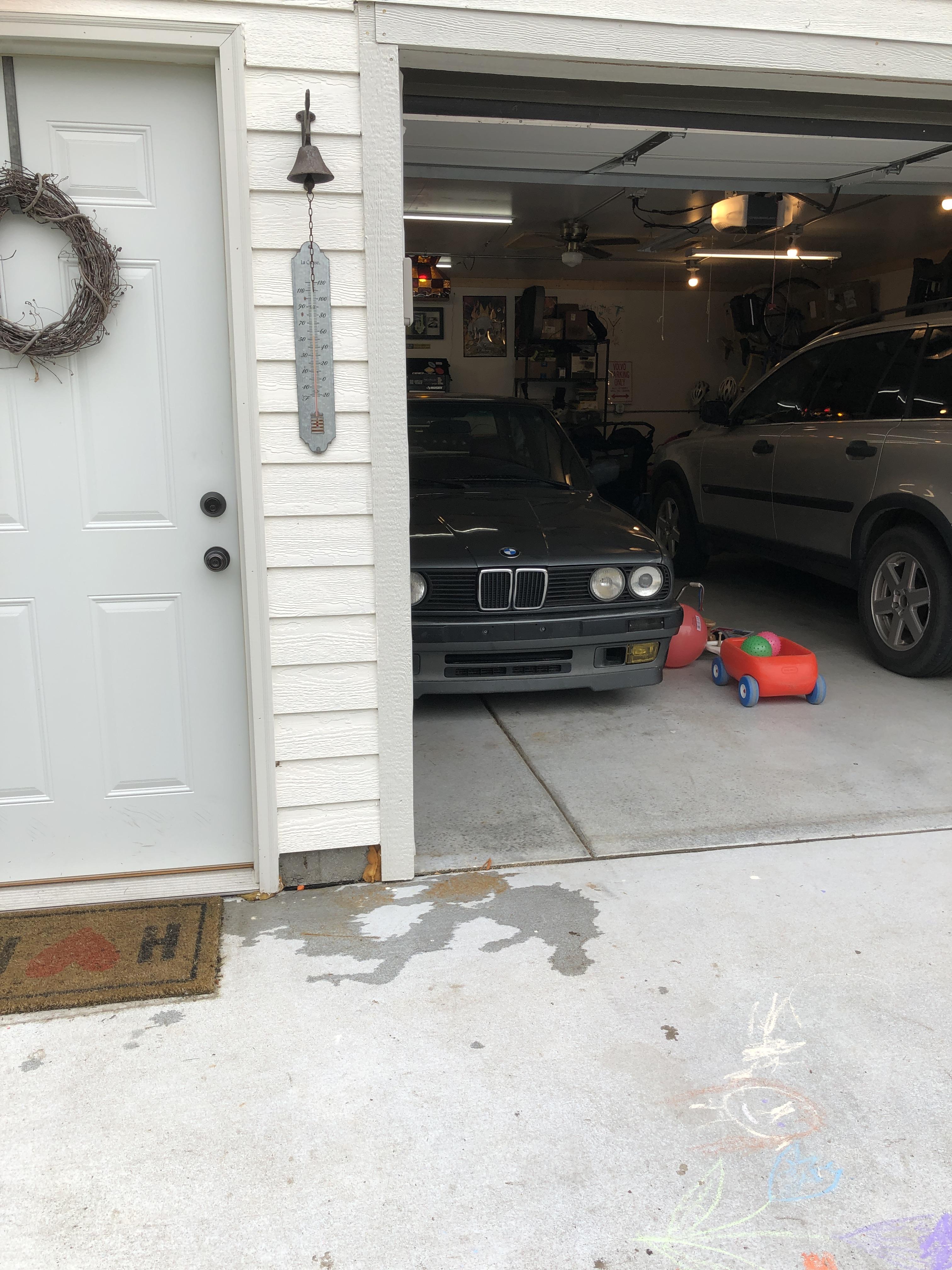

                                  Picture of it sitting in the garage. Did a short drive today and it was good. Minus the shift clunk.
