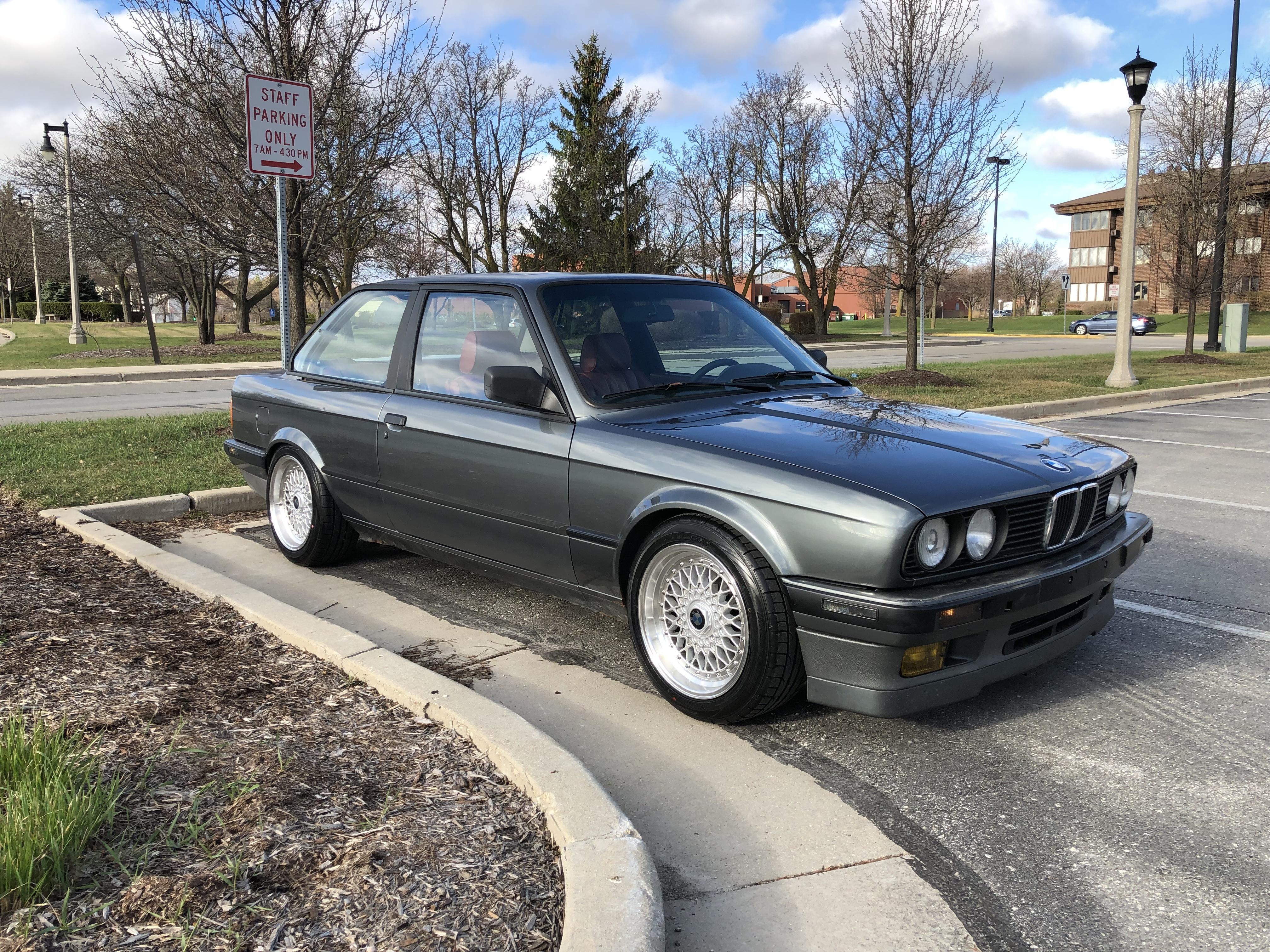

                              Taking it for a test spin this weekend when my wife is home and the kids aren't napping juuuuuust in case. But super excited. The wagon has some overdue maintenance, but in the meantime I had the windows tinted.
                              And did a little cleaning up.
                                #375
                                That M20 swap in that volvo looks mighty clean.
                                  #376
                                  LOVE a clean engine bay. Excellent work!
                                    #377
                                    Drove it to work with no issue! With the trunk hole patched and the HD rubber bushings in place of the solid bushings it was a very enjoyable drive. Once I got to work the flywheel chatter with the lightweight flywheel is definitely noticeable when your outside the car. Goes away when the clutch pedal is pressed.
                                      #378
                                      the car looks amazing, i'm jealous you've got it on the road!
                                        #379
                                        Thank you! It's on the road, but I didn't really do that much to it compared to most projects here.
                                          #380
                                          Looks fantastic!! Are you planning to bring it to the E30 picnic in June?
