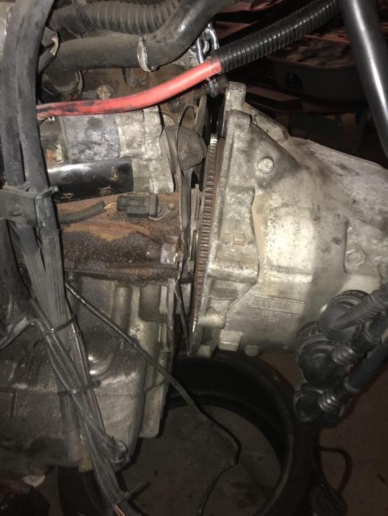

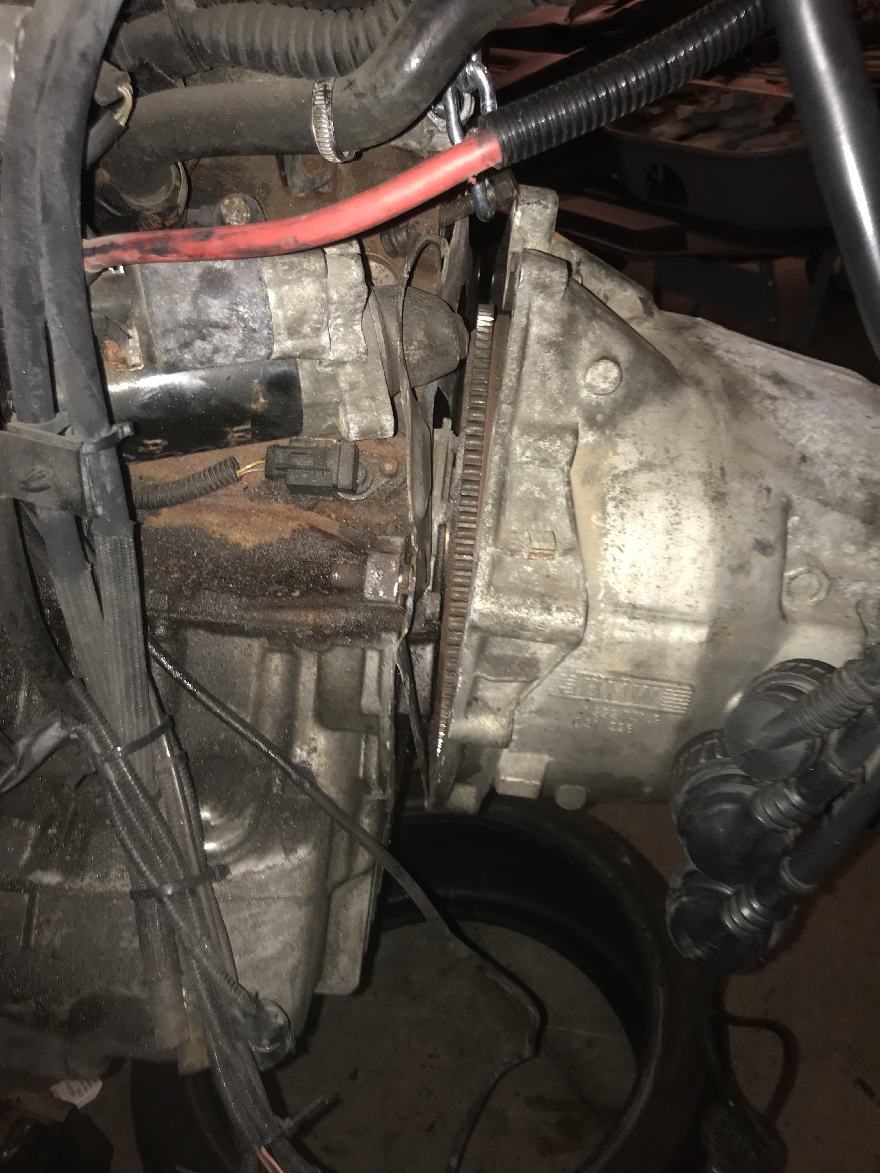

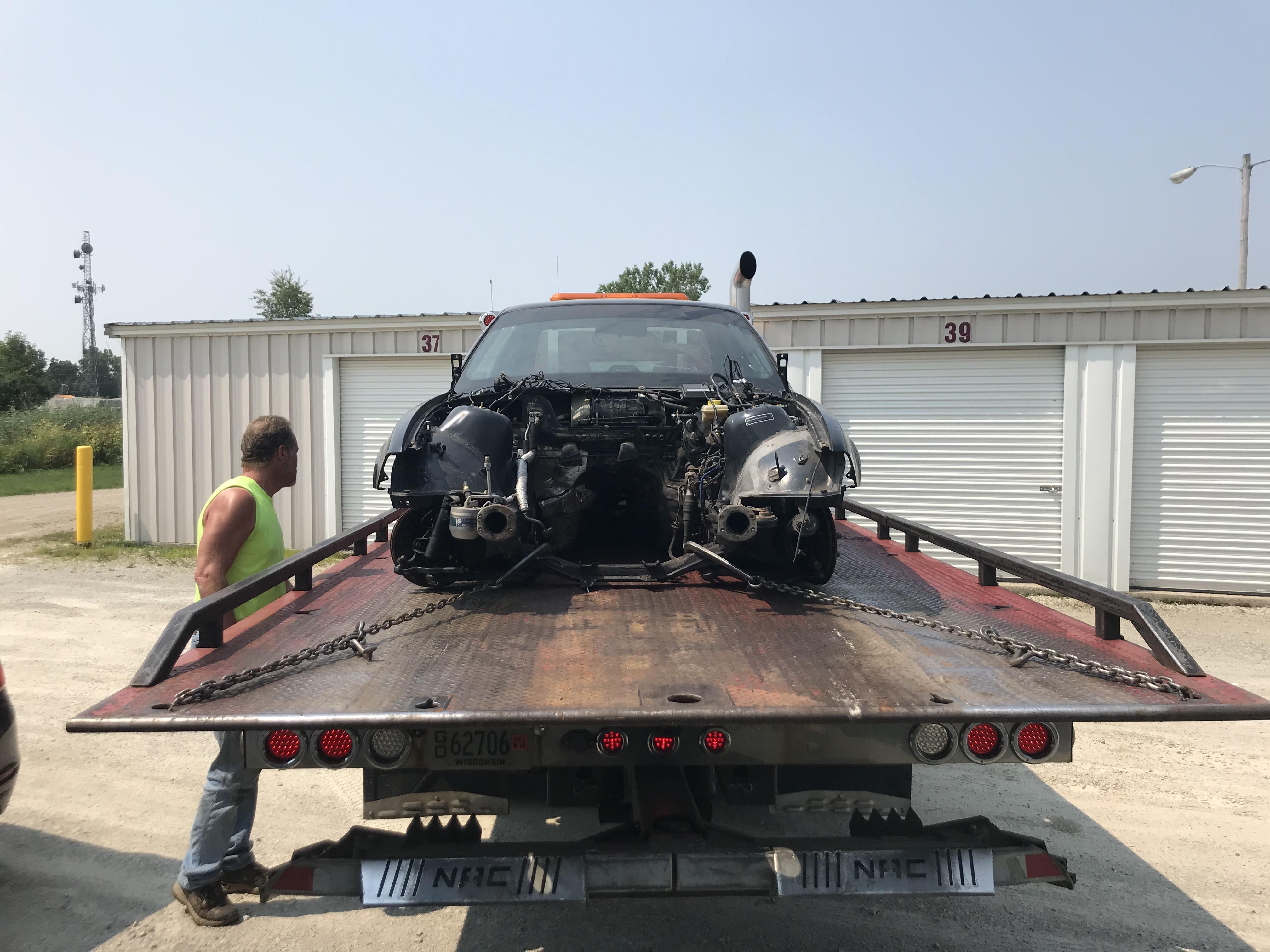

          Car was pulled from the storage unit. This dude pulled this thing out in a very unlikely circumstance.
          Got the motor home and have been in the process of trying to remove the trans. I’ve got it so it separates by an inch, but will not come off. I don’t know if I just need to pull on it harder or what. Is there a truck I’m not doing or am I supposed to just yank on it harder?
            #165
            It was the one tiny bolt holding the metal gasket....

                As I had posted earlier, the M3 shell was removed from the storage unit allowing me to get the motor home. I'm still in awe at how easy that guy pulled the shell out without scratching the floor and given the tight space. Brought the motor home that night and got to work right away. Trans had that broken off bolt that put up a fight, but after getting enough clearance I just cut it off with the grinder. Struggled for the remainder of the night to get the trans off, called it quits. Watched a video about a trans removal and heard that tiny bolt holding that gasket has to removed. Sure enough came our right away.

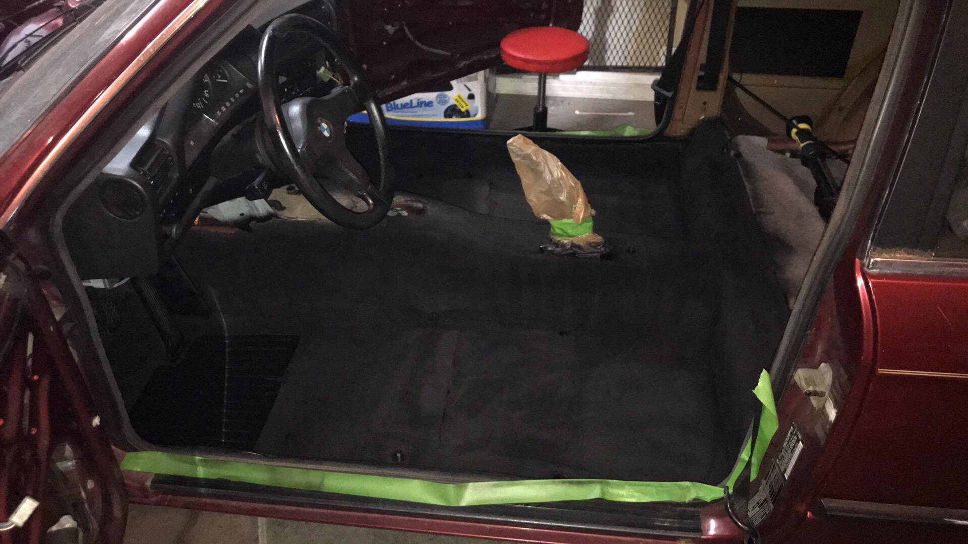

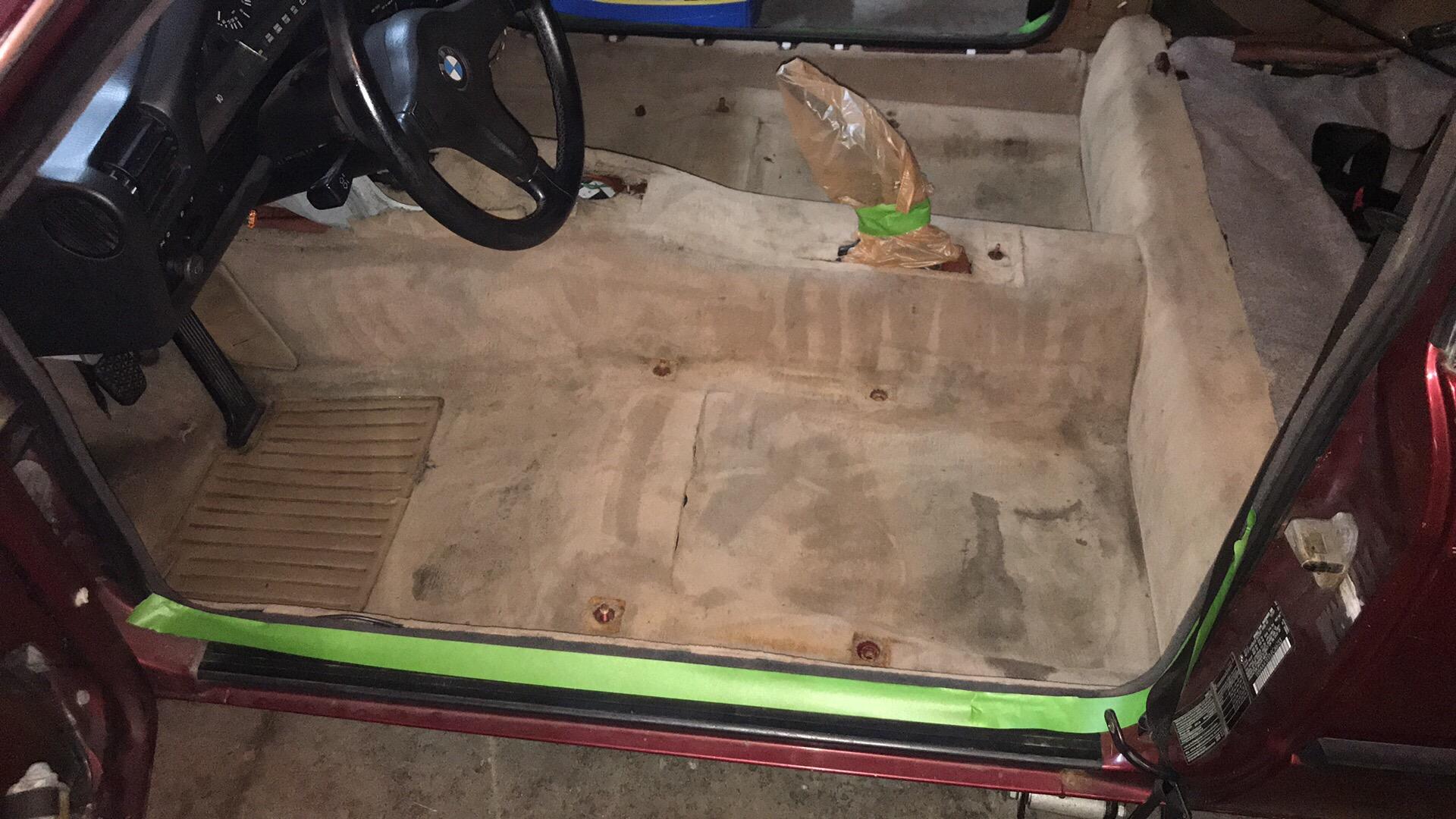

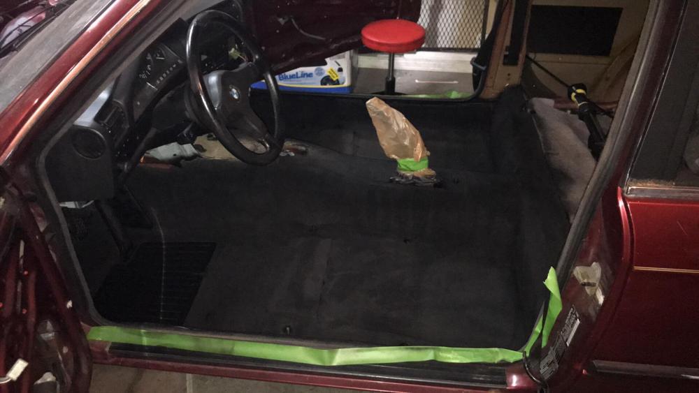

                              Got the carpets dyed last night. Think it came out pretty good. Honestly, anything was better than the current carpet situation.

                                Aww damn I would have traded you for my oem black carpet
                                  #176
                                  Well shit.
                                  Carpet was pretty stained and beat up in some spots. I think after further inspection you might have changed your mind. I'll still trade if you want 😂

                                          Also did you spray the carpet black too?
