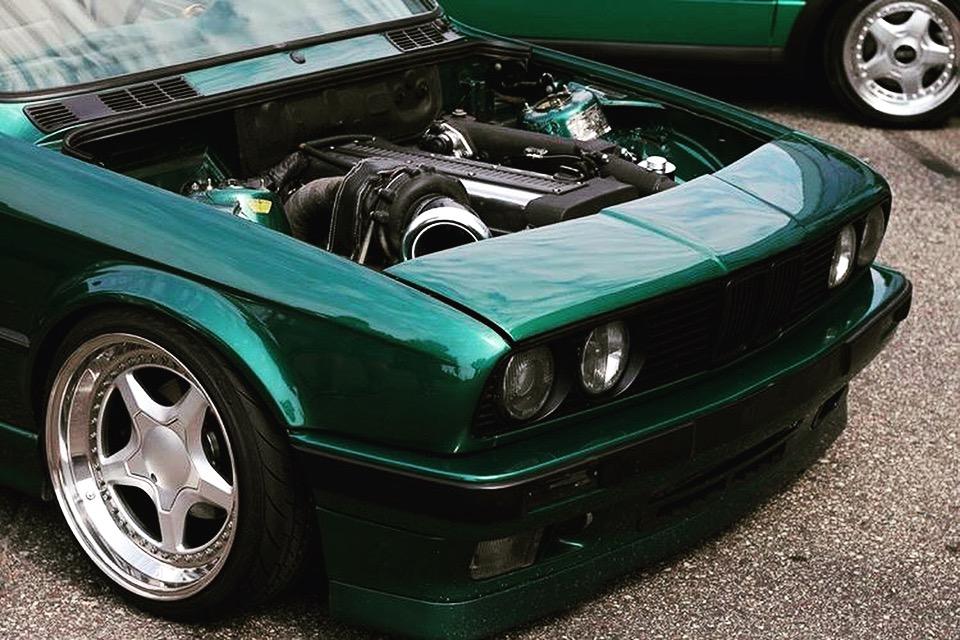

            Any alignment tips for the hood? One side it lines up okay with the fender, other side has a bigger gap. Gonna be doing some tinkering with it.

              Might be the fenders, I think they have a little wiggle room when reinstalling so if they’ve ever been off that could be your problem.
                #307
                Feel like it must be as there’s really no way to horizontally move the hood

                    you should be able to move the hood horizontally using the 4 points of attachment. look at the hinge brackets where they attach near the headlights. loosen the 3 bolts on the hood side on both and there will be plenty of wiggle. same goes for the other end - at the roller closers, you can loosen the 2 bolts on each side and wiggle them around a slight amount in each direction.  getting it all lined up may take several tries.  measure the gaps on both sides and find the difference. divide by 2. make alignment marks, then move the calculated amount. make alignment marks for both horizontal and front to back because it will slip when you loosen it all.
                    and, depending on prior accidents/fender alignment, you may run out of adjustment before its perfect. but honestly, your current alignment is as good as 90% of e30s out there, and no one will notice but you.
                      #310
                      Unfortunate this chassis was in a wreck, it's pretty clean otherwise. Hopefully I can even it out a little bit.
                        #311
                        I just loosen one bracket at a time and push it where I want it and snug it back down. Or you can just cut your hood in half when that doesnt work. 😒

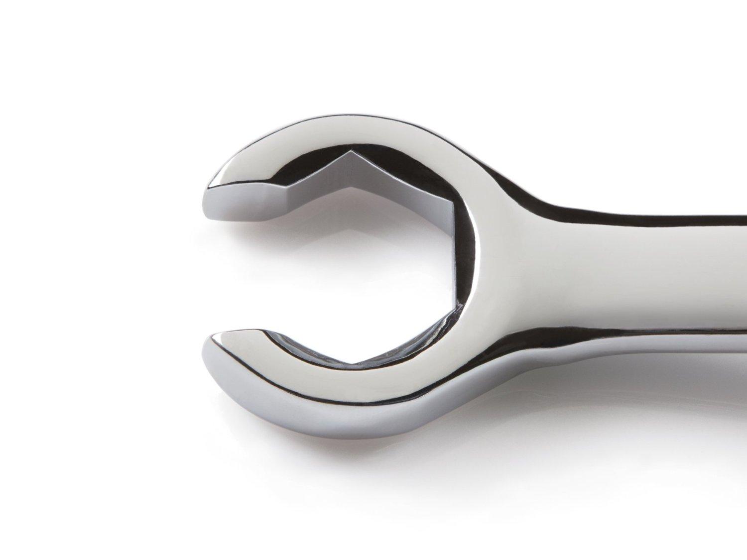

                          Planning to do the hard fuel lines this weekend. Any tips for doing this job? Shouldn't be to difficult as its just undoing soft lines on either end of the hard lines.
                          But I am told that the mounting bracket bolts/screws are rusted to shit, so that might make it difficult.
                            #313
                            Line wrenches. 11 and 13mm I believe...
                              #314
                              You're thinking brake lines.
                              The screws under the chassis are phillips head, and usually rusted in place. You can bust the head off the screw to get the retaining plate out. You may also be able to bend it far enough to remove the lines, then bend it back up when the new lines are in (not sure on that one).
                              The hose clamps are likely rusted, but use a 6mm socket to attempt to pull them off without cutting them.
                              You can also cheat and cut the soft fuel line and not have to take it off the hard-line that you are replacing anyway.
                              Hoses always pull off well once you rotate them, so spin the hose before trying to pull. A pliers is usually required to get them to rotate first, or just slice the hose parallel to the center axis of the hard-line and it'll slip right off.

                                I just placed an order for all new mounting hardware for the fuel lines from the dealer that I'll be picking up tomorrow.
                                Will cutting the soft fuel lines leave enough material to properly hook up the new hard lines?
                                  #316
                                  The hardware screws into studs that are welded into the chassis, so unless you manage to get the screw remnants out you won't be able to get the new stuff in.
                                  Replace the soft lines if you're replacing the hard lines. Parts store hoses work just fine.
                                  Make sure to get high pressure hose for the feed side (~$8/ft) vs the low pressure stuff at a buck or two a foot.
                                  At minimum replace the hoses by the fuel filter. The hoses up by the motor seemed okay.
                                    #317
                                    This. Still traumatized by those things. Can't move on...
                                      With you on this one. A line on my old m3 rusted in one spot and I pieced in a section with unions. Every double flare tool I touched was junk, and of course the one good double flare I made I forgot to put the threaded nut piece over the line before I flared it 😓
                                      was one of my least favorite times I ever worked on my car
                                        #319
                                        All the brackets are rusted for sure. I just ran the new brake line along the old one as I had intended to redo that all at some point. I don’t remover if the fuel hoses were replaced at the filter or not.
