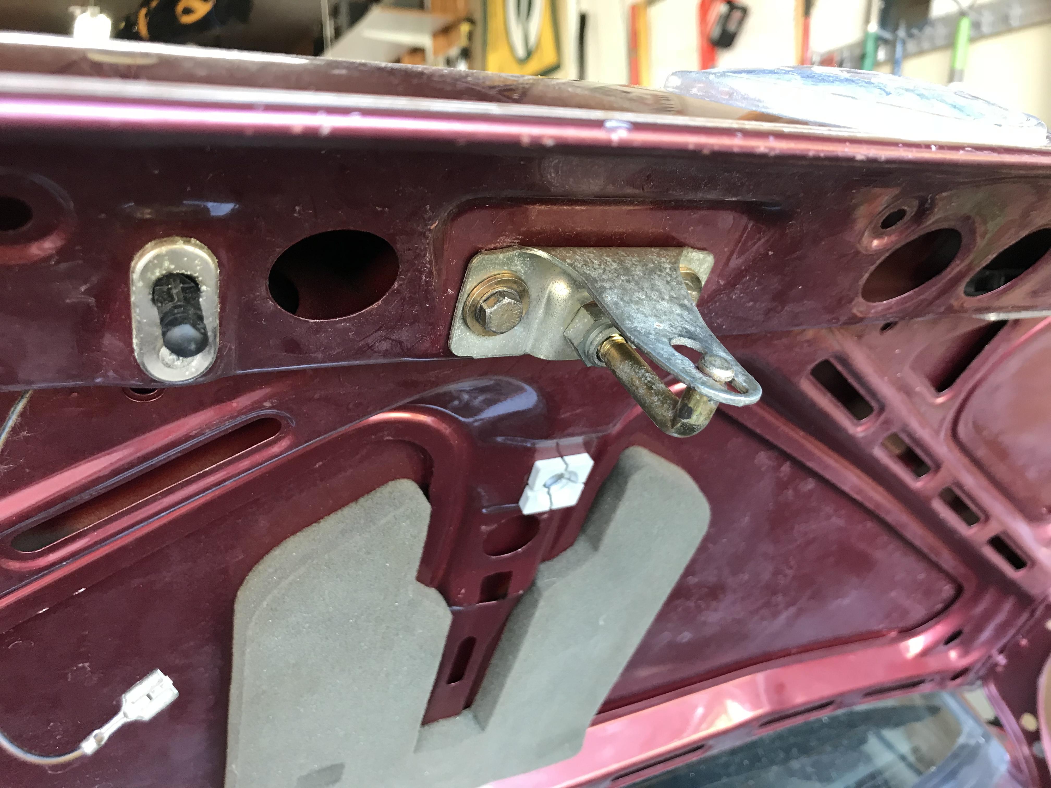

    I found the problem with my trunk. The lever in the picture below was getting stuck on the housing of the latch housing. I believe this is because the spring that this lever is on is not as taught and giving it some play. The lever would catch the side of the housing and not allow the latch to open. So for the time being, I have shaved the portion of the housing to make sure that it would not get caught. The picture below shows the lever pushed as far over, you can see how it would over lap.
    My plan is to go to the junk yard on Saturday and find a new male trunk latch(the part that was stuck in the latching mechanism that I cut off to get the latching mechanism out of the car) and possible a new latching mechanism all together to see if it is in better shape. The lock itself I believe is completely toast. I'm pretty sure it's supposed to spring out when it's pushed in but it just says. So I might just buy a new one off eBay with a key as my last lock rebuilding experience did not go to plan.

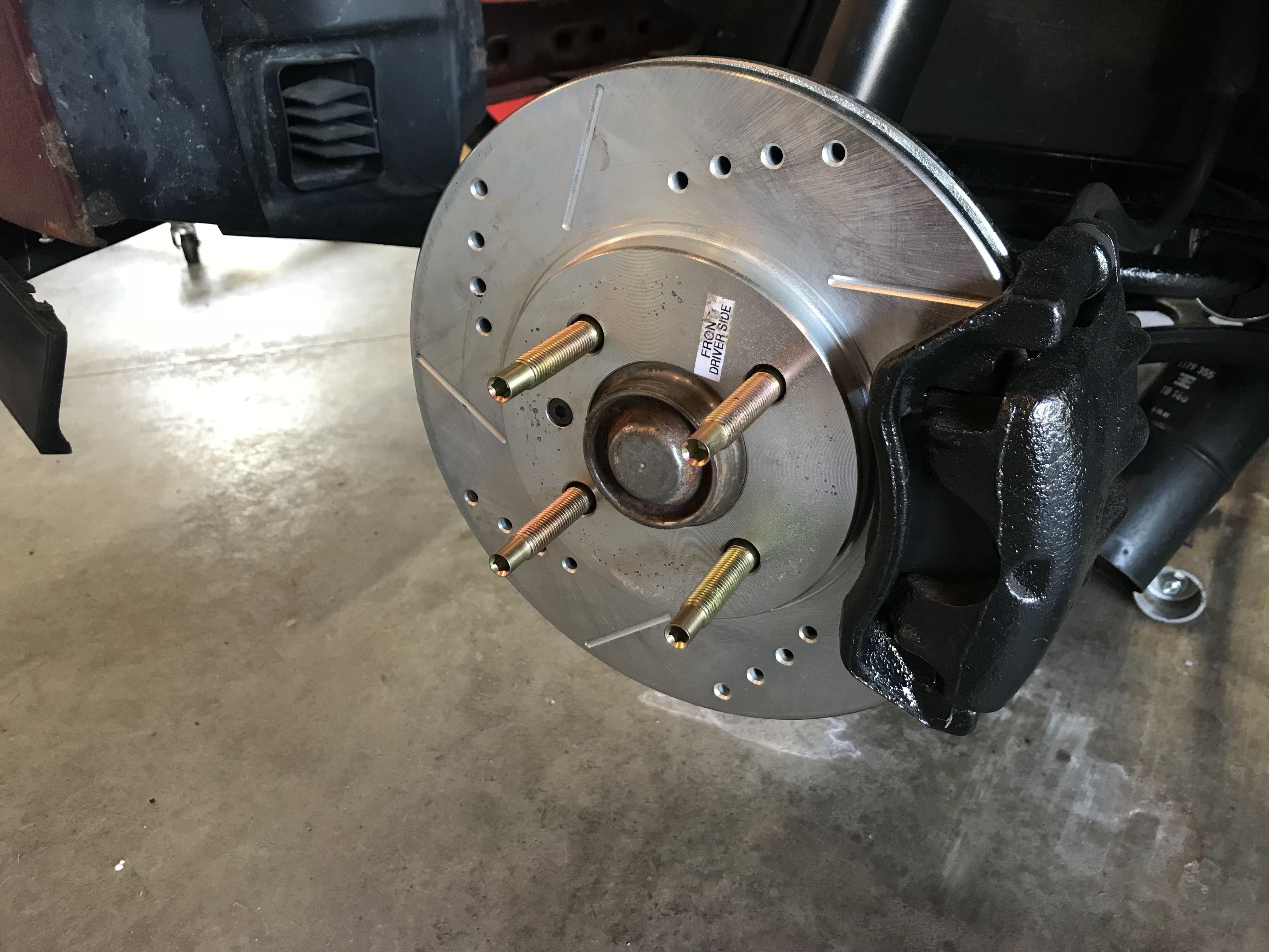

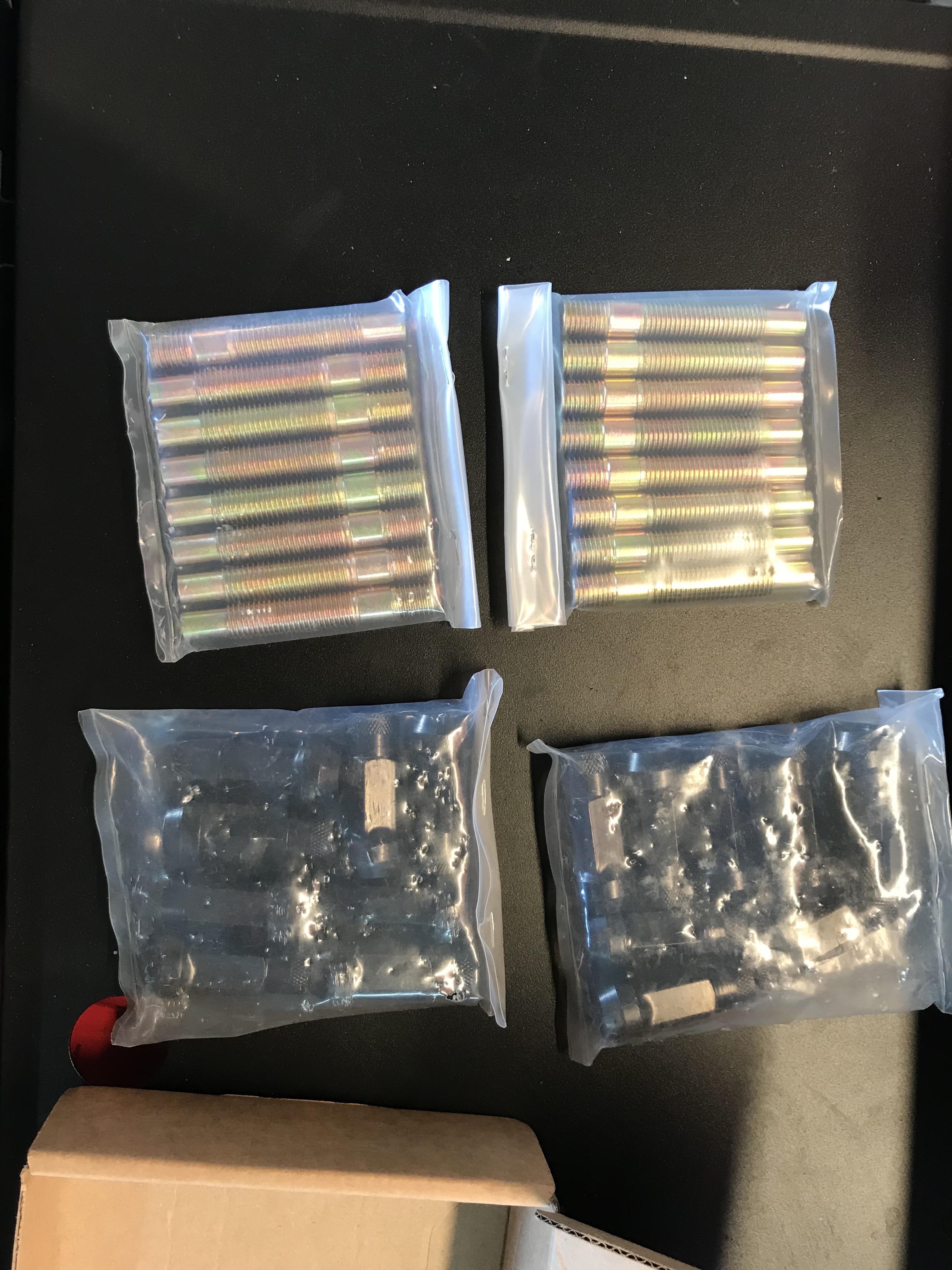

                    Wheel stud conversion done
                    Was able to get a trunk latch from Gibson’s. E32 trunk latches are the same as E30s. My trunk lock mechanism should be here tomorrow so should hopefully have the trunk wrapped up tomorrow.

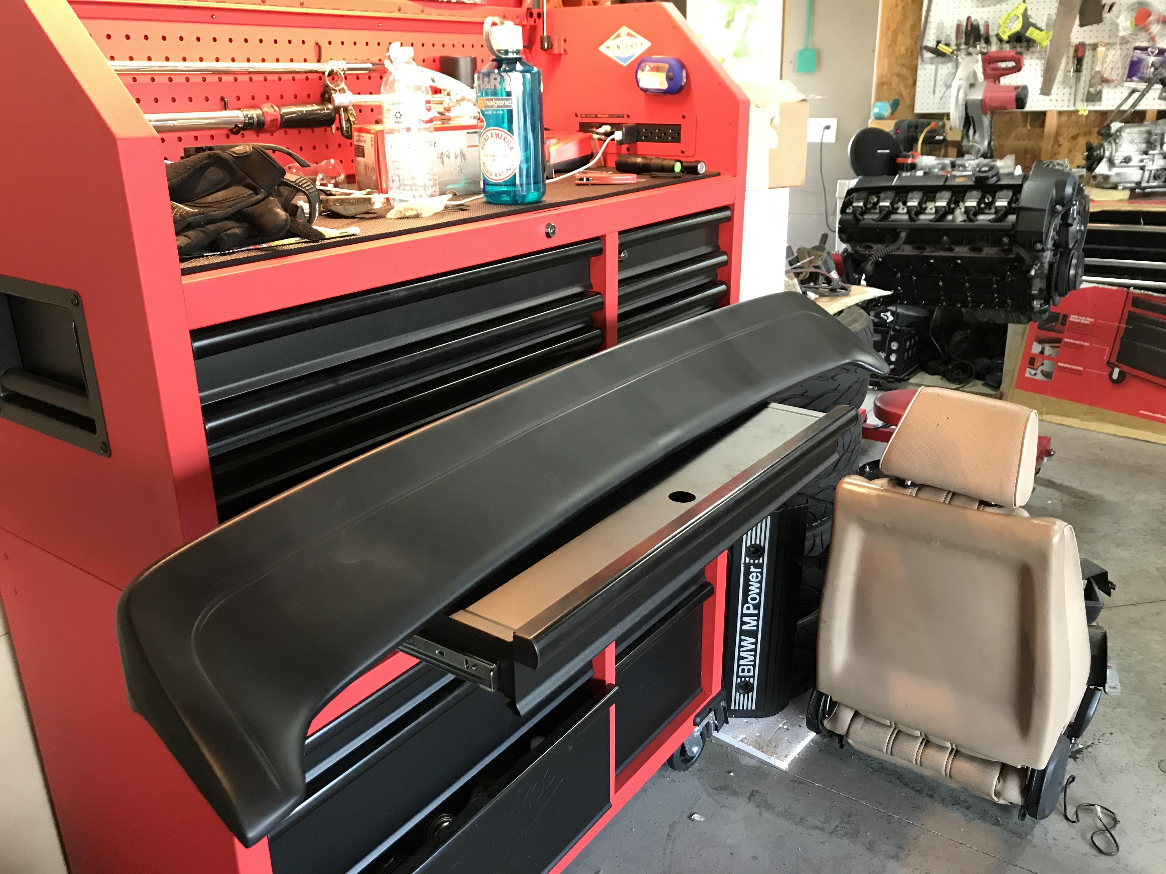

                    Mtech 1 spoiler also came today. Gonna paint it and install it tomorrow hopefully. Got a wedding and some buddies back in town so might have to wait until Monday. Gonna buff and polish the trunk before installing the wing.

                      Got my trunk lock mechanism, trunk closes and latches now. This is really small in the grand scheme of the car, but feels like such an accomplishment for this to work lol

                      Waiting for the paint to dry on the Mtech wing before installing.

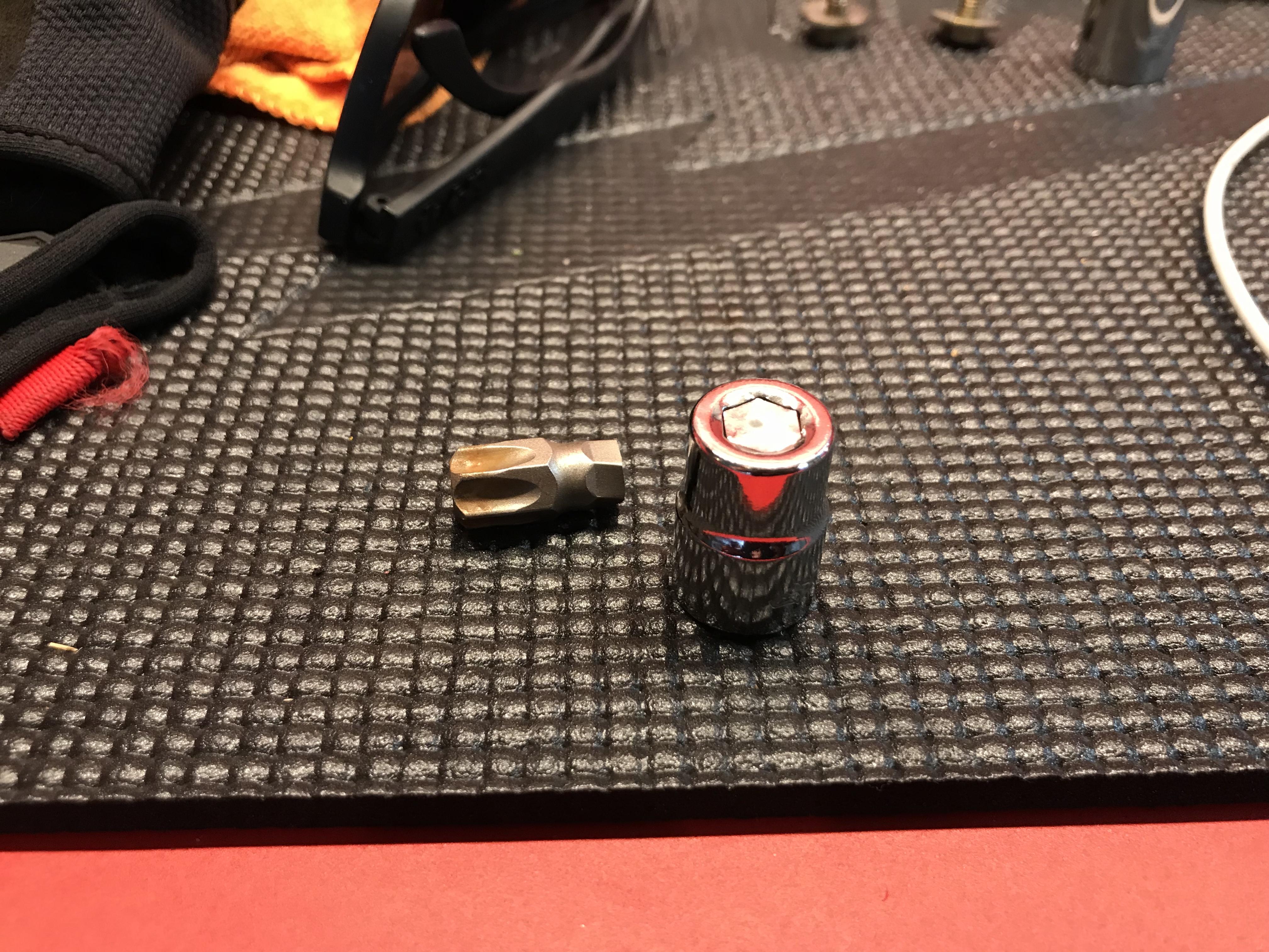

                                Went to pull the rear bumper and got the first torx bolt out, sheared my socket on the second one.
                                Not sure if I should try it on an impact instead of breaker bar with my jack handle next time?

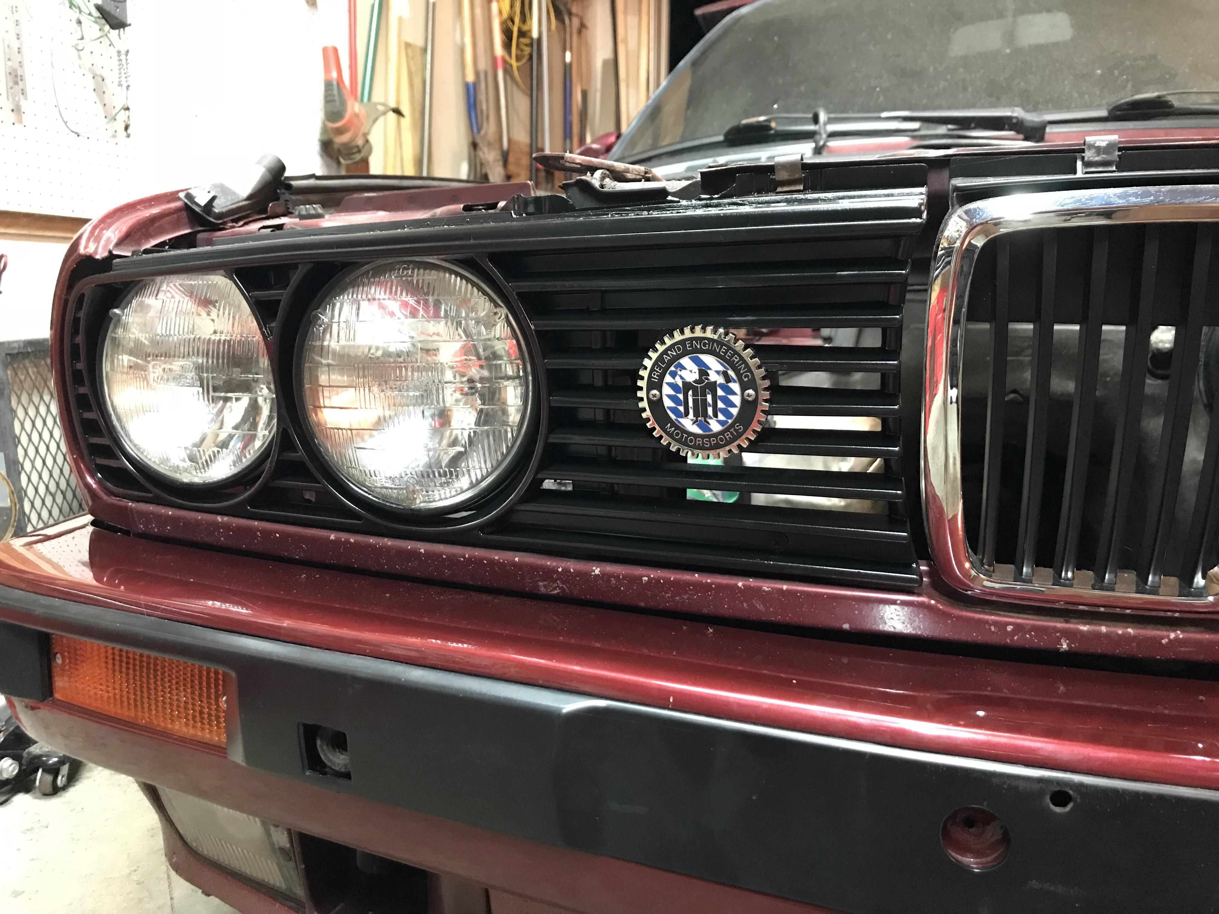

                                I pulled the door molding and didn’t brake any clips! Put a fresh coat of paint on the euro grilles and the head lights rings. I also took the IS lip off and got it painted.

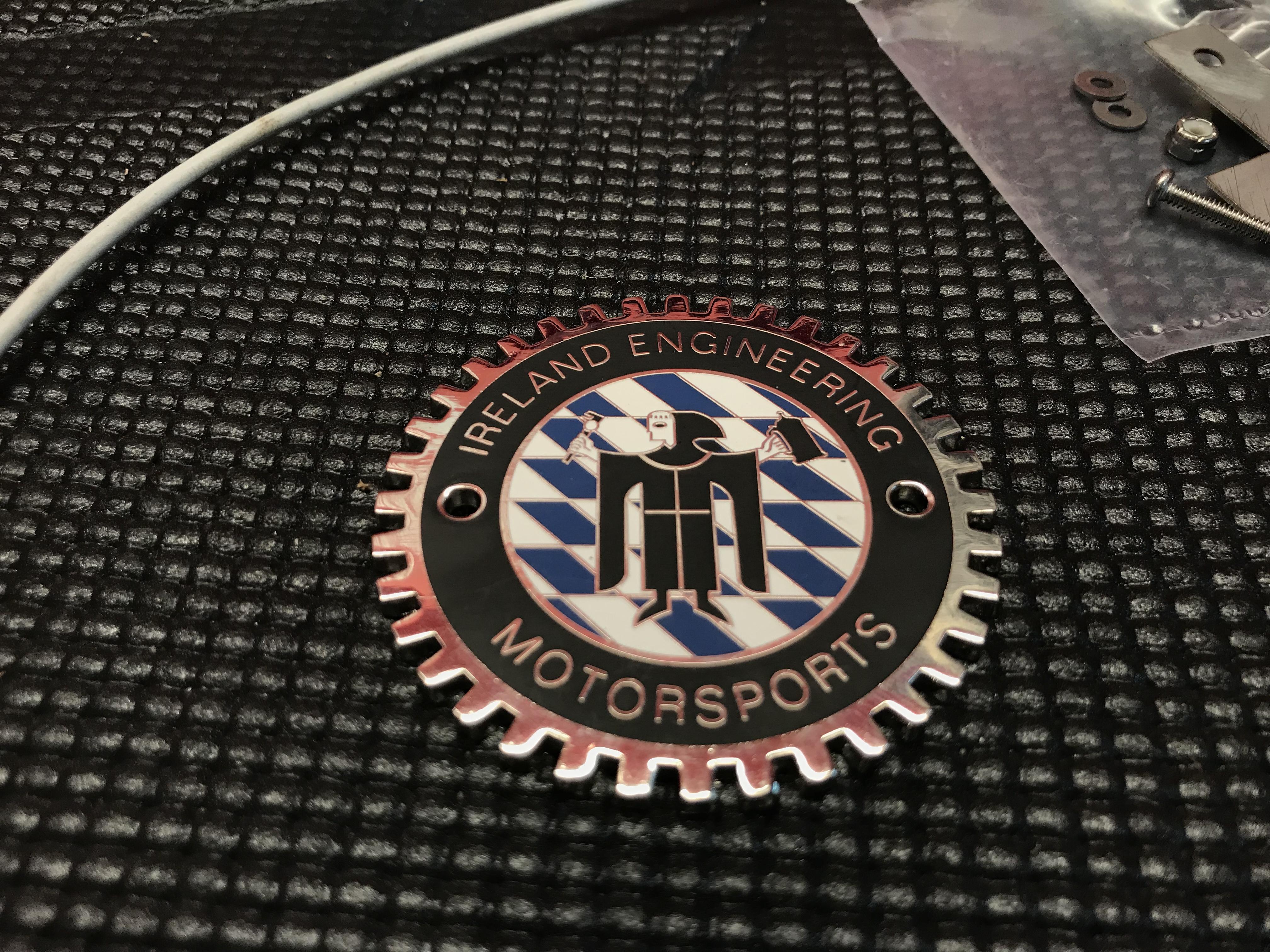

                                This I am super stoked on. I love the knick-knacky shit and this is definitely that. I see a lot of the Porsche guys with these at RA and really wanted to get one for the E30, I think it adds a lot of flare to the front of the car.
                                Installed with the fresh painted grilles. Need new headlights ASAP.

                                  the rear bumper shocks can be unmounted from the car attached to the bumper via the two bolts that hold them to the car, if for some reason that torx bolt is stubborn. then you can get in there with some spray/heat.
                                  an impact is always a better choice than a long breaker bar

                                    That IE grill badge is cool!

                                      The nuts that hold the rear bumper in are accessed from the truck (PS) or underneath the car (DS). Those torx bolts are pretty notorious for getting stuck, and the are not an easy one to get out after that.
                                      I like the IE badge!
