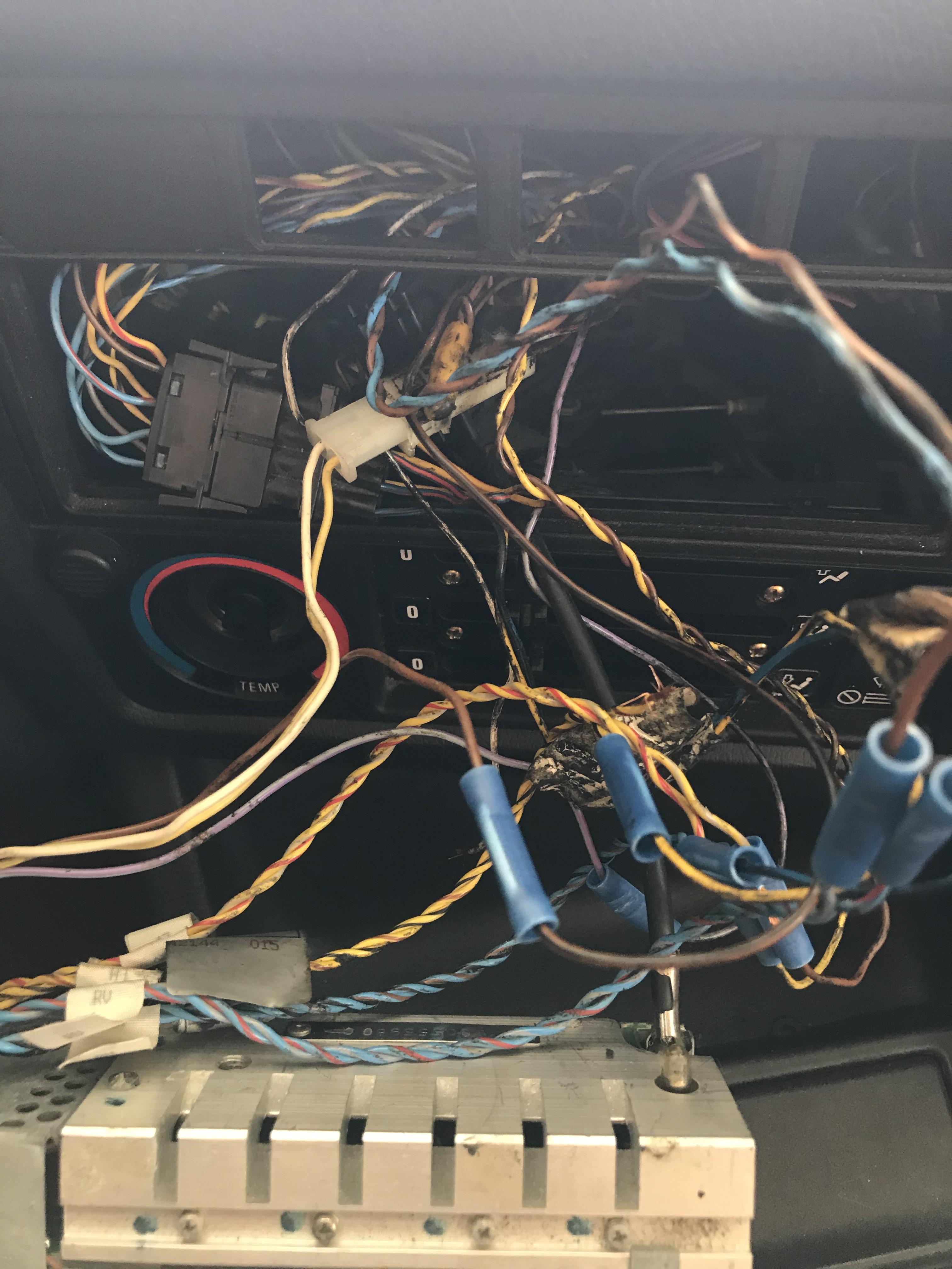

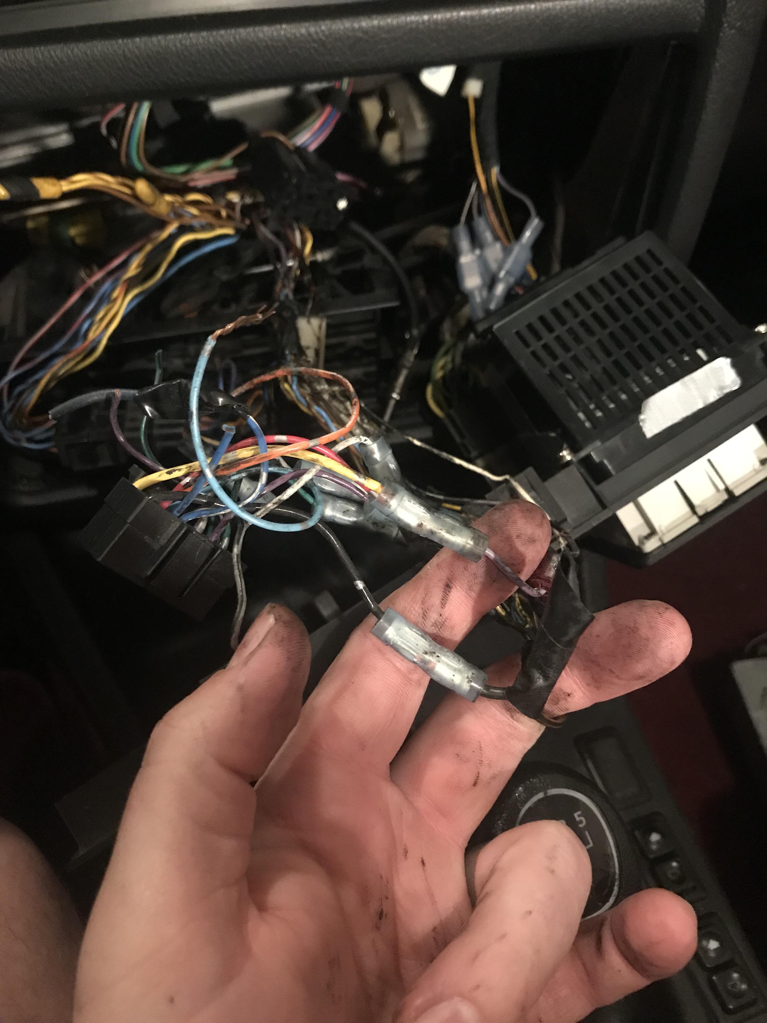

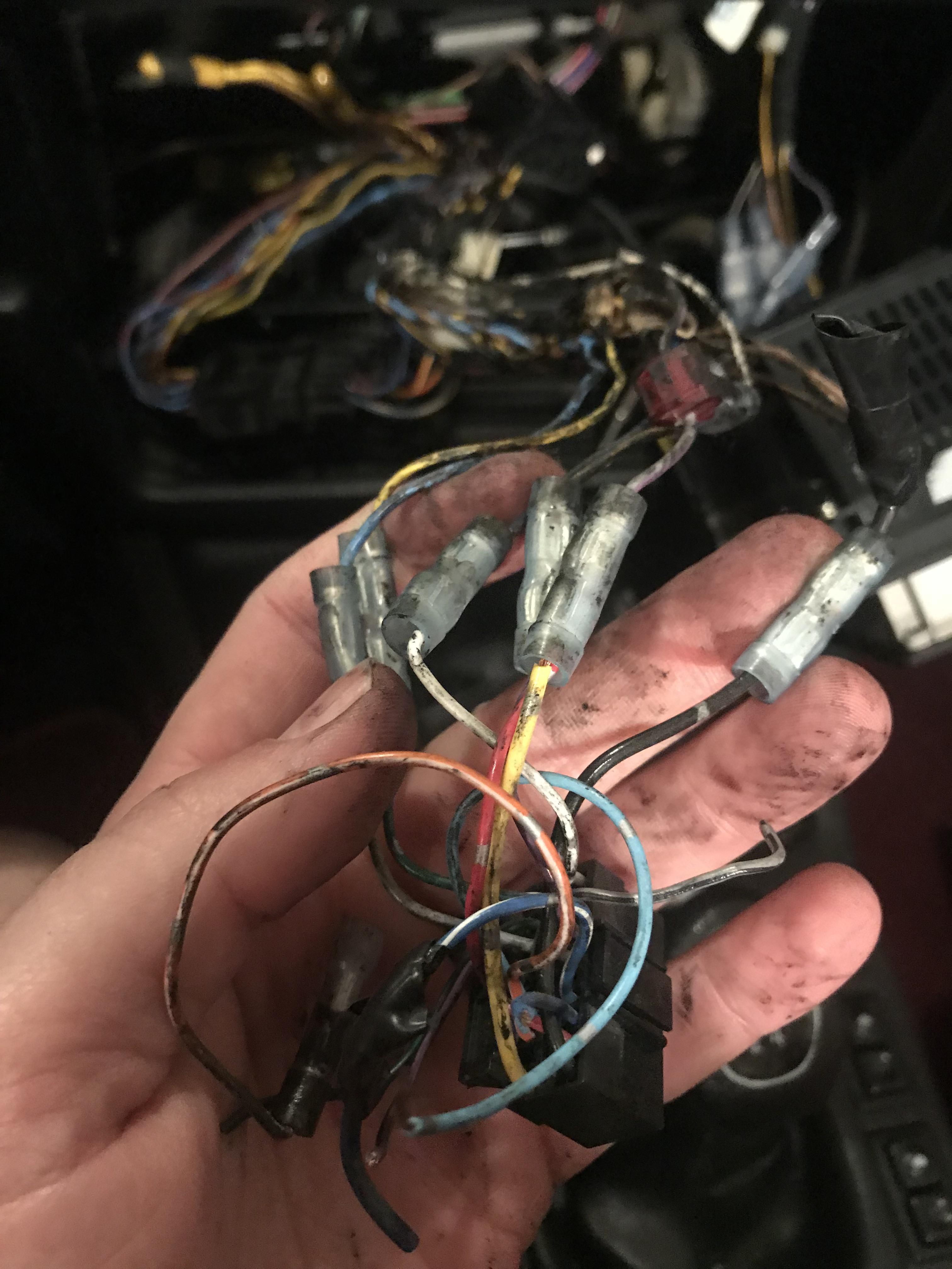

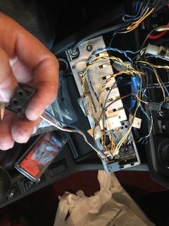

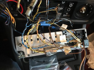

<p dir="auto">Still working on getting the stock radio working in my E30.  I've gotten power to the unit and it seems to be working, but I have no sound.  I have a few wires that are not connected, but 2 speakers should be working. </p>
<p dir="auto">I'll attach a before and now picture as well as the schematic I  am attempting to use. (If there is supposed to be an internal amp in the dash I am F*@#$%). </p>
<p dir="auto">If anyone has any insight I'd appreciate it.  </p>

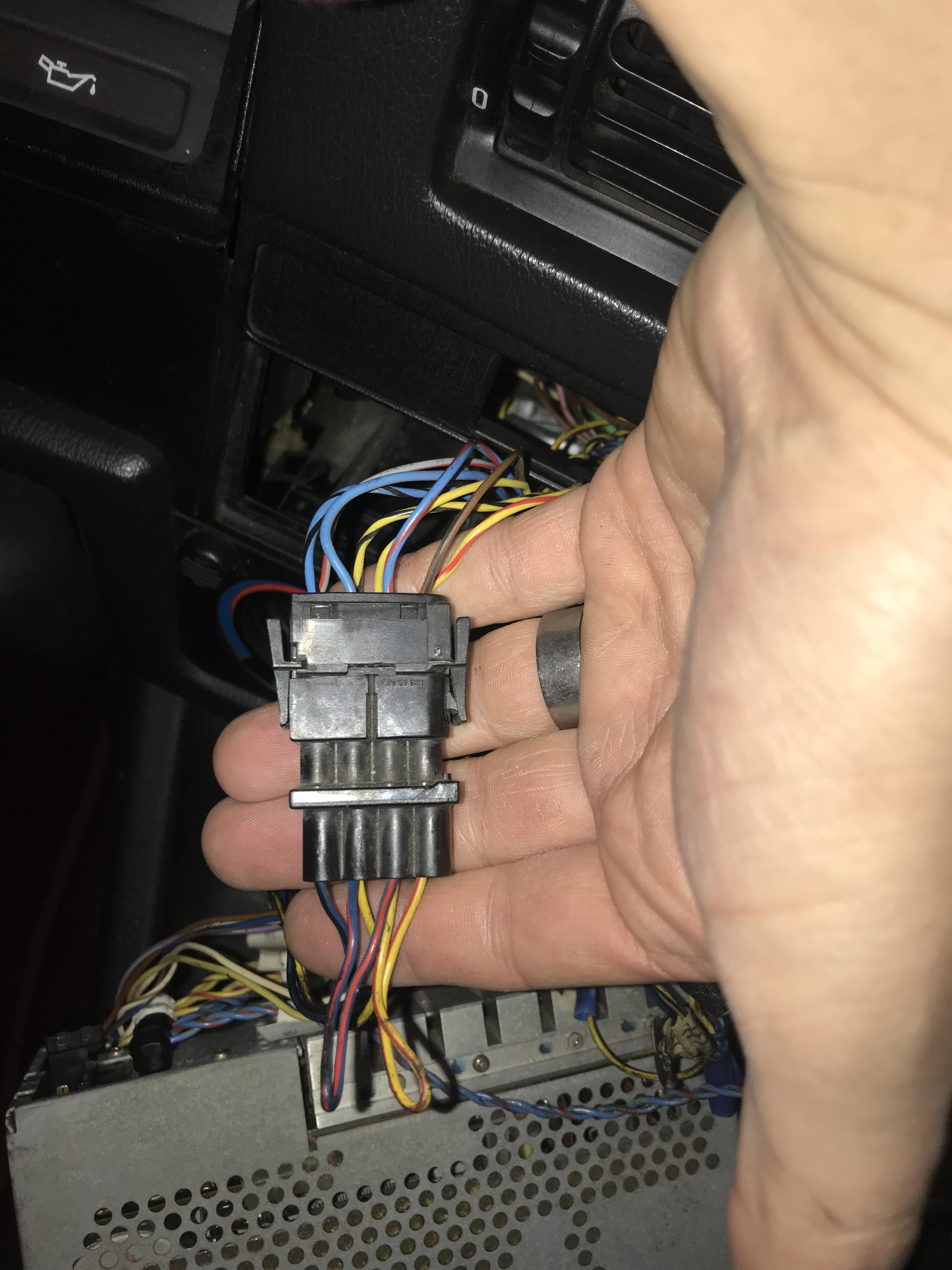

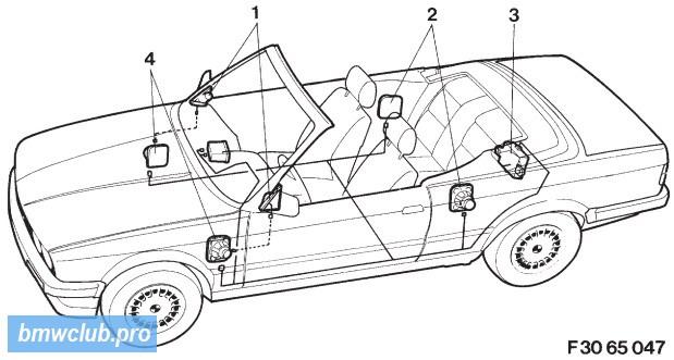

<p dir="auto">and just to be perfectly clear - there is no amp and location #3, hidden behind the carpet panel? and no wiring that has been cut running up inside the car under the seat/side panel between the rear speaker and location #3? there should be a big bundle (10ish wires) that would have gone to the amp.</p>
<p dir="auto">and to go back a little, did you say at some point when you owned this car the speakers worked? what was changed/who changed it since that point?</p>
<p dir="auto"><a href="/assets/uploads/files/monthly_2018_05_bmw_eba_online_www.bmweba.com_-355.jpg.d9c1fcb3800dc4b53565a595b0b02180.jpg"><img src="/assets/uploads/files/monthly_2018_05_bmw_eba_online_www.bmweba.com_-355.jpg.d9c1fcb3800dc4b53565a595b0b02180.jpg" alt="bmwebaonlinewww.bmweba.com-355.jpg" class=" img-fluid img-markdown" width="619" height="331" /></a></p>
<p dir="auto">I’m an idiot. I was looking under the carpet on the DS side towards the tail lights in the quarter panel. It’s there.</p>
<p dir="auto">Yes, the rear speakers were working for sure with the old radio.</p>
]]></description><link>https://wibimmers.com/post/91319</link><guid isPermaLink="true">https://wibimmers.com/post/91319</guid><dc:creator><![CDATA[AlpineE30]]></dc:creator><pubDate>Tue, 01 May 2018 23:29:28 GMT</pubDate></item><item><title><![CDATA[Reply to Stock Radio CLUSTER F*** on Tue, 01 May 2018 20:27:36 GMT]]></title><description><![CDATA[<p dir="auto">only one way to find out!</p>

<p dir="auto">the amp wiring is gone? i've never heard of anyone actually pulling the wiring when putting in a new system, that would be a waste of time and rather tedious to remove from the harness. your car most likely never had an amp. do you have tweeters in the doors at the mirrors?</p>
<p dir="auto">I was trying not to pull on them too hard, but there wasn't much to work with. Are you thinking it got pulled from the back of the headlight switch? </p>
<p dir="auto">I have one odd plug, but nothing that looks like the plugs I have found when I search for the amp.  There are a few loose wires back there, but nothing that matches the schematic. </p>
<p dir="auto">Yes, I do have the tweeters.</p>

<p dir="auto">Took the car for a spin last night my dash lights are no longer working. Unbelievable. From what I've read they are part of the same wiring cluster as the radio</p>

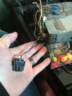

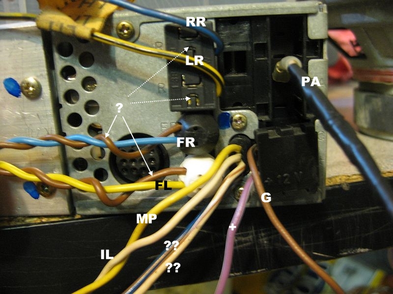

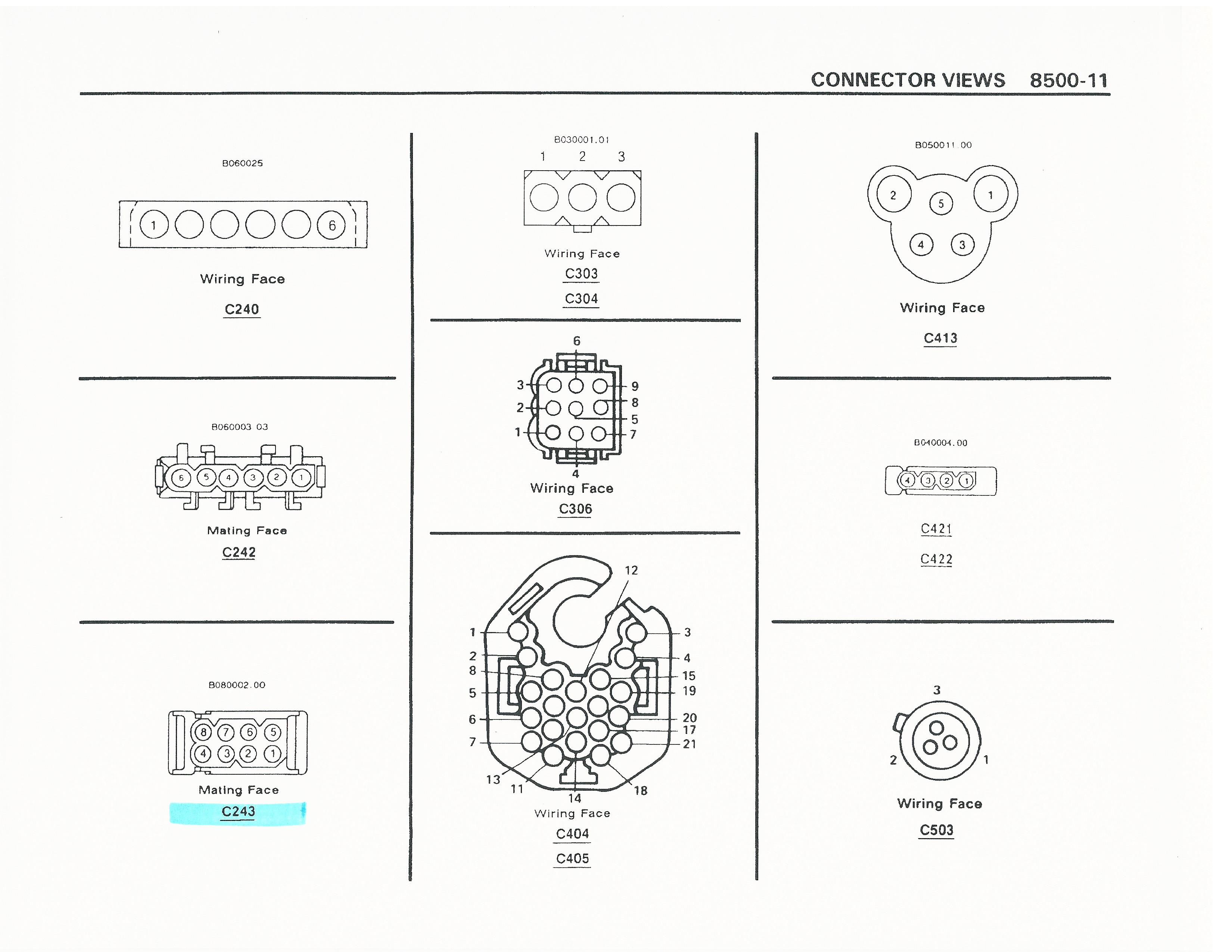

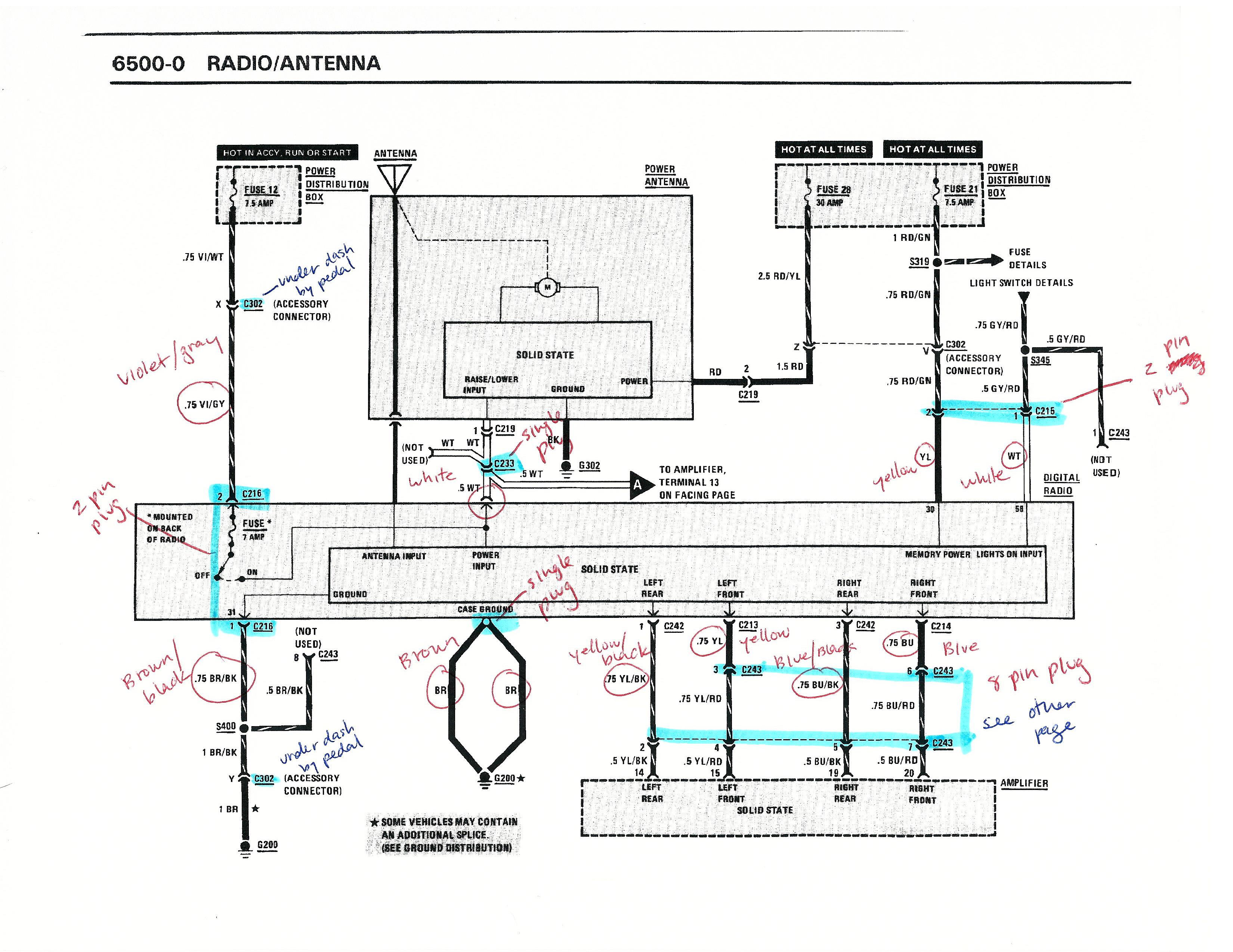

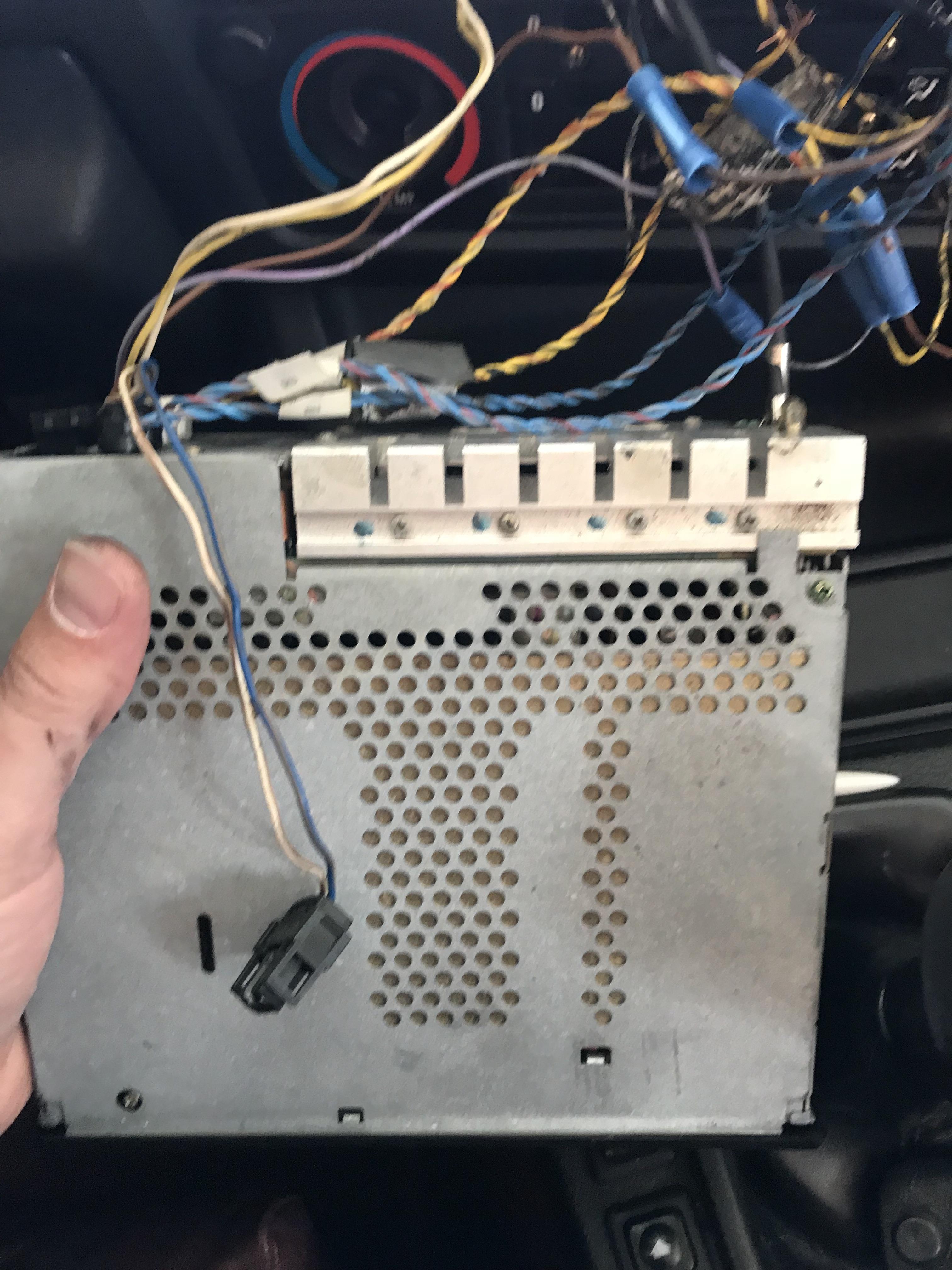

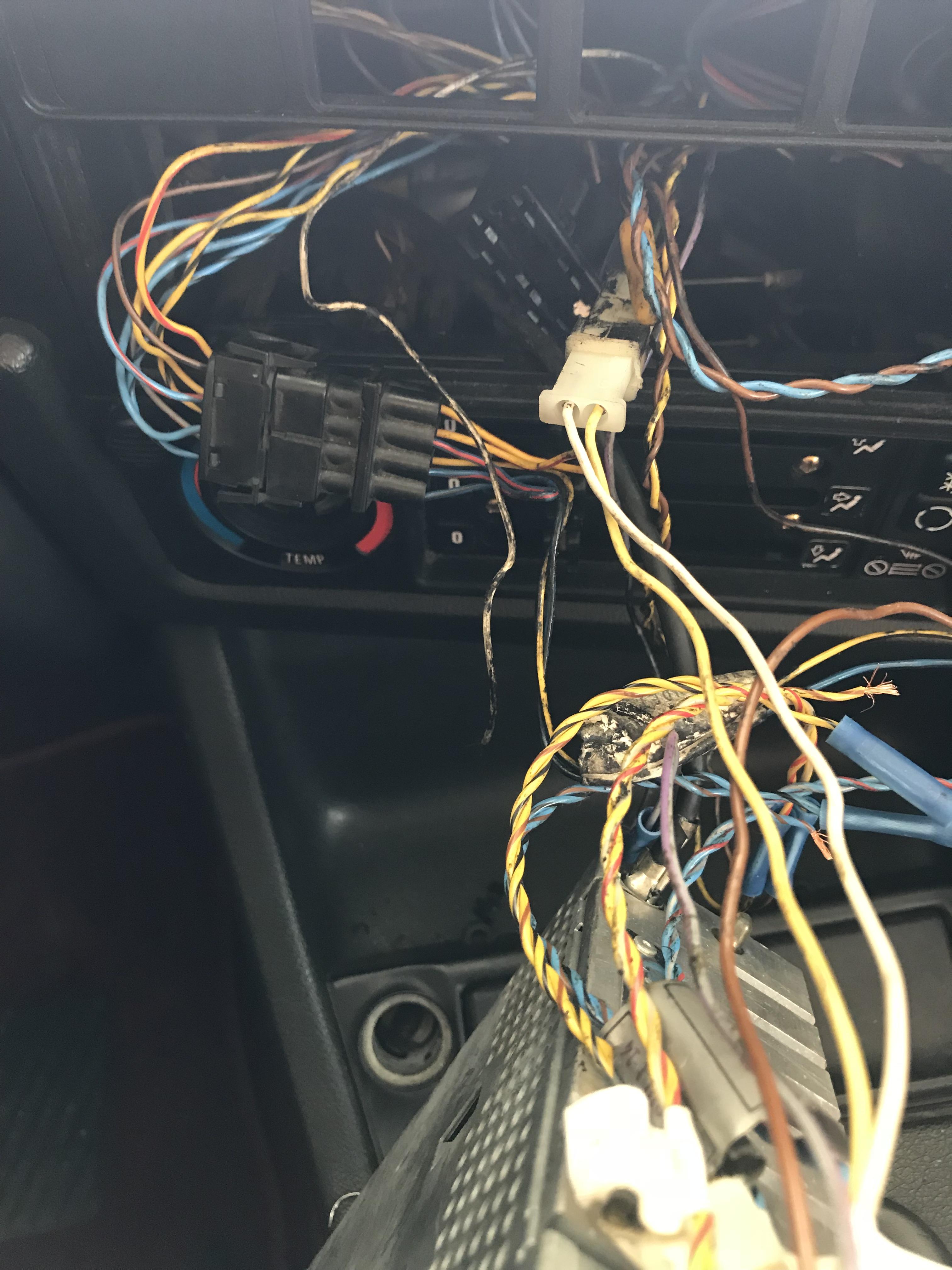

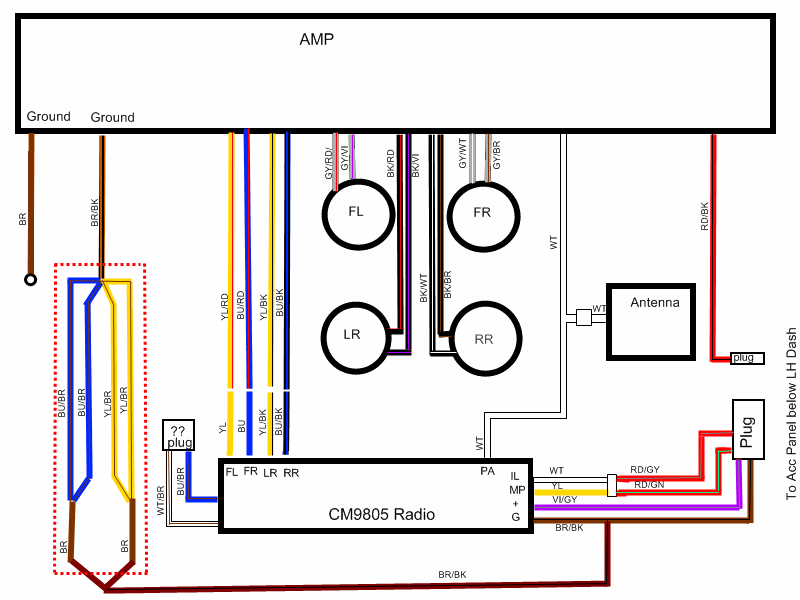

<p dir="auto">i've attached a photo showing the wires on the back of the CM5908 referenced below.</p>
<p dir="auto">its seems like general internet consensus is that mystery two prong plug is not needed. see '??' in attached photo.</p>
<p dir="auto">backlight wire should be the white wire in the 2-pin plug that has yellow and white wires. see 'IL' in attached photo.</p>
<p dir="auto">the white wire for the antenna power: there should be a prong near the top right corner (f you are looking at the back of the radio)where this would plug into. see 'PA' in attached photo.</p>
<p dir="auto">is the amp gone, like the wires are hanging around and its been removed, or it was never there?</p>

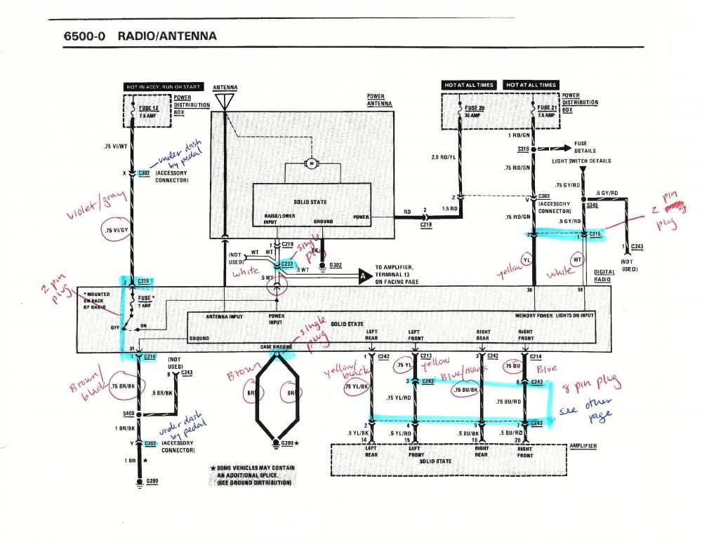

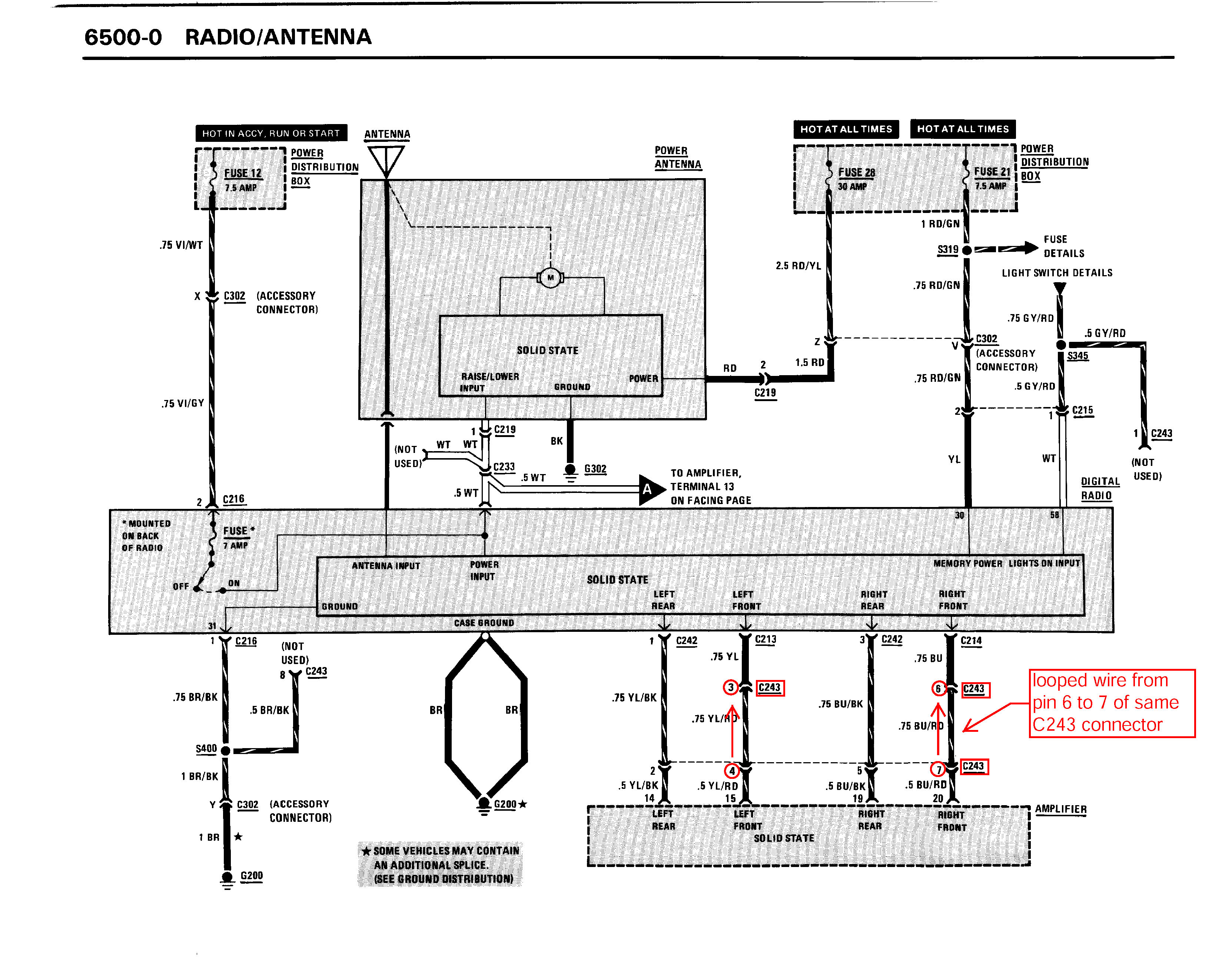

<p dir="auto">see my attached diagram for explanation of the wire loops. it shows a wire being connected to two pins of the the same connector.</p>

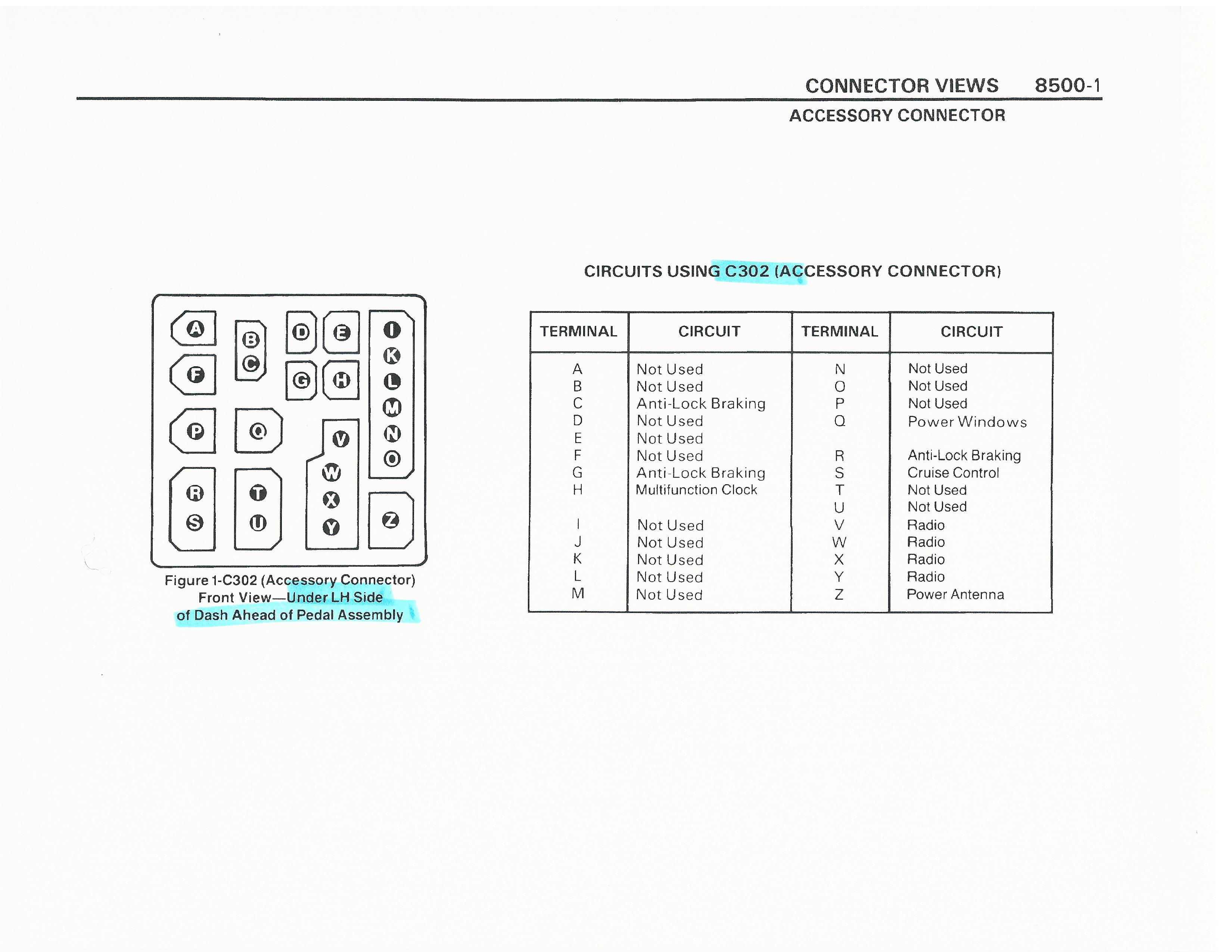

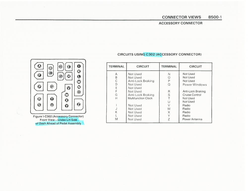

<p dir="auto"><a href="/assets/uploads/files/monthly_2018_04_3524061037_f6f9a3d3de_o.jpg.96a9b9c6d0f4721e05ebc44a4e66f73c.jpg"><img src="/assets/uploads/files/monthly_2018_04_3524061037_f6f9a3d3de_o.jpg.96a9b9c6d0f4721e05ebc44a4e66f73c.jpg" alt="3524061037f6f9a3d3deo.jpg" class=" img-fluid img-markdown" width="800" height="600" /></a></p>
<p dir="auto"><a href="/assets/uploads/files/monthly_2018_04_5ad0cf91c8a1e_Pagesfrom1990BMW325iConvertibleElectricalTroubleshootingManual.jpg.7ec38056d8469640852bb03e654dd994.jpg"><img src="/assets/uploads/files/monthly_2018_04_5ad0cf9255904_Pagesfrom1990BMW325iConvertibleElectricalTroubleshootingManual.thumb.jpg.818bfa1fea8e08651db64fb9b5ad15d1.jpg" alt="Pages from 1990 BMW 325i Convertible Electrical Troubleshooting Manual.jpg" class=" img-fluid img-markdown" width="1000" height="778" /></a></p>
<p dir="auto">the etm diagrams are certainly another language until you have used them a few times to figure out wiring.</p>

<p dir="auto"><strong><a href="/post/90660">straight6pwr said:</a></strong></p>

<p dir="auto"><strong><a href="/post/90642">AlpineE30 said:</a></strong></p>
<p dir="auto">I am not seeing on the diagram where you determine that there are loops, but they are there in the plug.</p>
<p dir="auto">The amp is gone. </p>
<p dir="auto">The 2 wires are White and Brown and Blue and Grey. They originate from the same plug ( +12V) as the Violet and Brown that go to the power distributor box (on the left side of the diagram). </p>
<p dir="auto">My backlight is not powered. I wonder if the 2 pin is for that?</p>
<p dir="auto">I don't have a corresponding solid white wire coming from the rear of the radio.  </p>
]]></description><link>https://wibimmers.com/post/90660</link><guid isPermaLink="true">https://wibimmers.com/post/90660</guid><dc:creator><![CDATA[straight6pwr]]></dc:creator><pubDate>Fri, 13 Apr 2018 15:42:18 GMT</pubDate></item><item><title><![CDATA[Reply to Stock Radio CLUSTER F*** on Fri, 13 Apr 2018 13:53:18 GMT]]></title><description><![CDATA[<blockquote>
<p dir="auto"><strong><a href="/post/90620">straight6pwr said:</a></strong></p>
<p dir="auto">do you have the speaker wires from the back of the radio matched to the 8-pin plug per the etm diagram?</p>
<p dir="auto">there are supposed to be two looped wires on that connector, per the diagram. A yellow/red loops from pin 3 to 4 and a blue/red wire loops from pins 6 to 7. That connector should also have 4 wires vanishing off into the dash headed to the amp. yellow/black, yellow/red, blue/black, blue/red</p>
<p dir="auto">did you look for your amp yet?</p>
<p dir="auto">you could run a temp. wire from the head unit outputs directly to each speaker to test the outputs of the radio/speakers.</p>
<p dir="auto">what color are the two wires from that 2-pin connector? your phone pics are sized for ants. maybe its powering up a 6-CD changer, i believe this radio was capable of connecting to one.</p>
<p dir="auto">is that white wire the power wire for the antenna, or is that accounted for already?</p>
<p dir="auto">I don't have a corresponding solid white wire coming from the rear of the radio.</p>
]]></description><link>https://wibimmers.com/post/90642</link><guid isPermaLink="true">https://wibimmers.com/post/90642</guid><dc:creator><![CDATA[AlpineE30]]></dc:creator><pubDate>Fri, 13 Apr 2018 13:53:18 GMT</pubDate></item><item><title><![CDATA[Reply to Stock Radio CLUSTER F*** on Thu, 12 Apr 2018 20:01:10 GMT]]></title><description><![CDATA[<p dir="auto">do you have the speaker wires from the back of the radio matched to the 8-pin plug per the etm diagram?</p>
]]></description><link>https://wibimmers.com/post/90620</link><guid isPermaLink="true">https://wibimmers.com/post/90620</guid><dc:creator><![CDATA[straight6pwr]]></dc:creator><pubDate>Thu, 12 Apr 2018 20:01:10 GMT</pubDate></item><item><title><![CDATA[Reply to Stock Radio CLUSTER F*** on Thu, 12 Apr 2018 19:17:36 GMT]]></title><description><![CDATA[<p dir="auto">I</p>
<p dir="auto"><strong><a href="/post/90603">straight6pwr said:</a></strong></p>
<p dir="auto">ok so i looked at the 1990 etm, looks like your car wouldnt have had the dash fader. that plug should be the c243 plug that the speaker wires go to, so looks like you have what you need.</p>
<p dir="auto">i put some notes on the pages for you.</p>
<p dir="auto">if you have power, youre only worried about the speaker wires. if you get everything hooked up and it still doesnt work, don't forget the speakers could be dead or the radio itself.</p>
<p dir="auto"><a href="/assets/uploads/files/monthly_2018_04_Scan0001.jpg.cc1b4dd32b814a6bc86f37c52b8fa6fa.jpg"><img src="/assets/uploads/files/monthly_2018_04_Scan0001.thumb.jpg.296970503bcff10fffc881f86a9e00da.jpg" alt="Scan0001.jpg" class=" img-fluid img-markdown" width="1000" height="773" /></a></p>
<p dir="auto"><a href="/assets/uploads/files/monthly_2018_04_Scan0002.jpg.50b0e9c71d72a74f0a29b0da49904e22.jpg"><img src="/assets/uploads/files/monthly_2018_04_Scan0002.thumb.jpg.5f59390c958cffa625d0167877de3ff7.jpg" alt="Scan0002.jpg" class=" img-fluid img-markdown" width="1000" height="773" /></a></p>
<p dir="auto"><a href="/assets/uploads/files/monthly_2018_04_Scan0003.jpg.9c064f9e89792866631e5eed358feeef.jpg"><img src="/assets/uploads/files/monthly_2018_04_Scan0003.thumb.jpg.c1a37022d4c446b925c140d2d9860f9d.jpg" alt="Scan0003.jpg" class=" img-fluid img-markdown" width="1000" height="773" /></a></p>
<p dir="auto">I have figured out where most everything goes. Except 4 of the speaker wires do not come from the (8)plug.  There are 2 loops in it and the other wires are coming from elsewhere. Also, I have a plug or cooresponding wires that don't appear to be on the schematic. I'll include a picture.  I also have a mystery white wire with no other markings coming from the dash. </p>
<p dir="auto">I know for a fact that 2 of the speakers worked with the previous head unit. </p>
<p dir="auto">Let me know your thoughts. </p>
<p dir="auto"><a href="/assets/uploads/files/monthly_2018_04_IMG_4595.jpg.7f7fefd66ceeb58f6d42086d13cd51d5.jpg"><img src="/assets/uploads/files/monthly_2018_04_IMG_4595.jpg.7f7fefd66ceeb58f6d42086d13cd51d5.jpg" alt="IMG4595.jpg" class=" img-fluid img-markdown" width="240" height="320" /></a></p>
<p dir="auto"><a href="/assets/uploads/files/monthly_2018_04_IMG_4597.jpg.7fec7bad4dabd153ef0639d9a9efdeb9.jpg"><img src="/assets/uploads/files/monthly_2018_04_IMG_4597.jpg.7fec7bad4dabd153ef0639d9a9efdeb9.jpg" alt="IMG4597.jpg" class=" img-fluid img-markdown" width="320" height="240" /></a></p>
<p dir="auto"><a href="/assets/uploads/files/monthly_2018_04_IMG_4598.jpg.ace53c65b25b1fd57c134fb28166a87e.jpg"><img src="/assets/uploads/files/monthly_2018_04_IMG_4598.jpg.ace53c65b25b1fd57c134fb28166a87e.jpg" alt="IMG4598.jpg" class=" img-fluid img-markdown" width="240" height="320" /></a></p>
