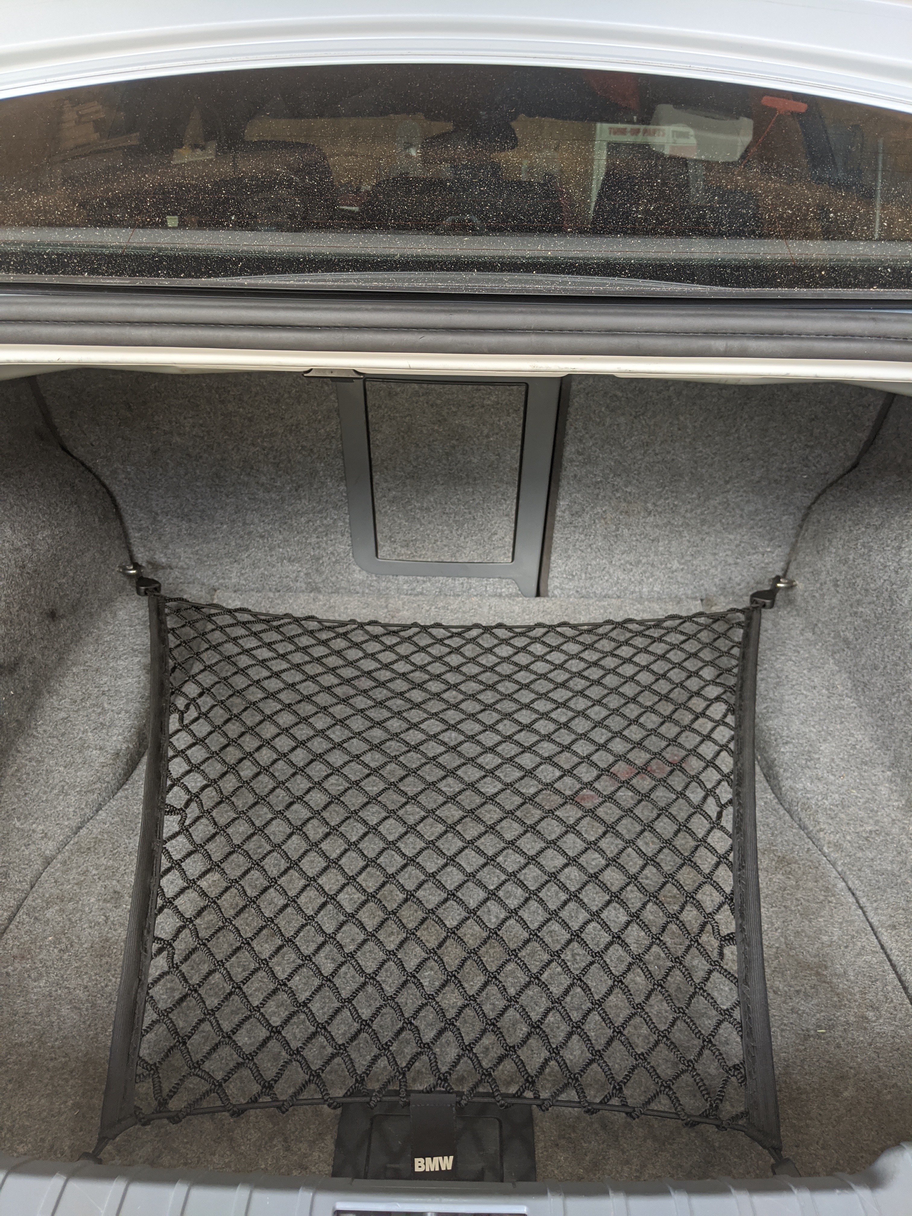

                Among my box of Liquimoly that showed up Saturday was also my newest interior upgrade. A cargo net!  I know, not the most exciting but for me this was a big upgrade.  It's bmw part # 51470010557.  For whatever reason BMW stopped installing the front facing hooks closest to the back seats sometime in the 2010-2011 MY but left the tapped holes in the body behind the felt.  At my cost it's about $70 to buy the screws, covers, etc to properly at the hooks that BMW should have put in to begin with. $70 isn't a lot of money in the grand scheme but my principles won't allow me to spend that on this absurdity so I figured out what the thread pitch is and ordered two eye bolts off of Amazon and am waiting for them to show up. For anyone else's reference they are M8x1.25.  For now I have it hooked under the tray so I can use it and boy did I get to use it this past weekend!  Turns out it has limitations and a week+ worth of groceries for a family of 4 exceeds them.  Overall I'm happy with it.  One of my biggest daily gripes driving this regularly during the salt free months is there is NO secure storage so anything in my car was one spirited roundabout away from certain doom.

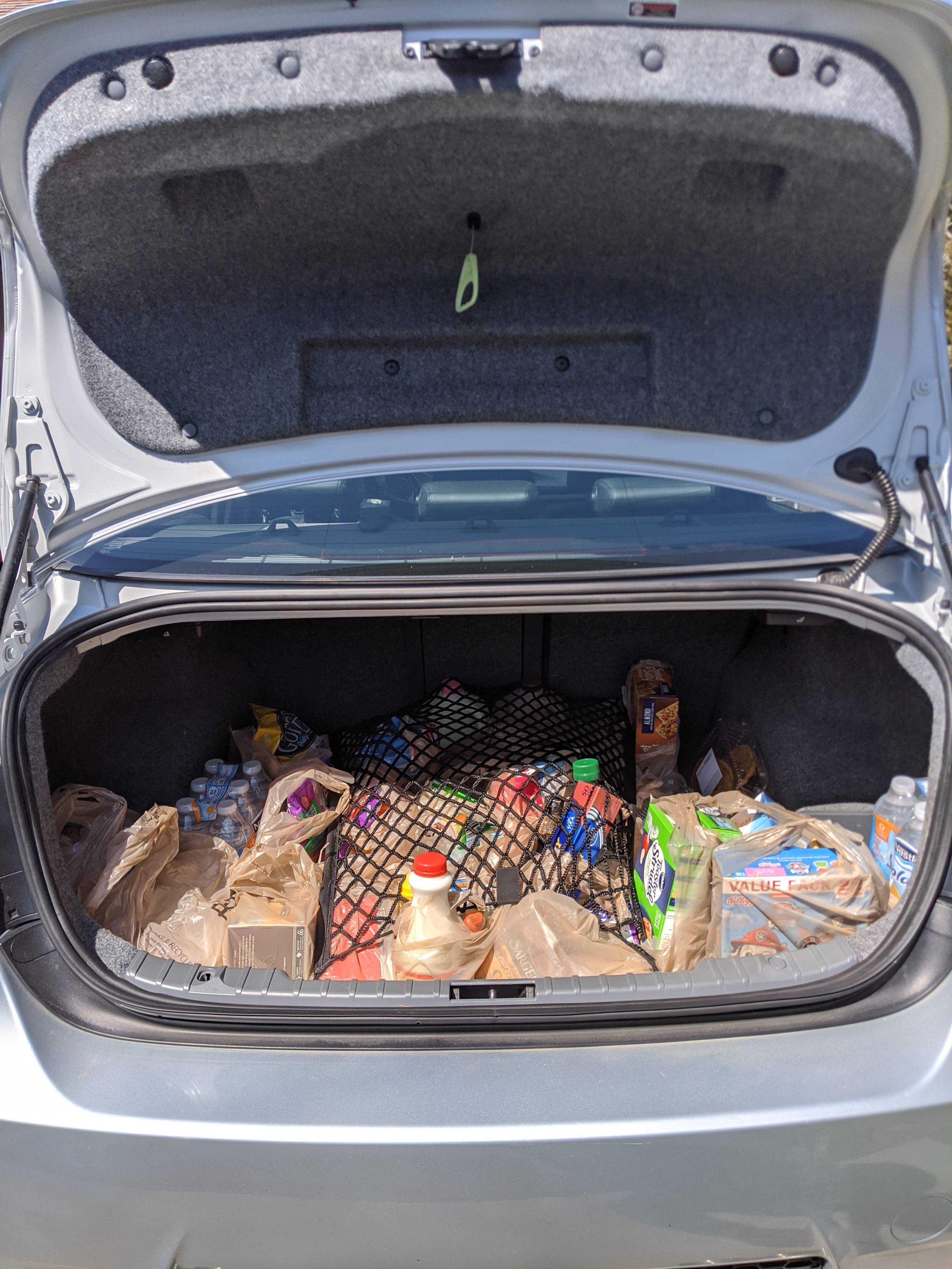

                        My Amazon eye bolts came in today!  They were 100mm in length so they required some trimming and die work but work just fine.  $10 eye bolts>$70 BMW cash grab.  I've thought about painting them black but I've also reminded myself it's my trunk and nobody will ever see them that's conscious/alive so silver they'll stay.
                        Also, I gave them a try with a much more reasonable load of beer this past weekend and they passed the roundabout challenge!
                            How was this not the photo you posted?!
                            That looks like a pretty slick cargo hold setup!
                              #154
                              I was so excited to get the beer in my trunk and then out and start drinking it that I completely forgot!
