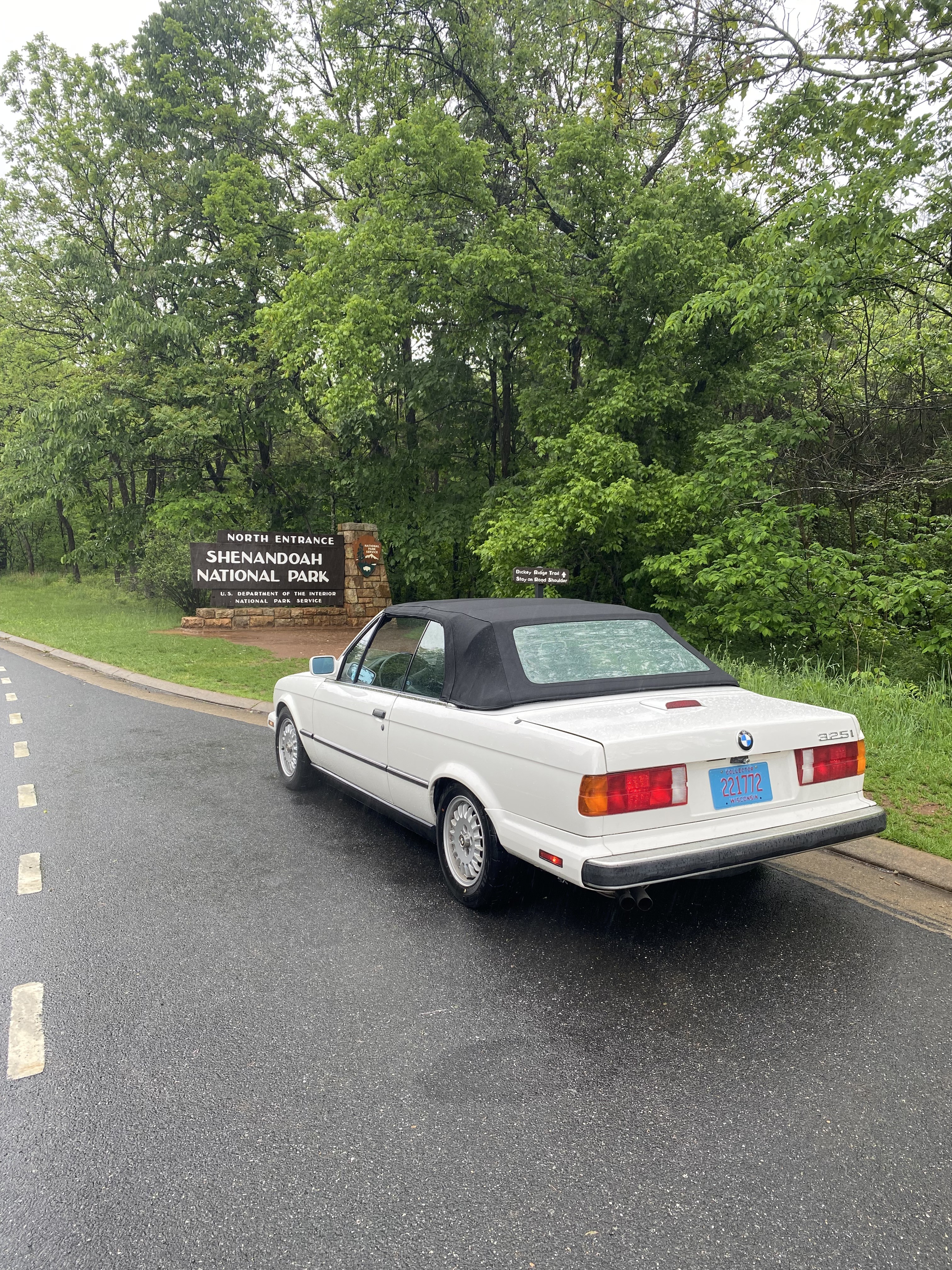

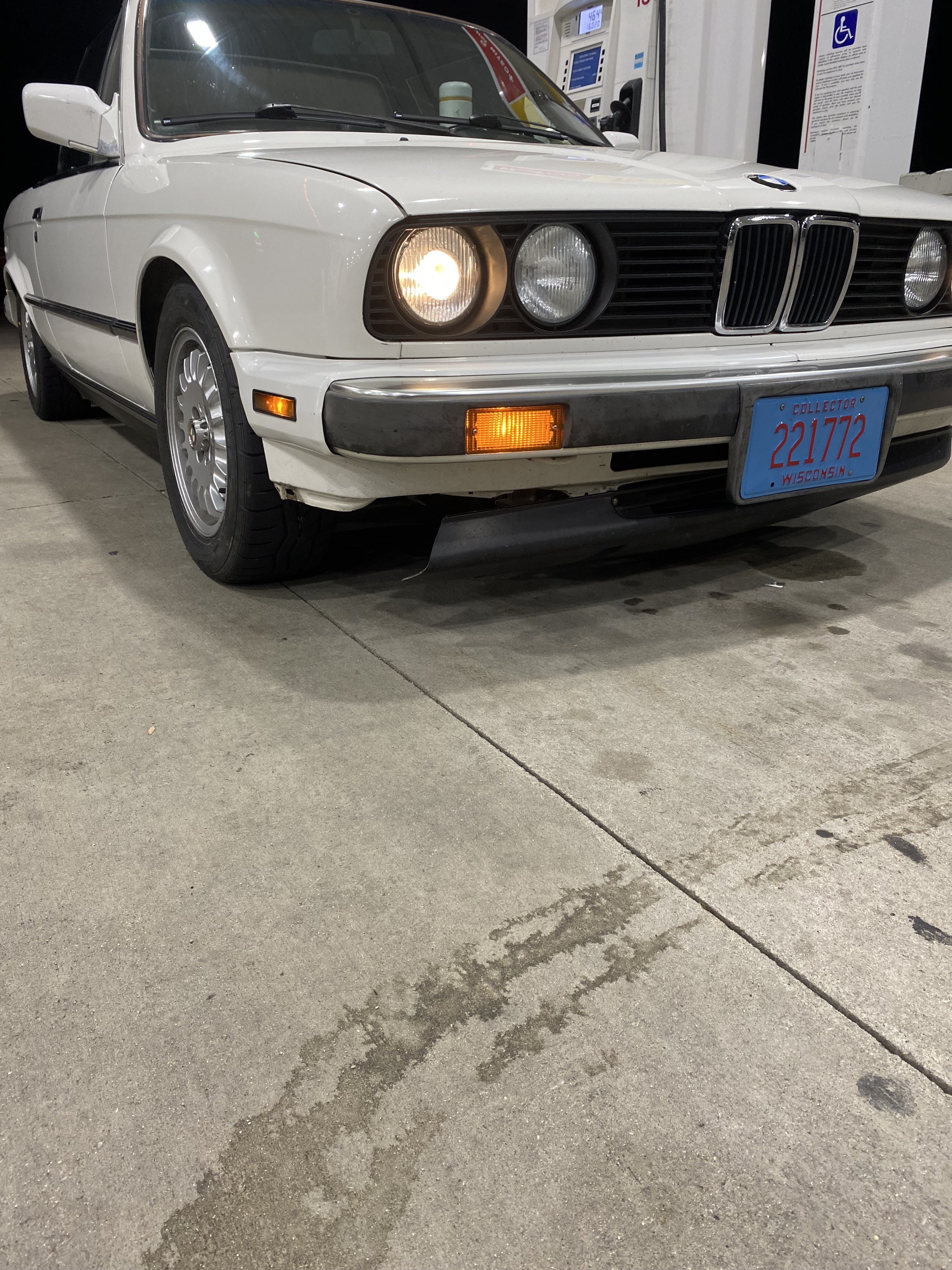

    It verks! Back to ticking away the miles. The check light in the cluster along with the ABS light both work now too, which is cool. Only took a decade 🙄.
    Put a little over a hundred miles on it today while heading up to Devil’s lake to hike, did about 10 miles there in a little over four hours. It was an absolutely perfect day for it too.
    In other news, my brother picked up a 1970 Honda CL100 for $20 last year, and has been getting it running and back into streetable shape when he has the time for it. Tonight he got around to pulling the piston and cylinder, and figured out what the source of his oil consumption was. This is the compression ring, and he said it was all still in there thankfully. Bore isn’t scored either, I’m amazing it ran as well as it did like this.

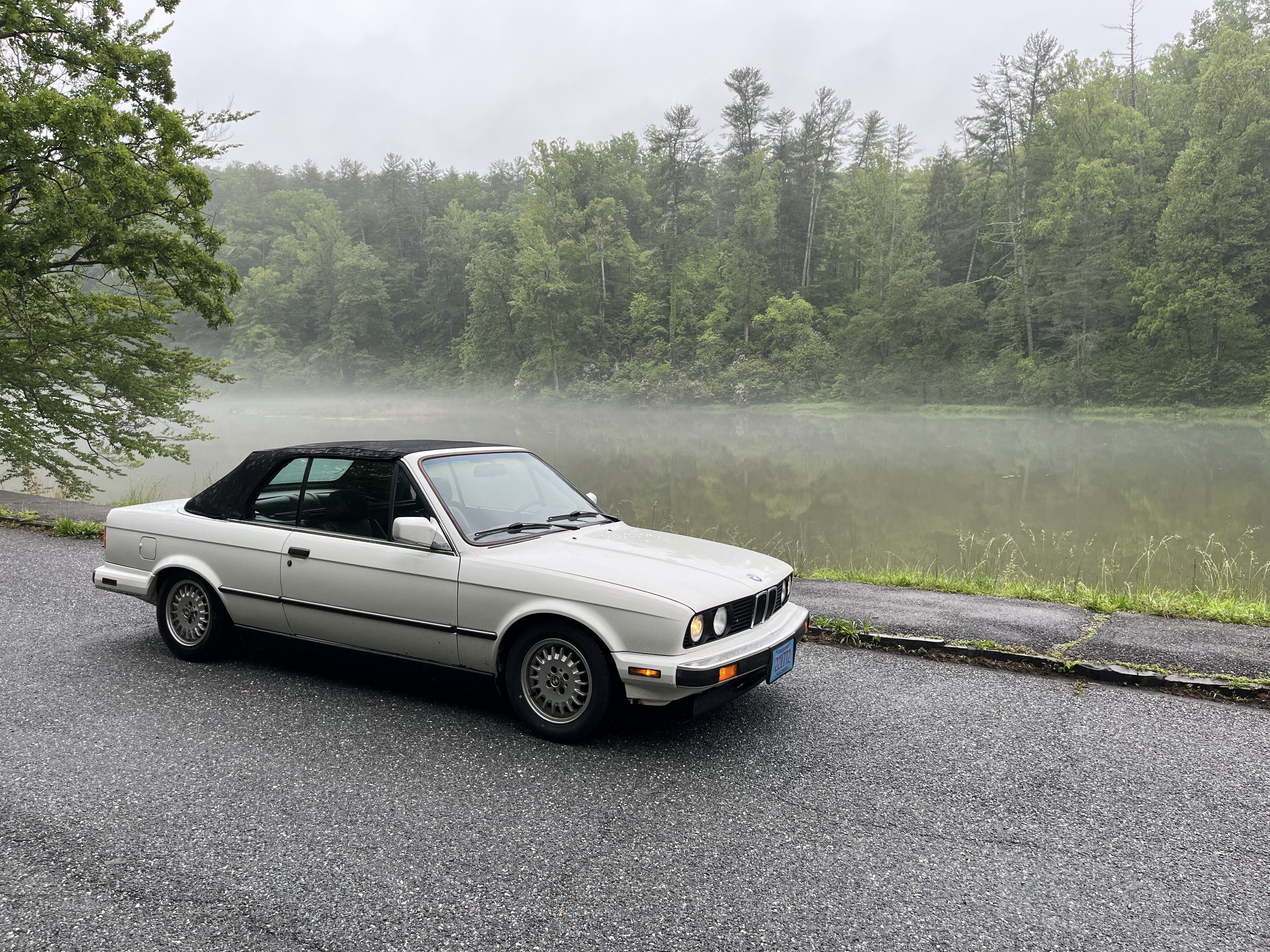

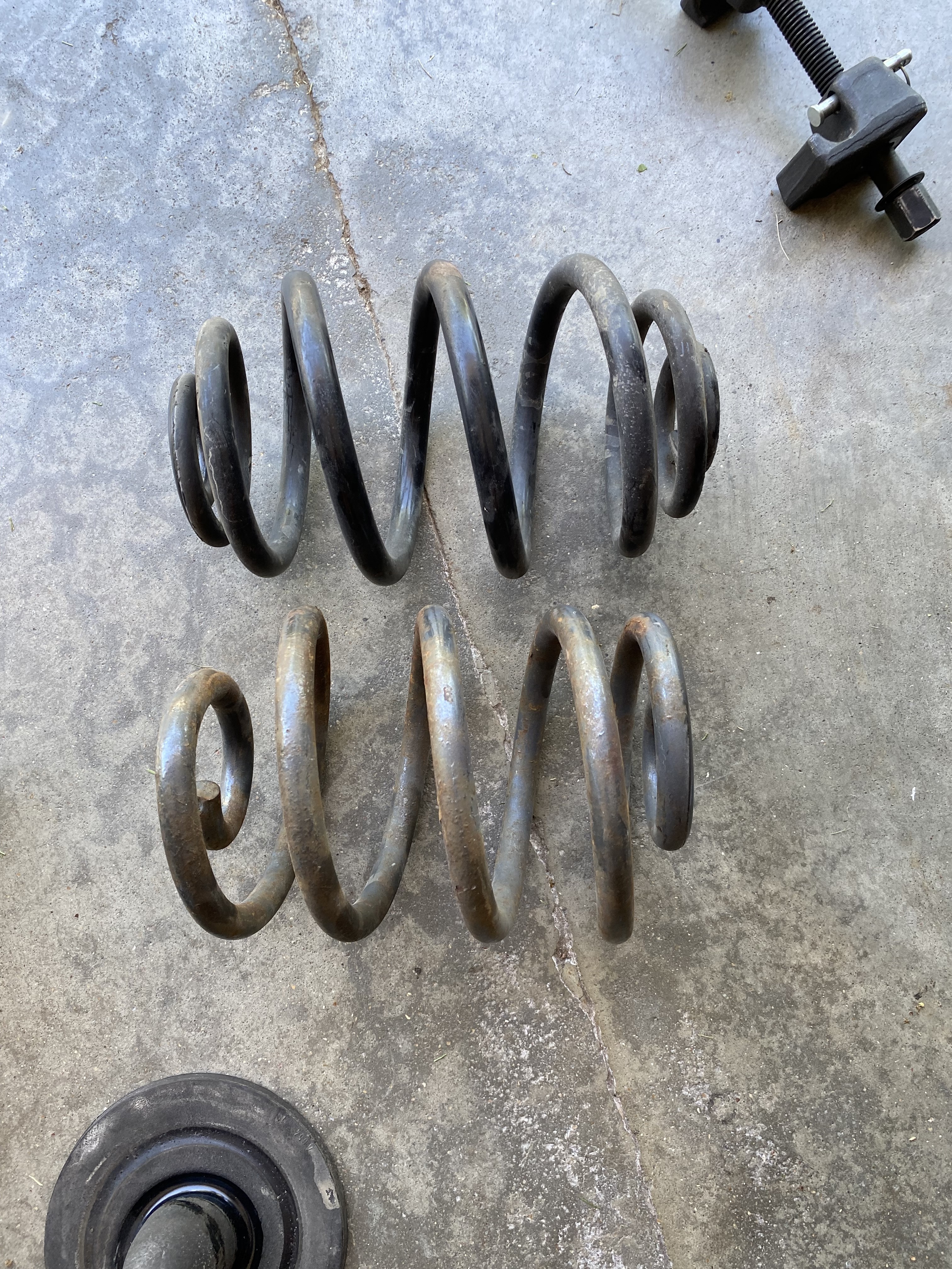

        Recently rolled past 201,000 miles. I haven’t been driving this as much as I should, but I haven’t been keeping it at my apartment and time to drive it is not as available as I’d like.
        About a month ago I installed the lowering springs and sport shocks I picked up from @timmer at the e30 picnic (thanks again!), and I’m really digging the new height and ride.
        4C8E25FA-53AC-494A-886F-4CB5DE395D72.jpeg1B66E78F-7063-4C7A-B64A-E1962DECC7BD.jpeg3157BB7C-10D3-4552-8222-2CBDDE73BCDC.jpegF683A48C-F180-4BC9-96E5-0F0817554529.jpegAA9994D8-33FA-48A3-BCF7-8DADC6FE806F.jpegDefinitely firm, but not overly harsh or bouncy and very go-kart like. It’s a blast and so responsive, but I’ve been struggling with how low the oil pan now sits (truthfully, most of the reason I haven’t driven it much) so I decided to grab a skid plate from HIKFab thru bimmerworld along with a muffler hanger kit and some fresh front wheel bearings. If anyone here is capable with a welder and would be willing to install the skidplate for me, I would happily compensate you for it.
        All that stuff will go on in a few weeks, and I’ll be (hopefully) back and ready to go for peak driving season. Then, it’ll be back apart for a new fuel tank, manual trans swap, diff swap, and subframe bushing replacement this winter.

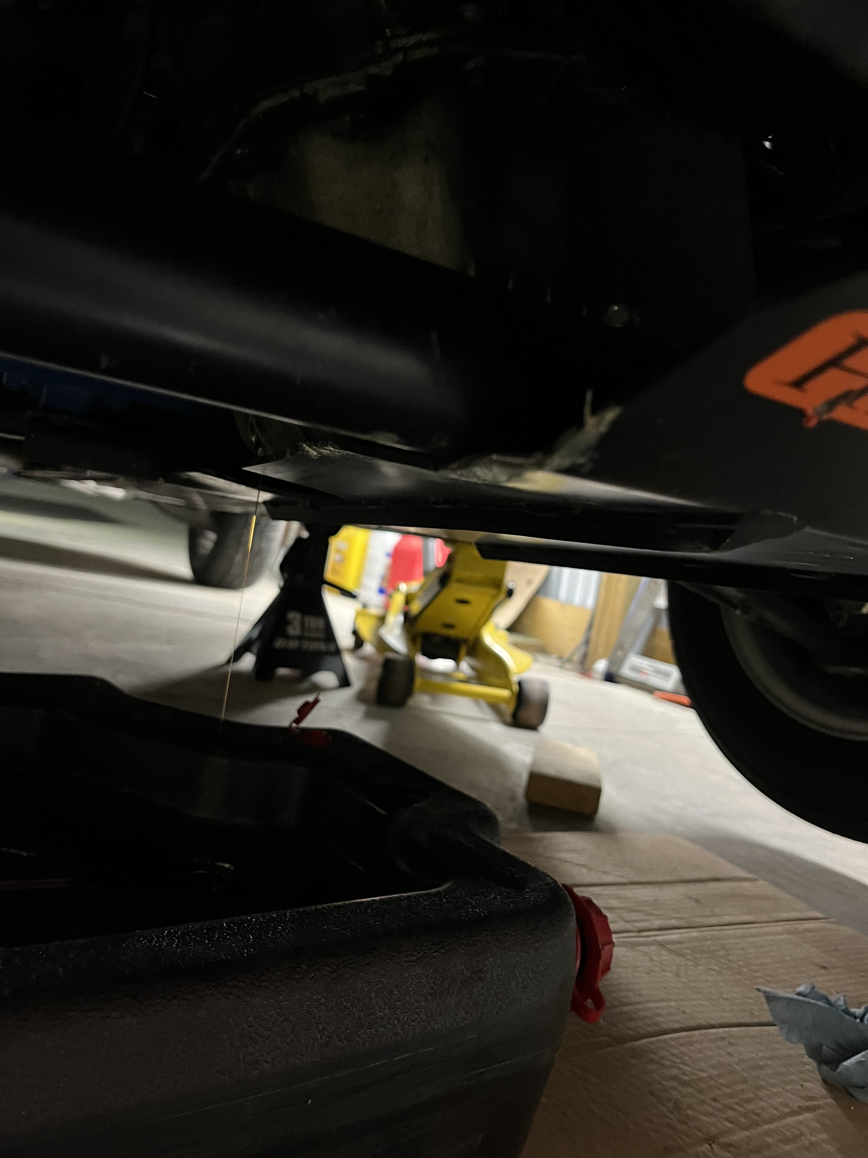

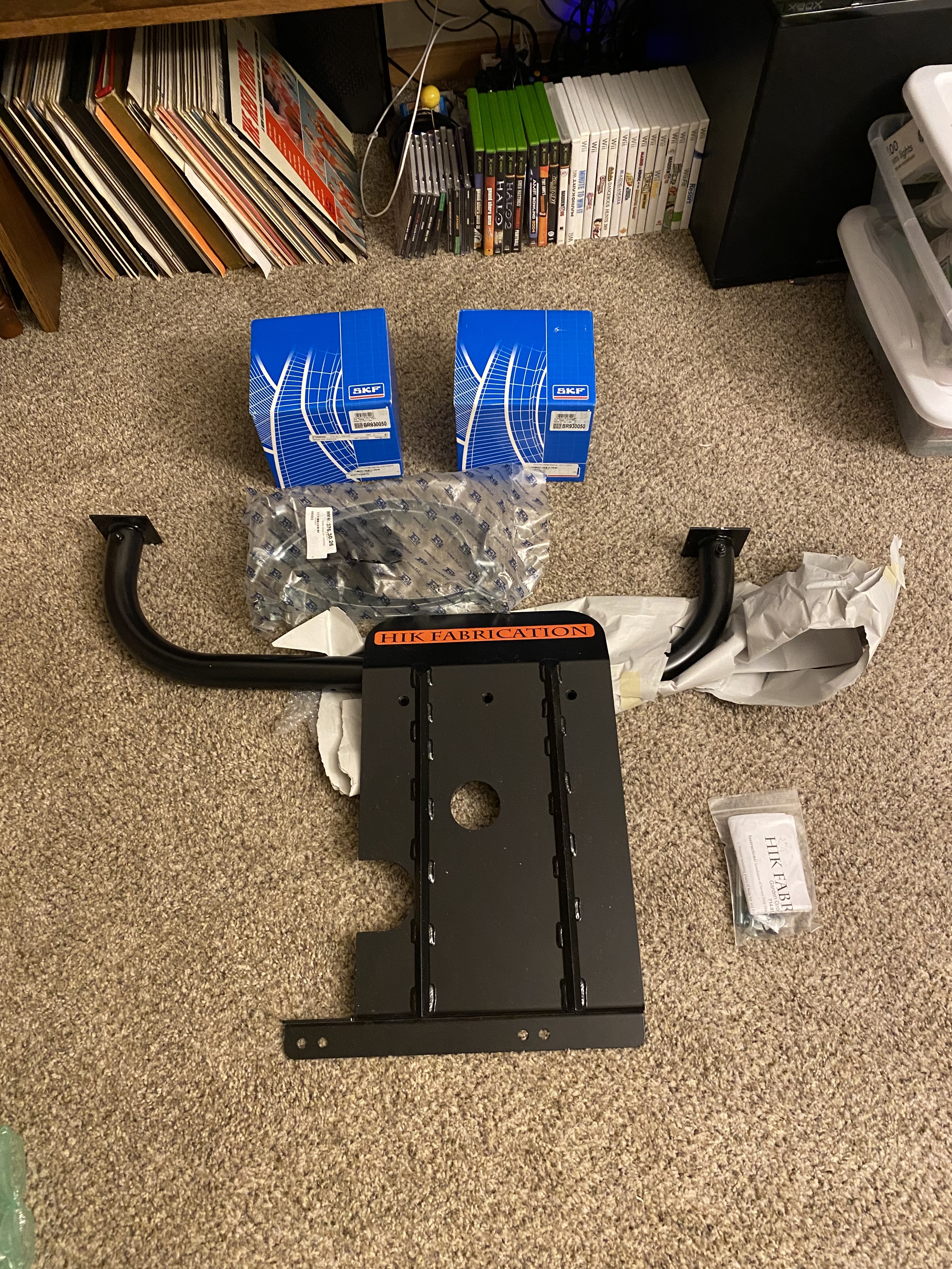

          For oil pan protection I went down the route of:
          1. Cross-brace - https://www.garagistic.com/collections/e30-performance-parts/products/garagistic-e30-x-brace-cross-brace
          2. Skid plate - https://red46.net/bmw-e30-skid-plate-sump-armor/
            I’ve always wanted to try an X-brace to see if it would tighten up the car a little bit, maybe I’ll get one after the skidplate is installed and see if it fits. Did you notice a difference? If they won’t work together, I might try my hand a fabricating my own brace around the plate.
            Right now the oil pan protection is a higher priority, with how much driving I do on broken pavement and unpredictable surfaces I need to have that peace of mind. I wince every time I drive over a large pavement heave or even a slightly protruding manhole cover now, and that sucks. I don’t want to have to care as much and just drive the damn thing.

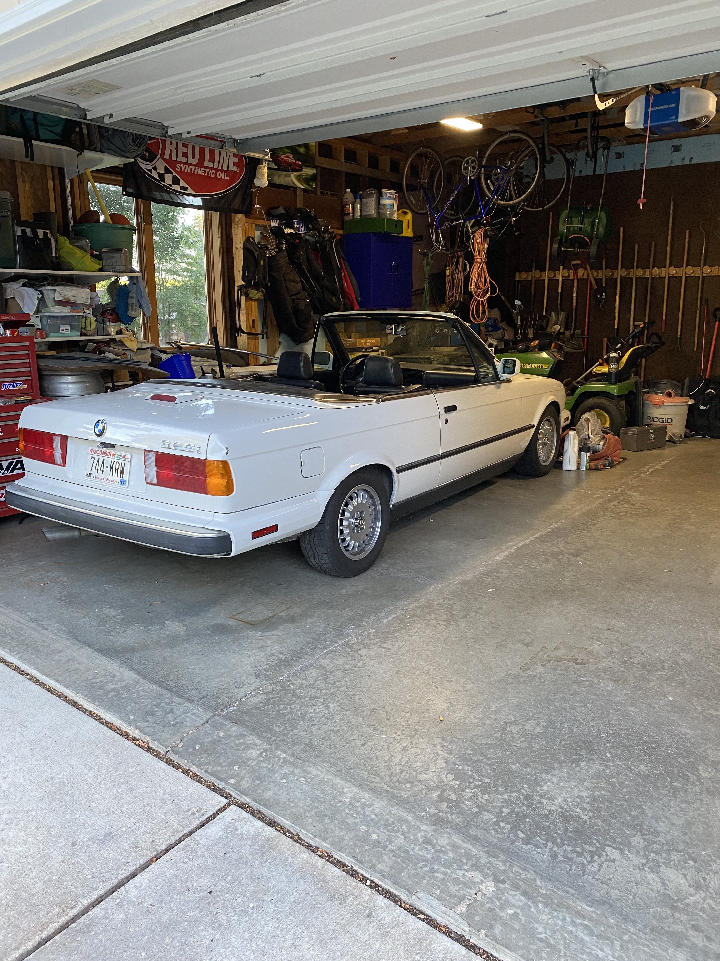

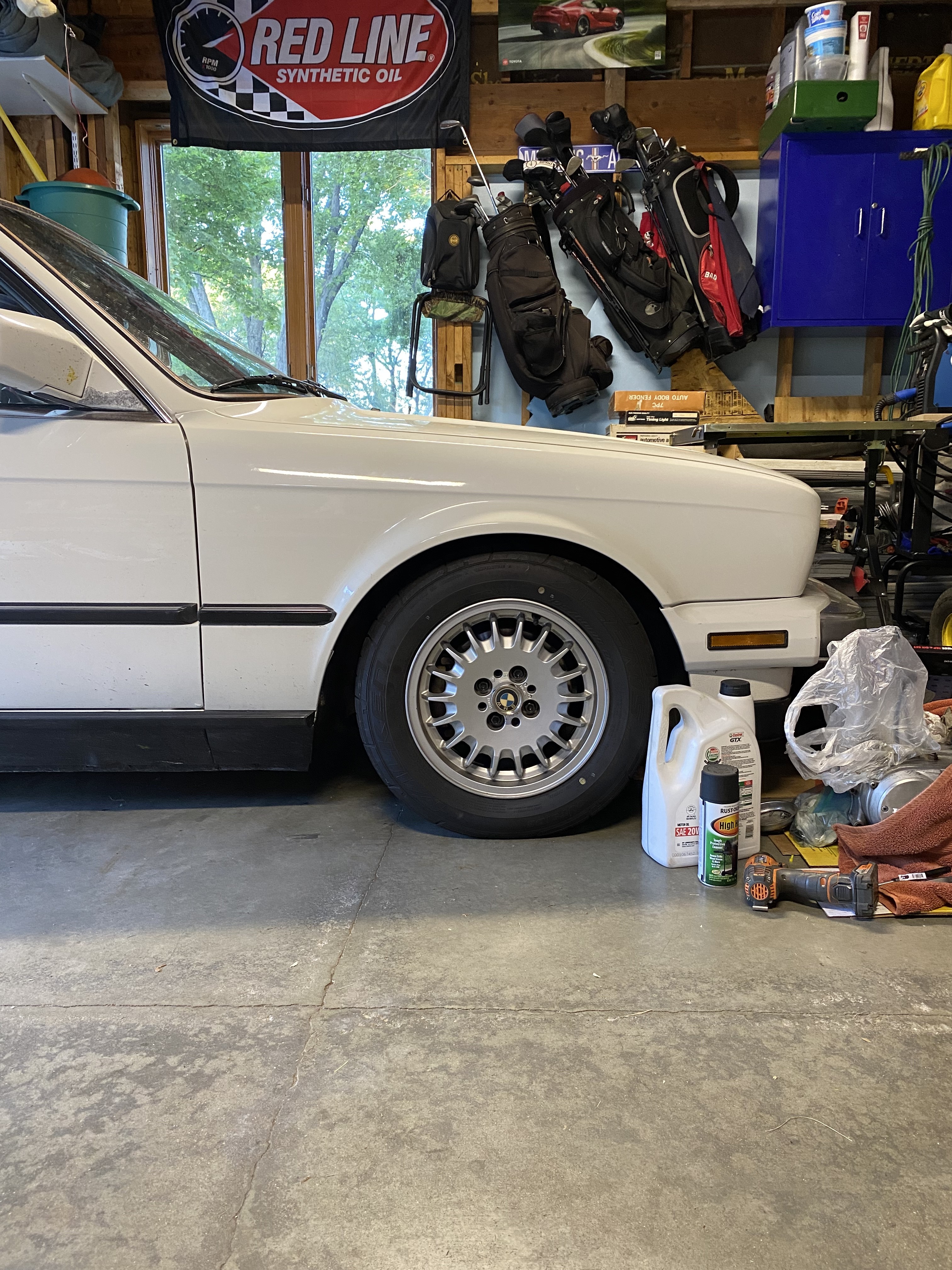

                #107
                New ride height looks perfect!
                Speaking of, if anyone has a lead on garage space or a decent storage facility that is preferably in the greater MKE area, let me know. I can make Madison work too, but the closer to Pewaukee the better. Heated and with electric would be a plus, but not necessary. Would rent year round and use for storage and wrenching.
                Speaking from experience, the farter away from the city you can be the better. You'll find much bigger options for a lot less money if you can be out of the Milwaukee metro area. Small shop spaces like two car garages and such where wrenching is allowed are out there but it takes some searching. I found all three of my rental garages through craigslist, so that or marketplace is probably the best bet (if you can wade through all the crap on there).

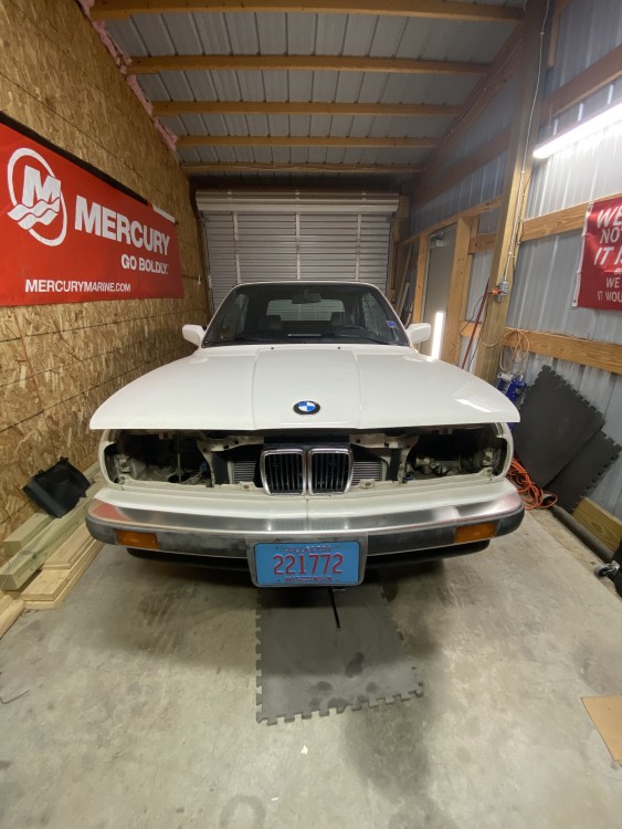

                          I really suck at taking photos…
                          Subframe is completely removed from the car as of today. Getting the aluminum sleeves of the bushings out of the body was a struggle, the drivers side wouldn’t budge using the standard lag bolt and 1/2” rod method, and I ended up snapping the top section of the sleeve off inside the bore in the body. 5 minutes with the trusty Milwaukee die grinder and the broken piece was out, and the other sleeve eventually popped loose after driving in the lag bolt and hitting the bolt head side to side until it released from the bore. Had a heck of a time getting the subframe down off of the driveshaft as well, but it’s done, and now the real fun can start!
                          I sourced a full manual swap kit already, hoping to get it within the month as the guy I’m buying from has yet to remove it from the parts car. I’ll be getting the stock single mass lightened and resurfaced before install, does anyone have firsthand experience with a good target weight and local shops to have the work done at?
                          Otherwise, next items on the list are installing the new subframe bushings and diff, pulling the driveshaft, exhaust, and fuel tank, and then the trans can come out. Hoping to get to that later this week or this weekend, we’ll see how things go. I’m generally just excited to be making progress, my goal is to be finished in early April so I have a solid month to shake the car down before heading to NC in late May.

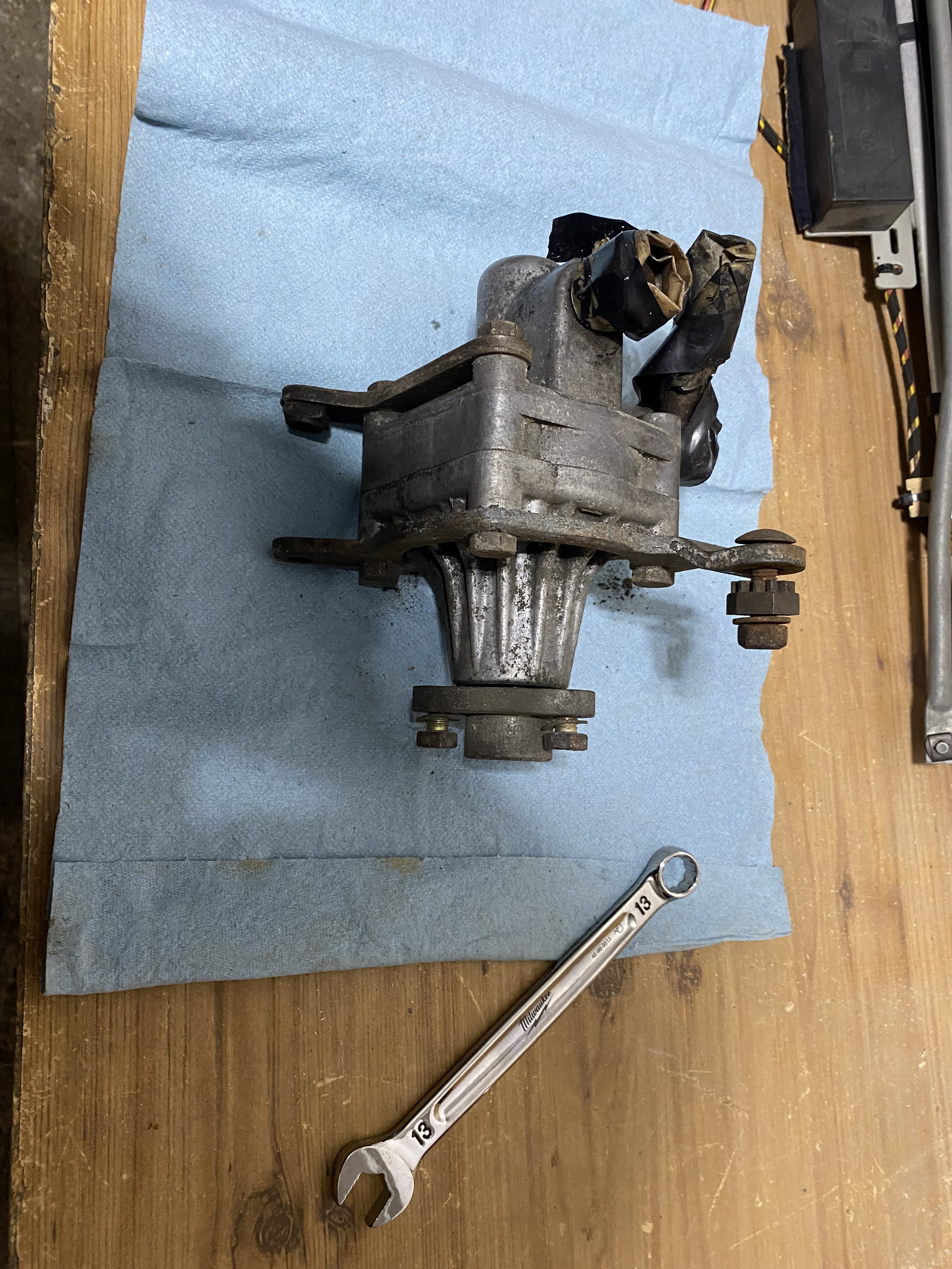

                                    Slow progress is still progress! Work has been nuts for me lately, but I found some time today to get out to do some work on the car. Managed to get the diff disconnected from the subframe (confirming in the process that the existing diff is FUDGED), and got the old subframe bushings out and the new poly ones in. I knew the diff had a shot I out bearing, but upon turning the output flanges it appears that the gears or bearings in the carrier are roached, it’s super chunky and has a lot of resistance to movement. Kinda curious how much fluid is actually left in it, but not looking forward to the smell when I find out.  Should make a good welded diff at any rate. Old crusty stuff:
                                    New nice stuff (including the 3.73 LSD I bought from @rampelsauce:
                                    Thanks to @YoungCR, I had the correct tools for the job, the right puller made this pretty pain-free. I used a torch to heat up the bushings from the outside and just applied force with the pusher until they popped out. One bushing was pretty cracked and deteriorated but stayed in one piece, while the other was completely torn in two. The new bushings should make a huge difference after seeing that, and thank goodness for the easy install of poly!
                                    I can’t remember if I updated here, but I picked up a full manual swap a few weeks ago from a local guy. I ended up paying more than I thought it was all worth especially considering condition, but I really want to get this back on the road quickly so sacrificed had to be made. I discovered however that the driveshaft u-joints were borked after I got home that night, and thankfully after some coaxing the seller gave me a refund on that (sold it all to me as good-condition, working, no issues with anything for a price that reflected it, so I was I think justifiably a little upset about it). So I’m still looking for a good g260 manual driveshaft if anyone has one laying around. And before anyone asks, yes, I’m planning to reseal the G260 before installing. Seller claimed that it shifted well and didn’t suffer from any grinding or gear pop-outs, so fingers crossed that’s actually the case.
                                    Other random news: scored a console with a Husco armrest for $10 the other night along with some sweet e34 parts, excited about that! It needs the cover replaced but I believe replacements can be sourced; otherwise, I have family that does upholstery so I could potentially go that route too. (E34 parts were rear headrests and a power rear sunshade if anyone cares)
                                    Next on the list: Drop the exhaust and driveshaft, then pull the fuel tank and replace. Then, it’ll be on to removing the trans and starting to put things back together.

                                      Any plans to replace the clutches in the diff while it’s out?
                                        #119
                                        Edit: ignore me on the diff studs I see them now lol
                                        No plans as of right now. I plan to check breakaway torque while it’s out, and if it’s poor I’ll drop it and rebuild it later. I truthfully bought it more for the ratio and overall condition, and I really don’t need to spend more time/money on it right now when there’s so much else to get back together. Now that all the fasteners are fresh it should be relatively easy to drop if needed.
