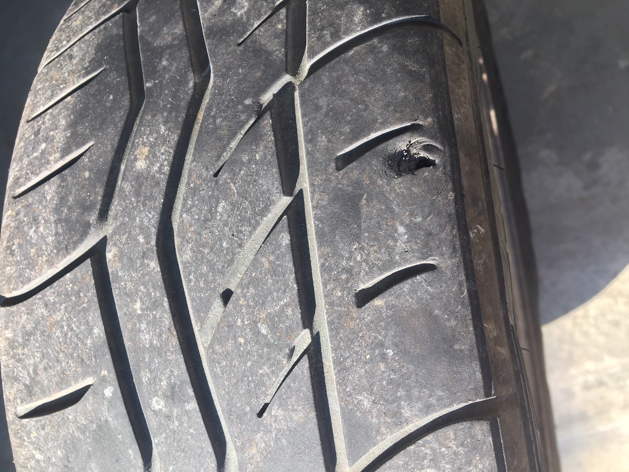

                    199,390 miles:
                    Ran over a bolt or something on the beltline in Madison today and got a flat, it's too far to the outside of the tread to get a plug so I have a pair of RT615k+'s arriving Tuesday from tire rack. I know I should probably replace the whole set instead of having tires with different amounts of wear on the front and rear, but it never gets autox'd or driven in the rain or anything so I'm not gonna worry about it too much and save the money. I'll also be swapping the good takeoff tire to the spare wheel, it has an original 30 y/o Michelin MVX marked with "Made in West Germany" on it now, it was not a fun experience driving on it and wondering if it was going to randomly let go.

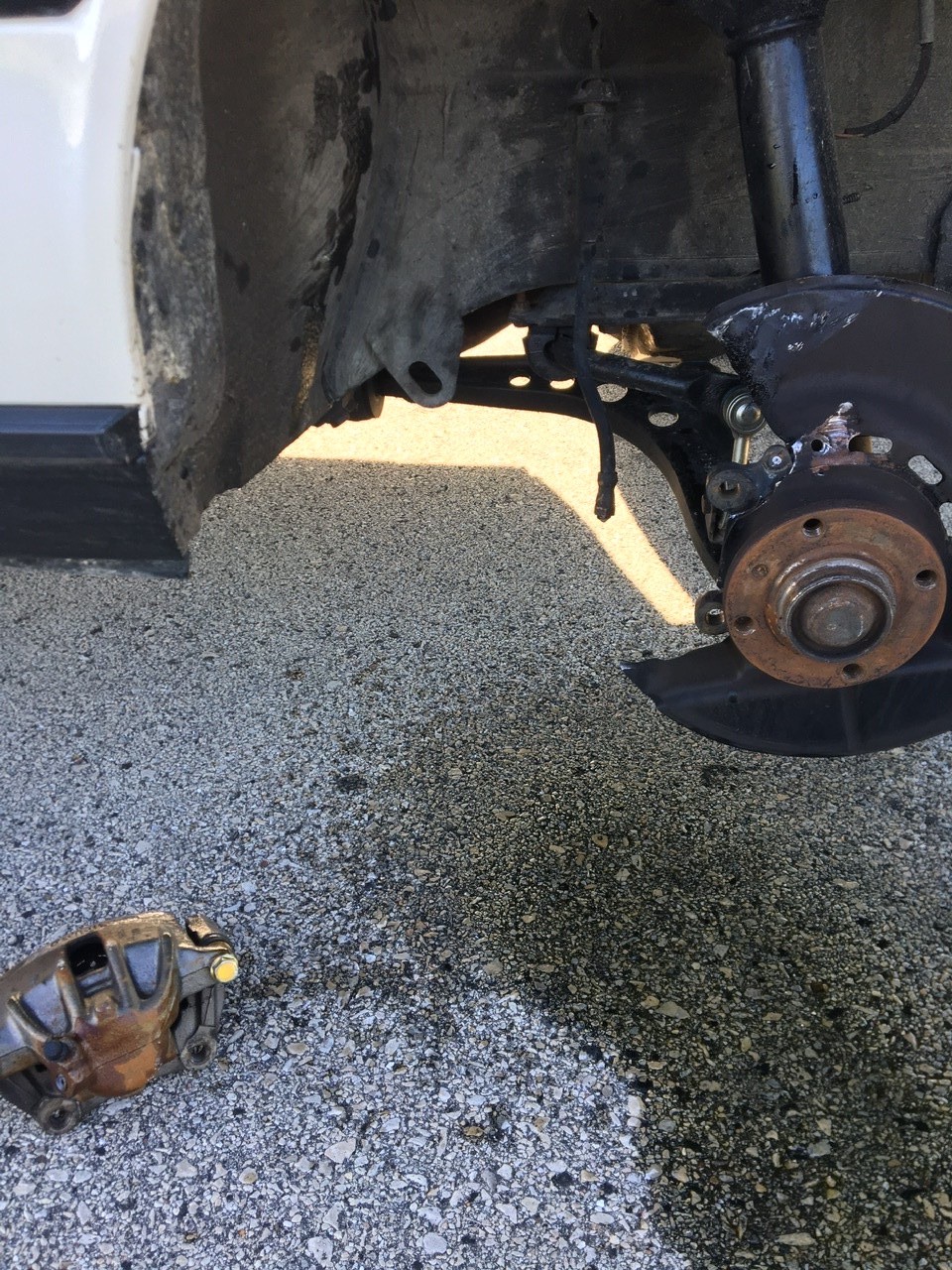

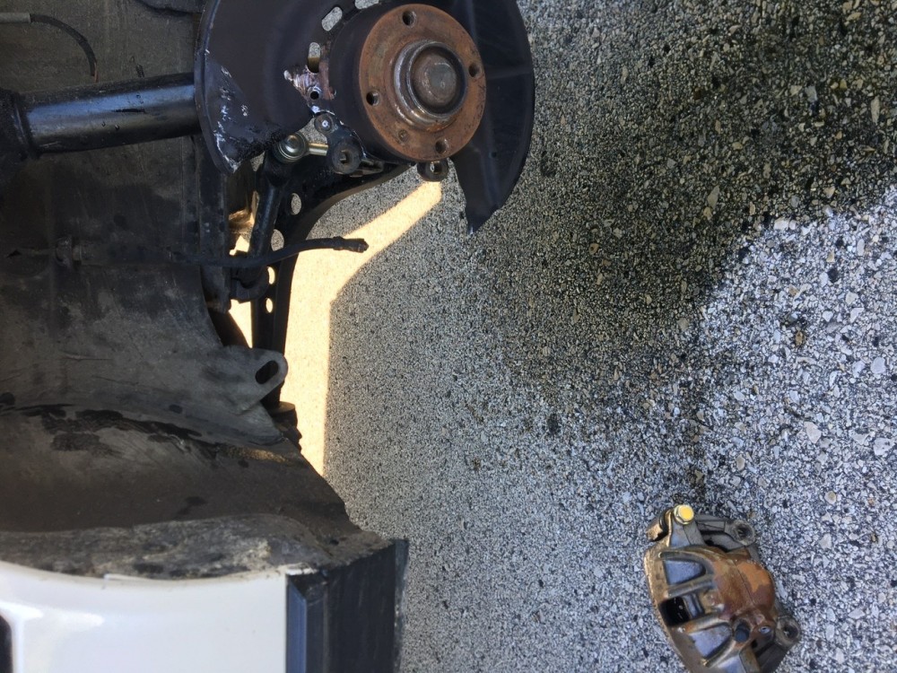

                                    Guess I’m not going to the brew city cruise night. I was around 5 minutes away, coming down the off ramp when this happened, pedal went to the floor but I was able to pump it up enough to stop. Looks like both caliper bolts came out somehow, mangling the brake shield and shearing the soft line. Got REALLY lucky with this one. Could’ve been a lot worse.

                                      Dual circuit masters and an emergency brake can be a real lifesaver. Glad you’re alright
                                        Thanks, me too. Could’ve ended a lot worse. Definitely taught me the importance of loctite.

                                          Glad you're ok! Easy fix if your soft line comes off on the other end.
