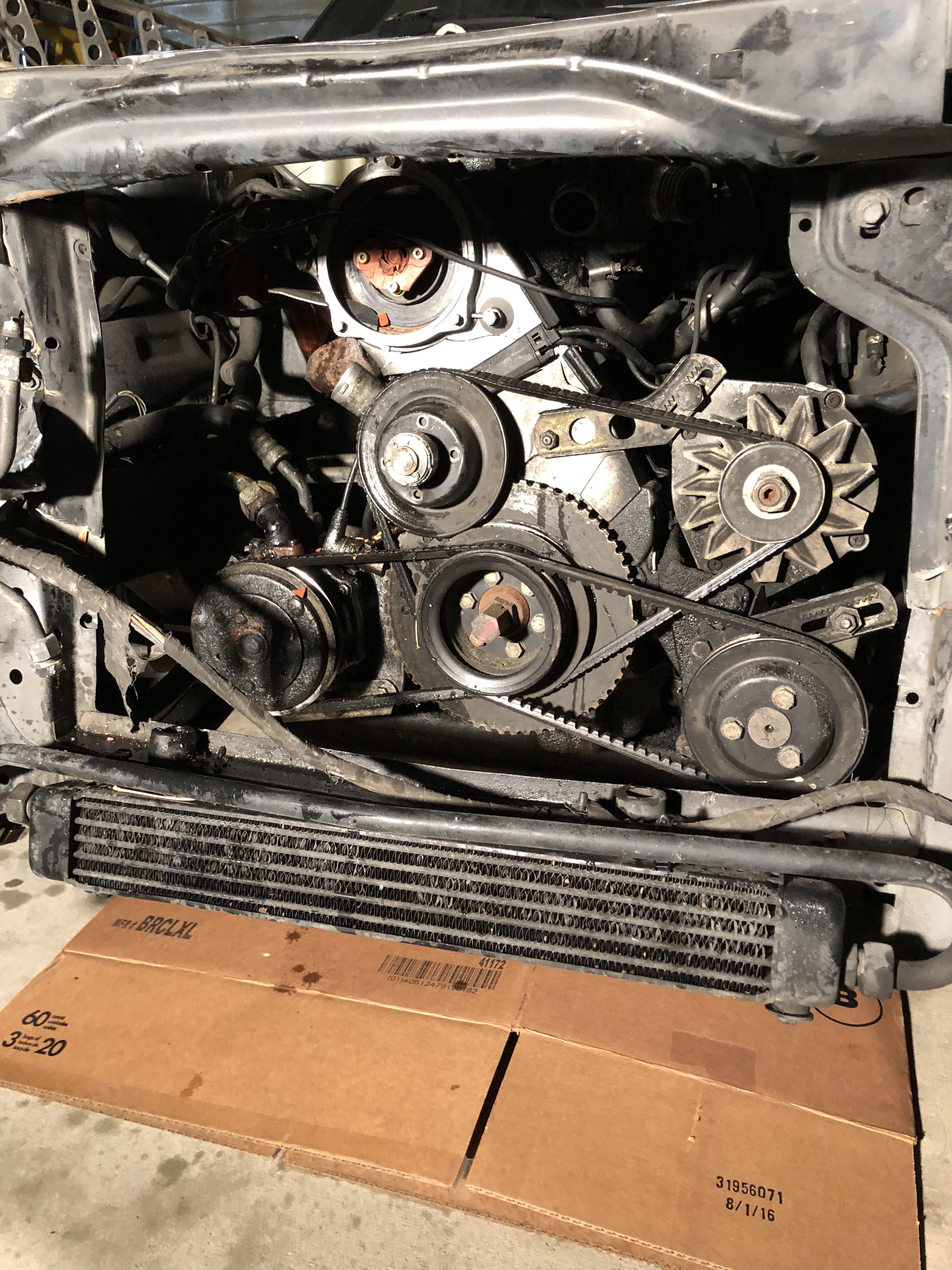

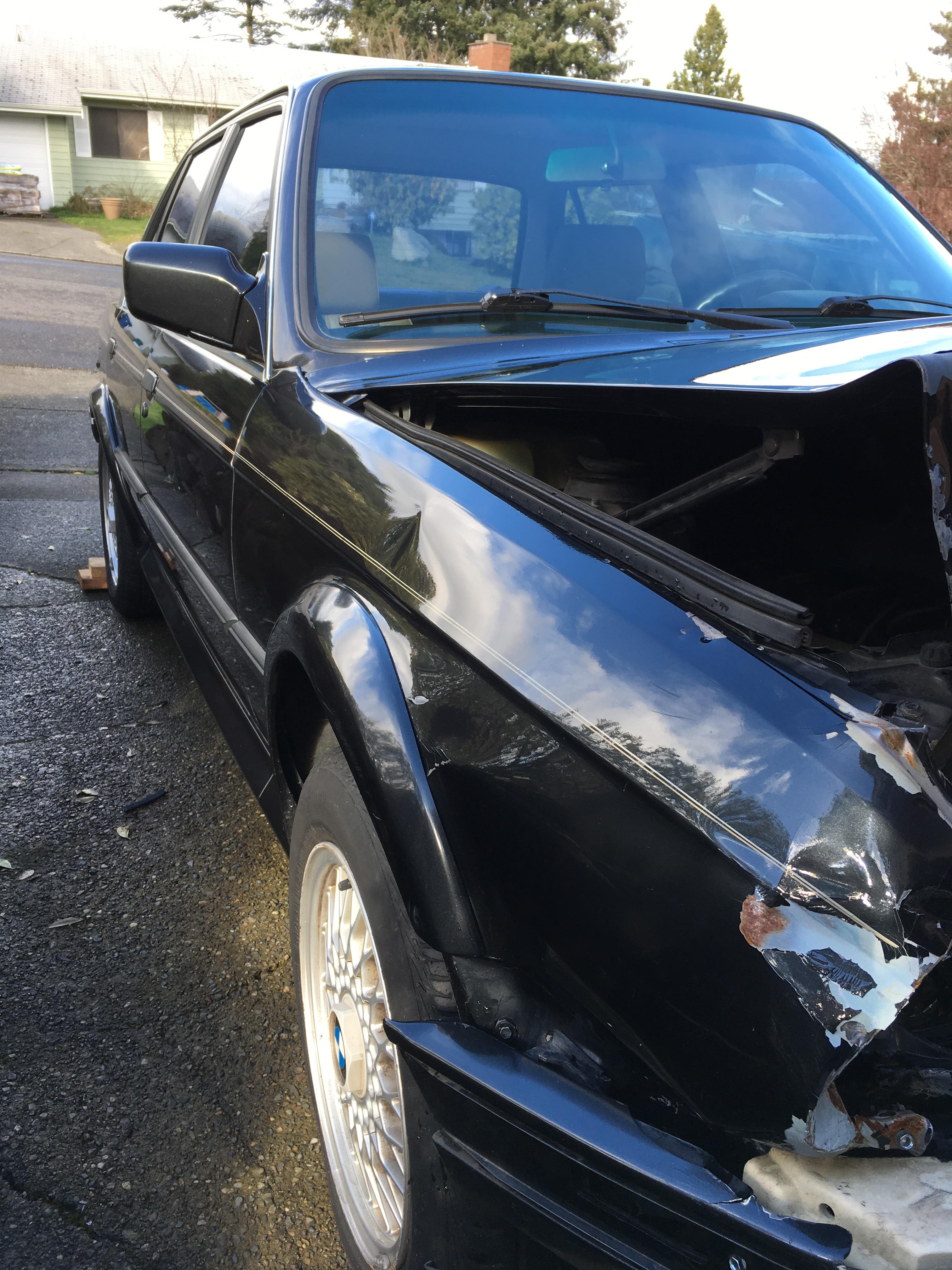

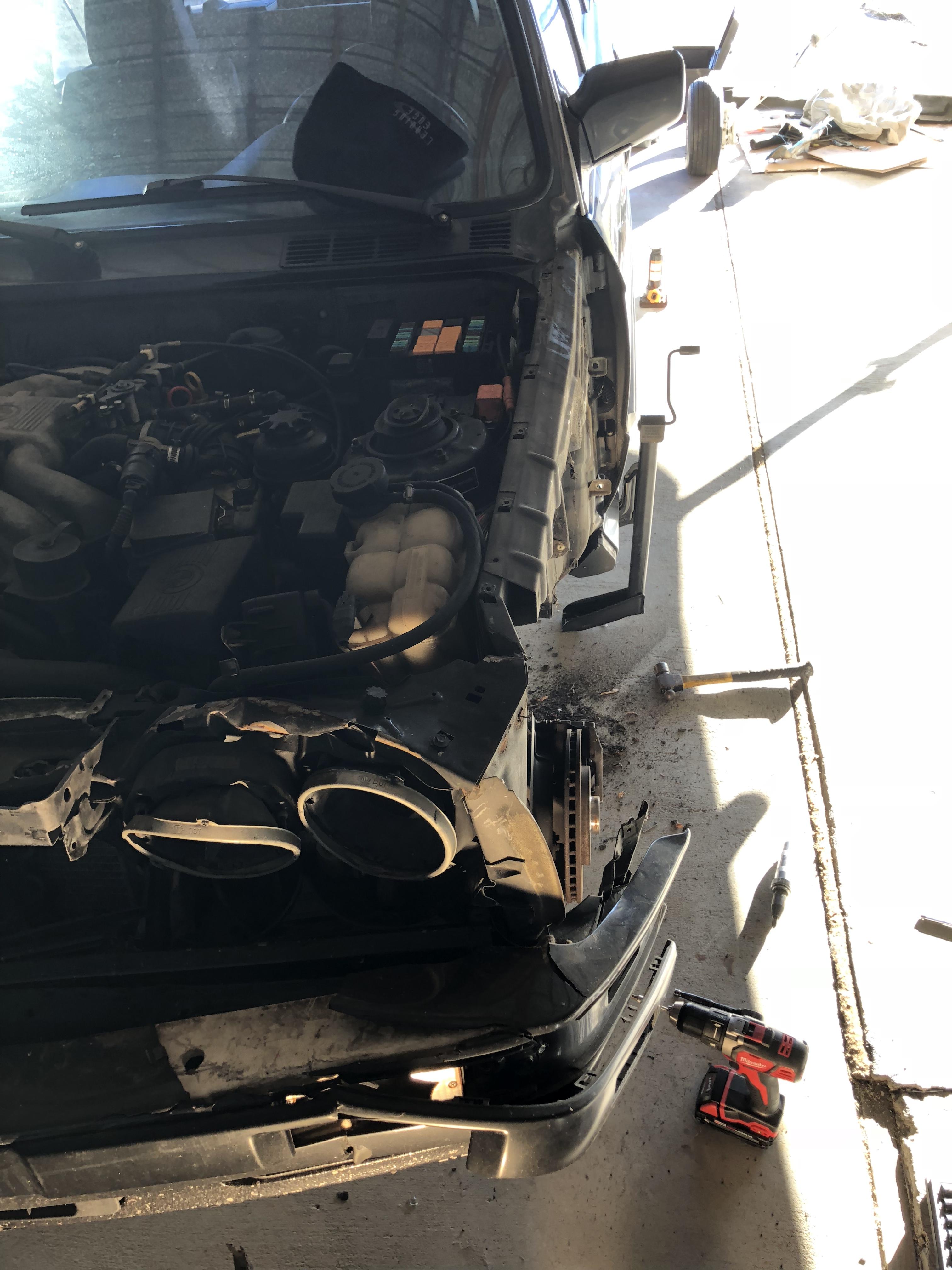

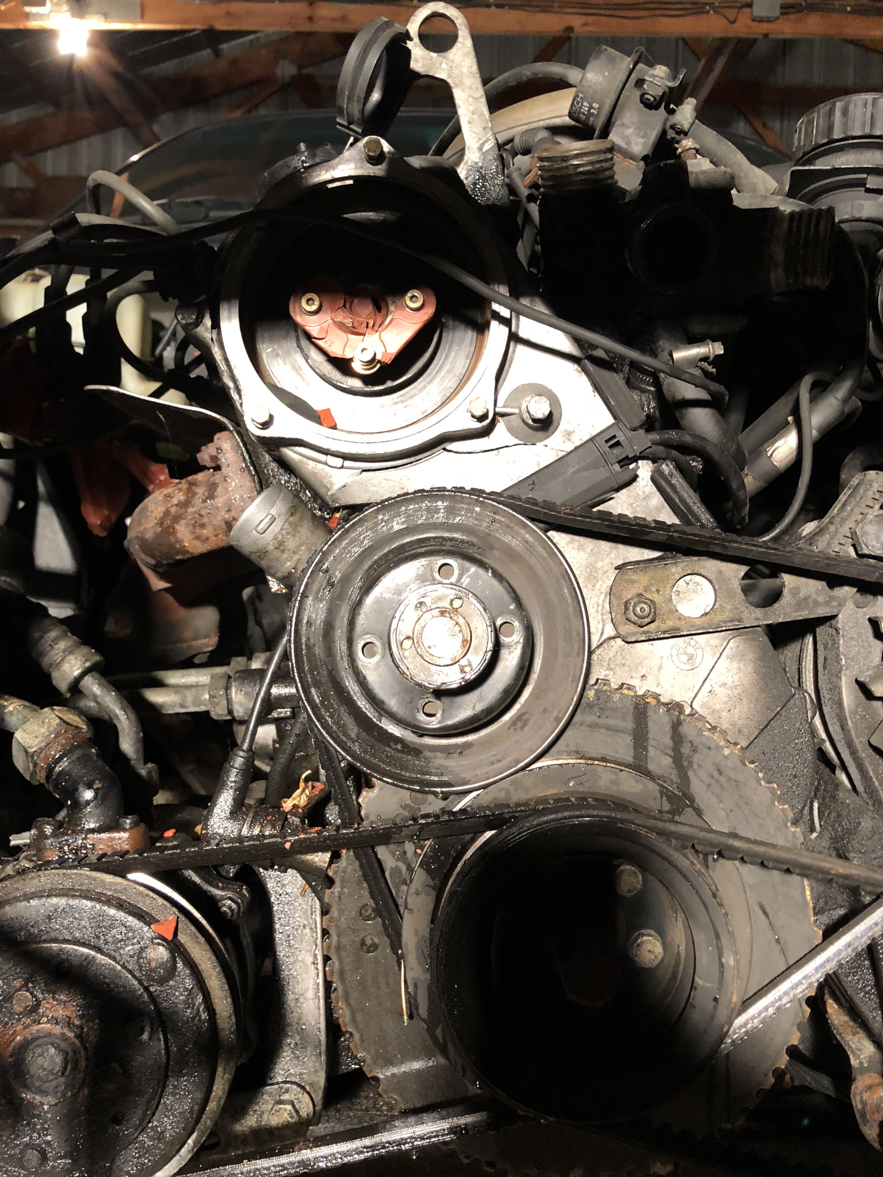

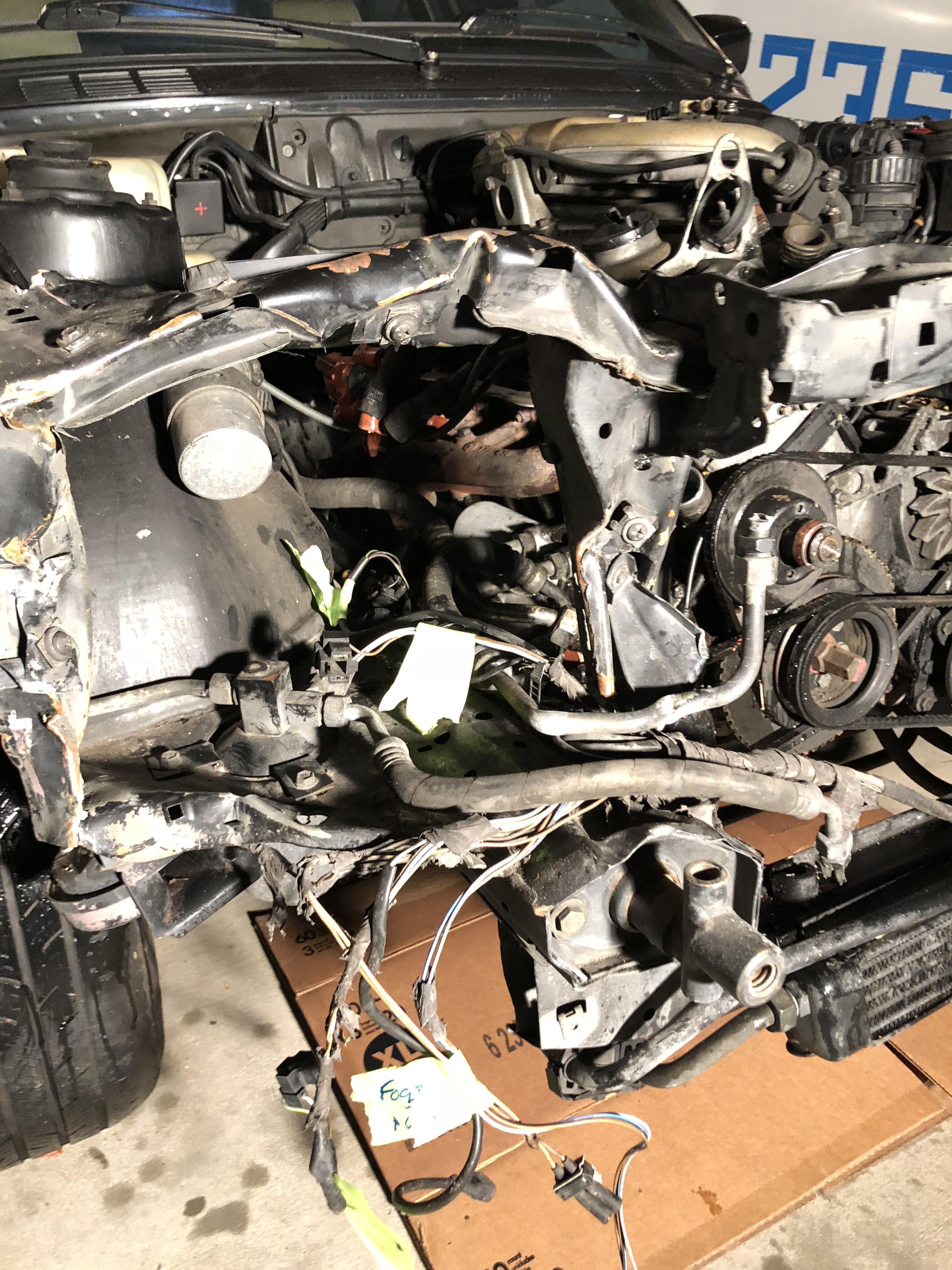

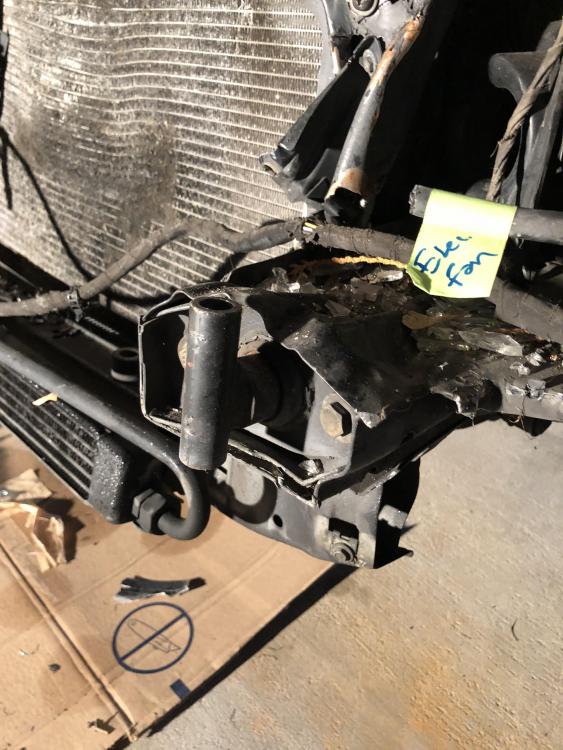

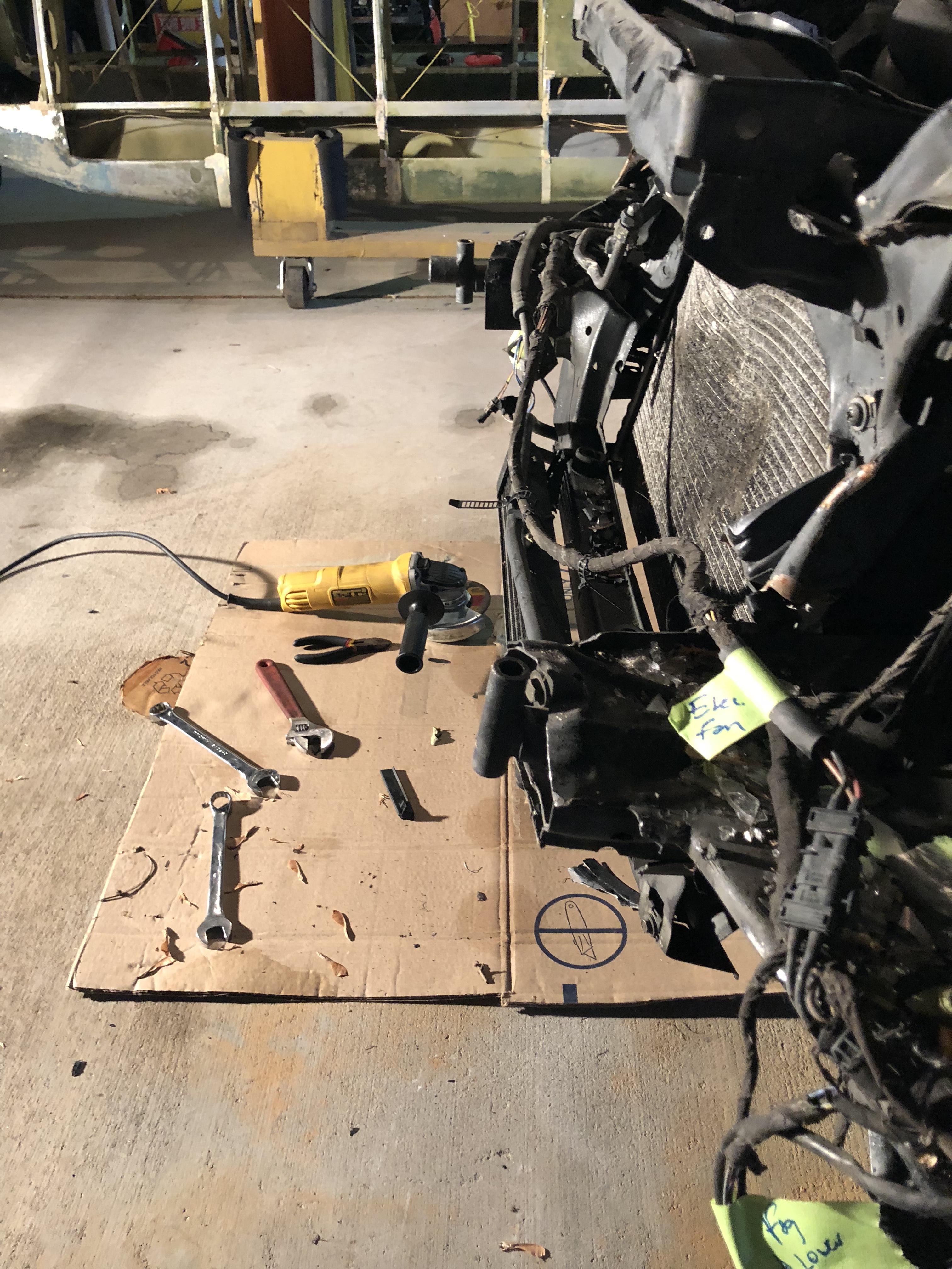

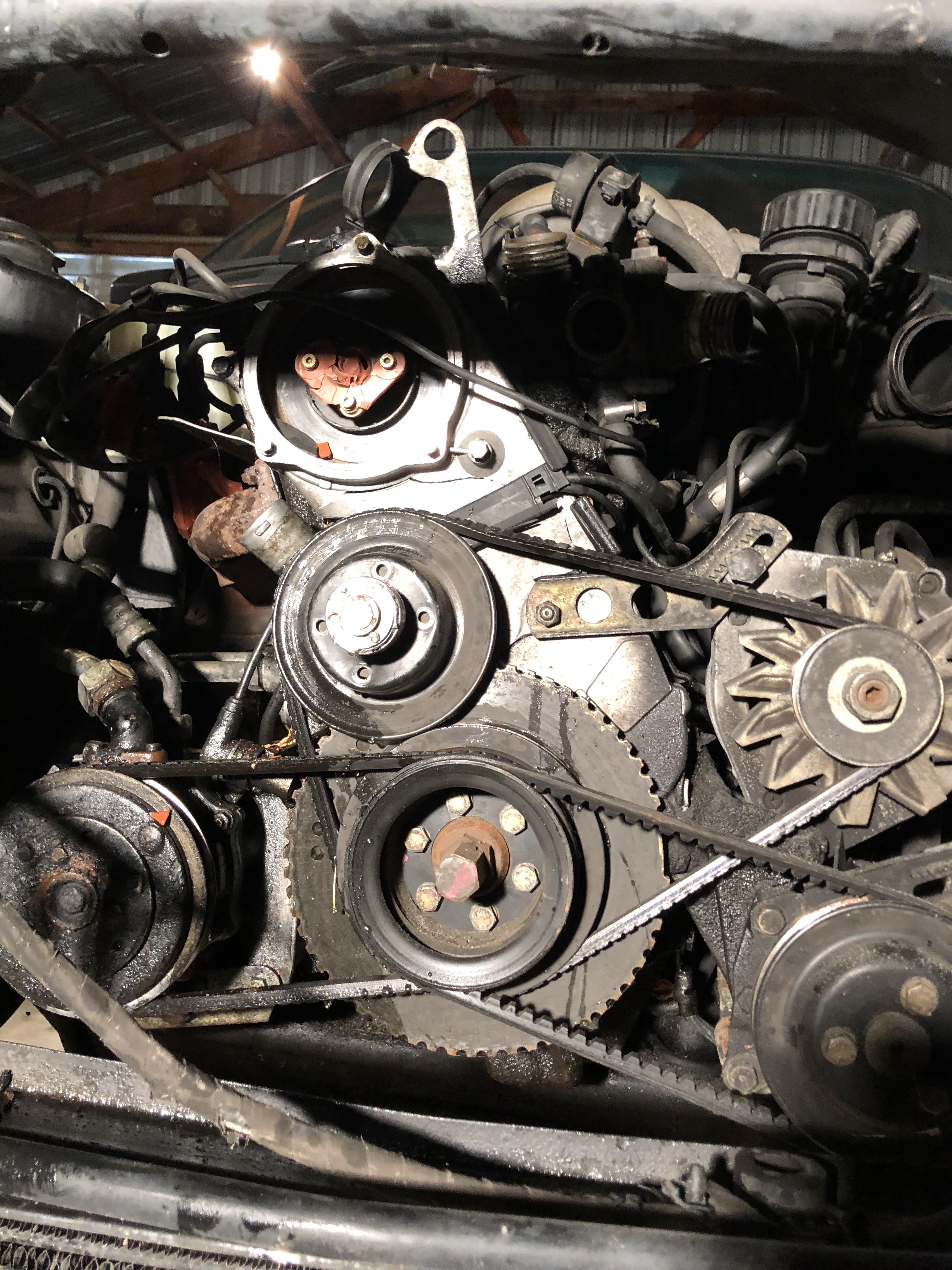

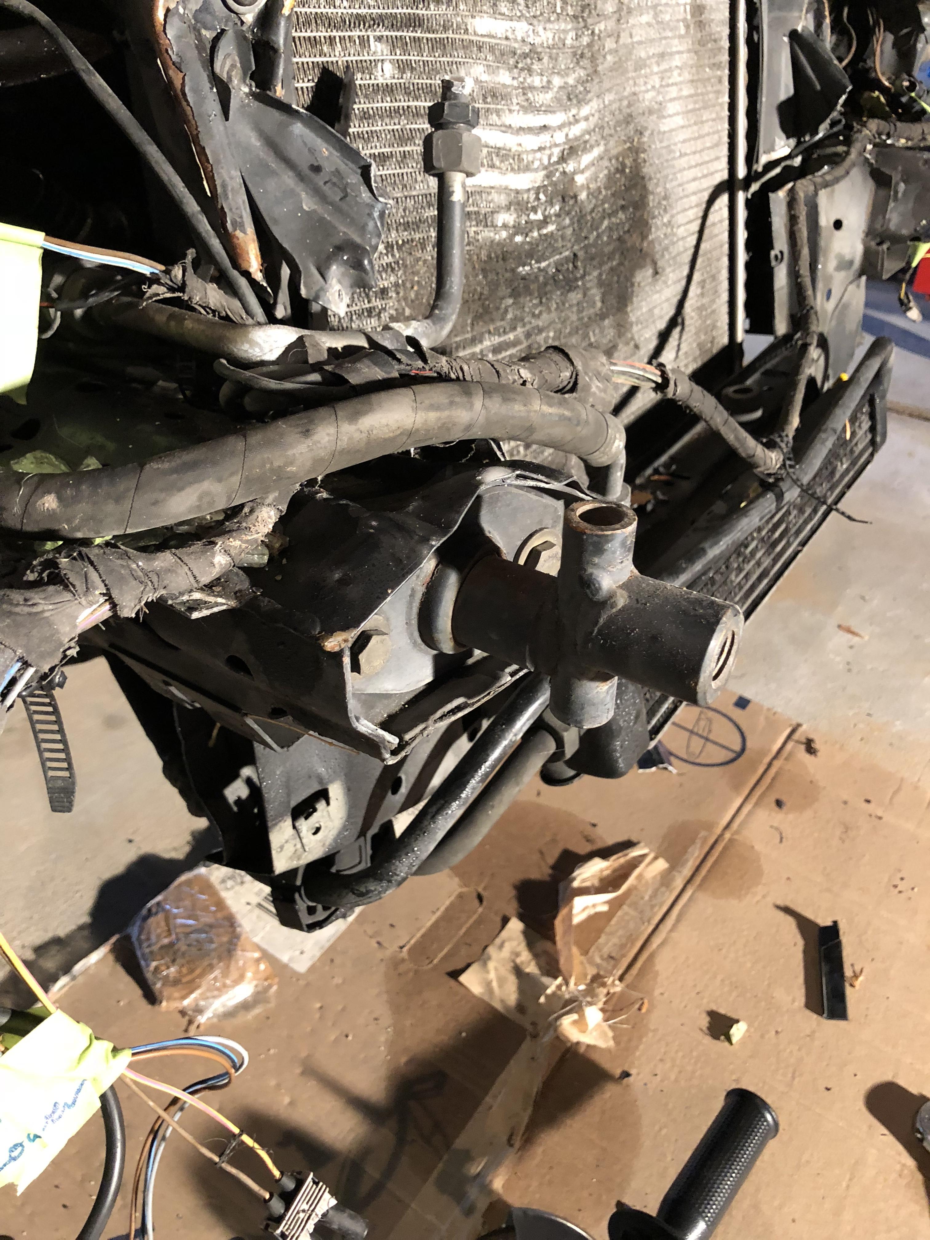

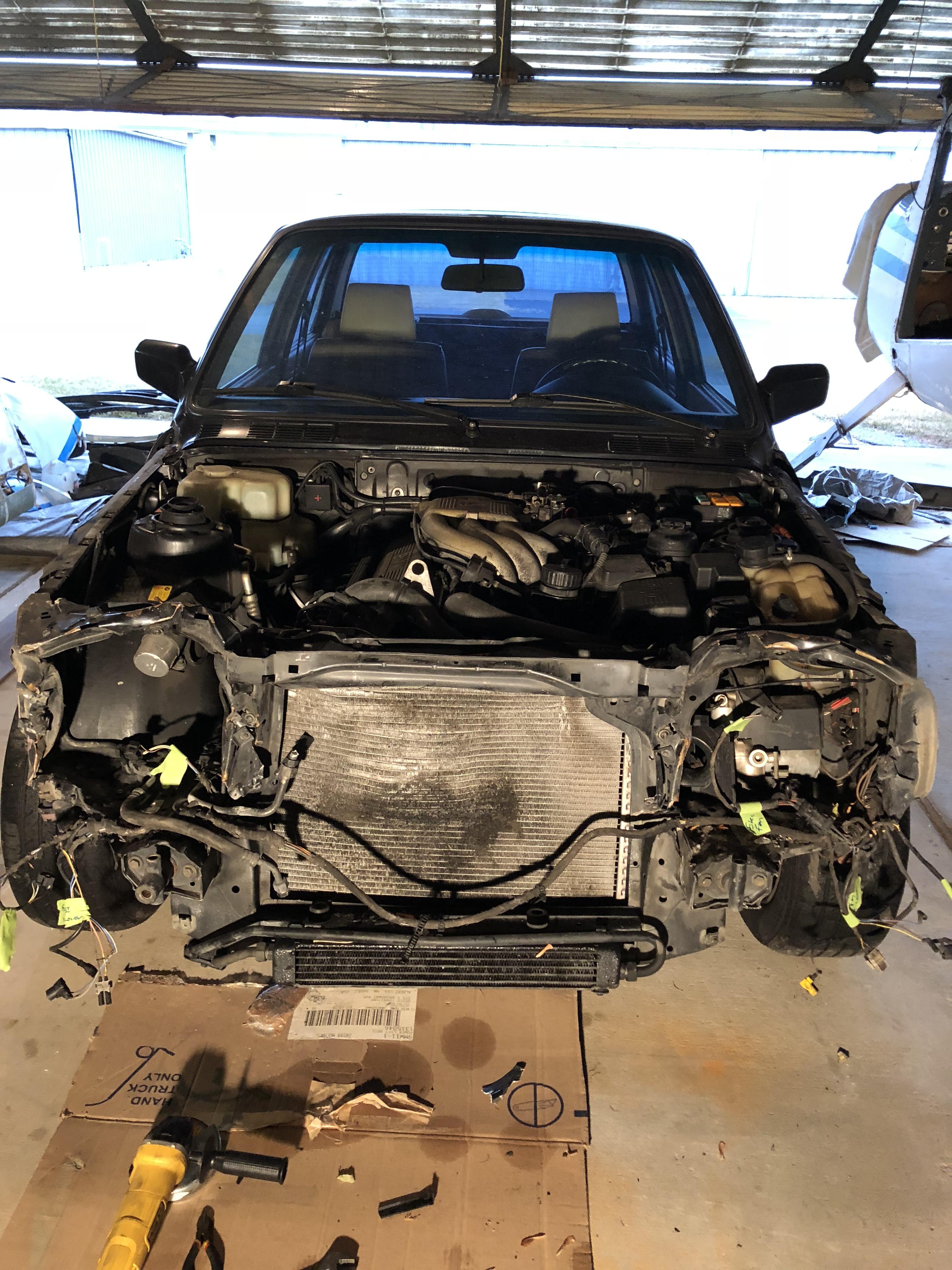

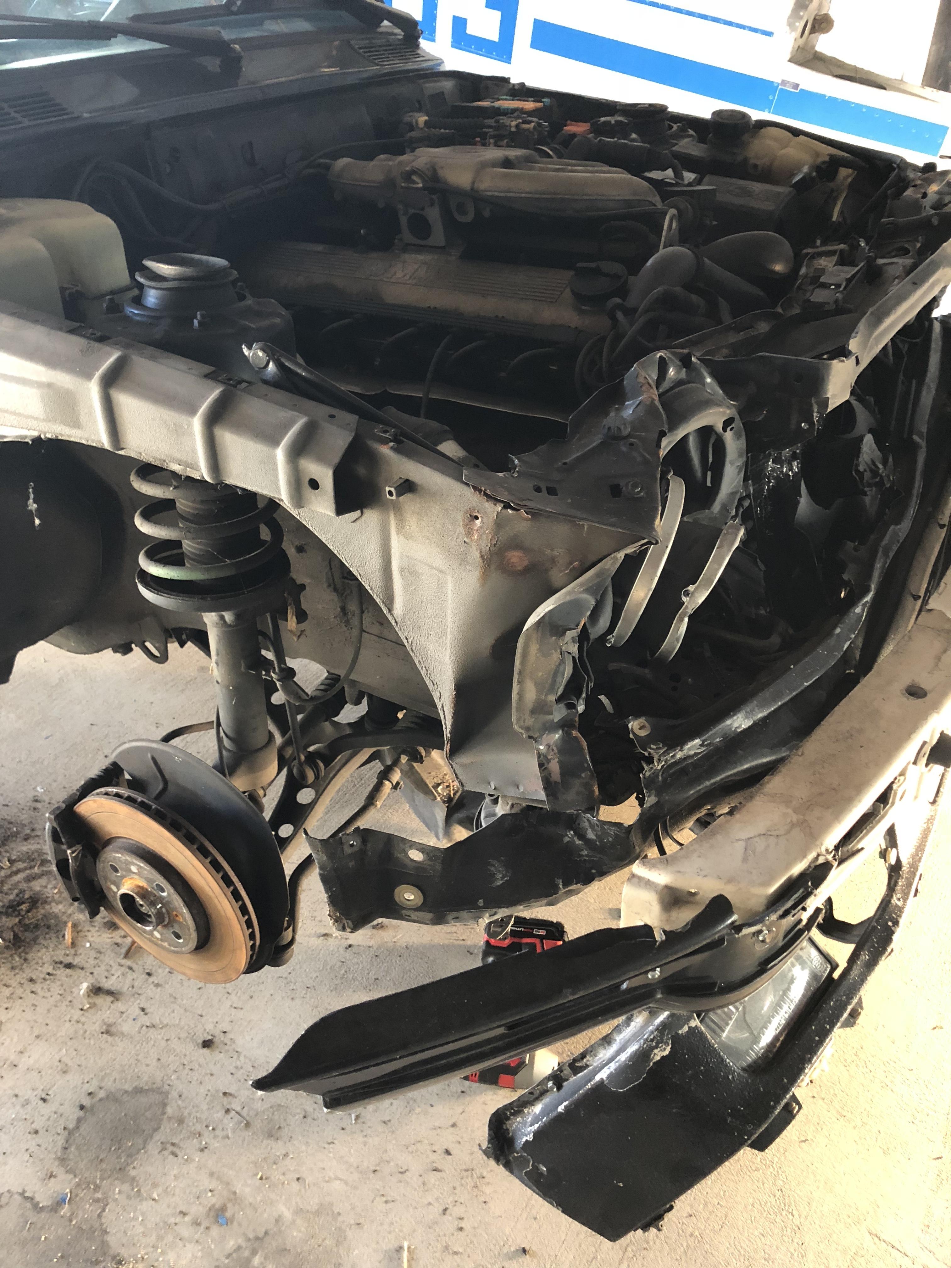

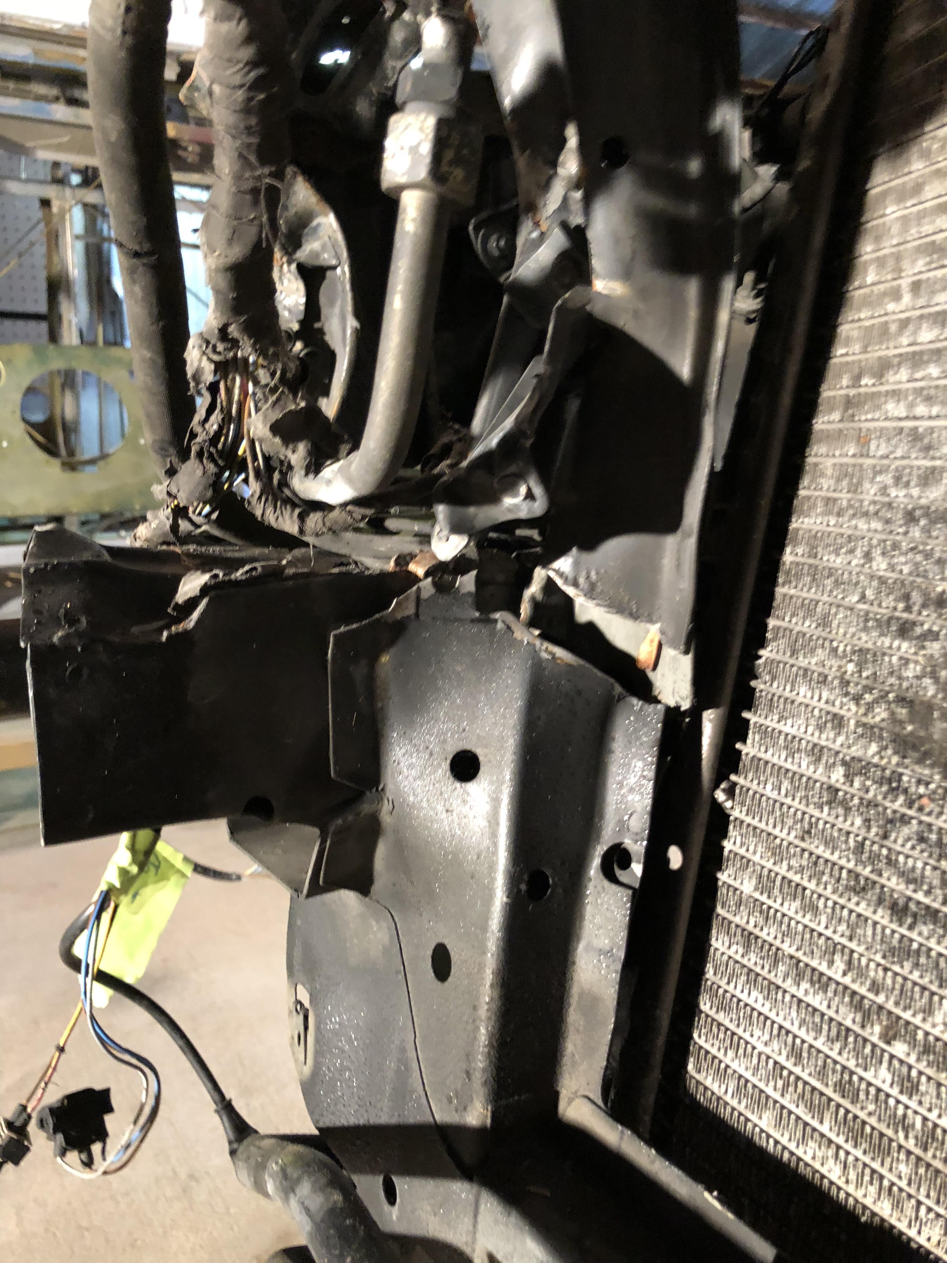

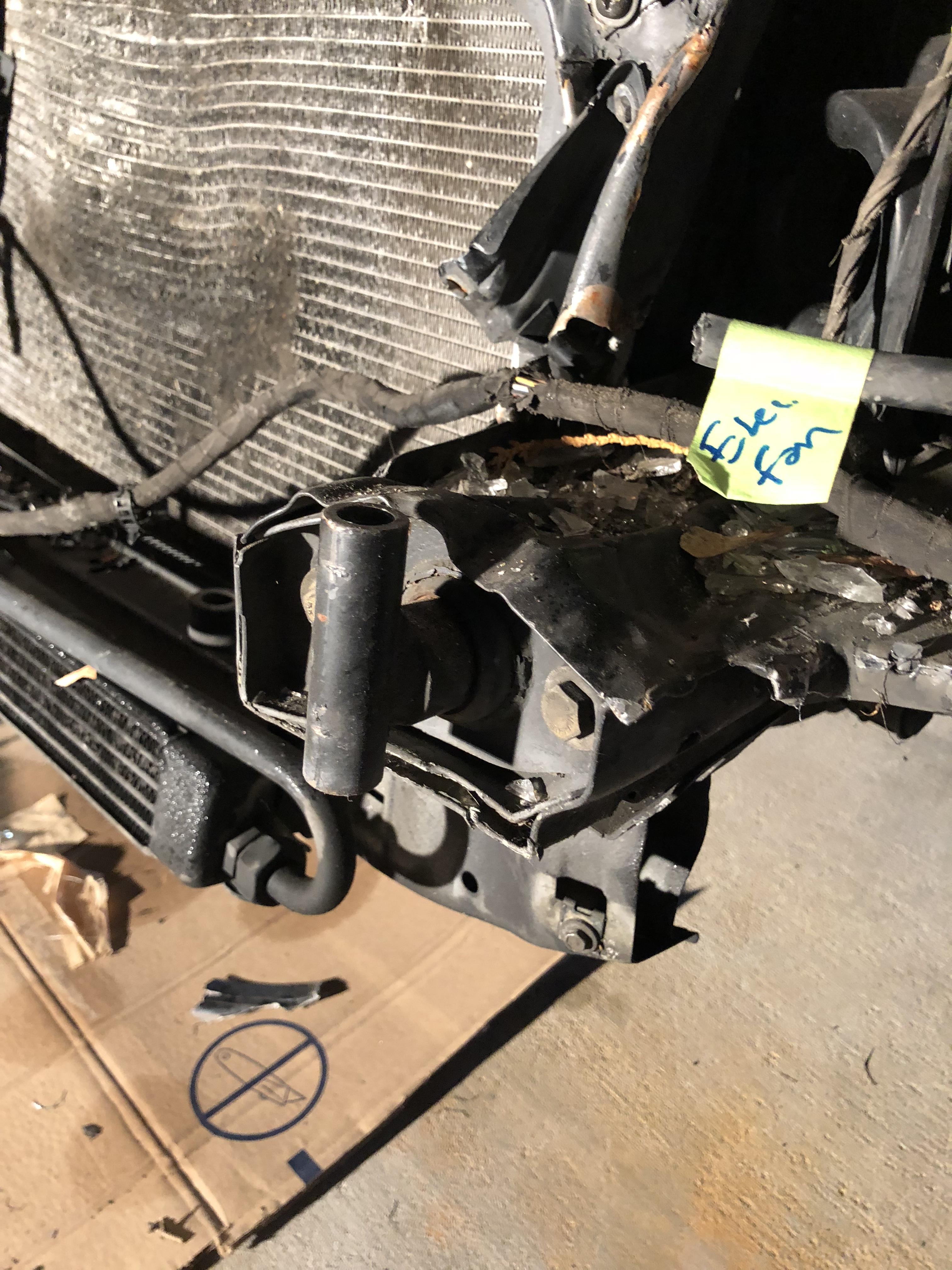

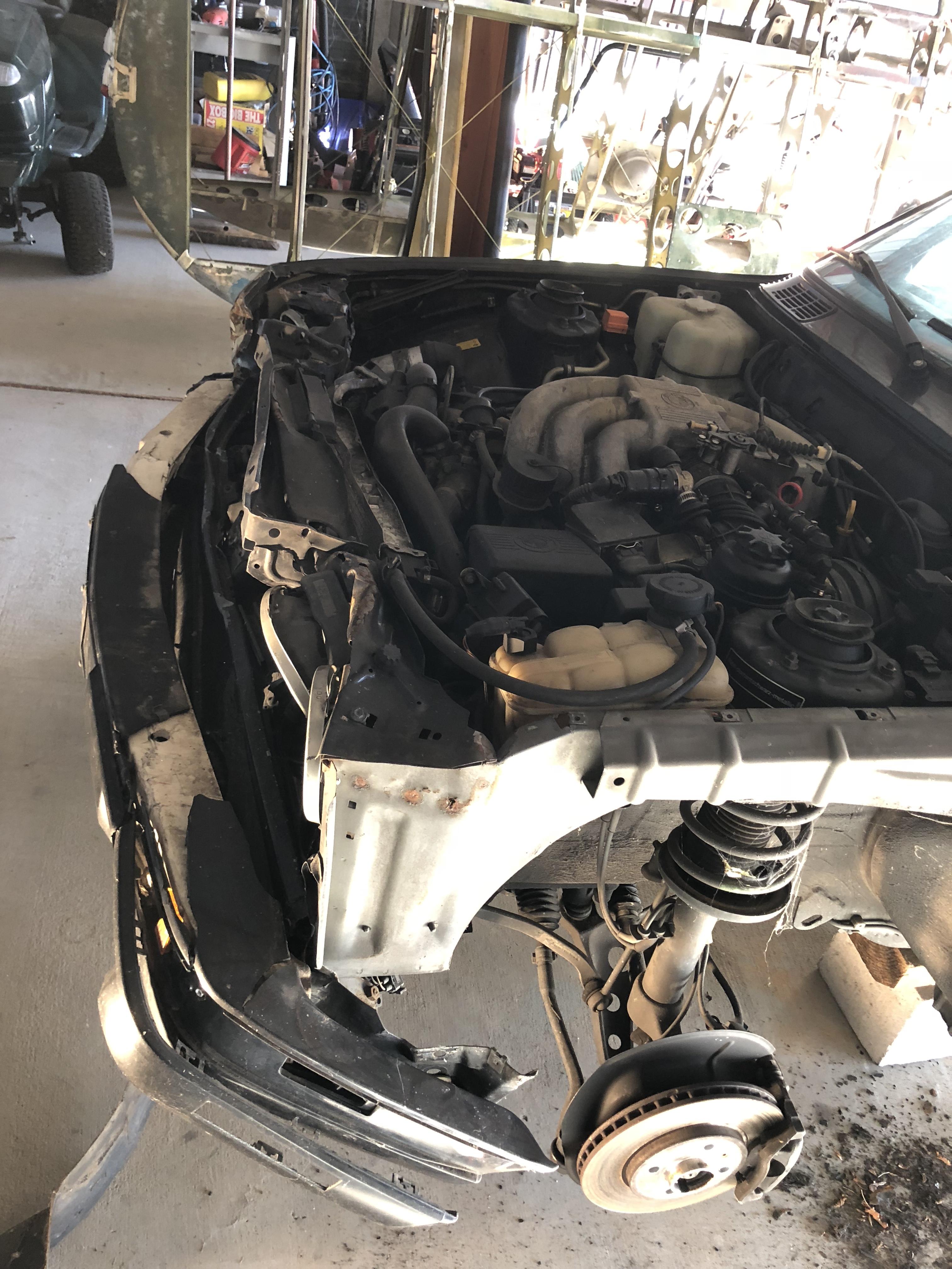

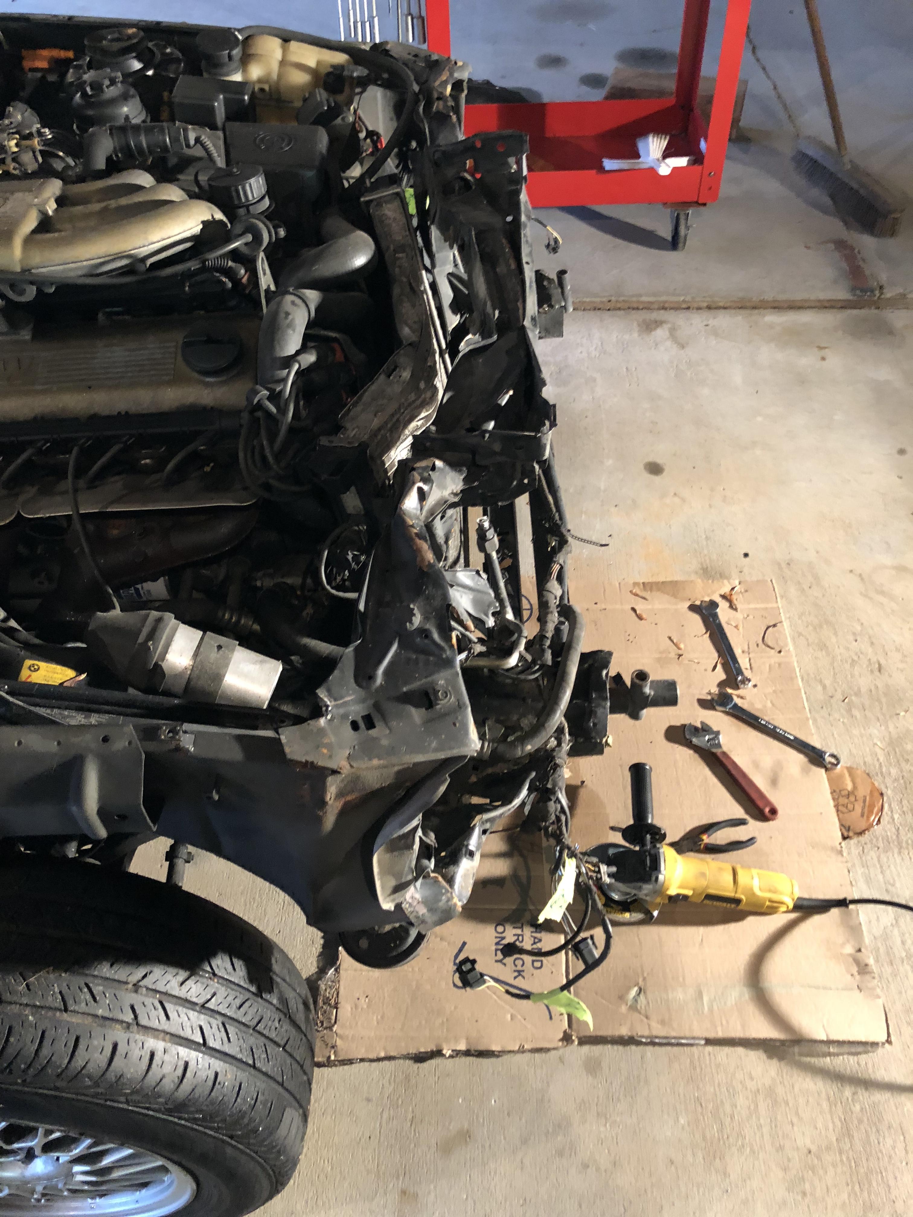

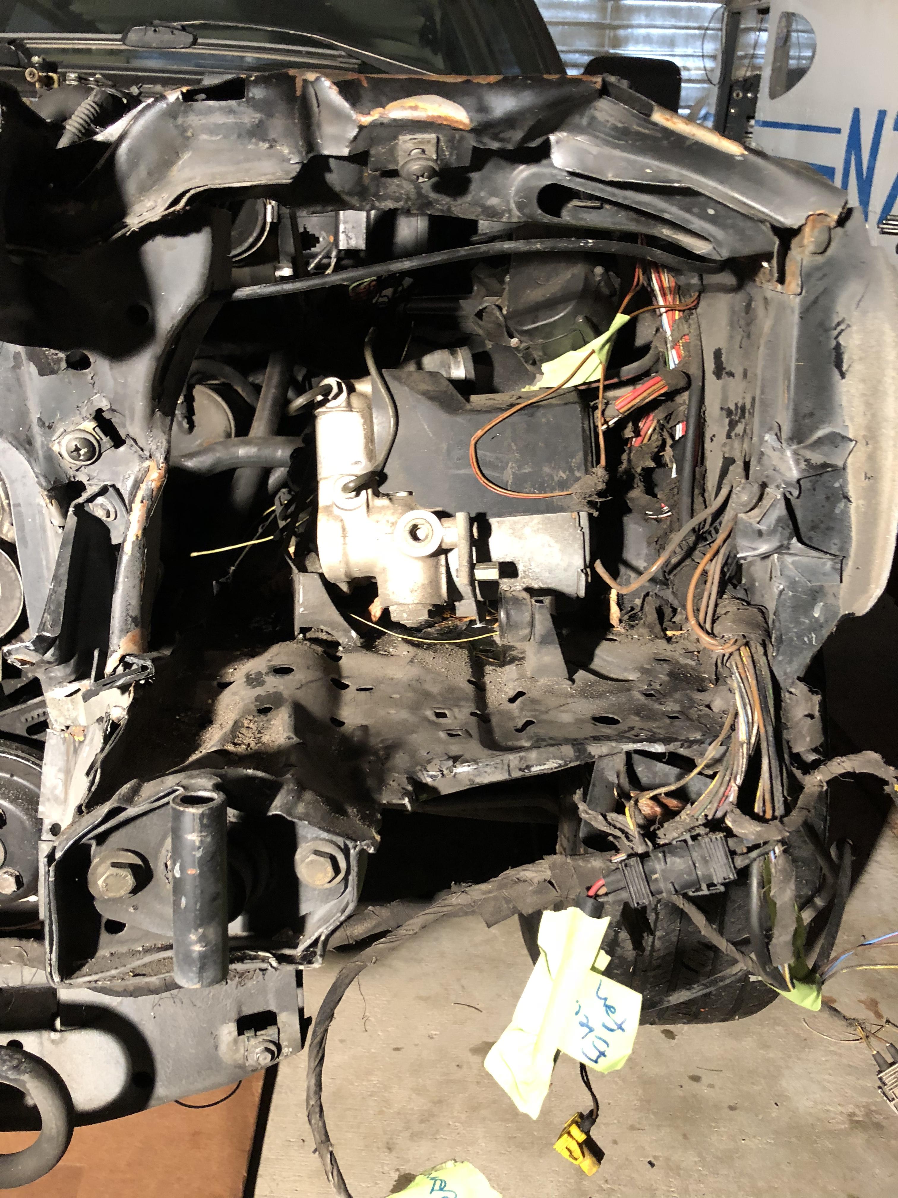

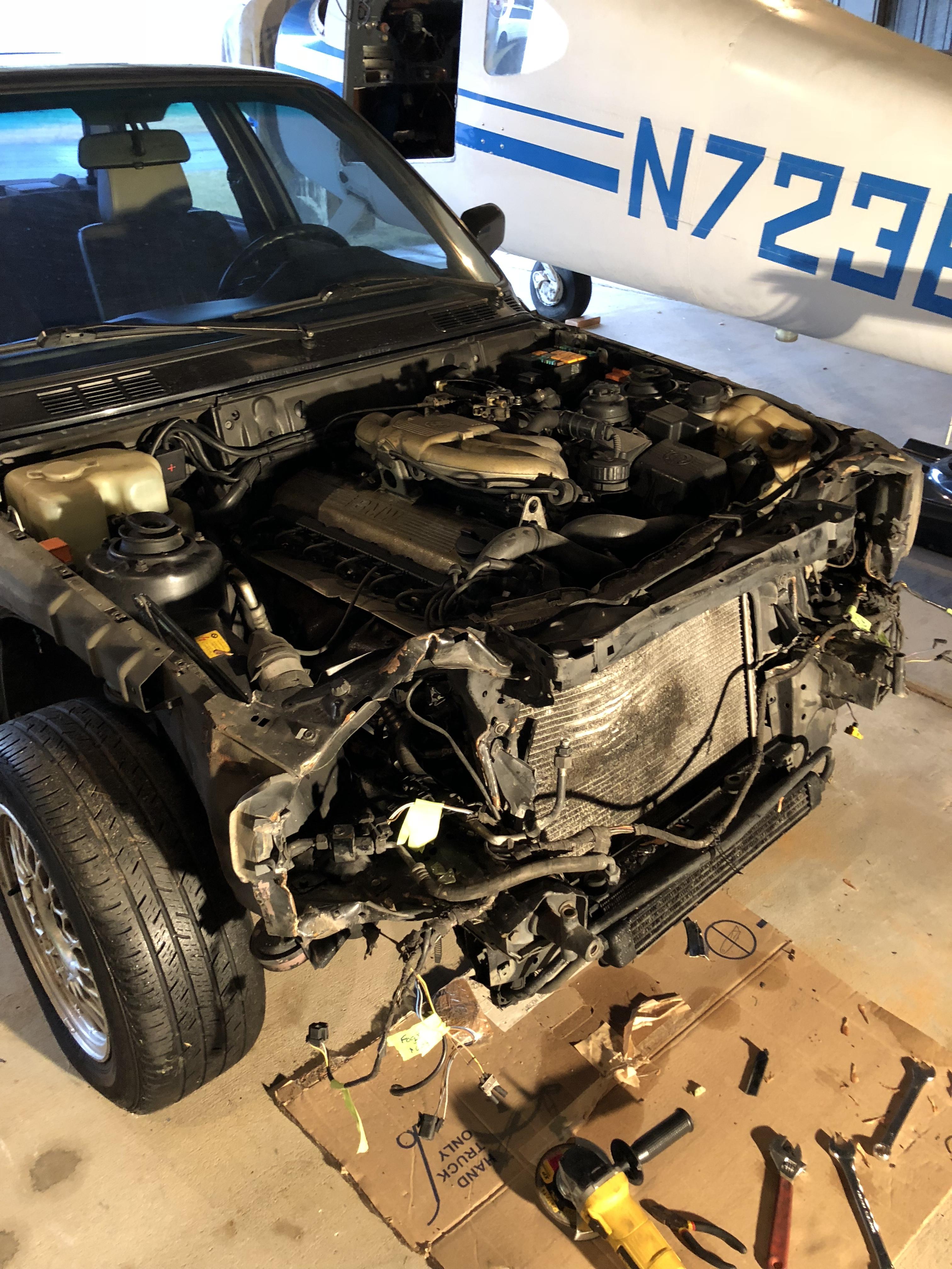

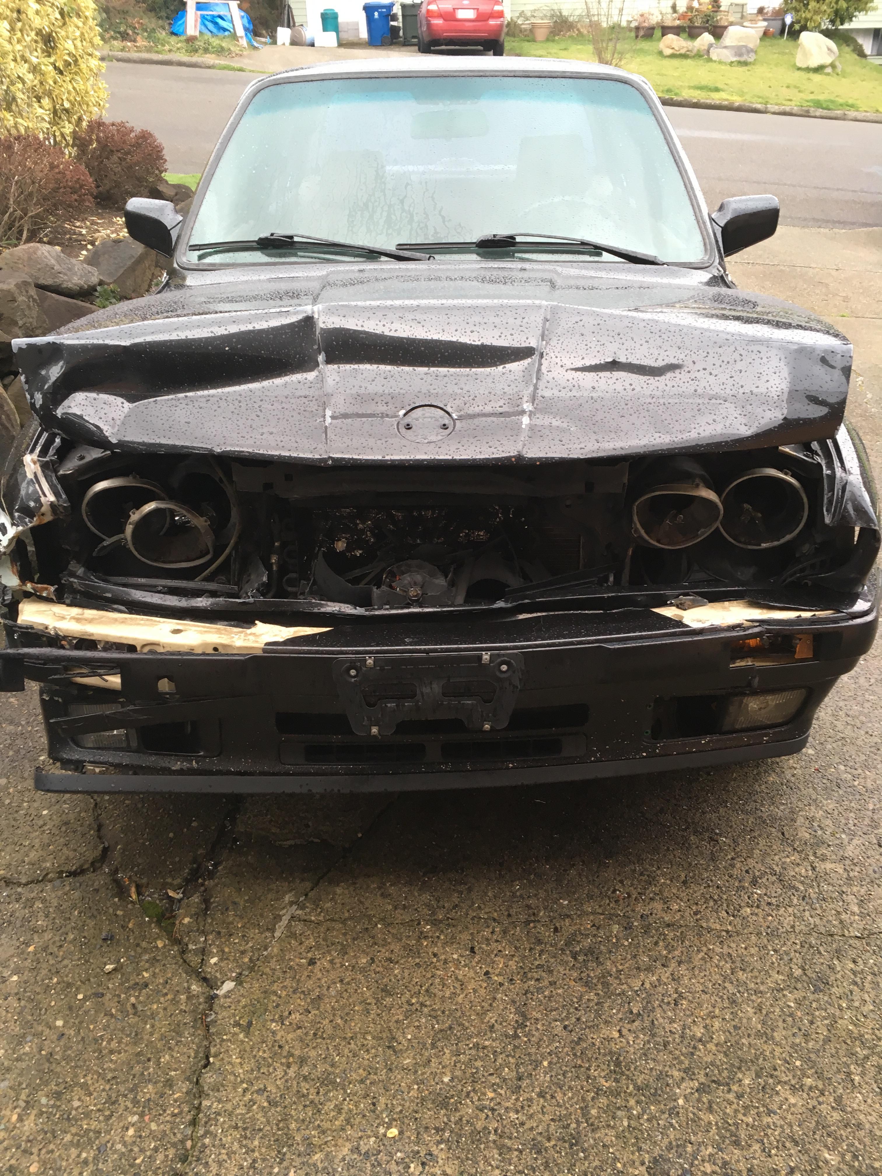

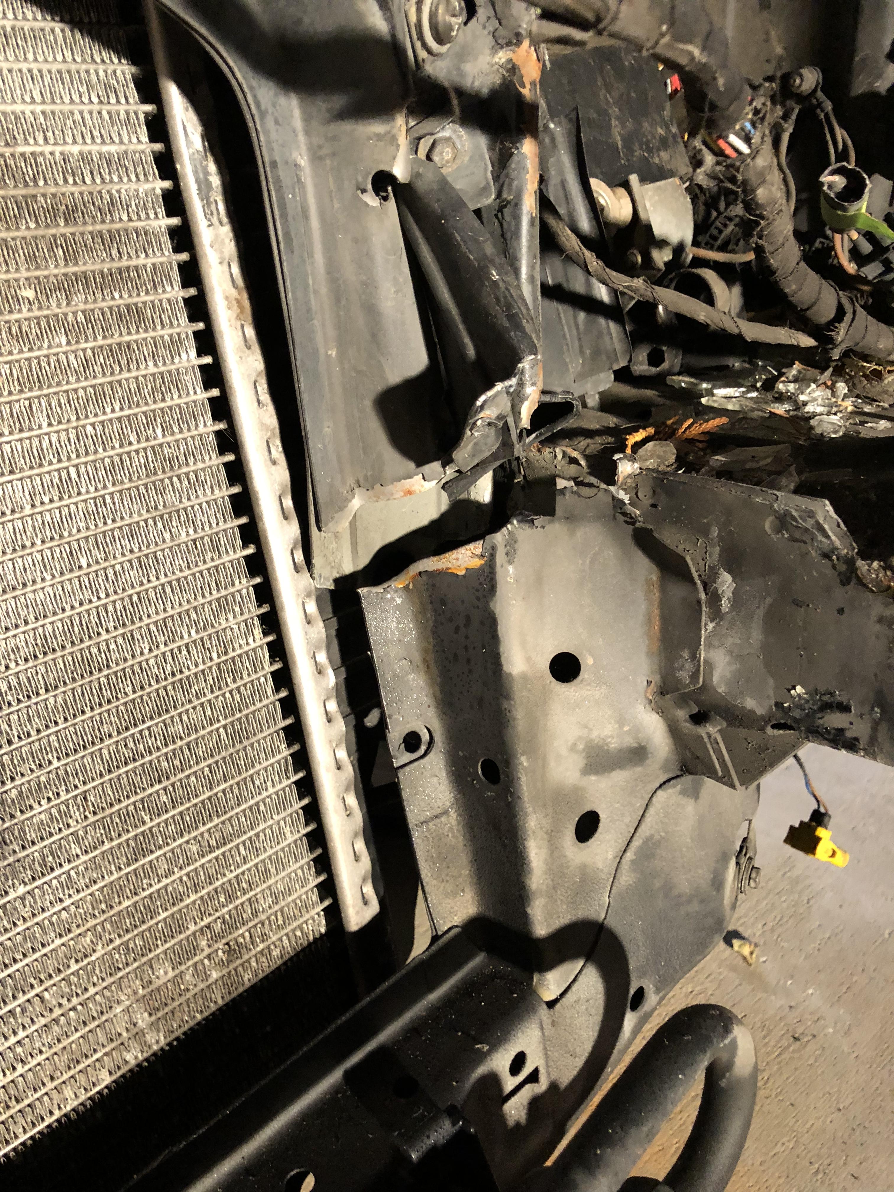

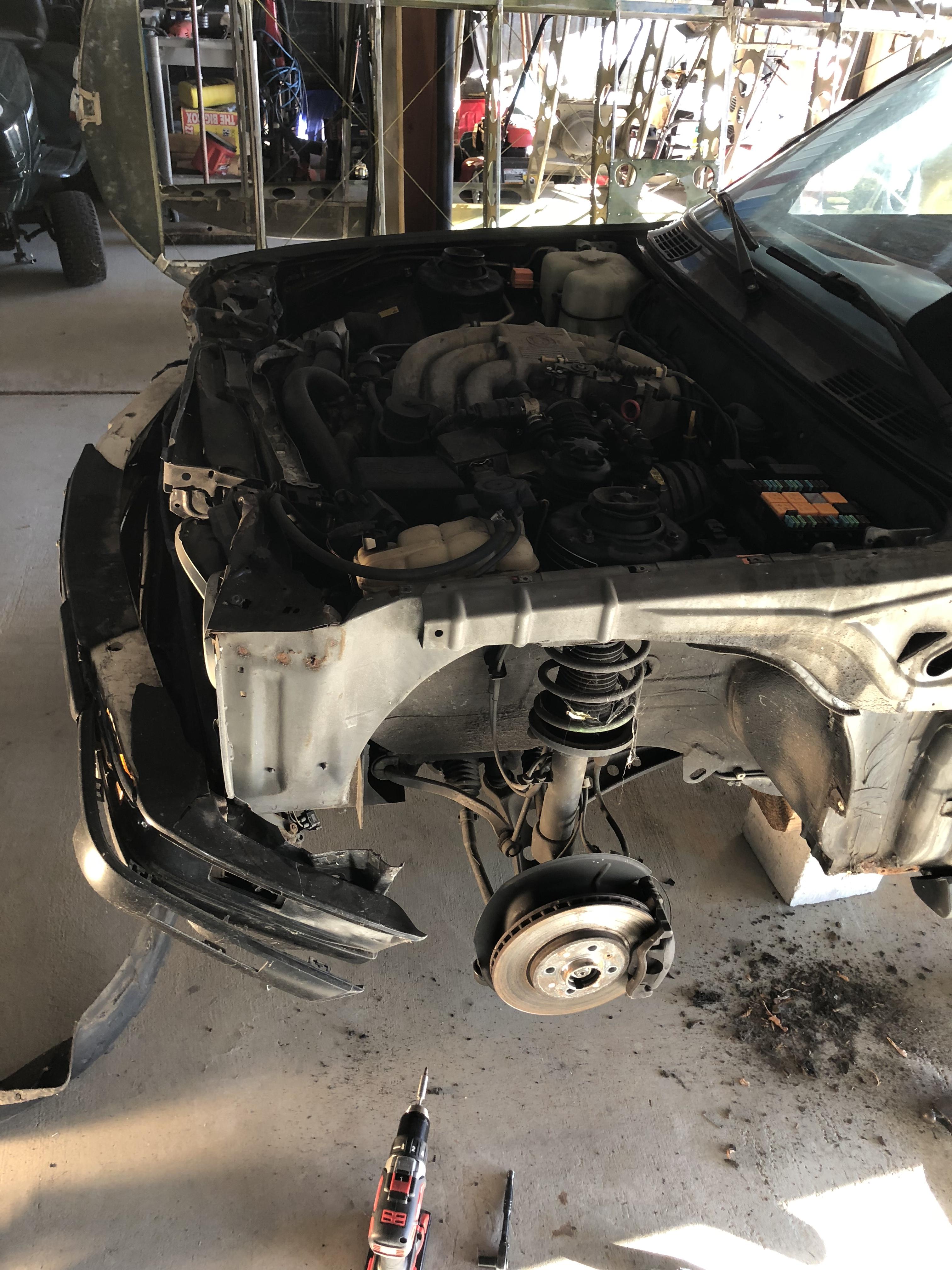

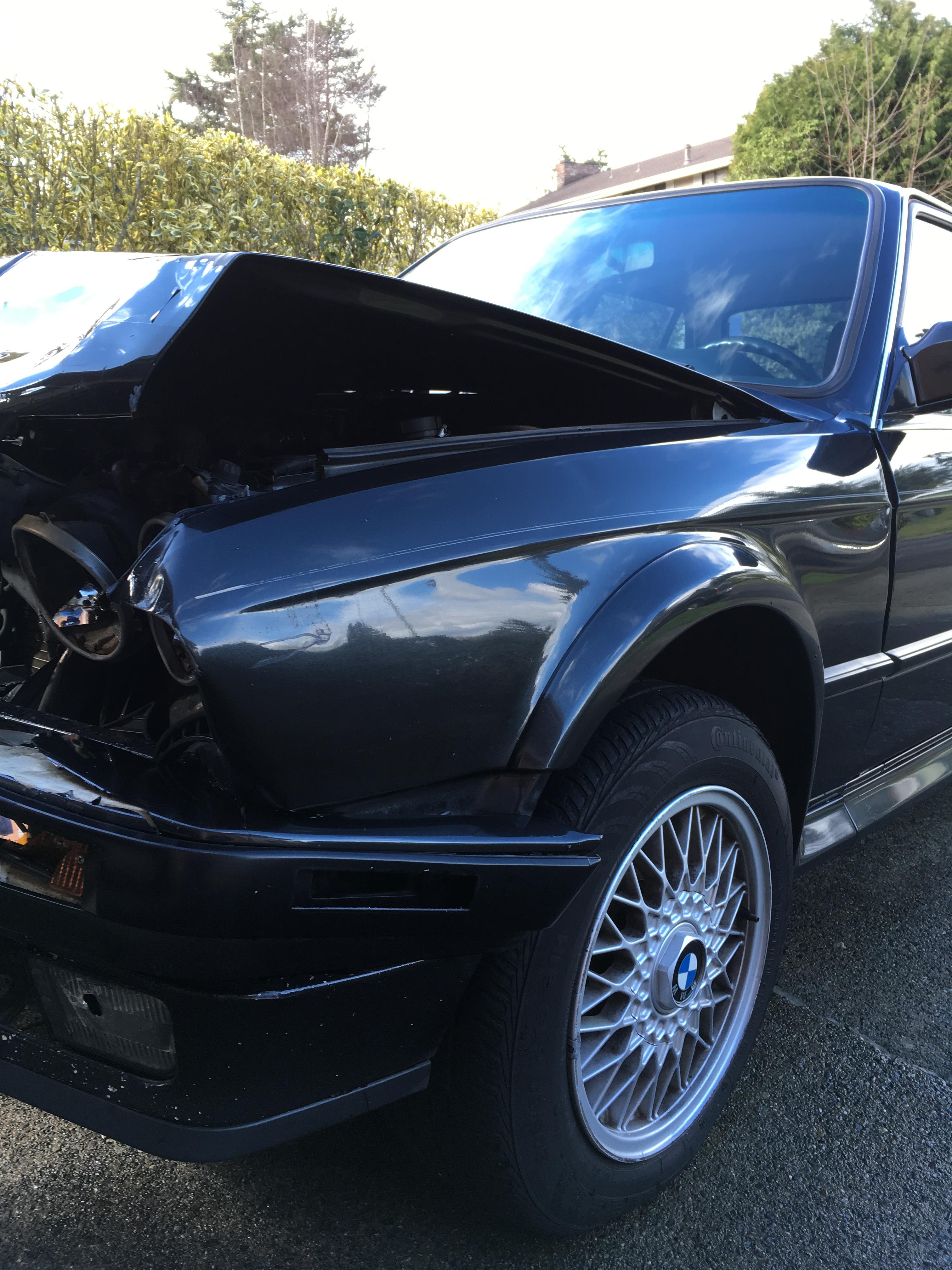

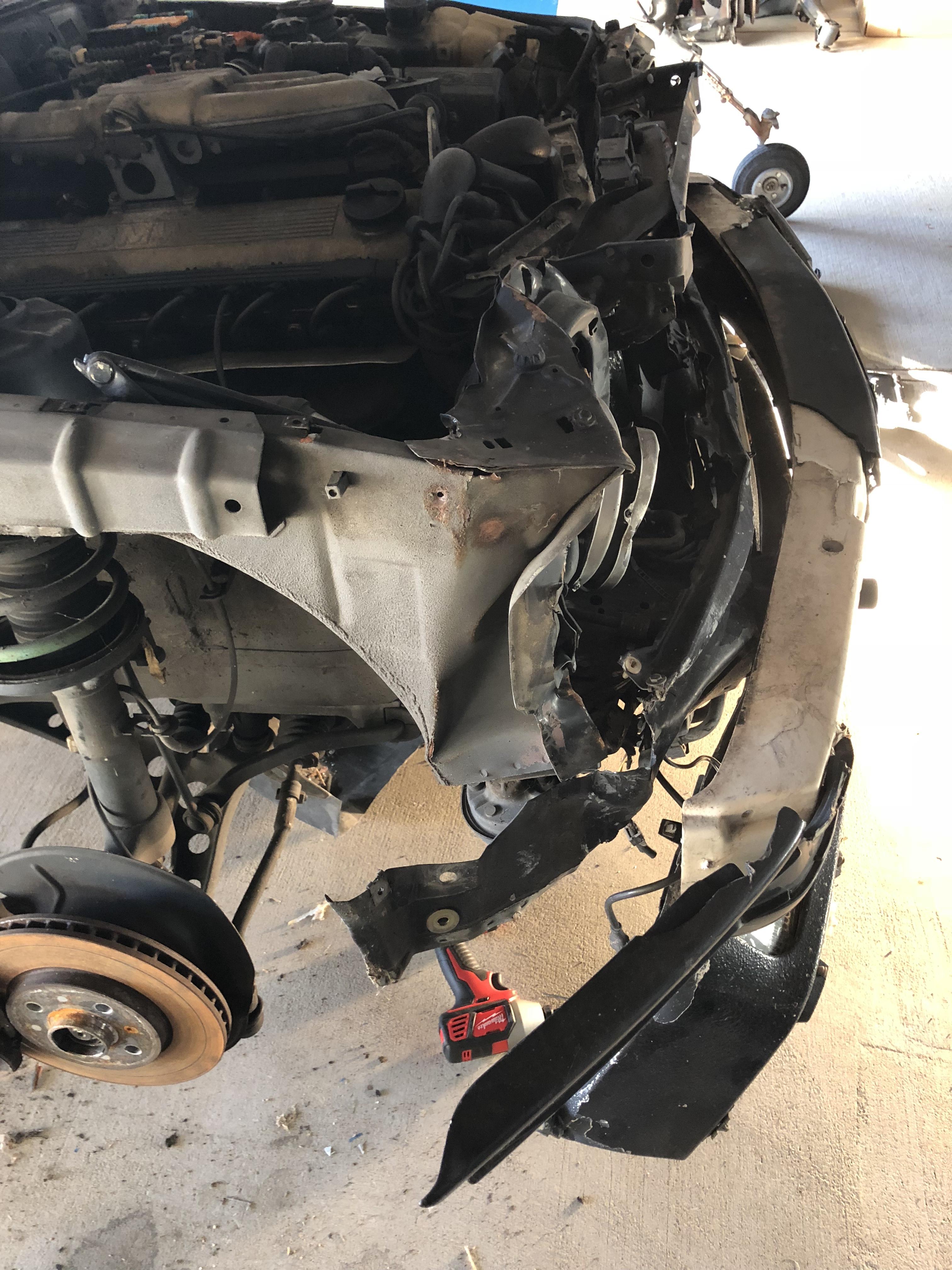

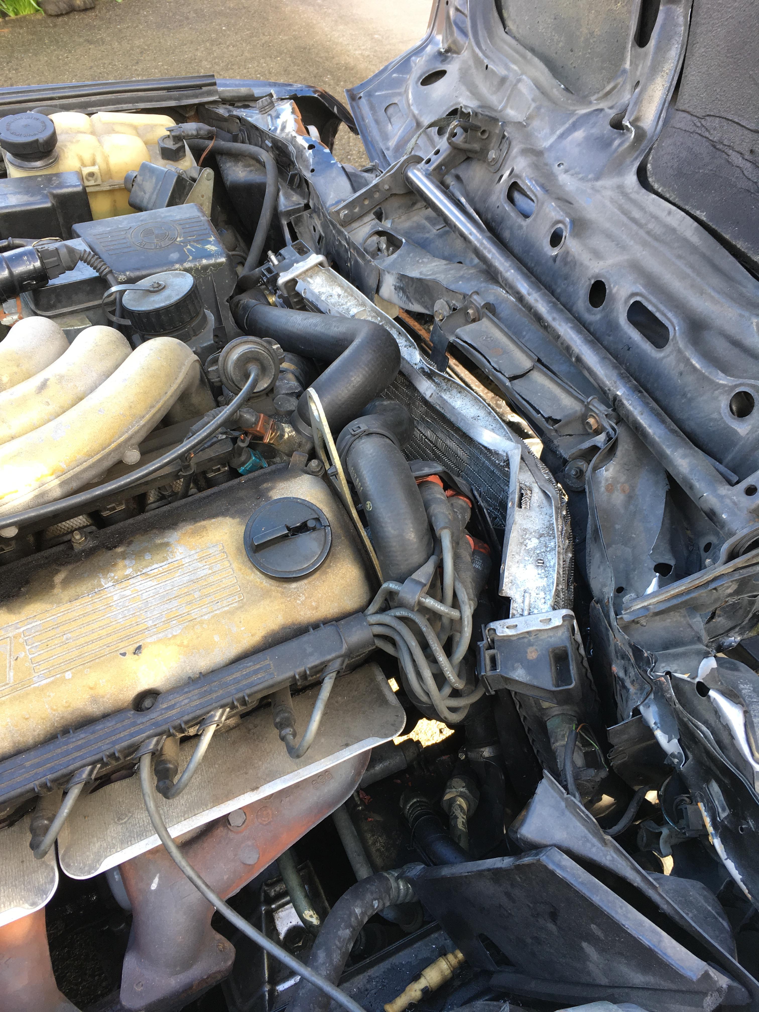

<p dir="auto">Made just a bit a progress yesterday. I pulled the hood and fenders off to further assess the damage. When I get chance next is pull bumper and rest of front end off including radiator to get access to the core support. I plan to buy a brand new core support for around $340 to assure I have a straight piece to rebuild on.</p>

<p dir="auto">Let me know if you need any dimensions from my car while the valence and bumper are off.</p>
]]></description><link>https://wibimmers.com/post/87245</link><guid isPermaLink="true">https://wibimmers.com/post/87245</guid><dc:creator><![CDATA[B C]]></dc:creator><pubDate>Fri, 12 Jan 2018 19:39:37 GMT</pubDate></item><item><title><![CDATA[Reply to 1991 325ix on Fri, 12 Jan 2018 19:32:39 GMT]]></title><description><![CDATA[<p dir="auto">Did you cut the core support? Or did it shear in a super awesome/crazy way?</p>
<p dir="auto">Be sure to inspect the firewall side of things. Where the wheel tubs meet the chassis, around the fuse box area and battery tray area for separation. Ensure there are no wrinkles in the strut towers or the vertical sheet metal surrounding them. </p>
<p dir="auto">Make sure to measure the distance between the frame horns (things that hold the bumper shocks) before cutting the old support out, seeing how much it was deformed is always a nice thing to know. </p>
<p dir="auto">I know it isn't your goal, but if you find something that keeps you from wanting to rebuild, I may know a guy interested in the drive-line bits.</p>
