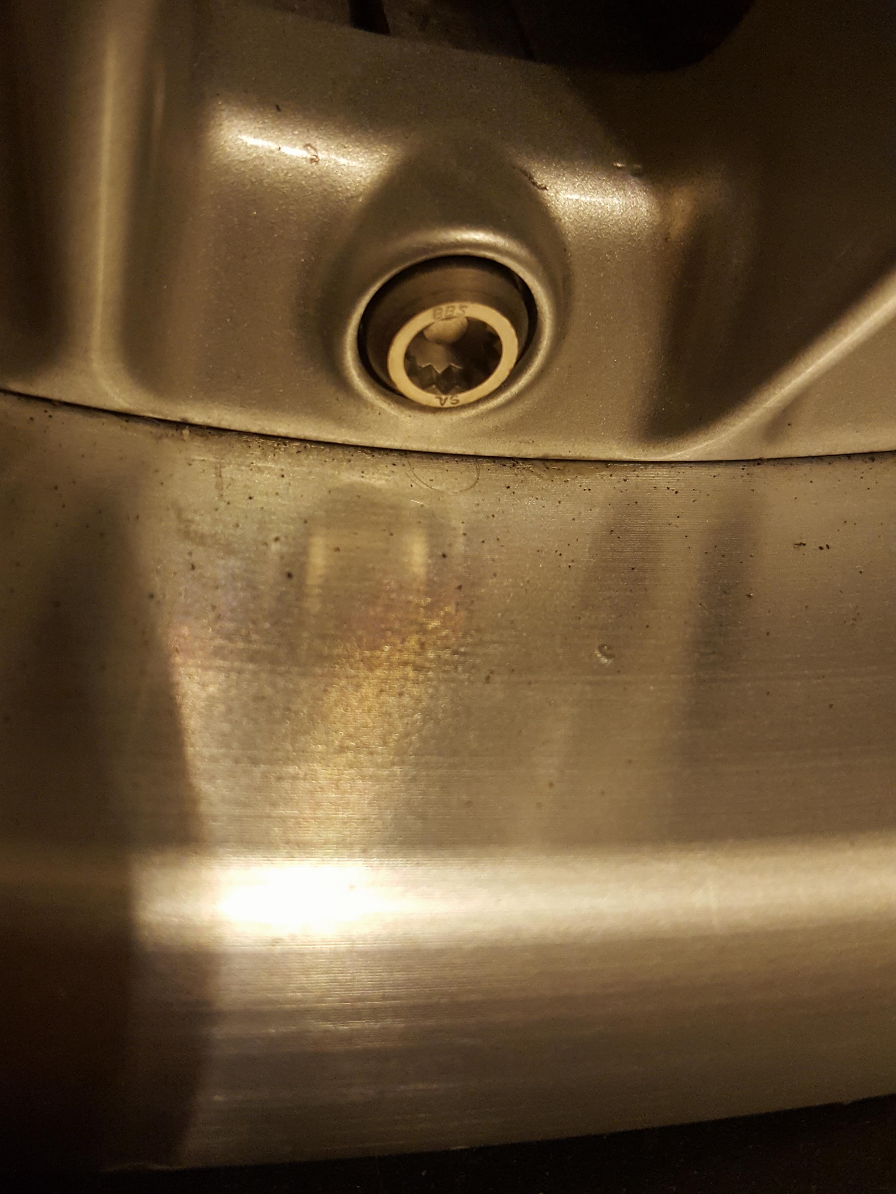

]]></description><link>https://wibimmers.com/post/84342</link><guid isPermaLink="true">https://wibimmers.com/post/84342</guid><dc:creator><![CDATA[stealthbimmer]]></dc:creator><pubDate>Sat, 14 Oct 2017 05:39:56 GMT</pubDate></item><item><title><![CDATA[Reply to Wheel refinishing on Sat, 14 Oct 2017 03:31:58 GMT]]></title><description><![CDATA[<p dir="auto">I have an untouched style 42 sitting in front of me. The bolt shouldn't be painted and the lip should just be machined with a clear coat. Soak the bolts in aircraft stripper.</p>
<p dir="auto"><a href="/assets/uploads/files/monthly_2017_10_15079518614201888844150.jpg.4c4d74bfe1219329a996f7d2dd834c3b.jpg"><img src="/assets/uploads/files/monthly_2017_10_15079518614201888844150.thumb.jpg.e5964112e26a707ad37e40382c5b7e5b.jpg" alt="15079518614201888844150.jpg" class=" img-fluid img-markdown" width="563" height="750" /></a></p>
