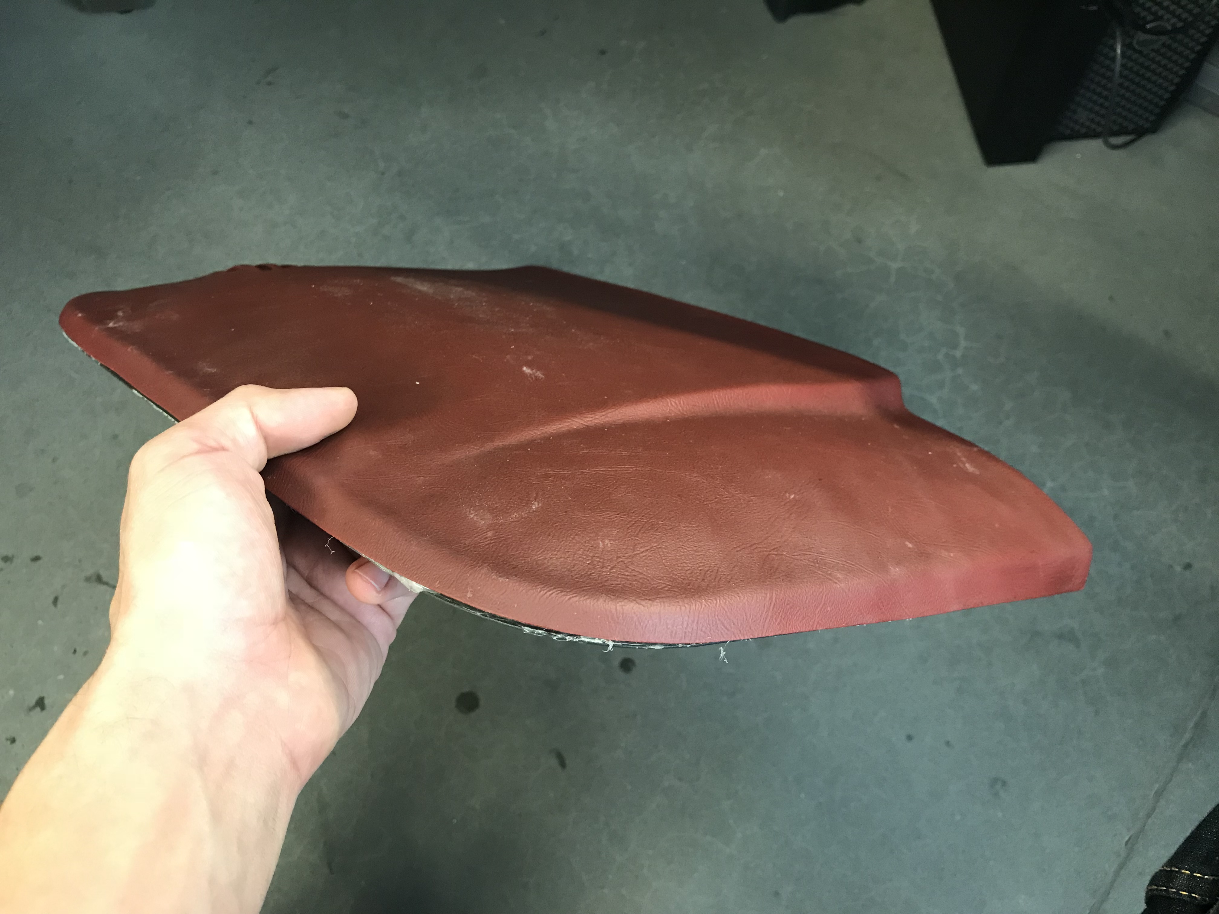

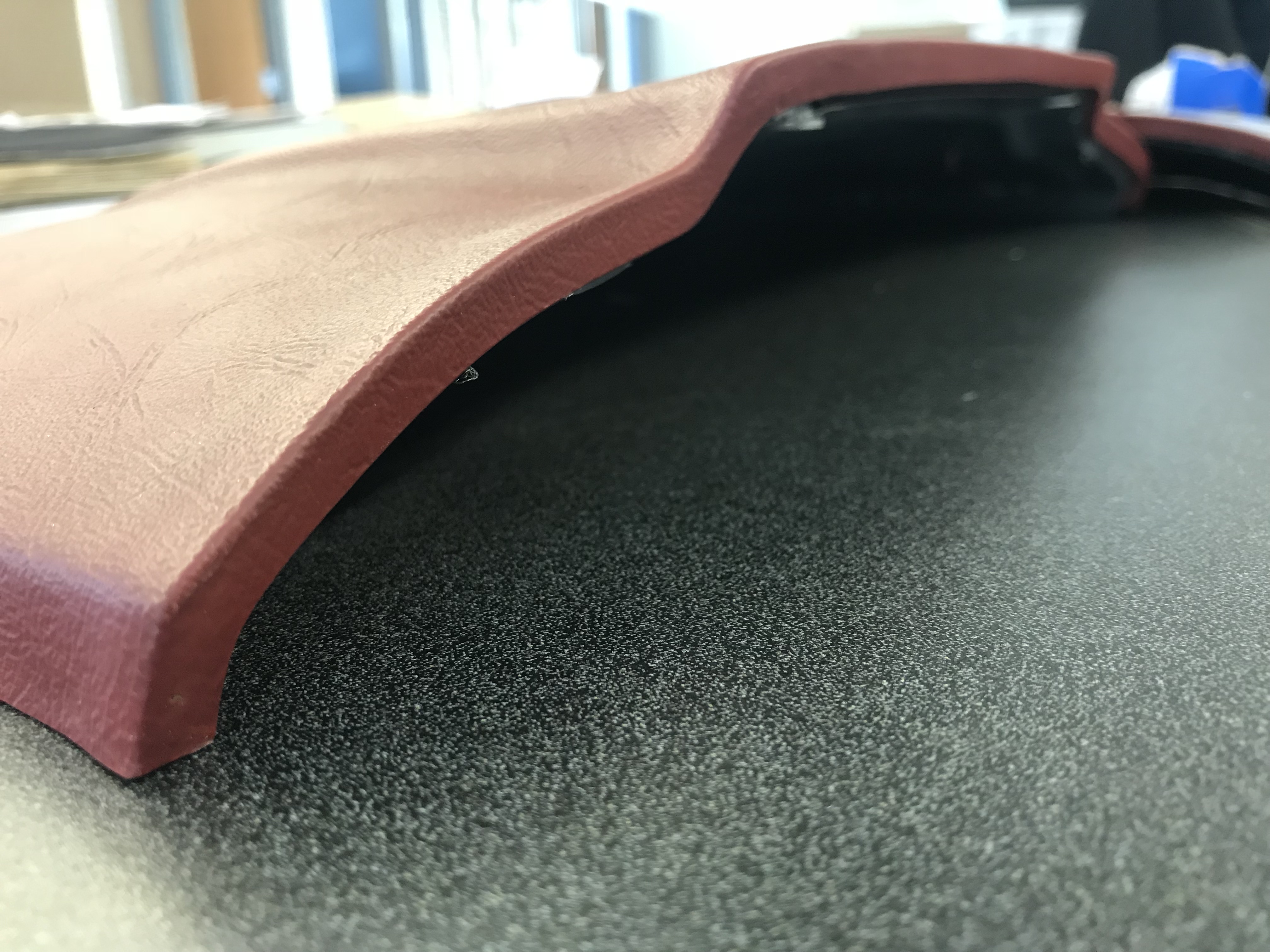

                            A little construction adhesive goes a long way. Section by section, I glued and clamped around the perimeter of the covers getting the foamed rubber to reattach to the metal base. What a terrible and odd combination. I feel like a lot of the elements and construction methods on this car were examples of trying to use new materials with very little long term testing.

                                Those gotta be the most expensive interior piece to replace, glad they turned out!
                                  #136
                                  Really? Why is that? And yes I as glad they held together. Adhesives that would work with such an odd combinations are very slim and I was worried about any chemical type of bond could have melted the foam..  Glad I didn't have to find out.
                                    #137
                                    I remember looking for used ones 8 years ago and it wouldve been around $3-400 for a good pair. They all split over time and probably haven't been available through the dealer forever.

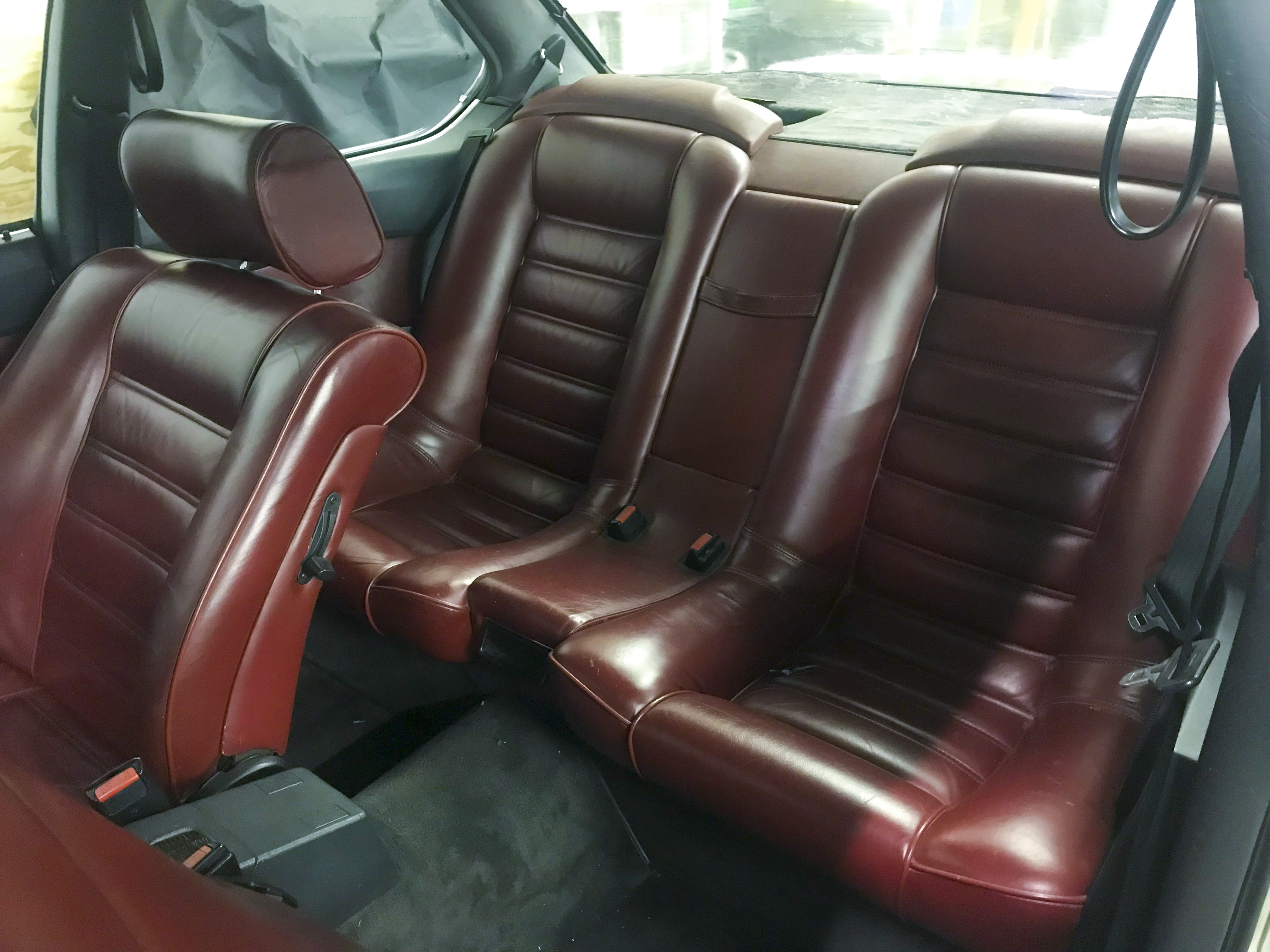

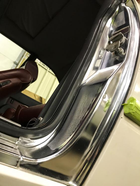

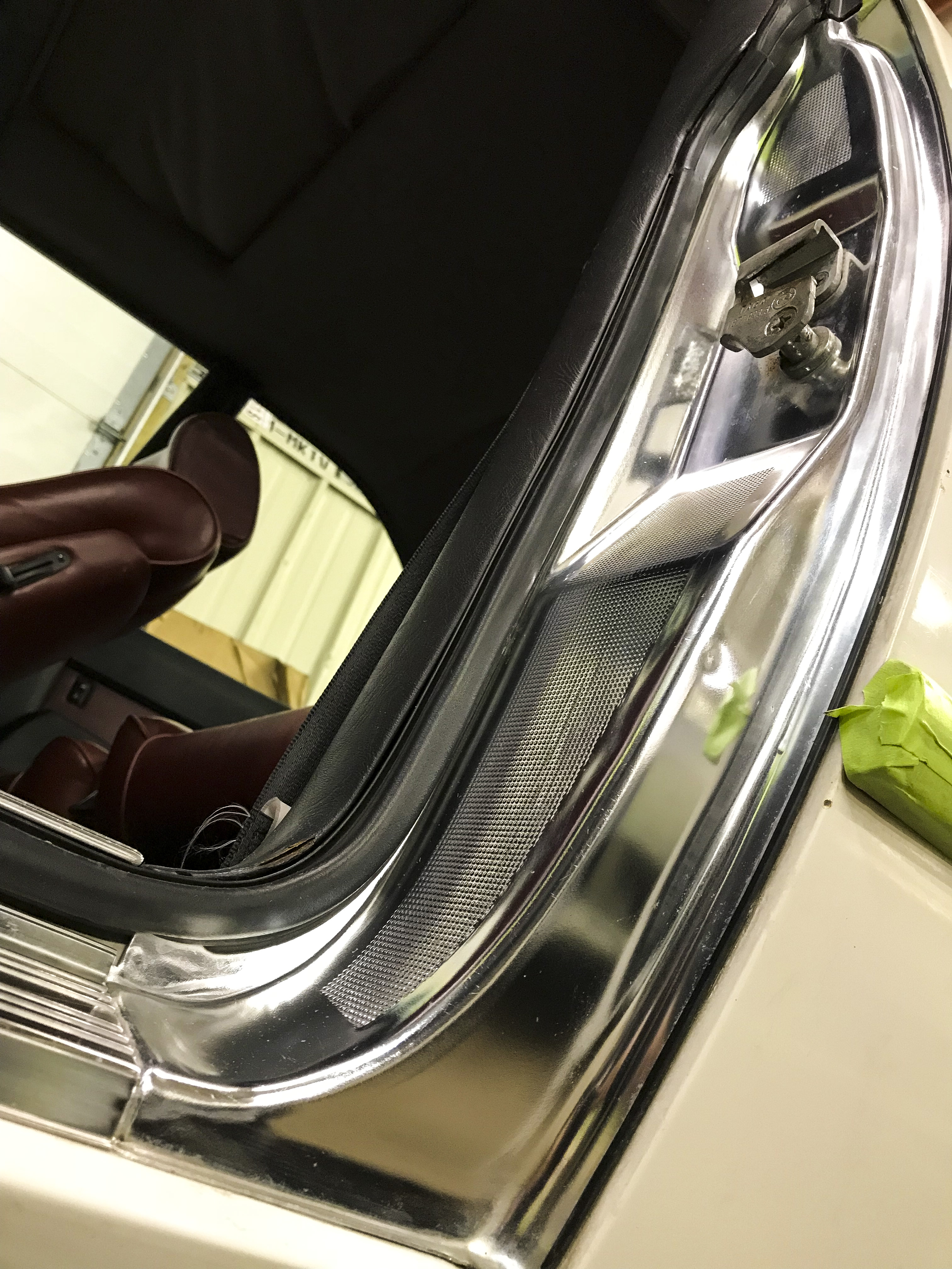

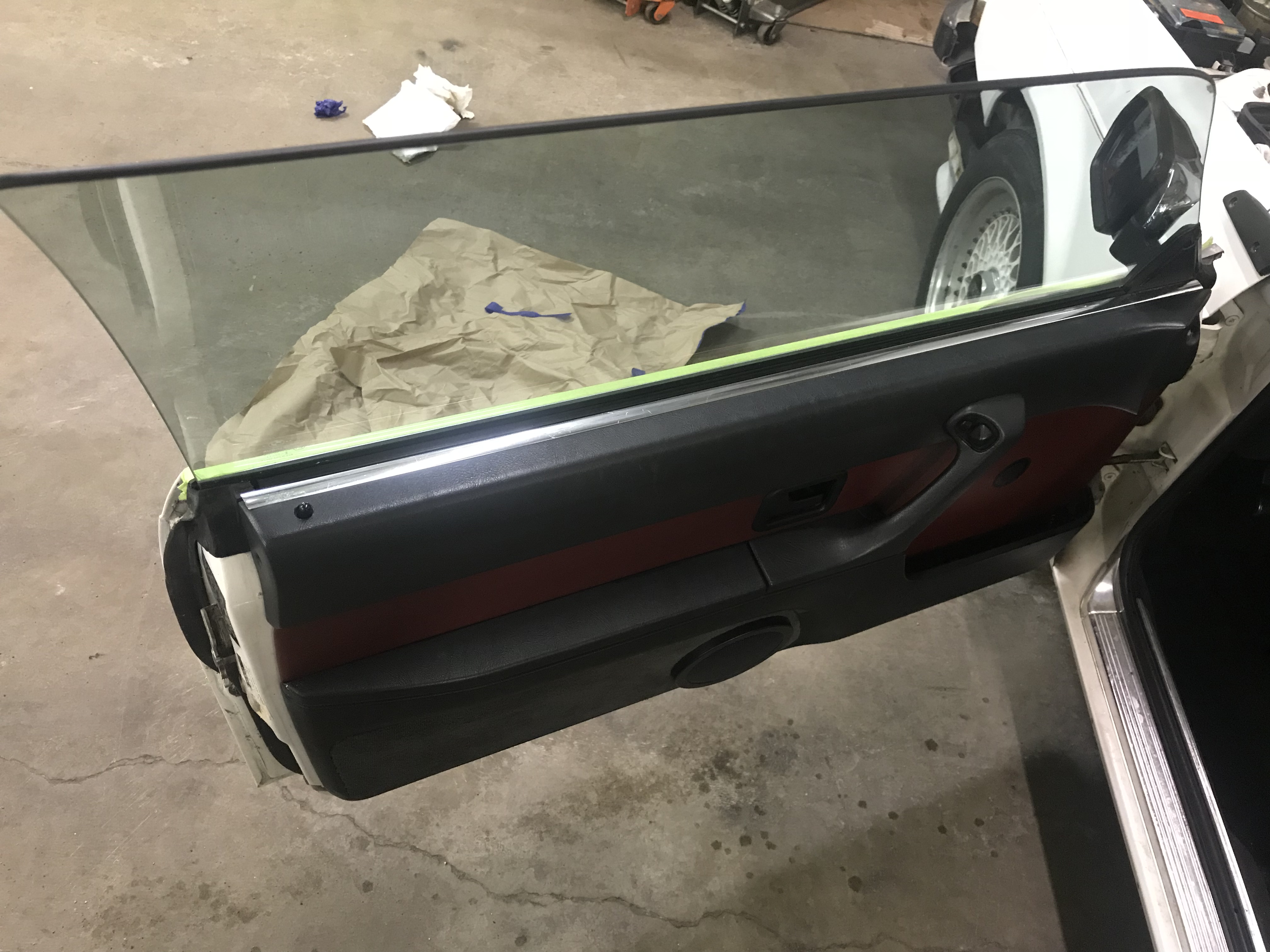

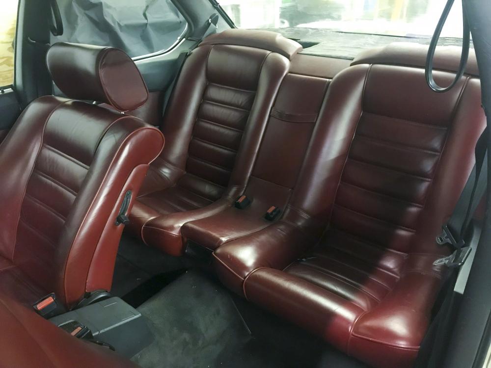

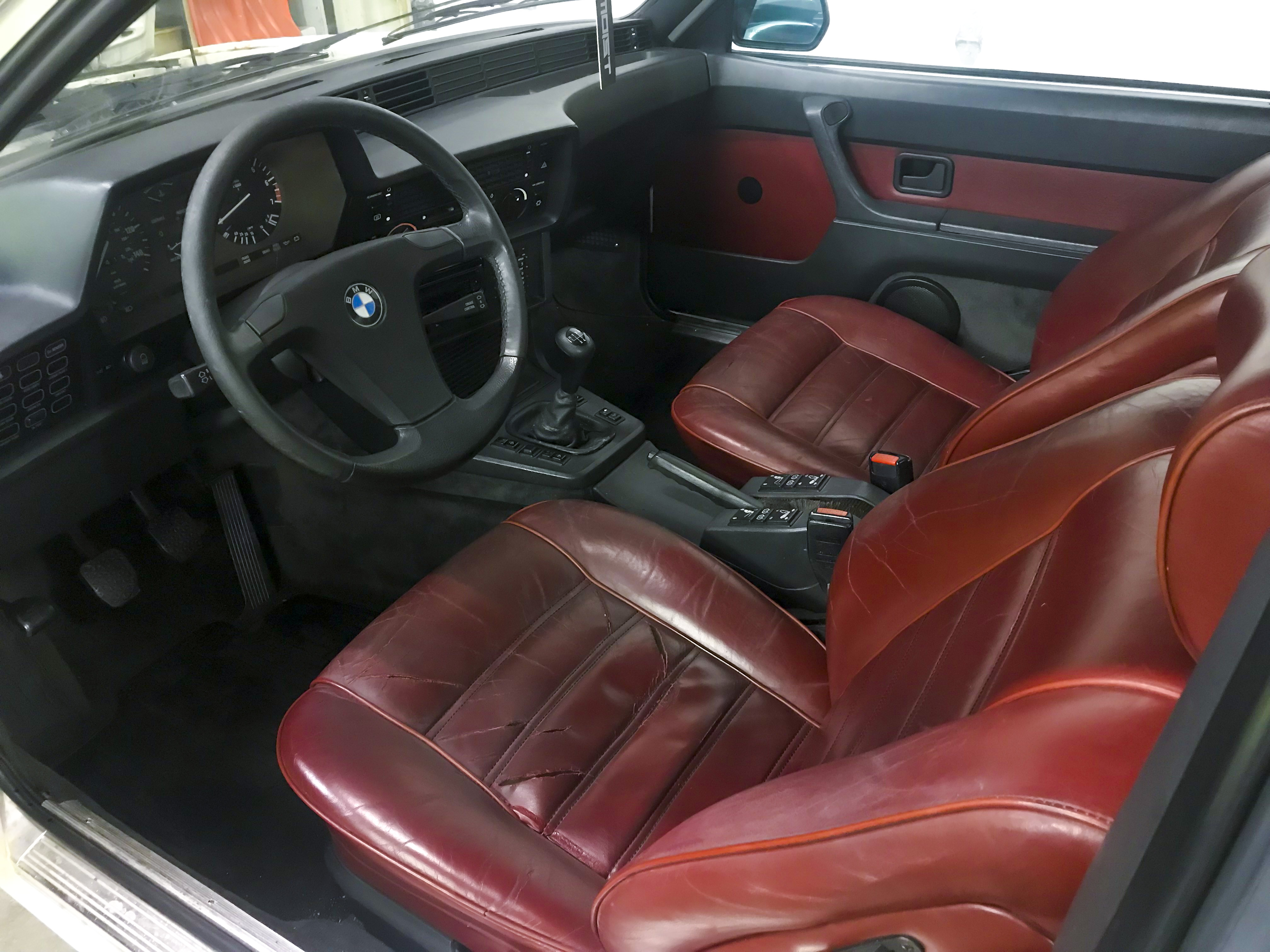

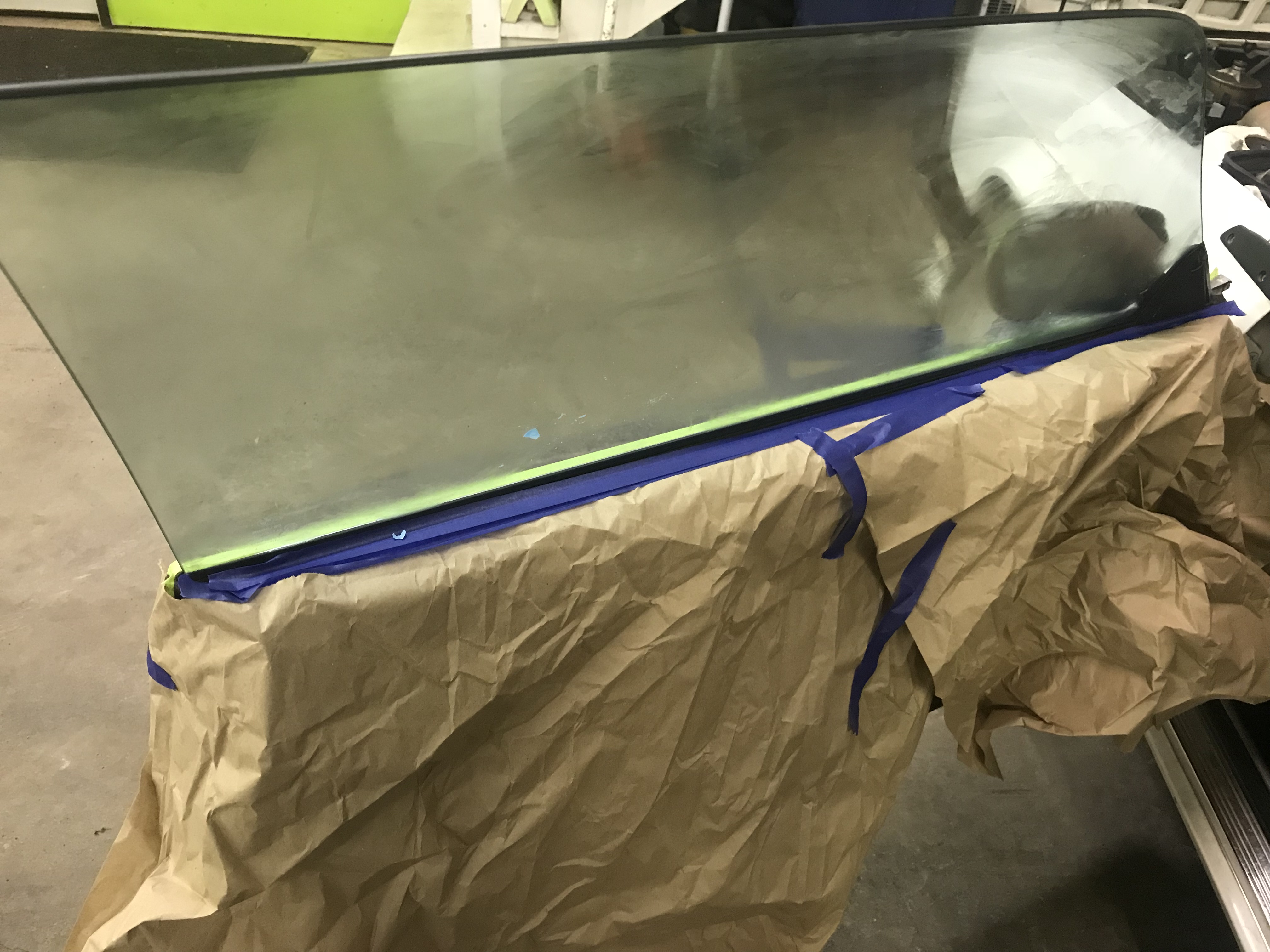

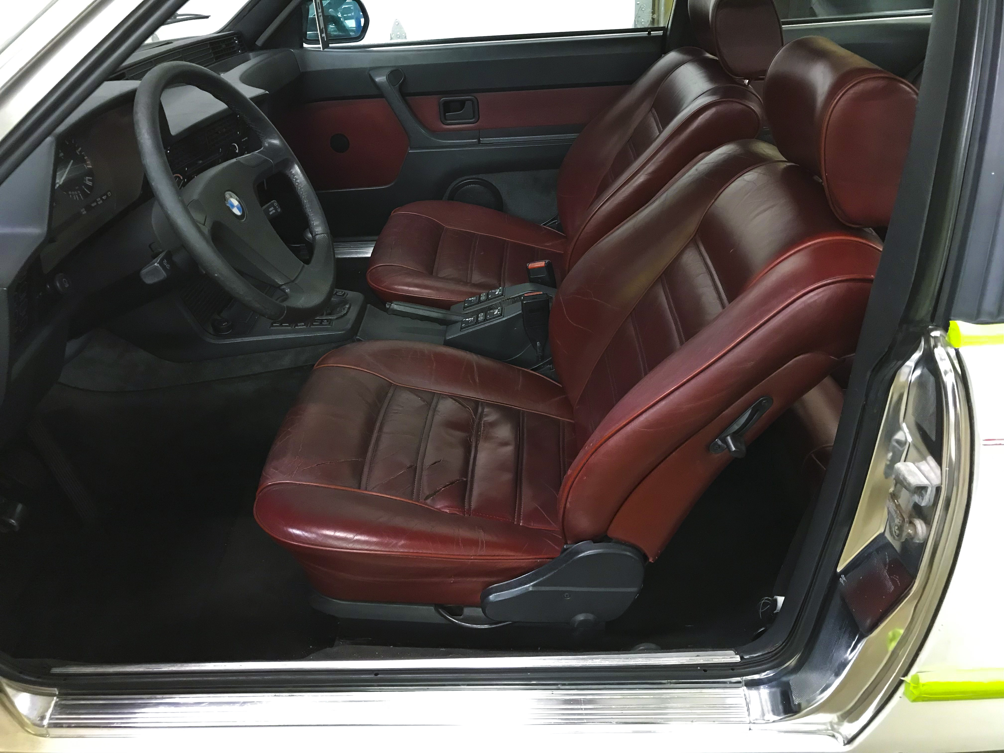

                                        So I spent more time last night removing tint adhesive. I have two windows left now. Im trying to do it little by little for a few reasons. 1. Its a lot of rubbing, scrubbing, and wiping and its exhausting. 2. the fumes from both the window tint glue and the lacquer thinner that it takes to remove it is overpowering even with a nice quality mask.
                                        I also installed the rear covers on their hinges and took some interior shots (sorry they are so dark) to share with you guys because @P_Roloff Said I didn't share any.
                                        My favorite and one of the most oddly obnoxious things on this car is the stainless door sills...
                                        And some temping before and after pictures of RS's in 16's and what they look like stepped to 18's
                                          #140
                                          That interior is AWESOME!! And looks to be in great shape too.
