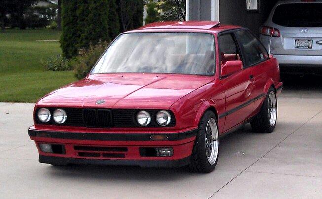

                                          #60
                                          So, I will make a larger update at some point, but the car has been "finished" to the point of driving, ordered some stuff yesterday, sent my rear shock mount through the trunk, and as a result may need a new tire, even though the current one only has 50 or so miles. And life carries on, got my black window banner;) few pictures?
