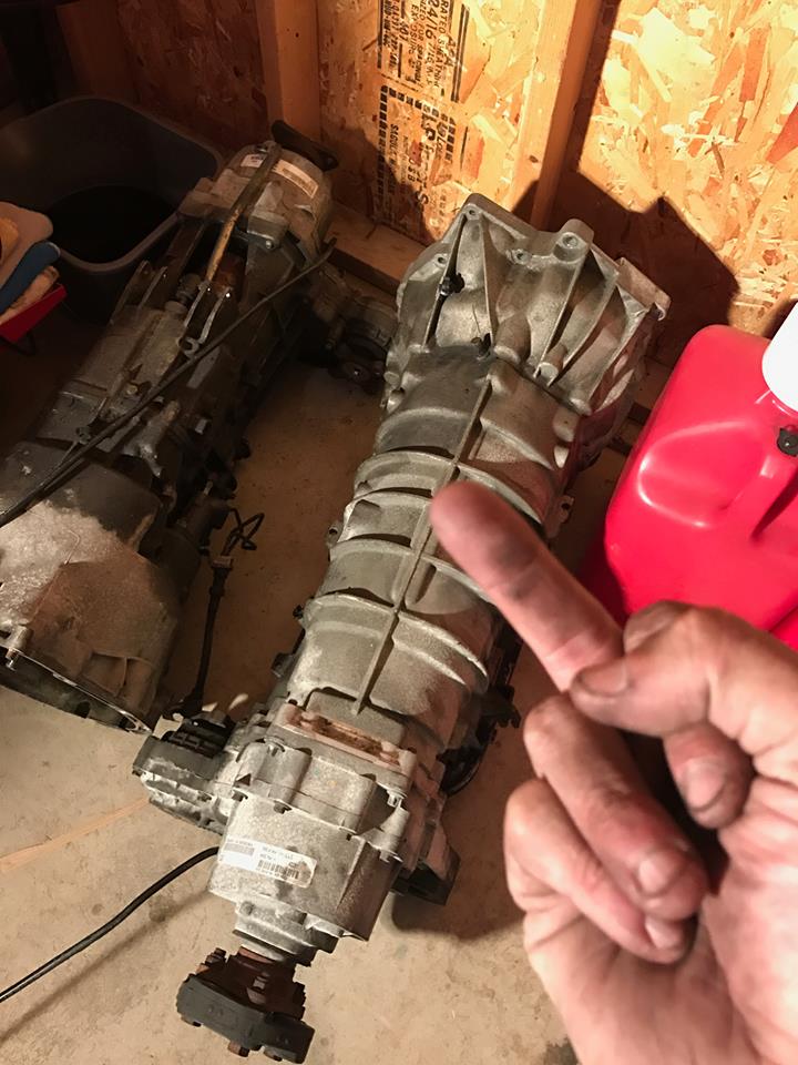

    transmission came out last night, and got a start on axles. I'm pretty tired so I probably won't hit it super hard tonight but at minimum i'd like to get the torque converter off, leaking rear main, etc. and prep everything for my new SMFW/clutch assembly that's arriving shortly.

      That's long enough to be a 12 speed!
        #43
        Yeah it's damn near a 4l80e in size haha. Hard part is over!
          #44
          Mandatory pic when doing such a swap..
            #45
            I drove over my auto trans and stabbed it with the bucket of a small Komatsu multiple times. Those trans cases are more robust than I would have thought.

              The trans looks long but remember that the xfer case is attached still. I took it all out as one unit. So it does look enormous

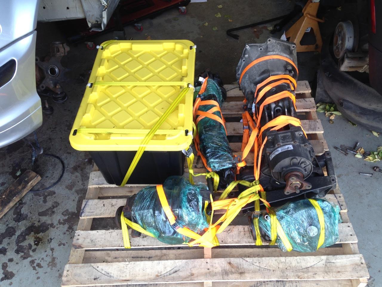

                  So, this is still happening, just been waiting on my parts provider to finish parting out his car. Everything is packed up and ready to be picked up by UPS Freight. They are still on holiday rates so we are just waiting until (hopefully this week) they go back down. Shipping should be about $340 for 410 pounds on a 48x48 non-stackable pallet. Not bad.

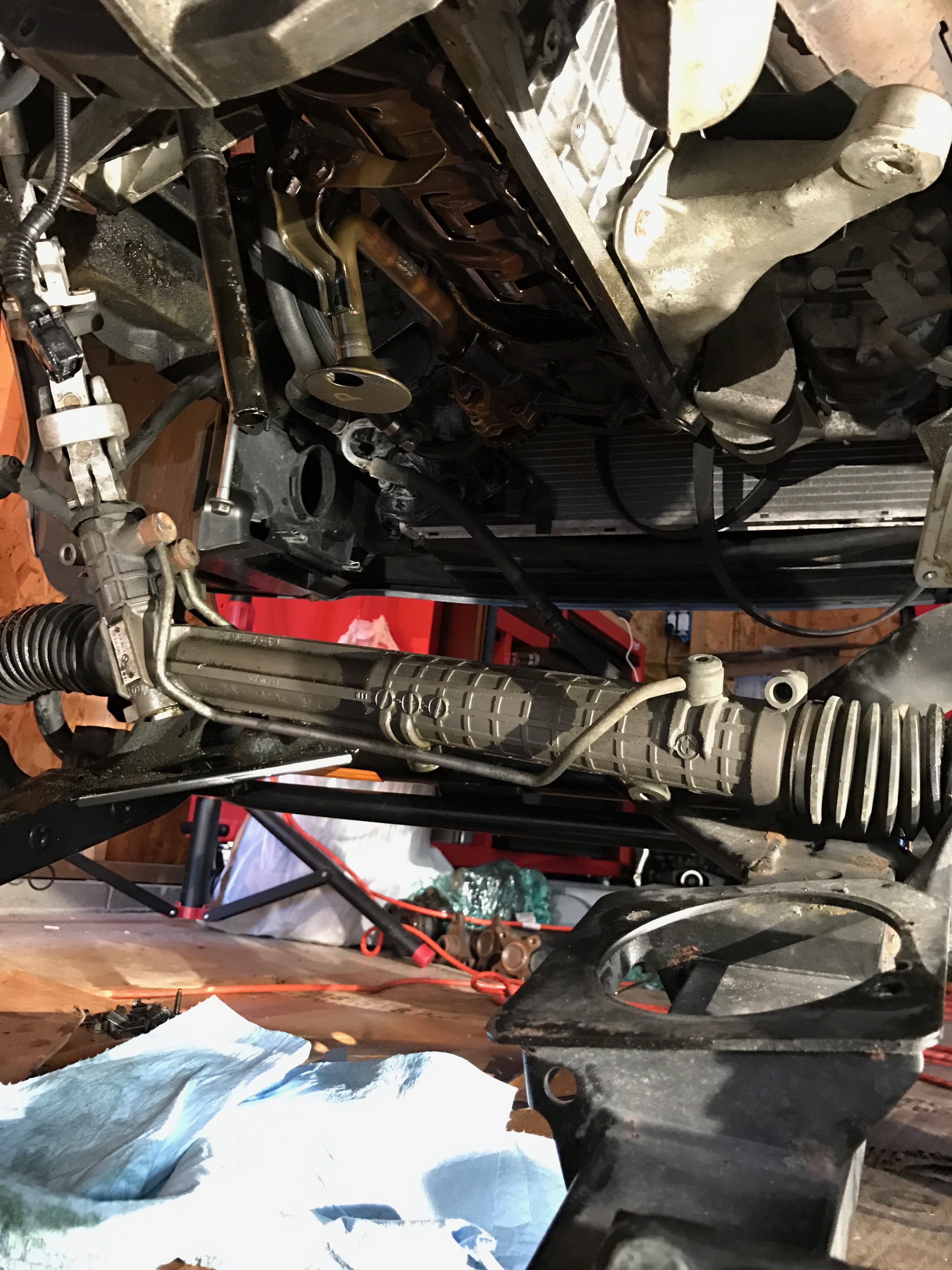

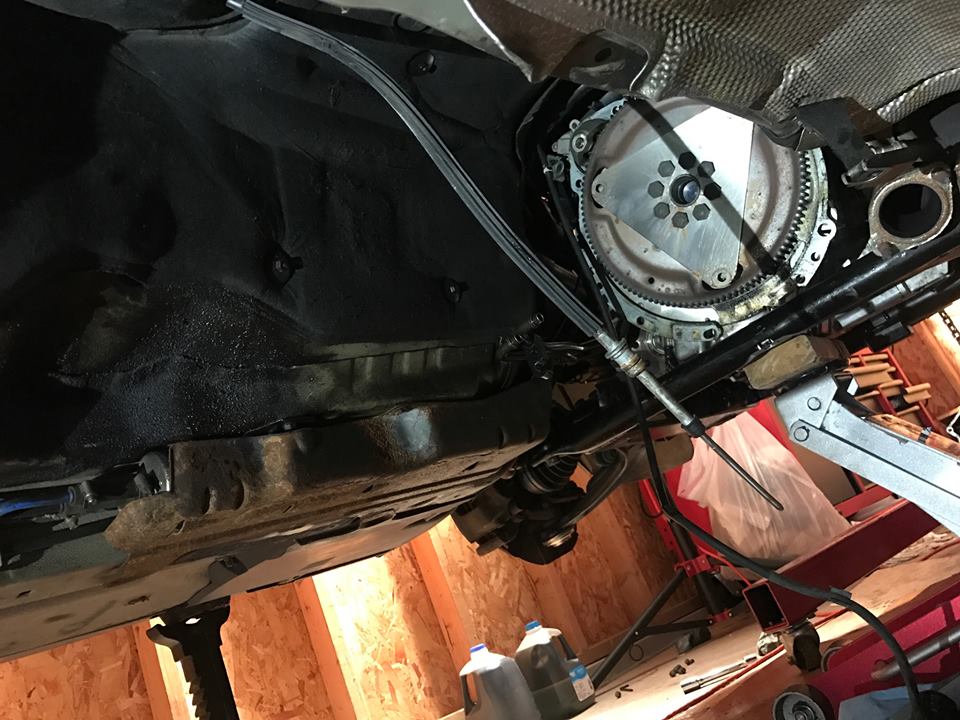

                    Ok so I've been super lazy about this. Billing 120 hours a week right now across 3 clients so time has been exceedingly short. I had to force myself to take some time off on Thursday/Friday last week to legitimately get this car back together. Final detail on the M3 for winterization is Nov. 4th so I am trying to make sure I've got this thing back on the road by then.
                    At this point, all I have left to do is bolt up the driveshafts, brake calipers, exhaust, and pedals. I'm halfway done with soldering the wiring for the clutch switch and the reverse light, there's not much to do there so I don't expect that to take much time. As long as I can get a solid 2-3 hours this week, I think I can have it all back together and put some fluids in it. Waiting on a couple random clips from ECS that will arrive later this week. Then as long as it doesn't grenade, I will try to get it over to Kummrow for re-coding.
                    The only unexpected thing I have run into with the swap was that for some reason, my car didn't have the support bracket for the shift fork bushing welded on at the back of the trans tunnel. Other auto e46s do seem to have this, so I was confused. I had to request the guy I got all my parts from cut it out from his car and send it to me. So then I welded that up only to discover that there must be minor chassis differences between his 2001 325xiT and my 2003, because the way the metal was formed, the bracket was hanging about an inch too low and collided with the guibo off the transfer case. So I took the xfer case back off (annoying), broke the welds, and cut the bracket plate down enough that it could sit nearly flush to the top of the trans tunnel. At that point welding wasn't gonna work because even at the lowest possible heat setting, based on the new location of the bracket, the welder was eating through the metal on the car (thin spots). So i ended up drilling a hole and just bolting the support bracket up. After that, positioning seems fine, and the shift lever is now centered like it should be and all gears seem to be ok for engagement. With the subframe back in and the trans crossmember bolted up - with everything fully straightened the bracket now sits between the guibo and xfer case so no collisions, and sits a bit higher.
                    At this point, I've gotten to the point where I can retrospect a little bit and if I had to do this swap all over again, I can say that because I don't have a lift combined with the fact that I was swapping out differentials as well, I would 100% pull the motor/trans. A lot of people don't swap differentials when they do an e46 manual conversion, and if you don't, then there's no need to touch the subframe and at that point I wouldn't worry about pulling the motor. I did swap the diffs because I wanted a complete swap that included proper gear ratios. My touring auto was a 3.46 and the manual is a 3.23 - due to that, I was forced to lower the subframe to get the front diff and when you're talking about removing both the trans and the subframe, it starts looking more attractive to just pull the motor entirely and bring the transmission along for the ride. That is, of course, if you don't have a lift.
                    There's just not a lot of room to work when you've got multiple jacks (3) like I did at one time in play to jockey shit around or balance things, it gets a bit tedious. I spent a lot of time moving in/out/around the car and was thankful I'm only 34 years old. Timewise it is probably a wash if you pull the motor entirely, but you gain in the fact that overall everything is just easier to work on.

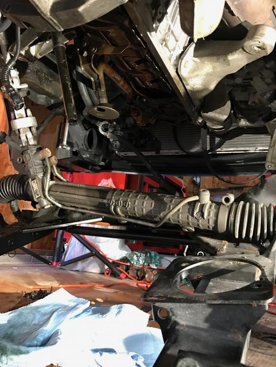

                    subframe had to come down a lot in order to get the front diff out, so I took the opportunity to do the oil pan gasket, etc.

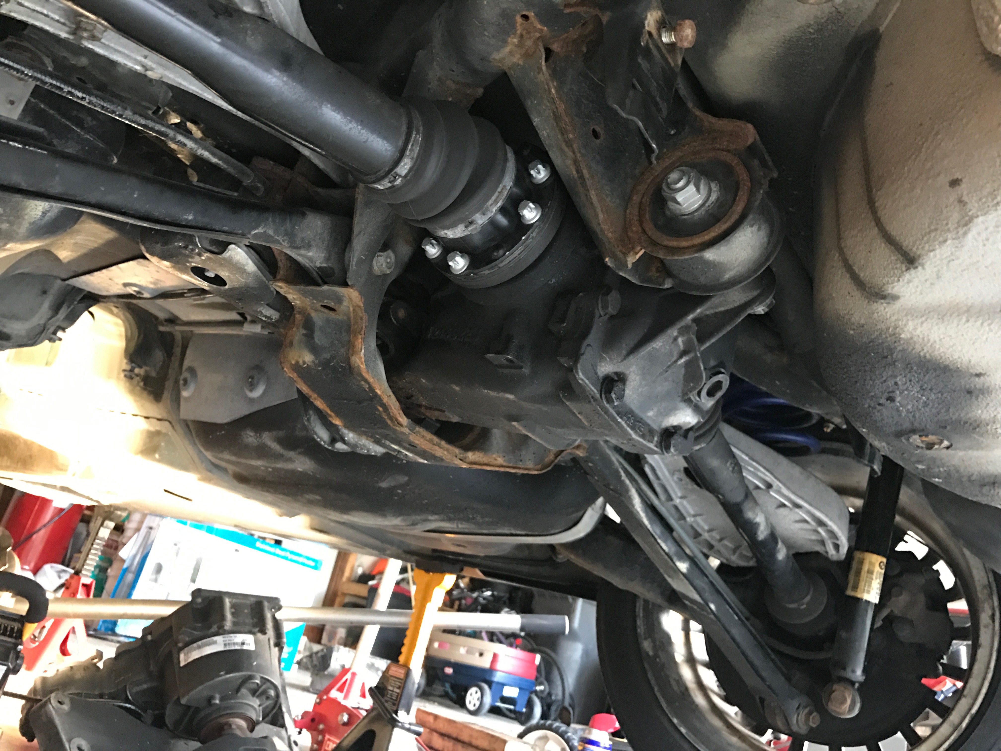

                    Subframe back up with new mounts, etc. xfer case and trans in, rear diff mounted:
                    Finally able to take the engine support brace off and have room up top again as it officially is supporting its own weight now:

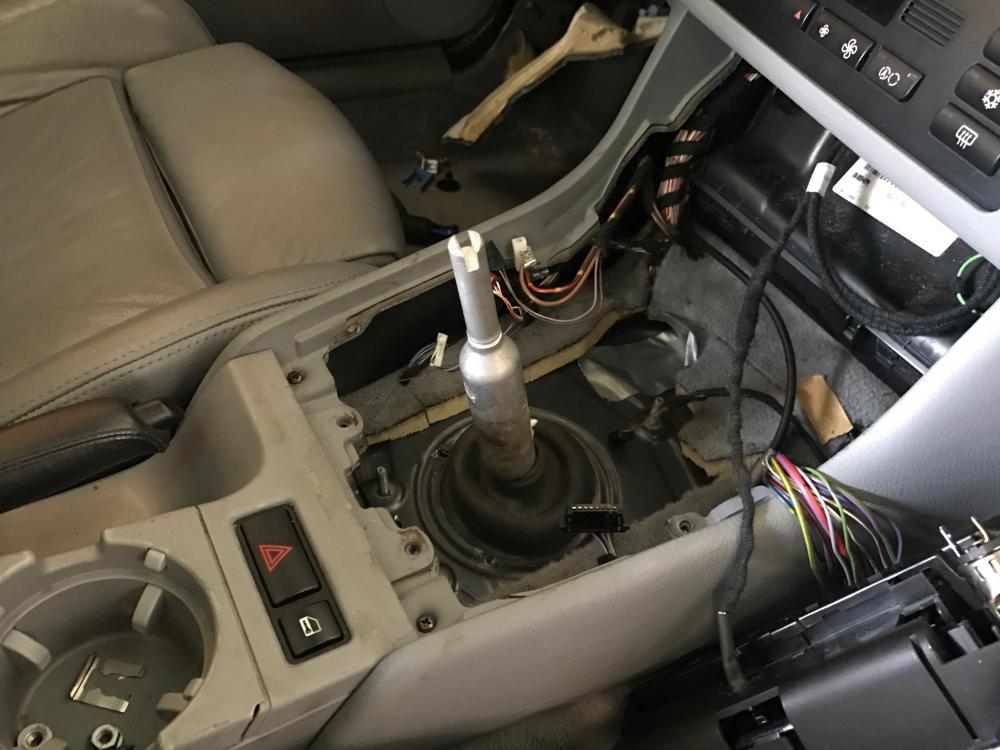

                                I just tried to crank it over to prove the wiring out and we have success!  Initially the security system engaged because I didn't have the EWS pin all the way in, but after fixing that it was instant crank. The car is still on jackstands so I didn't fully let it start but it should be good I think as it was happy to try and crank over.
