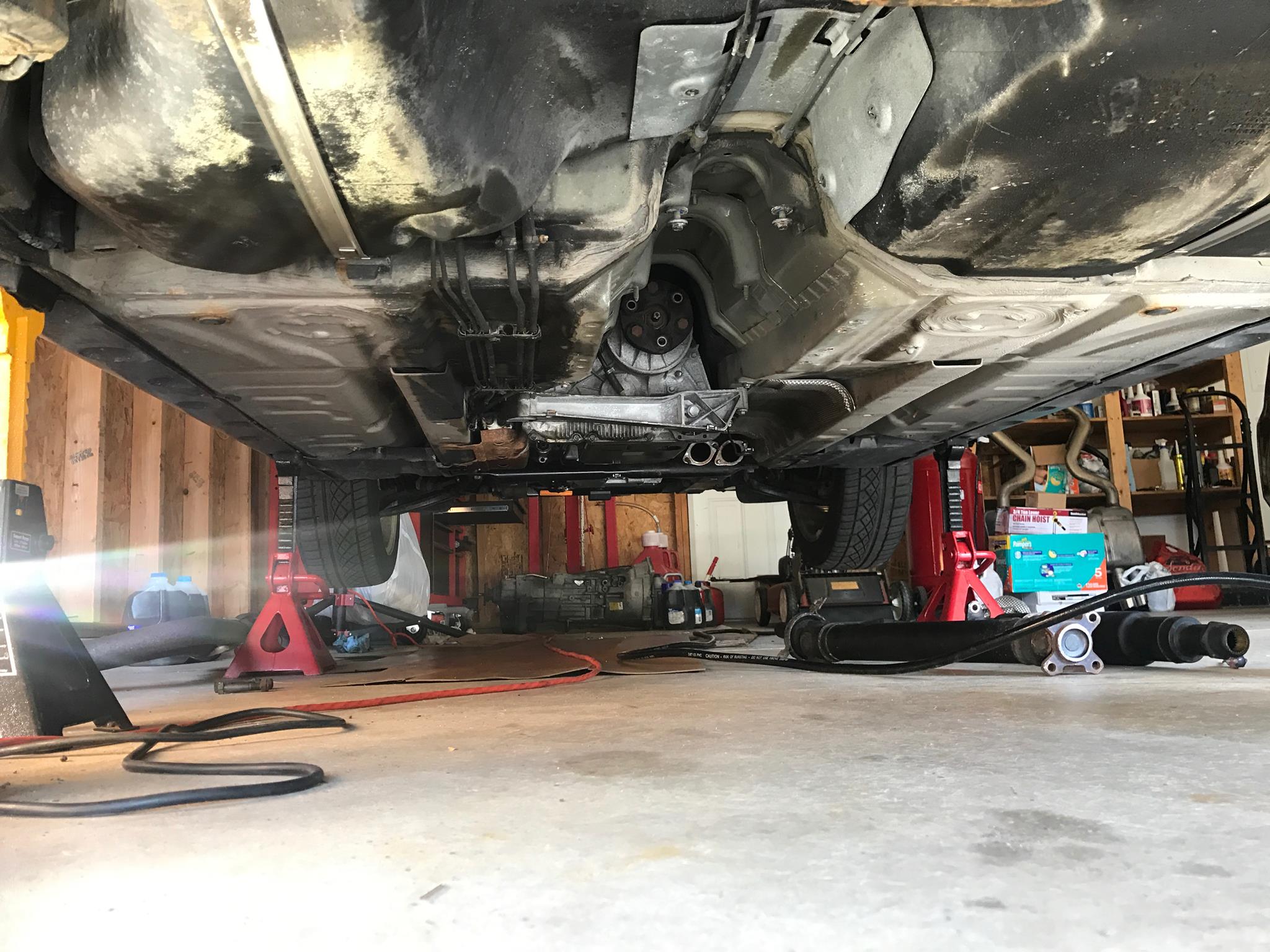

                                  progress. Stopping for dinner and then pulling the trans or getting very close to it tonight

                                      Did the rear diff have to come out? Are you switching ratios or was it just easier for the driveshaft removal?
                                      • i_love_carsI
                                        i_love_carsI
                                        i_love_cars
                                        #39
                                        switching ratios definitely is one reason - i originally wasn't going to when I bought the 330xi trans, because sourcing the awd manual diffs was more legwork and technically unnecessary - the manual is a 3.23 and the auto is a 3.46.
                                        But since I'm getting a complete setup from the dude who's parting out his 325xiT manual, i figured i may as well put the 3.23 since I'll have them now and it will be proper as a more "complete" manual swap.

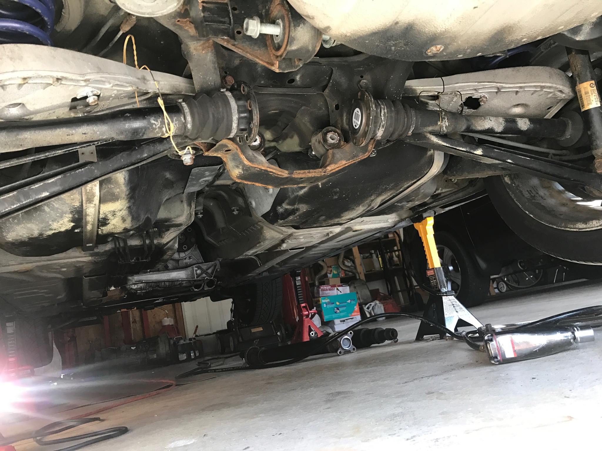

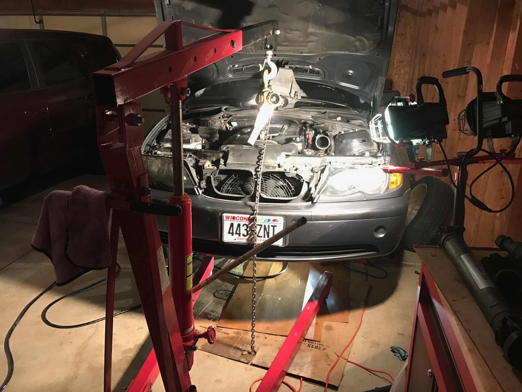

                                          Didn't get much time on this last night as I had to adjust my original plan which was to just use a support bar for the engine, then lower the trans and profit. There's no DIY on doing an AWD auto trans removal so I'm winging it and hoping that experience will guide me. I tested the waters to see how low the trans would go before hitting my stupid AWD subframe which is totally in the way of basically everything. So unfortunately because one of my goals is to do this without fully removing the front subframe, I need to raise the engine. So out came the hoist.
                                          The torque converter has been unbolted and the trans cross member is off. Supposedly the front diff comes out if you just remove the 4 main bolts on the subframe and also the engine mounts, when combined with the fact that the strut knuckle will be loose from removing the axles. You should be able to lower the subframe a few inches without undoing the 20 or so other bolts holding on random suspension shit on the stupid AWD subframe then, getting enough room to remove the diff.
                                          So knowing that, I think the first thing I'm gonna do here is try to keep it simple and just get the engine mounts out of the way and try to raise the engine and hope I get enough tilt on the trans to get the top bellhousing bolts. Assuming that works out, I'll put a jack under the subframe and remove those 4 mounting bolts and see if I can lower it enough to get the front diff out.
                                          I really, really, really don't want to take the front subframe off if I don't have to. I won't be getting to anything until late afternoon today but I will have a second set of hands helping me speed things along. I'm still planning to have everything removed including pedals and shifter by the end of the weekend.
