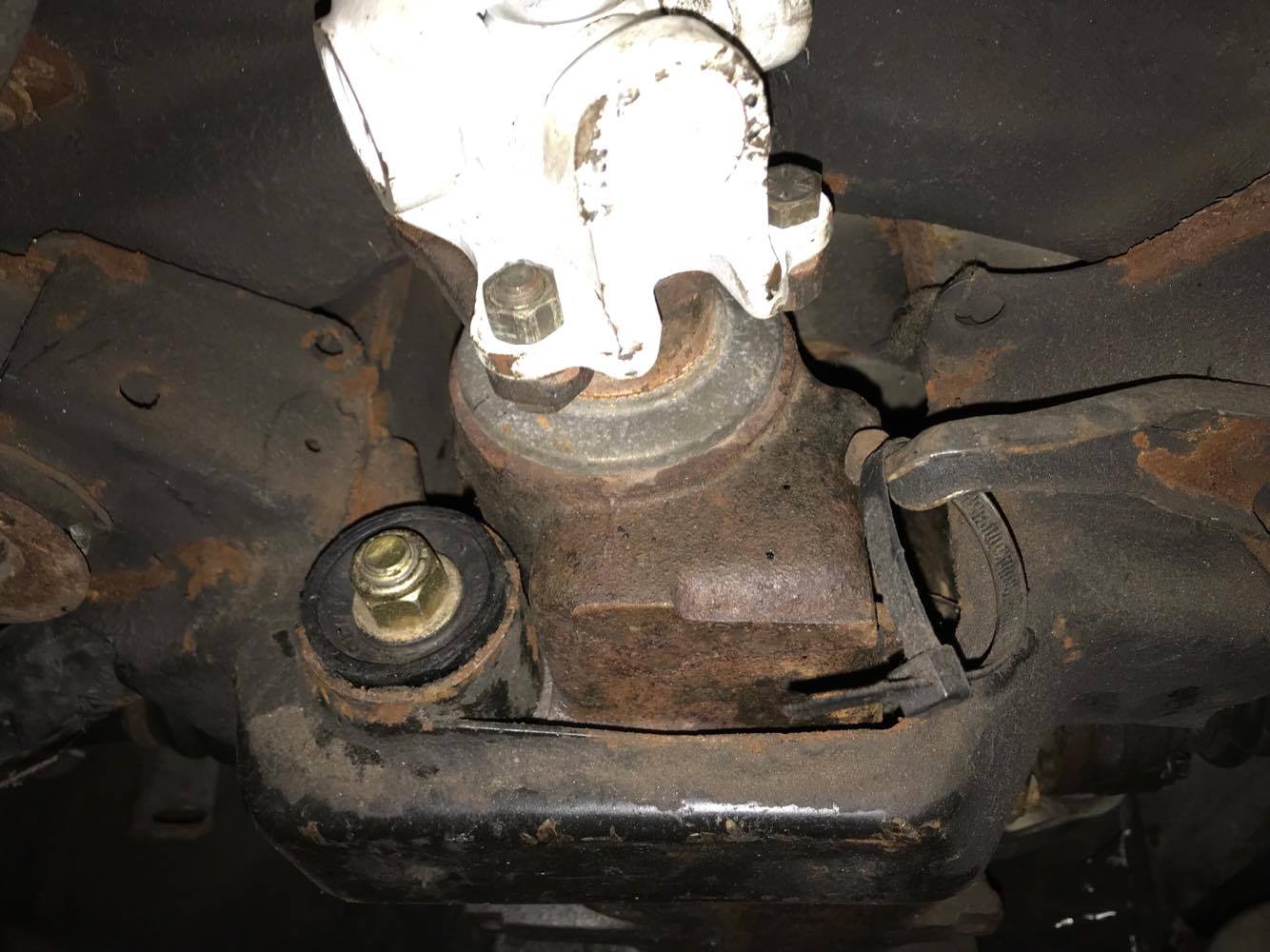

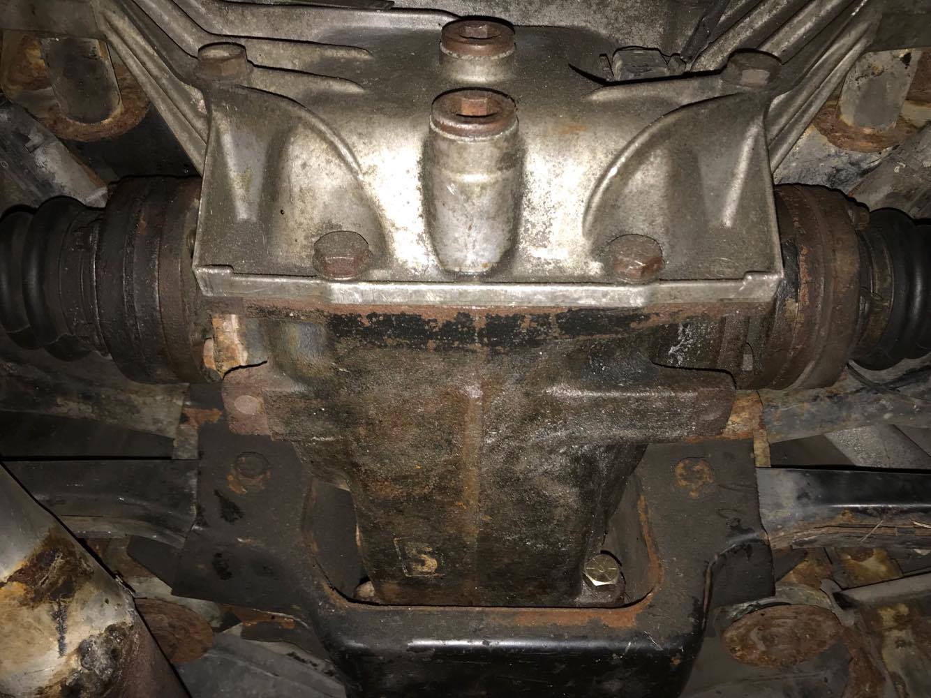

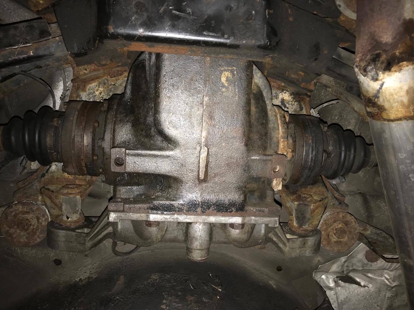

                    So I feel like an idiot for never checking this but this is my current predicament. I was going to go to the final drift event this weekend, but now that's looking like its going to be a stretch.

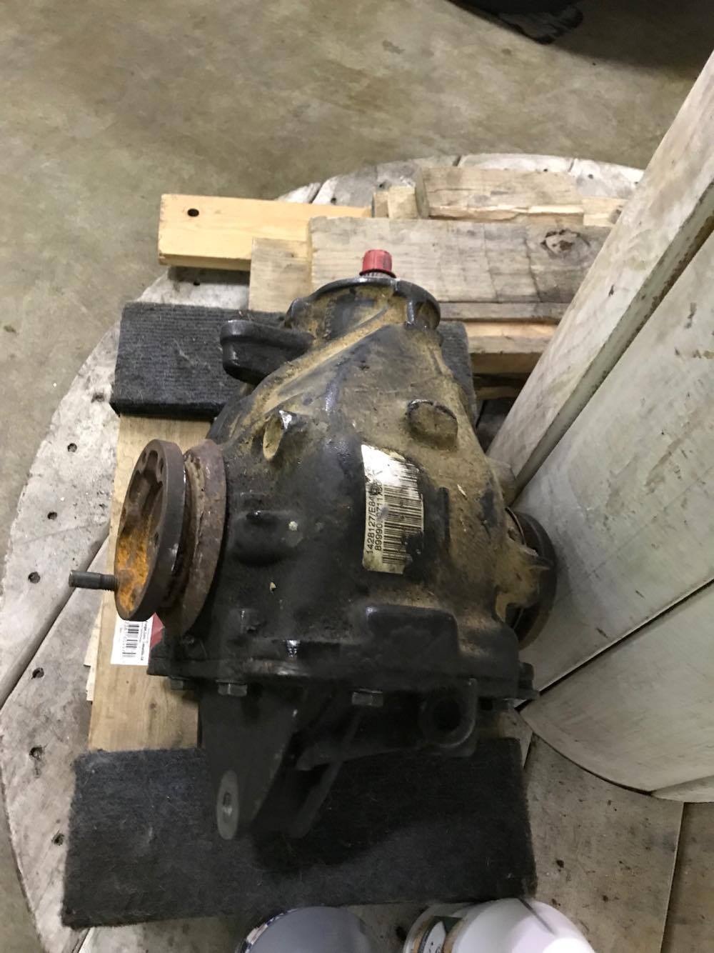

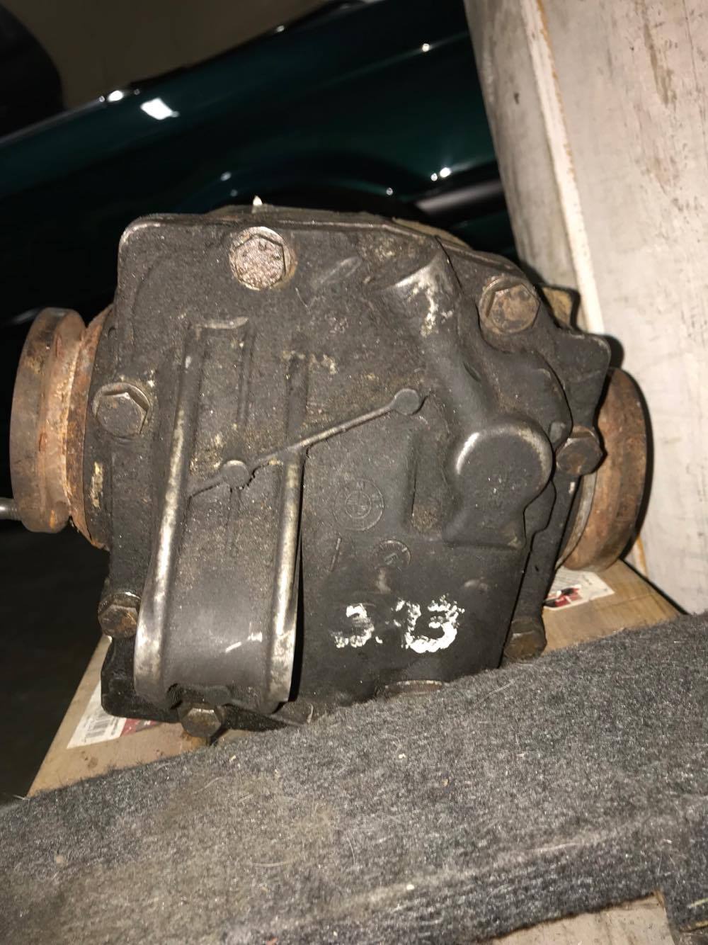

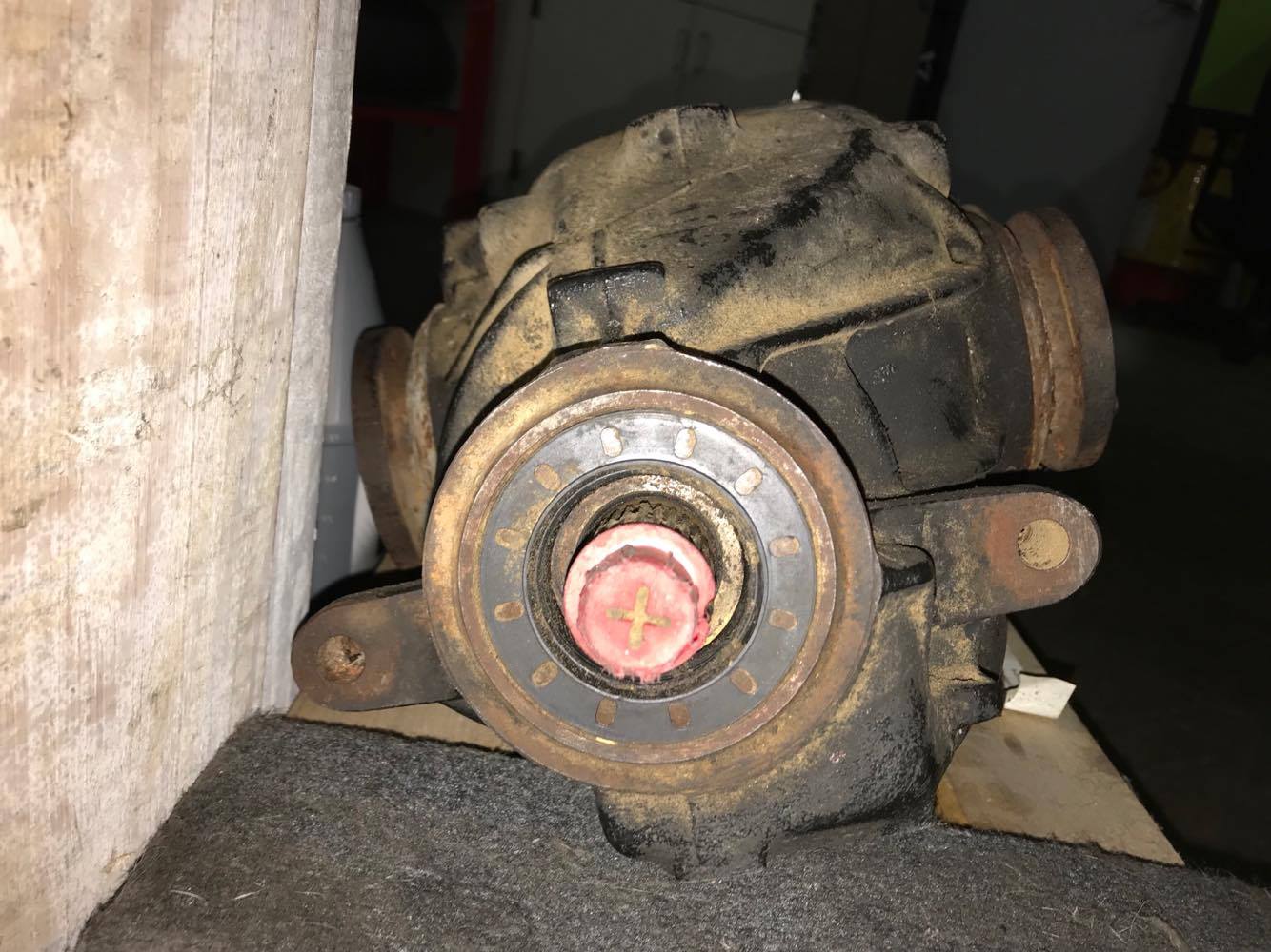

                    I had a what I thought was a spare 3.93 open diff for this car that I welded and was going to install last night. Problem is that its not the same style as what is in the car. The front half mounting position only has one mounting ear to the sub frame and the one I welded has two. So if anyone has an open 3.93/4.10 E36 diff that has one front mounting ear, I will trade you or buy it from you.
                    For sale/trade-
                    • 3.93 Welded
                    • 3.91 LSD
                    This is the diff/ subframe I have in the car:
                    This is the diff I welded:
                    22251468101548725346371091081206825o.jpg2221922410154872534432109932229113o.jpg22219403101548725345371091971762840o.jpg
                    I assume I cannot use this diff because the front mounting ears are not the same. Am I correct?

                      Idk if that is from an e36
                        #351
                        With much headache and research I have discovered that the new diff I welded is for an E46. On the hunt for an E36 unit thats open in the 3.91-4.44 range.
                          #352
                          @Daggerty to the rescue! I have another diff to weld, thanks again!

                                        Didnt make it to the event though. Other priorities and PO stupidities prevented an easy bolt in procedure. Remember the half a bolt head bolt in the diff? Yeah that's because someone drilled the diff out when they lost/stripped the original bolt. The sub frame was an easier fix and I was able to tap in new threads. Only problem I still have is that the subframe should be raised. With the 1pc driveshaft the universal joint will hit the chassis under heavy torque.

                                          I broke that differential mount bolt once, it was super fun.  I made a fancy bushing that is not necessary but you may have an easier time putting the bolt in the other way.  I had to grind some clearance in the casting to use a 1/2" bolt.
                                          http://www.wibimmers.com/board/index.php?/topic/4778-fancy-stancy-325is/&page=3
