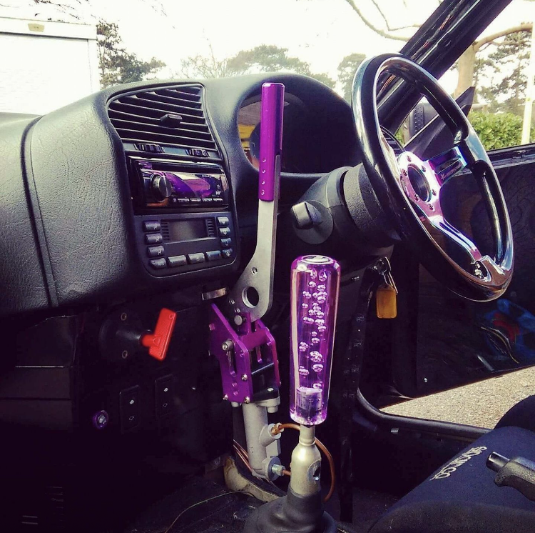

                  Not much to report on this as of lately. I did fix the lug holes that were stripped out by PO and ordered and replaced the shifter bushing that was missing. I also covered the trans tunnel hole with a nice piece of silicon sheet from McMaster Carr to prevent heat, noise, and other elements from coming into the cabin(pics of this later). I did though, manage to see something that has me rethinking my hydro bake location and lever design...
                    #189
                    placement looks good. aluminum lever style looks good. handles are women's sex toys...good?

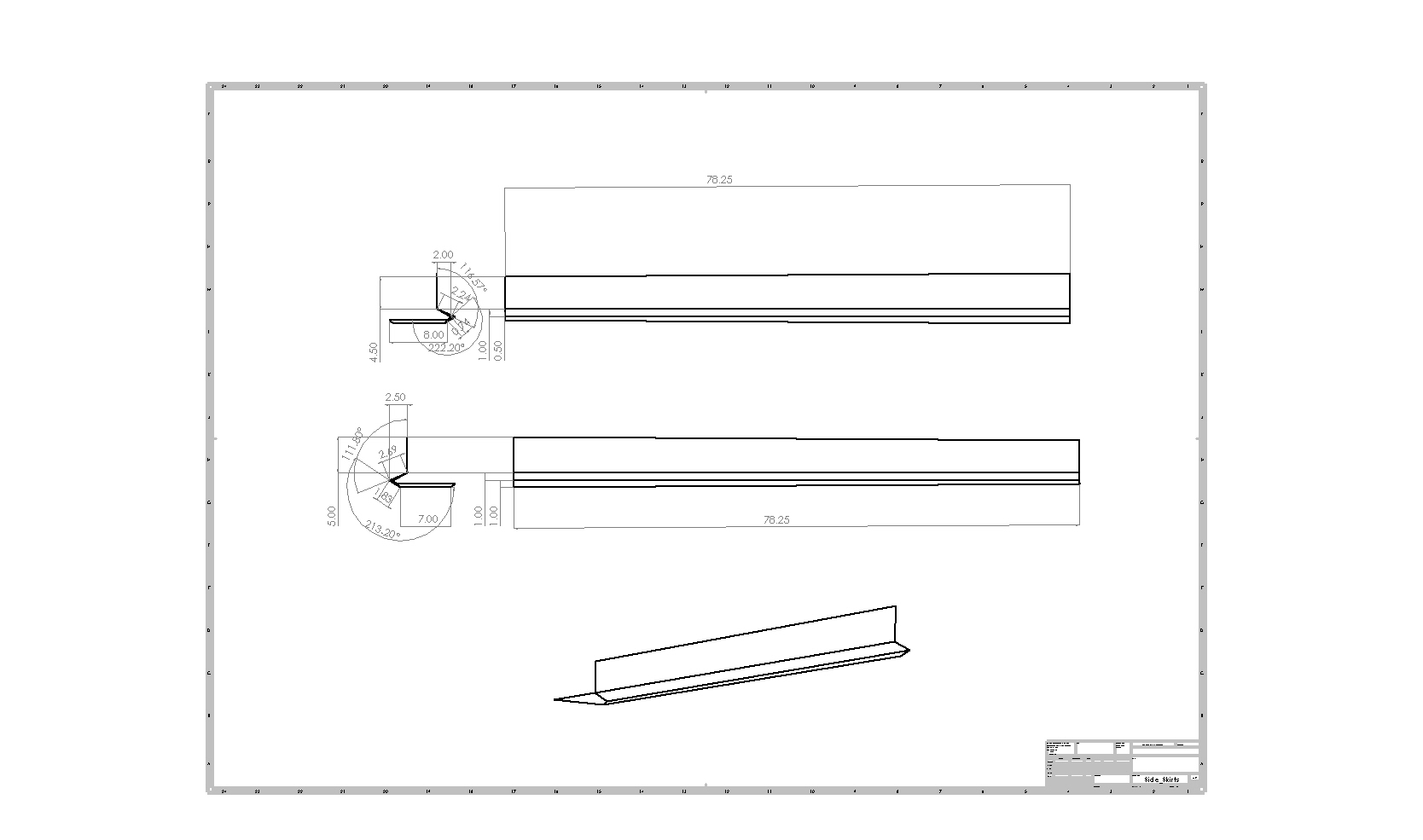

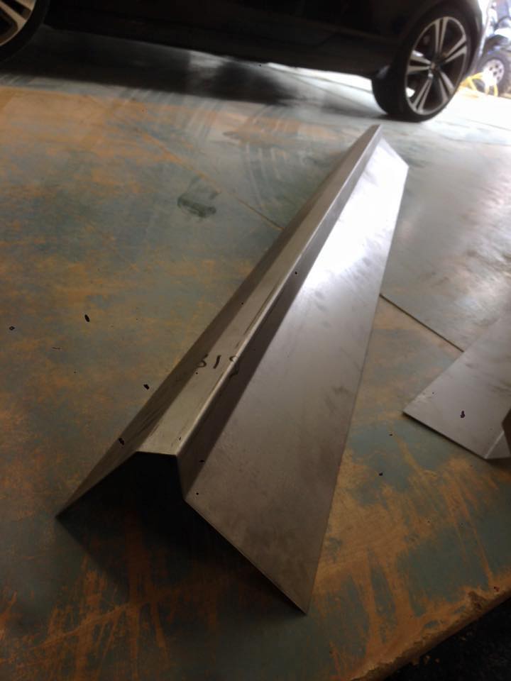

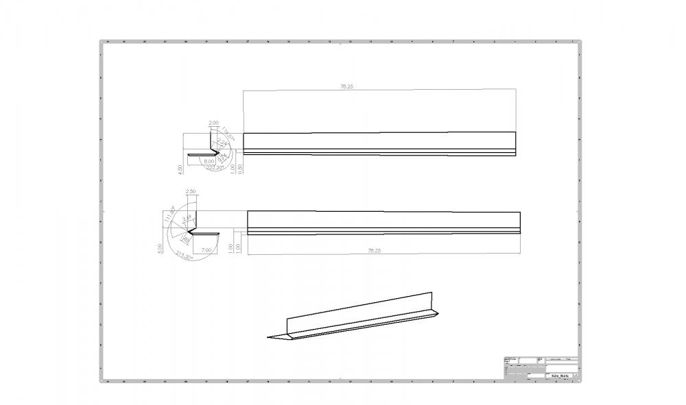

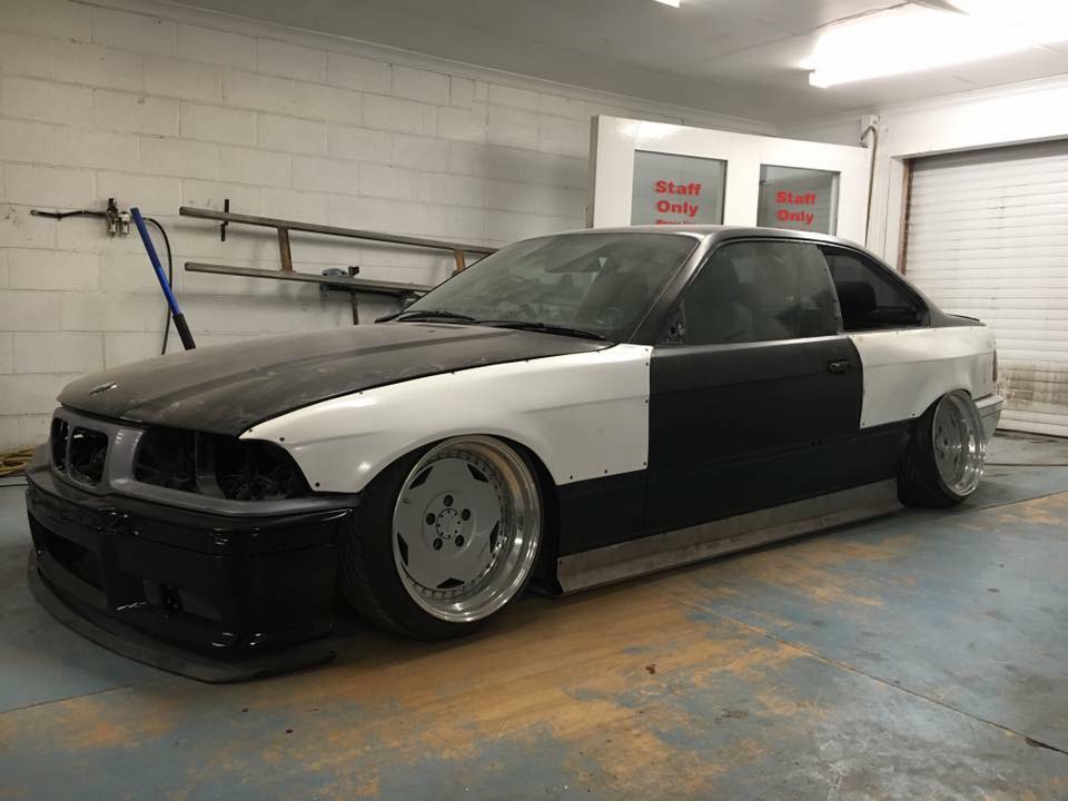

                            I contacted a friend of mine with a 12' brake at his shop that is going to bend up some side skirts for me. So I made him a quick orthographic with dimensions. Material is undecided, more or less I am just letting him use what ever is easier for him. He said he has aluminum, polycarbonate / lexan, and steel so we will see.
                            Here is an example of a guy in the UK that made a set for his car

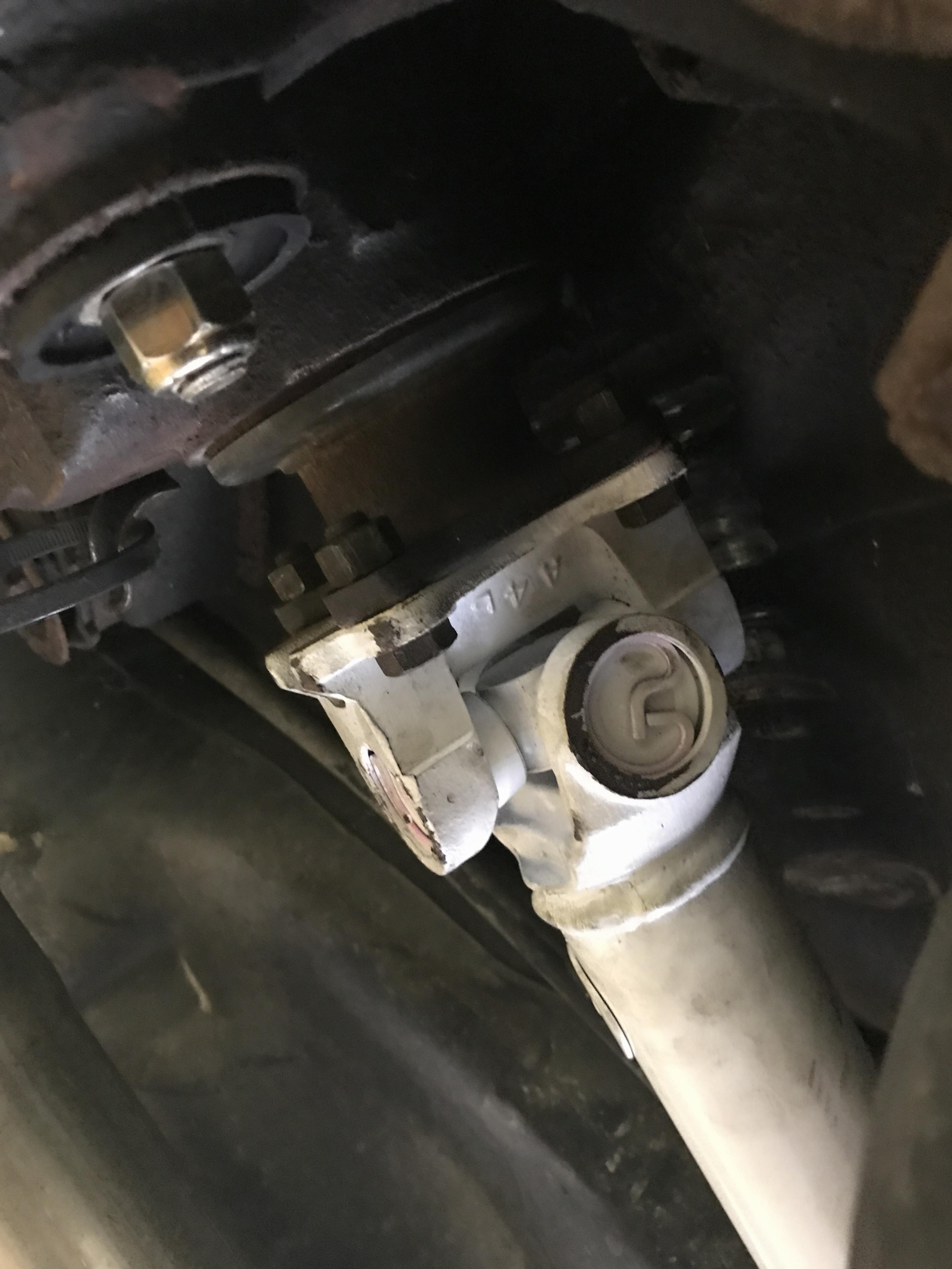

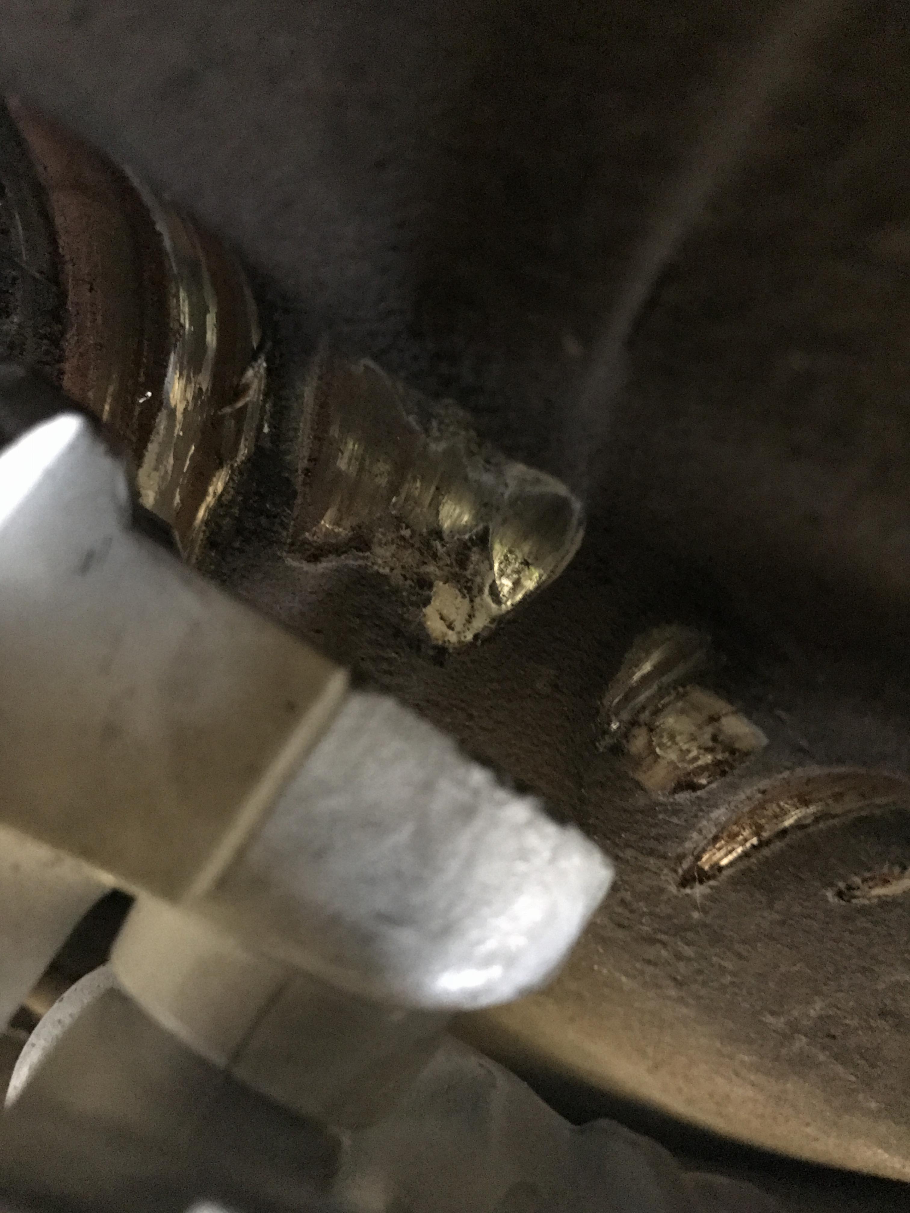

                                      Got pretty ballsy Last night and decided to drive 20 miles. It made it there and back without issues, but there was certainly ALOT of noises coming from areas. Areas noises shouldn't come from. I think my driveshaft/ brake/ scraping noise needs further inspection. It made the noise the entire time I drove, and was there at all speeds, 0-60 mph. I did manage to put the car on the lift before I left to make sure everything was tight and noticed these marks/gouges, but I wouldn't think that the suspension compression would move the drive shaft enough to make the connection. I assume these are older marks from a previous time. I need to compress the suspension when I have it on the lift and confirm this though.
