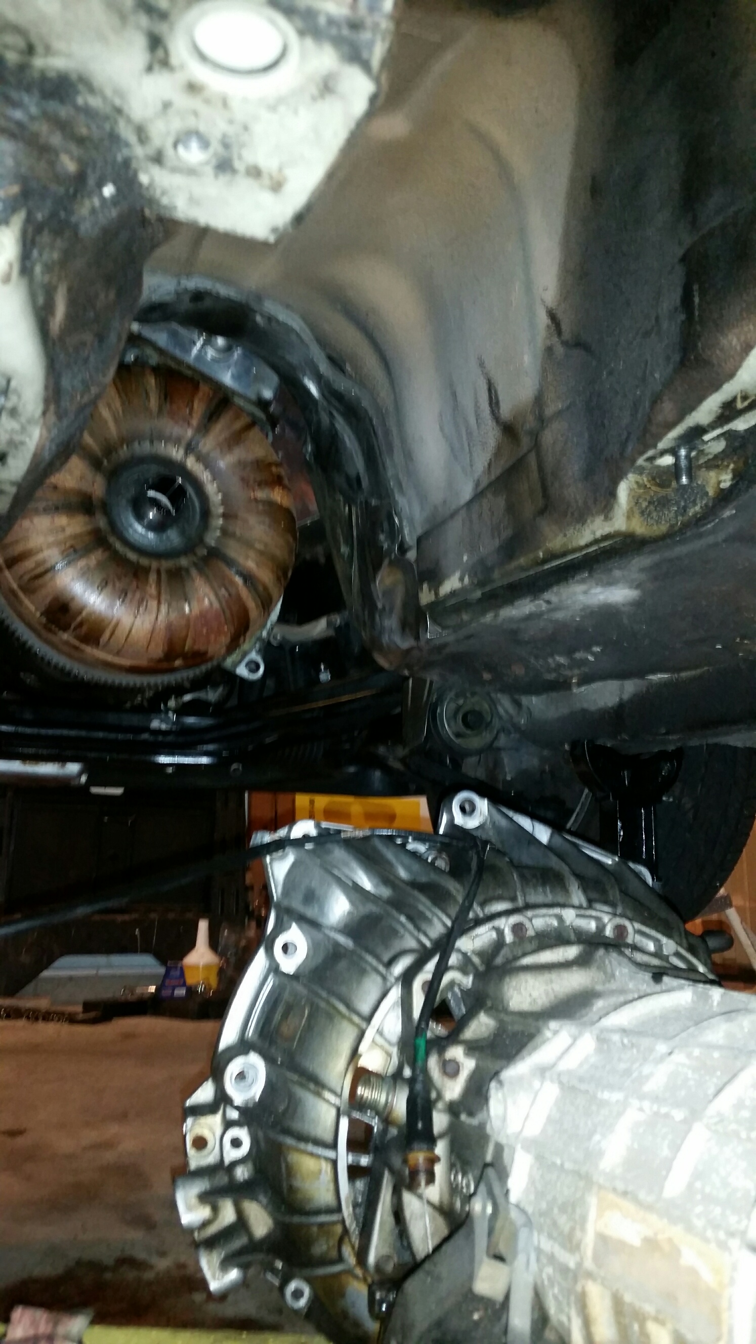

<p dir="auto"><a href="/assets/uploads/files/monthly_2016_09_trans.jpg.2baedbe800693325e01d5e27b1ad80f3.jpg"><img src="/assets/uploads/files/monthly_2016_09_trans.thumb.jpg.884f51b5fb7e45b544348b31cd8d542c.jpg" alt="trans.jpg" class=" img-fluid img-markdown" width="422" height="750" /></a></p>

<p dir="auto"><img src="http://uploads.tapatalk-cdn.com/20160927/381fe9ab30da15b9ac5436d96bdca6e4.jpg" alt="381fe9ab30da15b9ac5436d96bdca6e4.jpg" class=" img-fluid img-markdown" /></p>
<p dir="auto">I cant physically help you but I can walk you through the order of operations and what needs to be disconnected</p>
