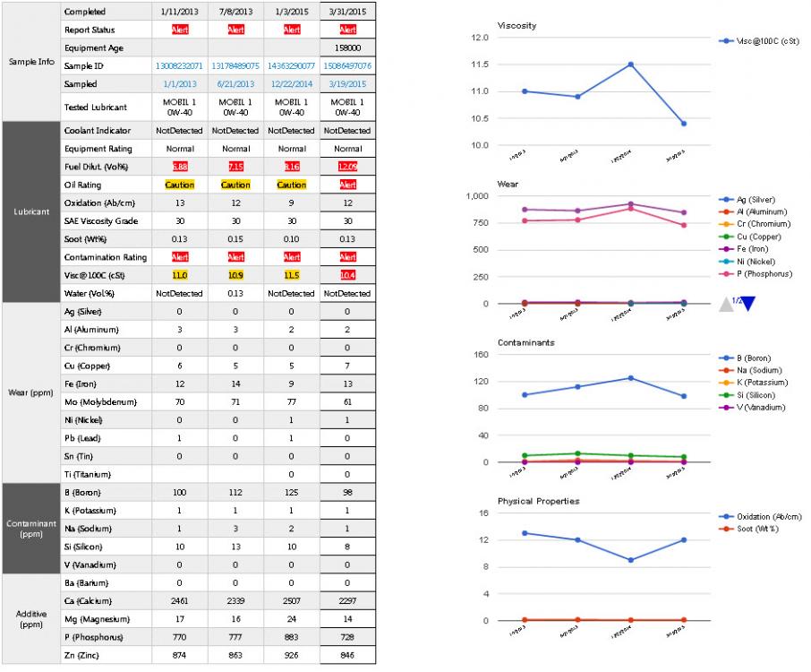

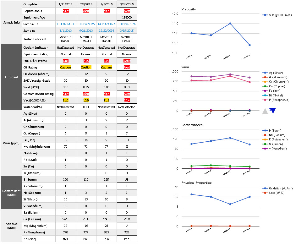

<p dir="auto">If you are really concerned and don't want to pull the engine apart you could start by sending in the oil for analysis. The wear part per million will tell you what type of metal you are dealing with. It will at least give you peace of mind knowing if its a bearing or not. </p>
<p dir="auto">I changed the oil on Saturday and found the issue on Sunday, unfortunately I already disposed of the oil and have no way to get it back because that would really help me get answers. The particles I pulled from the engine were magnetic shavings (so most likely steel) with some being a bit bigger than a grain of sand, if it were rod bearings I would imagine I'd be hearing knocking.</p>

<p dir="auto"><a href="/assets/uploads/files/monthly_2016_04_570d42683cc29_4-12-20161-42-09PM.jpg.c417413b7419073410e6f6585743d748.jpg"><img src="/assets/uploads/files/monthly_2016_04_570d426865742_4-12-20161-42-09PM.thumb.jpg.eb0850a66f19324cd037b094f0f3ad76.jpg" alt="4-12-2016 1-42-09 PM.jpg" class=" img-fluid img-markdown" width="906" height="750" /></a></p>
