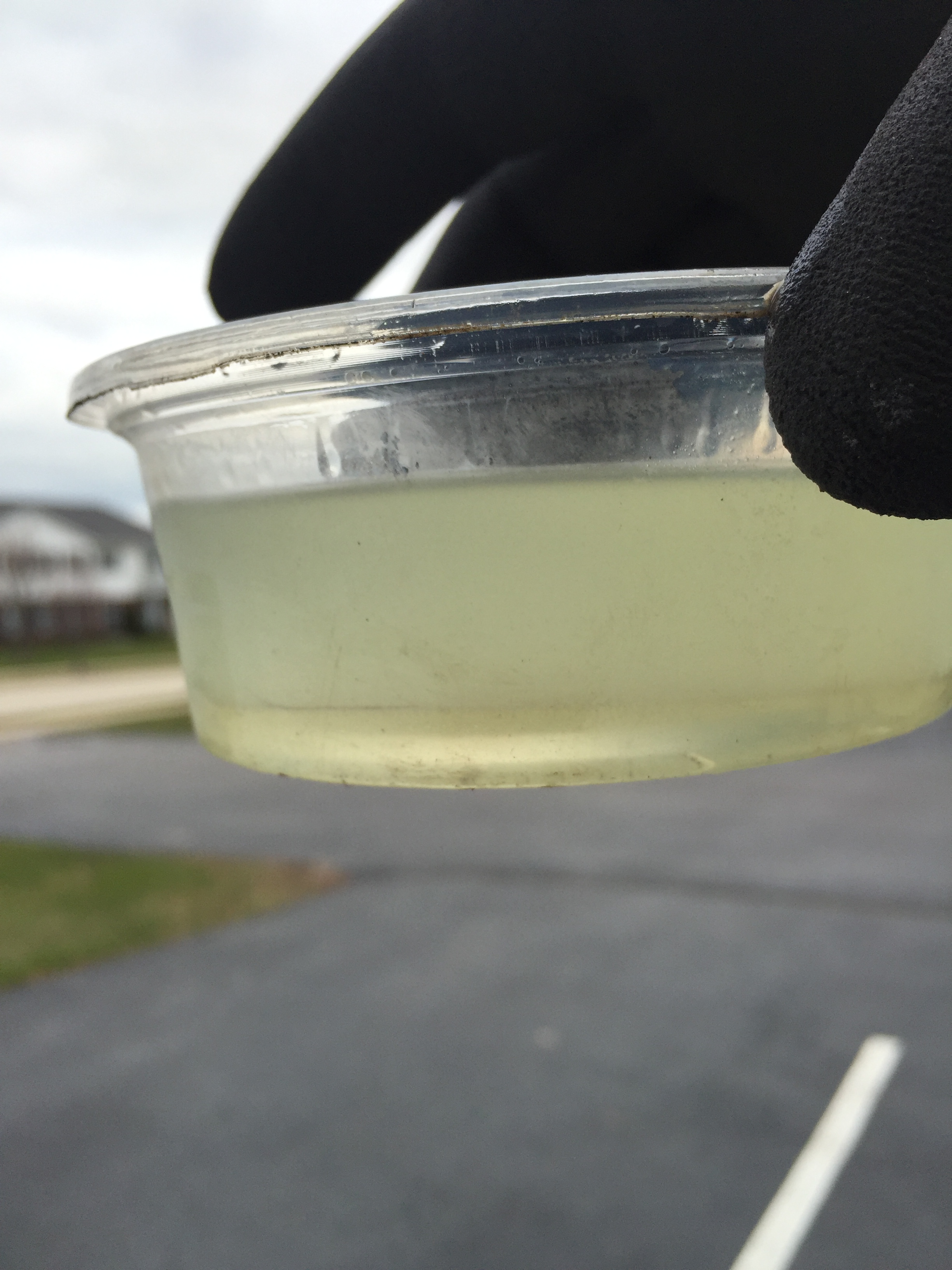

<p dir="auto">Two weeks ago I was driving my e34 home from work and was running dangerously low on fuel so I stopped and got gas at a BP in Belgium. I put somewhere near 20 gallons of gas in my car and took off. I was only able to make it to the freeway on ramp before the car sputtered out with symptoms opposite of a bad vacuum leak but to the same effect (foot to the floor would stall the car). I was able to get the car to idle for a while but it was clear that the car was not getting the correct AFR (running lean). It even threw a faulty primary O2 reading code. It was cold and snowing so I had it towed home thinking that my fuel pump was failing or my pressure regulator was simply stuck open. Expecting the worst I ordered new filters, regulator, and pump before I even began troubleshooting figuring I would just return what didn't work. I started by changing the filters and they were extremely bad so either way it was good that I did. Then I jumped the fuel pump relay to make sure that the pump was getting sufficient pressure and everything checked out. Finally I replaced the FPR but still no start. At this point I was pissed because I knew that the electrical and air side were operating correctly and I basically replaced the whole fuel system. The next day I felt pretty defeated at work and made a joke about bad fuel to my co-worker. I was expecting a laugh but instead he told me of a similar story of when he was 19 and had this happen to him. I called up BP and was "shadily" directed to the owner who admitted to selling potentially contaminated premium without having it checked by a state official who couldn't make it due to the weather that day. When I got home I siphoned all the gas out, bled my lines, and this is what I found within 2 minutes of settling. Keep in mind that I got mid grade which is unleaded and premium mixed at the pump so it is not as water potent as straight contaminated premium would be. It's been 3 weeks now and their insurance is dodging me and my car still won't start due to either fouled out plugs or clogged injectors. I will let you know how it goes tomorrow when I pull the plugs and fuel rail. </p>
<p dir="auto"><a href="/assets/uploads/files/monthly_2016_04_IMG_1017.JPG.3ec19f0ac7b61b43c957ef9e549051ca.JPG"><img src="/assets/uploads/files/monthly_2016_04_IMG_1017.thumb.JPG.4c3e8b8c9dfb2e92cae549d49c372edf.JPG" alt="IMG1017.JPG" class=" img-fluid img-markdown" width="563" height="750" /></a></p>

<p dir="auto"><strong><a href="/post/67829">straight6pwr said:</a></strong></p>
<p dir="auto">you've pumped out all the lines and replaced the fpr, did you do anything to the injectors? besides the fuel pump and fpr they are really the only thing left in the fuel system. buy a set of rebuilts, they are pretty cheap, maybe $60 for the set.</p>
<p dir="auto">i don't see how anything air or electrical would have been affected at all, so don't start chasing there.</p>
<p dir="auto">It took awhile to push the stuff through the system but I finally got her running. I was so worried the injectors were clogged last night.</p>
<p dir="auto"><a href="https://vimeo.com/162209189" rel="nofollow ugc">https://vimeo.com/162209189</a></p>
