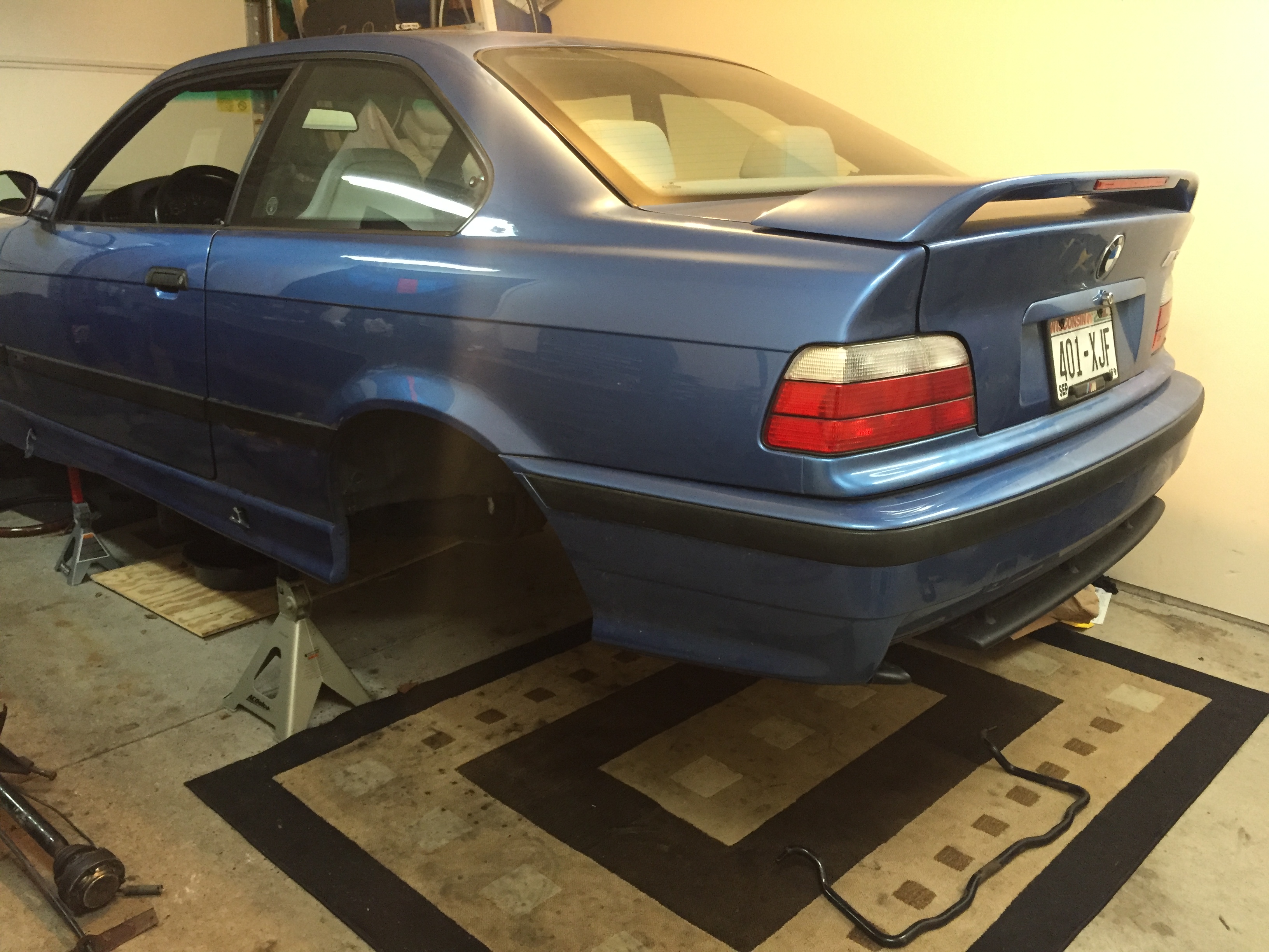

<p dir="auto">My name is Joe and some of you might know that I purchased a 1998 e36 M3 a few months ago. So far it turned out to be a good purchase but the car has it's flaws. Last fall I sheared the front carrier bolt on my differential (having too much fun) which messed a lot of stuff up so I decided to rebuild the rear end. The way I looked at was A.) I could have a moderately clean looking show car or B.) I could have a good looking (entry level) race car. I have always wanted to get into racing and with an M3 in the garage I just couldn't resist. So my plans are to start out with Autocross and keep my modifications limited to suspension so that I don't get thrown into a class out of my league. My car has been in the garage all winter but it wasn't until a few weeks ago that I decided to get my ass in gear. So far this is what I have done...</p>

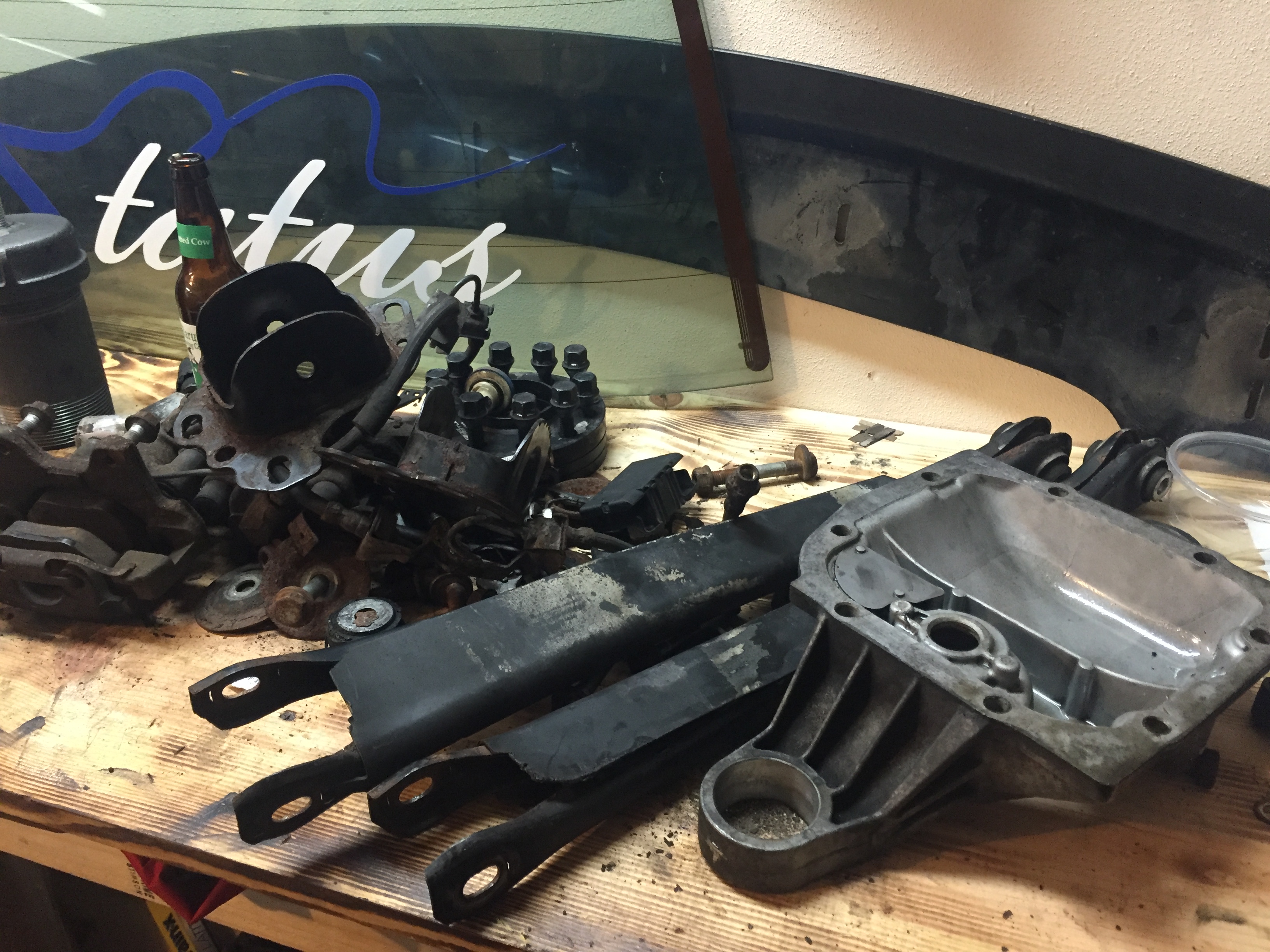

<p dir="auto">The whole rear end is out</p>

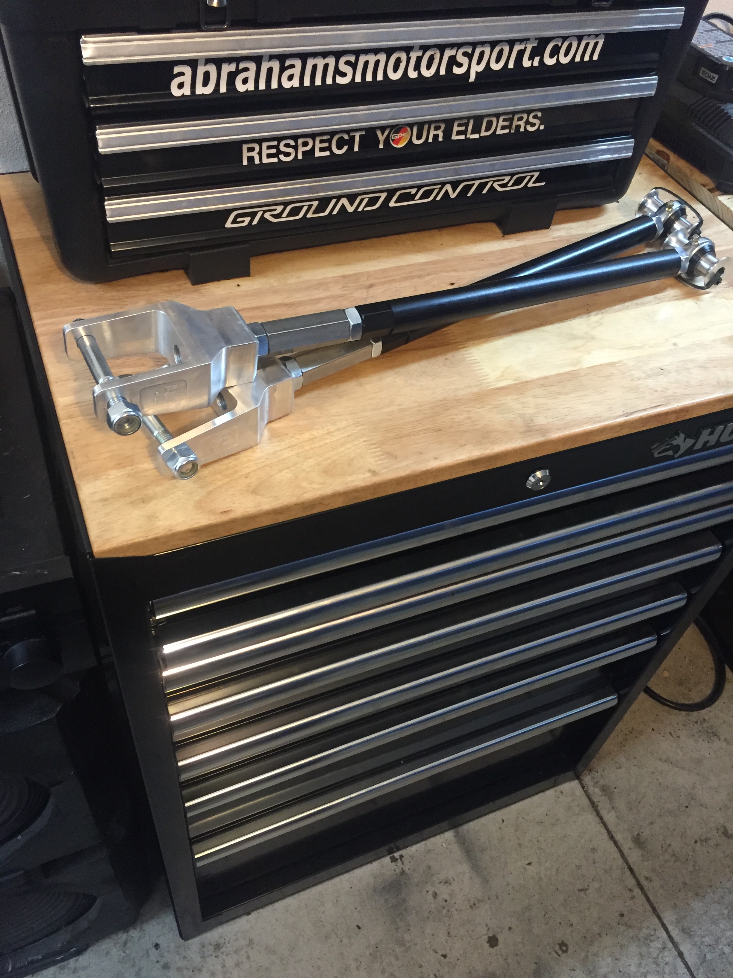

<p dir="auto"><a href="/assets/uploads/files/monthly_2016_04_1.JPG.09affbc565fae63270274436defa0462.JPG"><img src="/assets/uploads/files/monthly_2016_04_1.thumb.JPG.7d27ba4926b94cf80c7adadf641d0342.JPG" alt="1.thumb.JPG.7d27ba4926b94cf80c7adadf641d" class=" img-fluid img-markdown" width="1000" height="750" /></a></p>

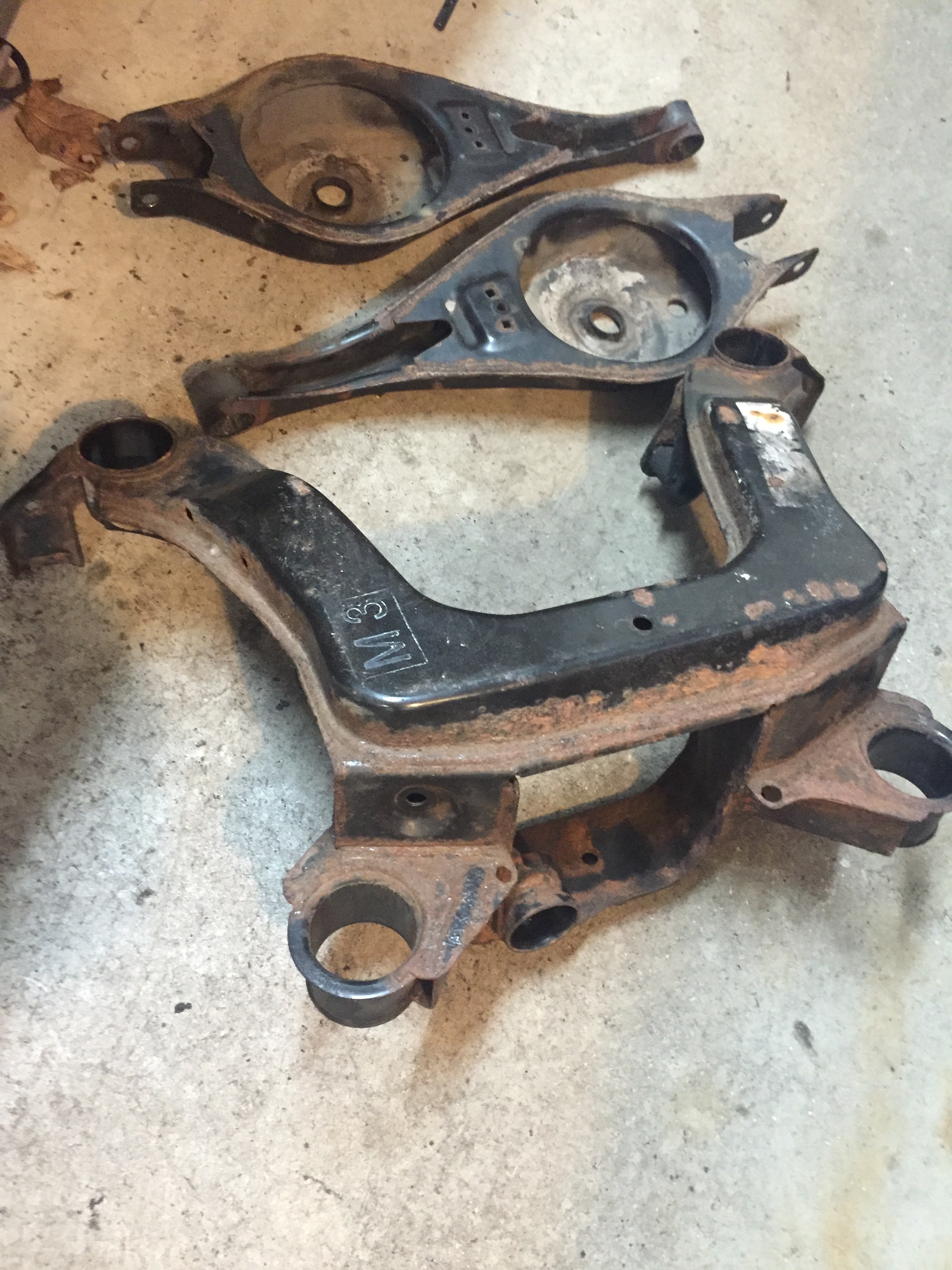

<p dir="auto"><a href="/assets/uploads/files/monthly_2016_04_2.JPG.76276484dacec46308b365a0fcb429a8.JPG"><img src="/assets/uploads/files/monthly_2016_04_2.thumb.JPG.eaa03ab104af61fb305074f9d718d24a.JPG" alt="2.thumb.JPG.eaa03ab104af61fb305074f9d718" class=" img-fluid img-markdown" width="1000" height="750" /></a></p>

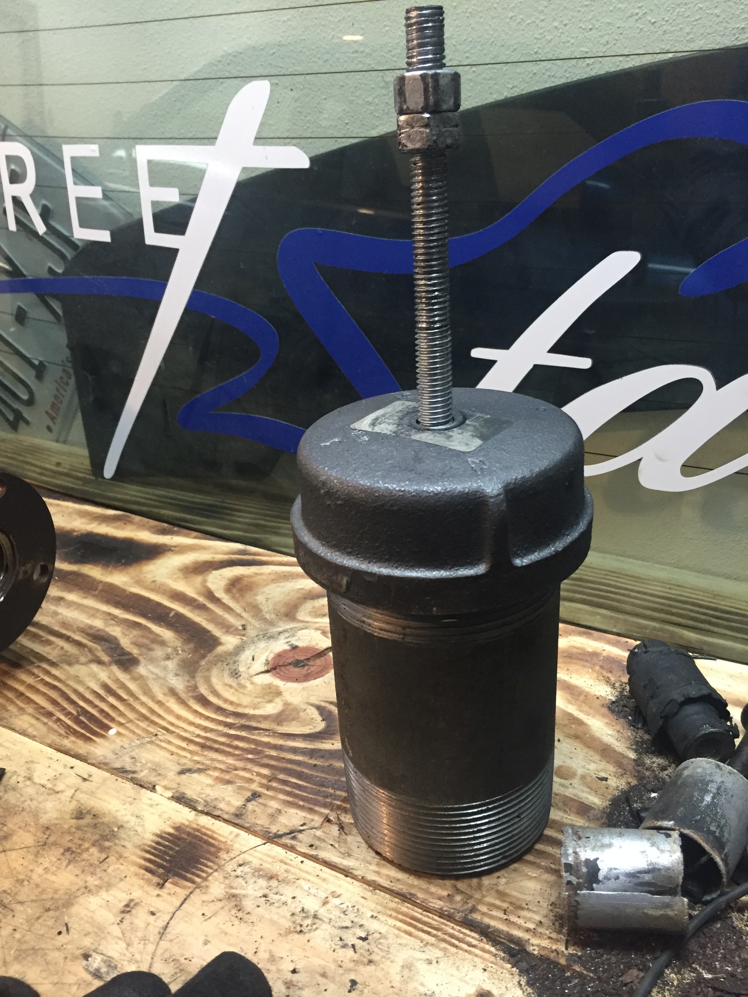

<p dir="auto">I made a bushing extractor tool with 3" pipe and the threaded rod lasted just long enough to get all the bushings out. It worked better than I expected. Some didn't pull the metal sleeve out with the bushing but nothing a cheap hack saw couldn't fix. </p>
<p dir="auto"><a href="/assets/uploads/files/monthly_2016_04_4.JPG.d2c65952e82515749810bfc6ab64993e.JPG"><img src="/assets/uploads/files/monthly_2016_04_4.thumb.JPG.2d2078f67e2d74a4a3f757c0e99f2443.JPG" alt="4.thumb.JPG.2d2078f67e2d74a4a3f757c0e99f" class=" img-fluid img-markdown" width="563" height="750" /></a><a href="/assets/uploads/files/monthly_2016_04_5.JPG.706b75feb8afed8220f30e953db4e751.JPG"><img src="/assets/uploads/files/monthly_2016_04_5.thumb.JPG.bef4dc8ed5d4ca1a5715b5ab668a67d2.JPG" alt="5.thumb.JPG.bef4dc8ed5d4ca1a5715b5ab668a" class=" img-fluid img-markdown" width="563" height="750" /></a></p>

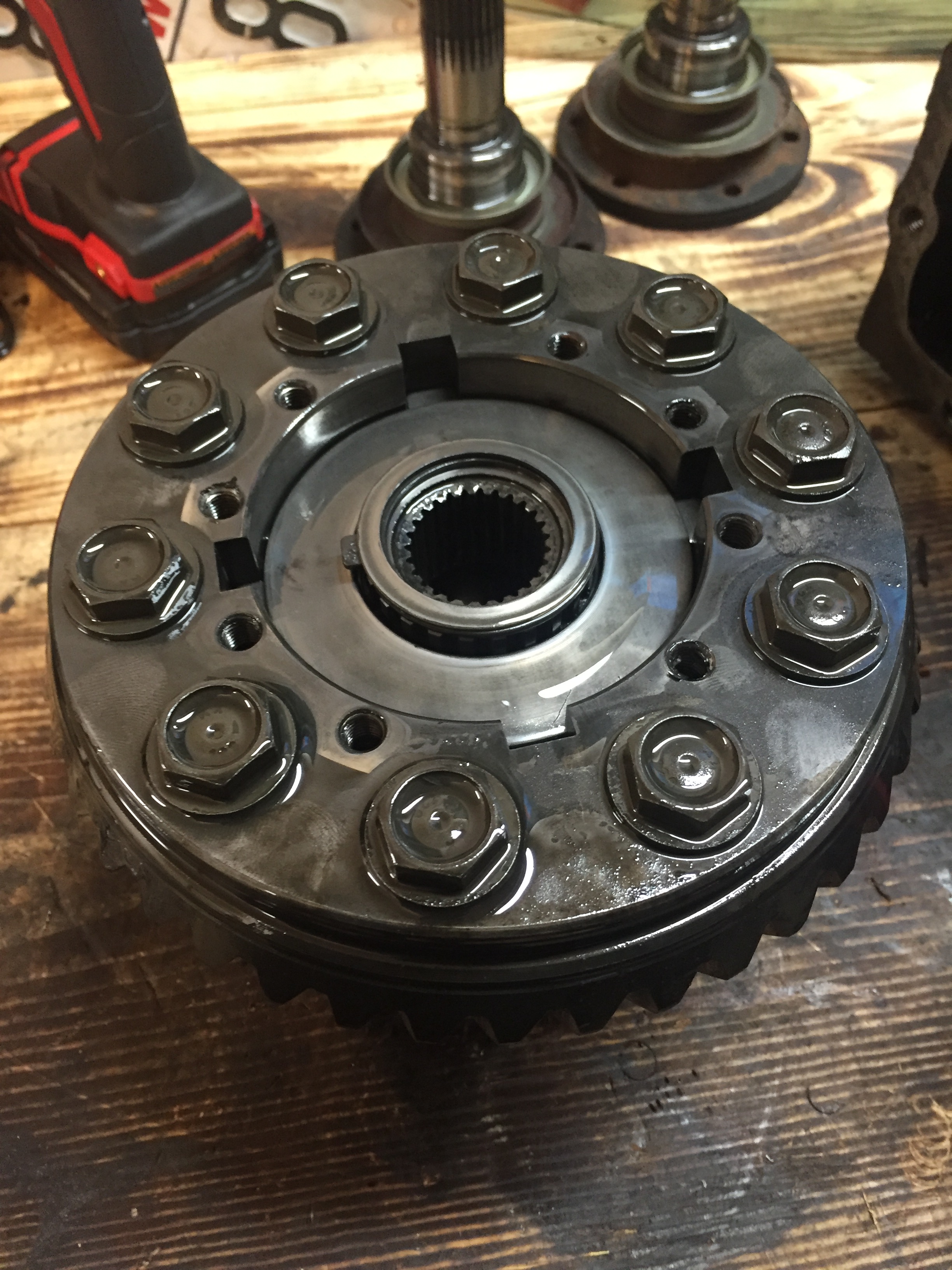

<p dir="auto">I have all the parts ready to get media blasted and powder coated but I am still looking for the best place to get that done. </p>
<p dir="auto"><a href="/assets/uploads/files/monthly_2016_04_6.JPG.37a6f521092019bd8cf5024a514df23f.JPG"><img src="/assets/uploads/files/monthly_2016_04_6.thumb.JPG.ac8e395f2d9b21ecc5da2a621f9ce6bd.JPG" alt="6.thumb.JPG.ac8e395f2d9b21ecc5da2a621f9c" class=" img-fluid img-markdown" width="563" height="750" /></a></p>

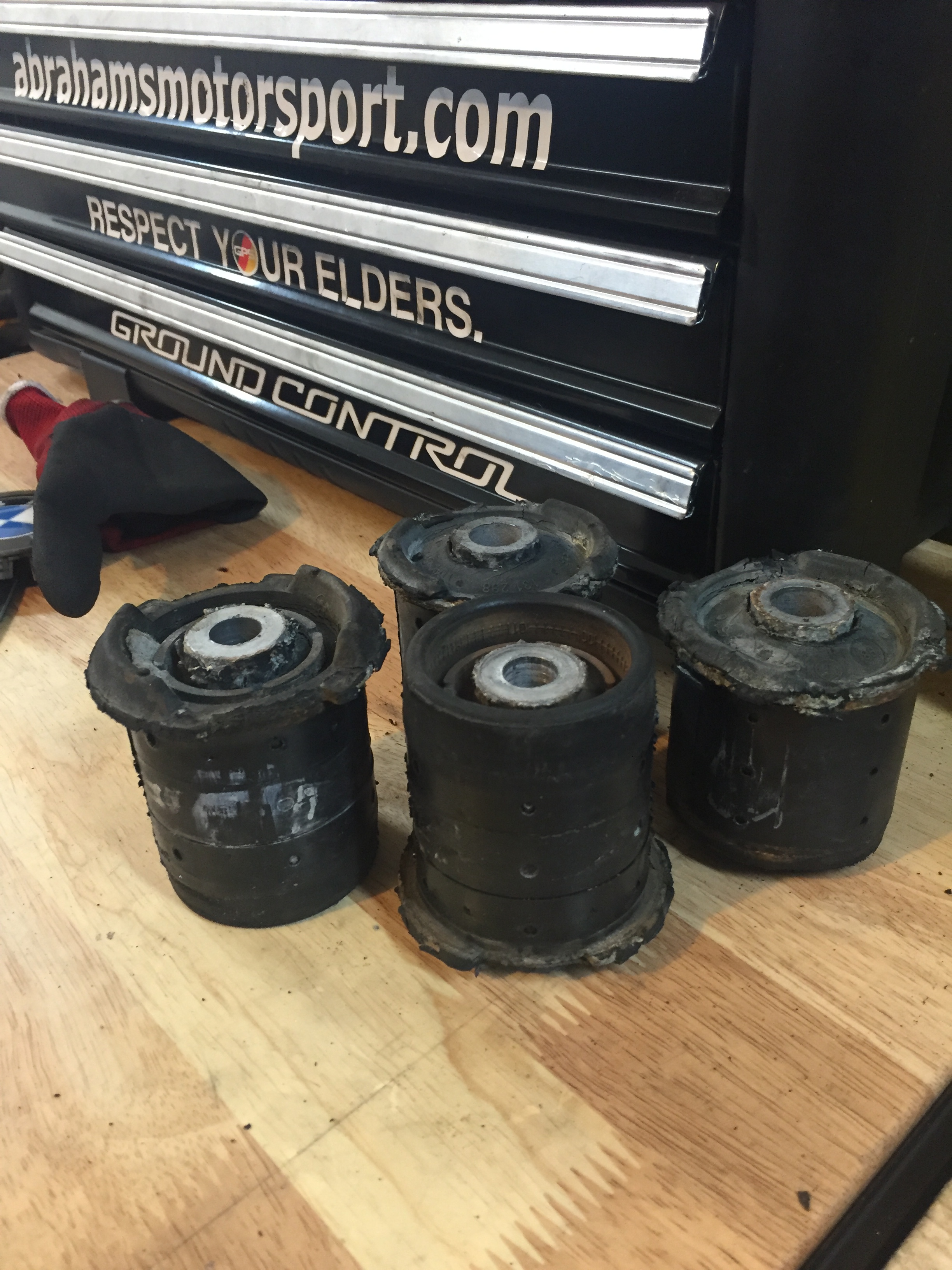

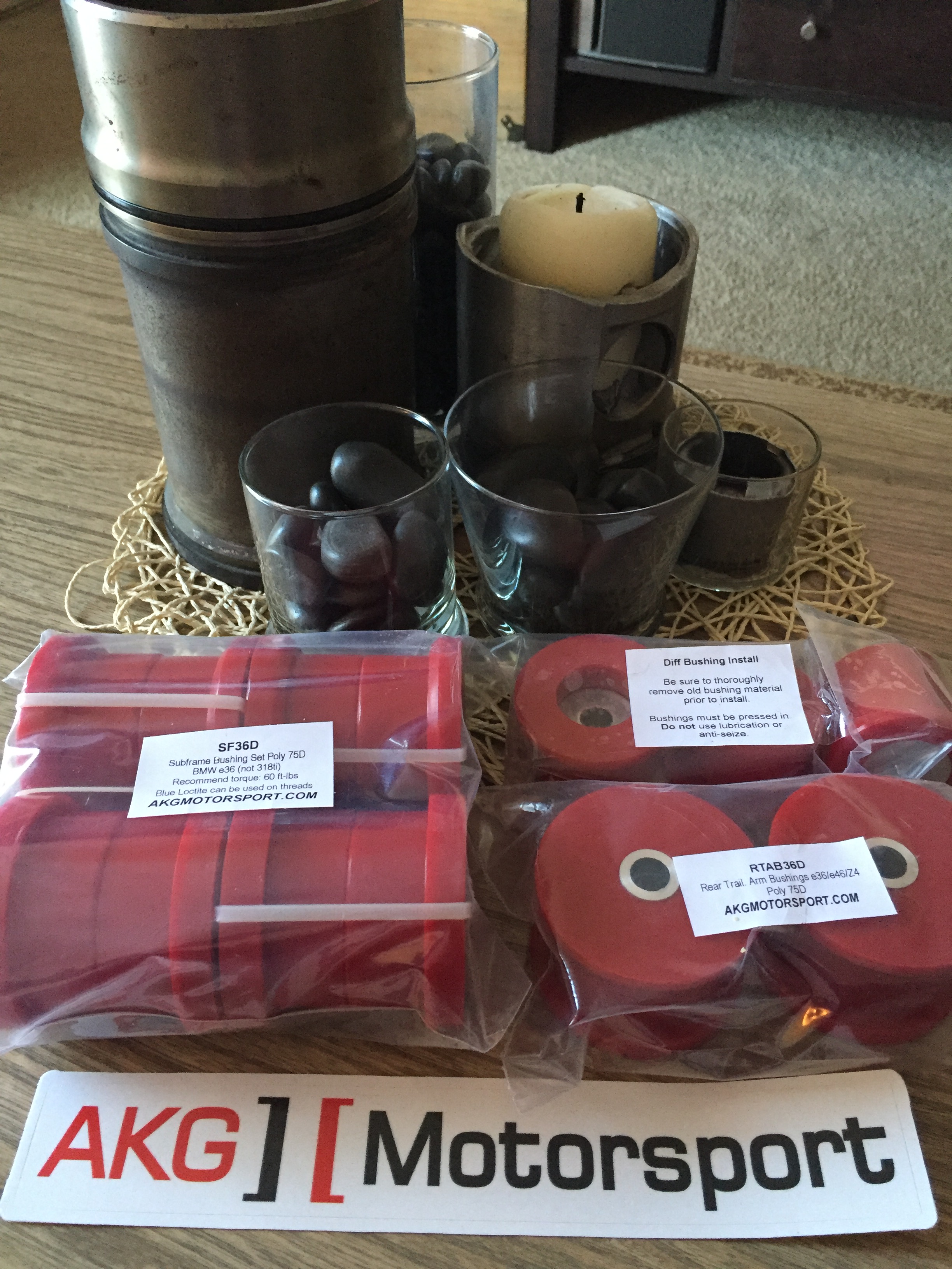

<p dir="auto">I purchased a full set of AKG 75D's for the subframe, RTAB's and the differential. I got my set of Rogue Engineering lower control arms in the mail today. I also have a set of BC coilovers coming with a custom spring rate of 12K front and 10K rear so between this, the (pretty much solid) bushings, and the control arms metal rod ends, comfort is out the window. </p>

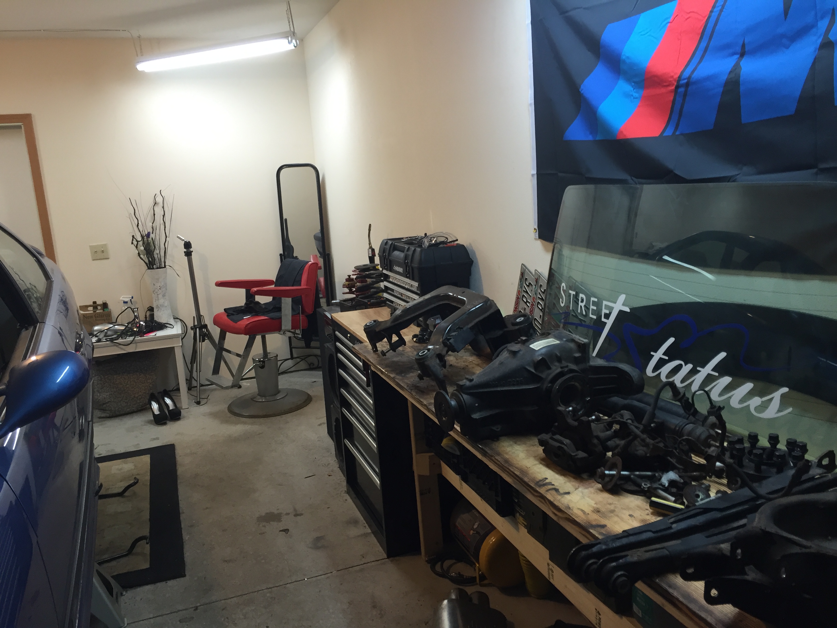

<p dir="auto"><a href="/assets/uploads/files/monthly_2016_04_7.JPG.0e8aaa48525faf7675a3cc4c0446b6f8.JPG"><img src="/assets/uploads/files/monthly_2016_04_7.thumb.JPG.9f7b9c6bd31824dc40a28e20da65c701.JPG" alt="7.thumb.JPG.9f7b9c6bd31824dc40a28e20da65" class=" img-fluid img-markdown" width="563" height="750" /></a><a href="/assets/uploads/files/monthly_2016_04_8.5.JPG.0f8002ca11e41788655011ca254792bb.JPG"><img src="/assets/uploads/files/monthly_2016_04_8.5.thumb.JPG.0c0497a36c673bd7a341a78c83c67dbc.JPG" alt="8.5.thumb.JPG.0c0497a36c673bd7a341a78c83" class=" img-fluid img-markdown" width="563" height="750" /></a></p>
<p dir="auto">Dont mind the mess...</p>

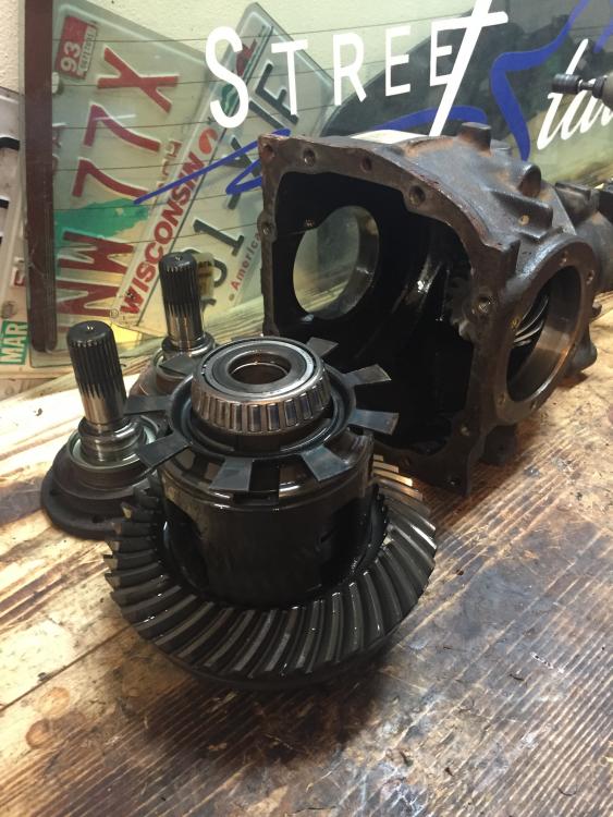

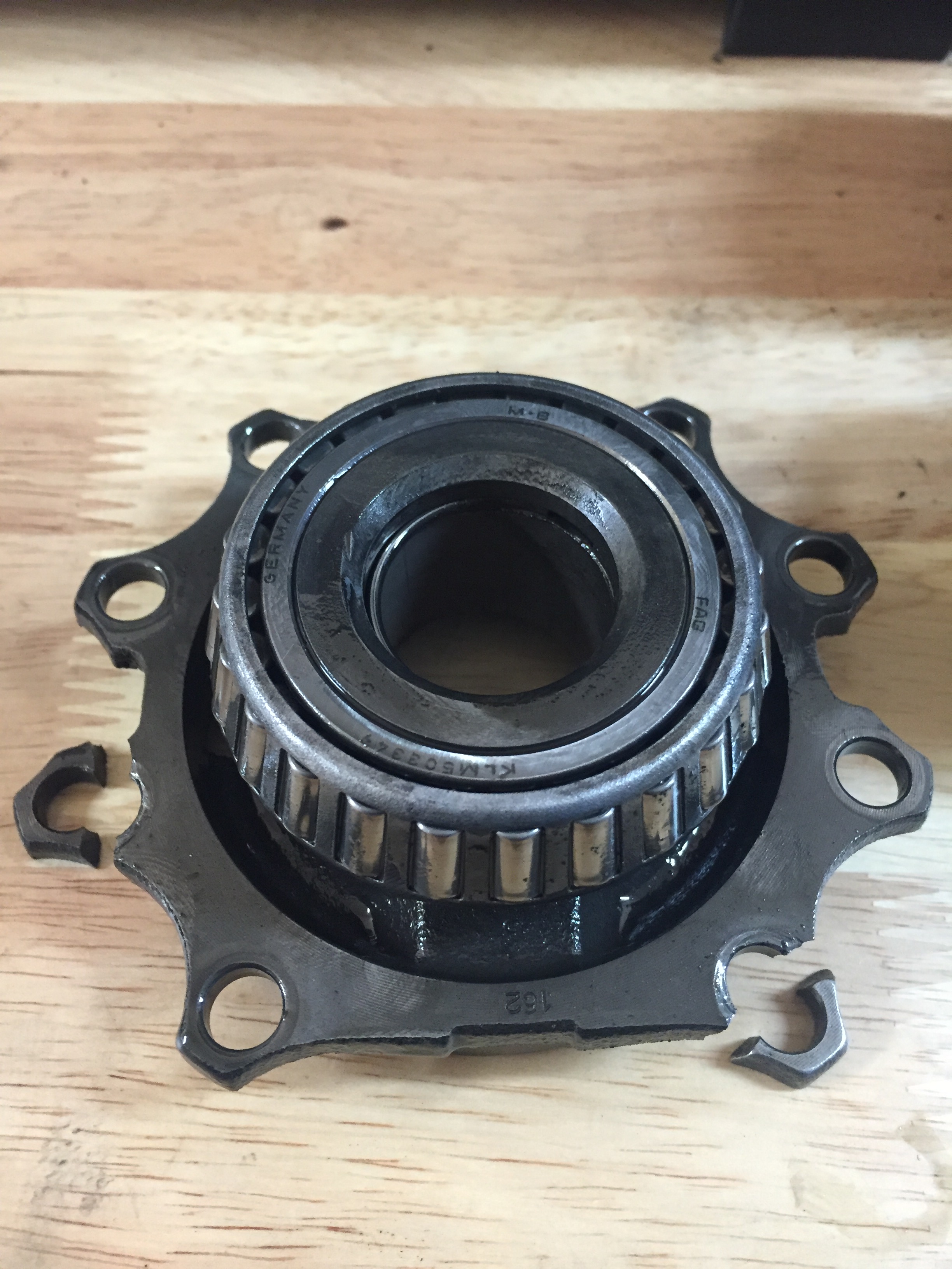

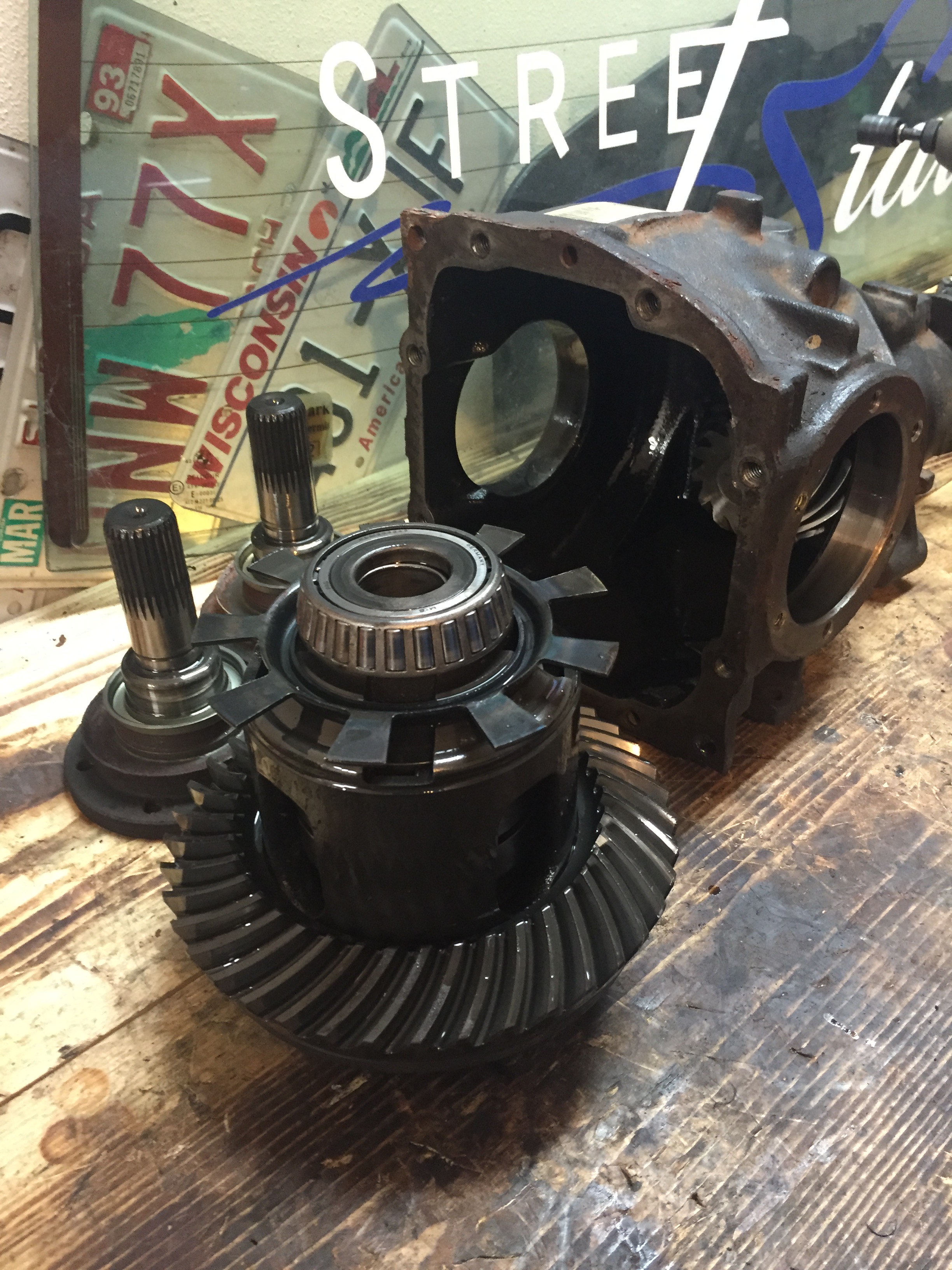

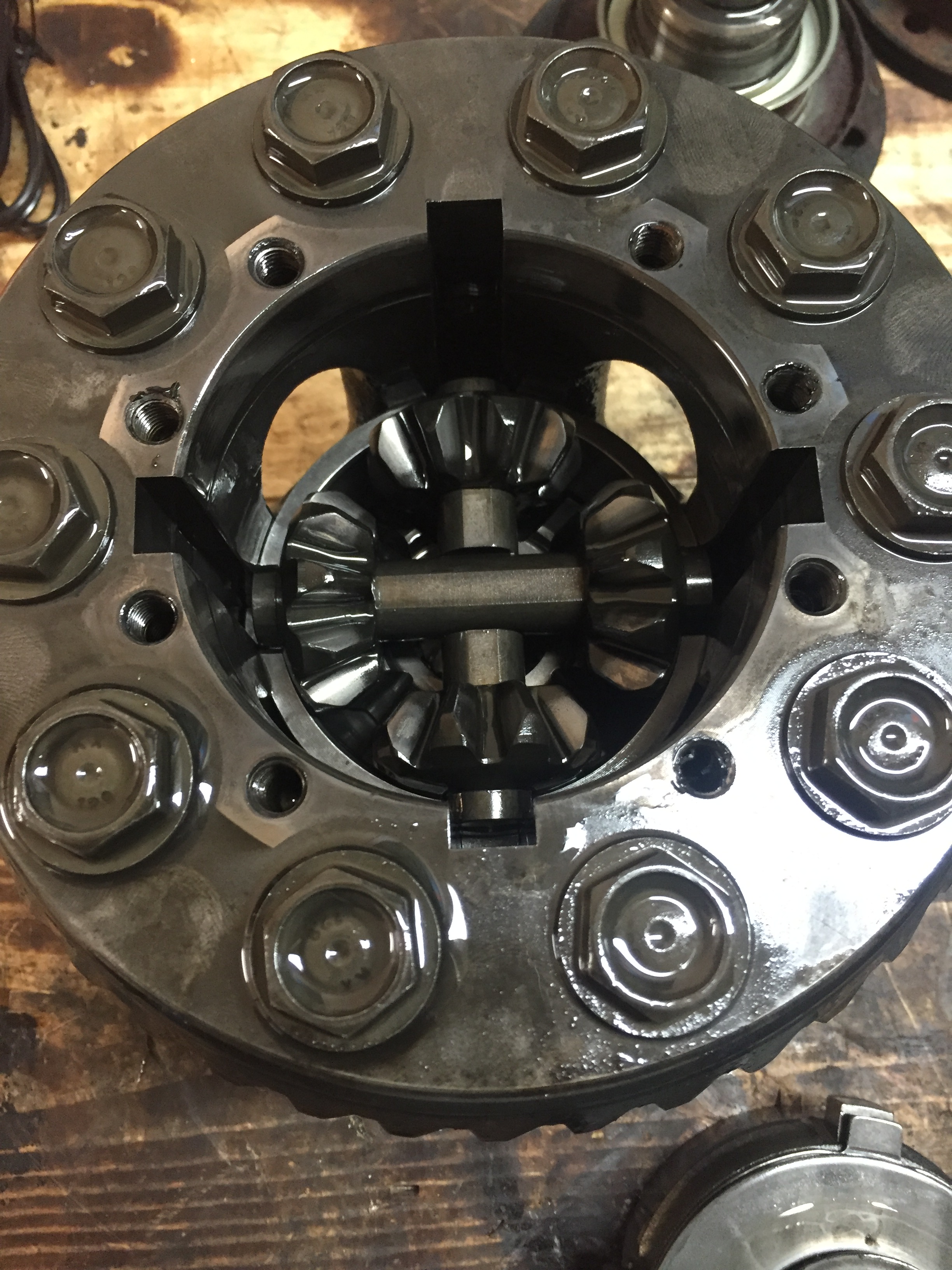

<p dir="auto">when I extracted the sheared diff bolt today I noticed that the output seal seemed to be leaking a little. I decided to open her up and I am glad I did. Turns out the LSD carrier housing cover was cracked in two places. I have no clue how this had happened. I might as well throw some new clutch plates in while I am in there. </p>
<p dir="auto"><a href="/assets/uploads/files/monthly_2016_04_9.JPG.3dea63e989abcc50121dc758d1469448.JPG"><img src="/assets/uploads/files/monthly_2016_04_9.thumb.JPG.01b8e0a436577439e846c1f9466a1756.JPG" alt="9.thumb.JPG.01b8e0a436577439e846c1f9466a" class=" img-fluid img-markdown" width="563" height="750" /></a></p>

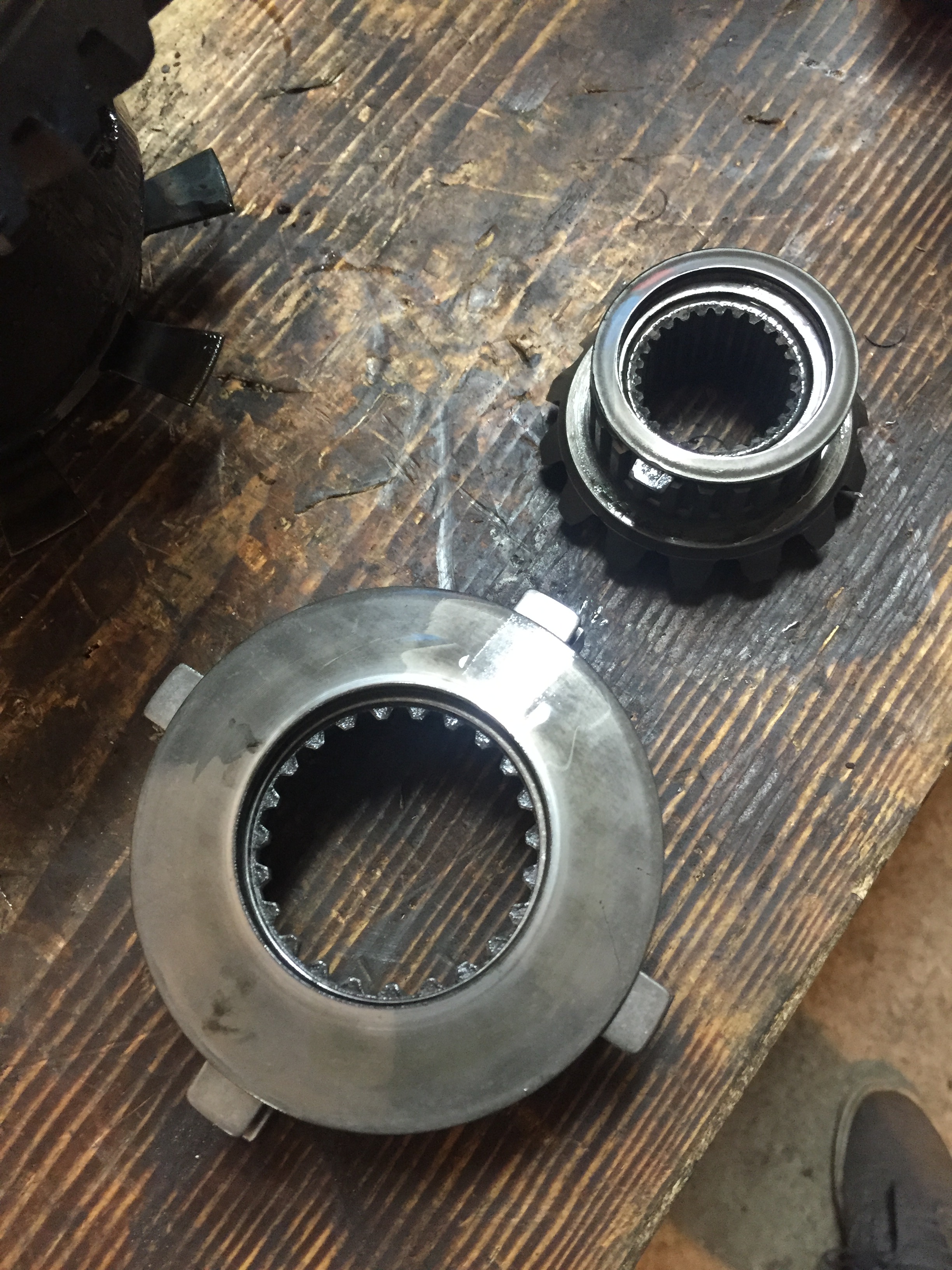

<p dir="auto">These pieced fell out when I pulled out the guts and it seems like they have been in there awhile due to the amount of wear on the edges. I am supersized that it didn't get jammed in the LSD housing or mess up the ring and pinion.</p>
<p dir="auto"><a href="/assets/uploads/files/monthly_2016_04_10.JPG.bac5db7dd4658850f7ba723f27423b94.JPG"><img src="/assets/uploads/files/monthly_2016_04_10.thumb.JPG.b37fa9ac8fff5014bcced972bd904350.JPG" alt="10.thumb.JPG.b37fa9ac8fff5014bcced972bd9" class=" img-fluid img-markdown" width="563" height="750" /></a><a href="/assets/uploads/files/monthly_2016_04_11.JPG.92ddc55eb06f3f3d8190ee3dd3c7c653.JPG"><img src="/assets/uploads/files/monthly_2016_04_11.thumb.JPG.8f1e2516f6b9fb5028d138378ba63e85.JPG" alt="11.thumb.JPG.8f1e2516f6b9fb5028d138378ba" class=" img-fluid img-markdown" width="563" height="750" /></a><a href="/assets/uploads/files/monthly_2016_04_12.JPG.2e4a769f22f50063e72f6ebffbc211e2.JPG"><img src="/assets/uploads/files/monthly_2016_04_12.thumb.JPG.e4ffbf69d12f52b503bd3aed9b646689.JPG" alt="12.thumb.JPG.e4ffbf69d12f52b503bd3aed9b6" class=" img-fluid img-markdown" width="563" height="750" /></a><a href="/assets/uploads/files/monthly_2016_04_13.JPG.b749c0515ada85ab0e4df547b0186ac7.JPG"><img src="/assets/uploads/files/monthly_2016_04_13.thumb.JPG.af85d292219ab962b7009ae173d3a175.JPG" alt="13.thumb.JPG.af85d292219ab962b7009ae173d" class=" img-fluid img-markdown" width="563" height="750" /></a></p>

<p dir="auto">Yikes, I hope my diff doesn't look like that, now I'm going to worry... </p>
<p dir="auto">I'd think about reinforcing the RTAB pockets if you are planning on running super stiff RTAB bushings, the extra stresses on the mounts can cause the bungs to pull out, it's rare but can happen. AKG makes a nice weld-in reinforcement plate for about 30 bucks for the pair and is good insurance while you're in there.</p>

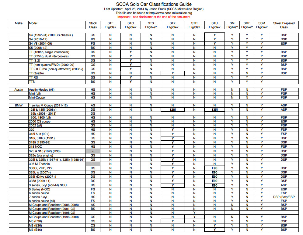

<p dir="auto"><a href="http://www.scca.com/pages/solo-cars-and-rules" rel="nofollow ugc">http://www.scca.com/pages/solo-cars-and-rules</a></p>

<p dir="auto">I have been reading through the rules and this is correct. The street class does not allow any other suspension bushing material other than OEM, any aftermarket control arms, and you need to run OEM spec springs... I will be thrown in to the Street Touring class. I am worried about one thing though. "The amount of metal in a replacement bushing may not be increased relative to the amount of metal found in a standard bushing for the particular application. Solid metal bushings are specifically prohibited."  I specifically went with 75D bushings because they are close in hardness as delrin and they are still a polymer which excludes them from the solid mount category but I am worried because I never checked the amount of metal between the AKG and the OEM. I would like to be competitive but If I get blown out of the water the first few years I am not going to cry about it.</p>
