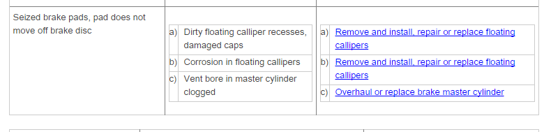

<p dir="auto">Just noticed if I lock my brakes up to stop, my caliper sticks pretty good until I start to move. Something isn't allowing the pressure to relieve normally.</p>

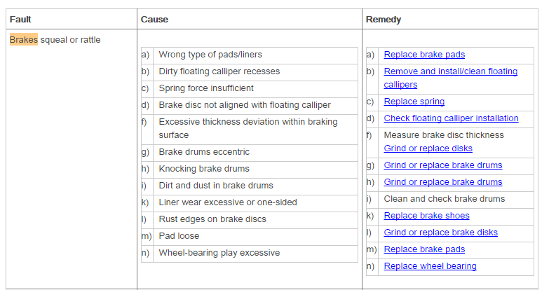

<p dir="auto"><strong><a href="/post/67270">patsbimmer1 said:</a></strong></p>
<p dir="auto"><a href="/assets/uploads/files/monthly_2016_03_e36.PNG.25c1bbf8562a2402c13d04c8a5c9ba1c.PNG" title="Enlarge image"><img src="/assets/uploads/files/monthly_2016_03_e36.PNG.25c1bbf8562a2402c13d04c8a5c9ba1c.PNG" alt="e36.PNG.25c1bbf8562a2402c13d04c8a5c9ba1c" class=" img-fluid img-markdown" width="783" height="414" /></a></p>
<p dir="auto"><a href="/assets/uploads/files/monthly_2016_03_56f1a850707cd_e36-1.PNG.bd07d84107c39c4778f07eb96b27b67a.PNG" title="Enlarge image"><img src="/assets/uploads/files/monthly_2016_03_56f1a850707cd_e36-1.PNG.bd07d84107c39c4778f07eb96b27b67a.PNG" alt="56f1a850707cde36-1.PNG.bd07d84107c39c47" class=" img-fluid img-markdown" width="780" height="189" /></a></p>
<p dir="auto">The only thing it could be from that list is that the vent bore of the master is clogged.</p>

<p dir="auto"><img src="/assets/uploads/files/monthly_2016_03_56f1a850707cd_e36-1.PNG.bd07d84107c39c4778f07eb96b27b67a.PNG" alt="56f1a850707cde36-1.PNG.bd07d84107c39c47" class=" img-fluid img-markdown" width="780" height="189" /></p>
