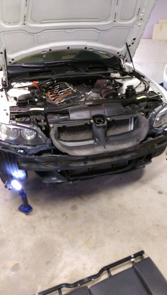

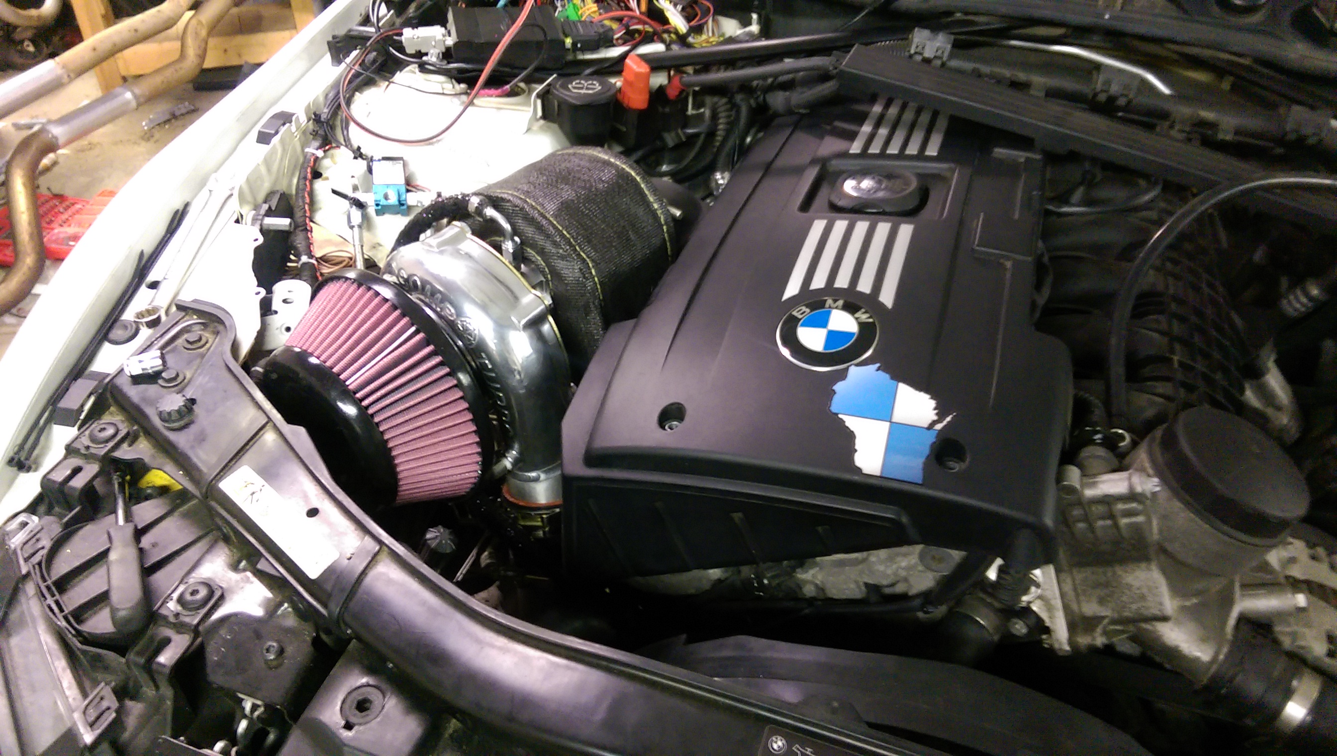

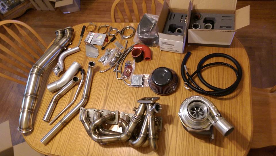

<p dir="auto">I purchased a 2009 335xi AT about 2 years ago and originally had no plans of modding it, but funny how that always changes.  Seriously though I had no idea what engine the car had or anything when I got it, but after some research the wheels started turning.  Like everyone here I started out with the basic "Tune" for the N54 (JB4 G5 ISO).  I was amazed at what the simplest of changes made the biggest power, but about 6-7 months later I started with the turbo rattles. Time slip in picture was only with the BMS cone filters and the JB4.  It was also a green light start (explains the reaction time).  </p>
<p dir="auto"><a href="/assets/uploads/files/monthly_2016_02_10523847_10152610425265439_7923375960872746976_n.jpg.a8e27b8f5c90fbd22001bfe49748395b.jpg"><img src="/assets/uploads/files/monthly_2016_02_10523847_10152610425265439_7923375960872746976_n.thumb.jpg.7720e2bdb58d37cf07ec4f2e8d6ea820.jpg" alt="10523847101526104252654397923375960872746976n.jpg" class=" img-fluid img-markdown" width="422" height="750" /></a></p>

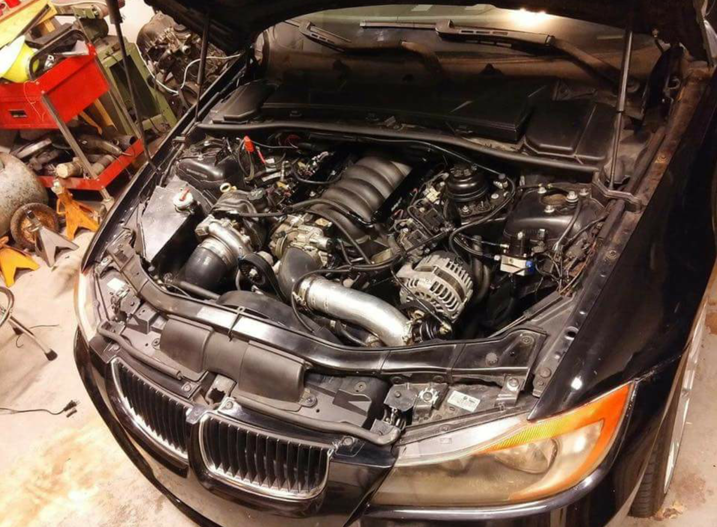

<p dir="auto">Awesome! Managing underhood temps looks like it's going to be your biggest enemy here.  I hope I get to see see this thing running one day!</p>
<p dir="auto">I have been thinking about that a lot recently and have been trying to come up with a solution. I thought about wrapping the headers since they are stainless but don't really want to deal with stressing the materials out with excessive heat and cracking them. It is looking like ceramic coating will be the best option but I've had crap luck with that in the past and it is rare it stays nice for long. Time will tell, might run them unfinished and insulate everything around them.. Hood louvers may be warranted..</p>
<p dir="auto">Sent from my HTC6545LVW using Tapatalk</p>
]]></description><link>https://wibimmers.com/post/80604</link><guid isPermaLink="true">https://wibimmers.com/post/80604</guid><dc:creator><![CDATA[Chris Welter]]></dc:creator><pubDate>Tue, 13 Jun 2017 13:23:03 GMT</pubDate></item><item><title><![CDATA[Reply to My life in the slow lane: Turning a z71 4x4 335I into something respectable. on Tue, 13 Jun 2017 13:15:41 GMT]]></title><description><![CDATA[<blockquote>
<p dir="auto"><strong><a href="/post/80597">Snap said:</a></strong></p>
<p dir="auto">Nice update! </p>
<p dir="auto">Access to the front of the engine looks improved over the I6 (obviously), Is there anything that is going to be a royal PITA to work on with this setup that will require pulling the engine, that normally wouldn't (spark plug access etc.)</p>
<p dir="auto">It really depends on how the exhaust and turbos all work out. The motor plate has been sheared and I can actually remove the plugs from the front of the engine (reach between the plate and the manifold to access them fairly easy). Compared to a C5 there is a lot of room and I could pull the intake manifold off or change oil or map sensors with engine in the car. The car being a prior Xi has a different front subframe that if the car is lifted there is HUGE access with the skid plate off. As of now I can't see a reason to pull the engine for anything really. It is truly impressive how it fit in there.</p>
