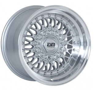

<p dir="auto">yeah I have the AVID AV-05 in mind, which only comes in 8" wide.  </p>
<p dir="auto">I like the AVID AV-18 more but only comes in these specs: 15x8 et 25 or 15x8.5 et 15, so seems those wont work <img src="https://wibimmers.com/assets/plugins/nodebb-plugin-emoji/emoji/android/1f626.png?v=6c9209168ce" class="not-responsive emoji emoji-android emoji--frowning" style="height:23px;width:auto;vertical-align:middle" title=":frowning:" alt="😦" /></p>

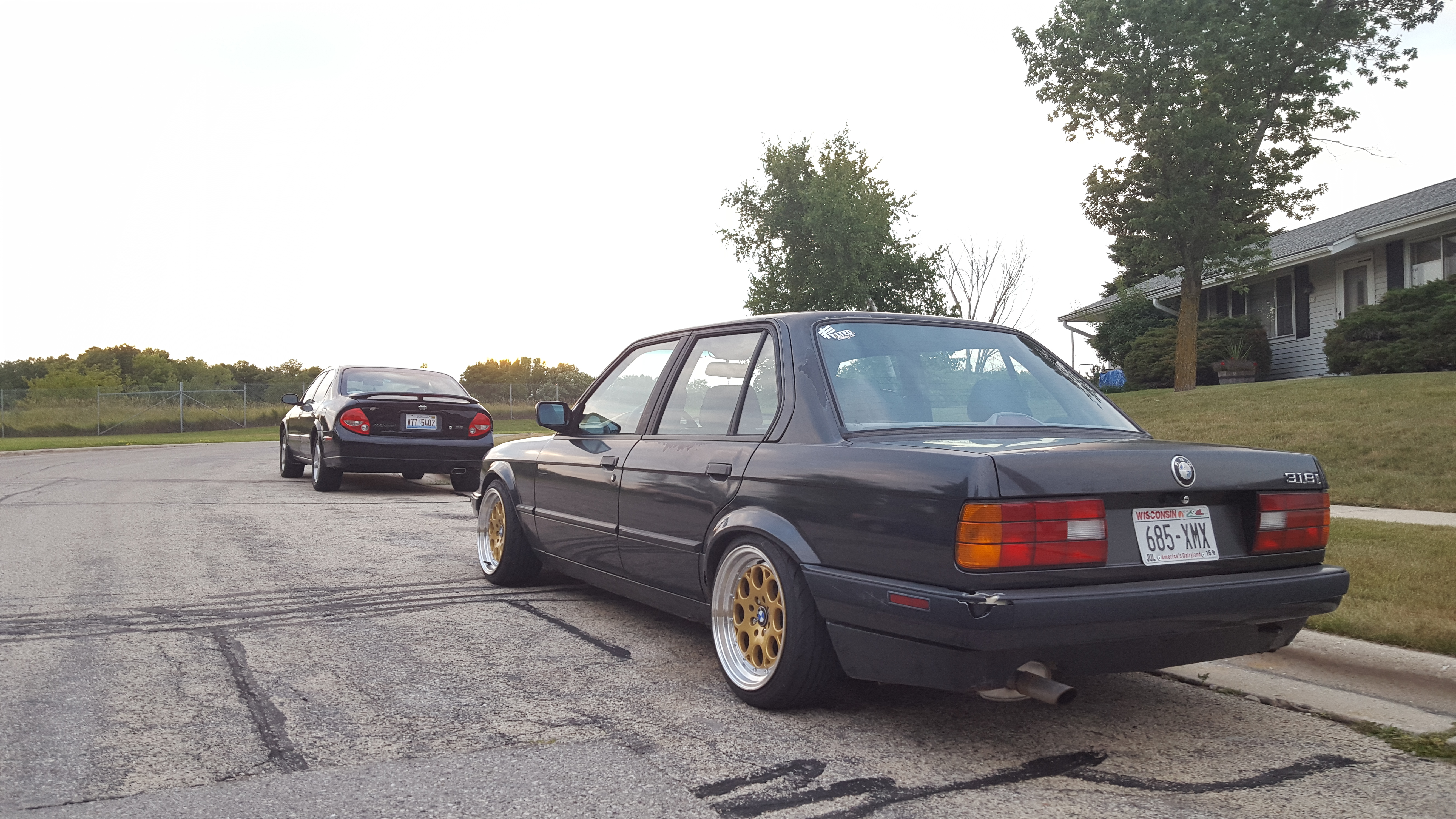

<p dir="auto"><strong><a href="/post/66167">cpandrewschmidt said:</a></strong></p>
<p dir="auto">That looks good HipMF.  Size rim, tire, offset?  Any fender rolling or spacers? </p>
<p dir="auto">more pics here, but no specifics on the <em>wheel</em> size of offset <img src="https://wibimmers.com/assets/plugins/nodebb-plugin-emoji/emoji/android/1f603.png?v=6c9209168ce" class="not-responsive emoji emoji-android emoji--smiley" style="height:23px;width:auto;vertical-align:middle" title="=)" alt="😃" /></p>
<p dir="auto"><a href="http://www.r3vlimited.com/board/showthread.php?t=295505" rel="nofollow ugc">http://www.r3vlimited.com/board/showthread.php?t=295505</a></p>

<p dir="auto">Ideally I'd like a 15x8 wheel with +20 offset and 225 tires but such is racing. Trade off of course would be the added weight.</p>
<p dir="auto">The daily e30 has the stock 14x7 weaves and 195/60/14 in the summer and 185/70/14 snows. Went for cheap and functional.</p>
<p dir="auto">Tire rack website has good illustrations of offset to help you understand the principles.</p>
<p dir="auto">Given your two choices in the 15x8 wheels and the tire size the +20 offset would be the better choice, but other folks with more wheel/stance experience may have other insights.</p>

<p dir="auto">15x8" et20 would like to run with a 205/50 R15 tire   or</p>
<p dir="auto">15x8" et25 would run same size tire.  I like this wheel better but can't confirm anywhere if the offset would work.  </p>

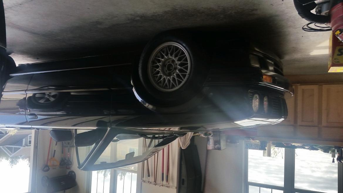

<p dir="auto">IIRC, my girlfriend has those exact specs on her e30 with 195/40's. </p>
<p dir="auto"><a href="/assets/uploads/files/monthly_2016_02_20150806_194429.jpg.59aea40f5c0b7aca98e2bb56414bf319.jpg"><img src="/assets/uploads/files/monthly_2016_02_20150806_194429.thumb.jpg.8244a55574762b2e08e088b5410252ee.jpg" alt="20150806194429.jpg" class=" img-fluid img-markdown" width="1000" height="563" /></a></p>
