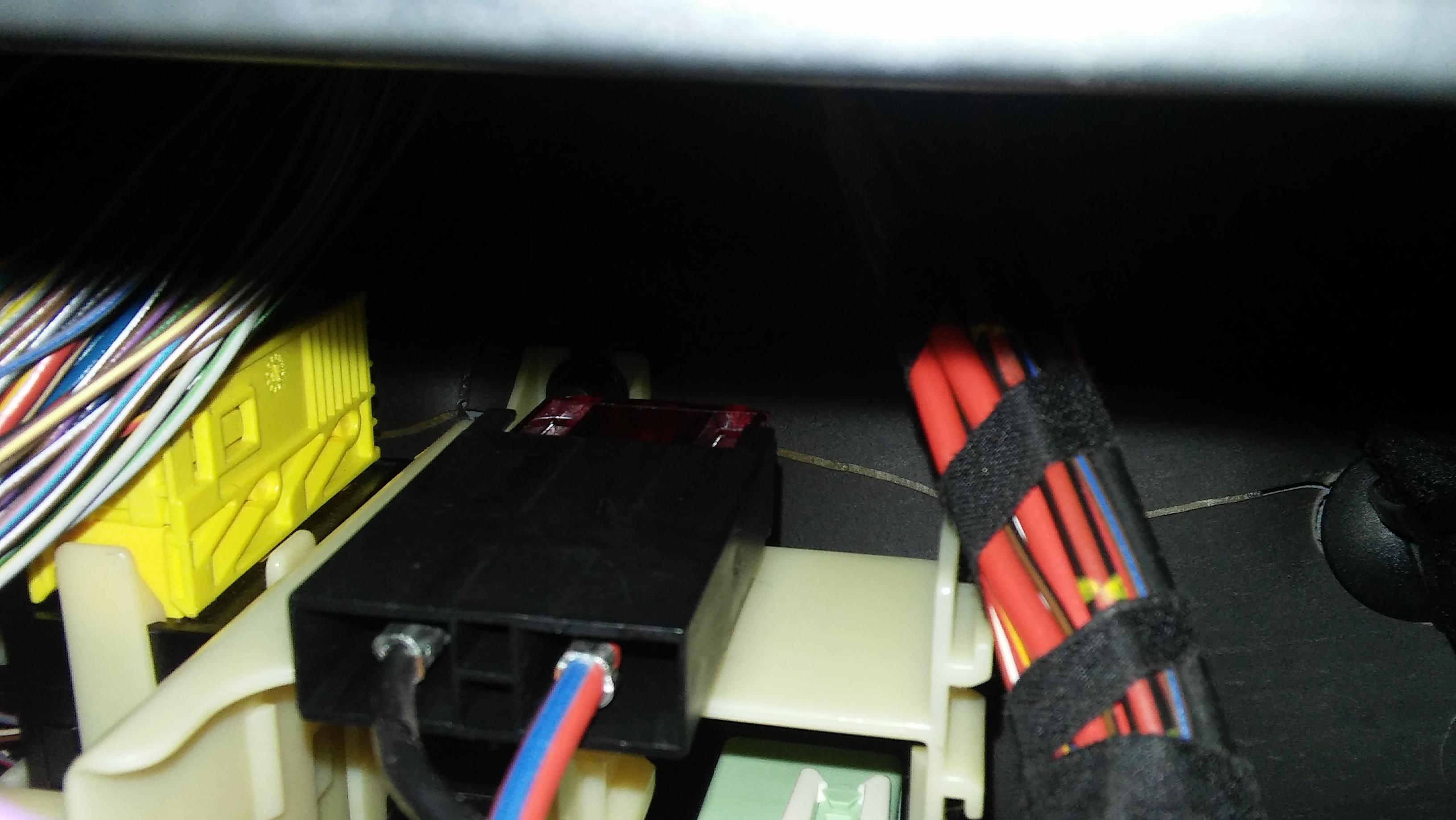

<p dir="auto"><a href="/assets/uploads/files/monthly_2016_02_20160209_202940.jpg.0d8ef38ad7e2ed5bddd5f0c797ad0ed5.jpg"><img src="/assets/uploads/files/monthly_2016_02_20160209_202940.thumb.jpg.354f979213d0553575d3e3ff3a68e654.jpg" alt="20160209202940.jpg" class=" img-fluid img-markdown" width="1000" height="564" /></a></p>

<p dir="auto">Well i have been under looking for fuses 75 and 76 i can onky find one fuse under the glove box area i removed what i could and all i see is one larger 50a fuse that does not look to be blown i belive i am hearing a little noise in the area while my head was down there i was hearing an almost thunping noise and the car has been off almost all day. When i turn the fan on it does not work but i hear an ever so slight noise. Any suggestions on finding that other fuse or the noise i am hea</p>

<p dir="auto">Well i have been under looking for fuses 75 and 76 i can onky find one fuse under the glove box area i removed what i could and all i see is one larger 50a fuse that does not look to be blown i belive i am hearing a little noise in the area while my head was down there i was hearing an almost thunping noise and the car has been off almost all day. When i turn the fan on it does not work but i hear an ever so slight noise. Any suggestions on finding that other fuse or the noise i am hearing lol</p>
