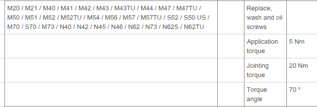

]]></description><link>https://wibimmers.com/post/65463</link><guid isPermaLink="true">https://wibimmers.com/post/65463</guid><dc:creator><![CDATA[DrLeadFoot]]></dc:creator><pubDate>Tue, 26 Jan 2016 01:48:29 GMT</pubDate></item><item><title><![CDATA[Reply to M52: Torque Spec Needed on Mon, 25 Jan 2016 22:57:03 GMT]]></title><description><![CDATA[<p dir="auto">Same as the M20</p>
<p dir="auto"><img src="/assets/uploads/files/monthly_2016_01_m52.PNG.a8198a527c4782ee602262e94db0cb1e.PNG" alt="m52.PNG.a8198a527c4782ee602262e94db0cb1e" class=" img-fluid img-markdown" width="642" height="218" /></p>
