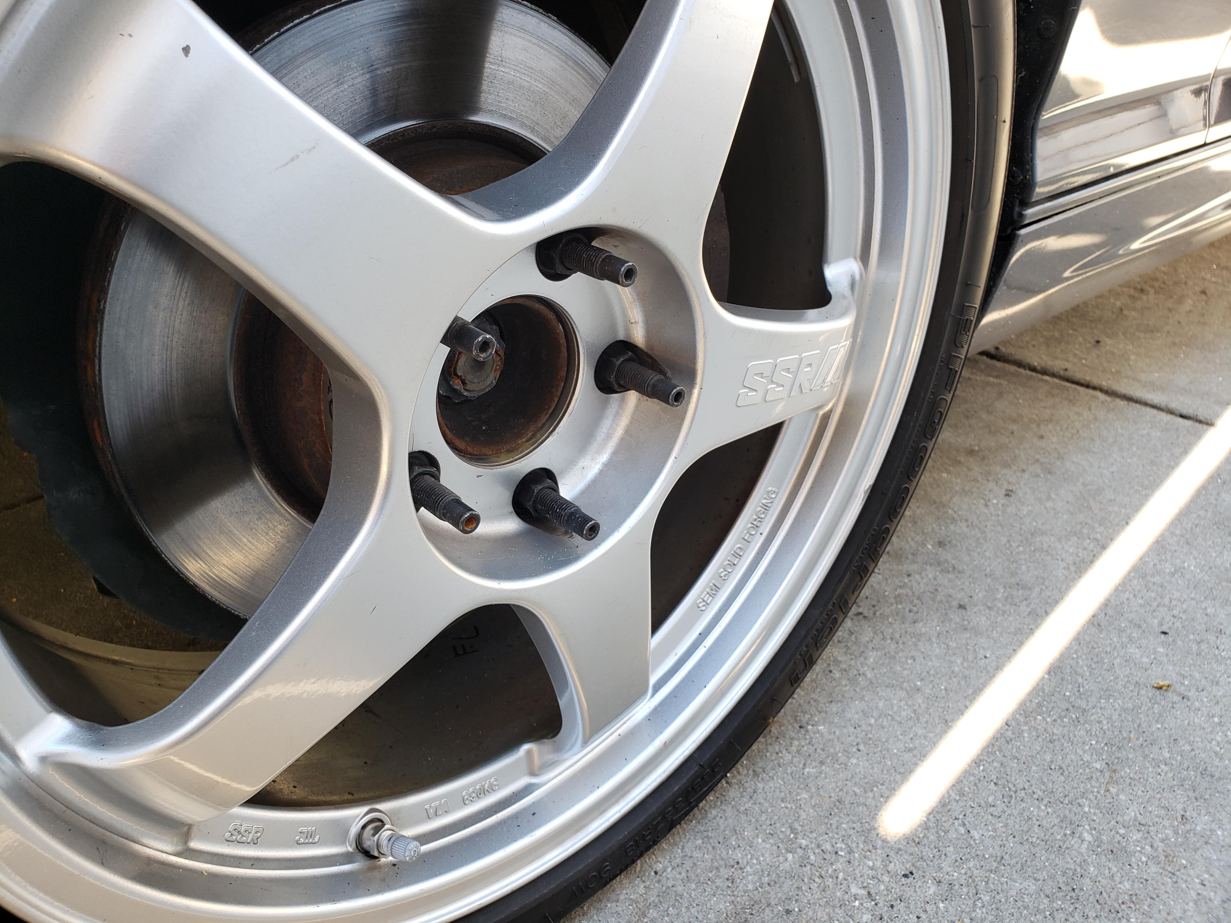

                          #72

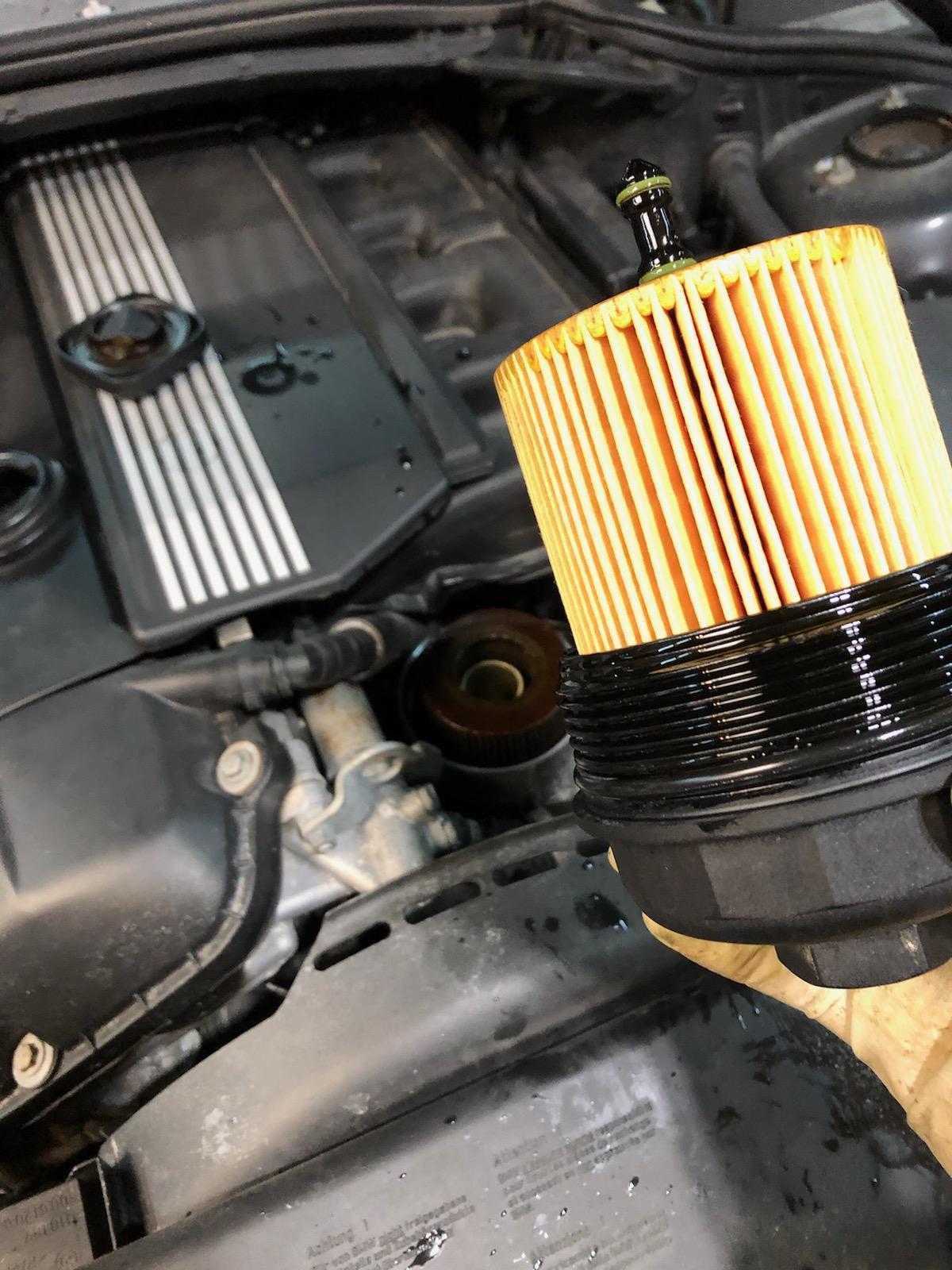

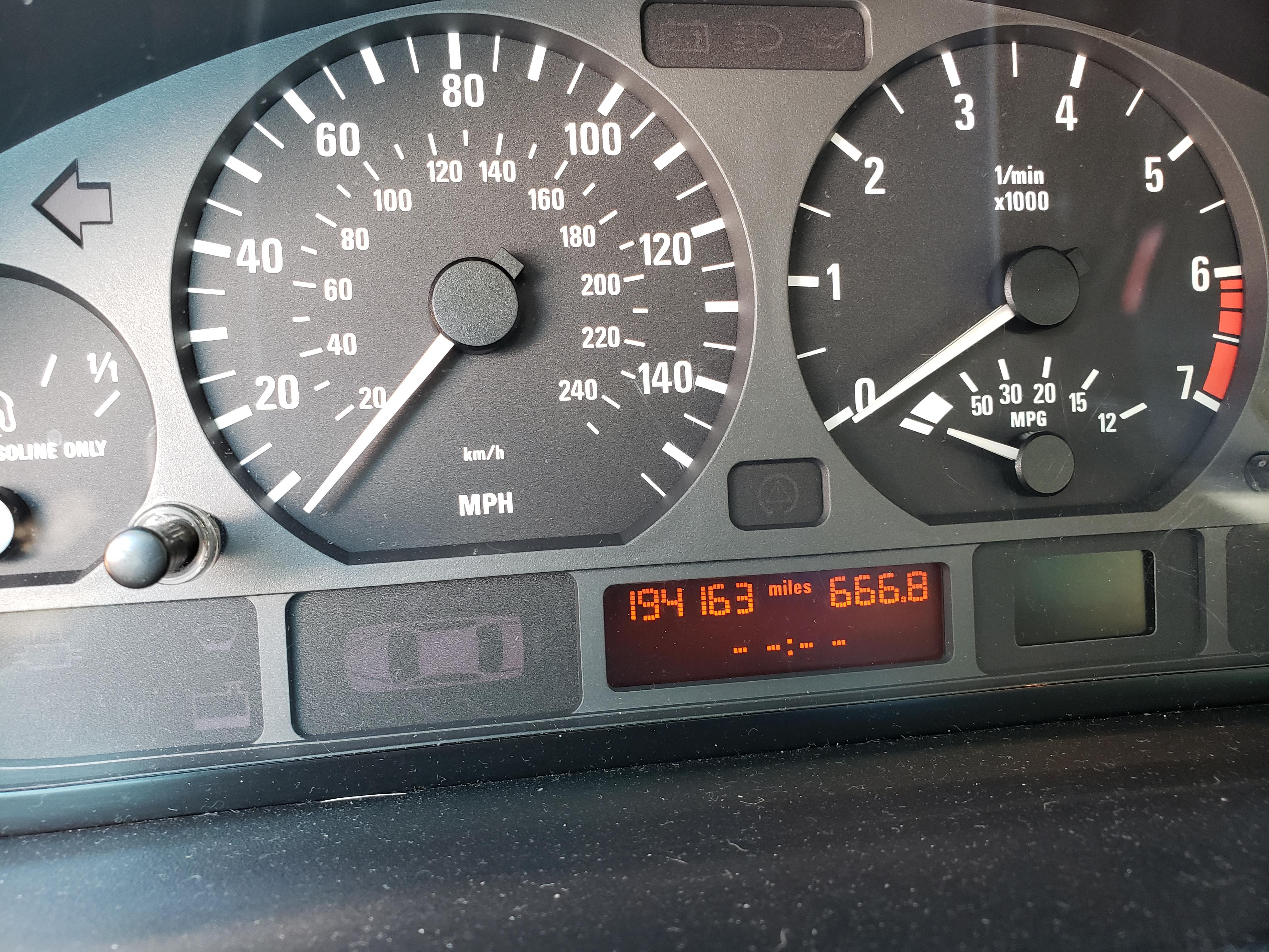

                          Oil and filter change!  194,163 miles.  Castrol 0W-40 & Mann filter.
                          Got the summer set up on a while ago and added a Motorsport Hardware Stud Kit.
                          Running great!

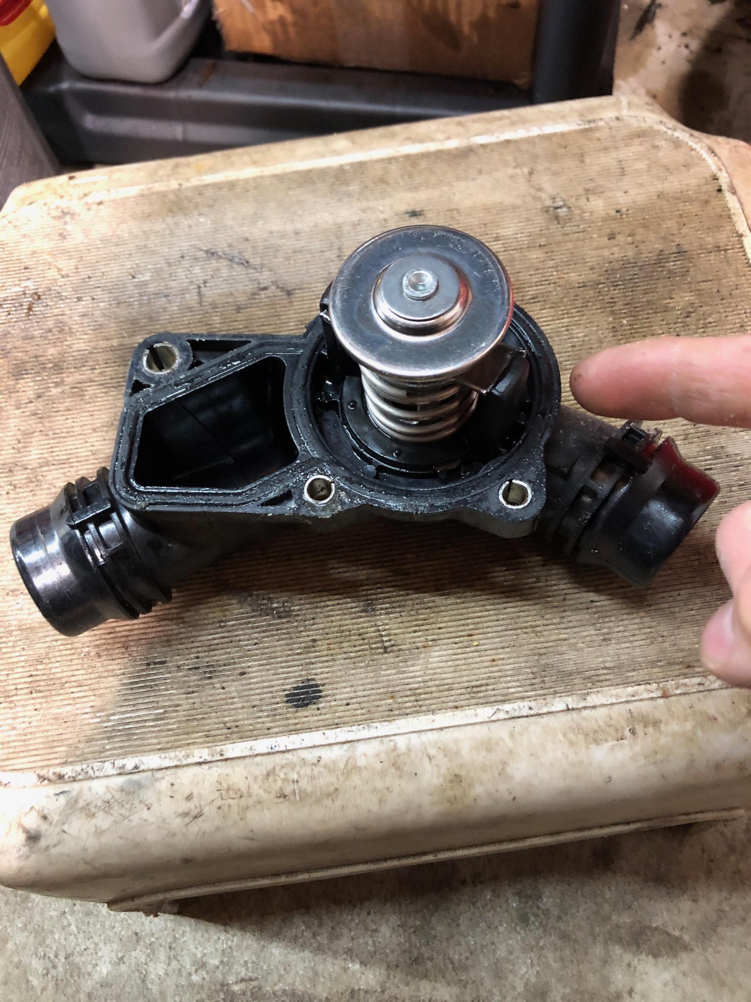

                            #73
                            198,622 miles.
                            New BMW OEM thermostat
                            Oil change with BMW 0w-30 Oil & OEM filter

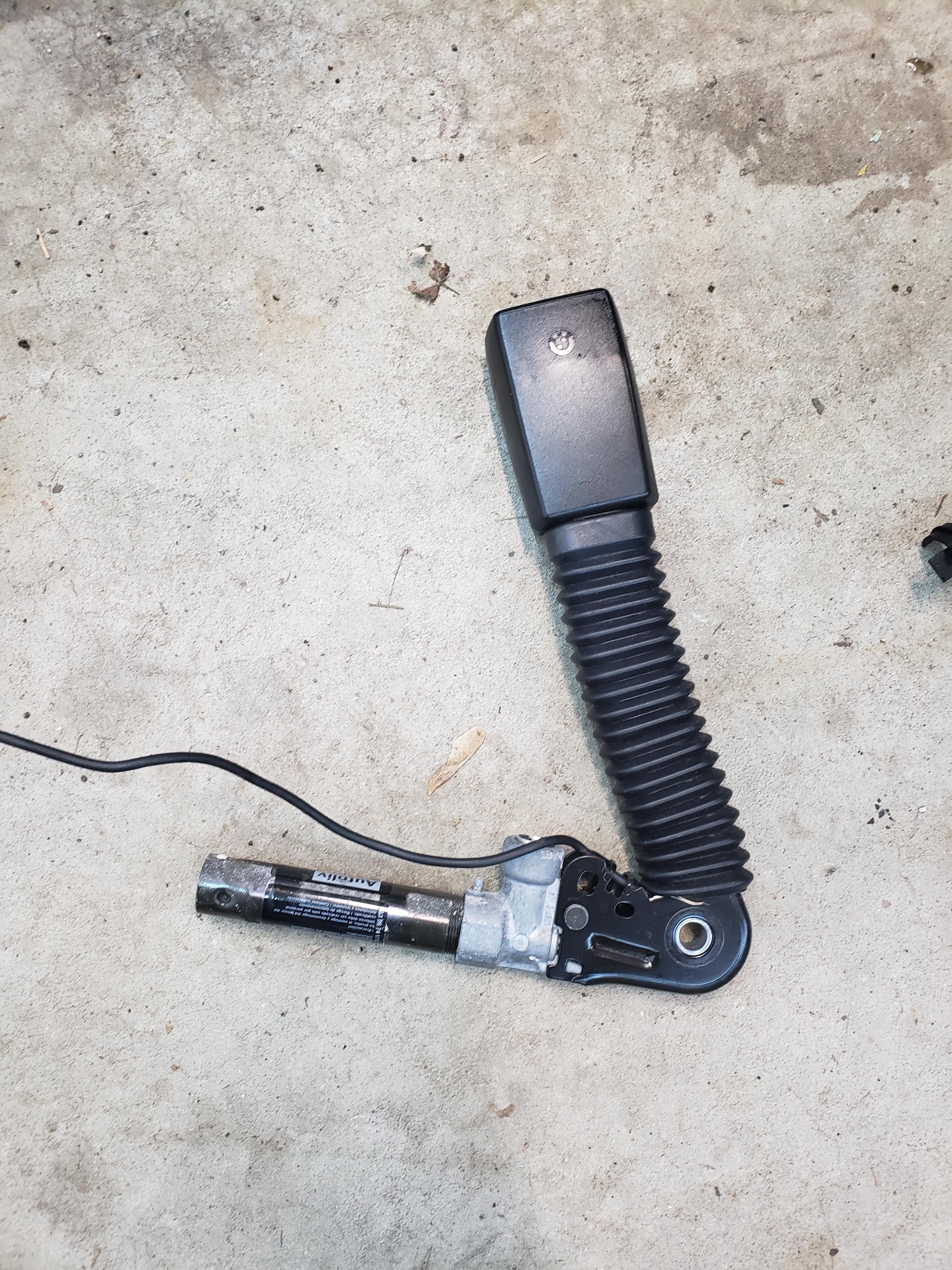

                              New passenger seat belt tensioner. Pic of old one.
                                   @DrLeadFoot

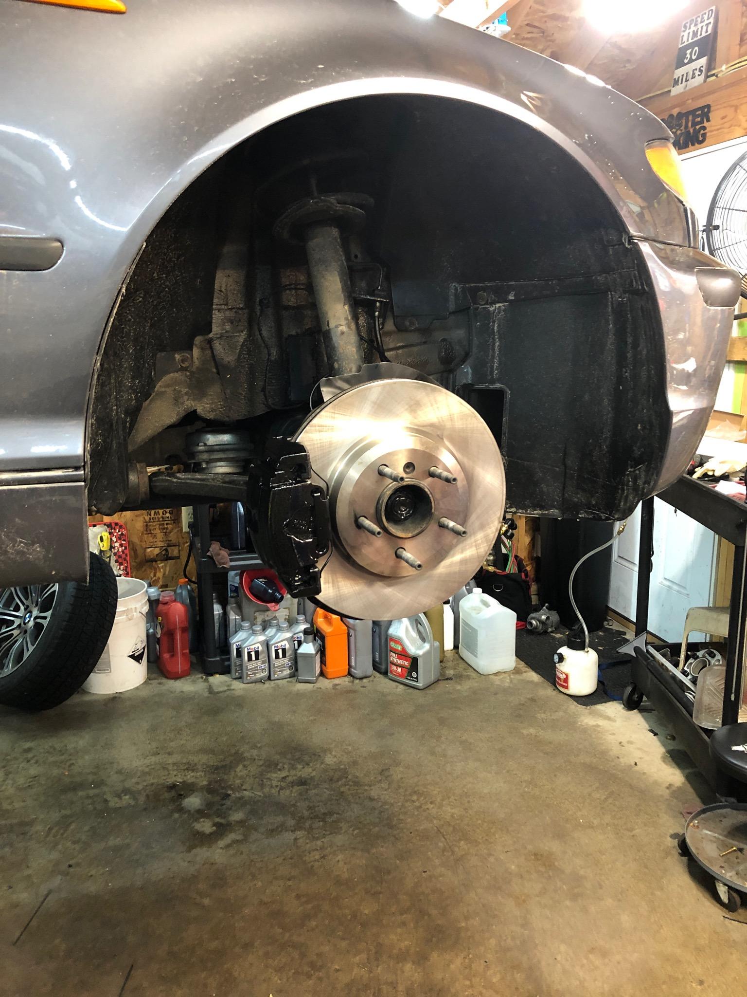

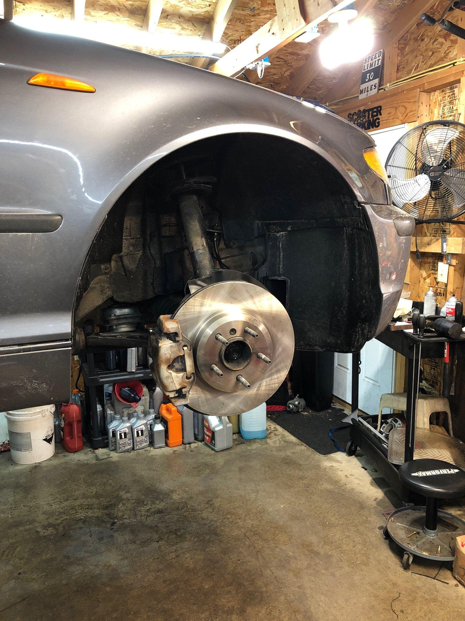

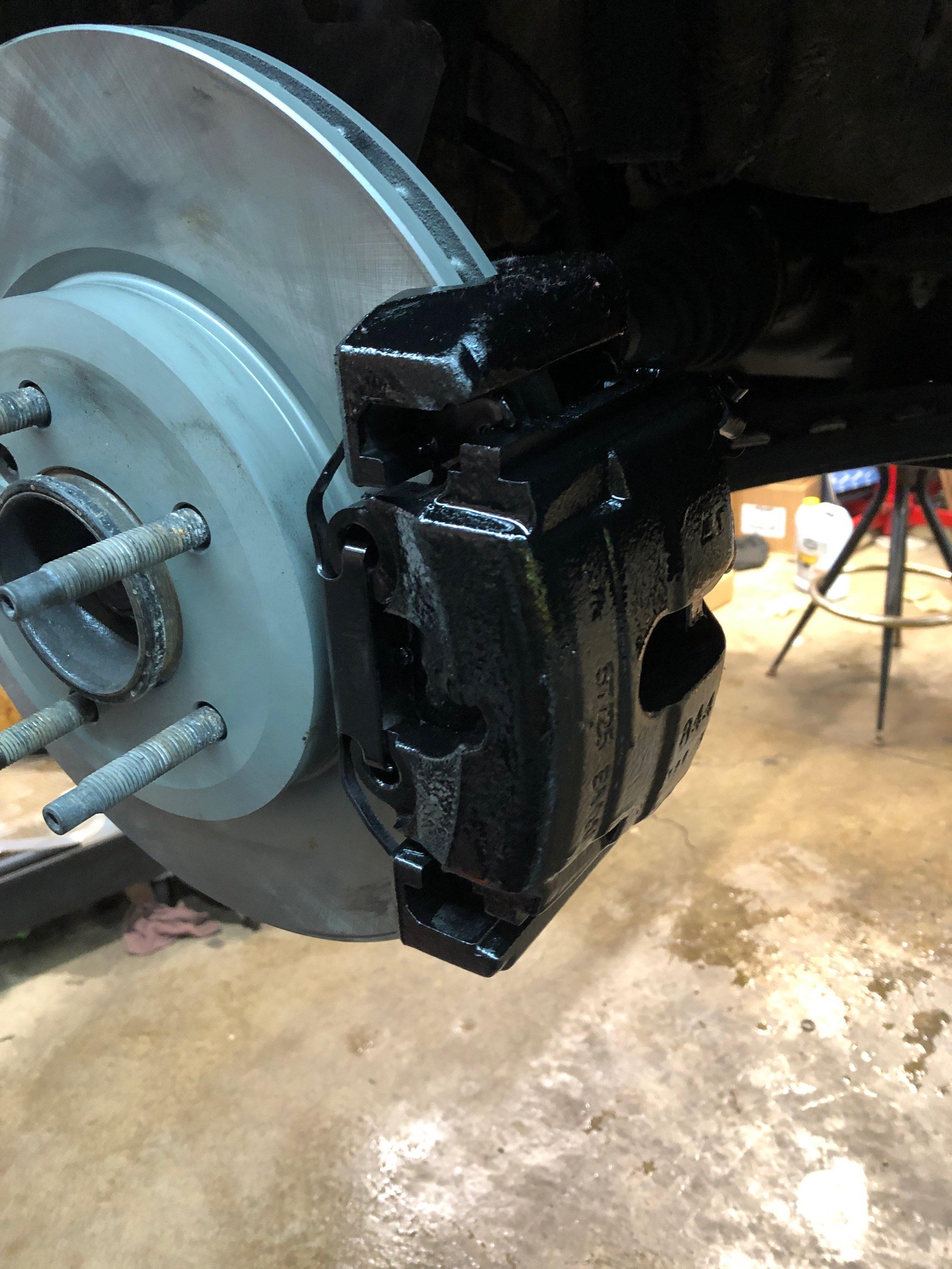

                                #75

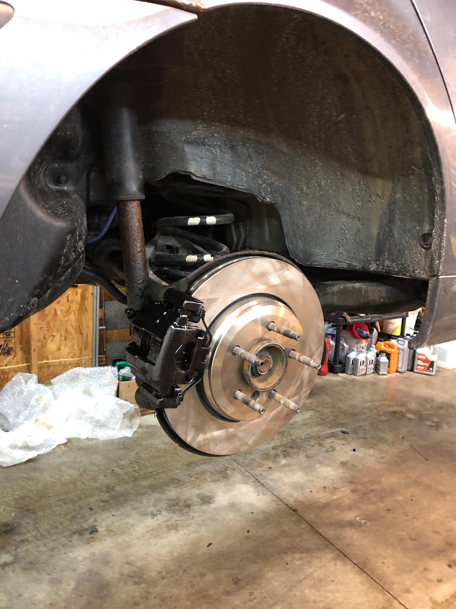

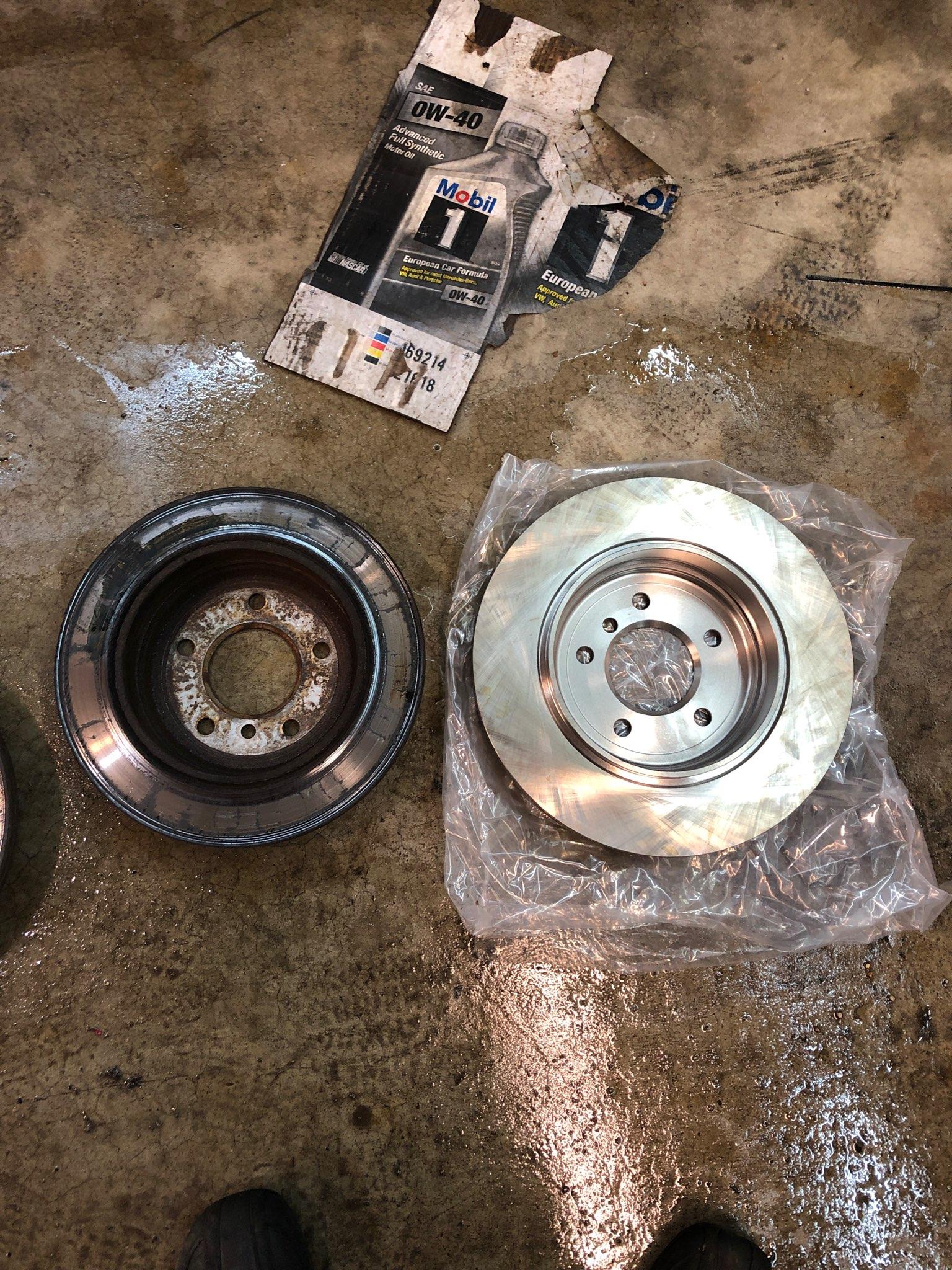

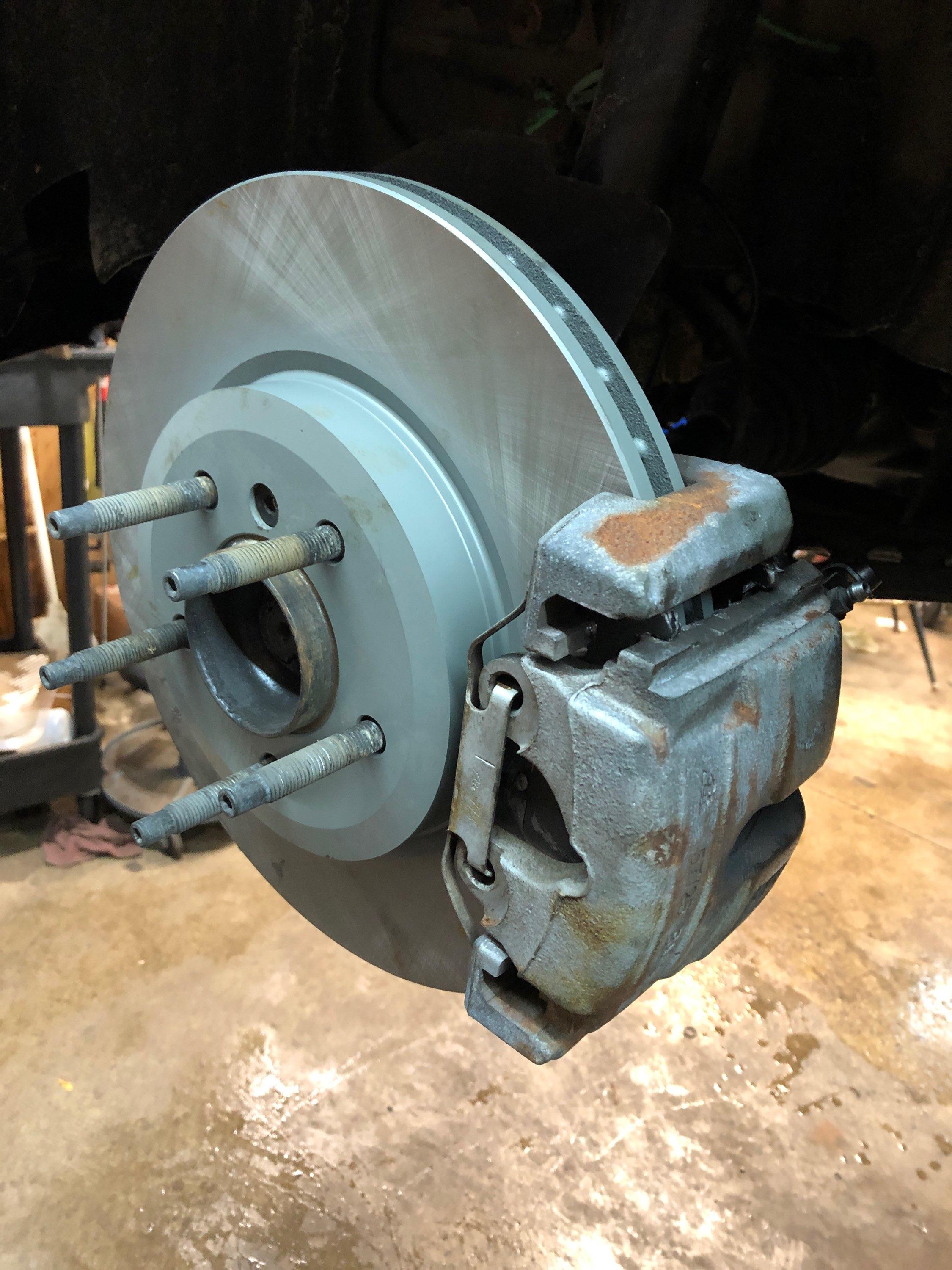

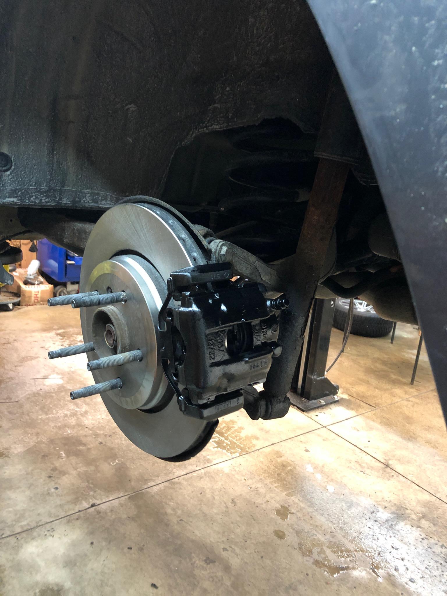

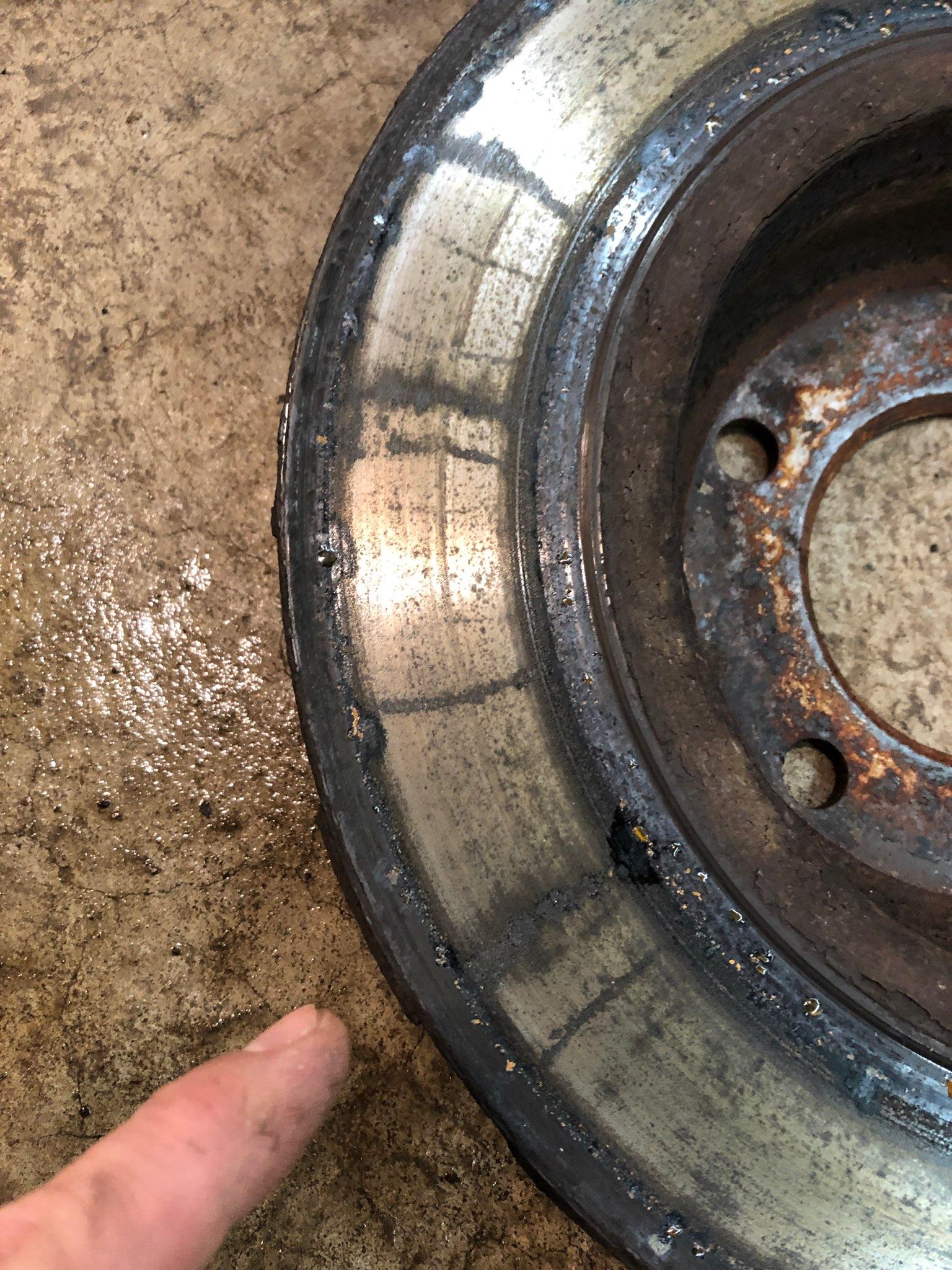

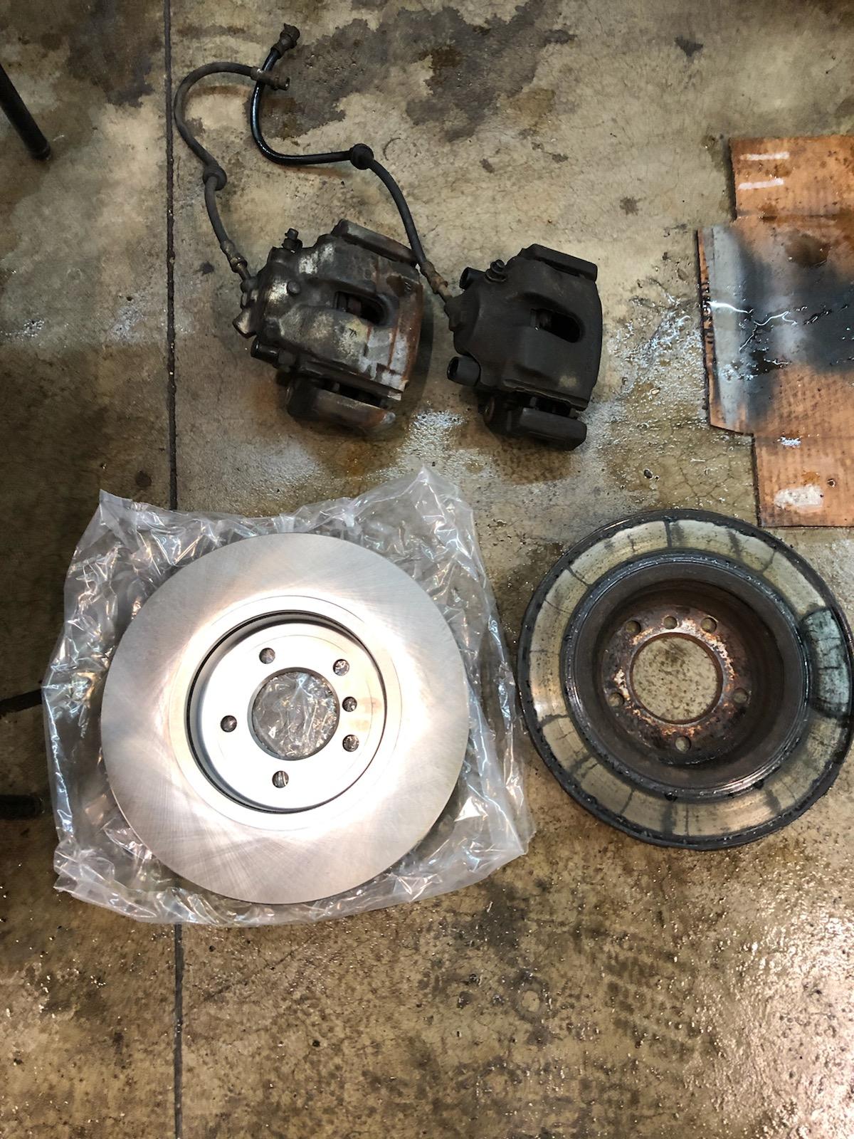

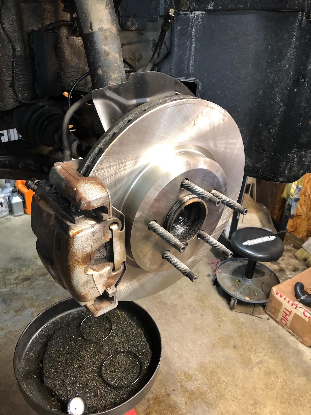

                                Lost brakes today while I was on a home tour with out of town buyers.  Thank the BMW Gods that I was going super slow coming to a stop sign when the pedal hit the floor.
                                I have been pushing the current pad/rotors tonthe limit and had a brake job on my radar anyways so this pushed me to get it done.
                                A box in my garage has been sitting for about a year with 330i calipers, carriers and pads.  So here we go! 330i on left, 325xi on right.

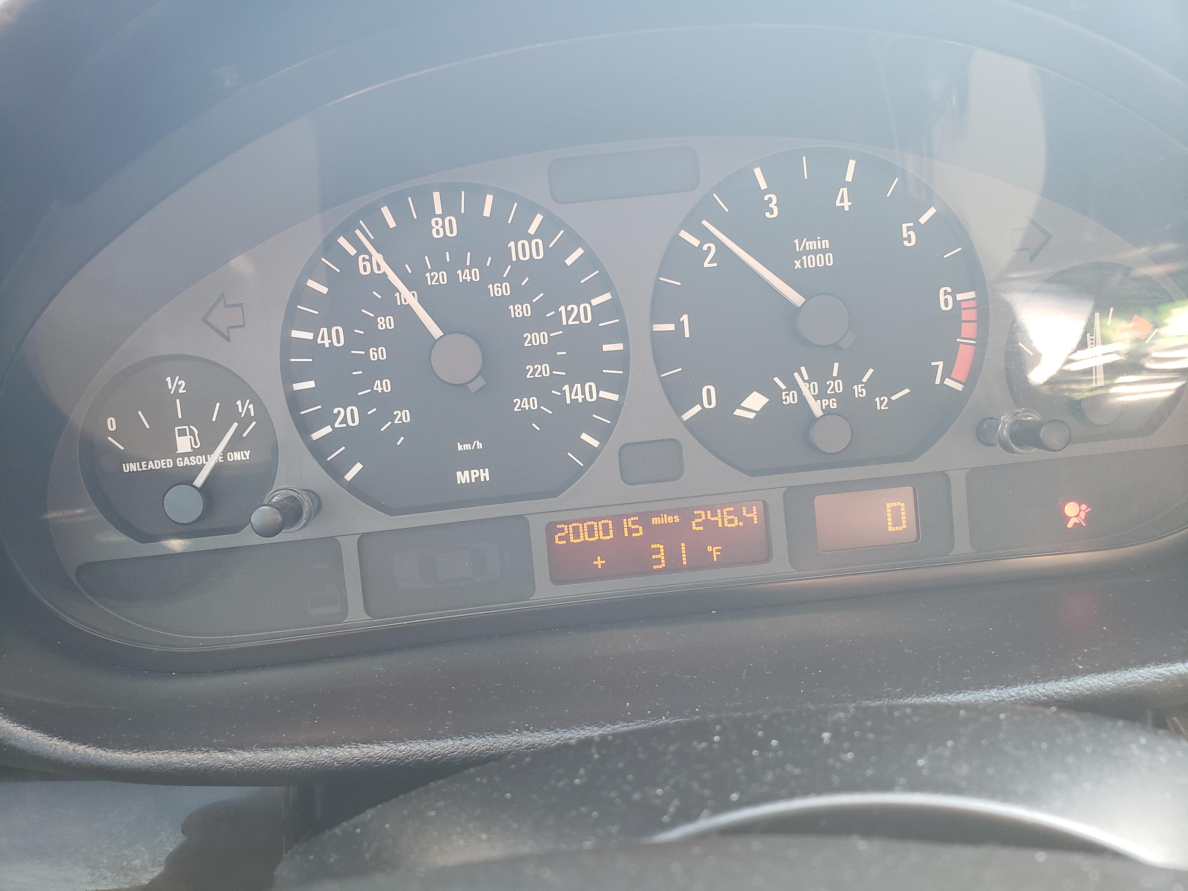

                                Also turned over 200,000 miles!  Missed the moment due to being on the phone with a seller but this is close enough.  Measuring miles instead of mins.

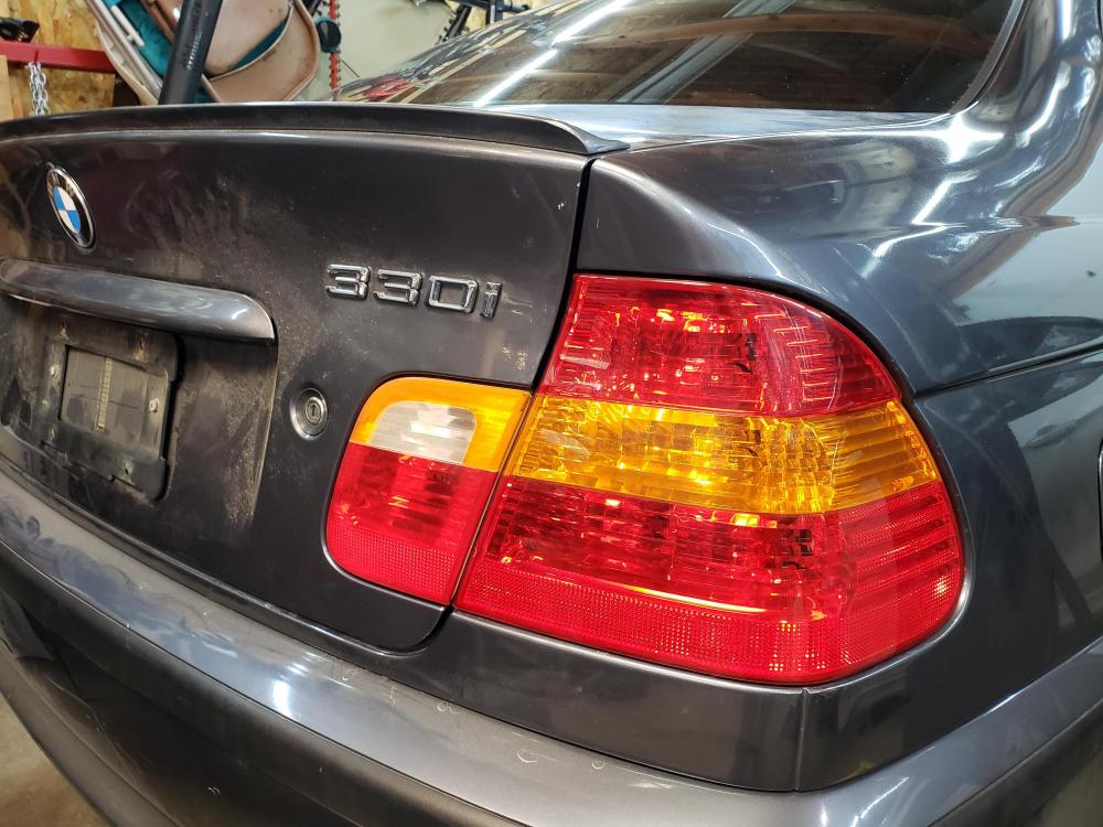

                                      Breaking purists' hearts with the new 330i/325xi!
                                      Rust free trunk installed, Thanks Troy!
                                           @DrLeadFoot

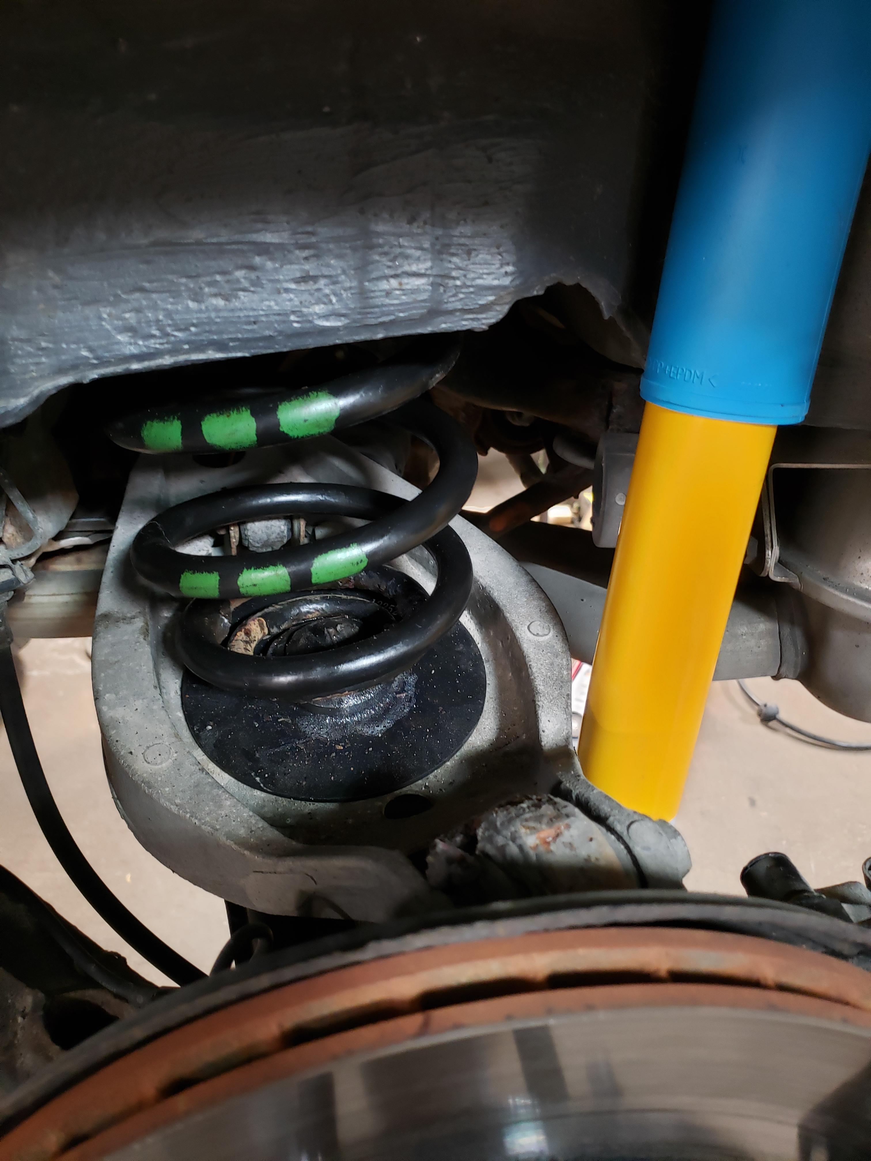

                                          203,XXX miles
                                          New Bilstein B6 struts/shocks and replaced the rear broken spring with these green ones my buddy had.  The original ones were thicker and had white markings.  Sitting a little lower in the rear but I'll get new 325xi rear springs later.  Totally different car with the new shocks.
