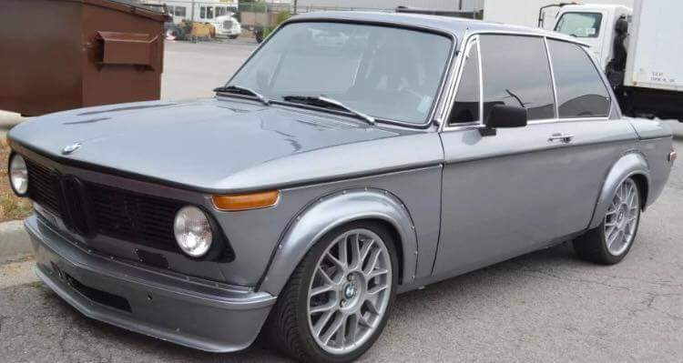

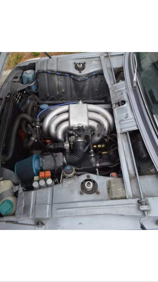

<p dir="auto"><a href="/assets/uploads/files/monthly_10_2015_post-2578-0-05231300-1444785189.jpeg"><img src="/assets/uploads/files/monthly_10_2015_post-2578-0-05231300-1444785189_thumb.jpeg" alt="post-2578-0-05231300-1444785189thumb.jp" class=" img-fluid img-markdown" width="750" height="399" /></a></p>
<p dir="auto"><a href="/assets/uploads/files/monthly_10_2015_post-2578-0-08057800-1444785221.jpeg"><img src="/assets/uploads/files/monthly_10_2015_post-2578-0-08057800-1444785221_thumb.jpeg" alt="post-2578-0-08057800-1444785221thumb.jp" class=" img-fluid img-markdown" width="422" height="750" /></a></p>
