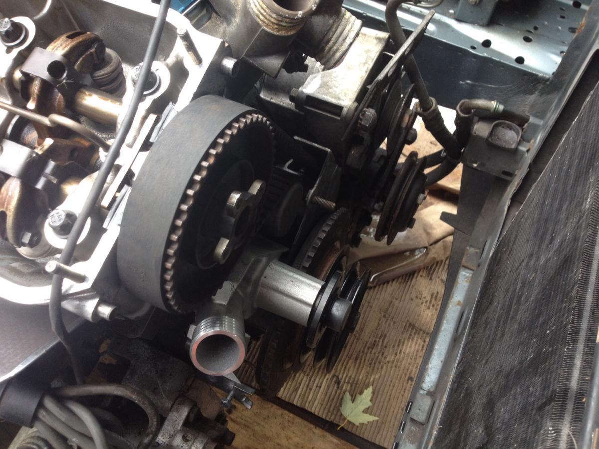

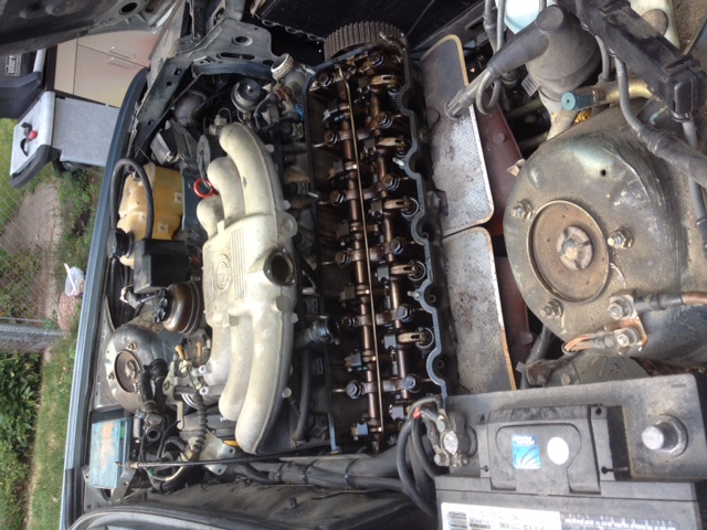

<p dir="auto"><a href="/assets/uploads/files/monthly_09_2015_post-2609-0-07601800-1442525613.jpg"><img src="/assets/uploads/files/monthly_09_2015_post-2609-0-07601800-1442525613_thumb.jpg" alt="post-2609-0-07601800-1442525613thumb.jp" class=" img-fluid img-markdown" width="640" height="480" /></a></p>
<p dir="auto"><a href="/assets/uploads/files/monthly_09_2015_post-2609-0-33609600-1442525622.jpg"><img src="/assets/uploads/files/monthly_09_2015_post-2609-0-33609600-1442525622_thumb.jpg" alt="post-2609-0-33609600-1442525622thumb.jp" class=" img-fluid img-markdown" width="640" height="480" /></a></p>
<p dir="auto"><a href="/assets/uploads/files/monthly_09_2015_post-2609-0-76243400-1442525630.jpg"><img src="/assets/uploads/files/monthly_09_2015_post-2609-0-76243400-1442525630_thumb.jpg" alt="post-2609-0-76243400-1442525630thumb.jp" class=" img-fluid img-markdown" width="640" height="480" /></a></p>
<p dir="auto"><a href="/assets/uploads/files/monthly_09_2015_post-2609-0-72588400-1442525639.jpg"><img src="/assets/uploads/files/monthly_09_2015_post-2609-0-72588400-1442525639_thumb.jpg" alt="post-2609-0-72588400-1442525639thumb.jp" class=" img-fluid img-markdown" width="640" height="480" /></a></p>
]]></description><link>https://wibimmers.com/post/61974</link><guid isPermaLink="true">https://wibimmers.com/post/61974</guid><dc:creator><![CDATA[6670charger]]></dc:creator><pubDate>Thu, 17 Sep 2015 21:34:06 GMT</pubDate></item><item><title><![CDATA[Reply to Replacing seals in my M20 on Thu, 17 Sep 2015 01:55:26 GMT]]></title><description><![CDATA[<p dir="auto">It is quite a workout installing a head. Looking good!</p>

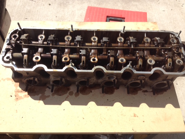

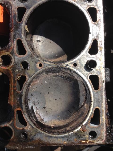

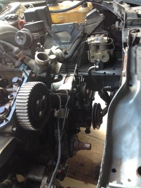

<p dir="auto"><a href="/assets/uploads/files/monthly_09_2015_post-2609-0-06584000-1442418477.jpg"><img src="/assets/uploads/files/monthly_09_2015_post-2609-0-06584000-1442418477_thumb.jpg" alt="post-2609-0-06584000-1442418477thumb.jp" class=" img-fluid img-markdown" width="640" height="480" /></a></p>
<p dir="auto"><a href="/assets/uploads/files/monthly_09_2015_post-2609-0-25711400-1442418486.jpg"><img src="/assets/uploads/files/monthly_09_2015_post-2609-0-25711400-1442418486_thumb.jpg" alt="post-2609-0-25711400-1442418486thumb.jp" class=" img-fluid img-markdown" width="640" height="480" /></a></p>
<p dir="auto"><a href="/assets/uploads/files/monthly_09_2015_post-2609-0-55166600-1442418500.jpg"><img src="/assets/uploads/files/monthly_09_2015_post-2609-0-55166600-1442418500_thumb.jpg" alt="post-2609-0-55166600-1442418500thumb.jp" class=" img-fluid img-markdown" width="480" height="640" /></a></p>
]]></description><link>https://wibimmers.com/post/61915</link><guid isPermaLink="true">https://wibimmers.com/post/61915</guid><dc:creator><![CDATA[6670charger]]></dc:creator><pubDate>Wed, 16 Sep 2015 15:48:24 GMT</pubDate></item><item><title><![CDATA[Reply to Replacing seals in my M20 on Fri, 11 Sep 2015 18:08:39 GMT]]></title><description><![CDATA[<p dir="auto">Well, hope to get started on re-assembly this weekend and maybe on the road by Monday. Any suggestions for a newbie to head gasket replacement regarding setting the gasket and timing?</p>

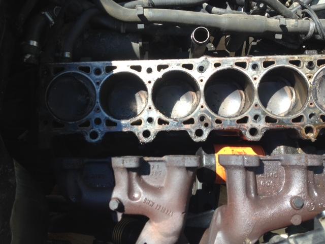

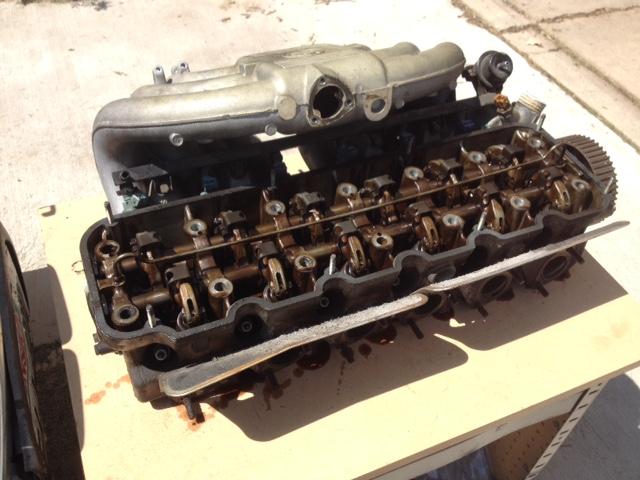

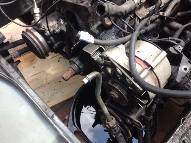

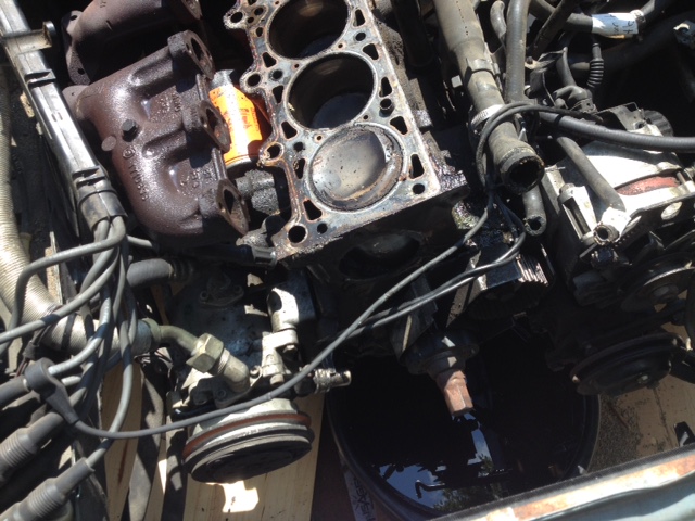

<p dir="auto">Got new head bolts, took a tap to each of the bolt holes to clean them up. All holes are dry and I took my parts retriever magnet to each of the holes to fish out any metal shavings from the tap. Took a razor blade to the top of the block and cleaned all the remnants of the old gasket, and cleaned the front of the block to set myself up for success on the water pump.</p>
