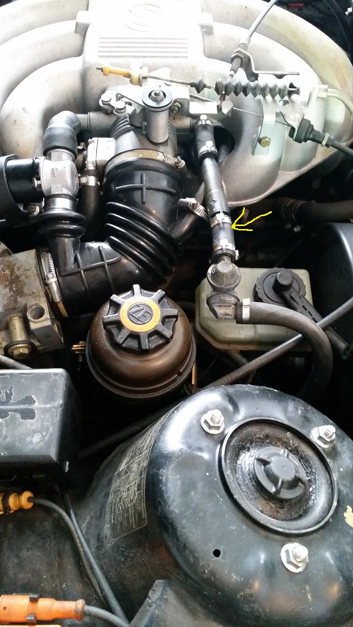

<p dir="auto">While waiting for that to come in I popped the valve cover and adjusted the valves.  There wasn't 1 that I could get the feeler under, so they were pretty tight.  I adjusted those to the best of my ability.  Definitely a finky job.  I don't feel like I did as good as I could have, anyway...</p>
<p dir="auto">Hose came in today and put it back on over lunch.  Fired it up.  Seemed to still do the same thing initially but settled down after a little bit.  DME adjusting itself??  I let it idle for 5 mins before working up the courage to take it out.  Drove it for 10 mins around the subdivision and a road up to 45 mph.  Knock on wood it performed well.  Going to put it through some more rigorous driving tonight.  </p>
<p dir="auto">I did notice my idle dropped to the 800 ish rpm range, where before it was about 1100 rpm.  So, I think that's a good thing too.  Valves still seem to tick a bit, there's probably one or two that aren't quite right.</p>

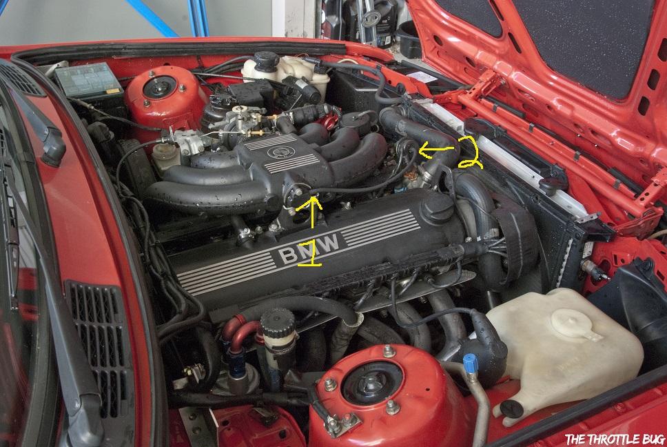

<p dir="auto">-any hoses removed, reattached improperly when removing the valve cover, or opening the air box to replace the filter (the wire plug to the air box unconnected/ reconnected), metal elbows still tight on the throttle body after working on the air box,</p>
<p dir="auto">-main accordion air hose to throttle body not cracked in the accordion seams (old hose could crack when opening the air box to replace the filter)</p>
