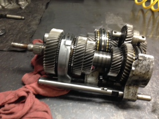

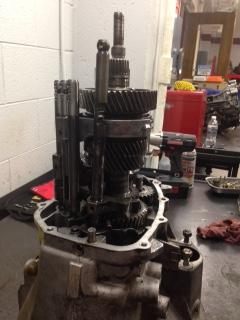

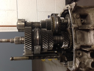

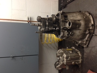

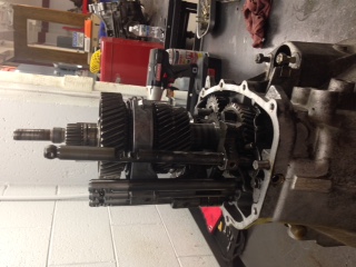

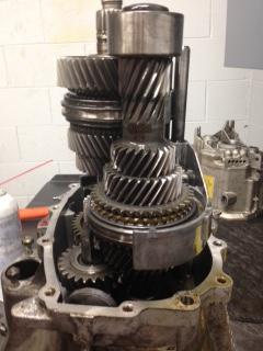

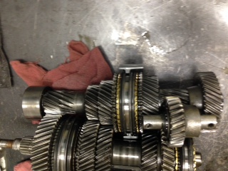

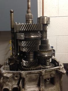

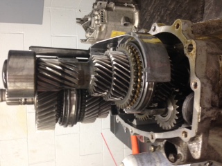

<?xml version="1.0" encoding="UTF-8"?><rss xmlns:dc="http://purl.org/dc/elements/1.1/" xmlns:content="http://purl.org/rss/1.0/modules/content/" xmlns:atom="http://www.w3.org/2005/Atom" version="2.0"><channel><title><![CDATA[Getrag 250]]></title><description><![CDATA[<p dir="auto">My car an E46 323i with 70,000 miles started to develop a grinding noise on downshifts into 2nd gear and sometimes the inability to engage 1st gear while fully stopped. I opted to repair my trans instead of replacement. I figured I should share some pictures of the process. I didn't document the entire process because its pretty in depth and my hands were constantly covered in oil. So far I have the trans pulled, case split and inspected my gear train and have most of my parts. My first gear friction ring for my synchro was completely shot (pictures to come), along with small amounts of wear on the friction ring for the 2nd gear synchro.<a href="/assets/uploads/files/monthly_02_2015_post-3360-0-93353100-1423798185.jpg"><img src="/assets/uploads/files/monthly_02_2015_post-3360-0-93353100-1423798185_thumb.jpg" alt="post-3360-0-93353100-1423798185thumb.jp" class=" img-fluid img-markdown" width="240" height="320" /></a><a href="/assets/uploads/files/monthly_02_2015_post-3360-0-52252100-1423798255.jpg"><img src="/assets/uploads/files/monthly_02_2015_post-3360-0-52252100-1423798255_thumb.jpg" alt="post-3360-0-52252100-1423798255thumb.jp" class=" img-fluid img-markdown" width="320" height="240" /></a><a href="/assets/uploads/files/monthly_02_2015_post-3360-0-03906300-1423798263.jpg"><img src="/assets/uploads/files/monthly_02_2015_post-3360-0-03906300-1423798263_thumb.jpg" alt="post-3360-0-03906300-1423798263thumb.jp" class=" img-fluid img-markdown" width="320" height="240" /></a><a href="/assets/uploads/files/monthly_02_2015_post-3360-0-99899800-1423798267.jpg"><img src="/assets/uploads/files/monthly_02_2015_post-3360-0-99899800-1423798267_thumb.jpg" alt="post-3360-0-99899800-1423798267thumb.jp" class=" img-fluid img-markdown" width="240" height="320" /></a><a href="/assets/uploads/files/monthly_02_2015_post-3360-0-23895700-1423798273.jpg"><img src="/assets/uploads/files/monthly_02_2015_post-3360-0-23895700-1423798273_thumb.jpg" alt="post-3360-0-23895700-1423798273thumb.jp" class=" img-fluid img-markdown" width="240" height="320" /></a><a href="/assets/uploads/files/monthly_02_2015_post-3360-0-29953000-1423798288.jpg"><img src="/assets/uploads/files/monthly_02_2015_post-3360-0-29953000-1423798288_thumb.jpg" alt="post-3360-0-29953000-1423798288thumb.jp" class=" img-fluid img-markdown" width="240" height="320" /></a></p>
]]></description><link>https://wibimmers.com/topic/3522/getrag-250</link><generator>RSS for Node</generator><lastBuildDate>Wed, 16 Sep 2026 04:50:38 GMT</lastBuildDate><atom:link href="https://wibimmers.com/topic/3522.rss" rel="self" type="application/rss+xml"/><pubDate>Fri, 13 Feb 2015 03:32:05 GMT</pubDate><ttl>60</ttl><item><title><![CDATA[Reply to Getrag 250 on Sun, 22 Feb 2015 23:54:11 GMT]]></title><description><![CDATA[<p dir="auto">BMW lists several special service tools but if you use your imagination you can create them. You will need a bearing splitter and something to press the gear train out of the input shaft bearing. Thats all that comes to mind right now</p>
]]></description><link>https://wibimmers.com/post/54689</link><guid isPermaLink="true">https://wibimmers.com/post/54689</guid><dc:creator><![CDATA[Schwabenlander]]></dc:creator><pubDate>Sun, 22 Feb 2015 23:54:11 GMT</pubDate></item><item><title><![CDATA[Reply to Getrag 250 on Sat, 14 Feb 2015 03:22:00 GMT]]></title><description><![CDATA[<p dir="auto">Any special tools required to change the syncros? I suspect my 240 will have the same issue with 1st gear.</p>
]]></description><link>https://wibimmers.com/post/54218</link><guid isPermaLink="true">https://wibimmers.com/post/54218</guid><dc:creator><![CDATA[HipMF]]></dc:creator><pubDate>Sat, 14 Feb 2015 03:22:00 GMT</pubDate></item><item><title><![CDATA[Reply to Getrag 250 on Fri, 13 Feb 2015 19:09:17 GMT]]></title><description><![CDATA[<p dir="auto">This case was pretty tough to split! I'm lucky enough to have All Data to my advantage</p>
]]></description><link>https://wibimmers.com/post/54181</link><guid isPermaLink="true">https://wibimmers.com/post/54181</guid><dc:creator><![CDATA[Schwabenlander]]></dc:creator><pubDate>Fri, 13 Feb 2015 19:09:17 GMT</pubDate></item><item><title><![CDATA[Reply to Getrag 250 on Fri, 13 Feb 2015 15:08:12 GMT]]></title><description><![CDATA[<p dir="auto">you brave man</p>
