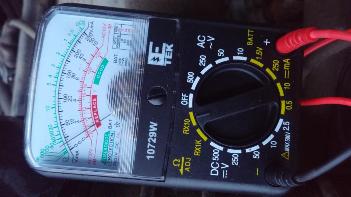

<?xml version="1.0" encoding="UTF-8"?><rss xmlns:dc="http://purl.org/dc/elements/1.1/" xmlns:content="http://purl.org/rss/1.0/modules/content/" xmlns:atom="http://www.w3.org/2005/Atom" version="2.0"><channel><title><![CDATA[no spark m30]]></title><description><![CDATA[<p dir="auto">Well I've finally gotten around to diagnosing my m30 with no spark. I've tried switching the coil and wires out with no luck. Im trying to test the crank sensor... This is the reading i got, are my settings right? If so what does the readout mean, i think its supposed to be around 540 ohms?</p>
<p dir="auto"><a href="/assets/uploads/files/monthly_01_2015_post-3433-0-24343800-1421623308.jpg"><img src="/assets/uploads/files/monthly_01_2015_post-3433-0-24343800-1421623308_thumb.jpg" alt="post-3433-0-24343800-1421623308thumb.jp" class=" img-fluid img-markdown" width="1000" height="563" /></a></p>

]]></description><link>https://wibimmers.com/post/52887</link><guid isPermaLink="true">https://wibimmers.com/post/52887</guid><dc:creator><![CDATA[frcefed]]></dc:creator><pubDate>Mon, 19 Jan 2015 07:05:22 GMT</pubDate></item><item><title><![CDATA[Reply to no spark m30 on Sun, 18 Jan 2015 23:43:40 GMT]]></title><description><![CDATA[<p dir="auto">A resistance reading only tells you that the wiring isnt broken. The air gap could be too large and the sensor could still be bad</p>
]]></description><link>https://wibimmers.com/post/52872</link><guid isPermaLink="true">https://wibimmers.com/post/52872</guid><dc:creator><![CDATA[B C]]></dc:creator><pubDate>Sun, 18 Jan 2015 23:43:40 GMT</pubDate></item></channel></rss>
