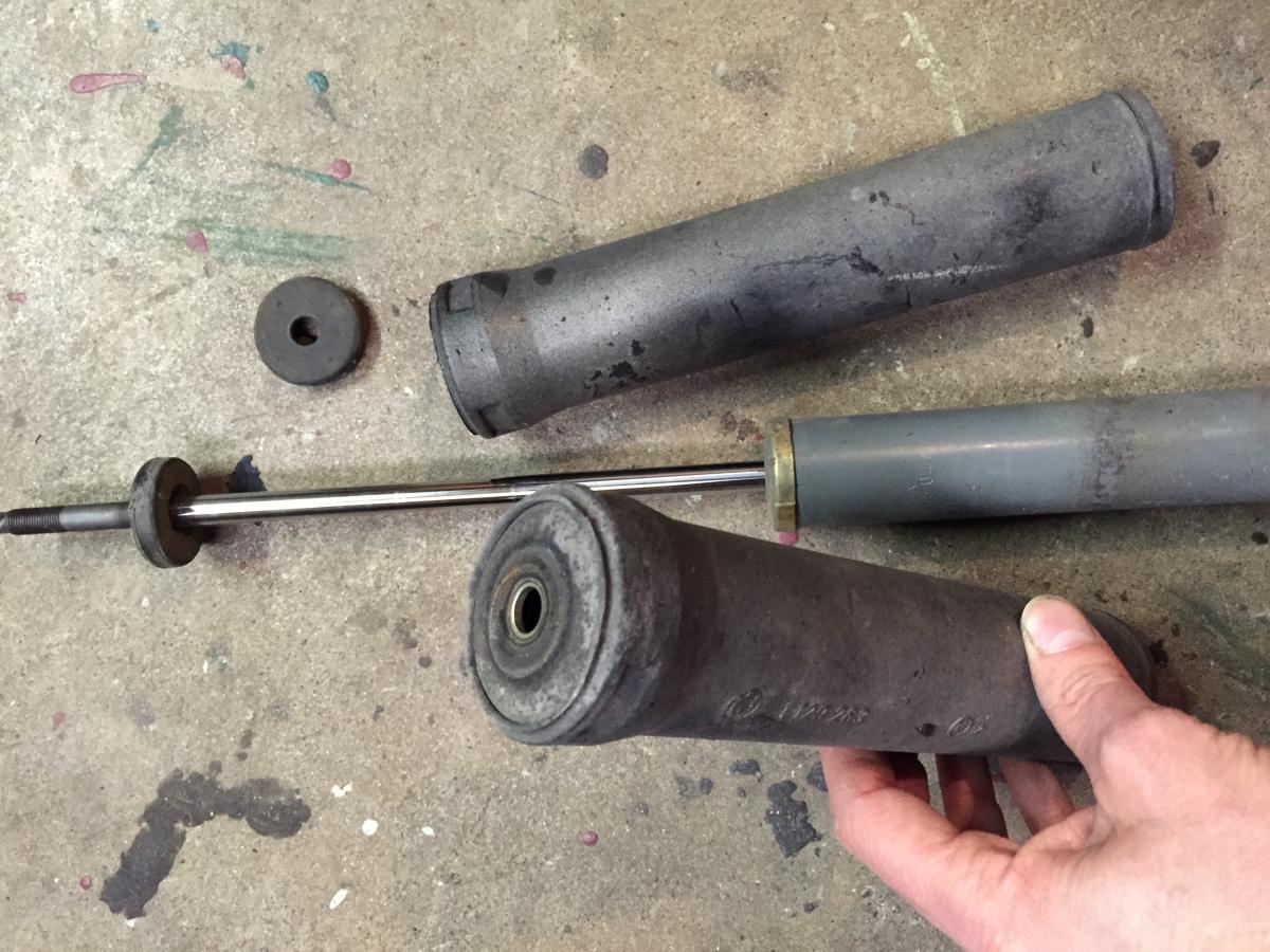

<p dir="auto">When I put in the bilstein and h&amp;r sports I followed the Turner diagram on assembly plus bought a set of stock rear plastic boots. Bilsteins don't have the Kyb metal sleeve and with a winter DD figured it would be good to keep the crap out of the shock.</p>
<p dir="auto">Still think your bouncing has more to do with the RSM and/or the pairing of shocks and springs. Might help to have someone take a ride with you to figure out what's going on.</p>
]]></description><link>https://wibimmers.com/post/52121</link><guid isPermaLink="true">https://wibimmers.com/post/52121</guid><dc:creator><![CDATA[Boris3]]></dc:creator><pubDate>Sun, 04 Jan 2015 14:56:09 GMT</pubDate></item><item><title><![CDATA[Reply to Rear end sideways bump on Sun, 04 Jan 2015 14:24:03 GMT]]></title><description><![CDATA[<blockquote>

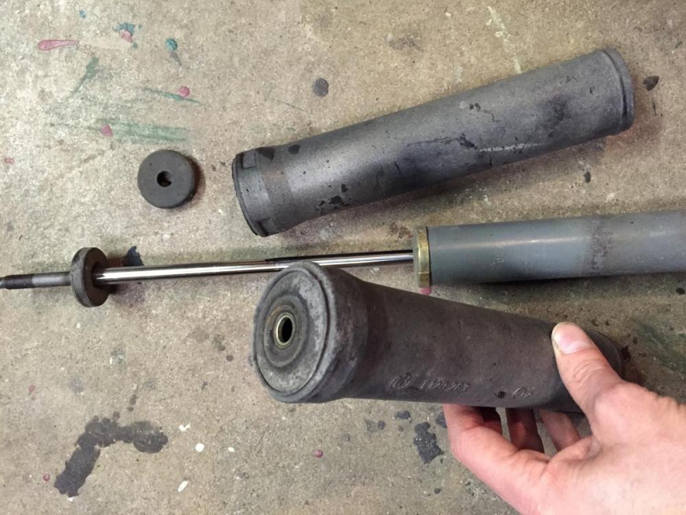

<p dir="auto"><strong><a href="/post/52098">Boris3 said:</a></strong></p>
<p dir="auto">That round rubber disk is your bump stop. The plastic sleeve will keep dirt and crap out of the shock and in the top of the sleeve is a metal cup washer open side down. See the Turner picture: which omits the bump stop and the sleeve.</p>
<p dir="auto">Now all that said if the rear end wasn't dancing around when you got it the issue is the shock and spring combination.</p>
<p dir="auto">Ok so now I think I still have it wrong. Am I supposed to reuse the washer thats in the sleeve on the bottom side of the mount or since the kyb has a metal sleeve on the shock do I not use a washer at all on the bottom. Because what I think I have going on now is 2 top washers. One on bottom and one on top.</p>

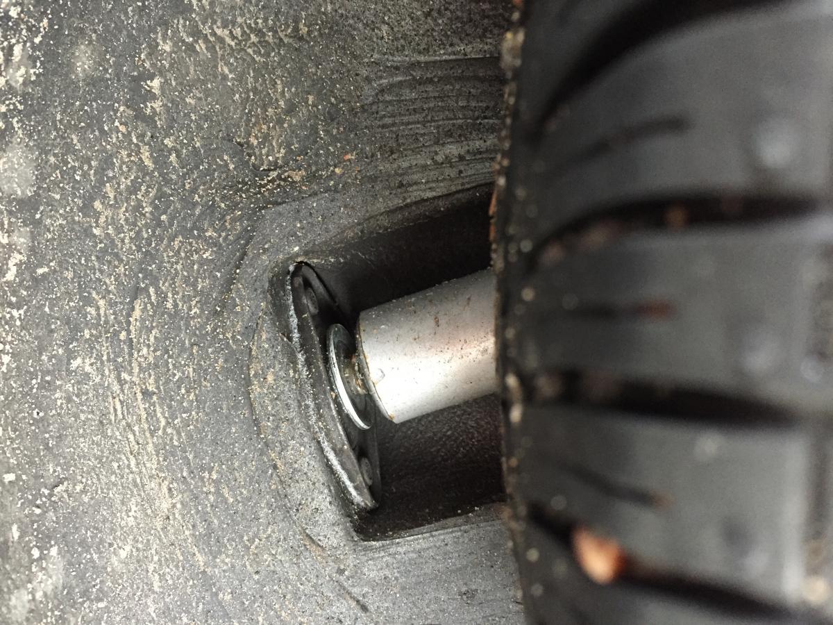

<p dir="auto"><a href="/assets/uploads/files/monthly_01_2015_post-2797-0-40043700-1420334867.jpg"><img src="/assets/uploads/files/monthly_01_2015_post-2797-0-40043700-1420334867_thumb.jpg" alt="post-2797-0-40043700-1420334867thumb.jp" class=" img-fluid img-markdown" width="1000" height="750" /></a></p>
<p dir="auto"><a href="/assets/uploads/files/monthly_01_2015_post-2797-0-25232800-1420334901.jpg"><img src="/assets/uploads/files/monthly_01_2015_post-2797-0-25232800-1420334901_thumb.jpg" alt="post-2797-0-25232800-1420334901thumb.jp" class=" img-fluid img-markdown" width="1000" height="750" /></a></p>
<p dir="auto"><a href="/assets/uploads/files/monthly_01_2015_post-2797-0-15596100-1420334980.jpg"><img src="/assets/uploads/files/monthly_01_2015_post-2797-0-15596100-1420334980_thumb.jpg" alt="post-2797-0-15596100-1420334980thumb.jp" class=" img-fluid img-markdown" width="800" height="600" /></a></p>
<p dir="auto"><a href="/assets/uploads/files/monthly_01_2015_post-2797-0-42044000-1420335020.jpg"><img src="/assets/uploads/files/monthly_01_2015_post-2797-0-42044000-1420335020_thumb.jpg" alt="post-2797-0-42044000-1420335020thumb.jp" class=" img-fluid img-markdown" width="1000" height="750" /></a></p>
]]></description><link>https://wibimmers.com/post/52101</link><guid isPermaLink="true">https://wibimmers.com/post/52101</guid><dc:creator><![CDATA[michael1972]]></dc:creator><pubDate>Sun, 04 Jan 2015 01:35:01 GMT</pubDate></item><item><title><![CDATA[Reply to Rear end sideways bump on Sat, 03 Jan 2015 23:14:17 GMT]]></title><description><![CDATA[<p dir="auto">That round rubber disk is your bump stop. The plastic sleeve will keep dirt and crap out of the shock and in the top of the sleeve is a metal cup washer open side down. See the Turner picture: which omits the bump stop and the sleeve.</p>

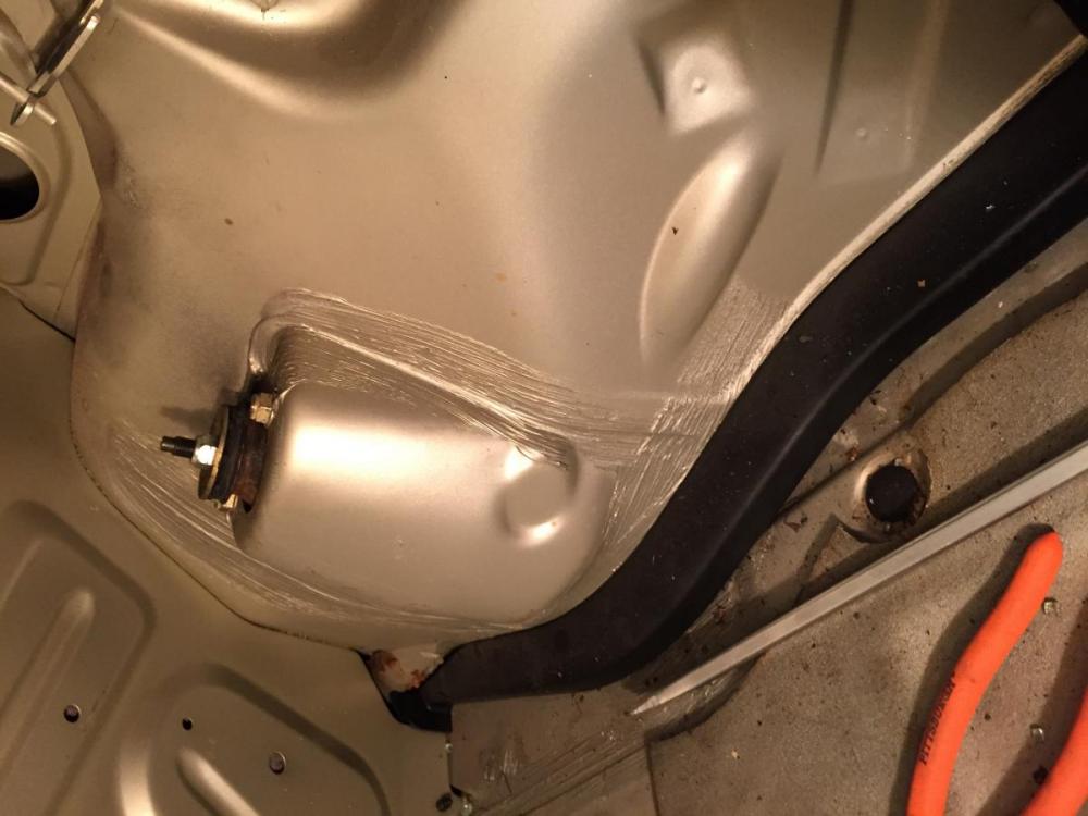

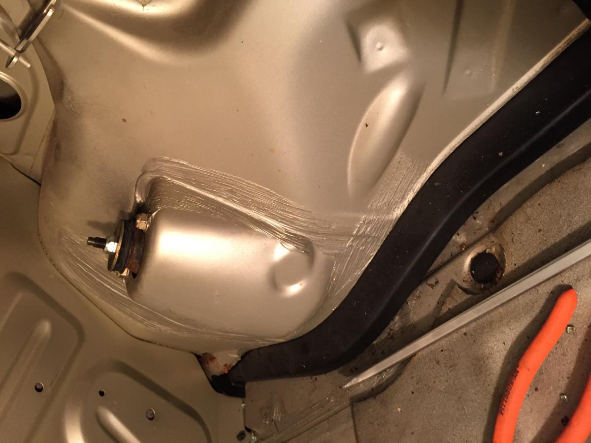

<p dir="auto"><a href="/assets/uploads/files/monthly_01_2015_post-2797-0-68085000-1420324025.jpg"><img src="/assets/uploads/files/monthly_01_2015_post-2797-0-68085000-1420324025_thumb.jpg" alt="post-2797-0-68085000-1420324025thumb.jp" class=" img-fluid img-markdown" width="1000" height="750" /></a></p>
]]></description><link>https://wibimmers.com/post/52095</link><guid isPermaLink="true">https://wibimmers.com/post/52095</guid><dc:creator><![CDATA[michael1972]]></dc:creator><pubDate>Sat, 03 Jan 2015 22:28:01 GMT</pubDate></item><item><title><![CDATA[Reply to Rear end sideways bump on Sat, 03 Jan 2015 22:22:04 GMT]]></title><description><![CDATA[<p dir="auto">Well now you have me second guessing. But I took the stuff off the one and put it on the other same way.</p>
]]></description><link>https://wibimmers.com/post/52094</link><guid isPermaLink="true">https://wibimmers.com/post/52094</guid><dc:creator><![CDATA[michael1972]]></dc:creator><pubDate>Sat, 03 Jan 2015 22:22:04 GMT</pubDate></item><item><title><![CDATA[Reply to Rear end sideways bump on Sat, 03 Jan 2015 21:32:42 GMT]]></title><description><![CDATA[<p dir="auto">A couple other things to think about. Did you replace the rear shock mounts? How did the rear towers look when you did the replacements (no tears in the metal)?</p>

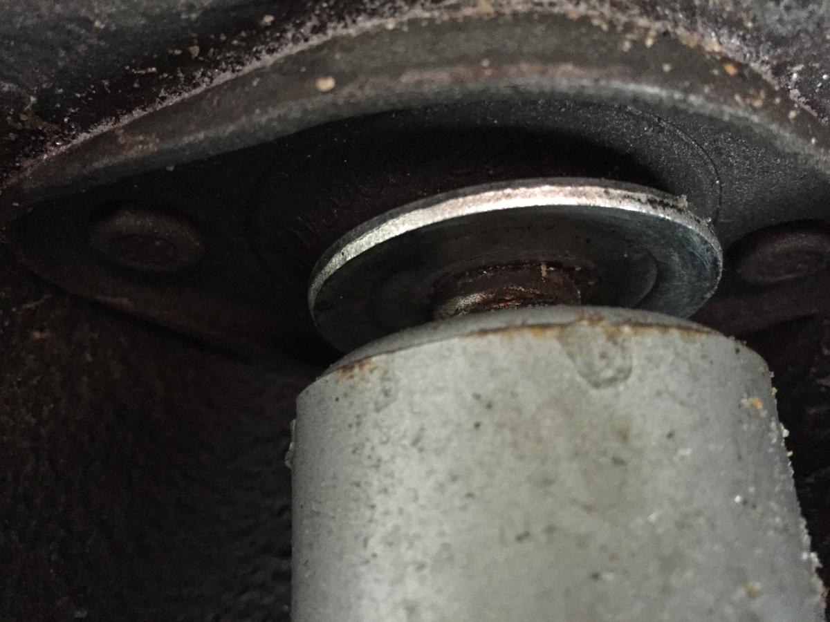

<p dir="auto">Did you put everything together correctly (esp the orientation of the cupped washers)?</p>
<p dir="auto"><a href="http://www.turnermotorsport.com/pages/Instructions/rear_shock_assembly.pdf" rel="nofollow ugc">http://www.turnermotorsport.com/pages/Instructions/rear_shock_assembly.pdf</a></p>
]]></description><link>https://wibimmers.com/post/52091</link><guid isPermaLink="true">https://wibimmers.com/post/52091</guid><dc:creator><![CDATA[Boris3]]></dc:creator><pubDate>Sat, 03 Jan 2015 21:32:42 GMT</pubDate></item><item><title><![CDATA[Reply to Rear end sideways bump on Sat, 03 Jan 2015 20:52:43 GMT]]></title><description><![CDATA[<p dir="auto">Earl would these be what I would want to try?</p>
