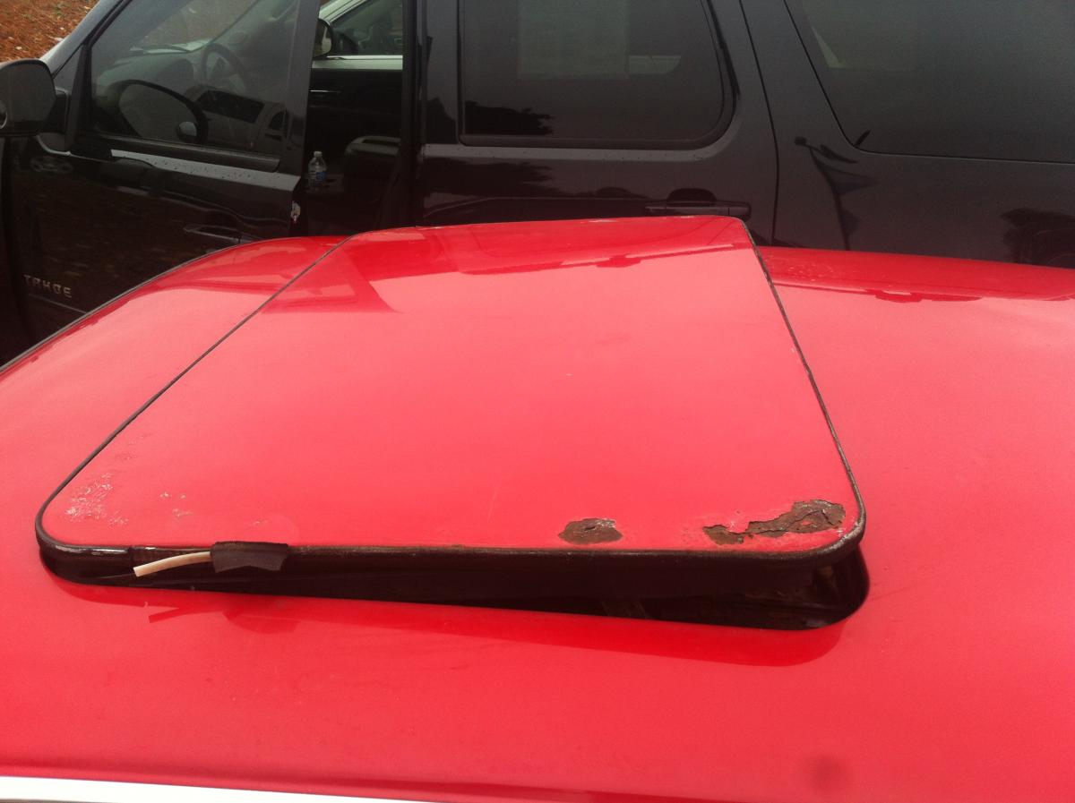

<?xml version="1.0" encoding="UTF-8"?><rss xmlns:dc="http://purl.org/dc/elements/1.1/" xmlns:content="http://purl.org/rss/1.0/modules/content/" xmlns:atom="http://www.w3.org/2005/Atom" version="2.0"><channel><title><![CDATA[Removing and Replacing e30 sunroof]]></title><description><![CDATA[<p dir="auto">I could not find a thread about this, but I was wondering if anyone had experience removing and replacing the sunroof panel on an e30?  I was also wondering what sort of electrical work would need to be done since it is a power roof.  I have read other instructions but almost all are on crank sunroofs. I bought the car with the old panel still partly in as well. Thanks! </p>
<p dir="auto"><a href="/assets/uploads/files/monthly_10_2014_post-3530-0-81831400-1413912276.jpg"><img src="/assets/uploads/files/monthly_10_2014_post-3530-0-81831400-1413912276_thumb.jpg" alt="post-3530-0-81831400-1413912276thumb.jp" class=" img-fluid img-markdown" width="1000" height="748" /></a></p>

]]></description><link>https://wibimmers.com/post/49140</link><guid isPermaLink="true">https://wibimmers.com/post/49140</guid><dc:creator><![CDATA[dirty30]]></dc:creator><pubDate>Mon, 27 Oct 2014 19:32:55 GMT</pubDate></item><item><title><![CDATA[Reply to Removing and Replacing e30 sunroof on Thu, 23 Oct 2014 00:14:56 GMT]]></title><description><![CDATA[<p dir="auto">It's a real pain, you need to retract the sunroof into the roof slightly with the handle and then pull the front of the headliner panel attached to the sunroof down, it is clipped at the leading edge. You then need to figure out how to push the cover back into the roof to expose the screws. The real trick is getting it all back on the track correctly!</p>
]]></description><link>https://wibimmers.com/post/49025</link><guid isPermaLink="true">https://wibimmers.com/post/49025</guid><dc:creator><![CDATA[GunMetalGrey]]></dc:creator><pubDate>Thu, 23 Oct 2014 00:14:56 GMT</pubDate></item><item><title><![CDATA[Reply to Removing and Replacing e30 sunroof on Wed, 22 Oct 2014 20:35:29 GMT]]></title><description><![CDATA[<p dir="auto">I didn't get any pics today, sorry, but it appears from what Chris says that it wouldn't help much anyway.</p>
